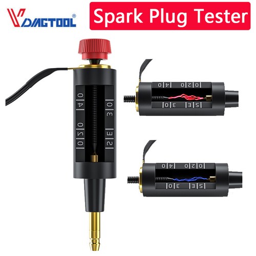

This is all academic now, but I was going to suggest first thing to pull the plugs and check them. Next would be to ohm out the wires- I have seen so many older wires that crack and arc internally and only a resistance test will tell. I also like to use a spark strength tester like this one just to make sure the spark was of sufficient and similar strength, being sure to check both coils. The stock 2-coil system passes current through two wires in series, so is more susceptible to wire failure.
