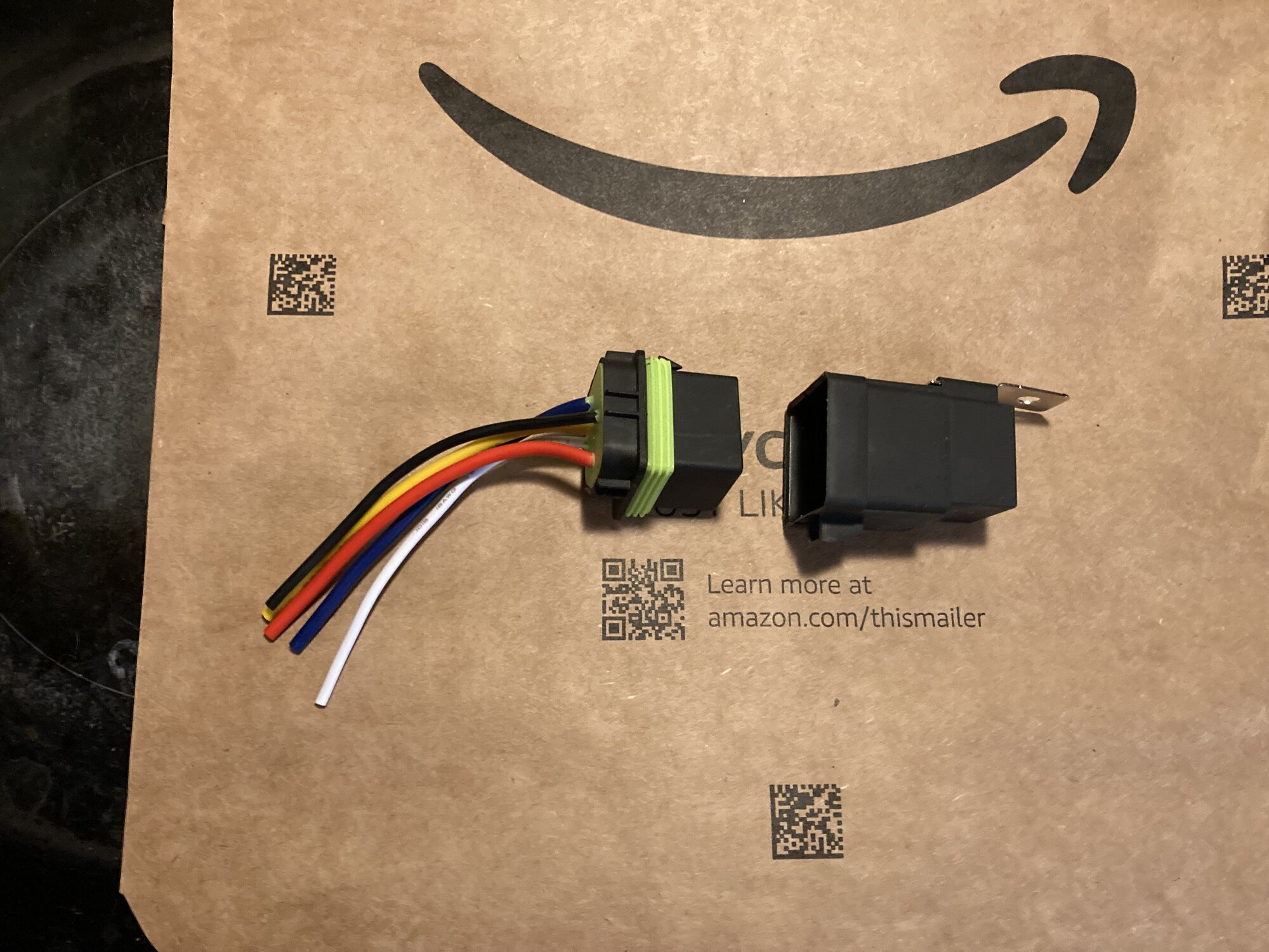

On another note I ordered a neat little thing. It’s a weatherproof and waterproof relay with a plug and pigtail so I can delete my crimped spade terminals and the relay they’re attached to. As a bonus this new relay is rated for much higher amperage too so hopefully it’ll be more resistant to spontaneous combustion. LOL . I even redid the spade terminals since the little fire and they’ve been rock solid no issues, but I’m super paranoid now. I’m uncomfortable with a sudden and random fire right next to my full tank of alcohol. On advice from others that’s why I went with the plug to just completely delete the spade terminals altogether.

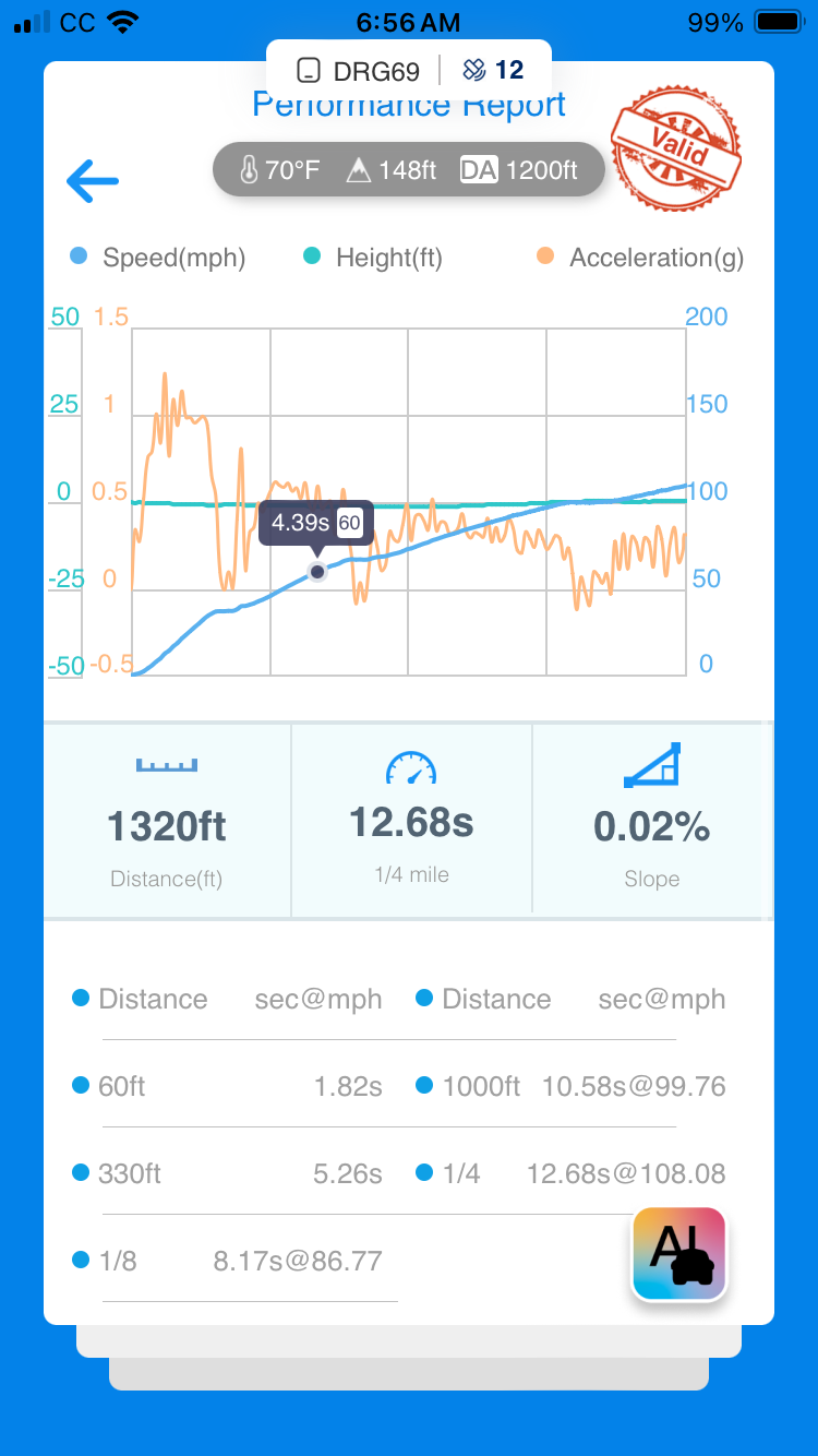

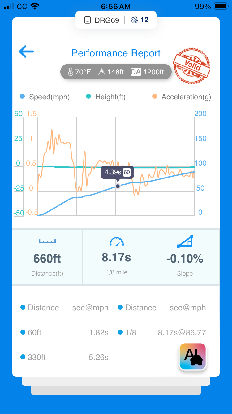

Got a pass in on the way home.
I am super pleased with this considering I did absolutely no changes except driver mod. I stayed on the two step longer and preloaded the ebrake a little more and man. Noticeable difference.
I can’t shift any faster than this sadly, I don’t have the skeelz. But I’m pleased with this. Absolutely slap full coming out of the filler neck tank of E85 as well. 24lbs of boost.
Not bad for 100psi of compression. Wonder what it could do with about 100-110 more. :D

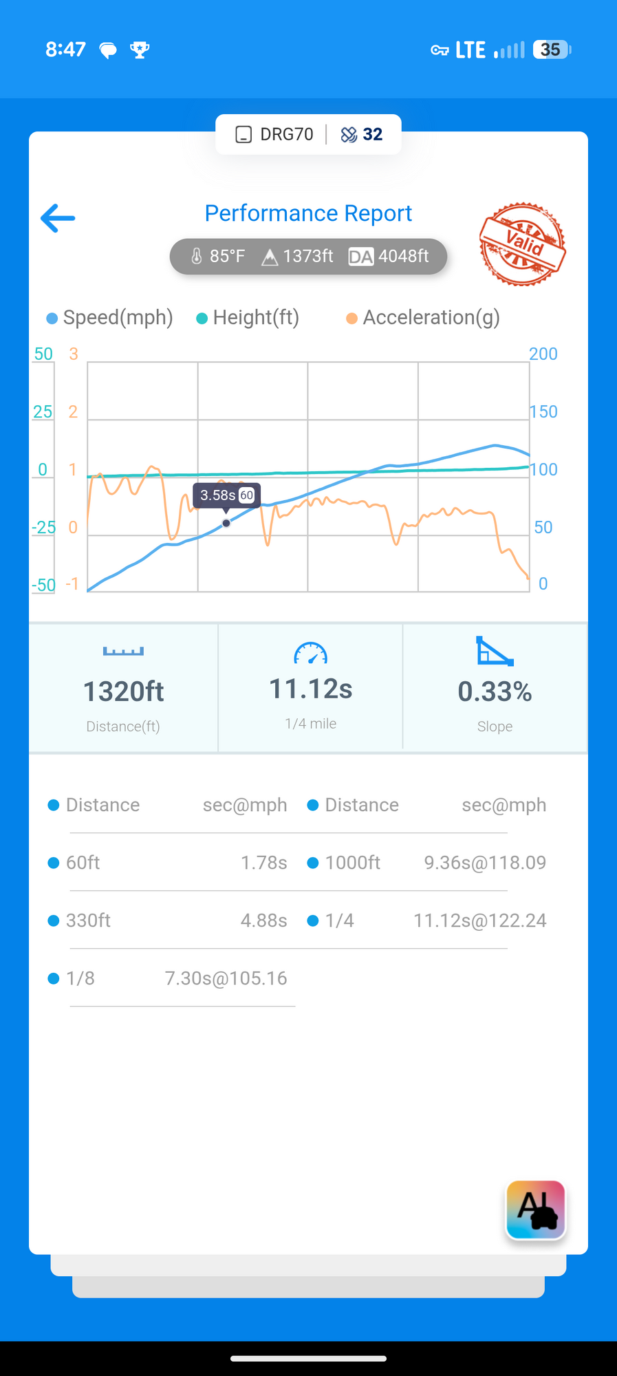

Jealous of your 60ft LOL
Why? I’m jealous of your whole pass! I really want my mph to be like 118 or so and to dip into the 11’s. But that’s just not gonna happen until I figure out what’s up with the compression or whatever.
Bastard is an asshole but he was right when he said months ago that there was a problem. If I deduce the head is leaking past the valves I’m gonna do a 2G head swap.
I’m impressed I ran this fast with essentially half an engine’s worth of compression. And on a small FP Green. I think I’m gonna stop chasing numbers though until I fix the engine.

Because yours seems consistent. I'm having issues with launch control too LOL as soon as my car came off the lower clutch switch it went straight out of launch control and right into my regular redline. That pass was spinning pretty much all of 1st

Oh I see. It definitely felt like a solid launch honestly. Best one so far and it just RIPPED through first. I did kinda feel it lay down up top though and you can see it on the Dragy yellow g-force line. But as far as the 60’ goes I think honestly at the track it would’ve been in the 1.7’s. Dragy usually struggles on the 60’s compared to the other benchmarks.
I’m admittedly a little bummed it’s not faster. But she doesn’t smoke and it isn’t a pile. Really want a 2G head now.

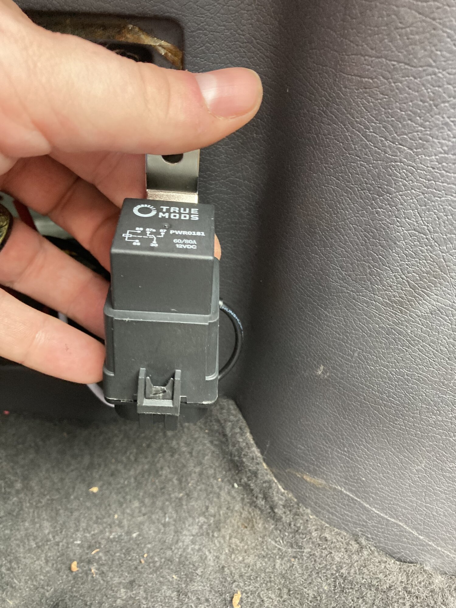

Two of my things came in today, and I'm pleased with it.
First up is this.

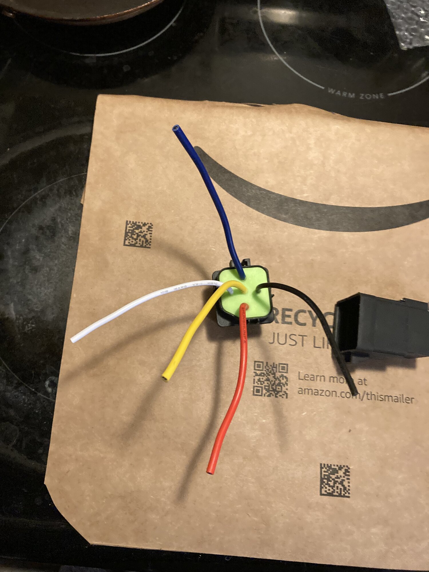

It's a higher load/better quality relay with a weatherpack connector that's rated for underwater usage/marine applications. I'm equally stoked about the weatherproof feature, as I am the higher amperage. Plus, no more spade terminals to connect it. I soldered it because it's my car and it's never going to vibrate a lot back there or move, so wires becoming brittle doesn't concern me.

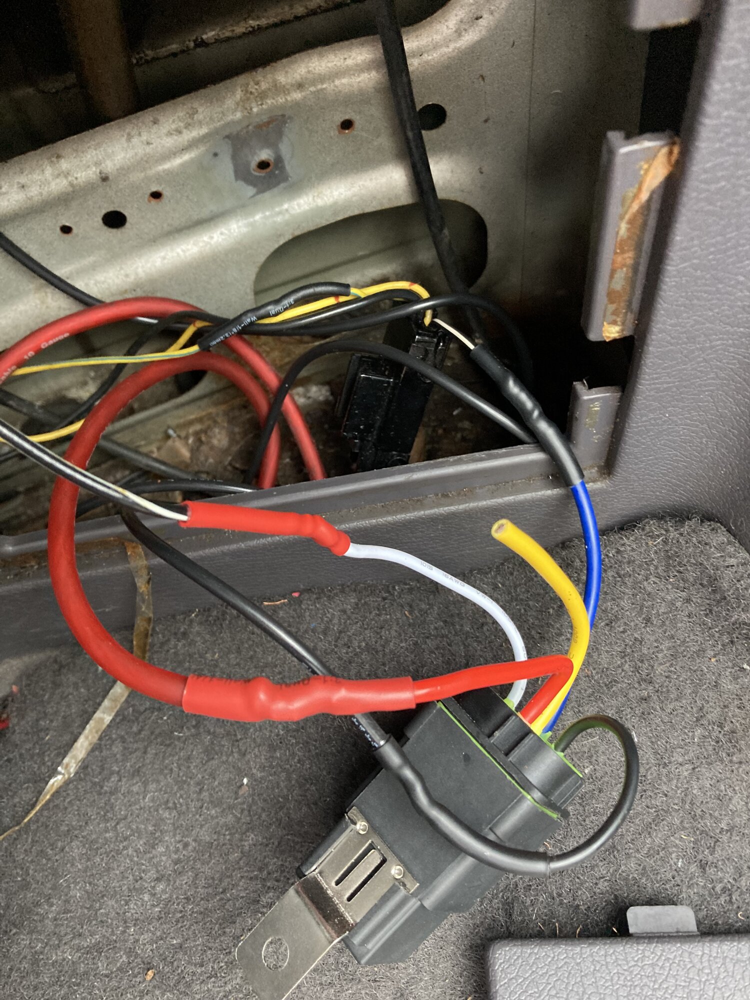

Install was easy, hardest part was soldering the big power wire running from the battery. That wire did not want to heat up. LOL
So nice.
Absolutely full disclosure here, it looks like a rats nest of wires because it is, but they're all sealed and marine 3:1 adhesive lined heat shrink'd up. The object is waterproof/weatherproof everything here. Plus, tucked behind that little panel it's completely hidden. I'm gonna test and monitor wire/relay temps during the next couple weeks and if I'm satisfied, I'll use some wire sheathing to make it all look OEM like an OEM harness so it's not a bundle of wires.

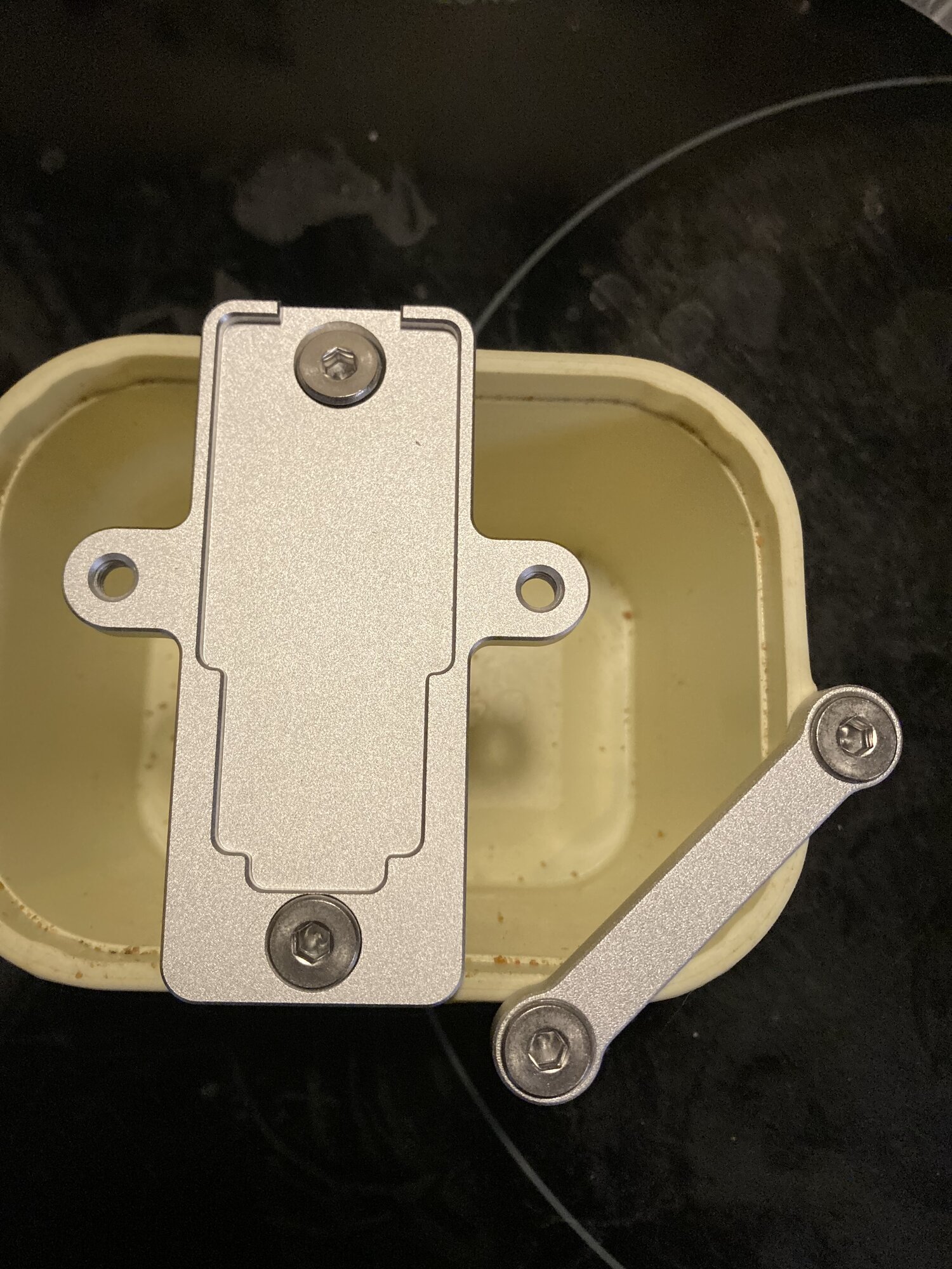

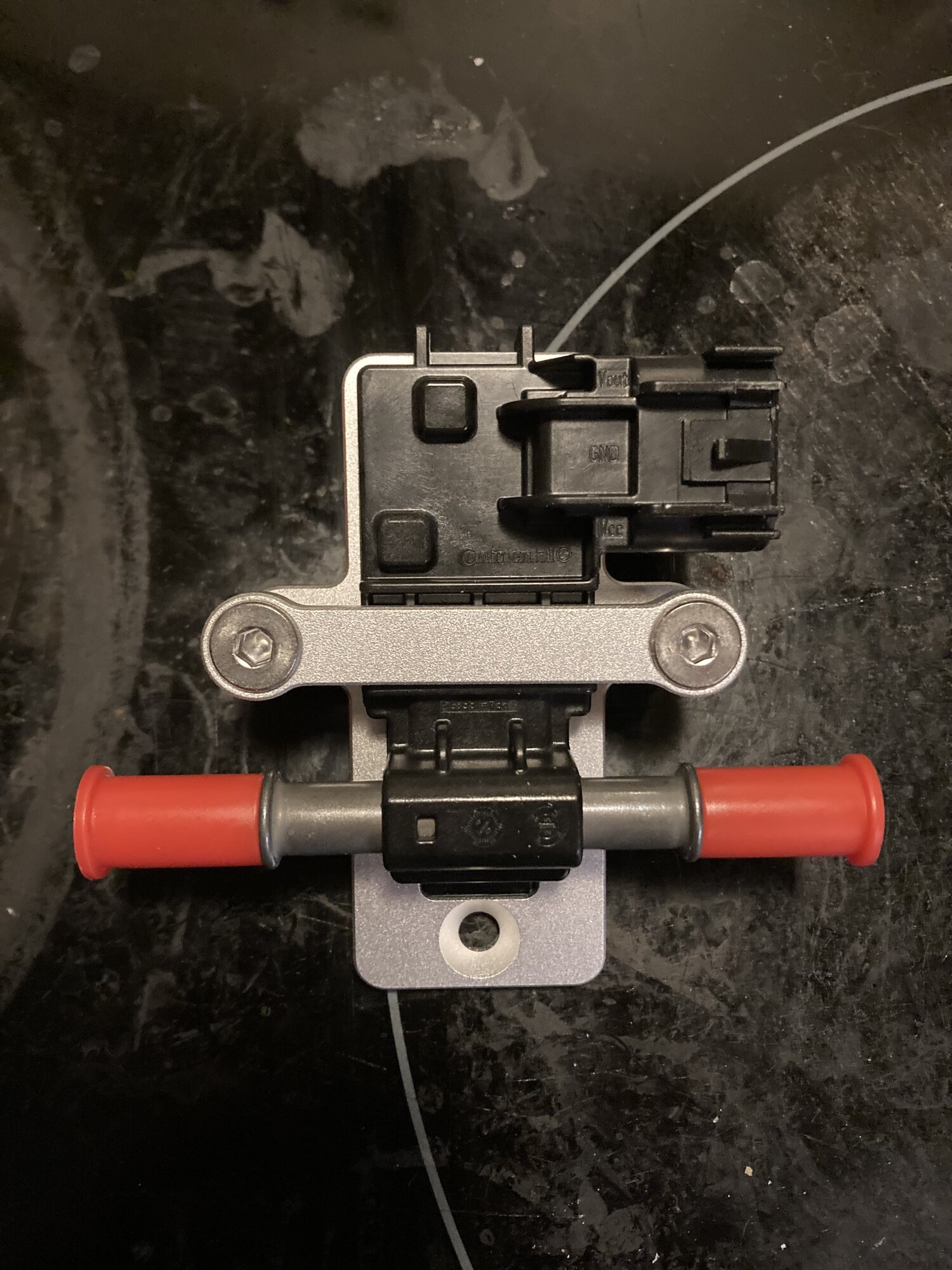

Lastly is this.

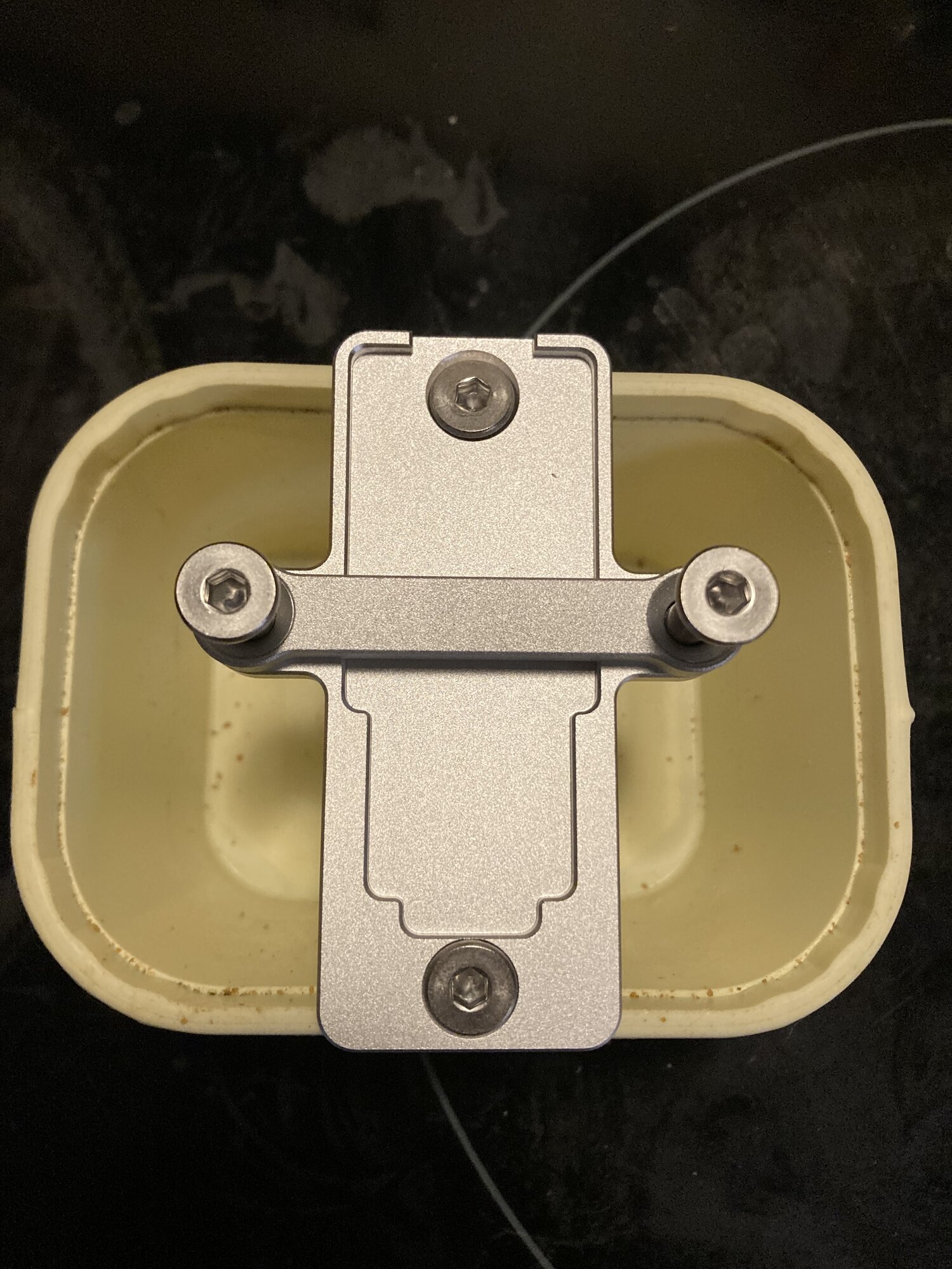

I bought a factory GM Flex Fuel sensor, but I didn't want to pay double price for the sensor that included the mounting holes vs the cheapest option. I found this bad boy on Amazon for like $14 and pulled the trigger.
It's got counter-sunk bolts that are included with it, so I'm gonna be able to mount it to look nice and clean instead of letting it dangle.
Still waiting on the ECMTuning adapter harness for the flex fuel sensor, but once that comes in I'm gonna install it and get this baby converted to true flexfuel. Excited for sure.

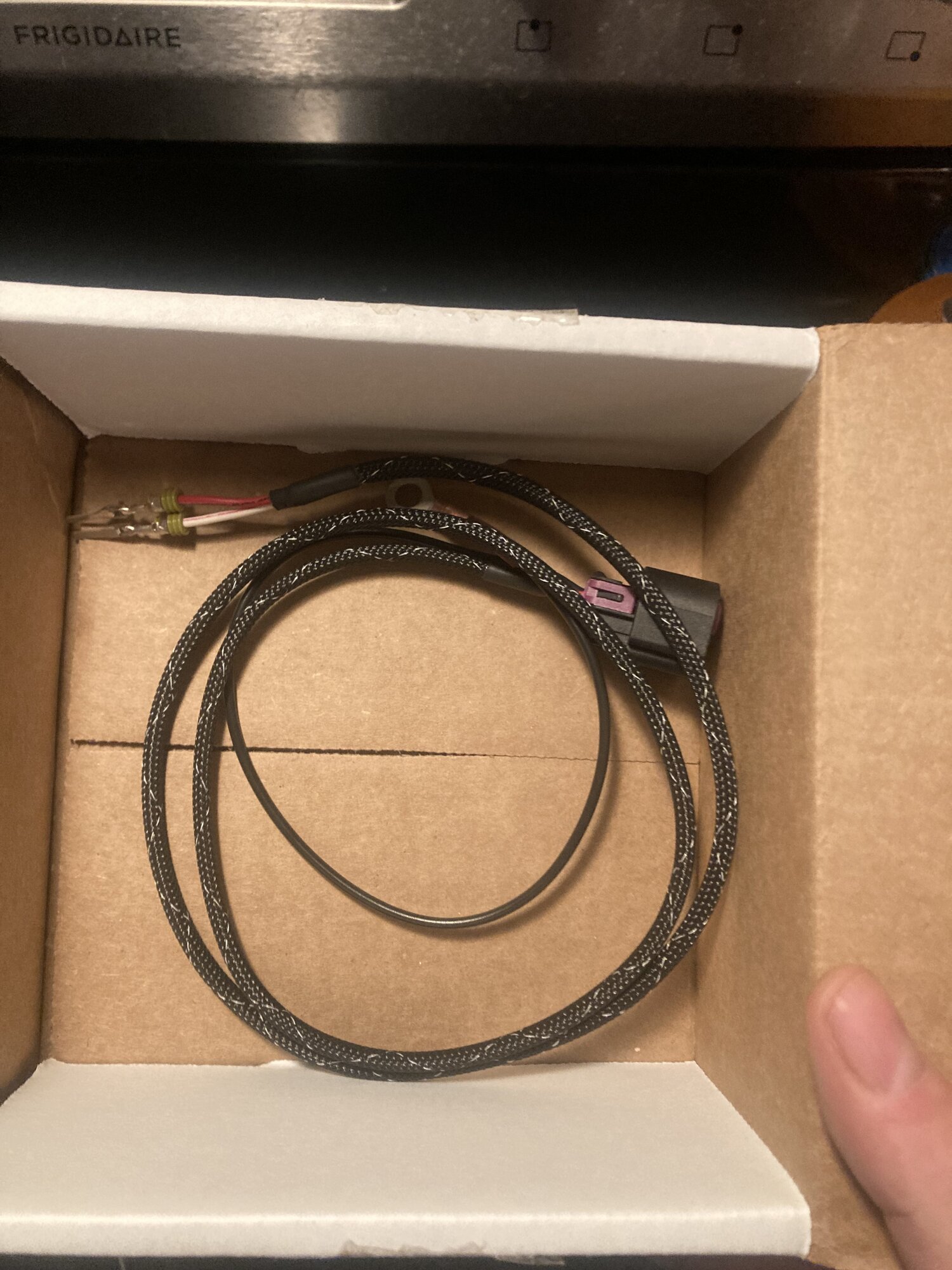

Last little part came in today from ECMTuning.
Plug and play harness for the Ethanol Content Sensor. Super good quality as it always is from ECMTuning.

Car is officially on FlexFuel. Never thought this would happen, man. Install was a breeze, especially with the ECMTuning adapter cable that plugs right into the MAF sensor's pigtail.

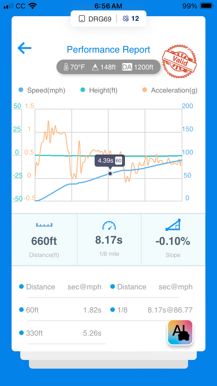

I can't (couldn't, trans is broke now) get out of the hole without NOS on my automatic DSM, but she clicked off the beams at 128mph out the back door.
And a short clip of a test hit.
I would think your MPH should be more and you have a real good 60'. Mine was 3.1 :ohdamn: and I still went out the back at 128.
