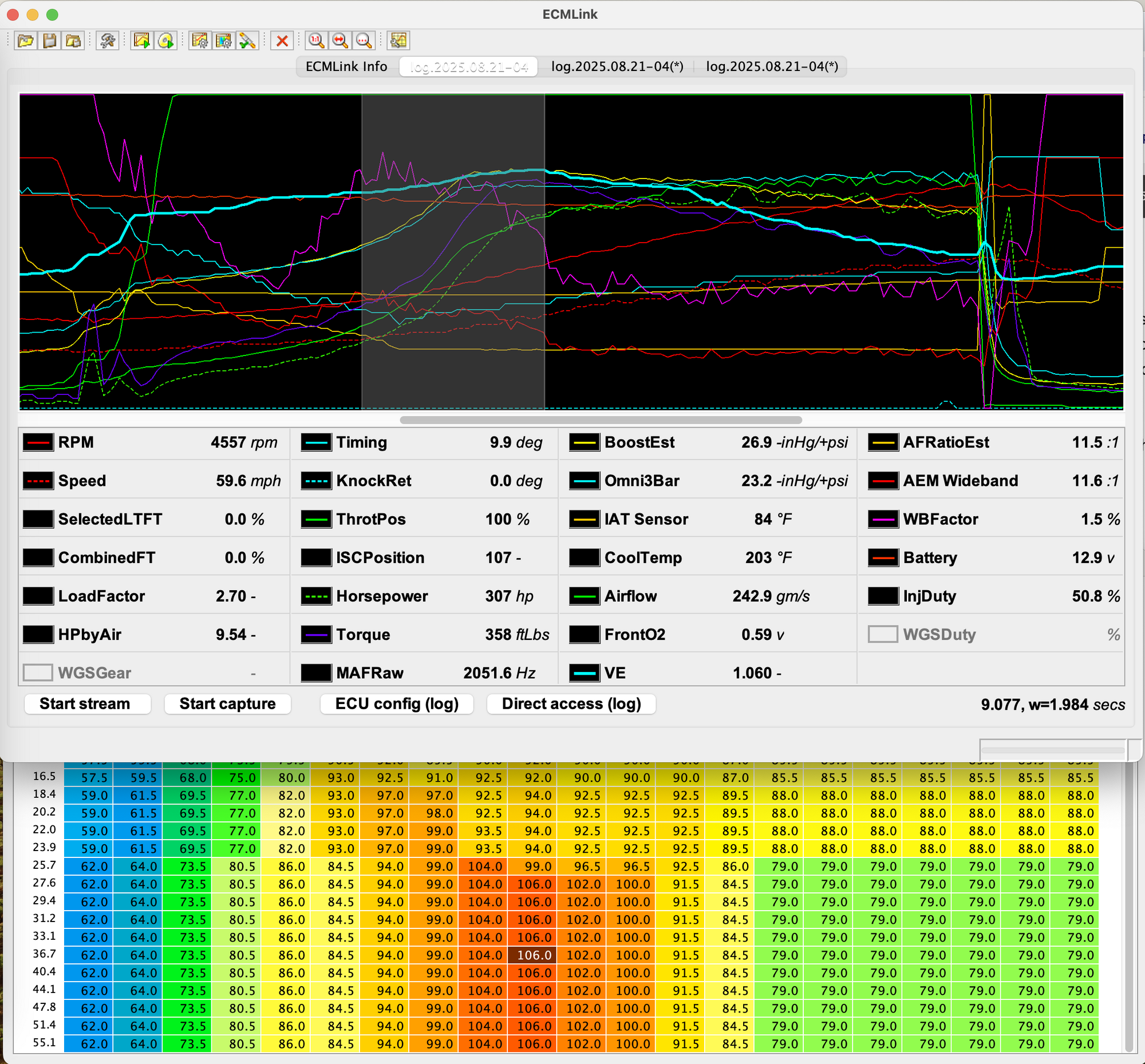

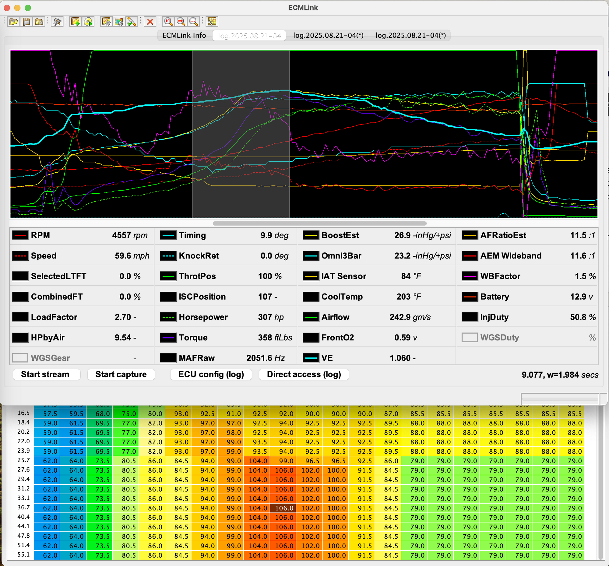

Adjusted the boost controller so 22-23lbs hits immediately instead of a slow ramp. I need to adjust the WGS a little so it doesn't go to 27 but how's this third gear pull look yall?
Attempts at a 1/8th mile pass or a 0-60 was a bust. Roads are somewhat dry but cold since it's been raining, and I missed second. 🙄 But, at least I got a third gear pull out of it. I'll adjust cam timing next I guess.
Kinda surprised I had no knock on that pull. Should I increase my timing up top or what? Advice desperately needed.
Been doing more digging. Old school guys on the OG FP Green were claiming 400hp on like mid 20 lbs of boost. One guy was using stock ECU and an SAFC. Which makes me think, maybe my timing map is really soft. I am heavily debating swapping to a stock 1G timing map and tuning out the knock where/if it appears and seeing how she runs. With such low compression, I do wonder if I can get away with more timing up top than most others.
On E85 I have zero doubt it'll hold whatever timing I give it. I also may lean it out up top fairly significantly on E85. Not sure why it's rich from 5500+ in the log in my previous post. I haven't changed fueling there at all.

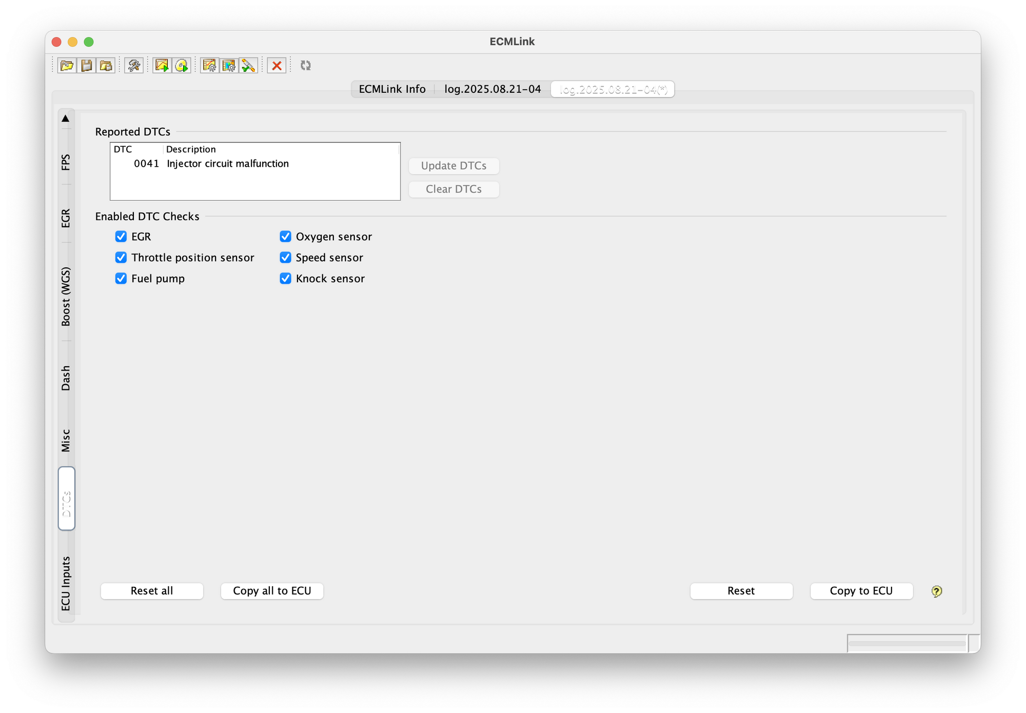

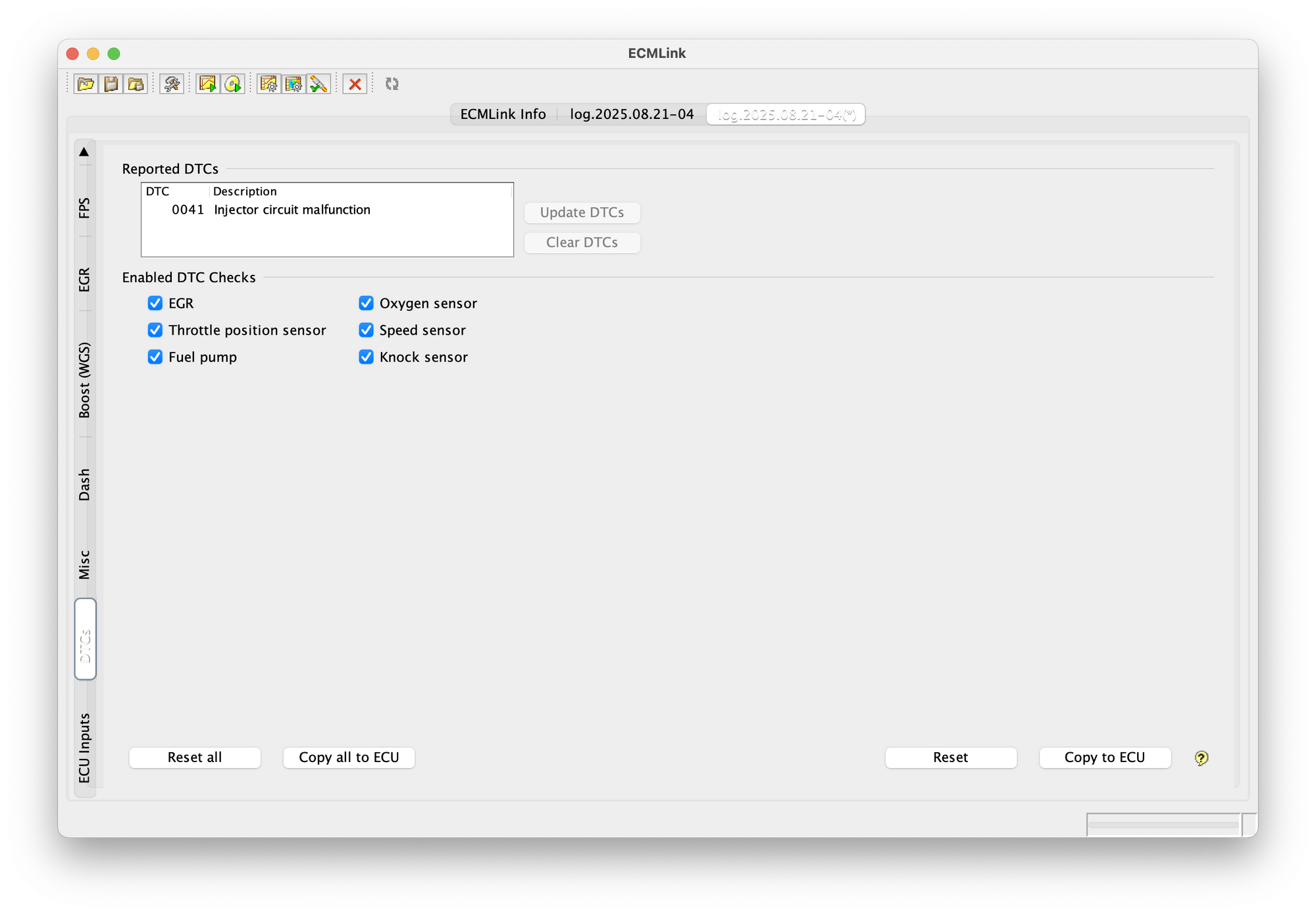

Your ECU recorded an injector circuit malfunction - if you clear the DTC, does it return?

You have too little fuel in the 3500-4500 rpm range being added in VE - Your Speed Density table is artificially high in those columns. You can be adjust those down to reduce the 99,104, and 106 columns. You should have values below 100 in there. If you can't hit the AFR target with SD below 100, then you should revisit your global fuel, but it looks like you have a lean condition to address.

Regards more timing - Yes - you can have more timing. If you are running E85, the knock sensor won't help you. The whole advantage of E85 is that it does not knock and detonate like gasoline - so you can run a lot more timing, and that should boost your HP numbers.
That’s because of my compression test. I unplugged the injectors and forgot to clear it. LOL
You have too much fuel in the 3500-4500 rpm range, and I can see why - Your Speed Density table is artifically high in those collums. You can be adjust those down to reduce the 99,104, and 106 collumns. You should have values below 100 in there. If you can't hit the AFR target with SD below 100, then you should revisit your global fuel.
I gave some wrong advice - lowering the ve in the 99,104 ,and 106 will go lean, which is the opposite you need, there is something else at work here causing a lean condition.
It’s probably something weird due to the flexfuel settings. I’ll tweak it a bit more/put it back to ECMLinks original settings and see if that helps. Because I’m randomly running rich from 5000-6000 as well which doesn’t make sense. At 5500 I’ve always been dead nuts on matching AFRest to actual AFR.
