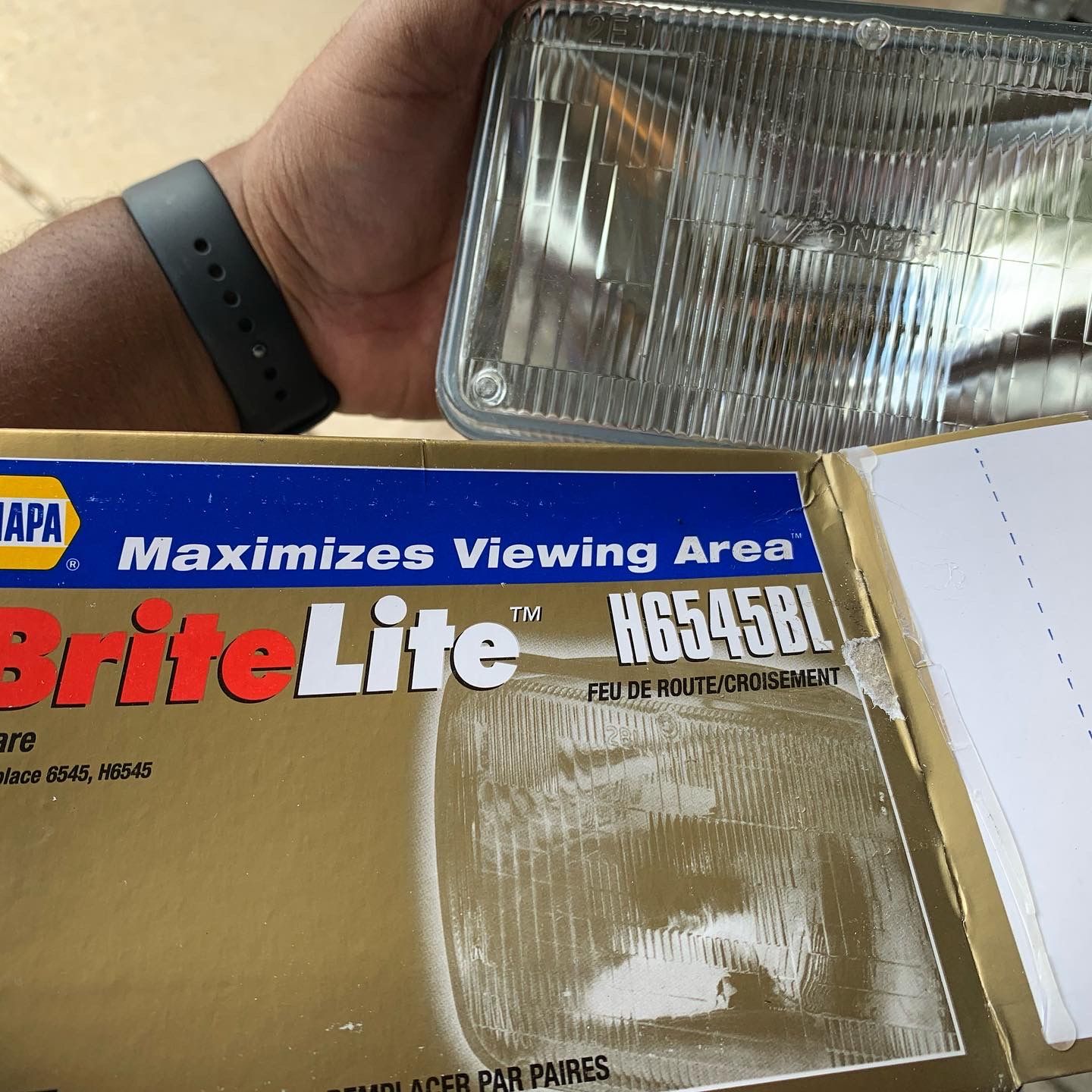

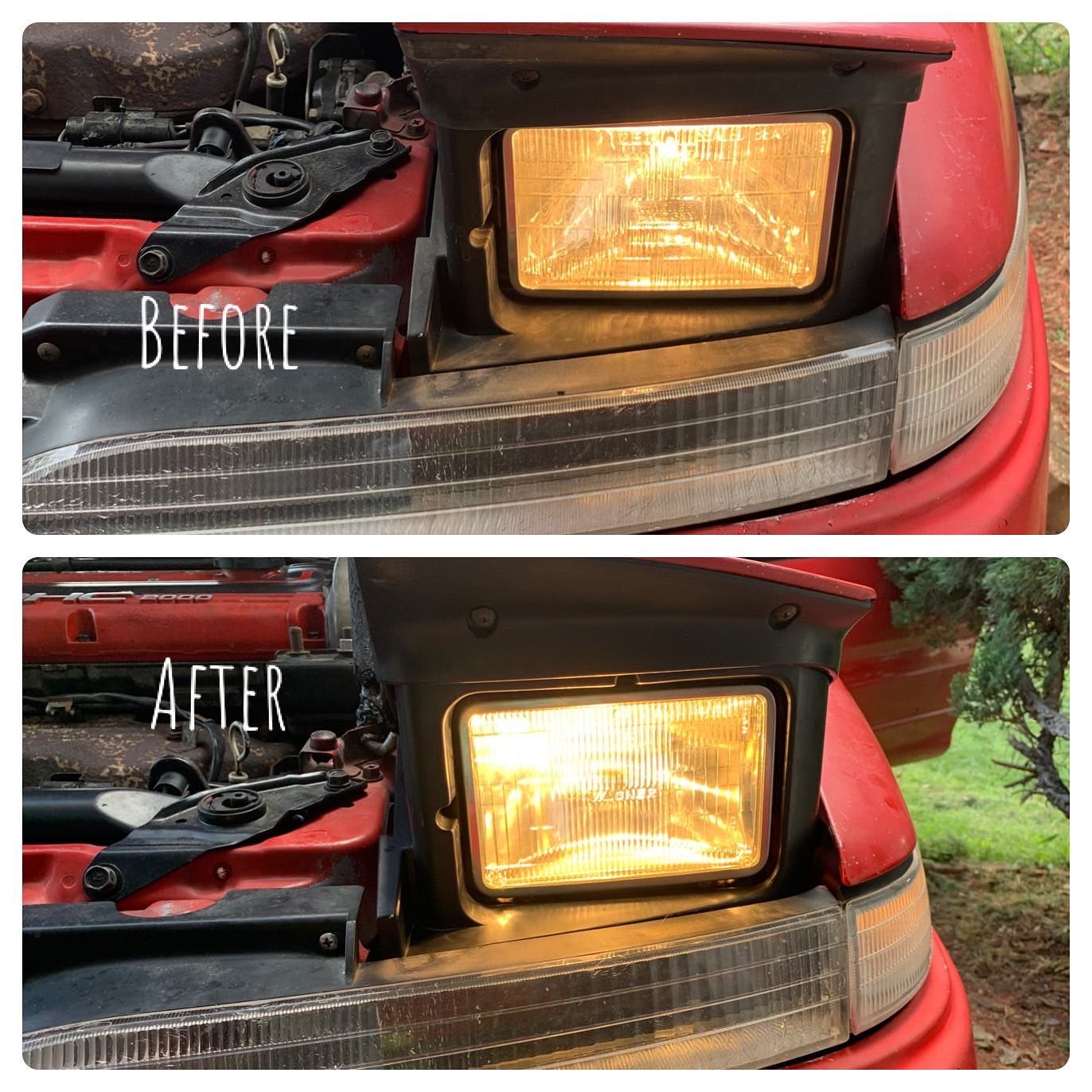

I was eventually planning to do some fancy led 4x6 bulbs but Rock Auto has these private label Napa headlights on close out for $5:each. So they will do for now. Supposedly 20% brighter. Even though I don’t usually drive at night since tow trucks are easier to call during the day. Haha.

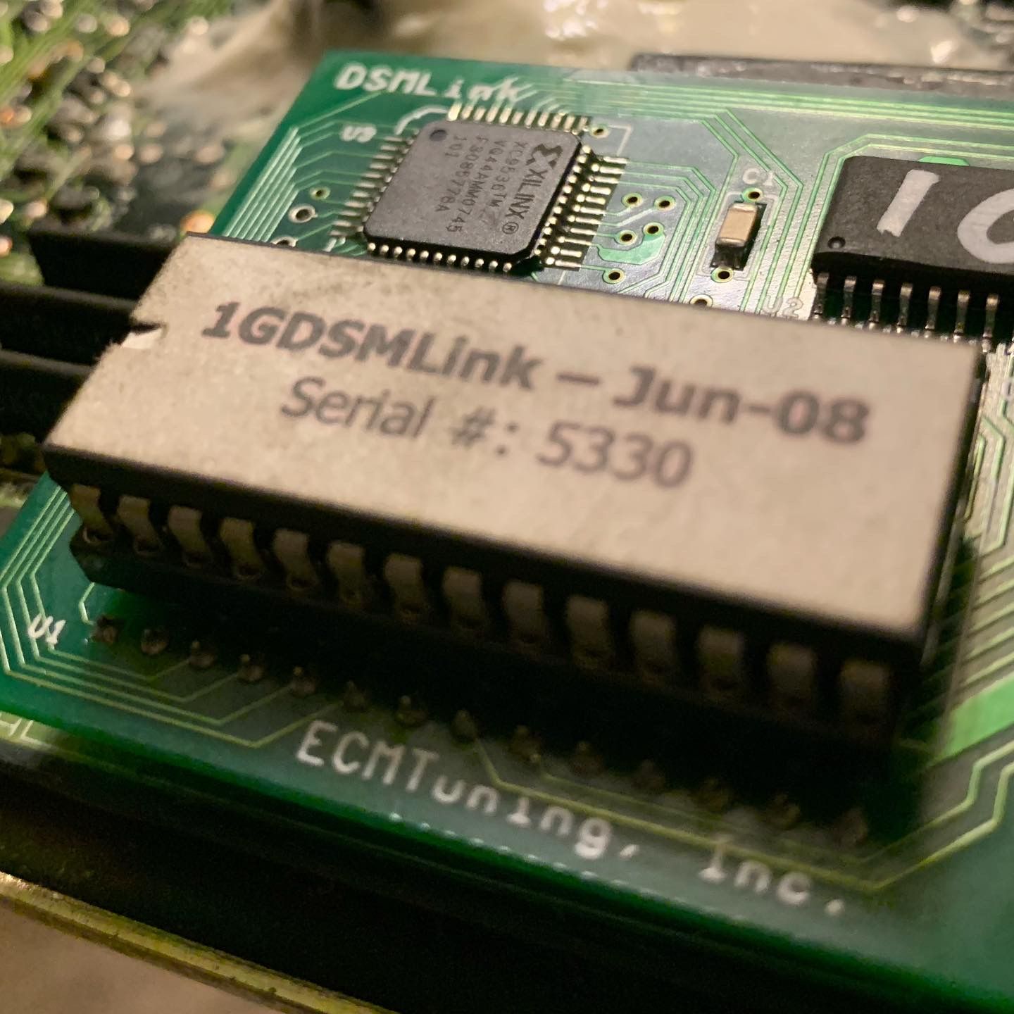

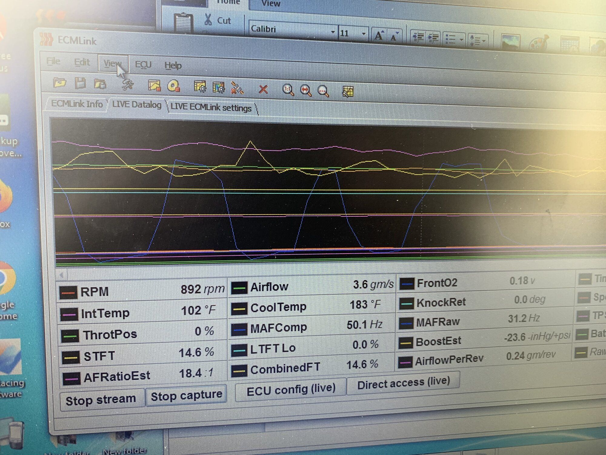

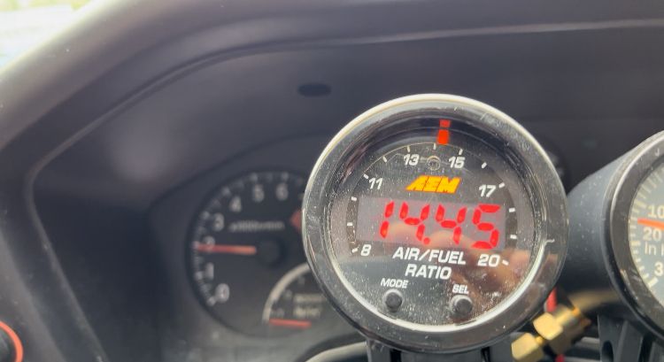

As much I loved having back a HKS VPC/AFC combo like I had with my last DSM I wanted to be able to control my timing which tends to go crazy high when you run piggy back fuel computers with large injectors. So I sold my previous setup and purchased a 90 ecu with DSMlink V2. It didn’t come with a cable so I purchased a V3 cable and I can confirm it does work with the V2. Now I just need to start the tuning process now that I have it setup with my Evo 8 MAF and 750cc injectors. I’m thankful we live in a time of YouTube and there are a lot of good resources out there so watching these videos over and over made it less overwhelming.
Scott Laird has a great video on V1/V2 and the MAF comp sliders:
I bought the same AEM wideband as Today’s Project Guide so I appreciated his input on setting up Linear wideband:
Jafromobile’s help with wiring for the wideband was also helpful. I wired into the EGR Temp since I wanted to keep the narrow band.
And since I have a 1990 Boosted Beaver’s guide on the clutch cut wire was useful as well.

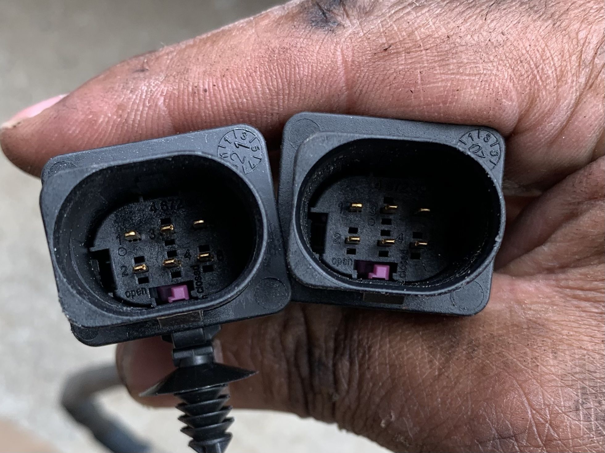

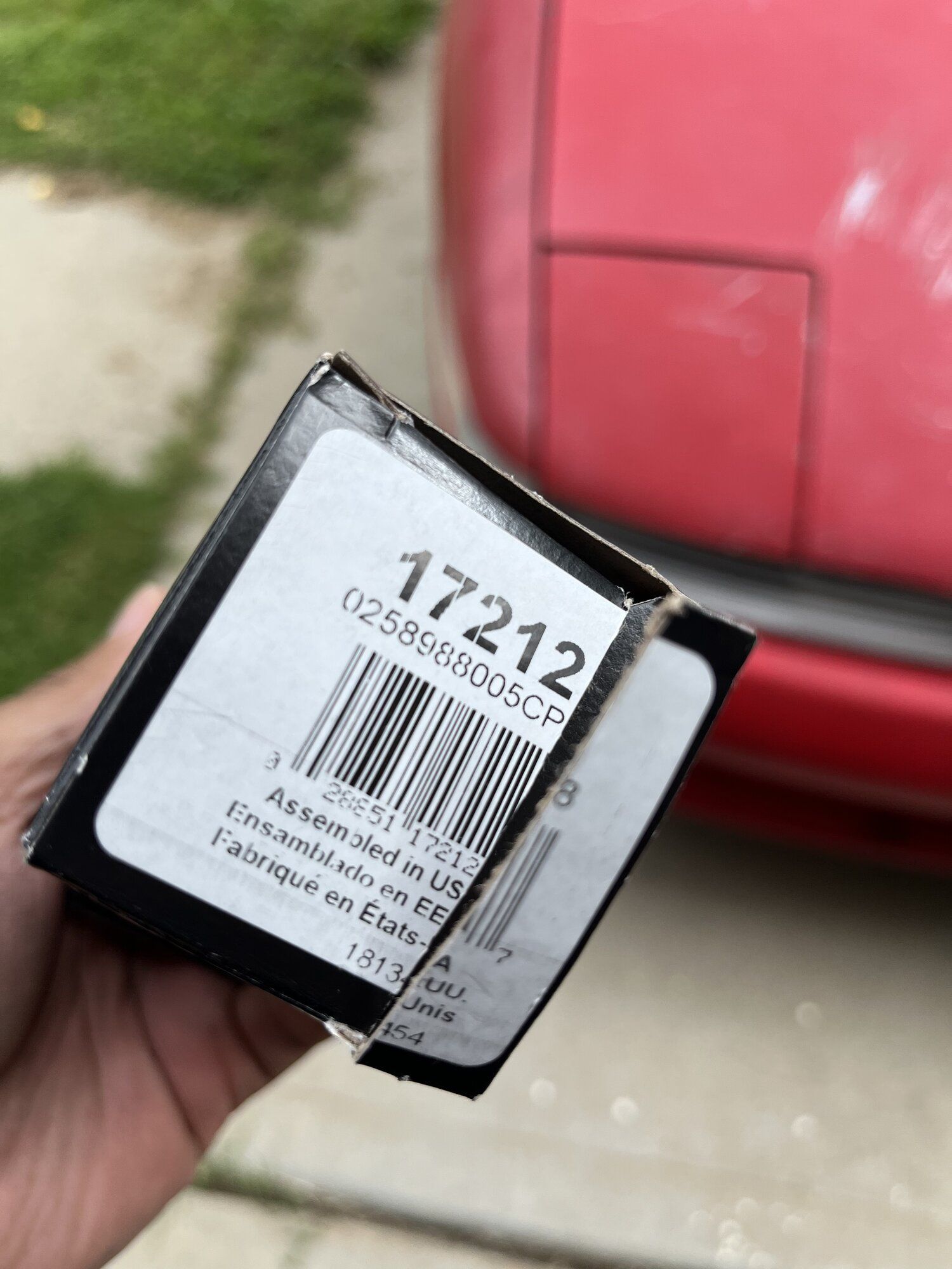

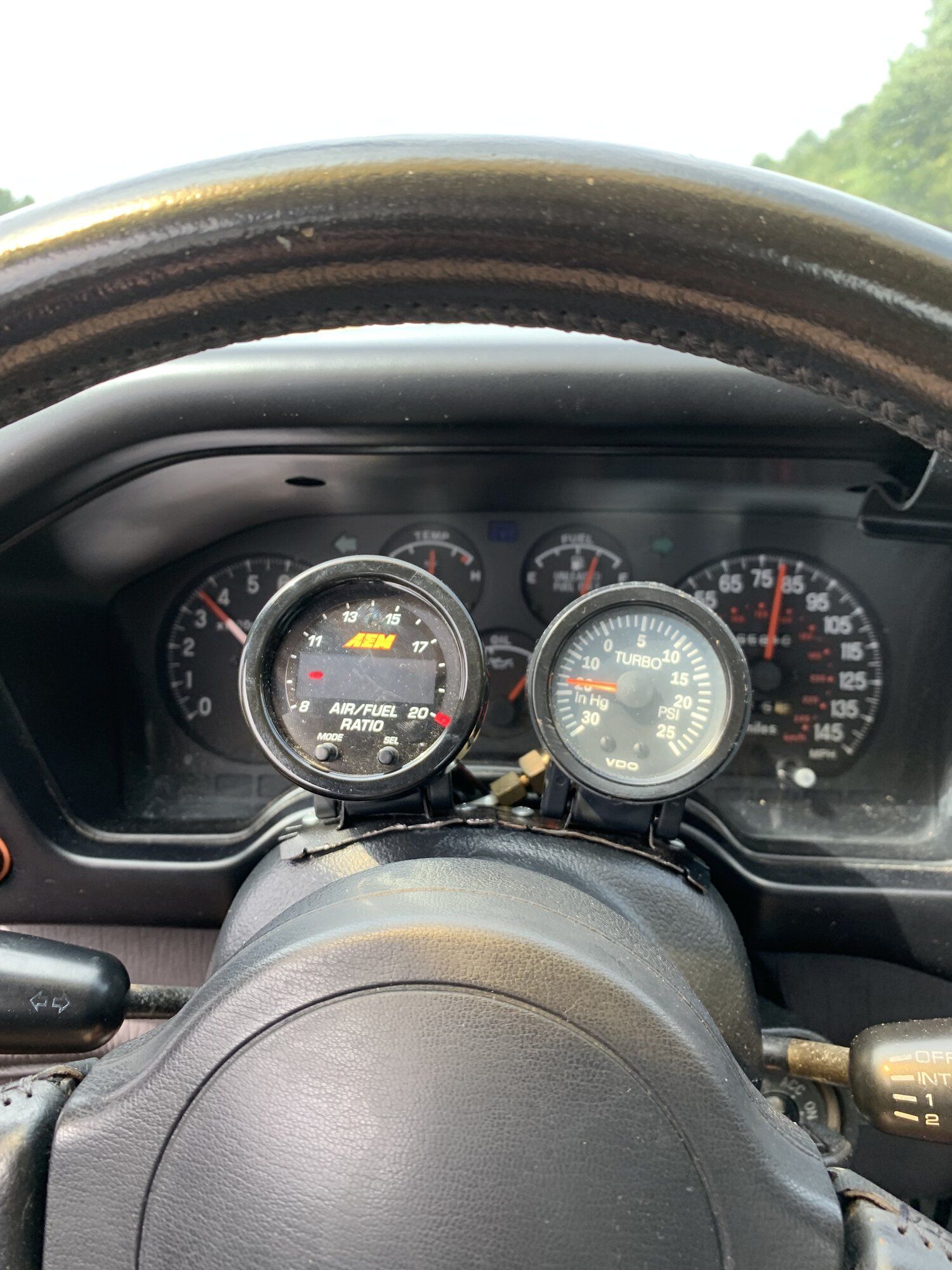

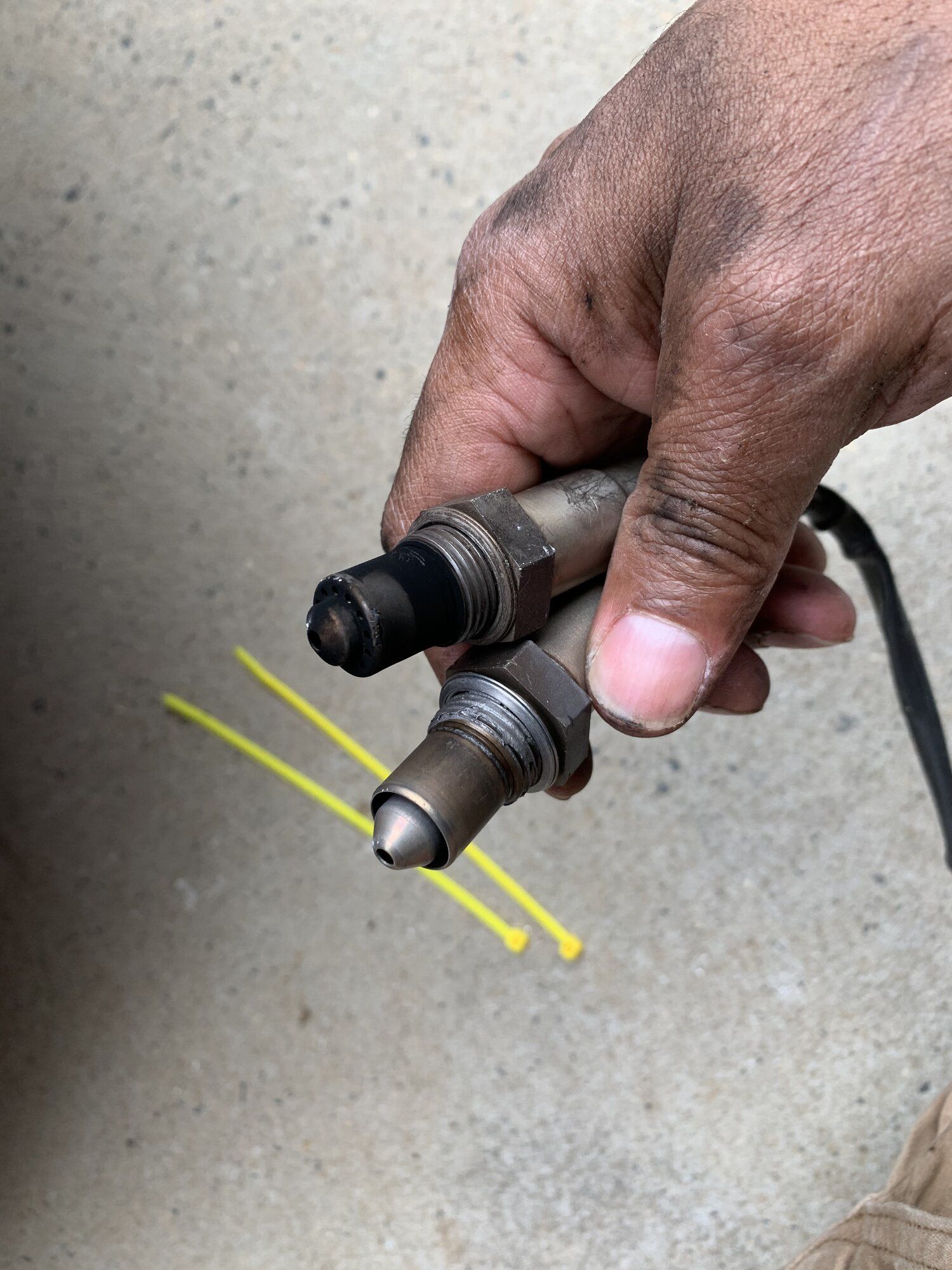

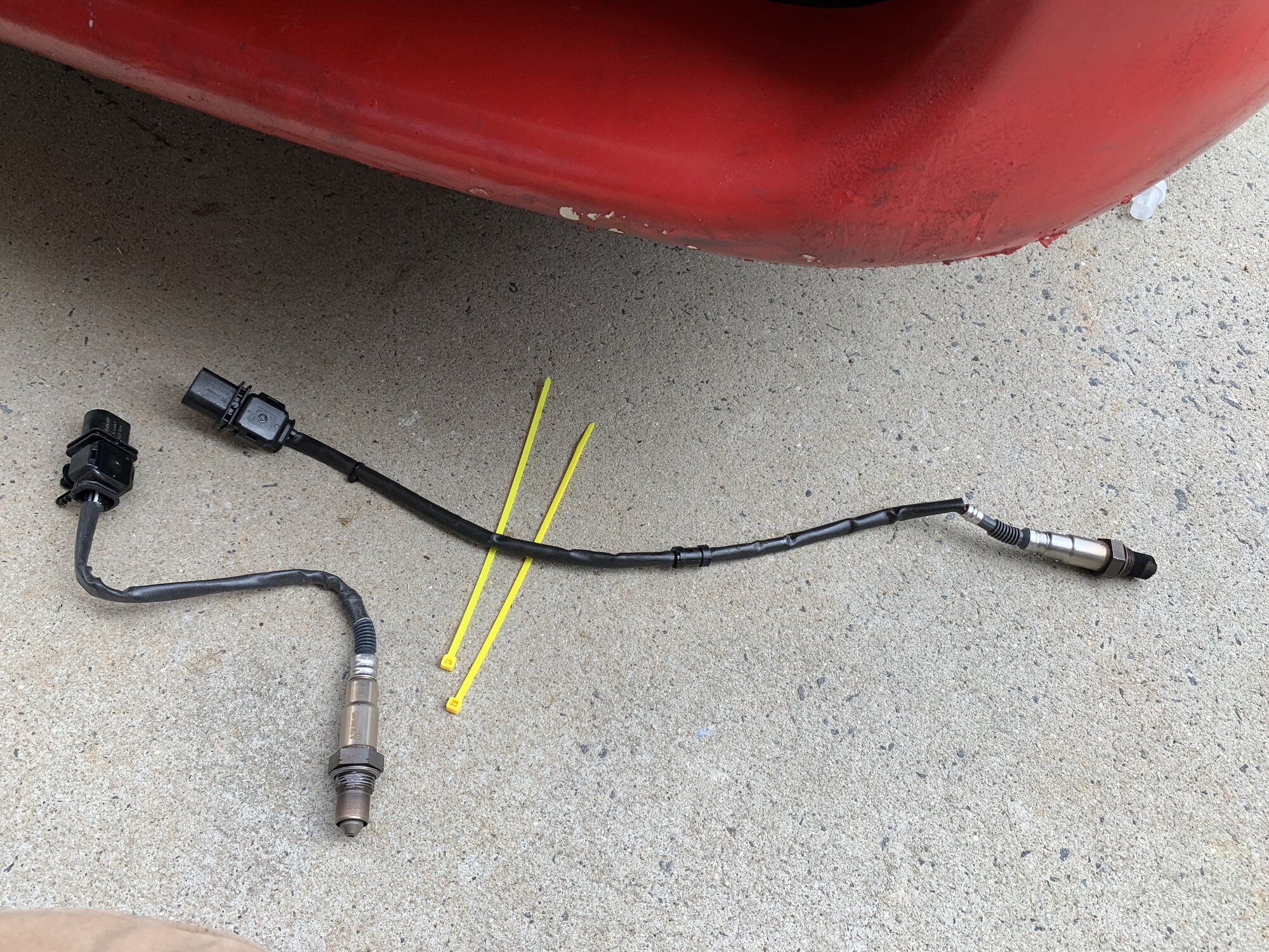

I bought an X-series AEM wideband second hand that the seller said the gauge hadn’t been installed. The gauge wasn’t installed but the sensor was used. And dead. So I bought a LSU 4.9 sensor from Autozone (Bosch Exact Fit Oxygen Sensor 17212) and I able to get plausible numbers. The lead on the Autozone sensor was much shorter but i had some extra cable length to spare. So much for saving a buck. But at least I can start tuning my Link now.

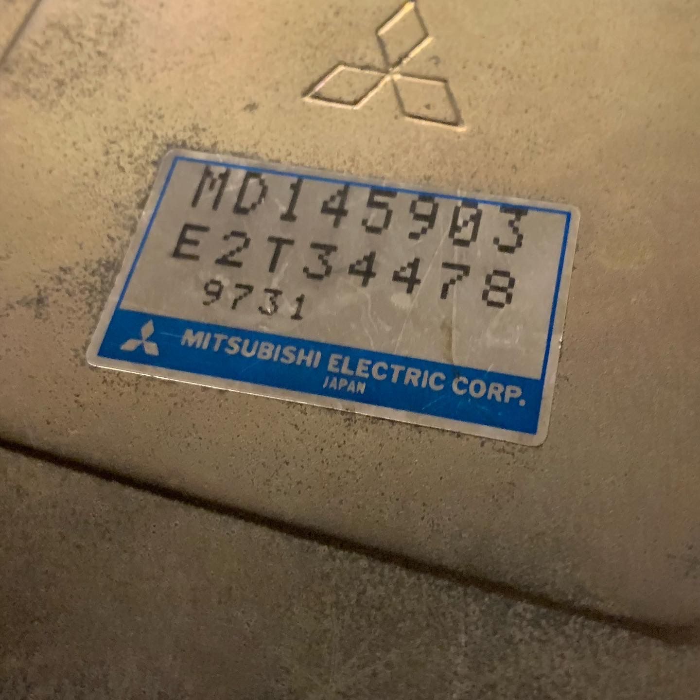

I bought an ecu with DSMlink V2 marketplace that said it was a 90 on the case. But when I tried to run it I noticed I had no idle switch response on DSMLink. But after swapping pins 6 and 14 the idle parameter worked. Plus my NLTS didn’t work wired up the 90 way so apparently what I bought was a 91+ ecu in a 90 case. It wouldn’t be a big except the tach doesn’t work under boost. The joys of being a 1990 model.

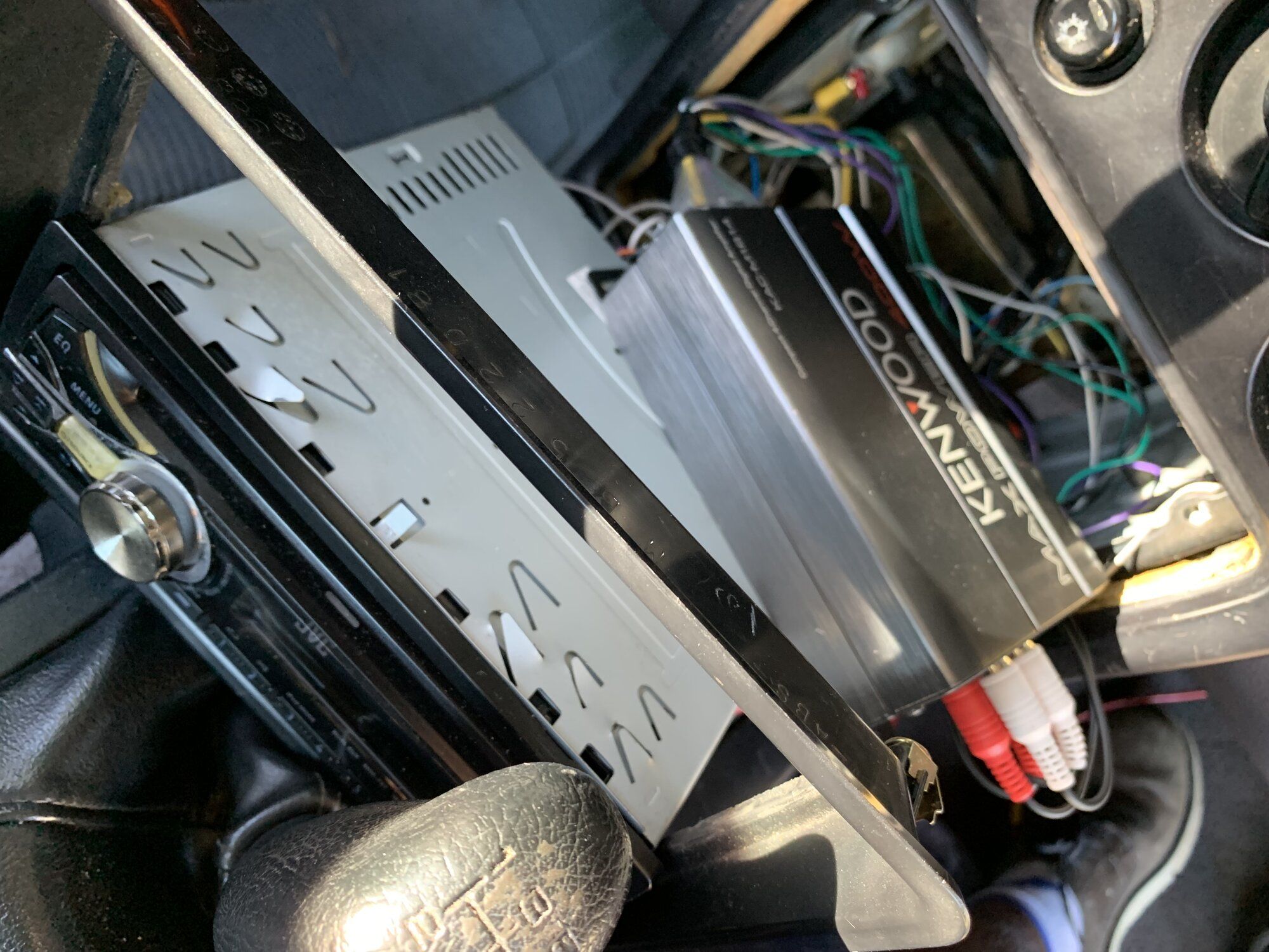

Im not a big audiophile but after Jafro’s recent video about upgrading his subs and simplifying his setup I thought about improving mine a little. The car came with some Pioneer separates in the door but I upgraded the front 4” from stock (on 600hz crossovers), and put some NOS 6x9 Sonys in the rear. They all were running off the Kenwood head unit the car came with. It’s rated at 20wx4 and struggled to replicate any deep bass notes. So I bought a Kenwood KAC m1814 4x100w amp. It’s been tested for around 50w rms. So I put the door speakers and the rears on the amp and left the dash speakers on the head unit. The amp fit nicely under the head unit so I didn’t have to figure out a place to mount it in the back. I may add a self-powered sub but for now the bass notes are a lot deeper and the mids and highs a lot clearer.
Nice, I like that little amp. Audio has changed a lot since back when I was in high school and into all that stuff.
I liked those under seat subs that Jafro did. That seemed like a nice compromise to not have to lose any trunk space to a big box and less obvious for thieves.
Of course with the 1g there is no room under the seats unlike Jafros Sonata. I was thinking of a powered 8” bass tube that would sit lay by the spare tire to further improve the bass. But it truly is amazing the power of small class D amps these these days for the size.

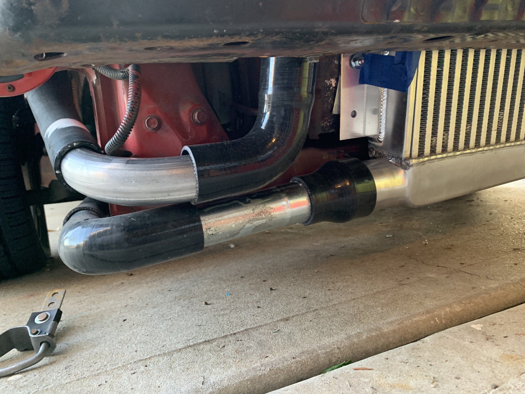

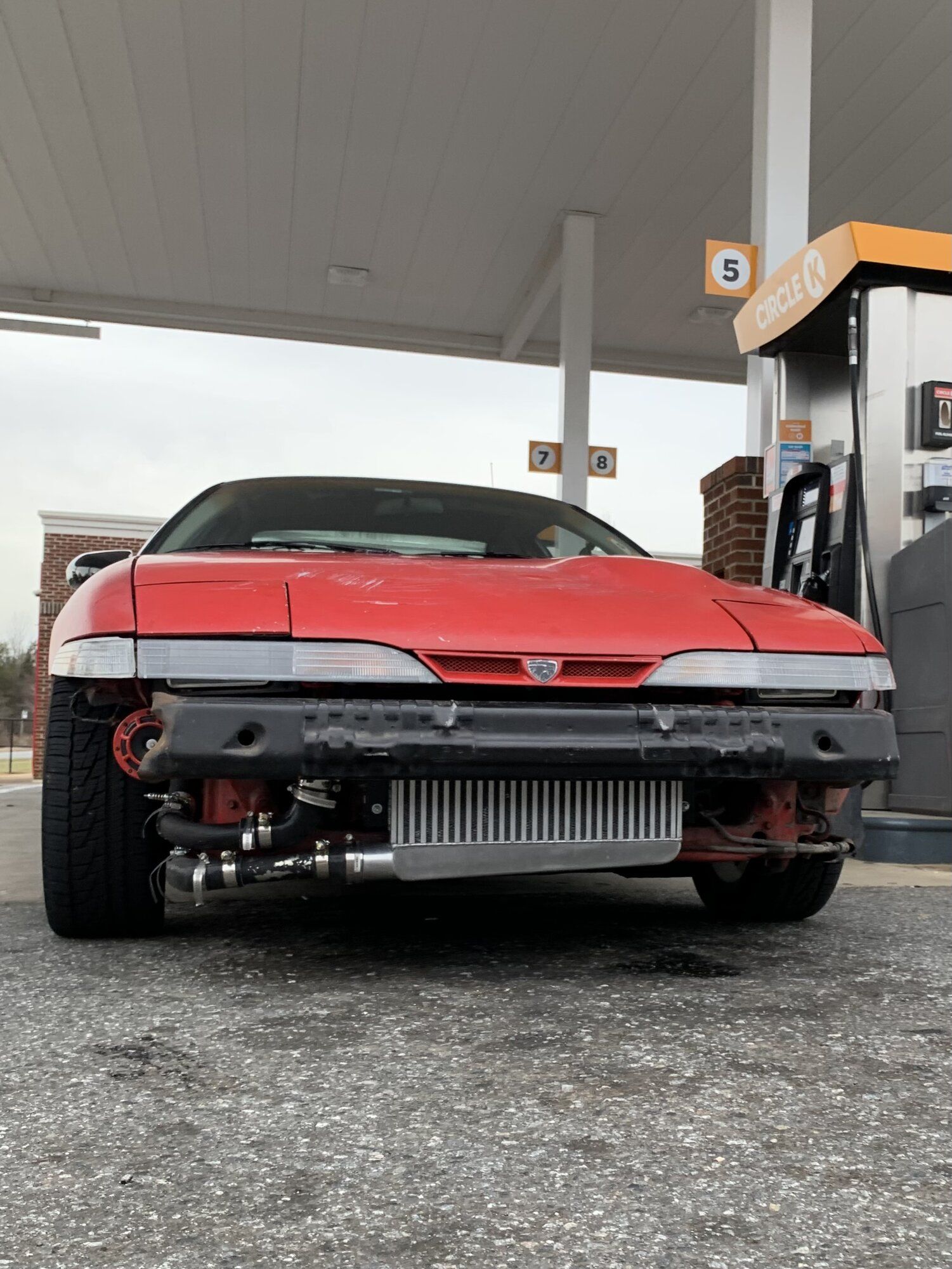

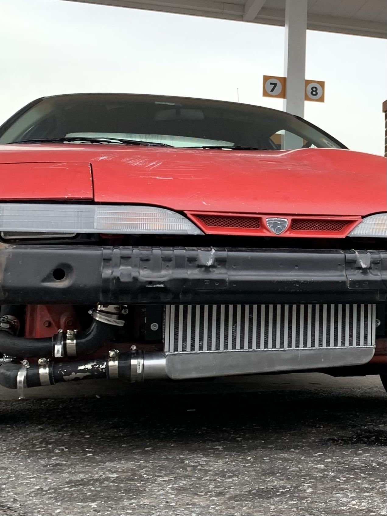

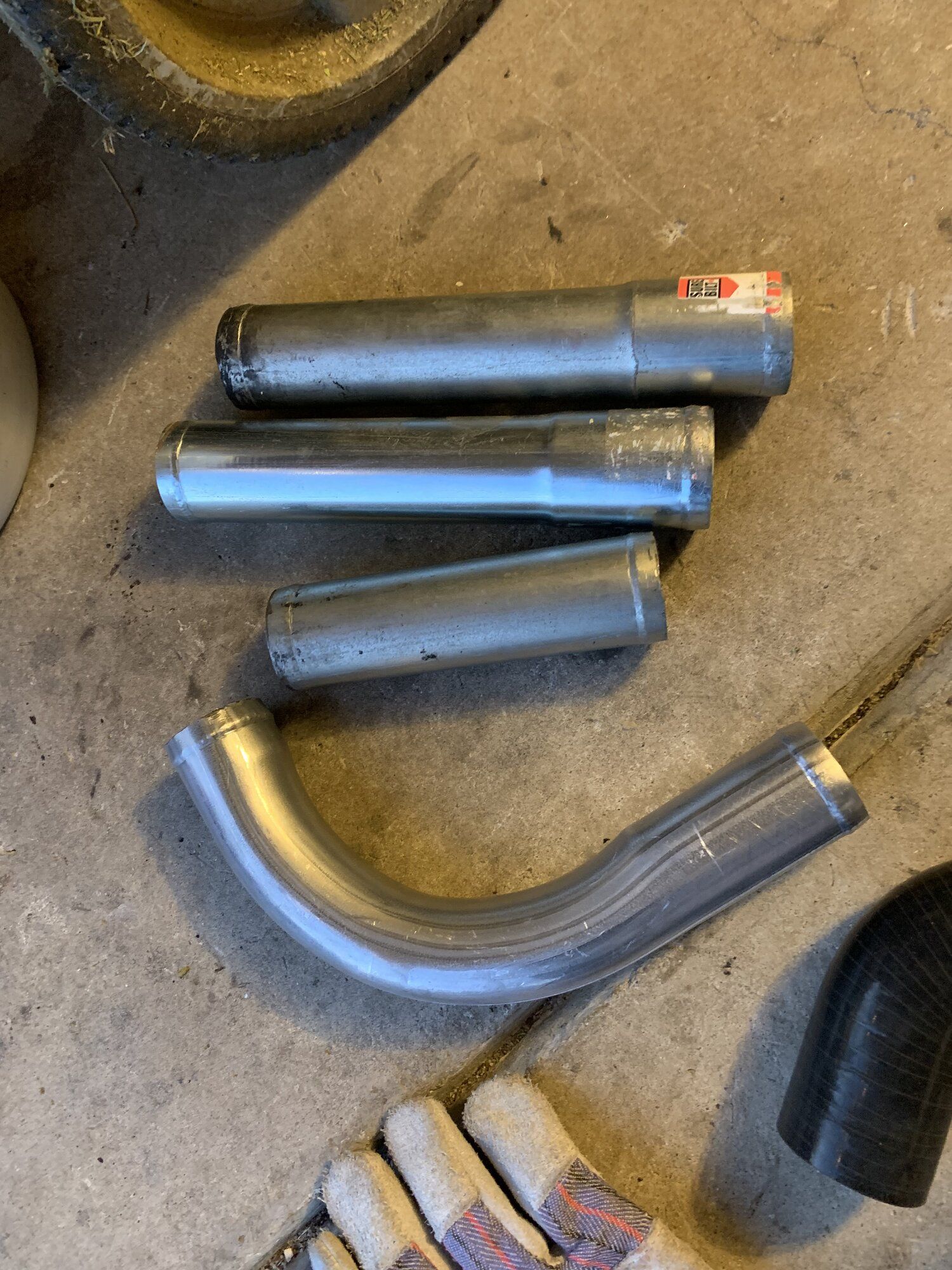

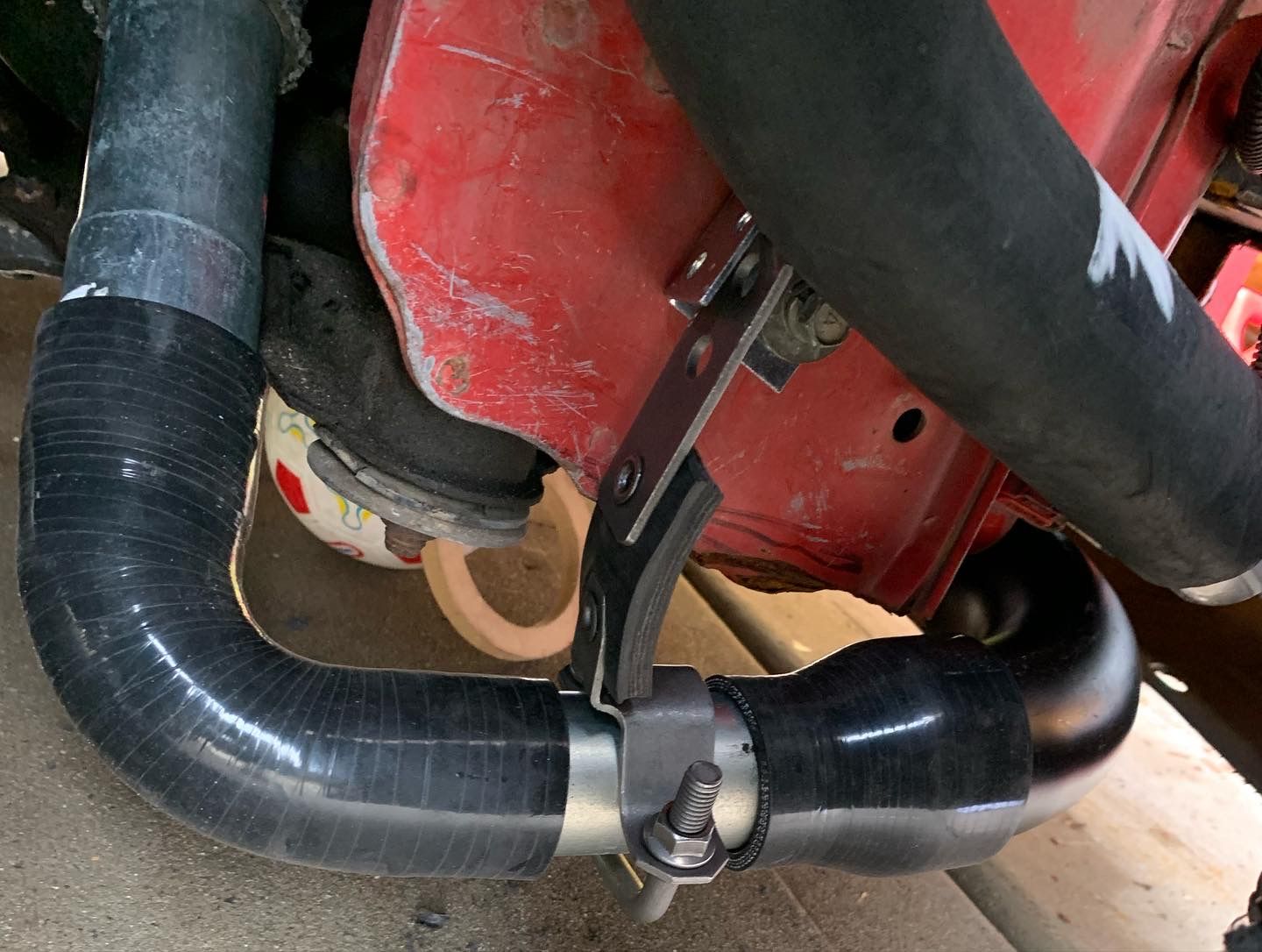

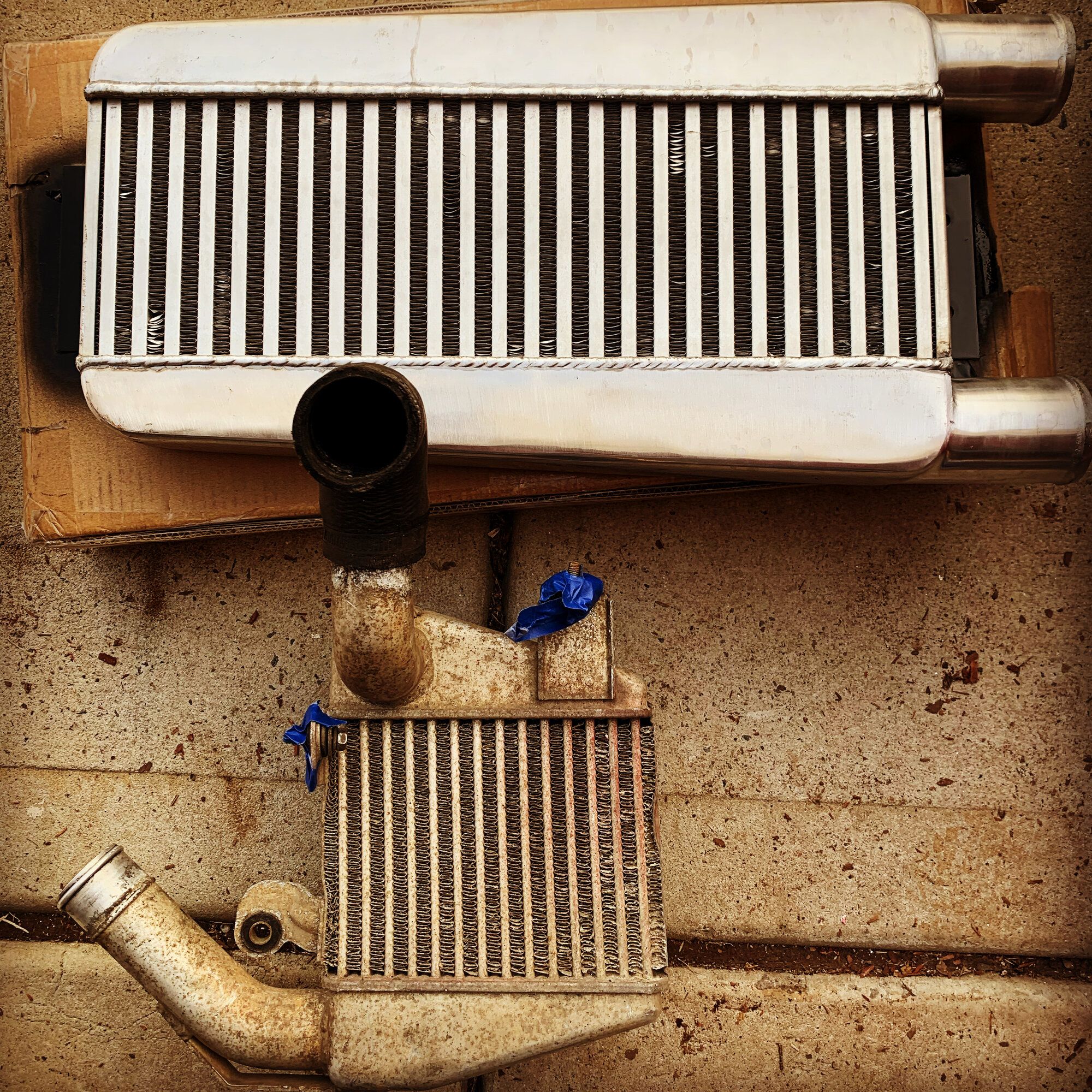

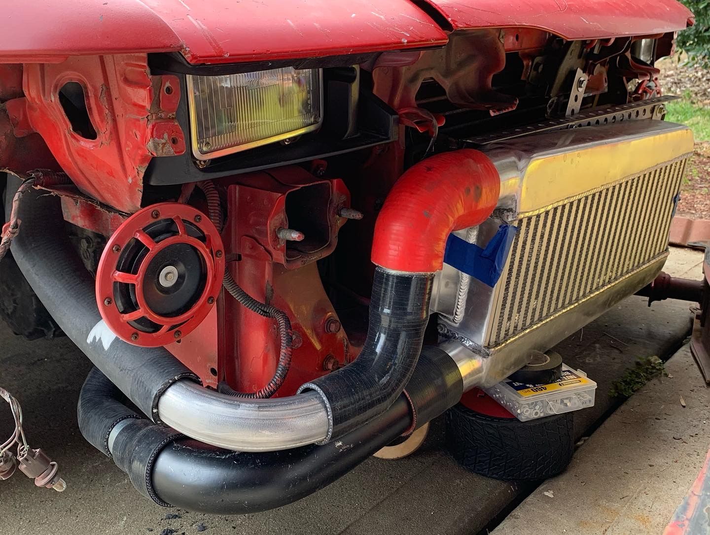

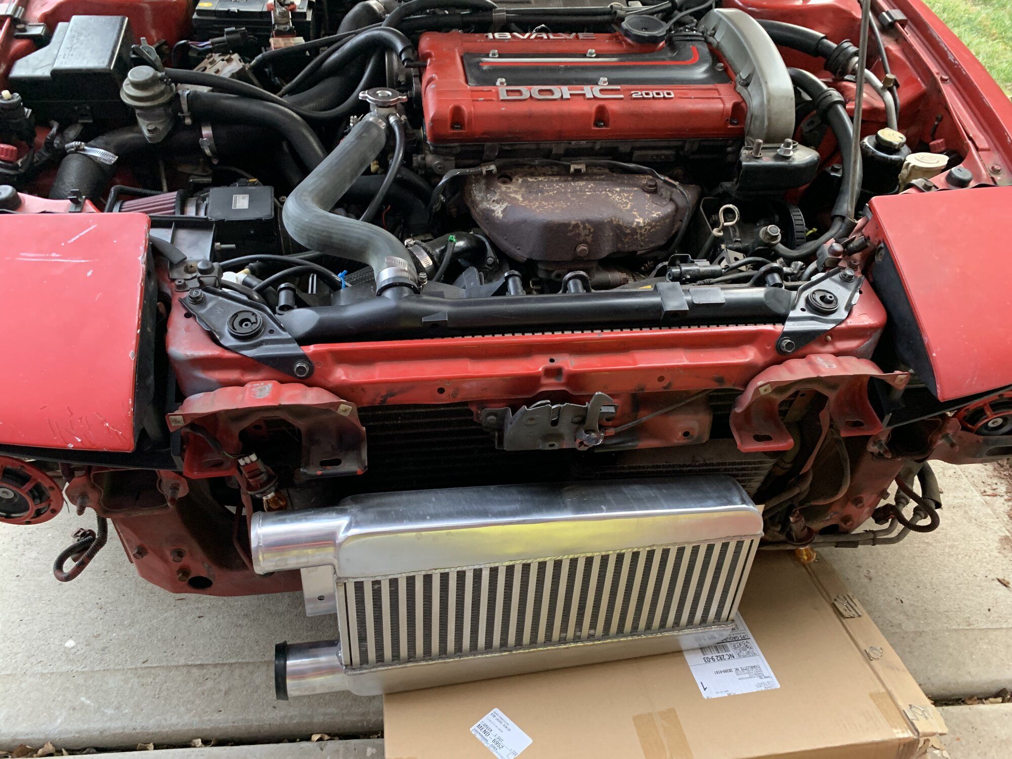

1G DSM kit options are fewer than back in the day. So I cobbled up this install to remind me of my last DSM where I used a Spearco 2-221. I’m using a Emcousa eBay core which is a little wider (24.25x11.5x3) than my old spearco but I still used the classic RRE installation instructions (http://www.roadraceengineering.com/instructions/1gfmic/1gfmic.htm). I even made a lower hose holder like their kit using an exhaust hanger. I fabbed up my own brackets with Lowes angle iron and straps and used a combination of piping I had, exhaust tubing, and eBay couplers. I still have the stock upper intercooler piping and turbo discharge from the 16g so I didn’t see the need to go 2.5” all the way at this point. The piping goes from 2.5 to the stock diameter 1.75. Going this longer route I didn’t have deal with slim-line fans, cutting the radiator support or moving the coolant over flow. I did cut the lip off the bumper to give the intercooler more room and clearanced it for the upper hose.
I still need to bead roll the pipes and perform final assembly before testing.

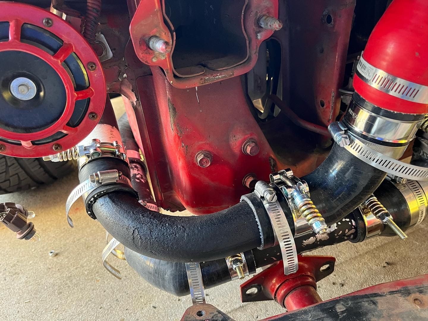

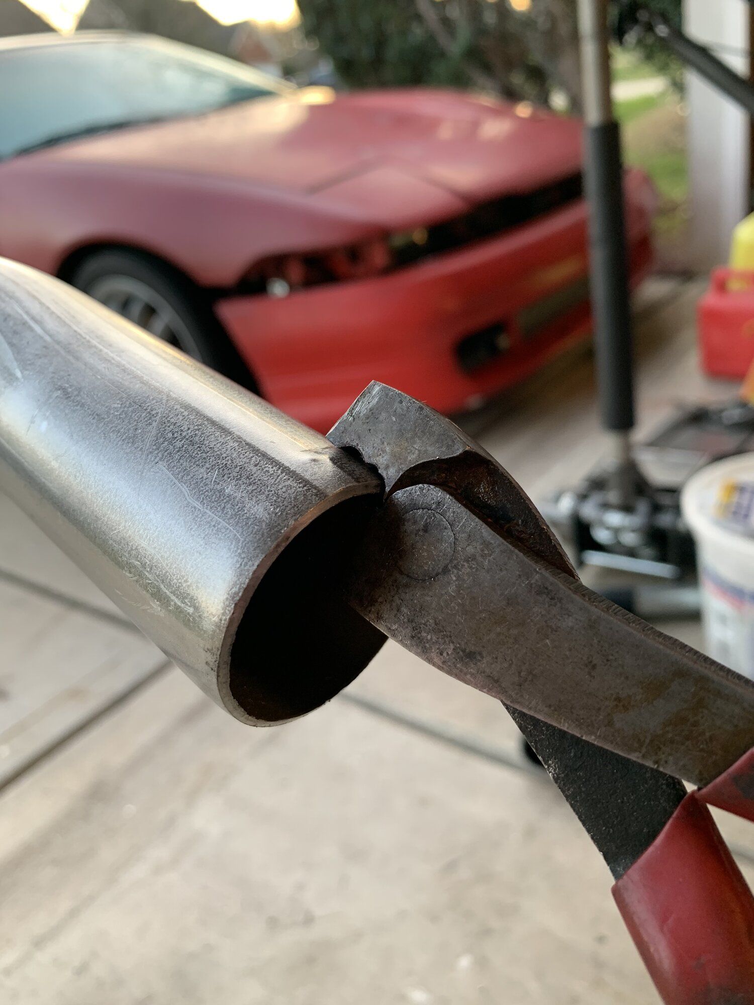

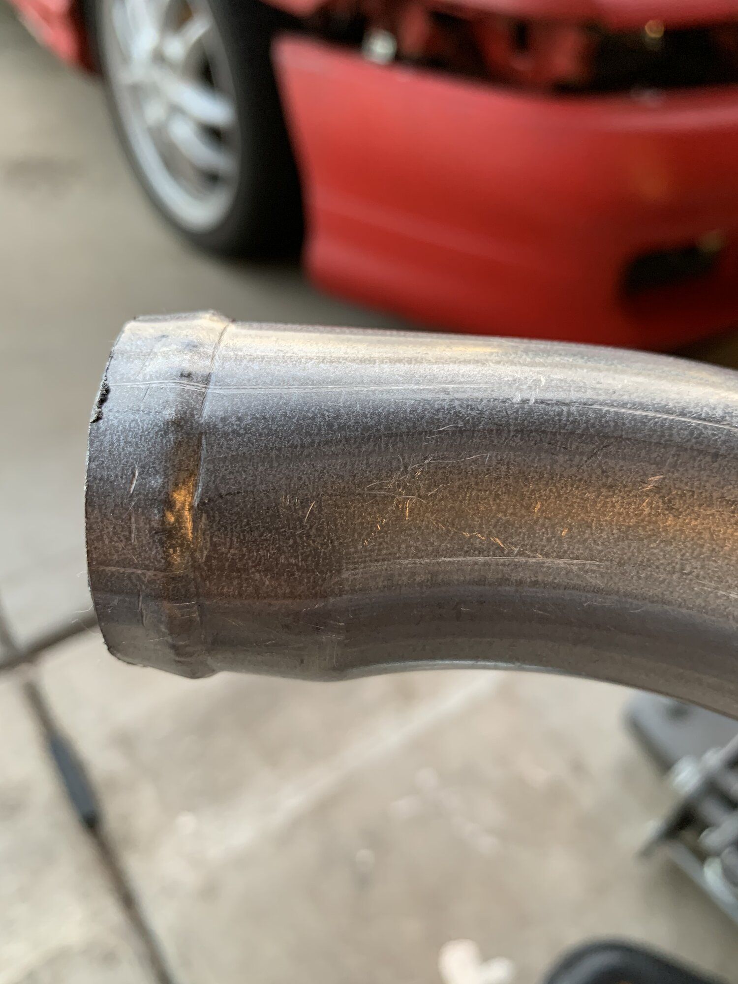

After a little more consideration I changed up my lower pipe for a little more clearance. I also did some budget bead rolling with a modified wire clippers to help keep the pipes from blowing off. I was also thinking about painting the pipes with rubberized undercoating spray I have so they don’t look so shiney plus maybe that will should give the couplers a little more grip.
Pulled everything apart while I’m painting the brackets and pipes so they aren’t so shiney. Ebay or not it should be better than the stock fmic. Hopefully since I’m still running the stock fans I won’t have any overheating issues.

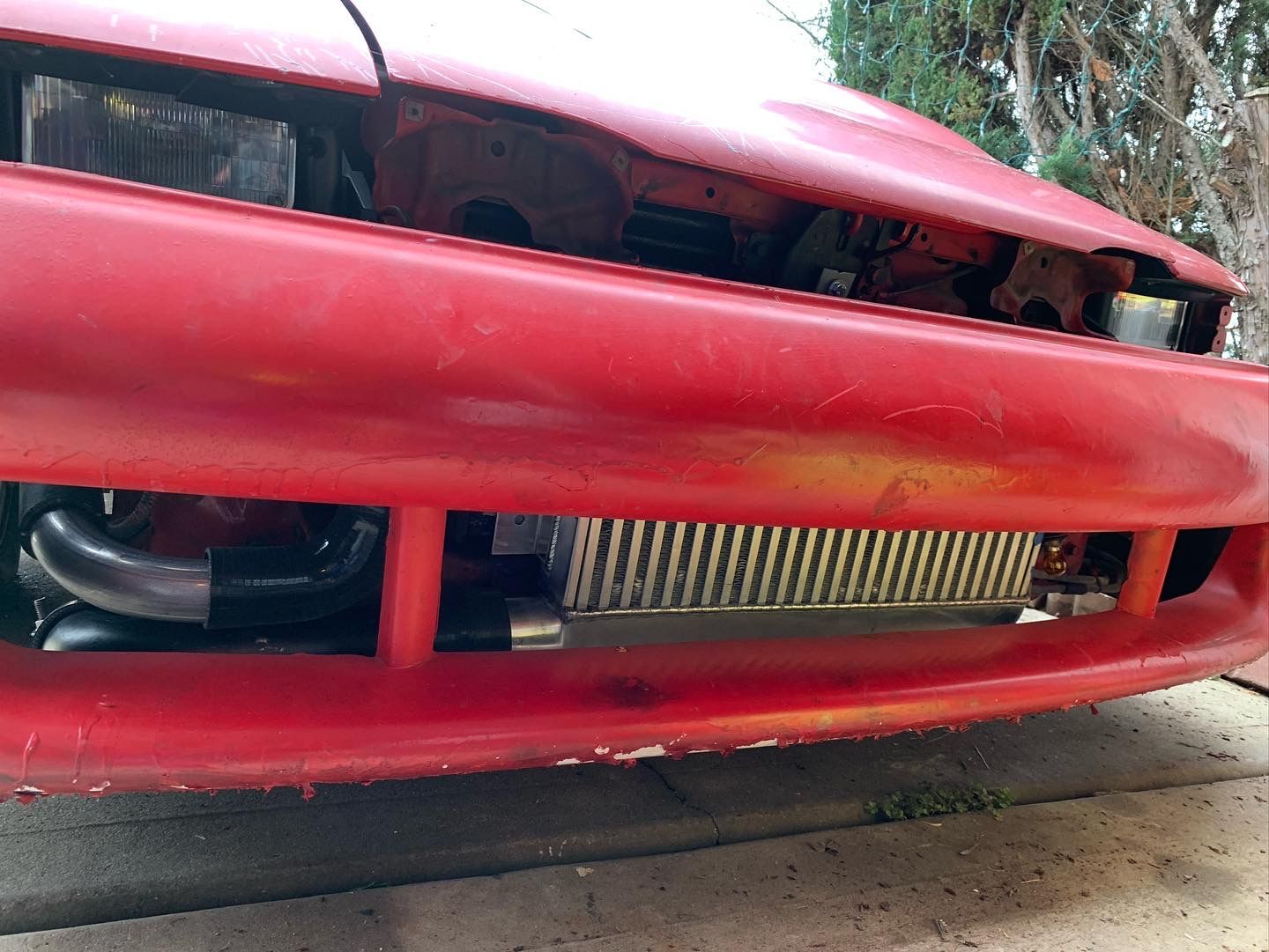

Wrapped up my fmic install. In double clamped the connections. I ran it for a little while without the bumper covers to see if I’d get any hose blowoffs but so far so good at 20psi.
