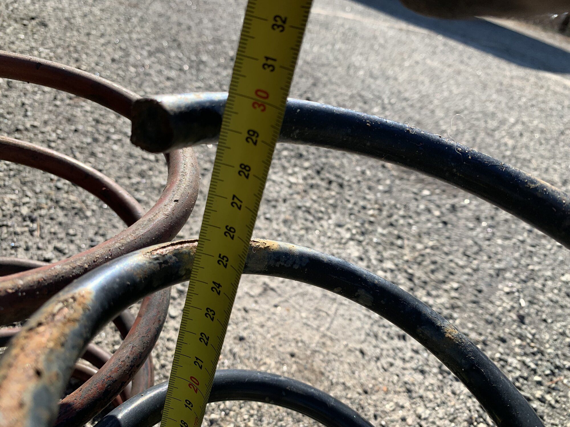

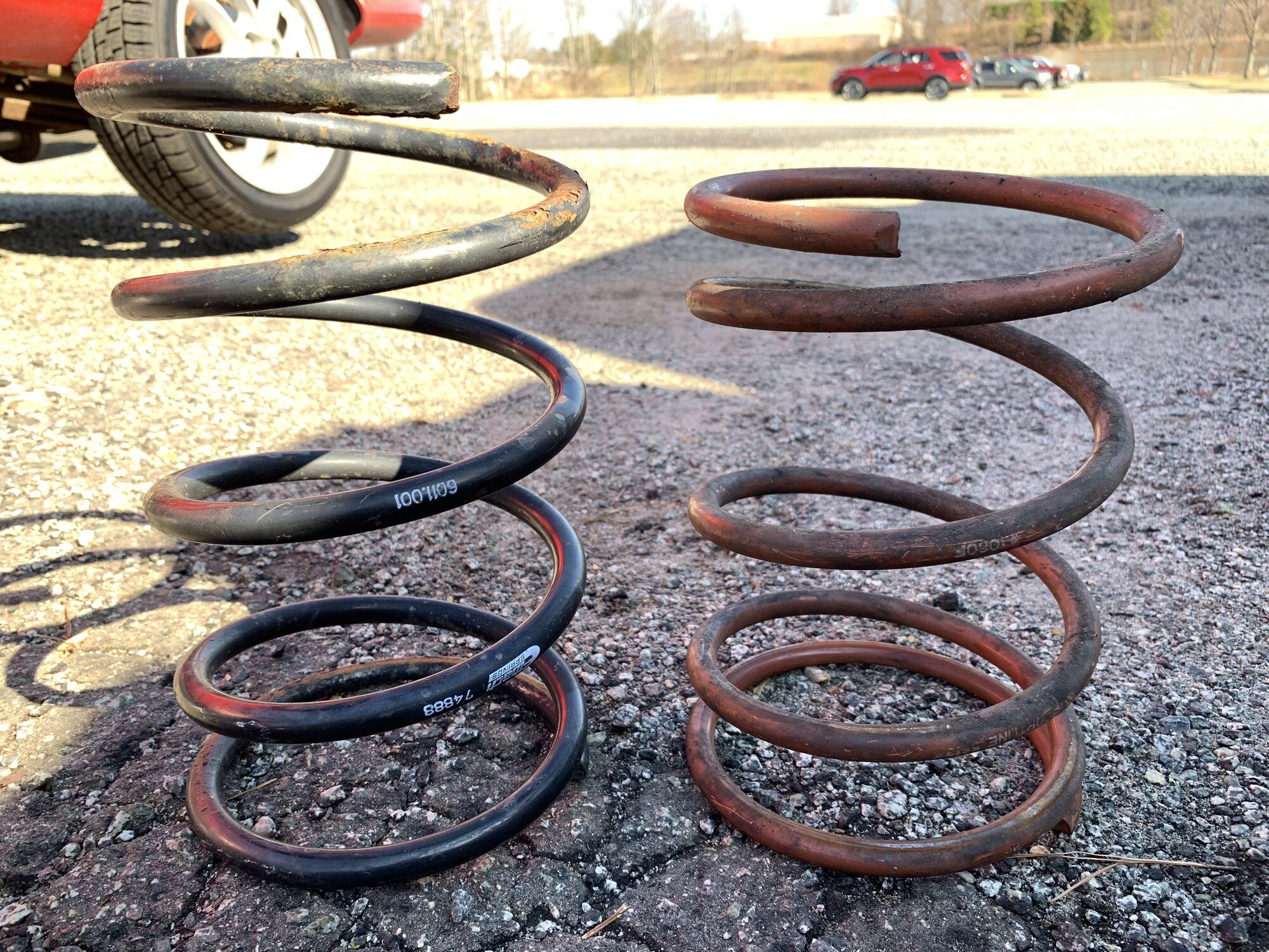

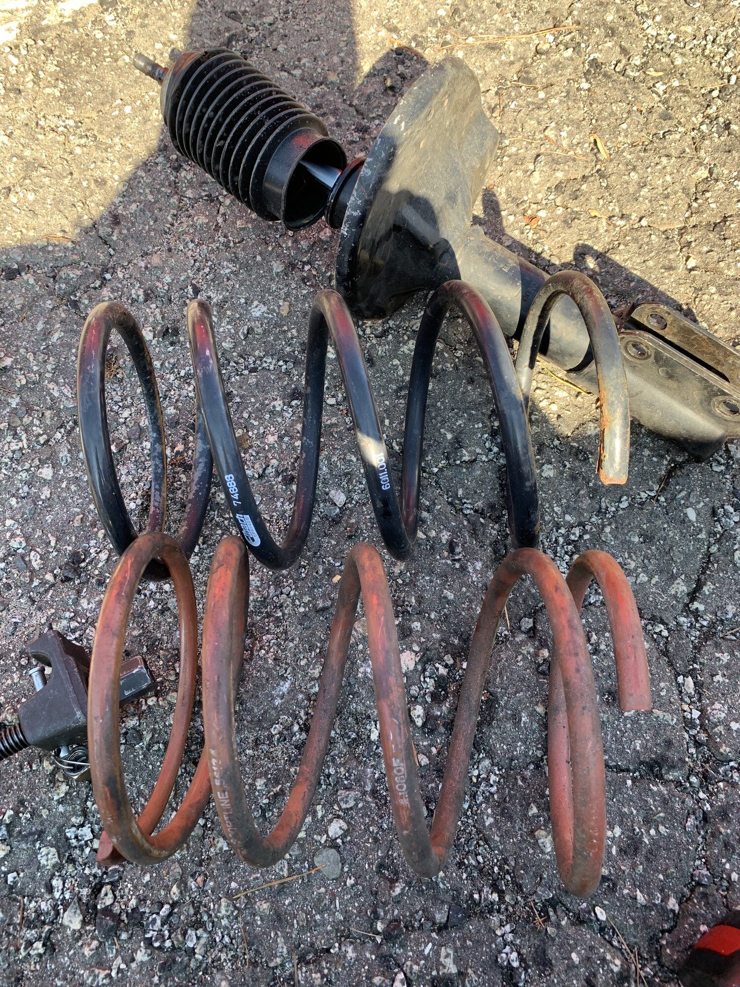

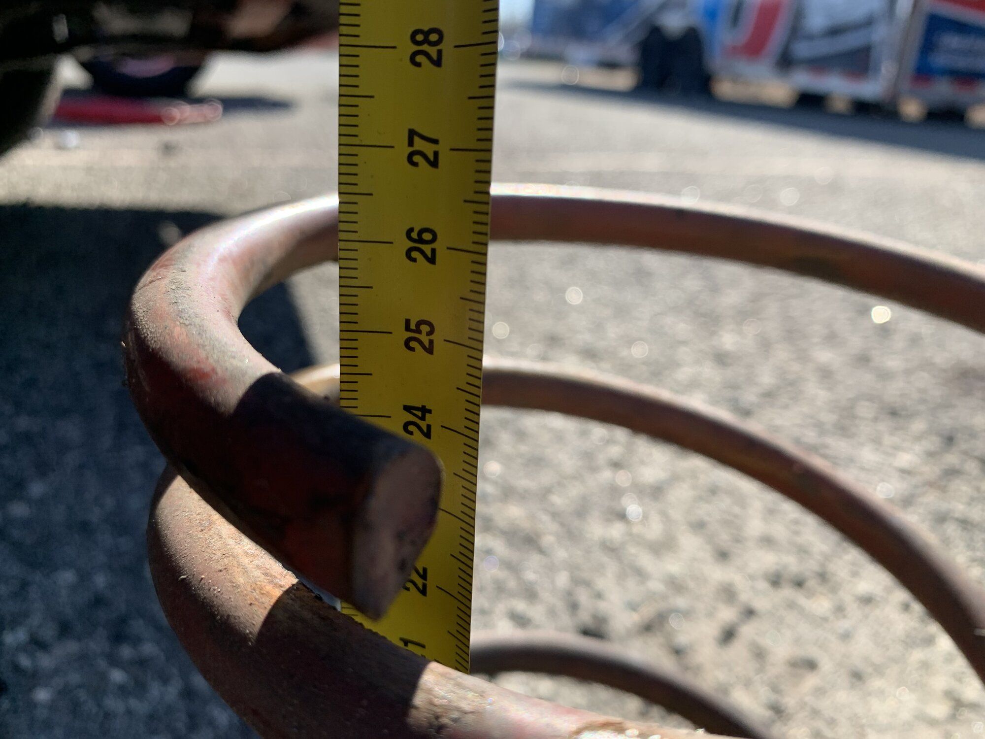

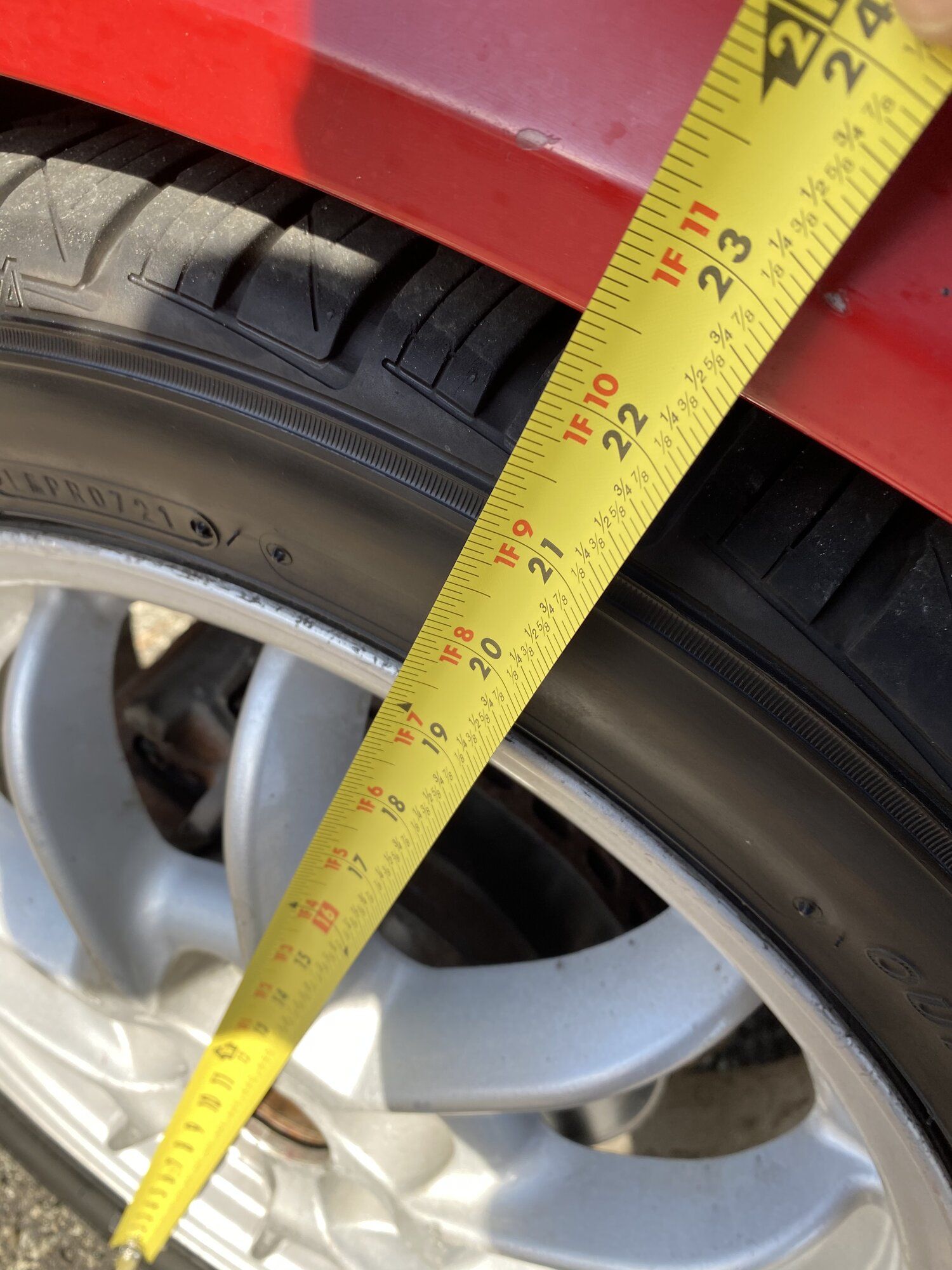

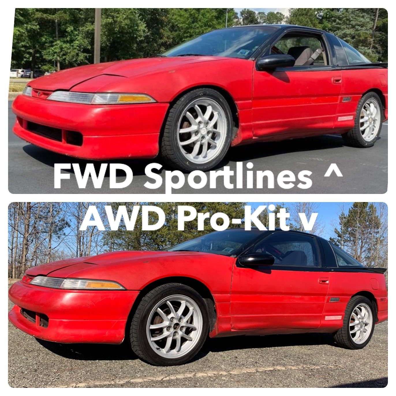

There aren’t many choices for lowering springs for 1G AWD DSMs these days. I came across some FWD Eibach sportlines a while back. I had read they didn’t fit AWD cars but I tried them anyway since there some brands selling springs that fit both. I actually loved how low the car looked and the rake it gave me. But the spring rate was a little soft and I was getting a lot of scrape. Much like on my previous teal dsm that had Intrax springs back in the day. It was an acceptable ride but was a little pitchy on new Gabriels up front and used AGXs in the back.
A local former DSMr was clearing out some old parts and got his Eibachs AWD Pro-kits springs. After installing them I was surprised how much the car went back up. The ride is definitely a little firmer but I’m a little bummed on the look. I may trim down the coils. But part of me is hesitant to do so since these spring are no longer made.
Coilovers would be great but not in my budget anytime soon.

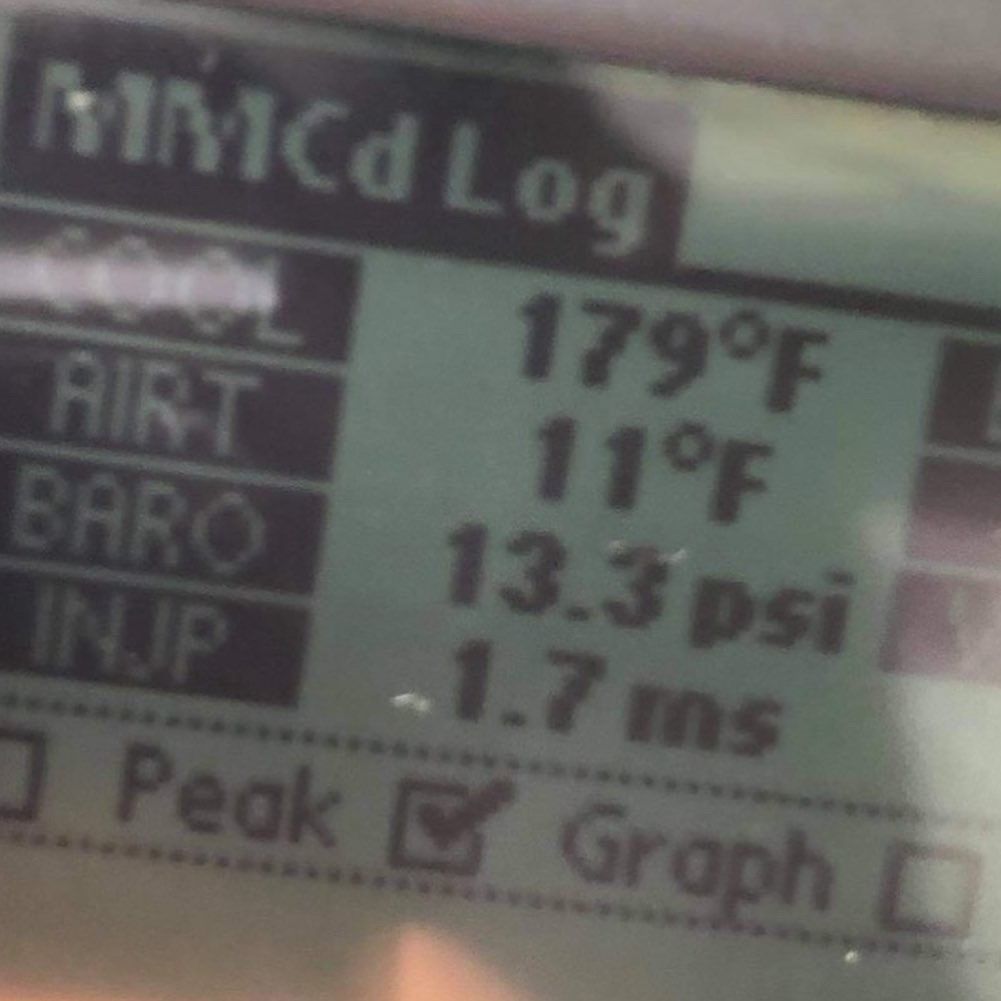

I was noticing some implausible (such as 11F) or varying temp numbers on the mmcd for air temp. Since I’m running a vpc those and the baro numbers should be fixed because the maf is eliminated and the ecu takes a 5v signal, runs it through a series of resistors and creates a voltage to simulate a baro and air temp reading. I ordered some color
matching resistors and soldered them in the vpc loom instead of using the taps from the factory.
The car is running better. The O2 reading at cruise is more consistent and the afr under isn’t as crazy rich as it was before. And most importantly I’m seeing a consistent air temp on mmcd.
