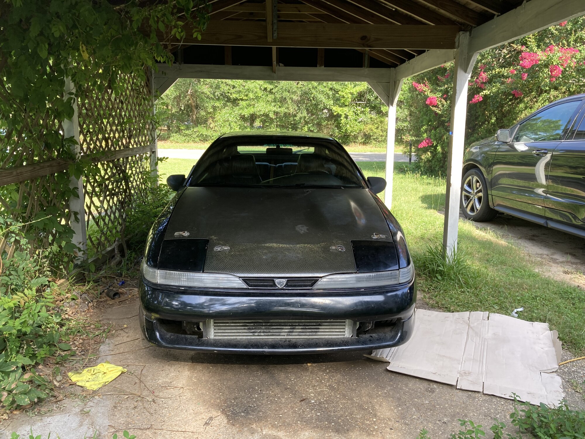

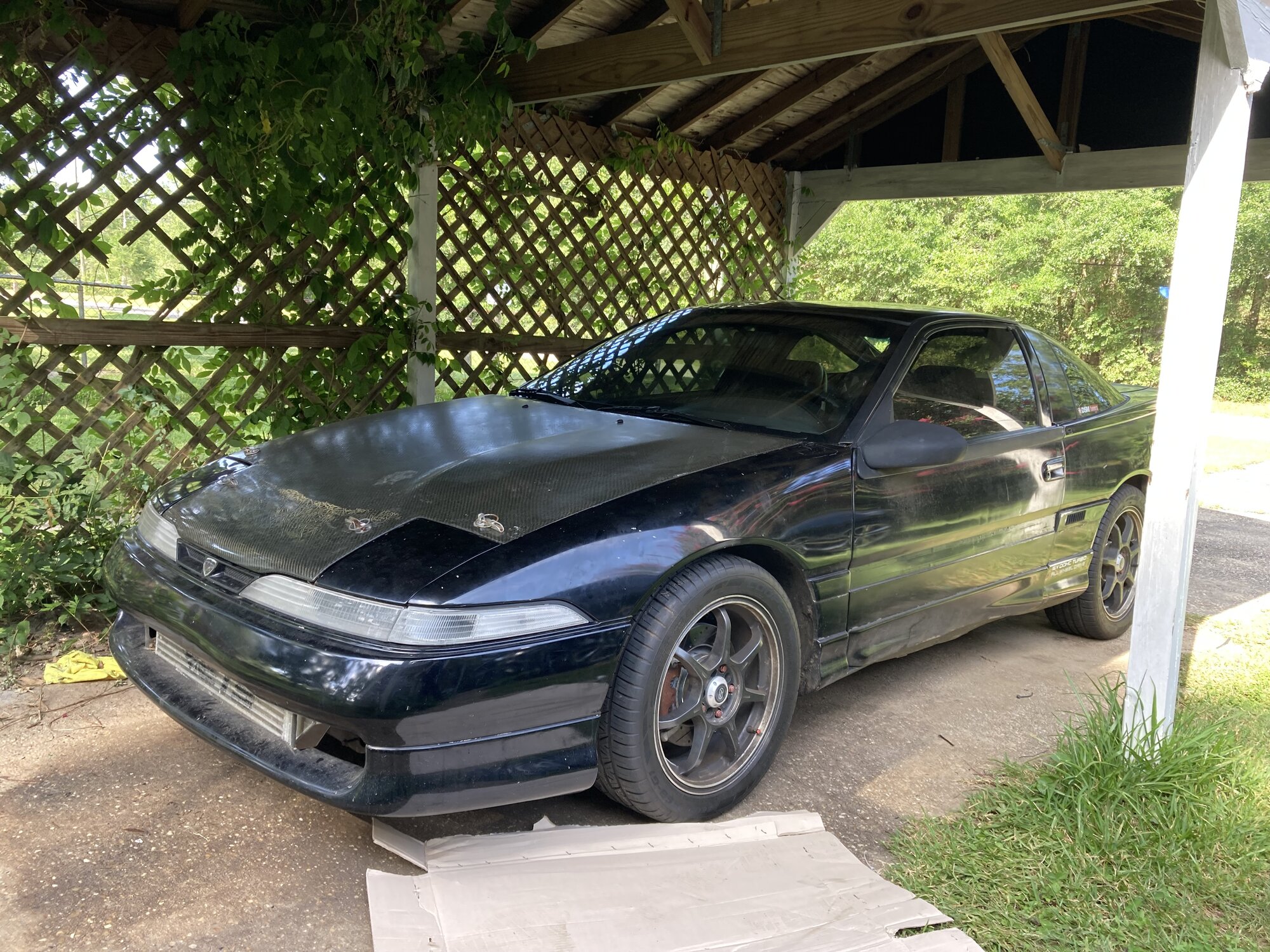

Got the intercooler mounted and front bumper/lights back on. It's like nothing ever happened, and everything fits a little better than before because since it was off I went OCD and made sure stuff looked and fit good.
I'll get pictures tomorrow when it's daylight out. Or I'll use my ridiculously bright flashlight(like 25,000 lumens) to recreate the daylight. Haven't decided which.
Either way, it's so wild how you can have the car completely blown apart and in a few days it's back together like nothing ever happened. If I had an idle switch I'd test the car tomorrow by driving it to work, but good things to those who wait as they say.

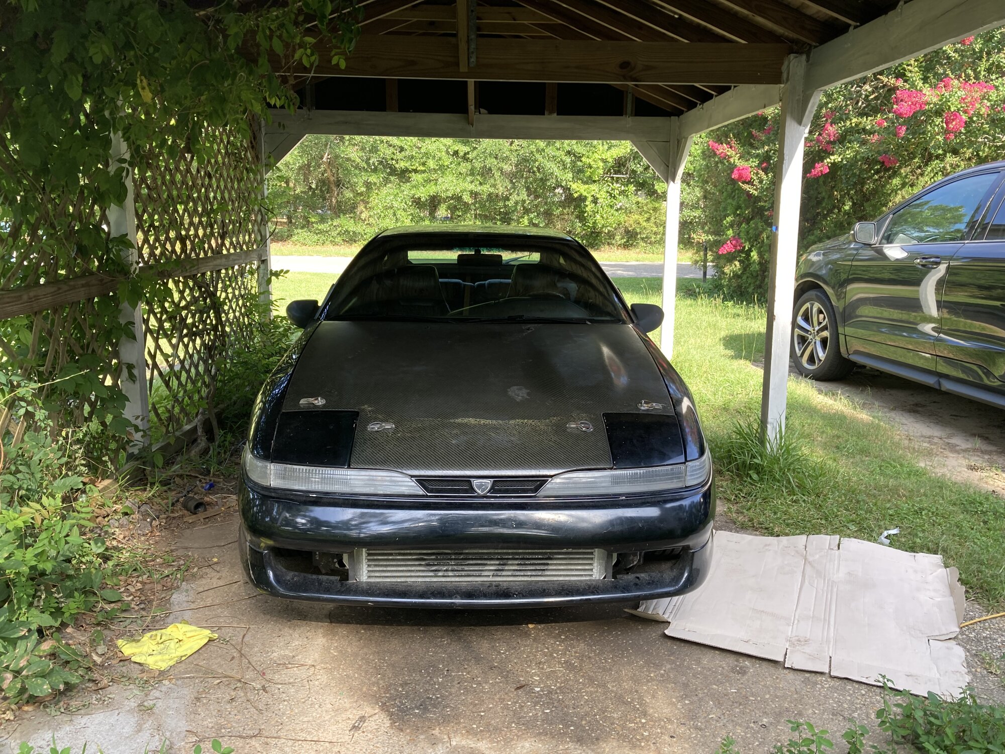

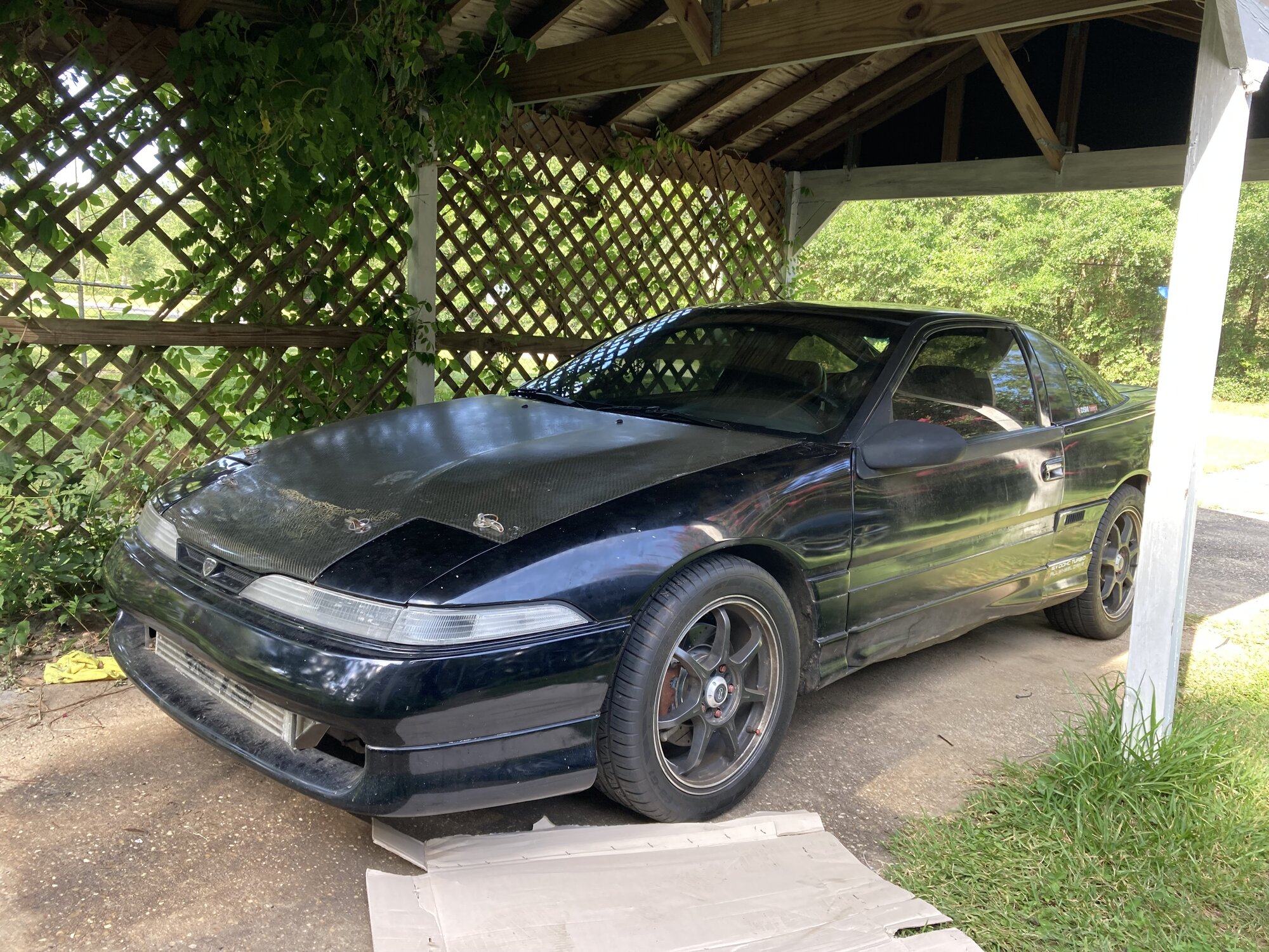

As promised, here’s pictures of it back assembled like nothing ever happened!
Crazy. You’d never know it was blown apart a day ago. Lol.

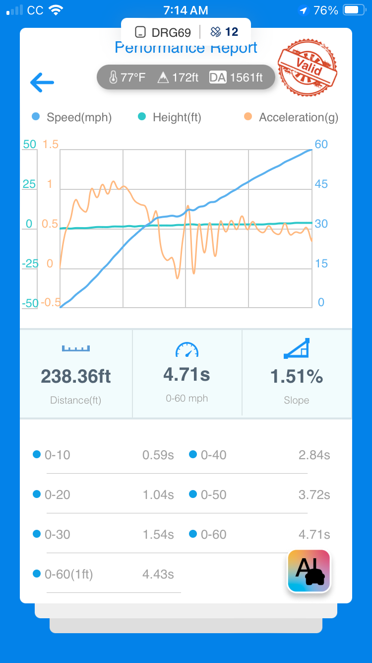

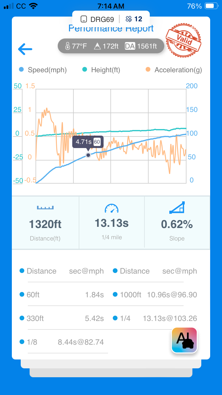

Anyway, I lowered the launch RPM from 5400 down to 4900, and did a test pass. The launch was significantly better. It felt better, and there was still wheel spin but less so. I made a full pass, and it didn't really feel like it was ripping as hard as it normally does. Turns out, I forgot I turned my boost controller off(I turn it off when I have the A/C on because I don't wanna see 24lbs+ with the compressor on. ROFL ) so these dragy passes were basically on wastegate pressure only. 15lbs creeping to 18.
Very pleased. Absolutely slap full tank of E85, all of my EMS gear in the car, full weight...literally as heavy as you can make the car, and only on wastegate pressure. I'm stoked.
I'm half tempted to lower the launch RPM another hundred RPM and see if the launch improves more. Slightly less wheel spin and I think we've got 1.6X 60 foots in her as she sits. Which is where I want to be launch wise. But yeah. Slightly annoyed and bummed I didn't make a pass on 24lbs but meh. The launch being so much better is encouraging.
