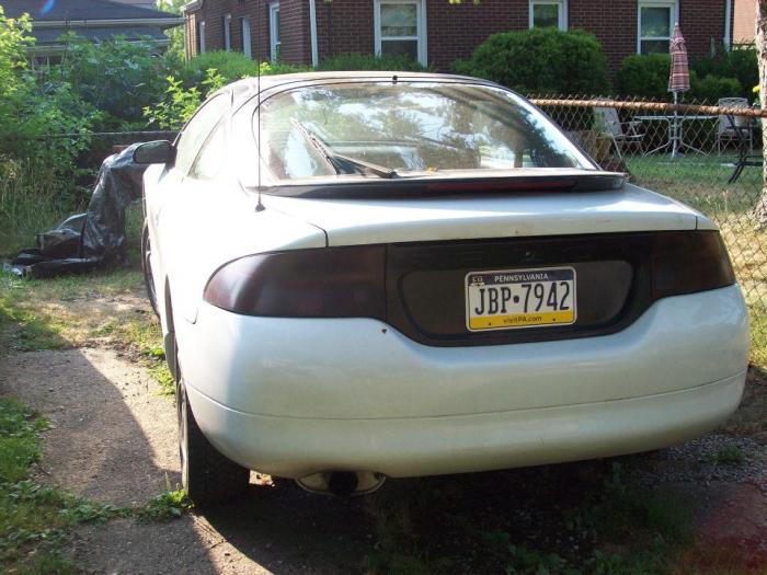

This is the build of my 1996 AWD Talon TSI 5spd.
Goal:initially it was going to be my daily driver, and kept mostly stock...

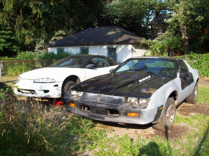

Pictured is shortly after I bought it, before I started working on it, alongside is my late '85 camaro project with a 3.4 swap, sadly I had to sacrifice one of the two when I was forced to move.
I chose to keep the talon because it has more potential, and a manual transmission, but I miss my Camaro and plan to eventually get another 3rd gen Camaro. Since I had to get rid of my Camaro(which I was building to race) and be down to 1 car, the whole keeping the talon stock thing went out the window, having to replace components shortly after buying it didn't help either...
I bought the car running, but with quite a few issues, but the upside, and reason I bought it and paid what I did, are that the body underneath is in very good shape(for a PA car) with only 2 small bad rust spots(rocker panels in the rear). And because I wanted a 2g, but was worried about crank walk-the solution, I bought a 6 bolt swapped car.
The 6 bolt swap was not done by the guy I bought it from, it was done by another owner, I was told it had forged pistons, and rods. The pistons I did later verify when I had the cylinder head off, are Ross racing pistons by the part # on them, I did not have the lower end apart, but I reckon the rods are forged, since the pistons turned out to be true. The crank from what I was told is stock.
