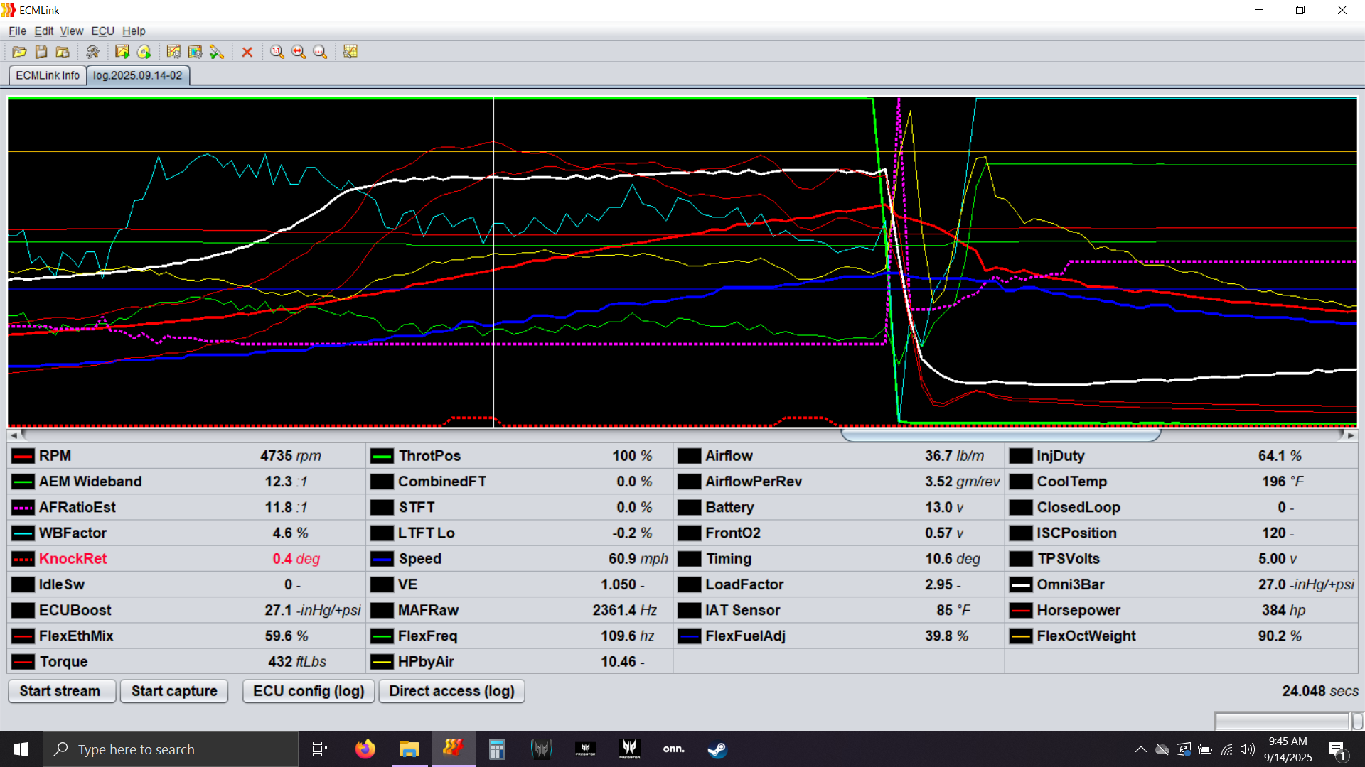

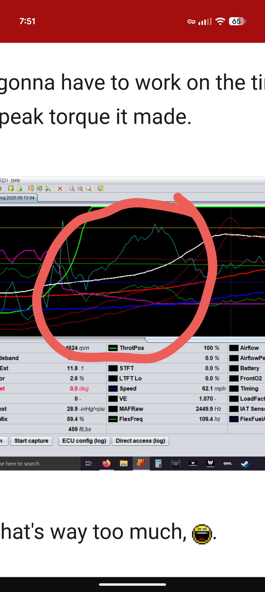

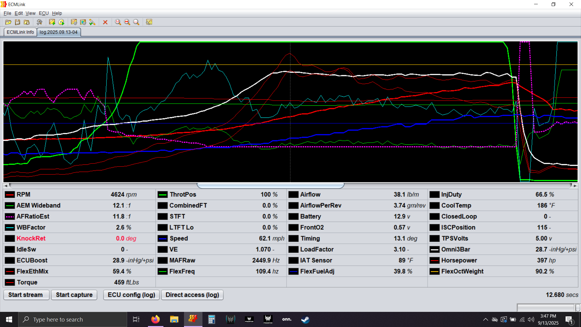

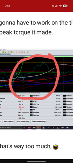

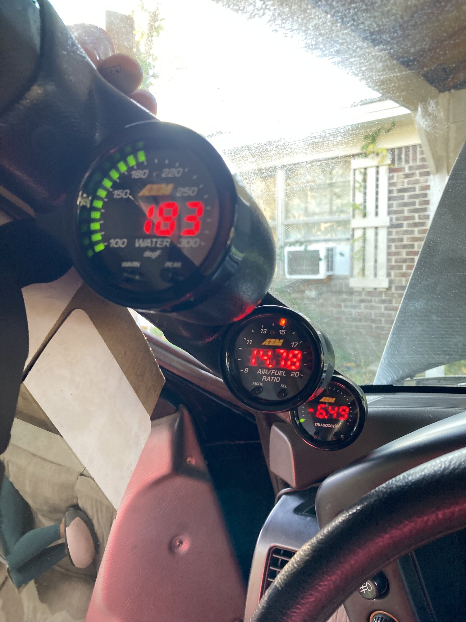

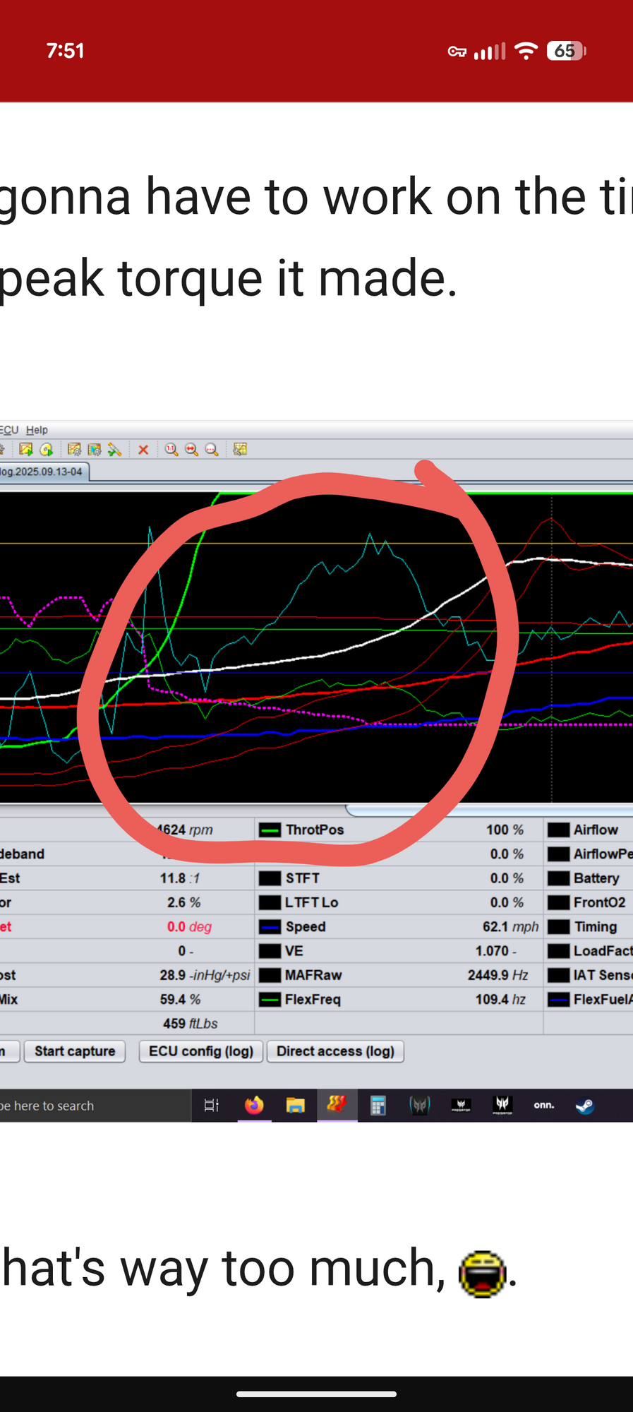

It looks like your spool up area needs some more fuel? I don't know exactly those show but maybe take a look at that?
I will for sure. I’ve been focusing so much on the upper RPMs being rich(which I’ve finally solved! Yay!) I haven’t really looked at that.

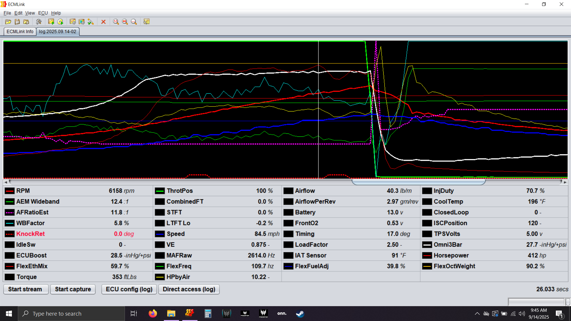

I did back off on my timing table since the last post because I really don’t want to grenade this setup. I figure I can run a bit more boost to compensate or just accept the little loss in power in exchange for longevity.
So I did a quick 0-60 rip, and good grief this thing makes way more power. 4900RPM launch, slipping the clutch as much as I always do which usually results in a solid launch resulted in a four wheel burnout that was so healthy it actually left four decent burnout marks on the asphalt. I stayed in the pass anyway just for giggles, and busted out a 4.69 0-60. That's INSANE.
This was after I took a lot of salt and pepper out of the timing map too. Removed timing, added a couple lbs of boost to offset, and the result was 0 knock and ECMLink actually estimates more horsepower now and only a slight loss in torque. It's like 82* outside instead of 90*'s so I'm sure that's a lot of it, but still. That's wild.
412 awhp and 432 ft/lbs of torque. Not too shabby at all considering it's on an engine with 150psi of compression, stock intake, stock exhaust manifold and o2 housing, and with my tarded ass tuning it. :p The BC Cams are also not degreed or adjusted, just installed straight up. I'm 100% sure a pro could get like mid 400's or higher out of it even as it sits, but I'm proud of it.
I still am running a bit lean in the 3500RPM range, so after this pass I gave it about a 1/3rd turn on the AFPR because the whole map is just a touch lean. If it gets even more lean after I attempt to give it more fuel, I'll check out the hose on the fuel pump because that was the problem last time.
But this is wild, yall. I am so happy. Changing to the -10AN valvecover made a HUGE difference in performance in the upper RPM. The very first pass I made after getting it back together and changing NOTHING with boost or tune and it made 394HP/over 400ft/lbs and felt amazing. Now it makes over 400! Invest in a catch can with big lines yall!!
Stoked. I am extremely tempted to go to the local track now and see what I can click off with this thing.
How accurate is ecmlink with power numbers?
Realistically not as accurate as a dyno. It is a really good metric to use to measure performance increases or decreases though. That's how I'm using it. It's "close enough" to a real world power number, but more importantly it shows that I am making improvements. I'm using it like you're supposed to use real world dynos. Less about the number, more about tracking gains vs losses.
What will really show how accurate or inaccurate it is, will be when I make more 1/4 mile passes. The MPH don't lie.

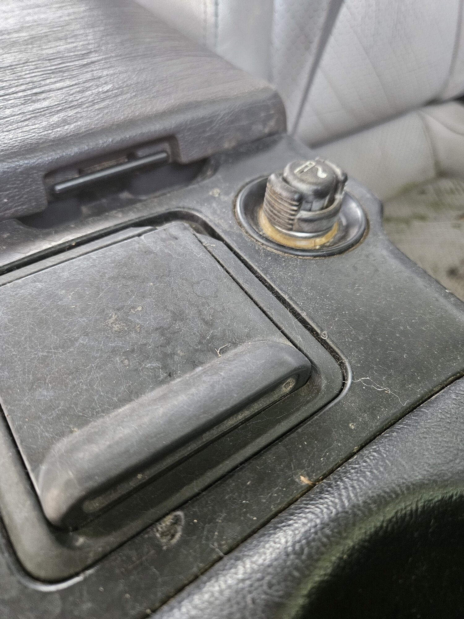

Also! I fixed my cigarette lighter finally. I've been meaning to do that, but now I can actually use 12v adapters where before I couldn't. Yay! Best part, I fixed it for Free.99 baby.

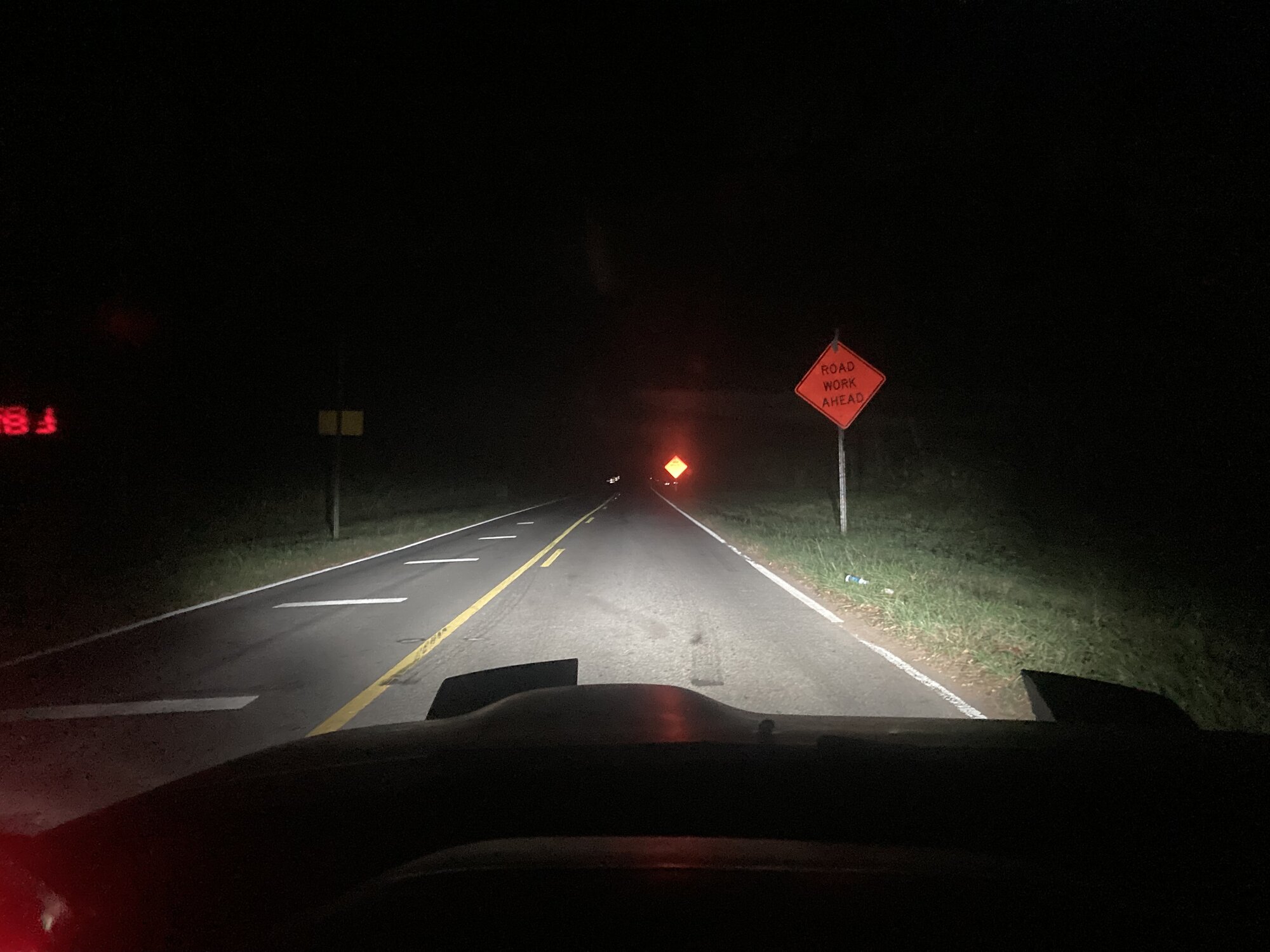

But!! While I was out, I finally remembered to get a picture of the headlights.
Low Beams - Keep in mind I aimed these down pretty far on purpose. I have ranted for YEARS about douchebags with LEDs that don't have proper cutoffs so I aimed them low, and to date I have never been flashed by an annoyed motorist in the oncoming lane.
Even with them aimed down, line of sight is drastically improved. These are the cheapo amazon H4 LEDs, so nothing spectacular either. Keep that in mind.
High Beams - What I use when I need to see extremely far down the road. You can see why. :p
Sorry the second pic is so shaky. I was leaning on the wheel and yeah. Car vibrates. :p

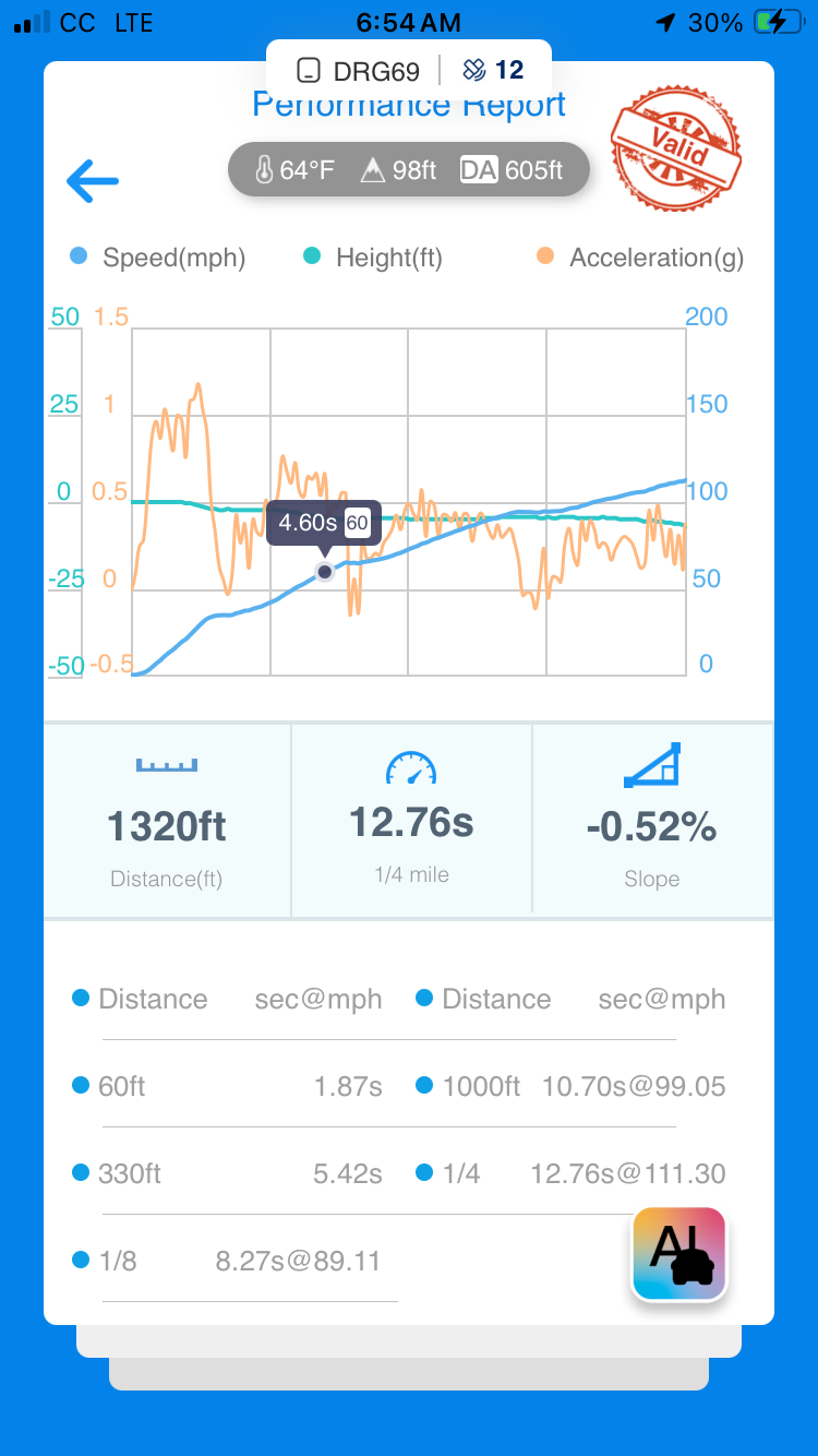

This thing is a beast now, man. Trying to launch at 4900 on the 29lb boost curve just isn’t gonna happen. Lol. Not without DRs or something.
Gonna lower the launch limit by 200RPM and see what she’ll do. I tried to power through the AWD burnout but 2nd gear wasn’t happy. Ran a 13.2 at like 110mph.
If lowering the launch limit doesn’t work I’ll install a scramble boost button and launch on the 21psi curve that nets me good 60’ times and then after the launch hit the scramble button for 28+. See how that works.
Brooooooos.

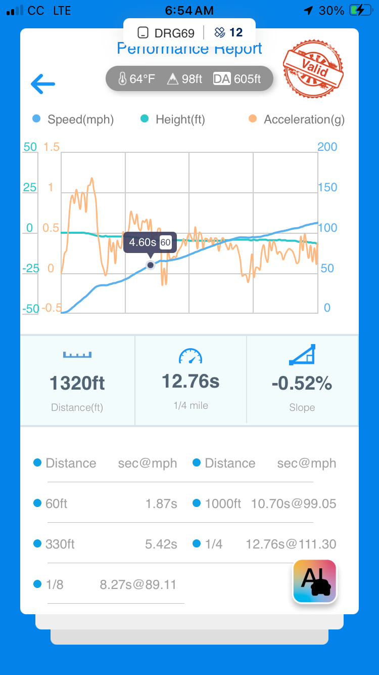

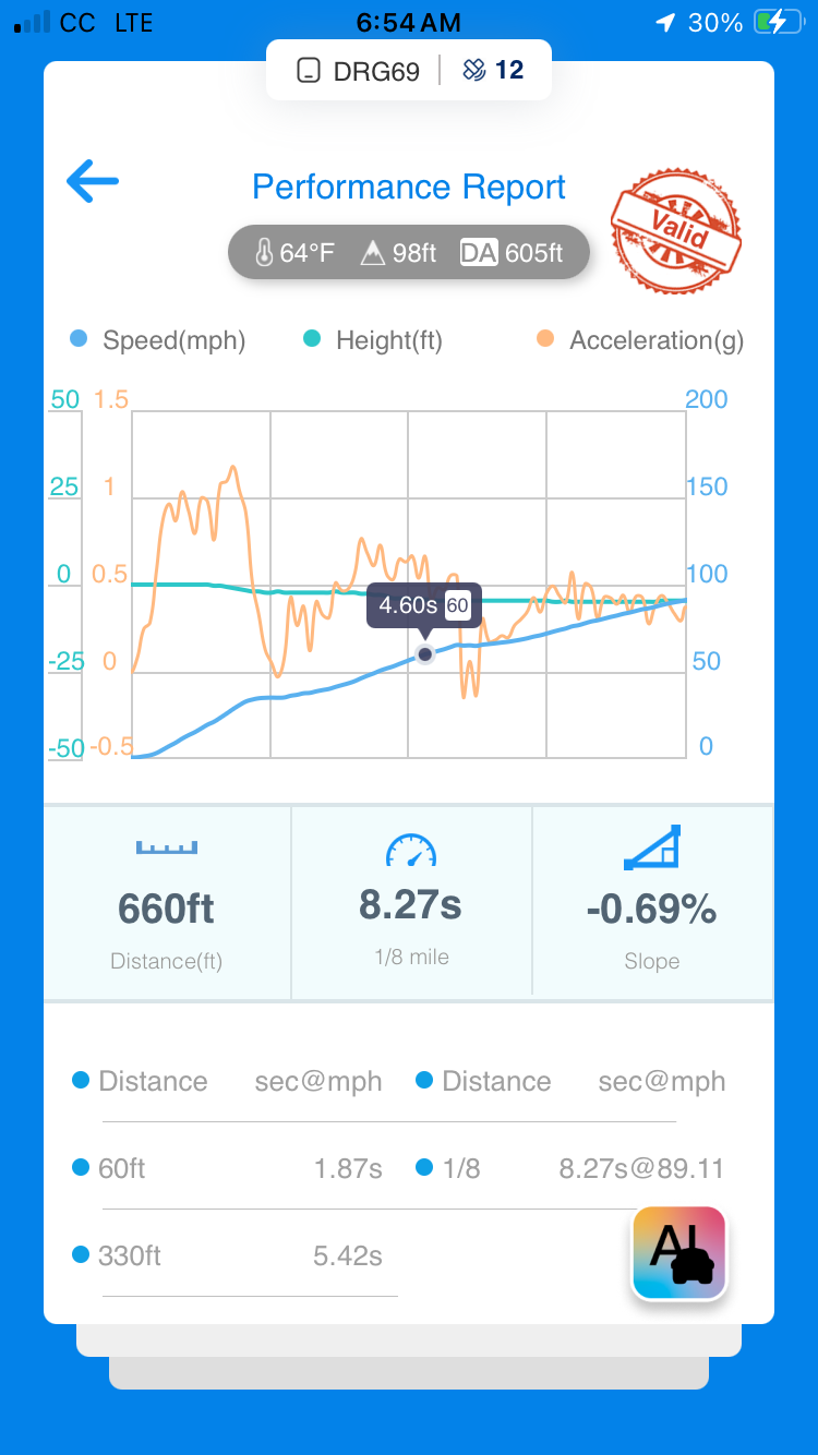

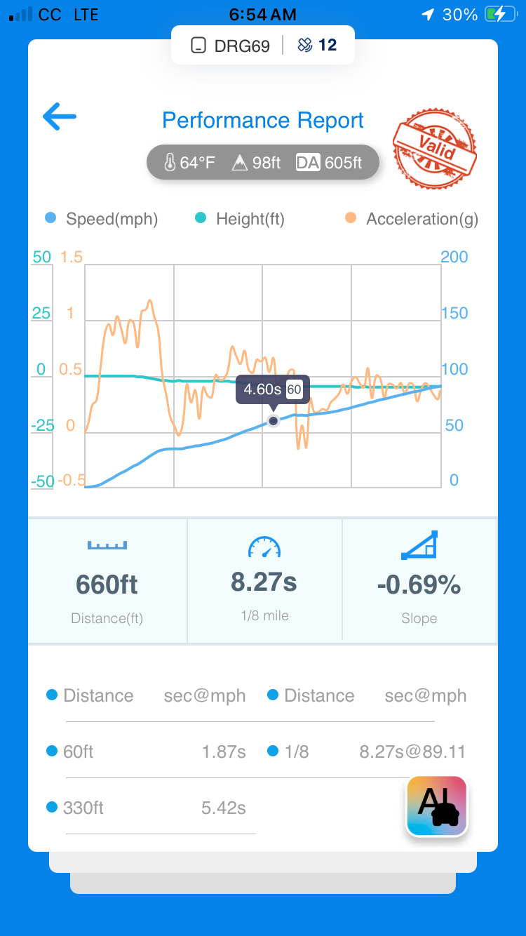

I will spare you the paragraph of ricer excuses and just sum it up with: I’m a terrible driver. But look at that MPH! I am stoked. I feel like 11’s are within reach if I can learn how to drive.
The goal for the car has always been 7’s in the 1/8th and 11’s in the 1/4. This 1/8th mile pass alone would’ve been a 7. My best 330’ has been a 5.24 and this was a 5.4X. Man! So close.
Anyway. What a difference a properly orientated CAS and a free breathing engine makes.

If you can get that 60' down it's for sure a 7 second 8th mile.
Yeah, I'm gonna wire in a scramble boost button to make a poor mans "boost by gear". Launching at 4900 on a lower boost setting usually results in an awesome 60' time. Then when I hit 2nd gear I can grab the button for the full monty. Or I could get stickier tires, but I really don't want to break driveline stuff and I am super worried about that if I suddenly had traction on 29lbs. Lol.

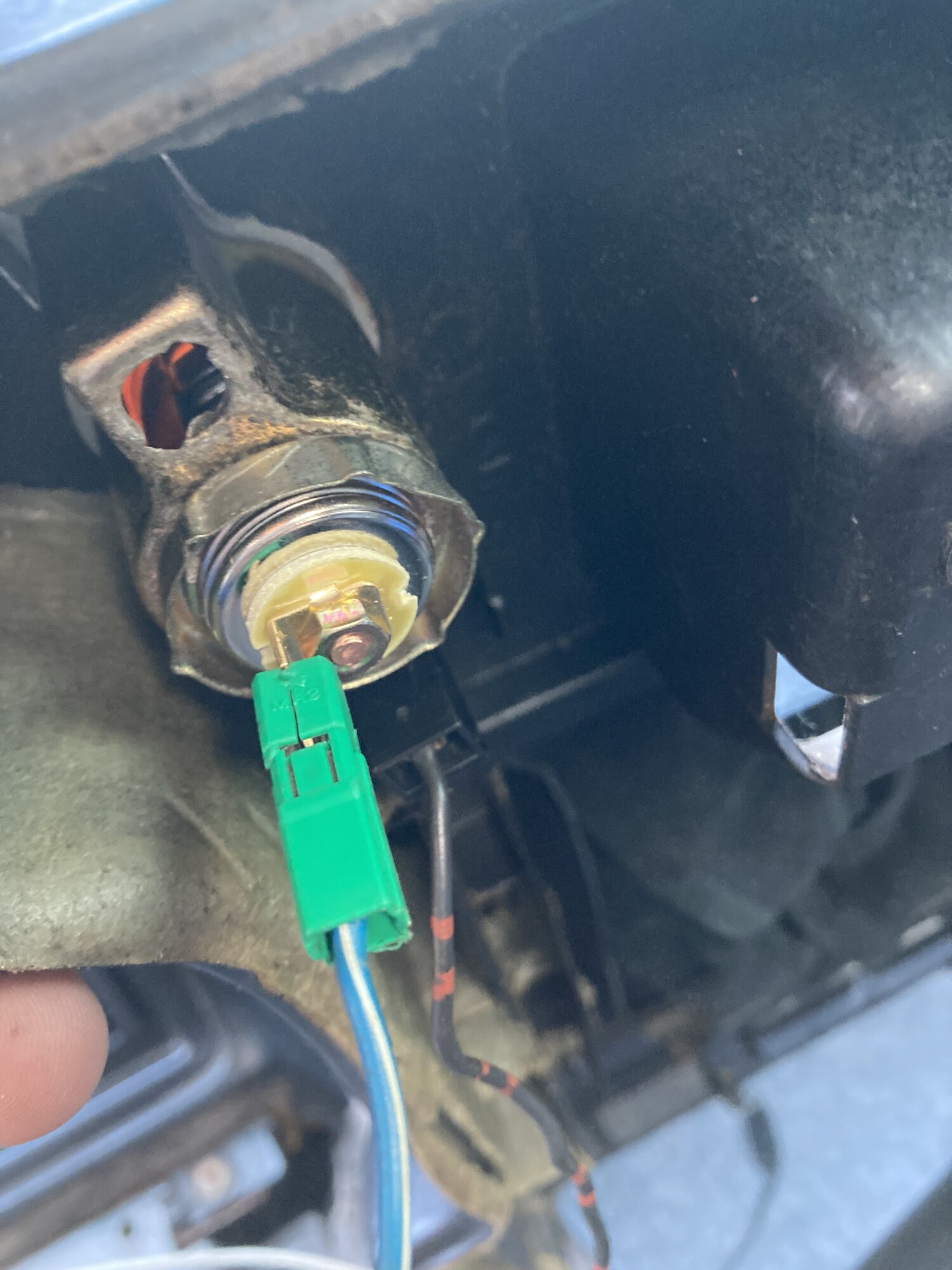

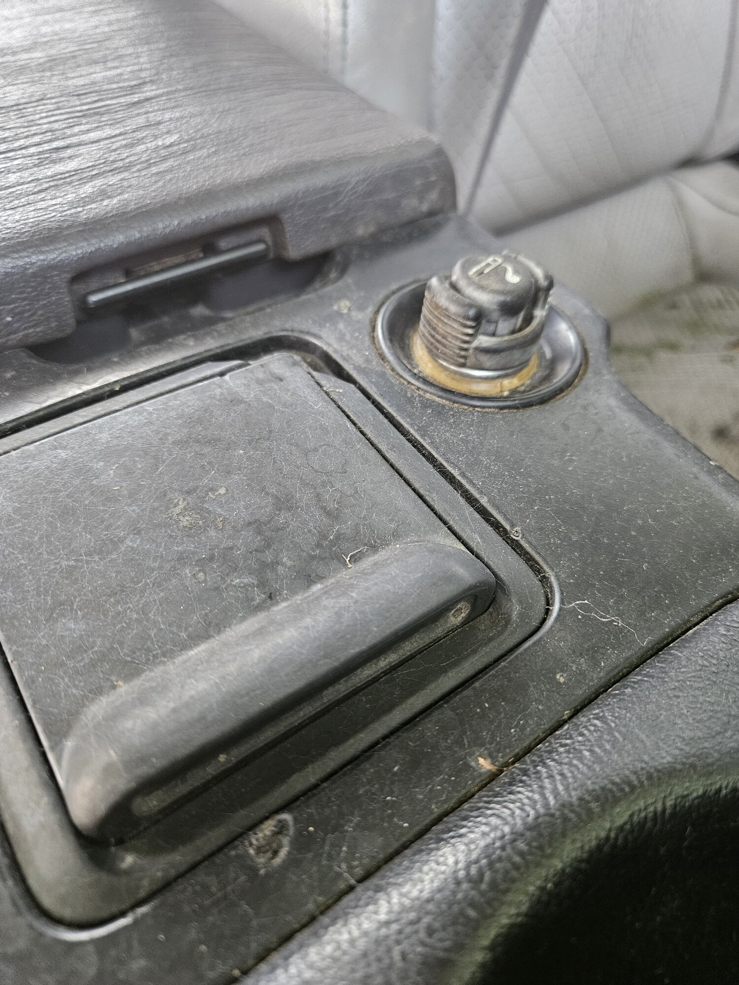

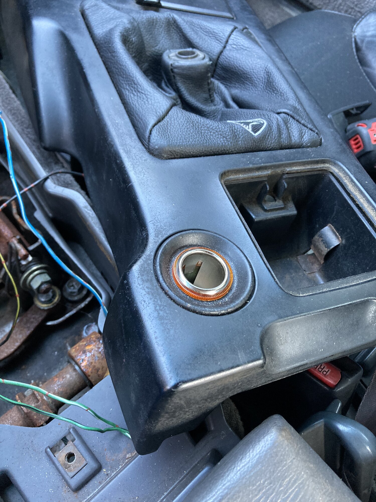

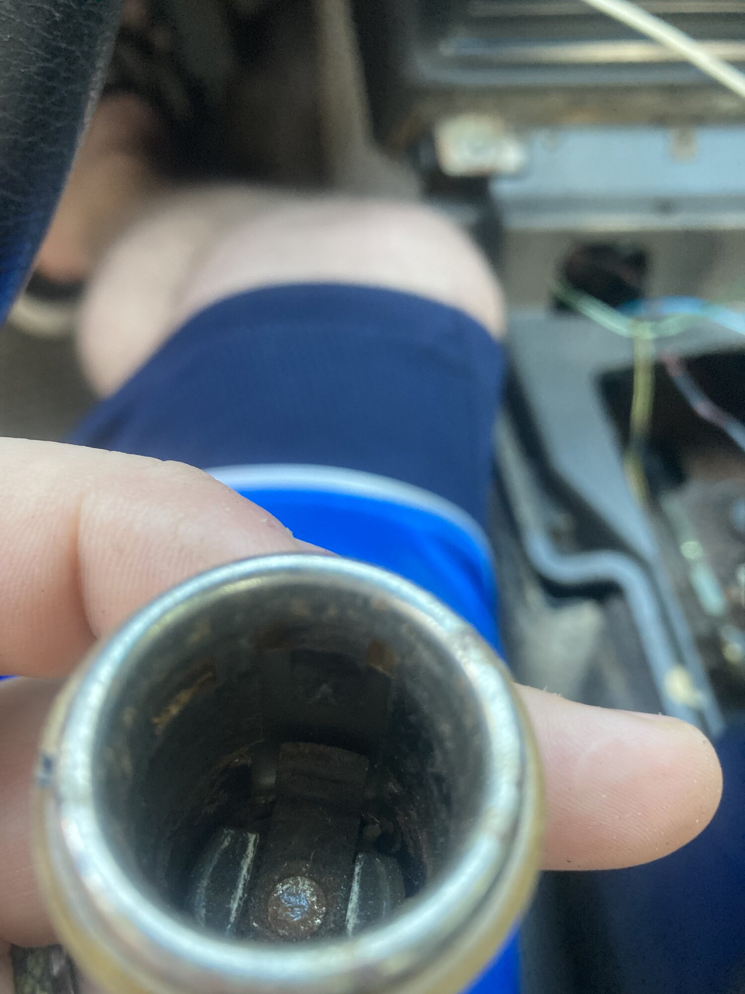

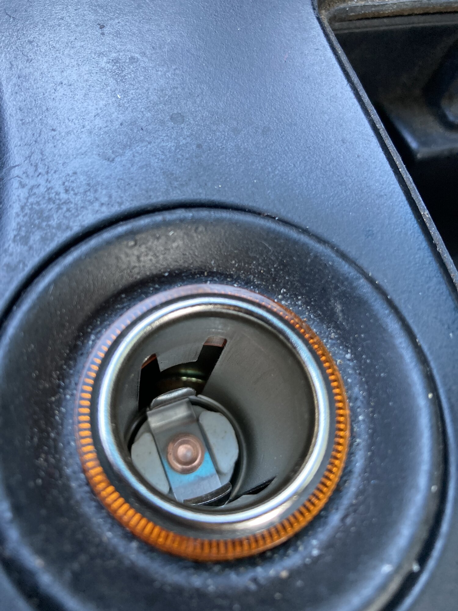

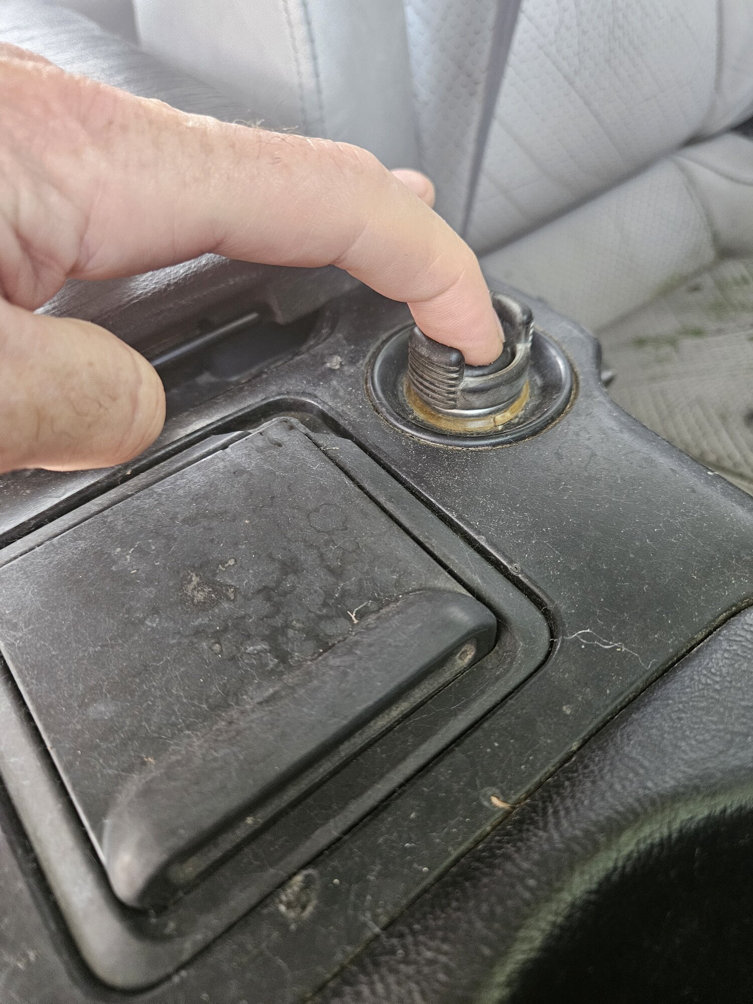

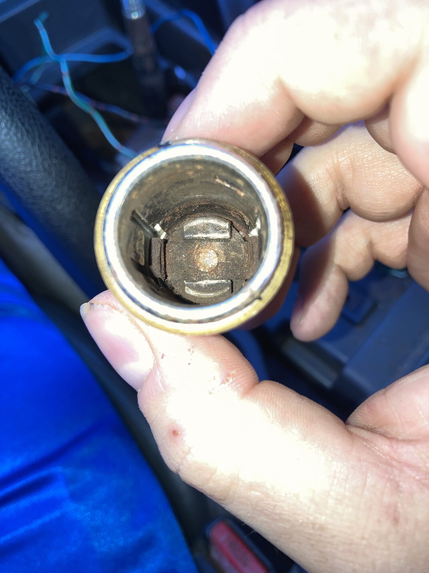

Couple days ago now I fixed the wiring to my cigarette lighter, but it was finicky. If you bumped it whatever you had plugged in there would give out. Looking inside, I could see the problem.
I could technically probably clean it by soaking it in rust remover…but new cigarette lighters are $8 shipped on Amazon. So I got one and threw it in.

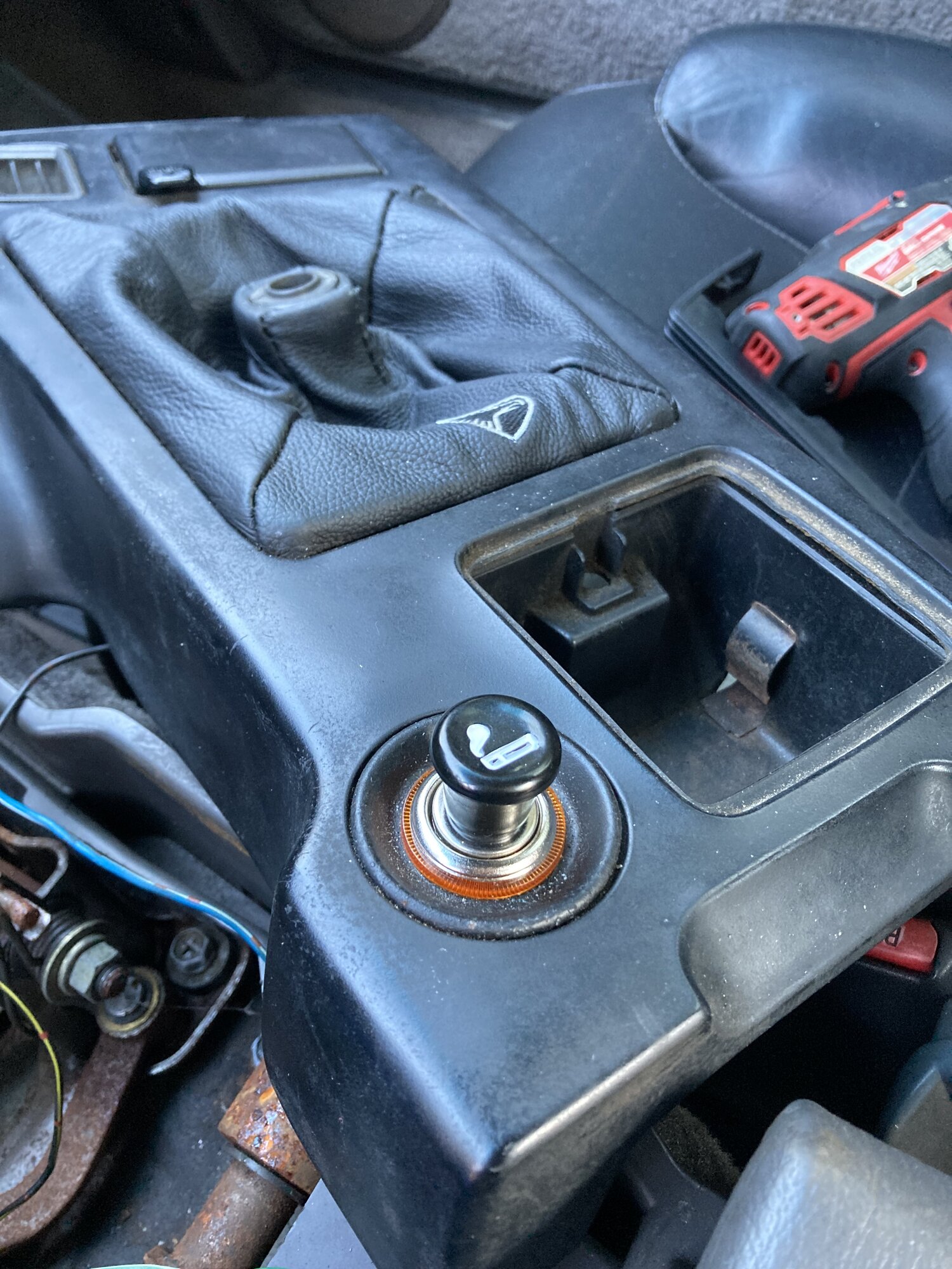

Works great!
Looks like OEM fit and finish which was my goal, and my favorite part is this.
The OEM sleeve that holds the light bulb and stuff fits on it just like the OEM one. For all intents and purposes it looks like a brand new OEM unit. Extremely pleased. And now whatever you plug in there doesn’t care how much you bump or move it.
I love little stuff like this. It’s small but man. The little stuff adds up.

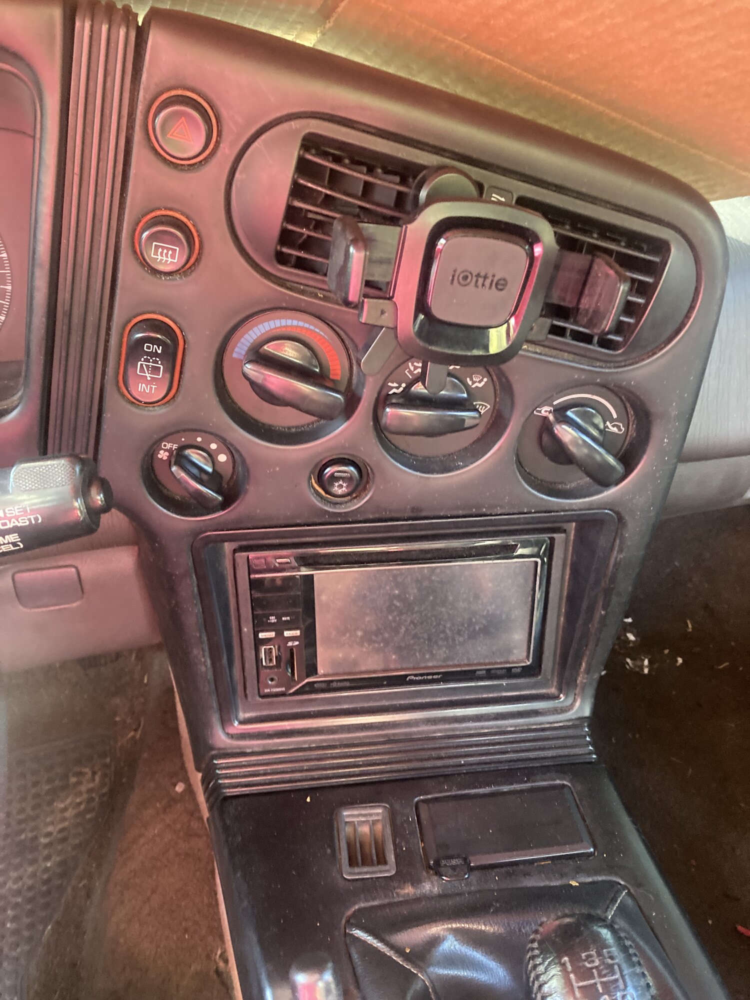

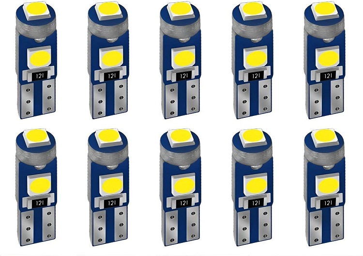

Also: the cigarette lighter and ash tray lights haven’t worked but all got the proper voltage. Pulled one out and it was missing one of the metal tabs on the bulb itself and I guess without a working bulb, the circuit doesn’t complete.
So I grabbed a set of these from autozone for $8.
I am pleased to say they are identical to the #74 bulb that supposedly is OEM. They’re not bright at all but I don’t think they’re supposed to be. I ordered a set of LEDs off of amazon(10 pack) but I wanted to see if I fixed the lighting itself and that the 2721 bulbs would even work first, before I bought more.
Either way, it all works now. Now I just need to get my HVAC control lights working, and find a rear privacy cover. Then the interior will be 100% complete and working. :D

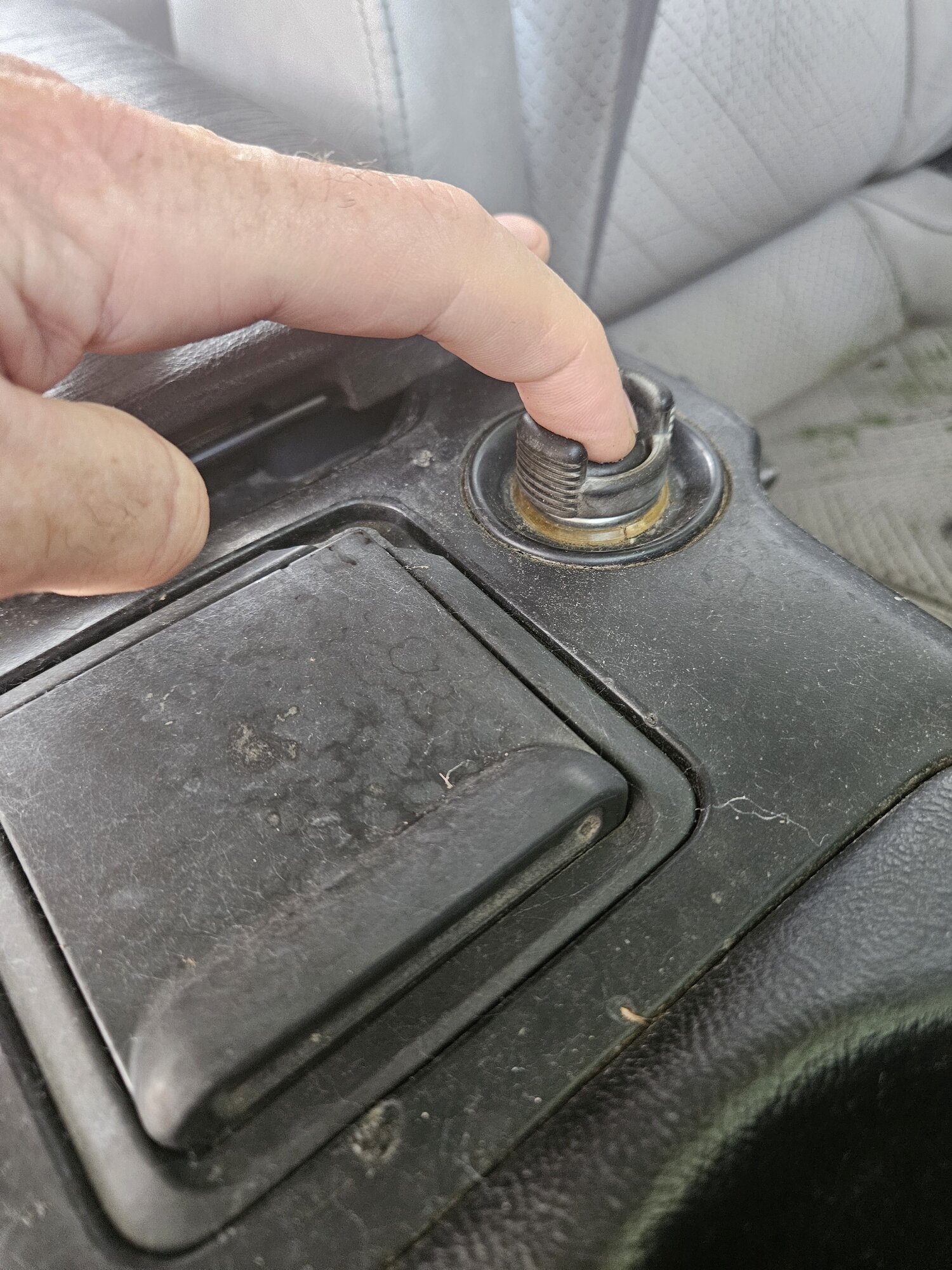

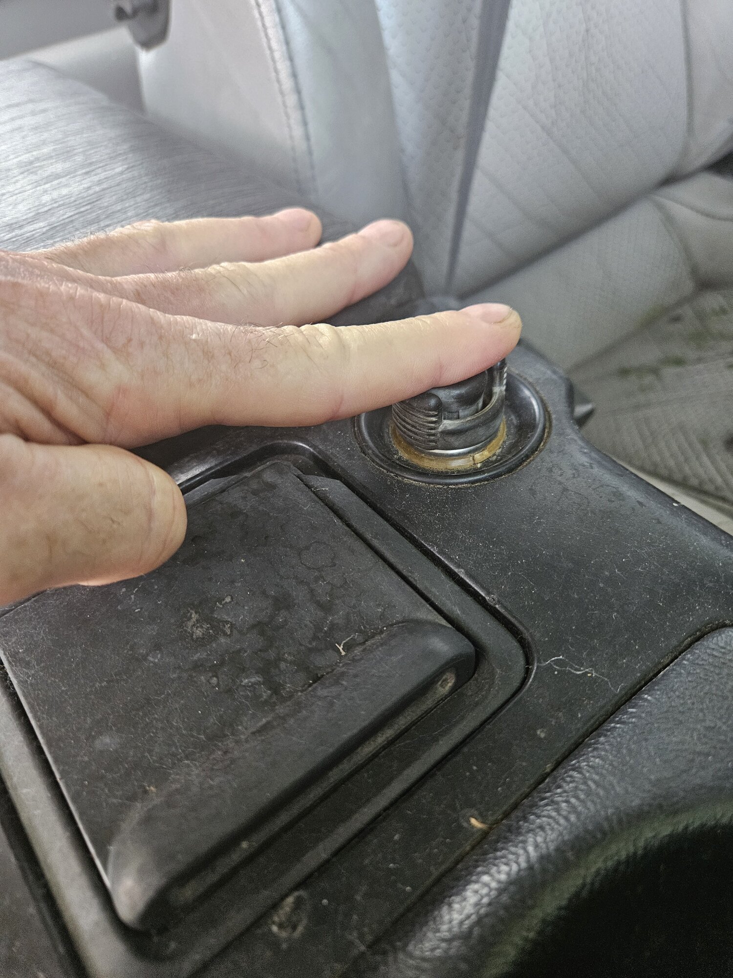

Now, don't LEAN on that lighter. The OEM one had a shield, kinda, around it so if you rest your arm on the console, it wouldn't depress.
Looks nice tho!

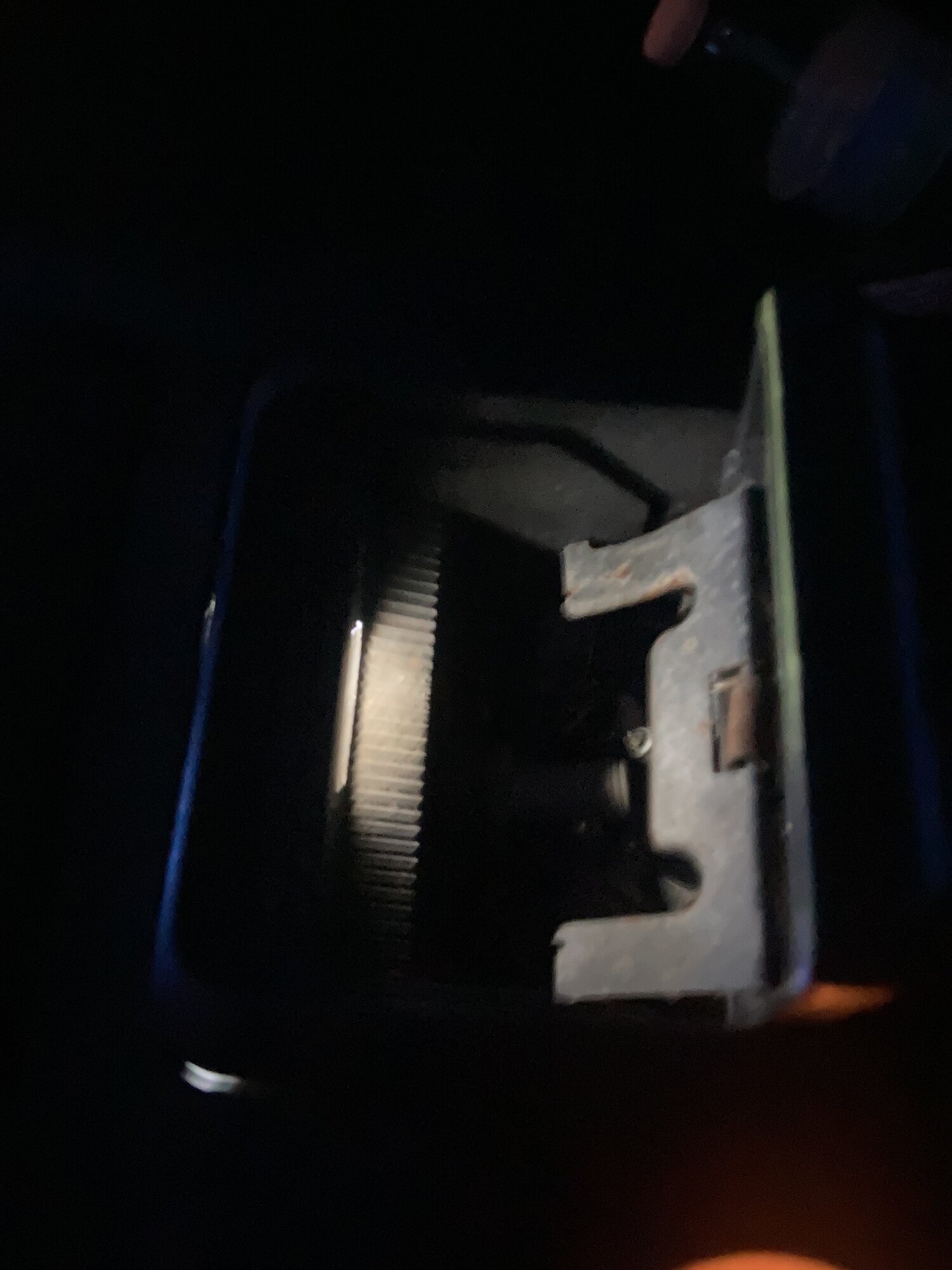

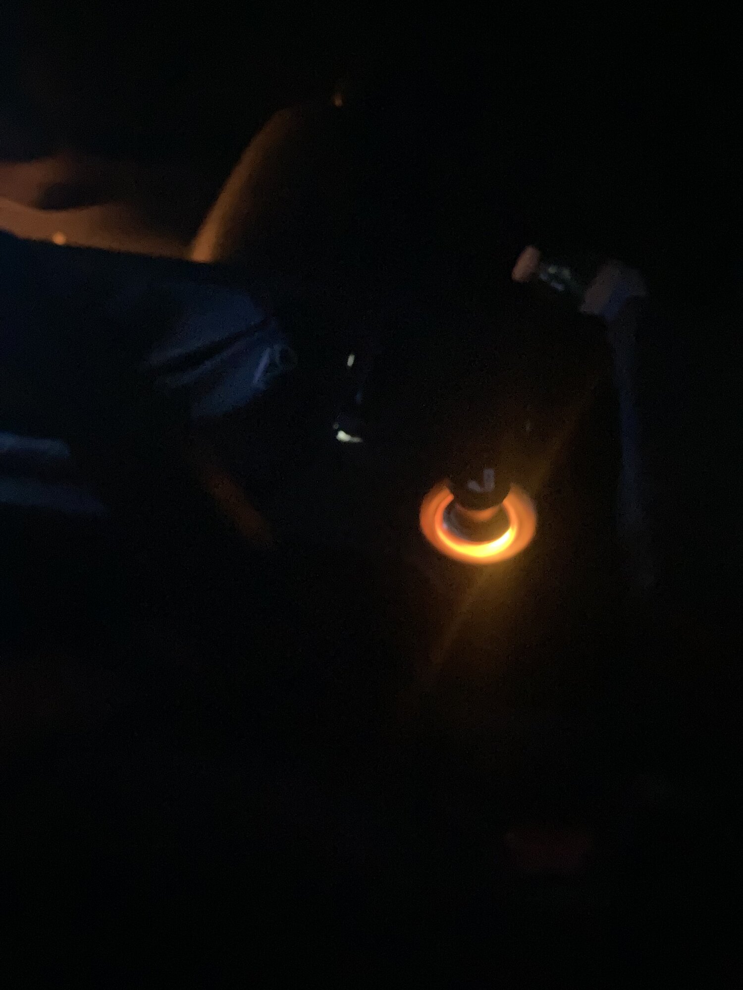

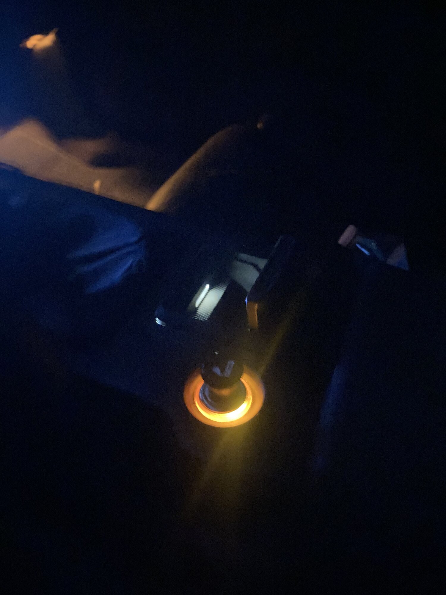

So, super duper small thing but I've been messing with my lights for the cigarette lighter and ashtray. They never worked even when I plugged the OEM harness in, and it turned out that one of the bulbs was blown. I ordered new incandescent bulbs for it, but they just weren't bright. There was a voltage issue, and when I grounded one of the bulbs with my test light, it'd burn nice and bright. Inside the socket was pretty corroded and even after sanding, it wasn't quite up to snuff.

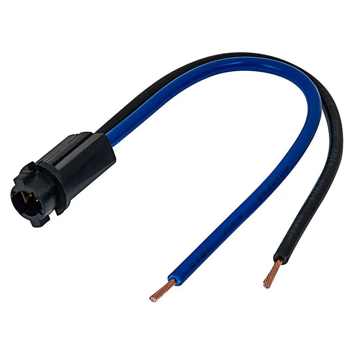

Fast forward a bit, and I decided that maybe throwing in some LEDs would solve it, as they burn brighter. So I ordered some of THESE from Amazon. Which are the #74/2721 bulbs that go into the ashtray, the cigarette lighter, and even behind some of the HVAC/dash board lights.
Picture for the future in case the link is broken for you future peeps.
Unfortunately, it didn't work. The voltage drop or whatever the issue was, wasn't even enough to light the LEDs up. Figuring the problem was the socket, I hopped on over to superbrightLEDs and found a T1-34 base wired socket, which is identical to the sockets our light bulbs plug into. THIS is the link for them, and as with before, here's a picture of what it looks like in case the link breaks in the far future.
First thing I did when I got them, was test fit. I'm pleased to report they fit perfectly in a 1G center console for the ashtray and the cigarette lighter. Better than the OEM ones that are 30 years old now.
On a whim, before I wanted to commit and solder it all together, I hooked the pigtails up just twisting the wires together and hooked them in the same sequence the OEM wiring does. The way it's wired from the factory(I assume at least this was factory) was positive wire goes to the blue wire of the first socket, and black wire runs from the first socket, to the blue wire of the 2nd bulb/socket, then black goes to ground somewhere. Which to me seems really dumb, because if one bulb blows it breaks the circuit so neither works.
Either way, doing this resulted in only one of the LEDs turning on. Not sure why, but I was thankful I didn't solder it all together. So I at this point did some testing and swapping and discovered that they both ignite when you just wire the bulb sockets separately so they have their own power and ground, and aren't chained together. Both sockets share a power wire, and a ground wire, but they're not connected in "sequence". Doing this resulted in a spectacularly bright LED light, and I couldn't be happier.
Word of advice, if you go with this specific brand of socket, and these specific LEDs...the LED bulbs are a SUPER tight fit into that socket. You'll feel like you're breaking the bulb by how much force you have to press them in, but they do eventually snap in with a satisfying click.
The result speaks for itself.
I absolutely could not get the pictures to be not blurry, but you get the idea. The lights are actually usefully bright, not too much at all. When you remove the cigarette lighter, the light illuminates inside the 12v socket nicely. I'm extremely pleased overall, especially for how ridiculously cheap this was to do. And I've got like 8 of the LED bulbs leftover so I can hopefully replace some of the ones that are missing for my HVAC controls, which are the next thing on my to-fix list.
It's the little stuff, man. Very pleased.

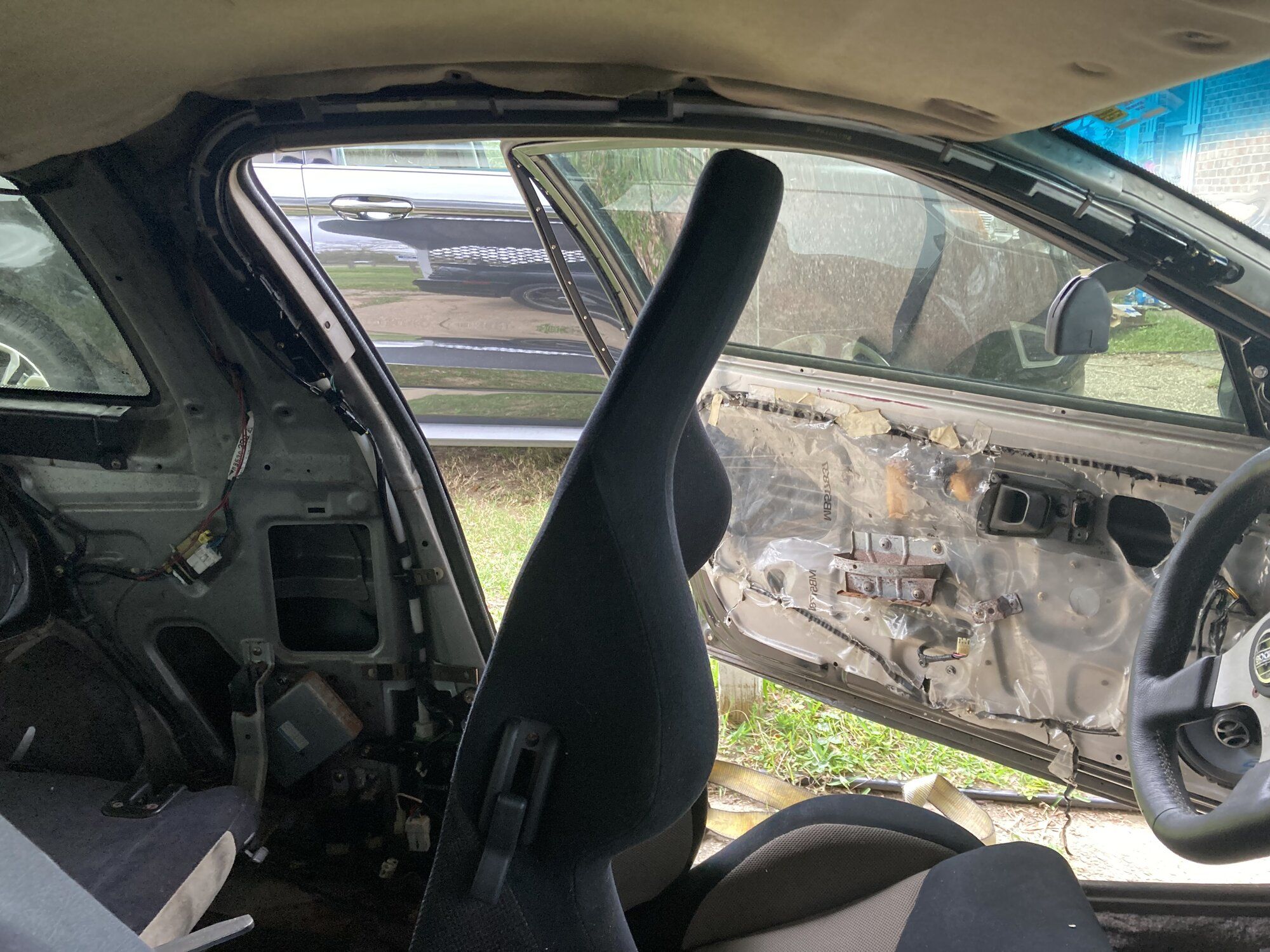

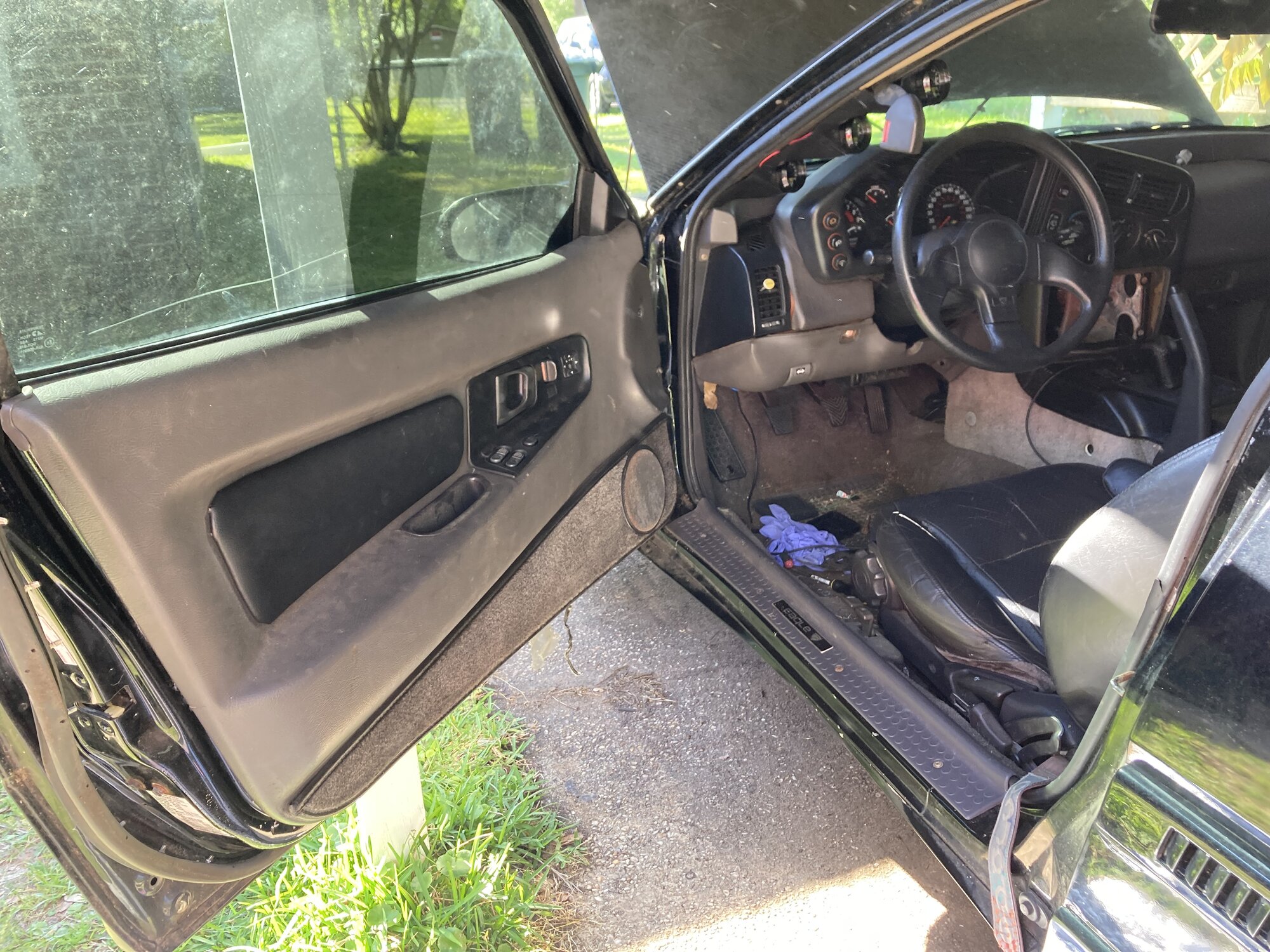

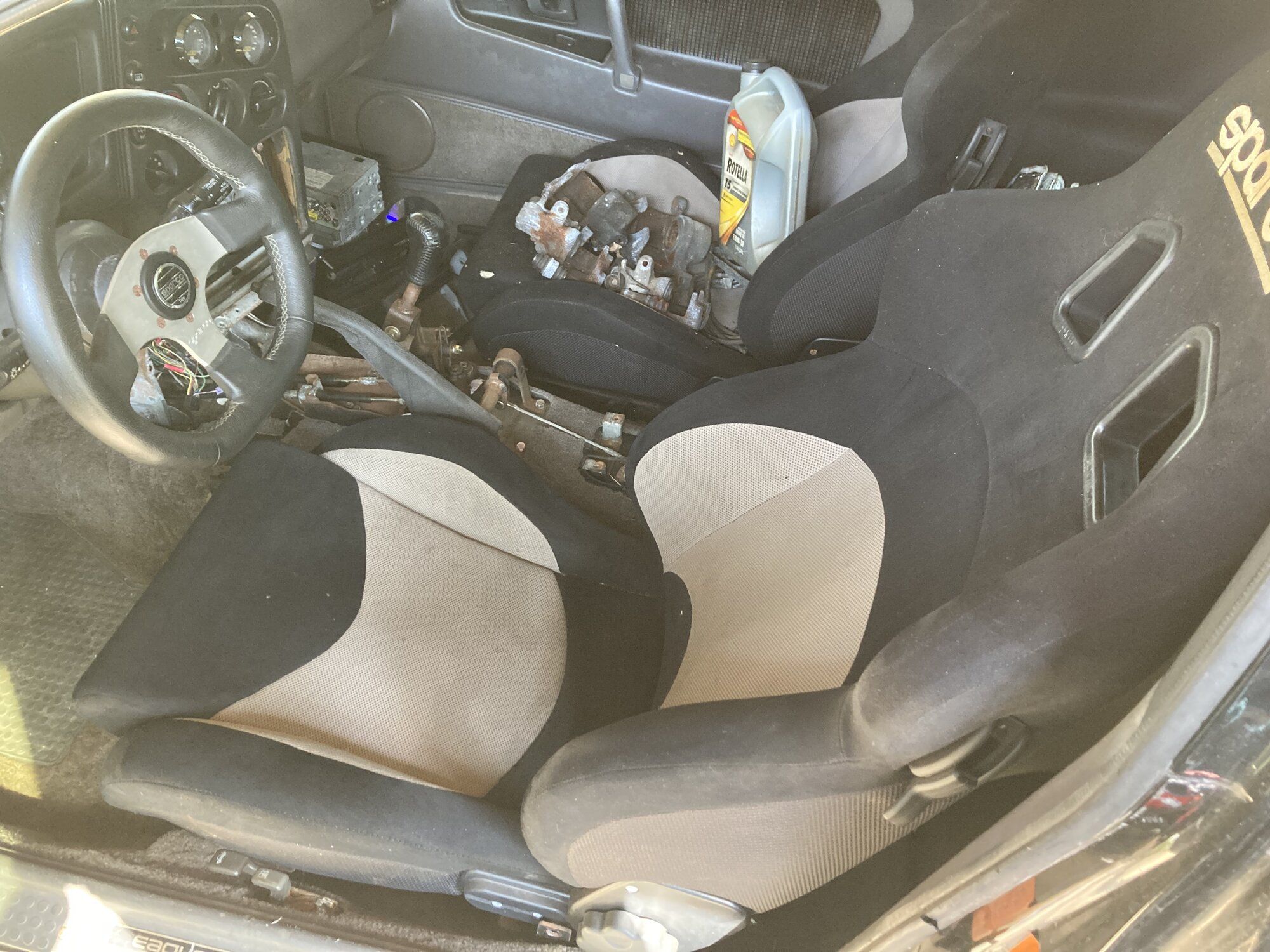

Just a little throwback reminder of where this cars interior was when I first got it.
Terrible seats, terrible wheel, gauges just screwed in wherever they would fit, no driver's side seat belt, "harnesses" bolted directly 90* to the floor of the car, missing panels, no center console, no radio installed. No door panels. Lol.
Fast forward to now
Radio, creature comforts, full black leather interior. Man. Two years came and went by fast. Thanks everyone for making it possible and sticking with me!
