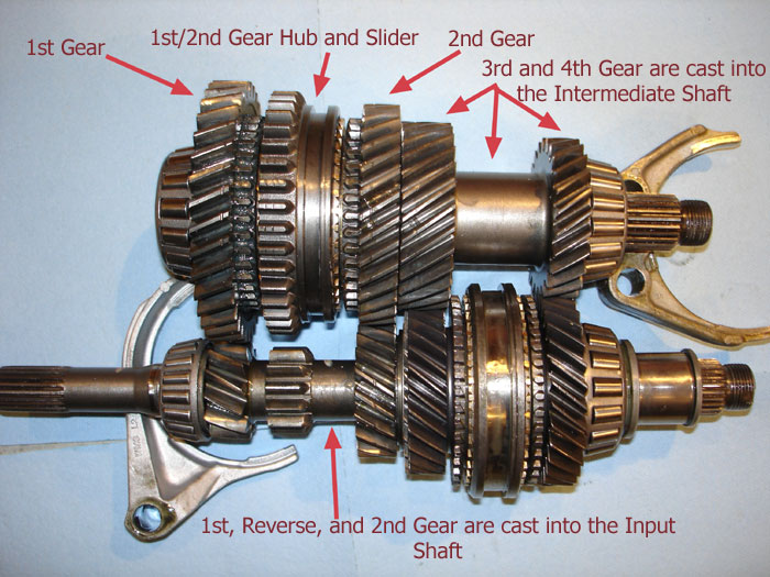

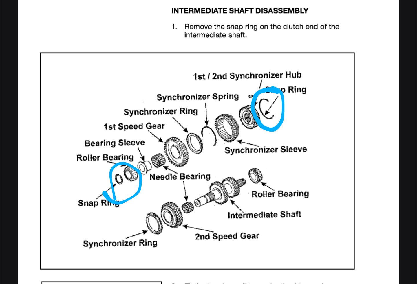

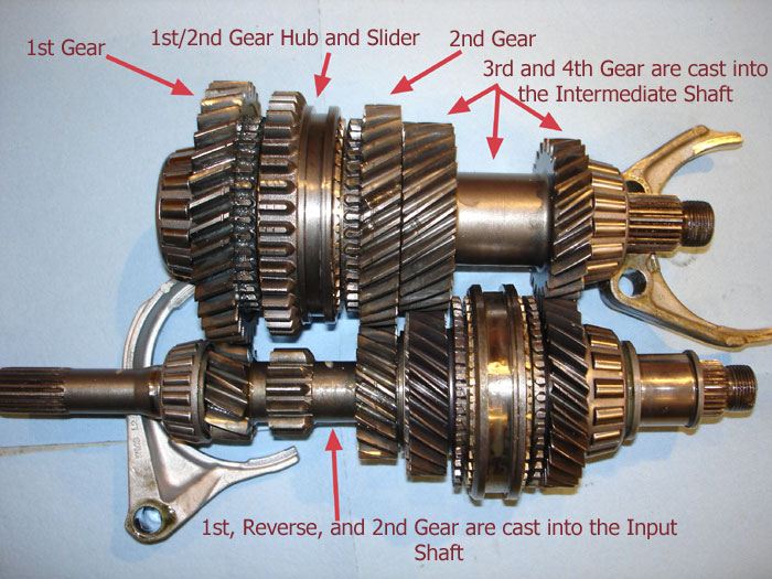

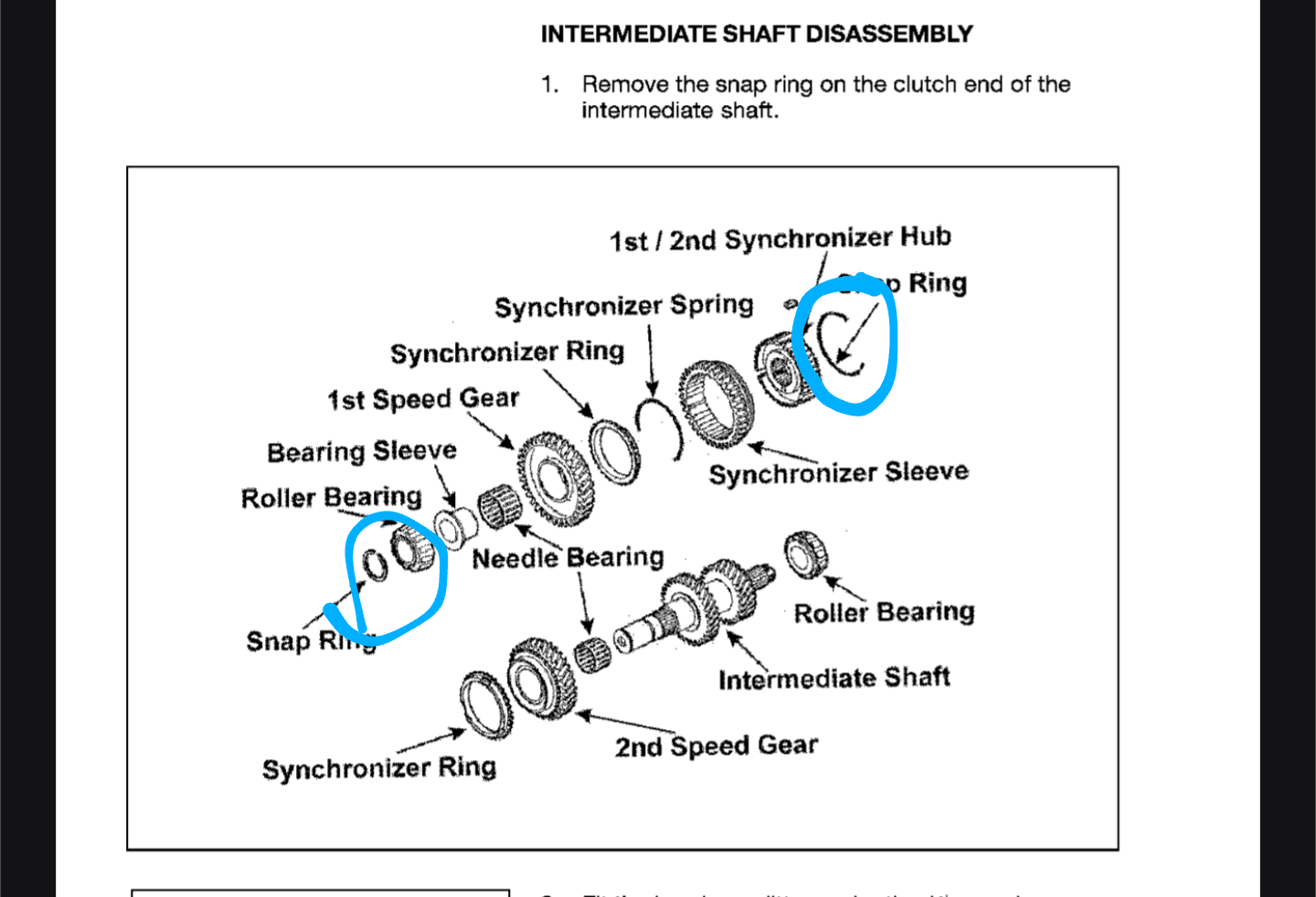

The intermediate shaft is pretty easy. One snap ring, and you can literally press off everything from the cast 3rd gear down in one go. I think you could use a bearing puller for that one?
Don't mind the blue circles. That picture is just meant to show the exploded view of the intermediate shaft.

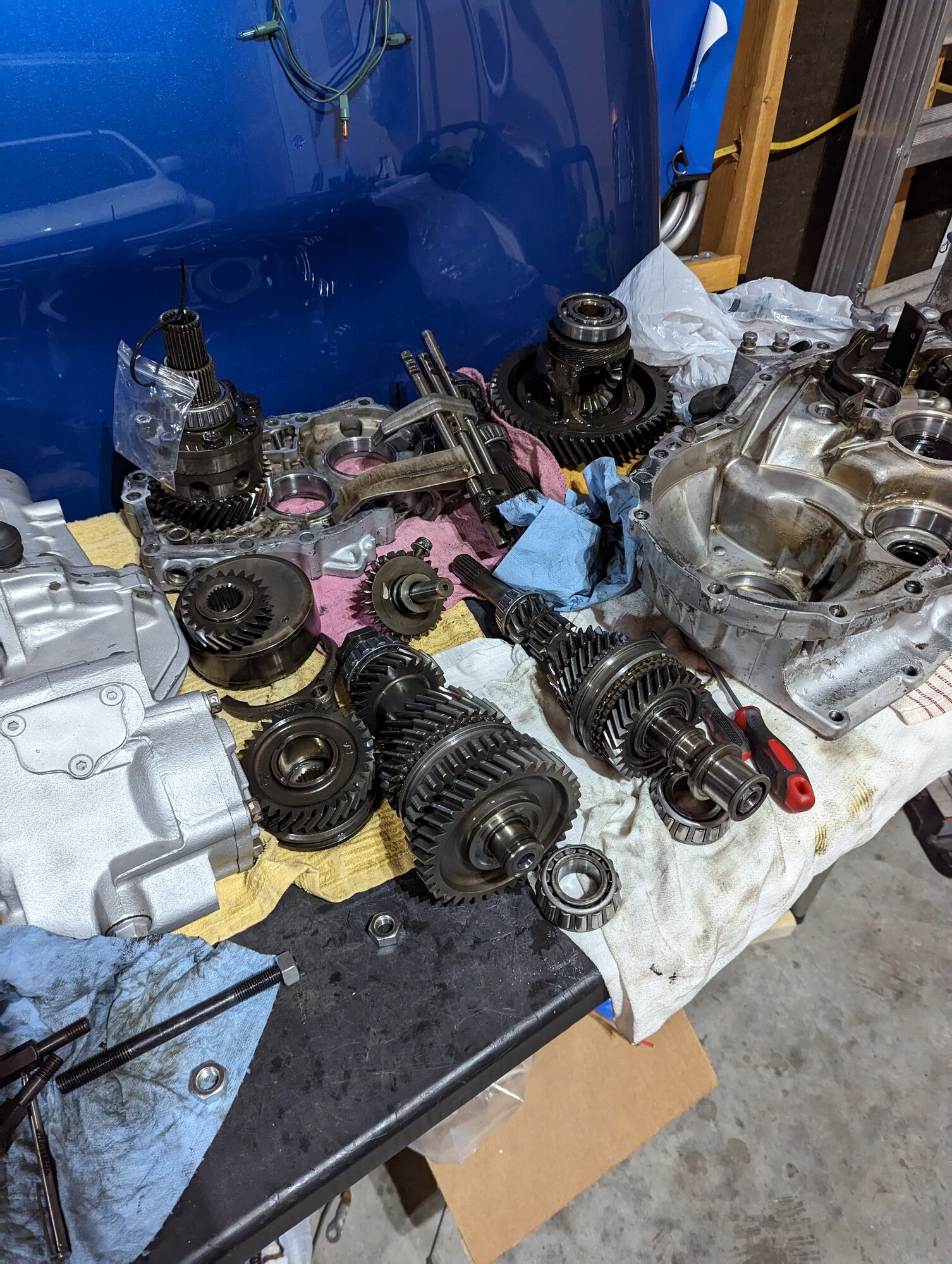

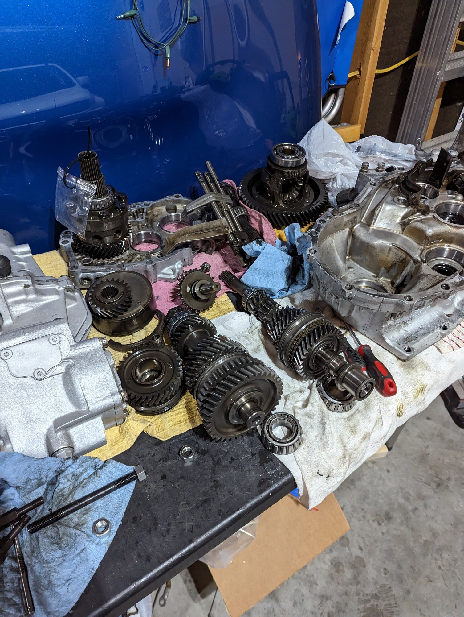

More good news: I decided to pull the trigger on a rebuild kit of sorts for my transmission. I'm not gonna go crazy, and I have a spare...I just wanna get my feet wet and experience taking it apart/assembling it. I'll post pictures as I go, but for now I'm just gonna do 1-2, since 3/4/5/R are all fine even at WOT/max shifting speed. 1st has always been iffy and 2nd is unhappy as well. So. Yeah.
I didn't get a new slider and hub, because I'm just gonna see/look at it when I have it apart. If it needs a slider/hub, then I'll just reassemble it with the new parts I have, and do a full rebuild on the spare transmission with all the bells and whistles. I went for cost vs just doing the whole thing for now. If it goes good, I'm 100% gonna do a full/crazy build on my spare trans that includes billet forks, double synchro first and 2nds, 4 spider center diff w/ torrington bearings, and billet rail ends. For now, I'd just like to limit the damage and get it shifting into 1st and 2nd again.
I'm excited for this. I'll probably take a week off from work when I do it, so I don't need to just rush and crunch time it all back together.
