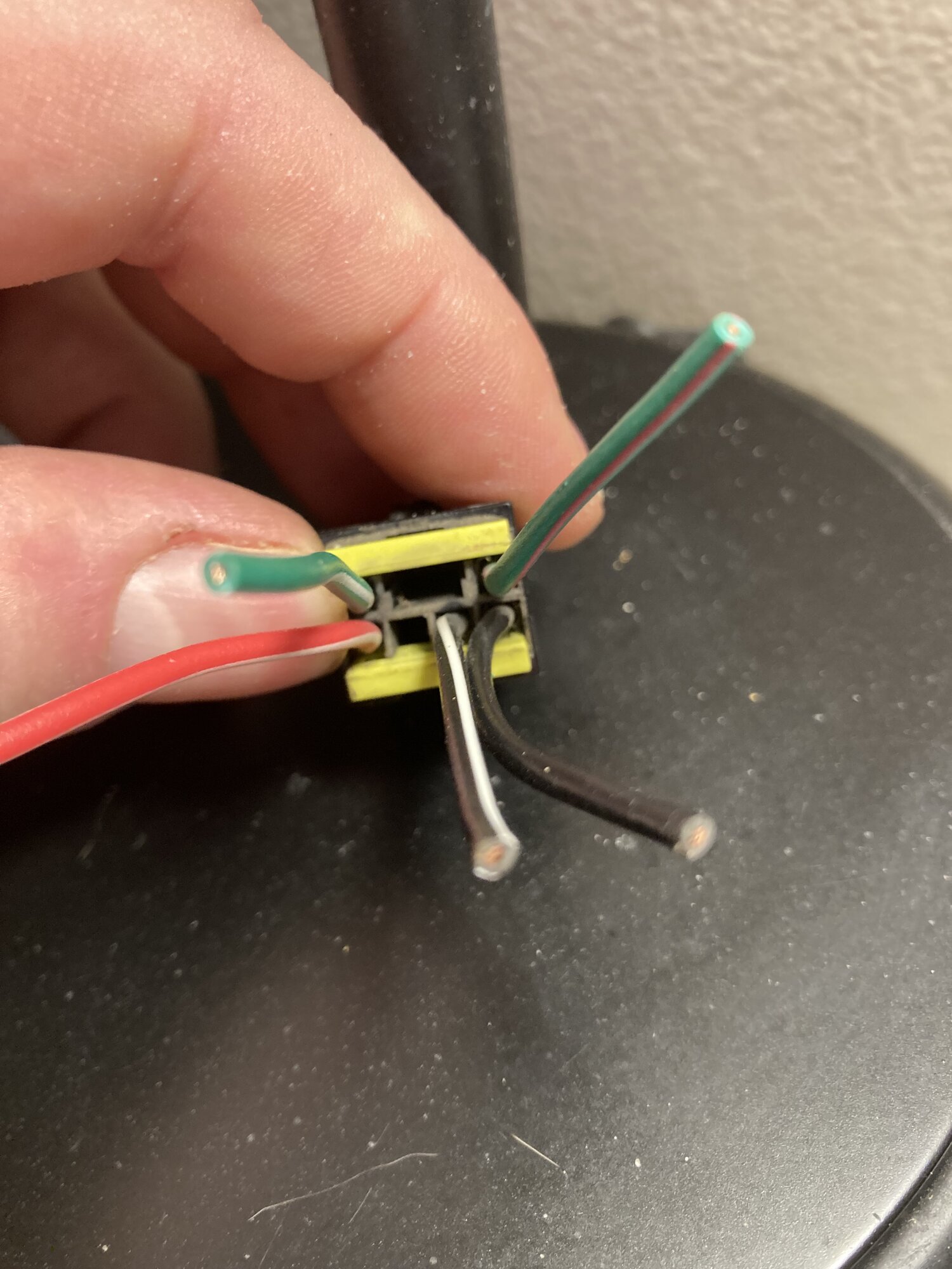

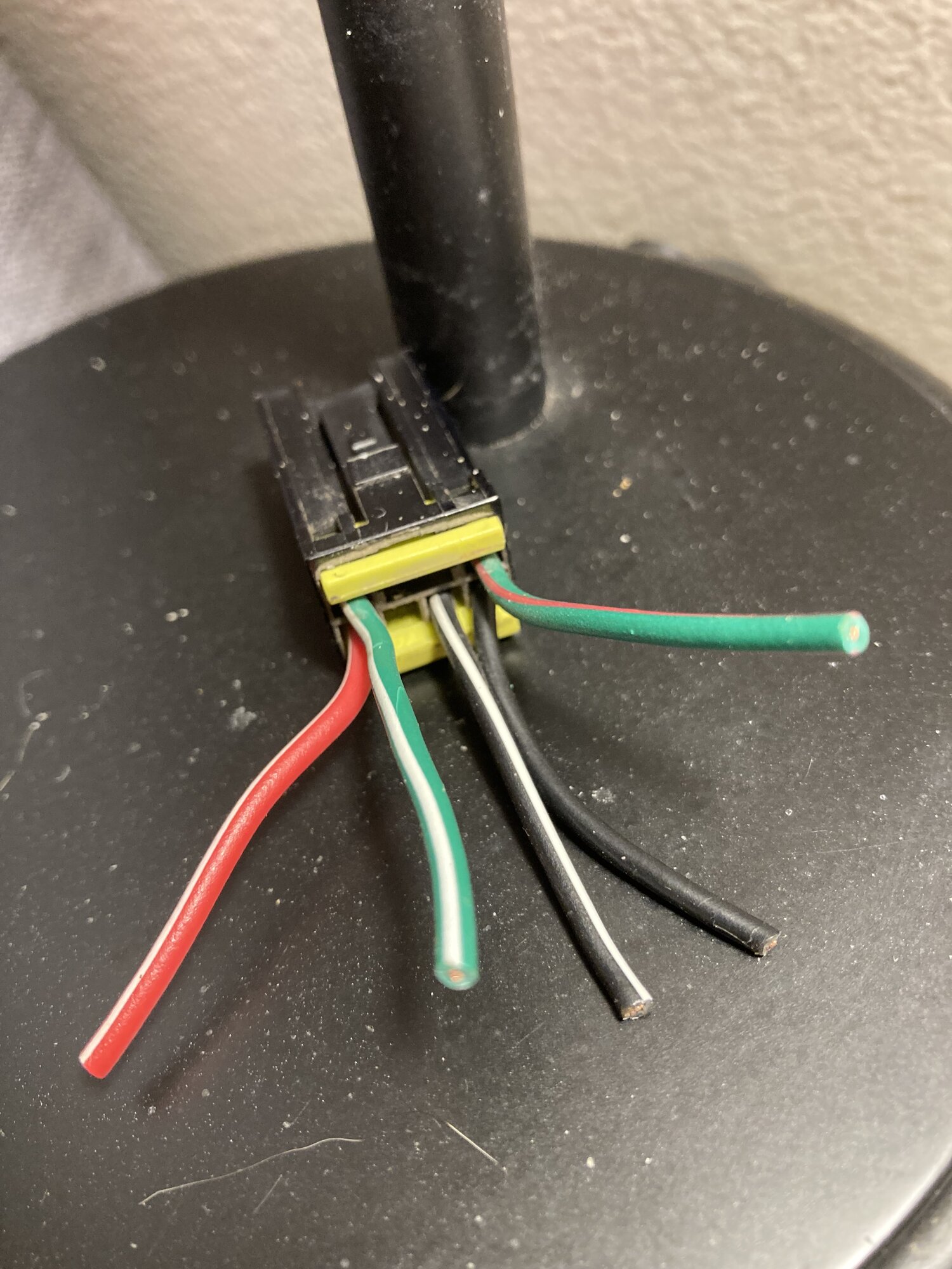

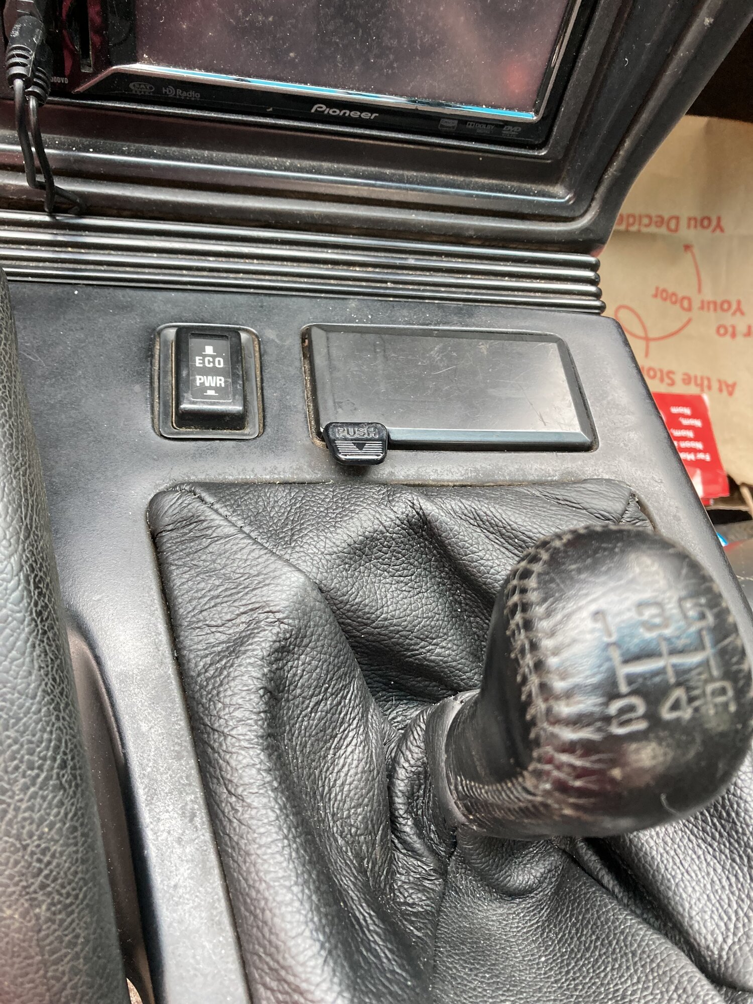

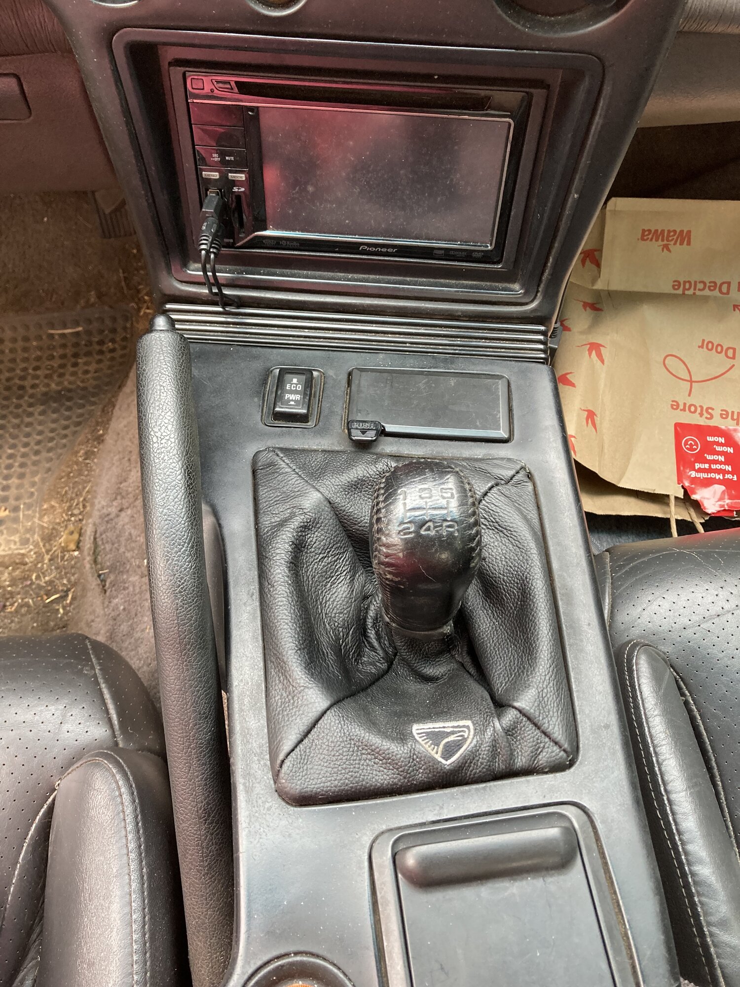

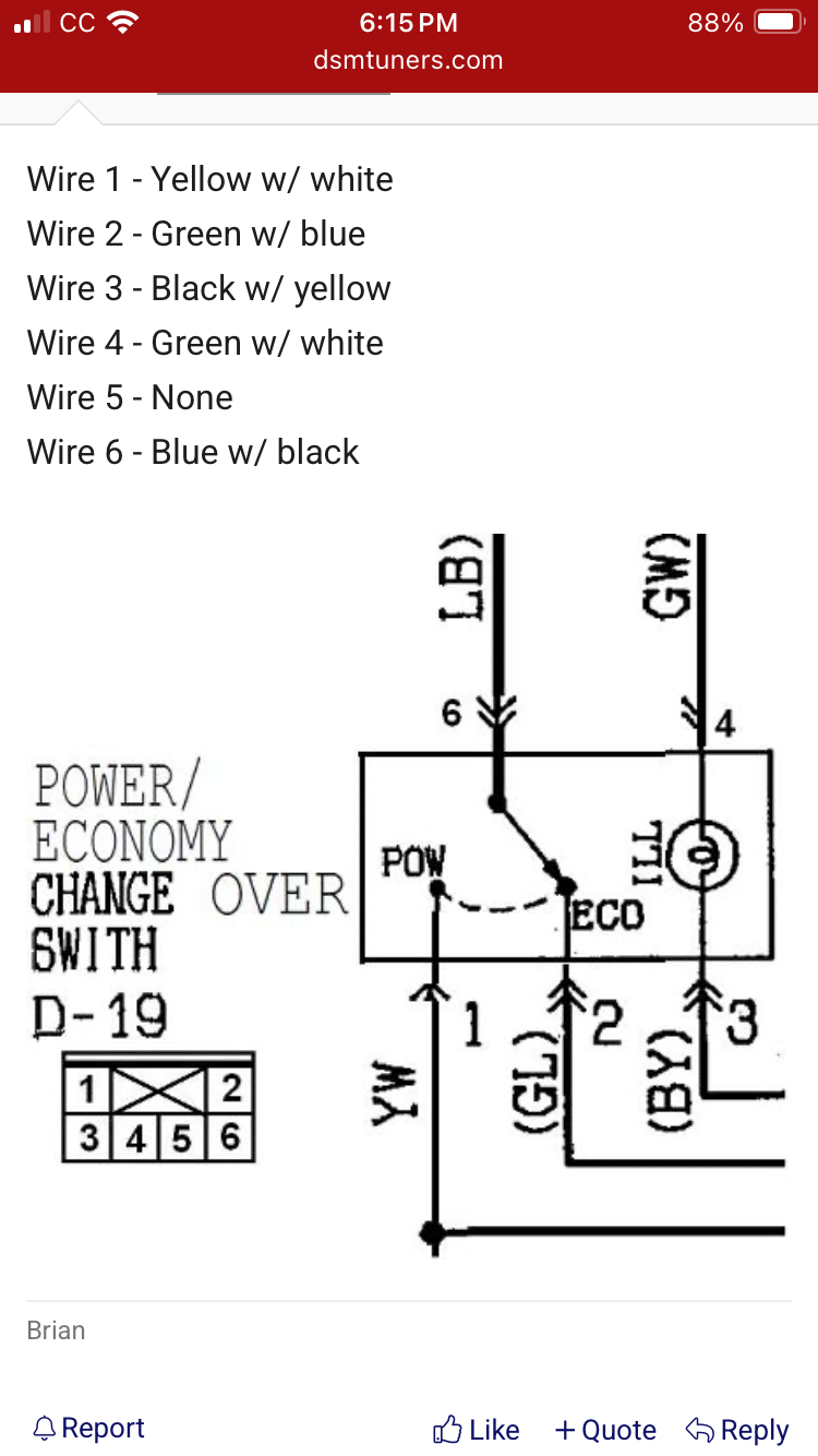

Well, while I wait for my trans stuff to come in, I did a neat little side project. I want to utilize my scramble boost feature in my AEM TruBoostX, but I really don't want to use a toggle switch, and I'm not gonna drill my stock steering wheel for a button. Although it was tempting. I was kind of stuck, unsure what to do. Then...eureka, I remembered I have used the Eco/Power switch as a "toggle switch" before with great success in my old Auto 1G(kiggly shifter mod, I used the Eco/Power for OD) so I figured this would be a great way to add a sneaky switch to use that good old scramble boost feature.
I used this helpful diagram provided in another thread by @steve the guru.
Only caveat, is it's for a 1GB. On my 1GA the wire colors were different, but locations/functions were identical. On a 1GA the wire colors are:
Wire # 1 - Green w/ Red stripe
Wire #2 - Green w/ White stripe
Wire #3 - Solid Black
Wire #4 - Black w/ White Stripe
#5 - Unused
Wire #6 - Red w/ white
Pictures for posterity's sake.
Anyway, wiring was super easy. I did have to cut off the oem connector because I couldn't find the female connector to match it, so instead I used some good quality spade terminals and just crimped them on and made it detachable if you remove the center console cover.
After that, it was a super duper simple reassembly since it's all OEM.
I am absolutely stoked with how it works.
In case you're curious, whatever you want "toggled" just hook one side up to the red/white wire, and the other side to the Green/Red wire. When the button is clicked down it's "on". When it's left in the "eco" position or out, then it's "off". Use this for anything you would a toggle switch. OD for kiggly shifter mod, Nitrous, whatever. :) It's VERY easy to reach from the shifter, and if you only want it to be "momentary" and not stay clicked down, it's easy to disassemble the switch and remove the "stop" for it, so it won't click down.
Anyway, I love it. If you didn't really know DSMs, you'd never think twice about the switch. Plus it's an enjoyable play on words. Switch off it's "eco" or low boost". When you click down for "power", it's scramble boost and 30+lbs. 😈
Hope this helps someone in the future!
