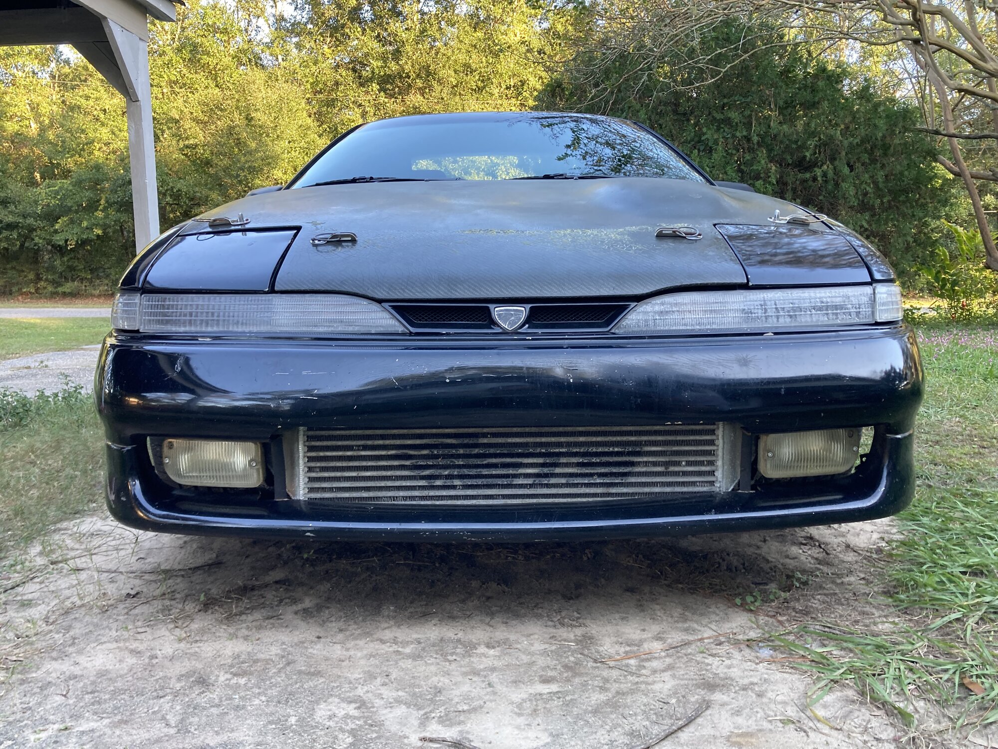

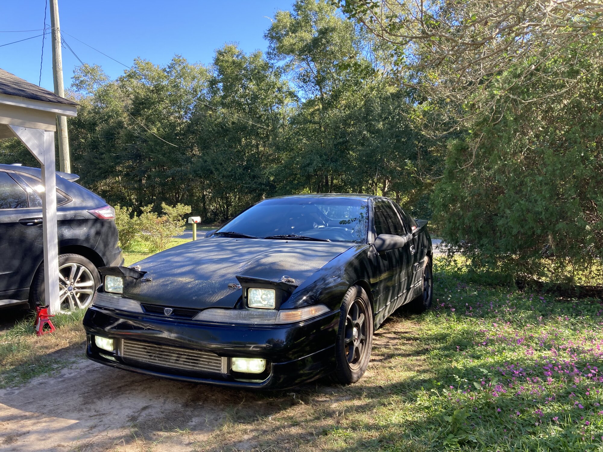

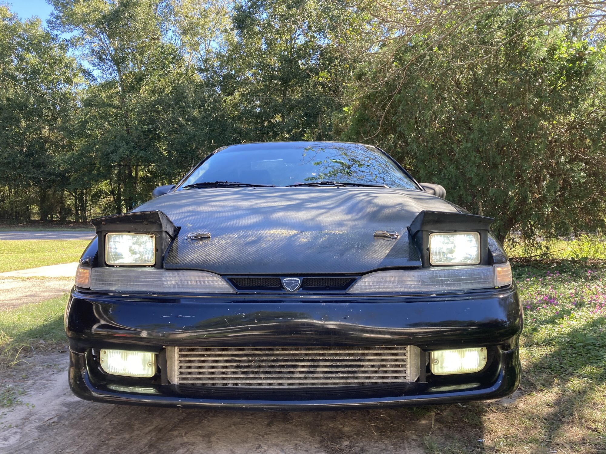

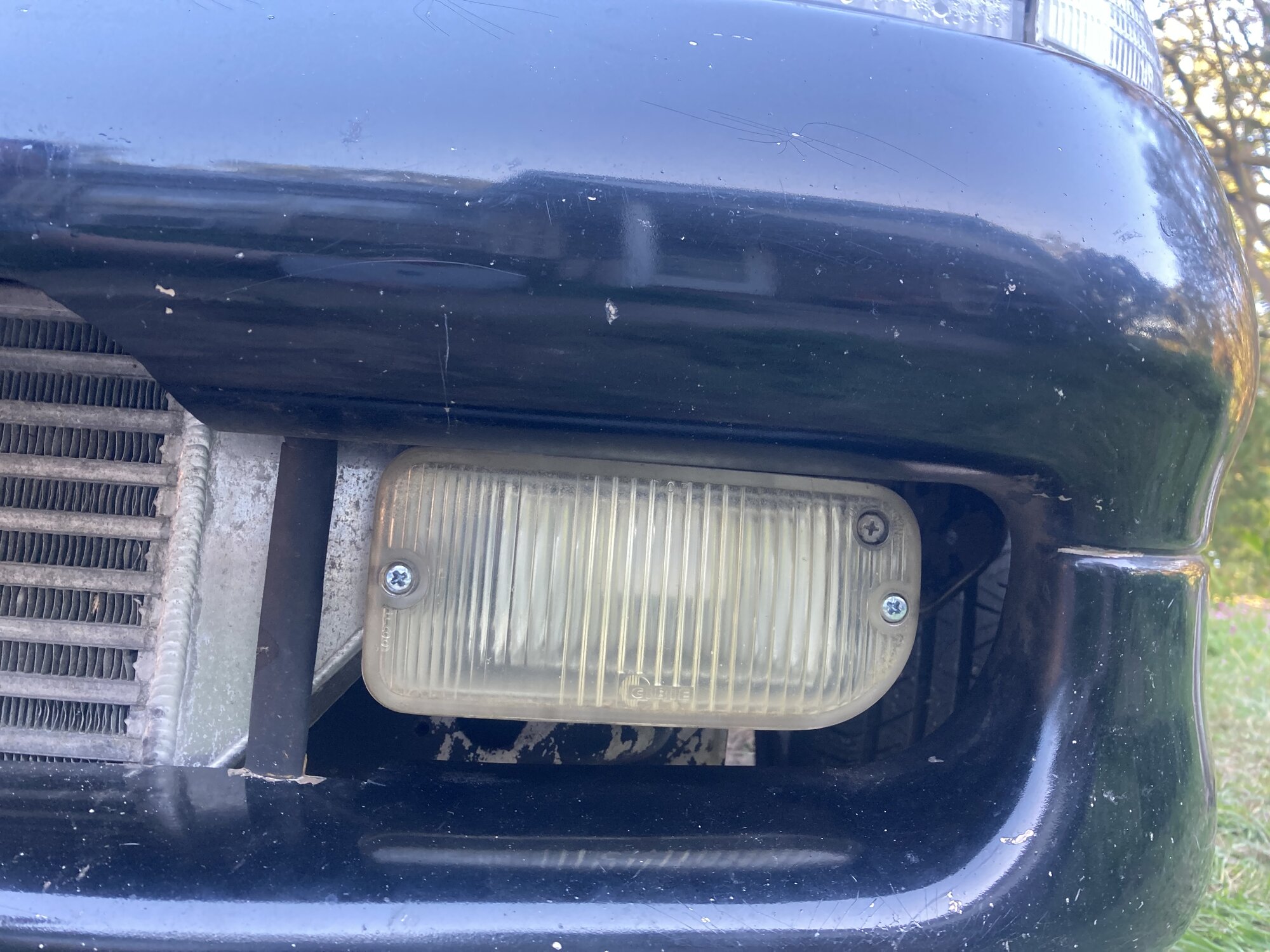

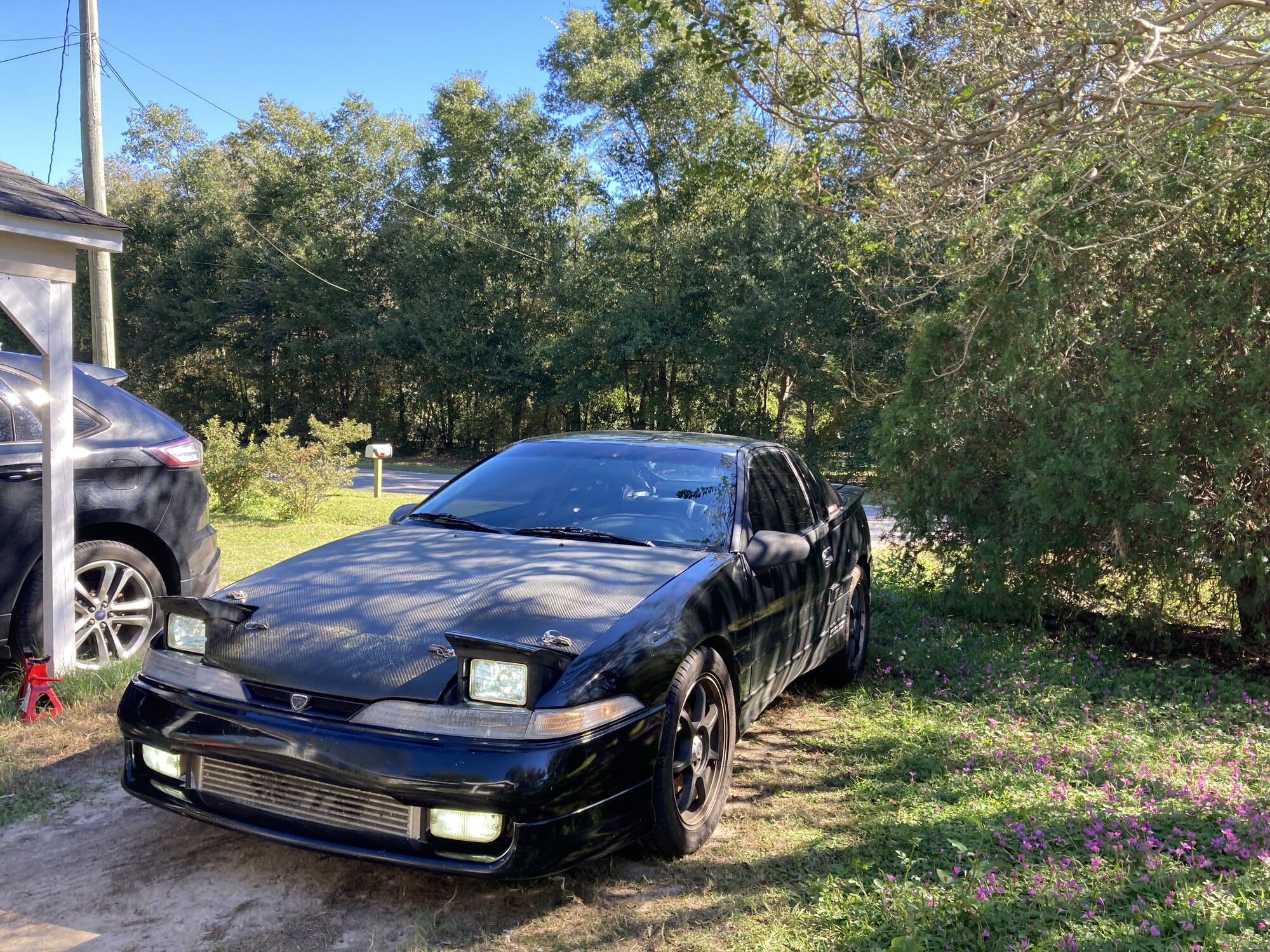

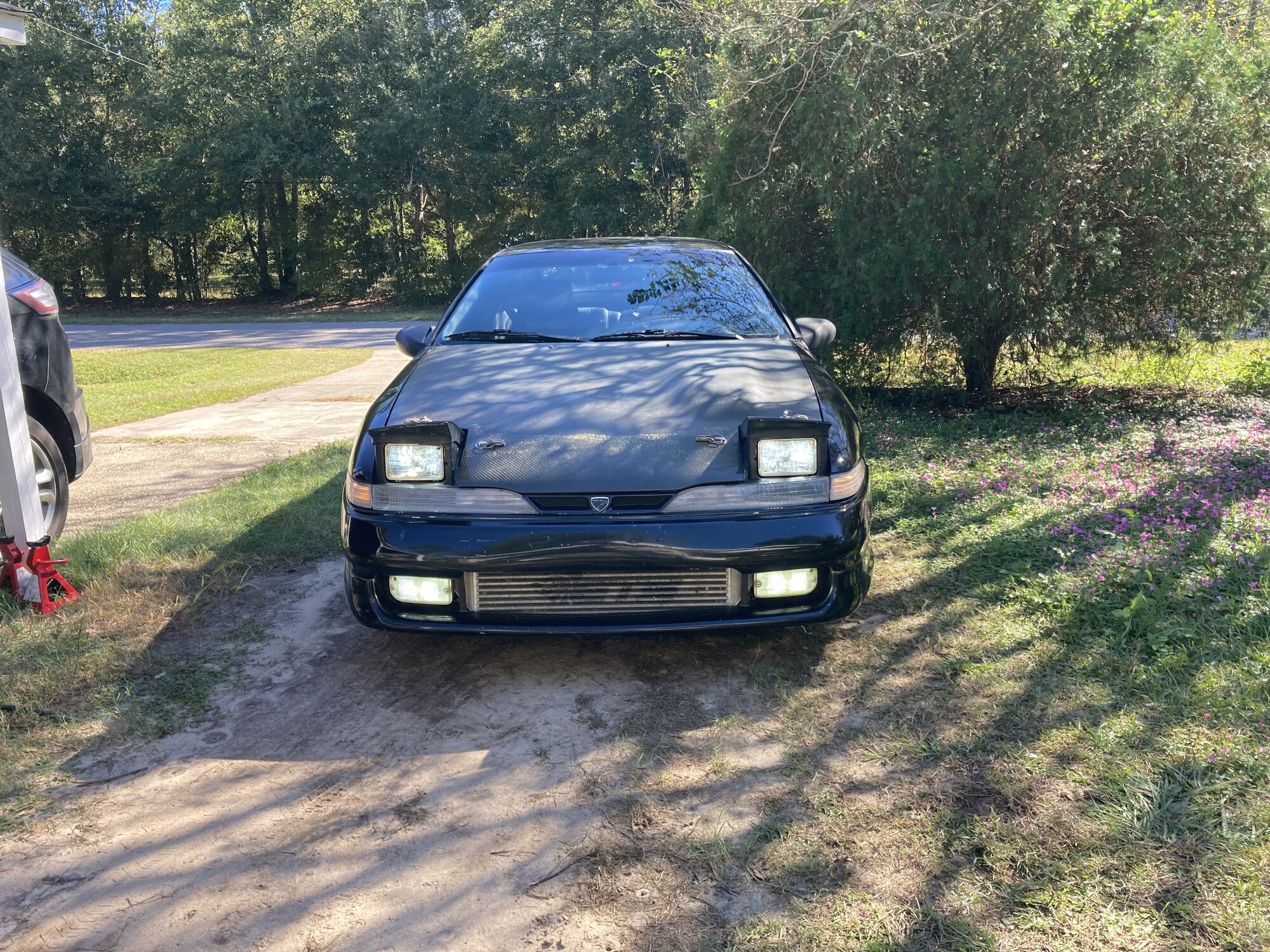

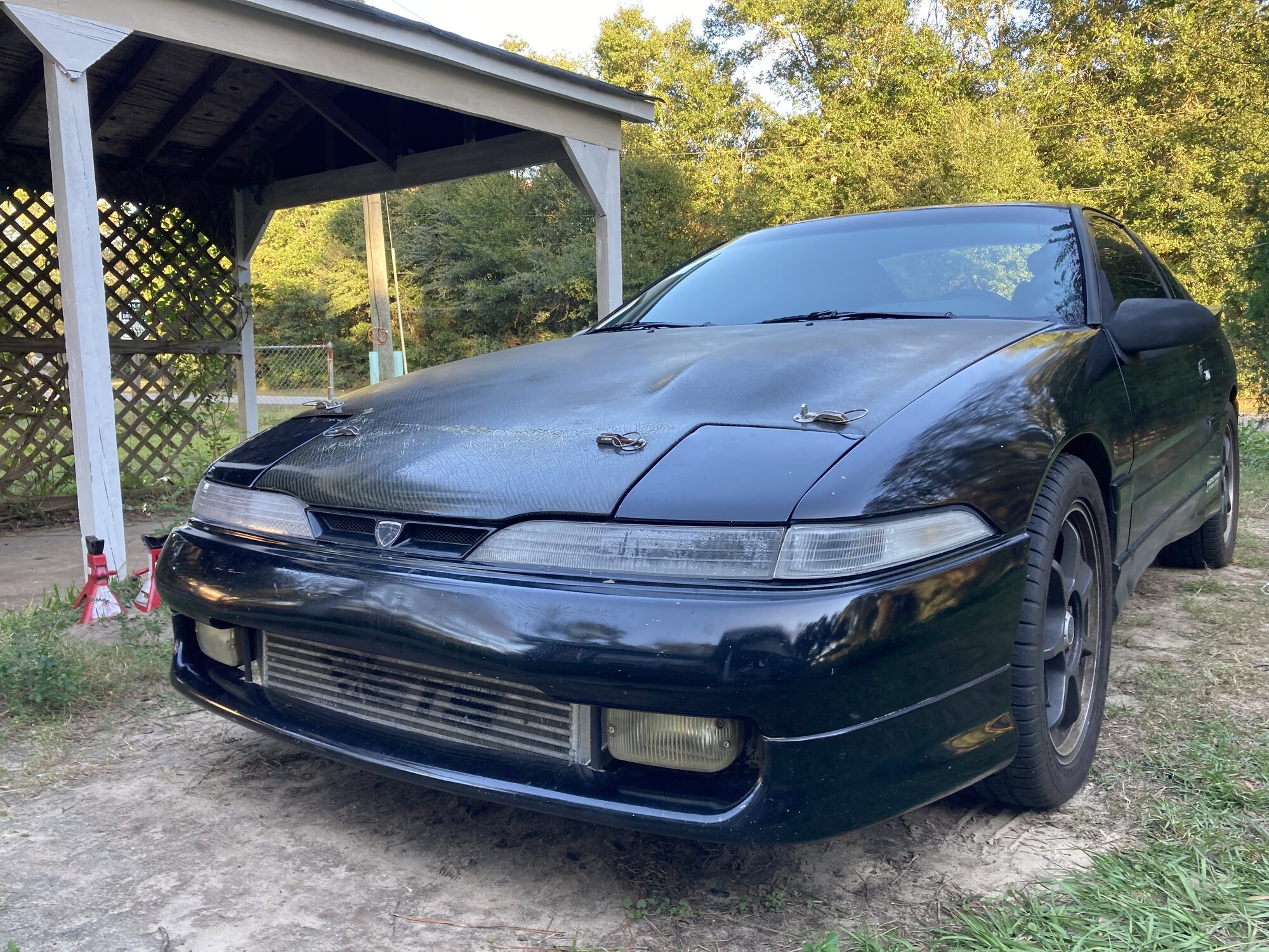

Ordered some supercheap LED fog lights and tossed them in today. Install was super easy, just snipped off the OEM bullet connector, and crimped/adhesive heat-shrinked on a female spade terminal in its place. Done deal-skis. These look so much better and match my headlights perfectly. No extra wiring or modification required.
Also: I couldn't just pick two pictures so I just uploaded all four. :p Deal with it. 😎
Still need to polish the lenses, but that's not gonna happen yet. I'm recovering from nearly dying in the hospital from what I THOUGHT was just a headache, so yeah. All my savings went towards some emergency "cut your skull open to relieve pressure" surgery. At least my fogs look cool though!

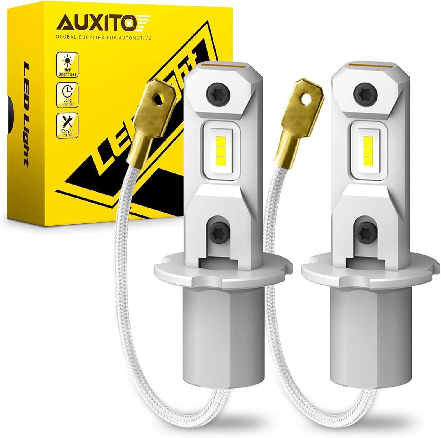

What LED bulb number works in the 1ga foglight housings?
Just the regular H3 LED bulbs. I’ll link the ones I bought from Amazon here. The OEM ones have a bullet connector so you’ll have to cut/splice a spade terminal on but that’s it. Easy peasy. If you buy those ones, install them opposite of the OEM bulb. The OEM bulb has a little arm that doubles as the "ground" for the bulb, and the OEM bulbs make a + sign. What you want to do with these bulbs for the widest split/best brightness is install them so it's even with the "arm" (looks like the open end of a safety pin) making it an I shape instead of a +. You'll see what I mean.
Including picture for posterity's sake for one day when the linked pictures don't work anymore.
I will say, I'm really impressed with these bulbs. The spade terminal on the bulbs had clear adhesive heat-shrink done over it so it's completely weather sealed.

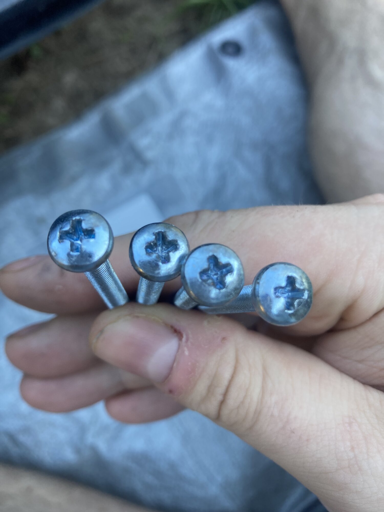

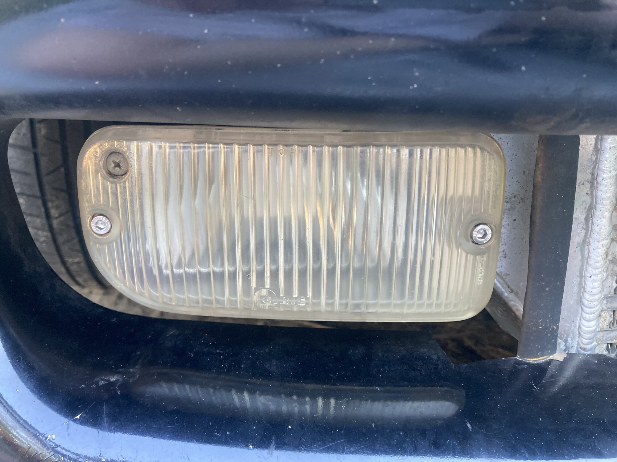

Quality of life improvements just now. This might not seem like a big deal now, but I have read multiple horror stories about these stock phillips head bolts for the fog light. Just for example, these are BRAND NEW from Lowes, stainless steel phillips head bolts using a screw driver that is properly fitted to the screw head. I have only touched a screwdriver to these bolts like..four times individually. By hand. Gently.
Might be hard to tell, but they're already knurling/looking sus. With Florida salt and water, I was terrified this would strip out like almost every other example I've seen, so looking out for future me, I ordered some Stainless steel quality Allen Head bolts of the same length/thread pitch. The result was extremely pleasing. It cranked down the light more secure, and I really don't think I'll strip these AS EASILY as phillips heads would be. I did use a ratchet, but basically put zero torque on these. Not only does it work great, and can be removed easier, but they also look better...at least to me.
Before
After!
God I love stainless allen head hardware for certain things. They fit PERFECTLY as you can see.
Glamour shots!
Very pleased with this. Also! I'm gonna make an offer. I have like, 5 more sets of these. If you want some, pay for the shipping whatever it may be and you can have a set for your foglights too.
