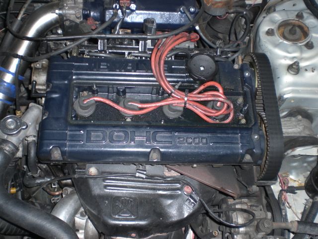

I redid my catch my catch can setup again. I'm done with the sealed setup and will be doing an open system from now on. The MCR valve cover baffle system was horrible. I went to TX2K and came back to my car to notice oil pooled up under the old catch can. Long story short the MCR baffle lets oil gush out of the 10an ports into the catch. The MCR guy was of course not helpful and blamed by engine even though my old valve cover didn't let a drop of oil out. I wound up cutting out some oil drains for the baffling system and elevated the new catch can rather than having it in the wheel well. These changes seem to be working.
View attachment 631315View attachment 631316View attachment 631318View attachment 631319View attachment 631326
Just to add my own personal and very limited input, when I ditched the stupid factory “sealed” design and went to a vented set up I never had issues again. My dipstick doesn’t need a spring to hold it down, when I started pushing 30+psi on the fp red the factory set up didn’t like it much. Sure you can run bigger lines to a catch can, but your still pressurizing the $h#! Out of your system with big boost. That pressure is no longer a concern on a vented set up because… it’s vented LOL, my valve cover has no baffle other than a strip of aluminum welded under the breather ports, and after a max of 37psi on a dsm82 and roughly 60-62 lb per/min airflow, I NEVER saw more than a few ounces of oil in the can. Now granted I know I had good ring compression, so your amount of blow by will effect this, but I personally think stinking to sealed set up on a highly modified dsm is kind of:banghead:
For different reasons I wanted the sealed setup because it would make the engine more efficient blah blah but it just isn't worth it in the end. I had the same baffle setup as you with the aluminum strip, and I kid you not there wasn't a drop of oil in my catch can after running my htz76 at 36-37psi for a year. I drop in the MCR vc and it almost drains engine of oil in the 30 minutes of driving...I really wanted the billet cover work so that's why I switched everything up.
