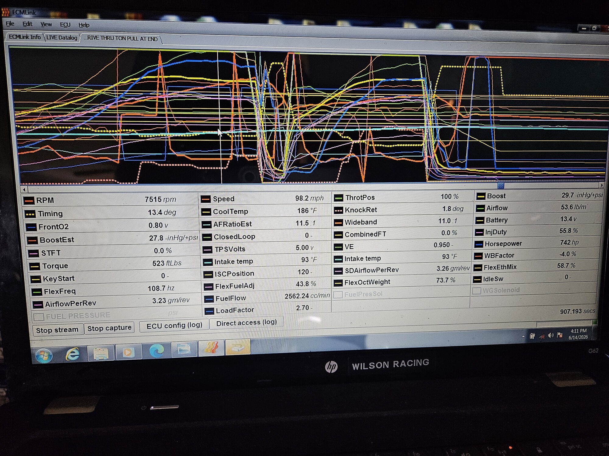

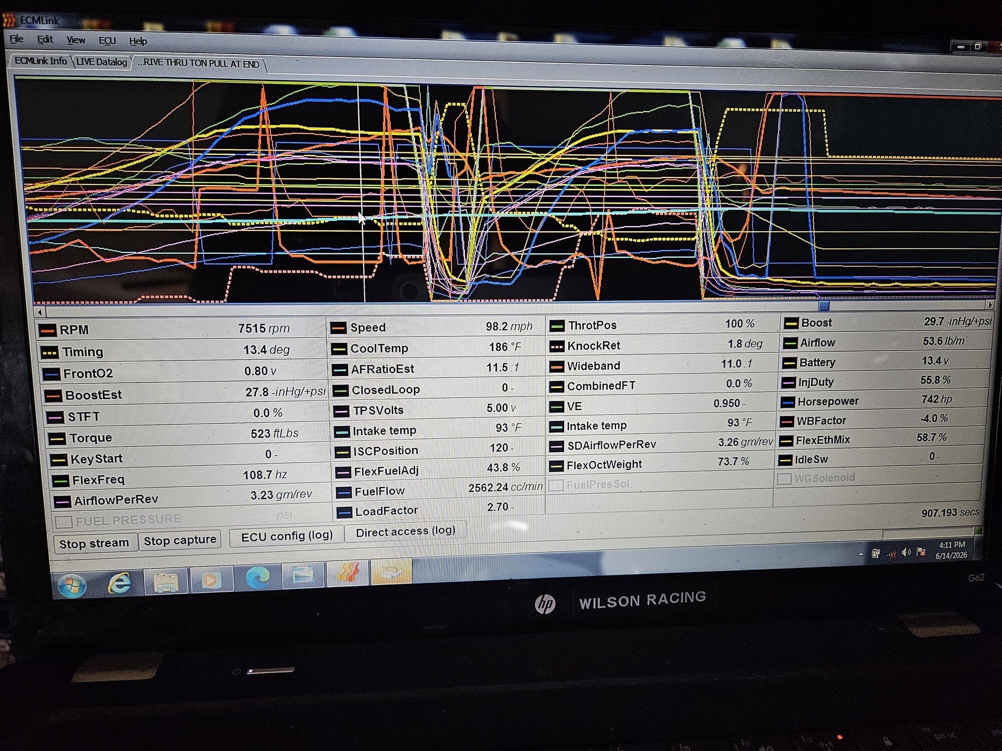

Just a picture of logging the WORLD. I didn't run her hard or under a bunch of boost. I think i WILL turn the boost up tho, it'll take it.😎

7.5k Rpm with 30psi at WOT and 13.4° of timing and less than 2° of knock !!!!!!
Wow 😮 you don’t need boost just more mixture and you can slightly up the timing yielding significantly more - power train exploding power LOL.
Very nice - thanks for sharing
Only 55% injector duty , curious what size they are and if you have any comparison logs of the injector duty values with and without injection, like how much reduction in duty cycle are you getting per injection ?

I think i did the tune on this... if it was my work its still not perfect.

Marty it looks like you went another 500 rpm or so farther before shifting, and the boost held up during that time, and the airflow line goes off scale so we can't see it. What did the airflow get up to in there?
The knock that you are wanting to get rid of, do you think it would still knock about the same if your eth% was up to more like 70 or 80%?
I might have missed something back a ways, because I thought you were running straight E85. Are you running 55%-60% now, trying to avoid the ethanol gremlins?
I havent seen a link long in over a year, haltech is definitley different its i guess ill get used to it once its running. Good numbers

It is still the tune we were working with @enriquez2000 👍💯 and thank you, it's not bad at all. The car gets outta town once the turbo lights. 😊
That's pretty good airflow for 30 psi. Definitely needs more boost once that meth is ready.

FIC 2150s and the airflow was 56.2 at 7900 with 29.5 lbs of boost 👍
The E I am getting is not 80% yet. I guess maybe the next load will be summer blend. 🤞
I looked at an older log, and it was 58-60 airflow. I really don't think my meth purged all the air out of the line. The next drive, I'll log again. I need a new slave cylinder. It is leaking horribly, but its the original slave so its overdue. It barely got me home.
