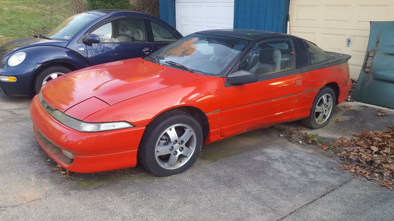

Now, enter this piece of shit that I made the mistake of buying:

The reason why I'm calling the car a POS is because it basically was when I bought it. I was very ignorant when I purchased the car in 08/2015. I hadn't touched a DSM in ten years so in my mind all the modifications the car had were great. However, they were nice mods 10 years ago, not in 2016. And the problems the car had I arrogantly brushed aside as silly tuning issues. I used to know a lot about DSMs....10 years ago. But I forgot all that stuff and I didn't take the buying process seriously. For example, 18g turbo, fmic (very cheap pos ebay), gm maf setup, cheap bc 272 cams, cheap ebay bov, crappy 90 transmission, cheap racing seats, poorly made press-bent exhaust system. SUPPOSEDLY it had a fully built 1000hp-capable engine (eyes roll-more on this later). The ONLY good thing about this car is it came with dsmlink v3. That's it.
