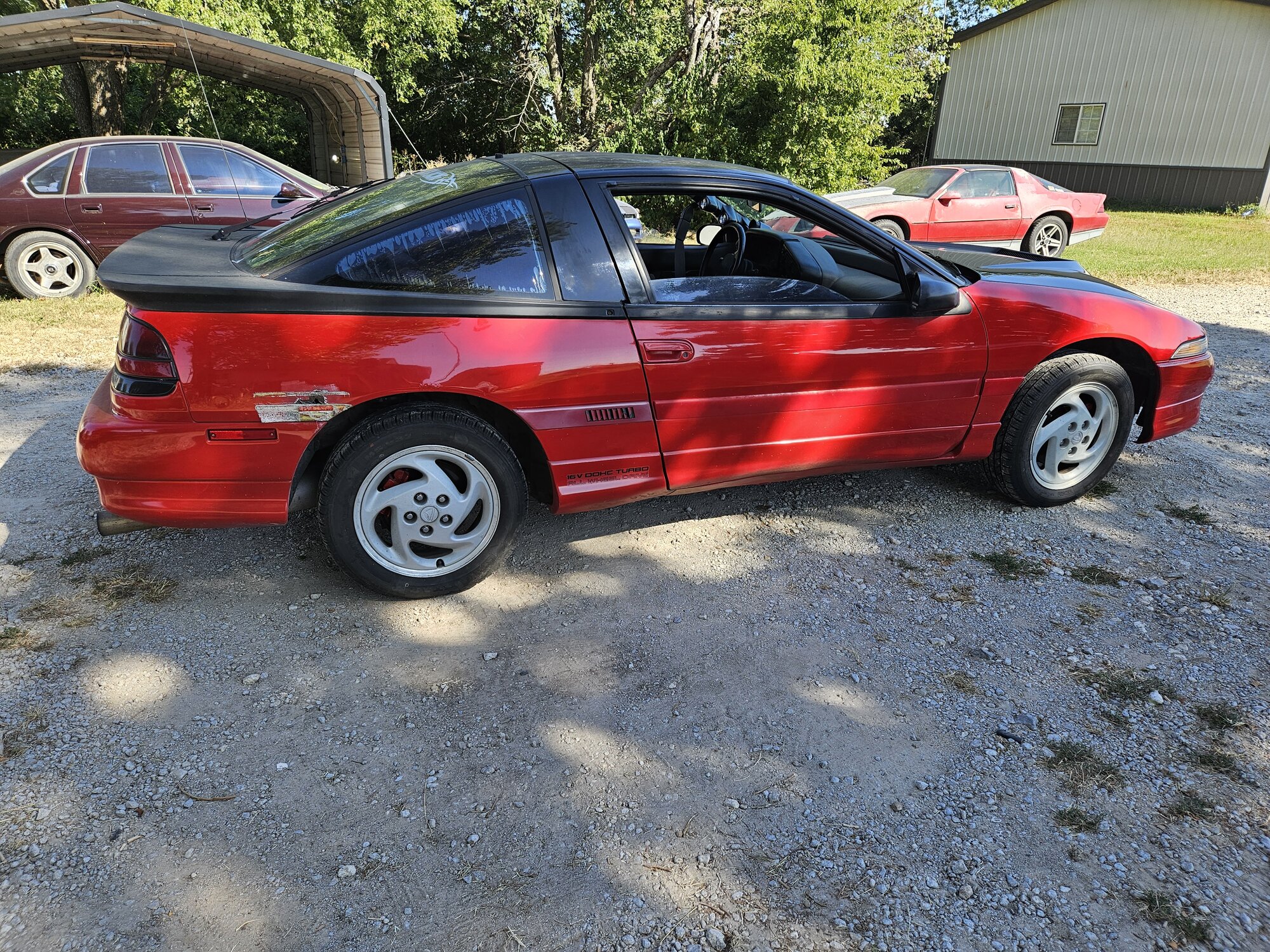

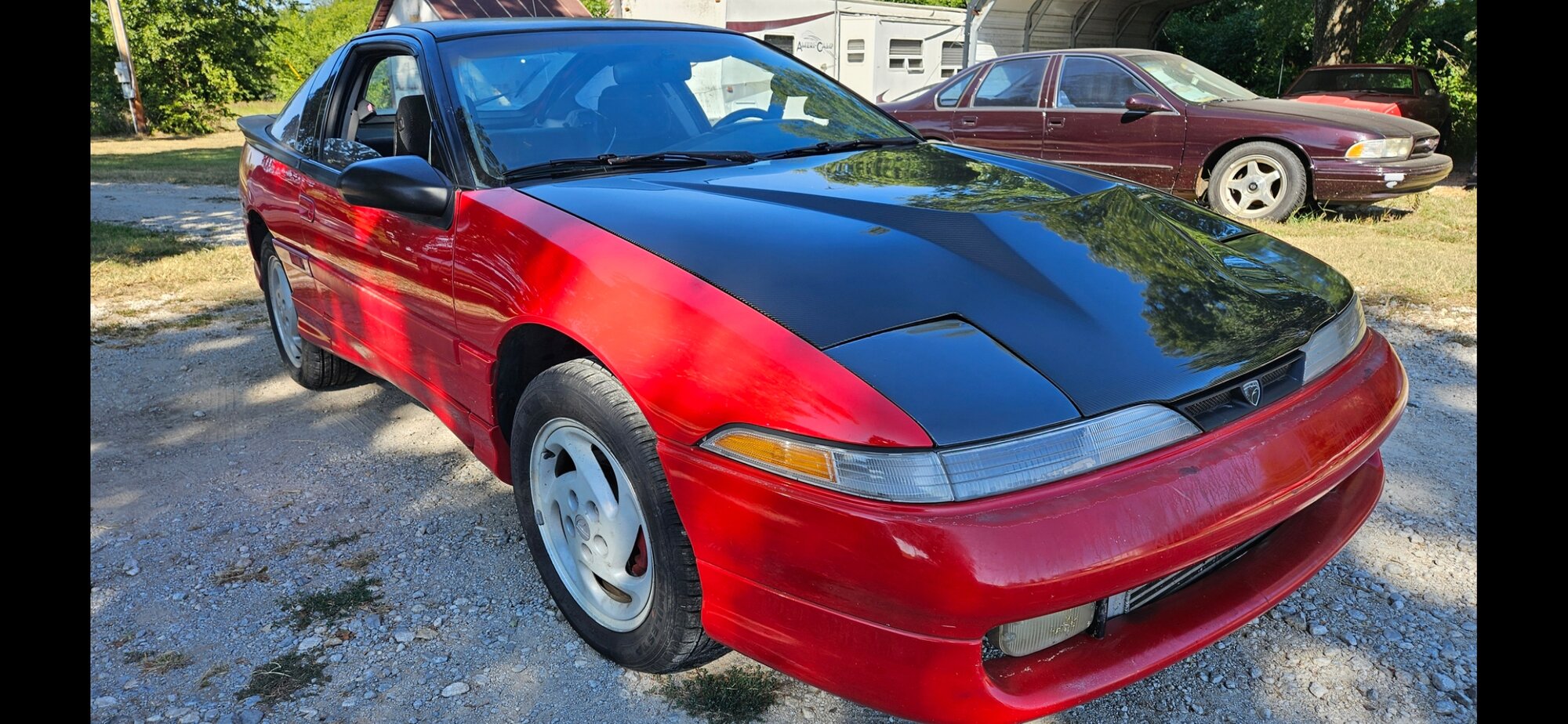

1990 Eagle Talon TSI trying to save her life from the previous owner and its alot of work but a nice base car. My youngest son, who also races this car has nicknamed her "The Red Baron".

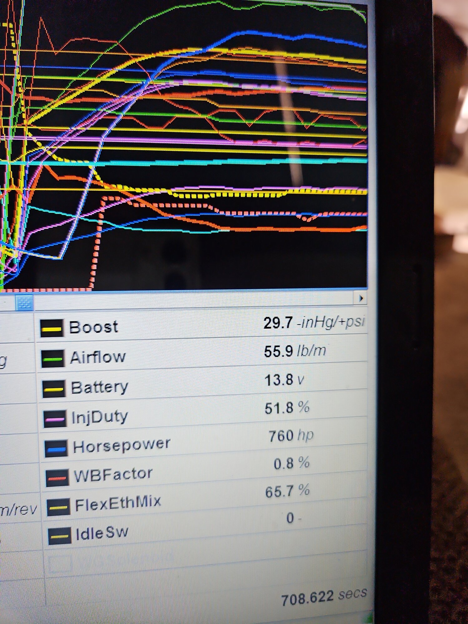

There is a car show next weekend so I am taking the Talon (the only car like it) to the show and put her in the "Special Interest" class since that is about all she fits into. The Mopar class would just laugh, but if they'd like to put their money where their mouth is, I'm game! She is running pretty dam good and flowing almost (55.9) 60 lbs/min. It is an outrageous car to try and drive and keep straight, I can certainly testify to that! It felt over 500hp and wheel spin was a bummer.

Congratulations on retirement marty!!!! 🥳. Also. 760 HP 🤯😎 Wow. that thing runs like a damn rocket I know.
Yes, when it lights, it's a HANDFULL.
I never really believe that number but as far as air flow, it is doing 500+ at only 29lbs of boost. :thumb:

That's pretty good airflow Marty. When I had my car on the dyno(2019), I made 572 awhp with 57 lbs/min airflow. This was at 34psi but with a Cyclone intake mani. For reference and possible future goal for yourself, I made 608 awhp with 62 lbs/min. Took me 38psi with that setup.
And I will push this compressor to 40lbs as I get the motor broken in and line out the tune more. It really is quite a monster to drive at WOT at just 30. :oops:
