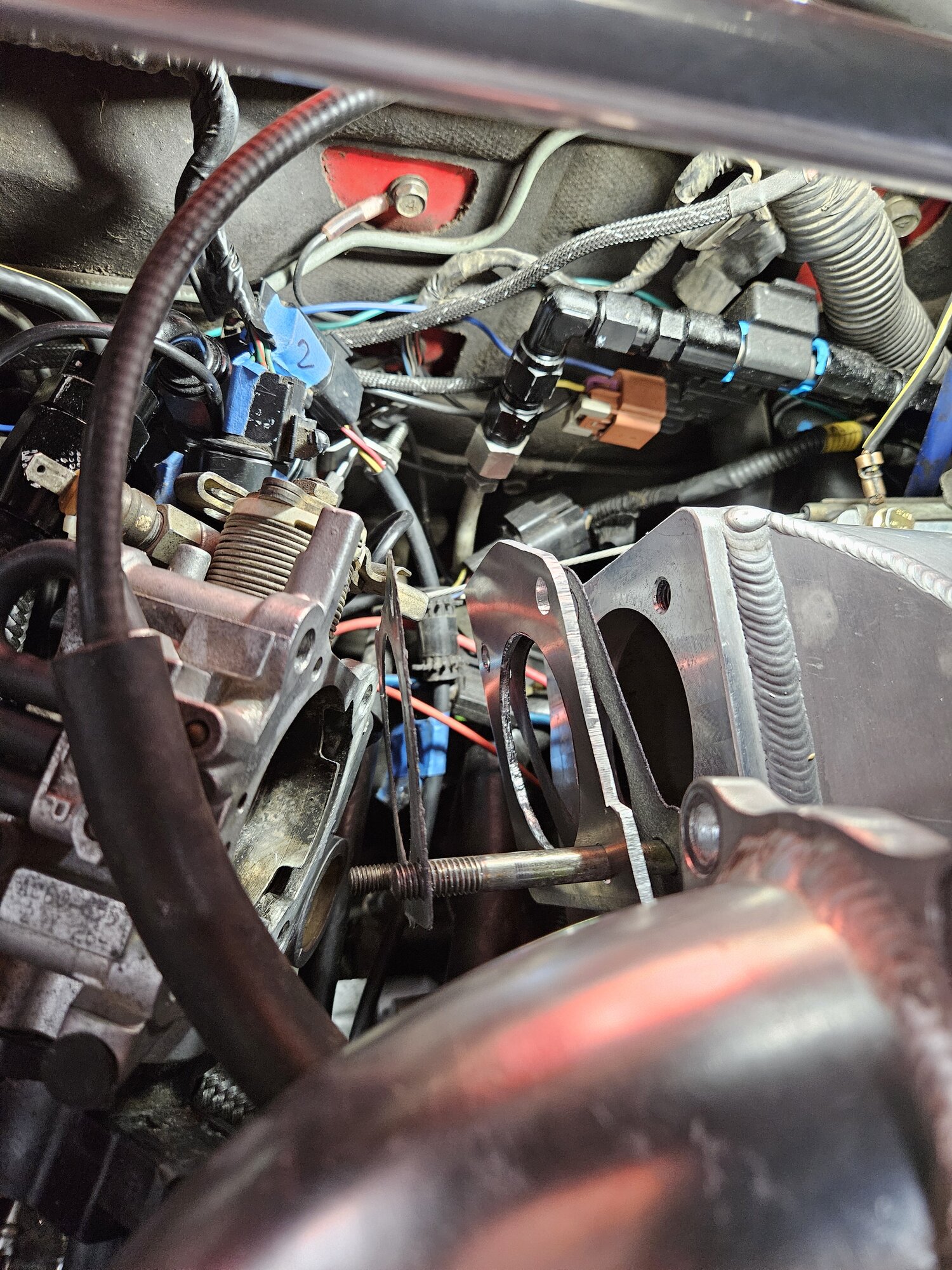

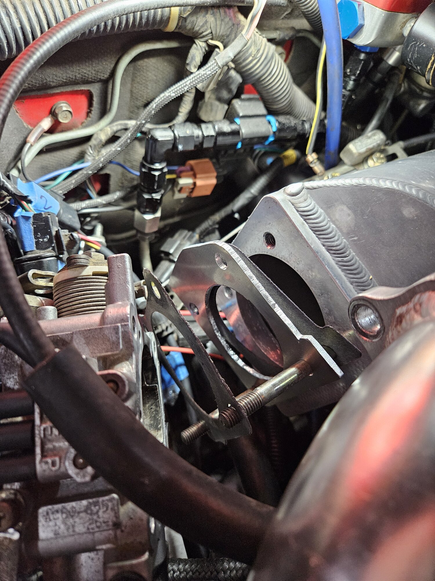

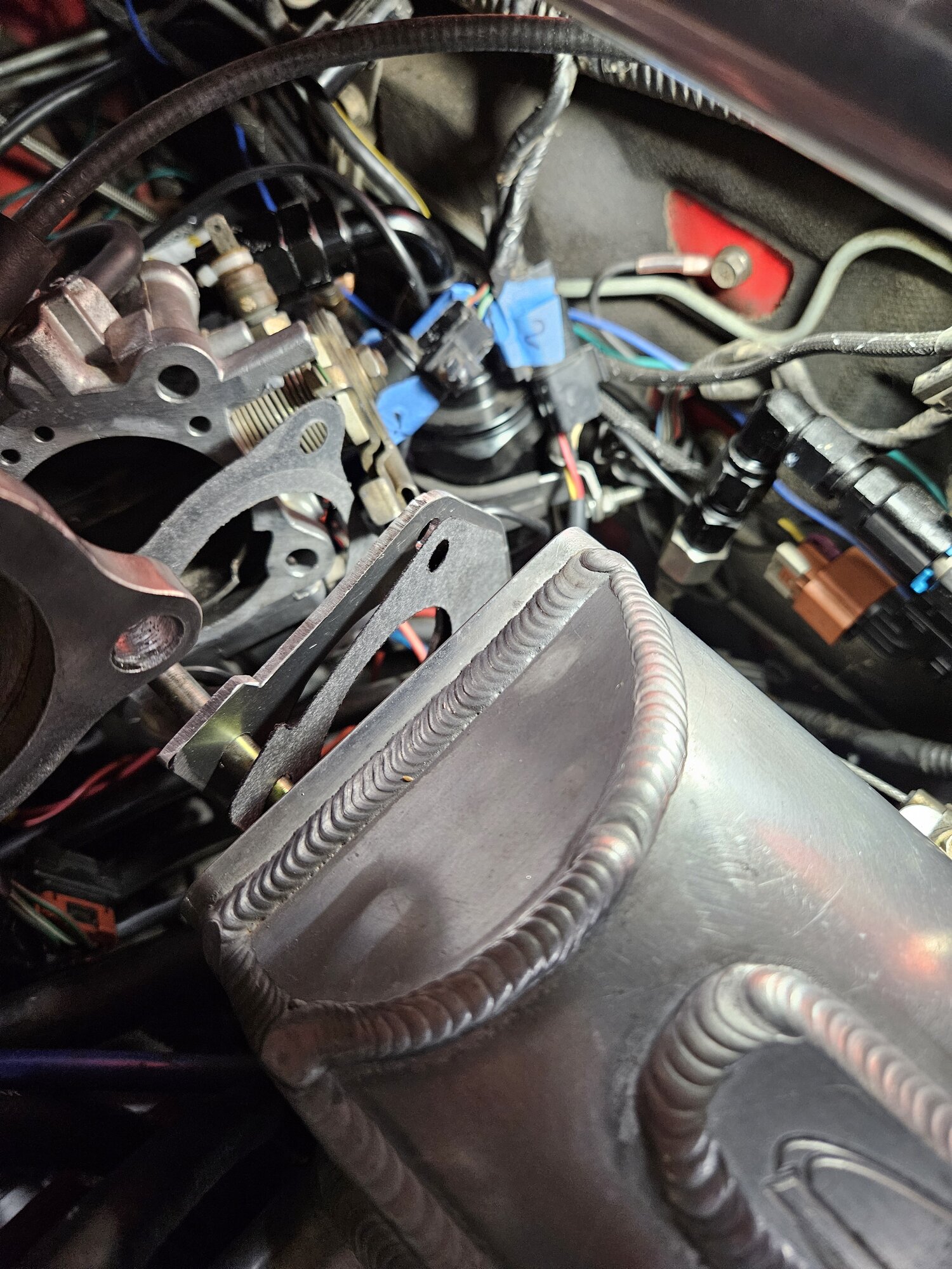

Ok, I BLT'd the car today and right at 21-22 lbs, the TB gasket started leaking on the firewall side. I am running a JMF Drag Manifold and had an issue there before but thought I had fixed it, obviously not. Anybody else have this issue??? :idontknow: Even tho it has this massive boost/vacuum leak, she still picks up and starts moving out FAST AS FK. I will pull the 1g TB and see what is going on with the sealing surface as soon as she cools down.

Ok, I BLT'd the car today and right at 21-22 lbs, the TB gasket started leaking on the firewall side. I am running a JMF Drag Manifold and had an issue there before but thought Ibhad fixed it, obviously not. Anybody else have this issu3???
I never did but seems like most people find it's the throttle shaft seals that need to be replaced, even though it might look like the problem is with the sealing surface between TB and manifold.
Oh no, it is most definitely the mating surface seal. I've been thu shaft seals and this has nothing to do with them. When I "wiggle" part of the TB/Manifold gasket, it is most definitely the issue. Behind the throttle shaft between the 2 intake bolts. I might see if they happen to be loose but IDT so. We will find out though! :thumb:

Back in 70's, we would take the throttle plates out of carbs and replace the shaft bushings so shaft seals are nothing new to me, although I am sure they are not thought about by the general crowd probably. Thanks for the suggestion anyway! Appreciate any help. 😊
Hey Marty, on my s90 I just lightly pasted some rtv on the gaskets and I’ve got no external leaks at all with 50psi tool pressure on a blt :thumb:
Also don’t forget to do your “vacuum pulls” LOL, I know you know, I was going wot on my engine on wastegate to like, 6500, then 7000, then 7500 and everything seemed to work out great LOL, forgive me I know you’ve “forgotten” more about engines than I’ll ever know LOL I just want this engine to live and kick a$$ and take names:hellyeah:
I started doing the same thing a while back. Little dab of the right stuff and everything seals to 50psi no problem. I even started putting a light layer on biss screw plug

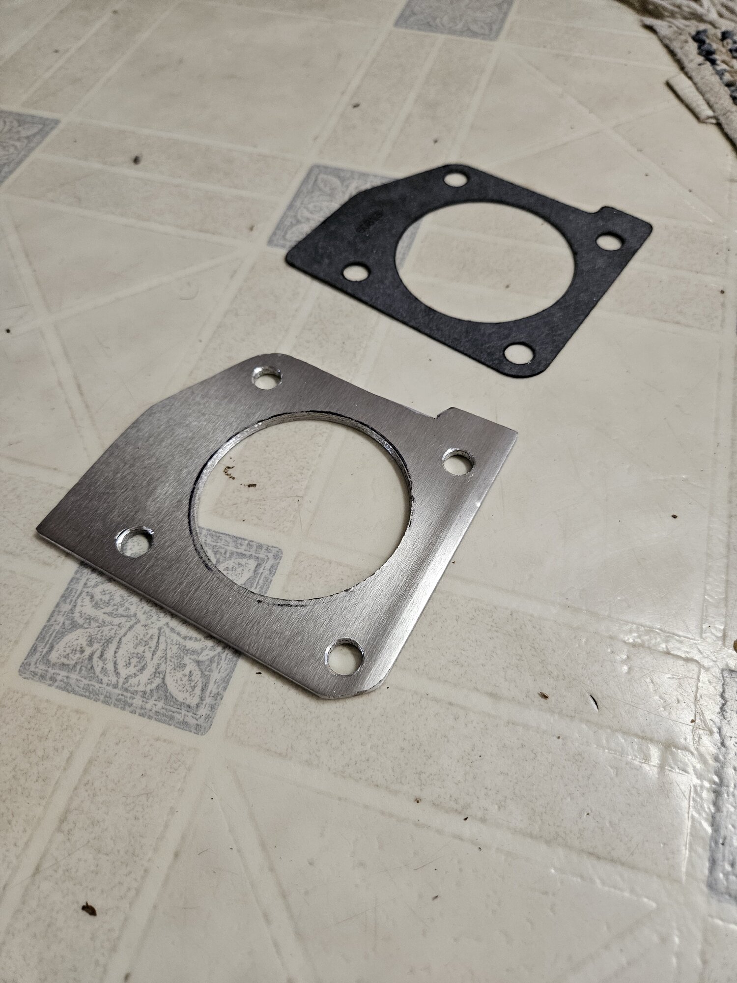

Alright, boost leak fixed PERMANENTLY. I made a sandwich plate, put a gasket on both sides, and that's all it needed. Boy those cams sound "rough" :cool: :)

Just to be clear on the problem with the intake flange and the throttle body.
1g Throttle Body - 60mm
JMF Drag Manifold opening - 70mm
Hmmm :hmm:
The sandwich plate was just an adapter from 70 to 60mm.
Anyone running this setup will need this and they are EASY to fabricate. :cool:
Hmmm :hmm:

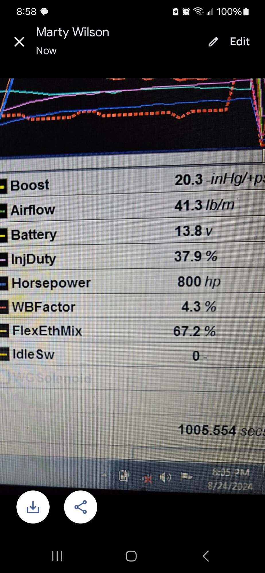

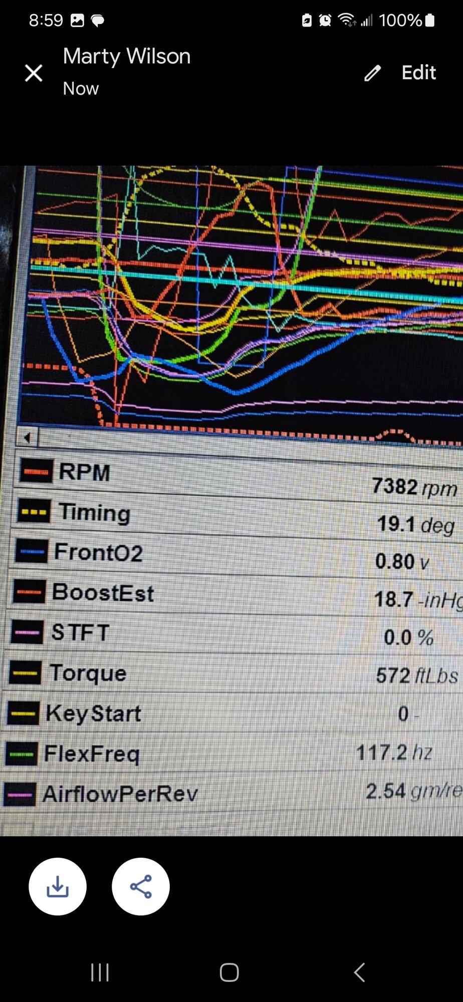

I took the car for a breakin drive and ended up passing 2 cars while logging. I've never seen these numbers before, BUT THEY ARE JUST NUMBERS.
I kept the rpms to only 7500 and boost to only 20psi.
The car felt STRONG, a bit jerky at lower rpms, but the cams are not little.

Those numbers are so wrong. ROFL When I see more airflow, I will think more about it. It is flowing only 41lbs so it's around 410hp, by guessing,.at 20ish lbs of boost. I think my MBC line was leaking before this, allowing me to reach 34lbs. Now that that leak is fixed (I had to have my son listen for me as my hearing is getting worse), I think the MBC is working correctly now and I will crack her open the next drive, while logging, to see if she will give me more. Ultimately, I would like to max the compressor out on this setup, which is about 40 or so. I'd take more if the turbo will give it to me! :cool:
