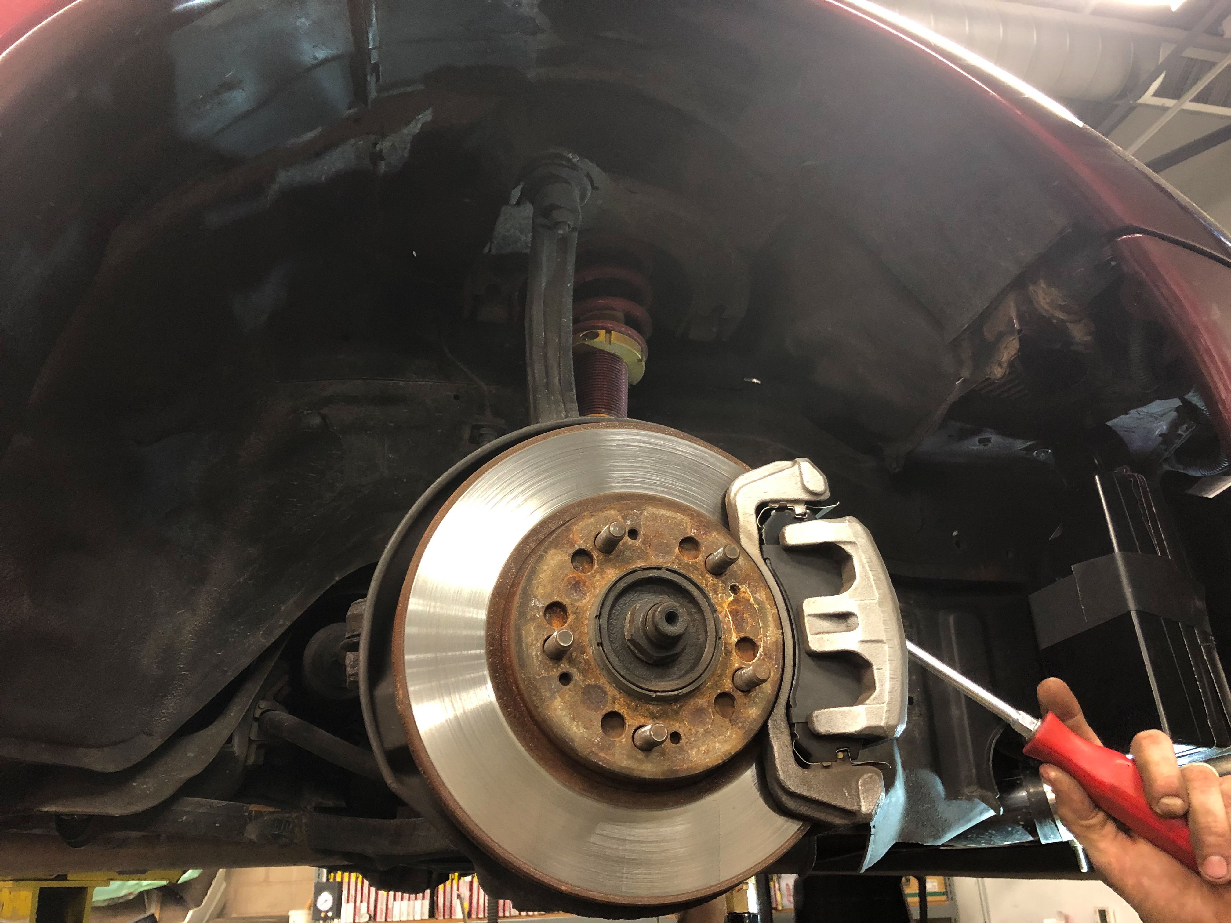

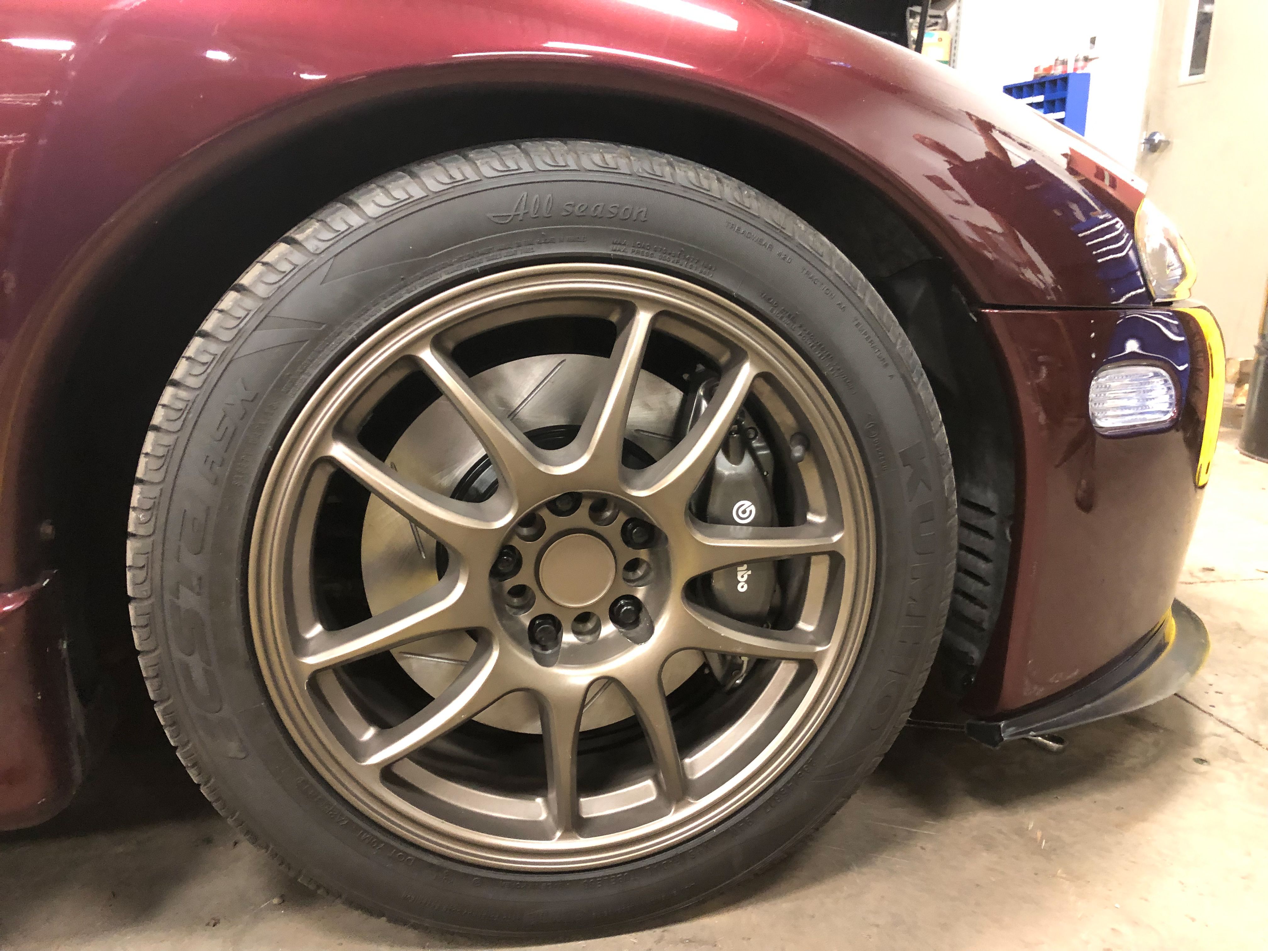

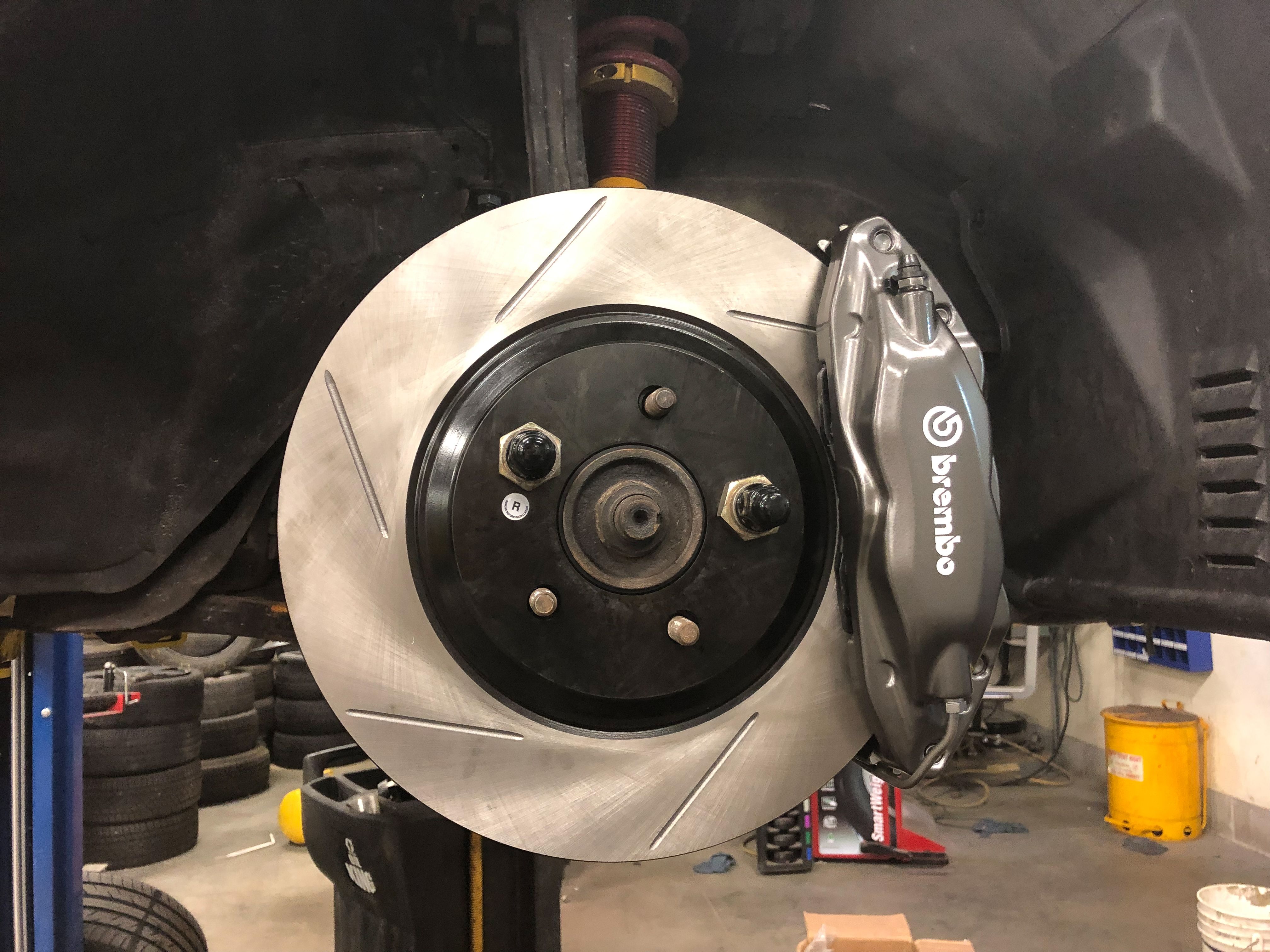

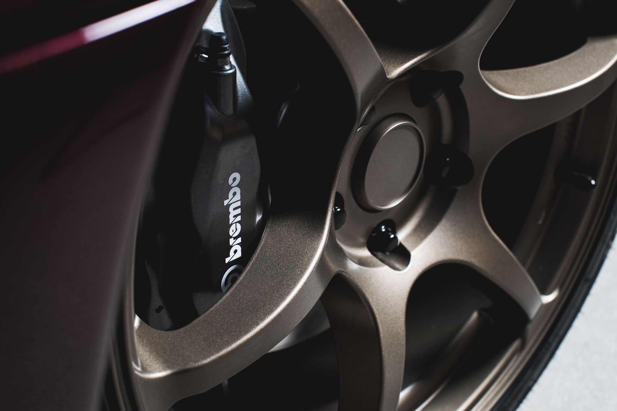

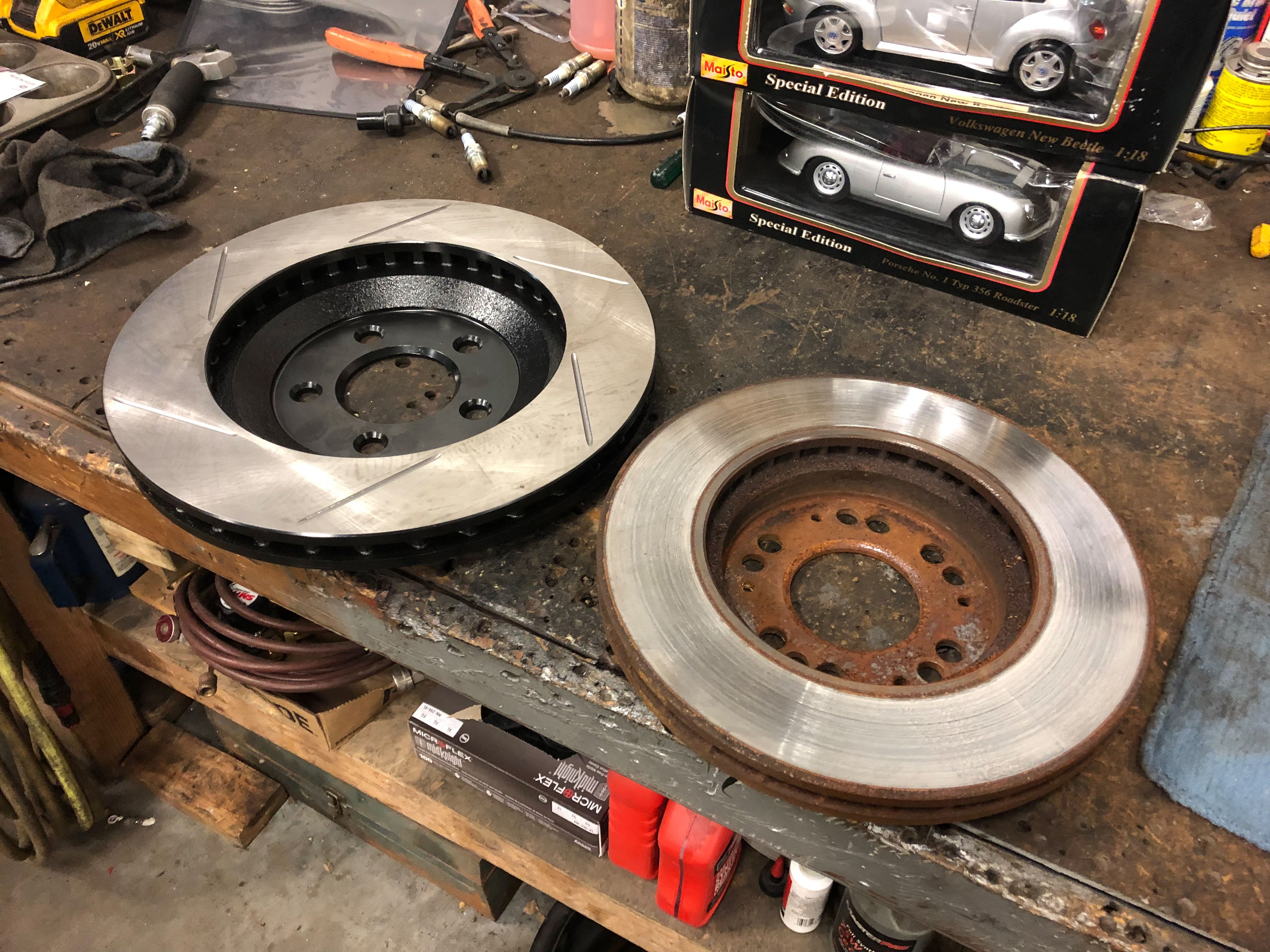

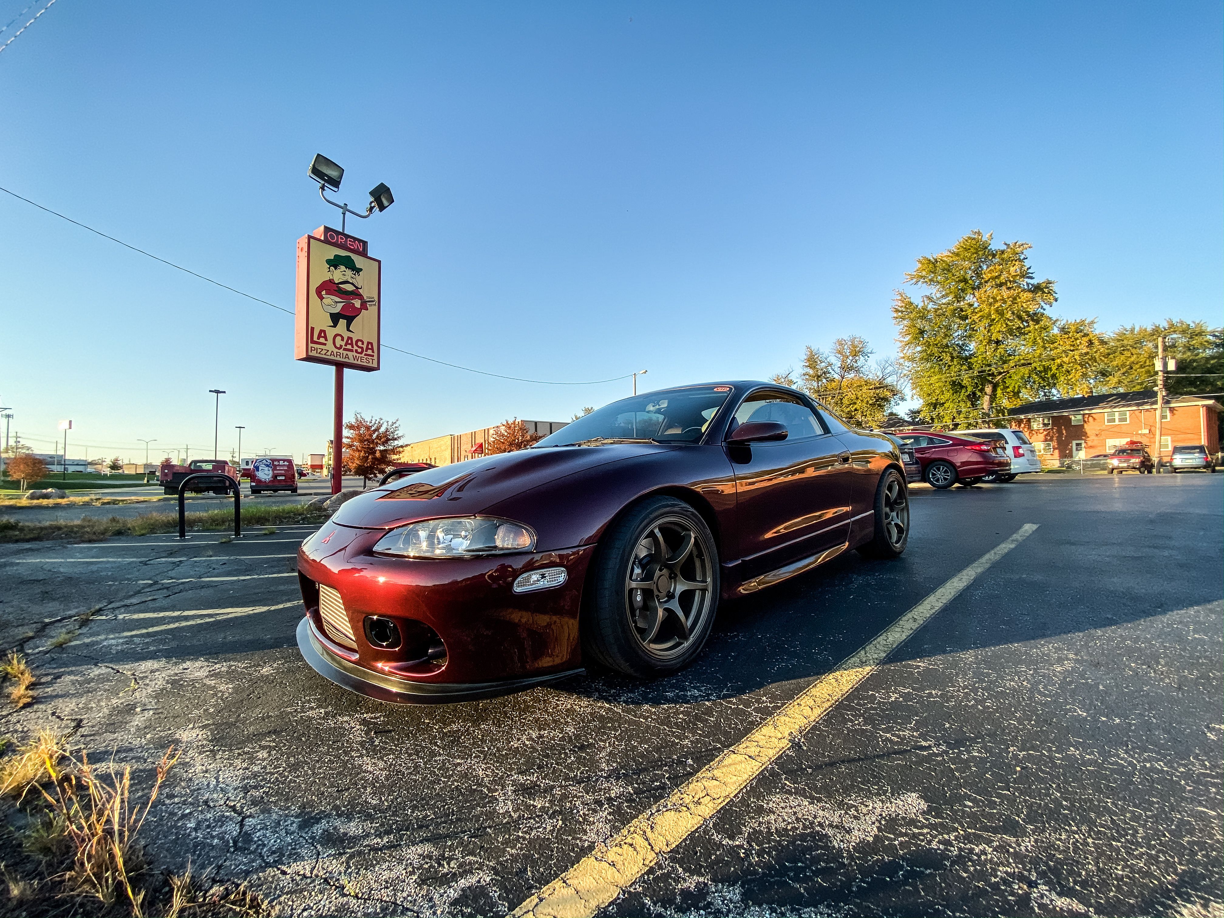

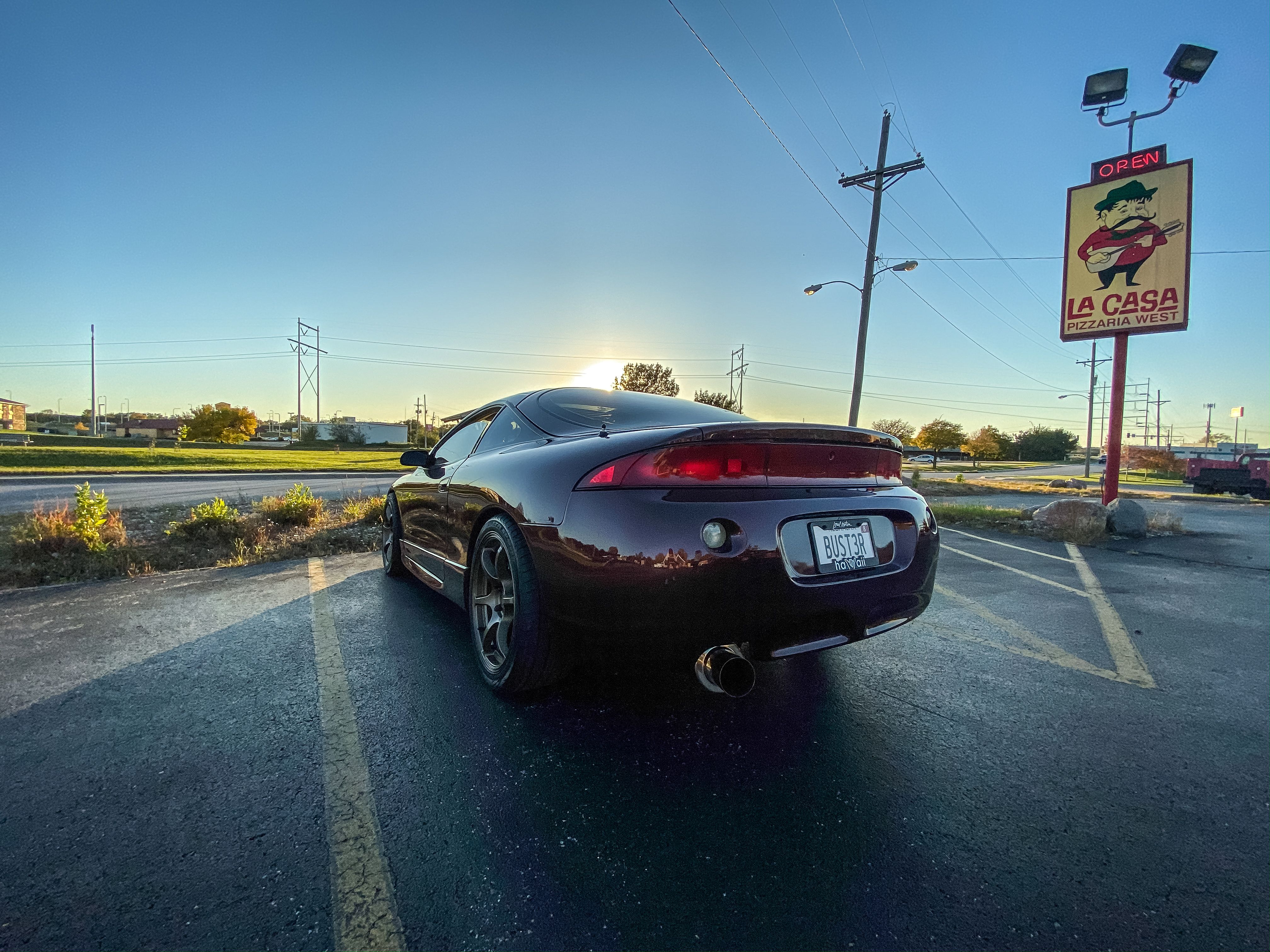

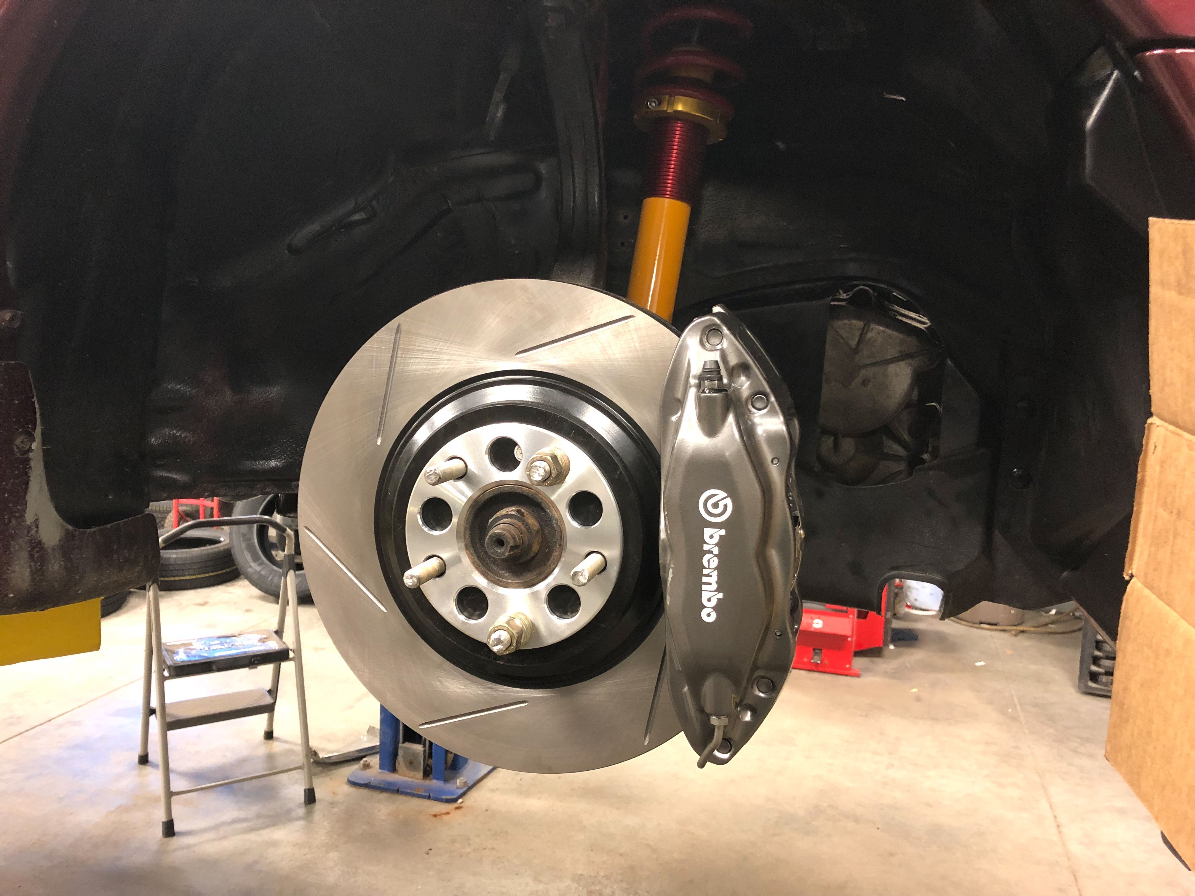

Well I got the front CTSV brakes on. This swap is extremely easy. All was good, my old 17x8 +35 cleared just fine! The bad news. My new 18x8.5 +35 did not clear at all, and I scratched some of the powdercoat off the calipers when I spun the wheel and it dug right in :banghead: . I did my math wrong I suppose.

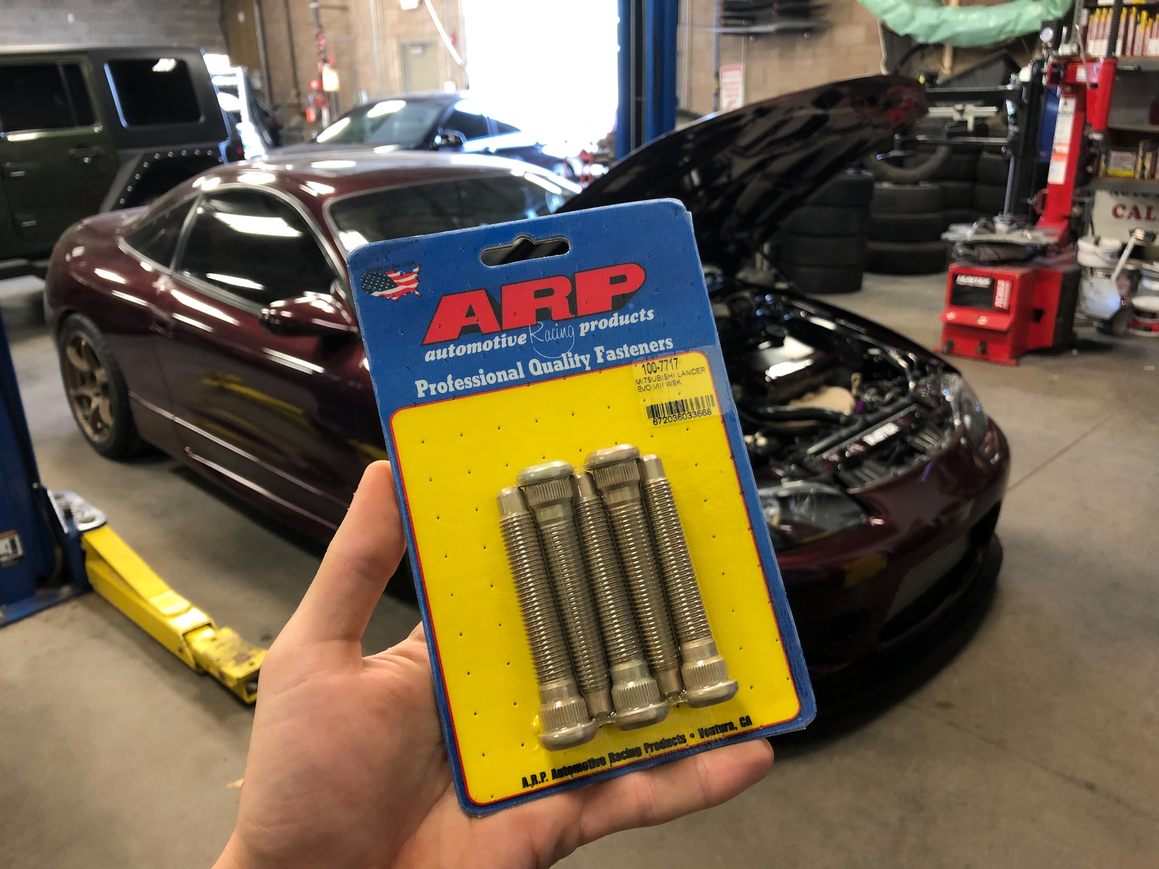

This called for a 5mm spacer and extended lugs to make it work 2 days before the car show I attend every year. Not ideal, and I really don't like how hard they poke out, but for now I'll have to deal with it until I figure out a solution.

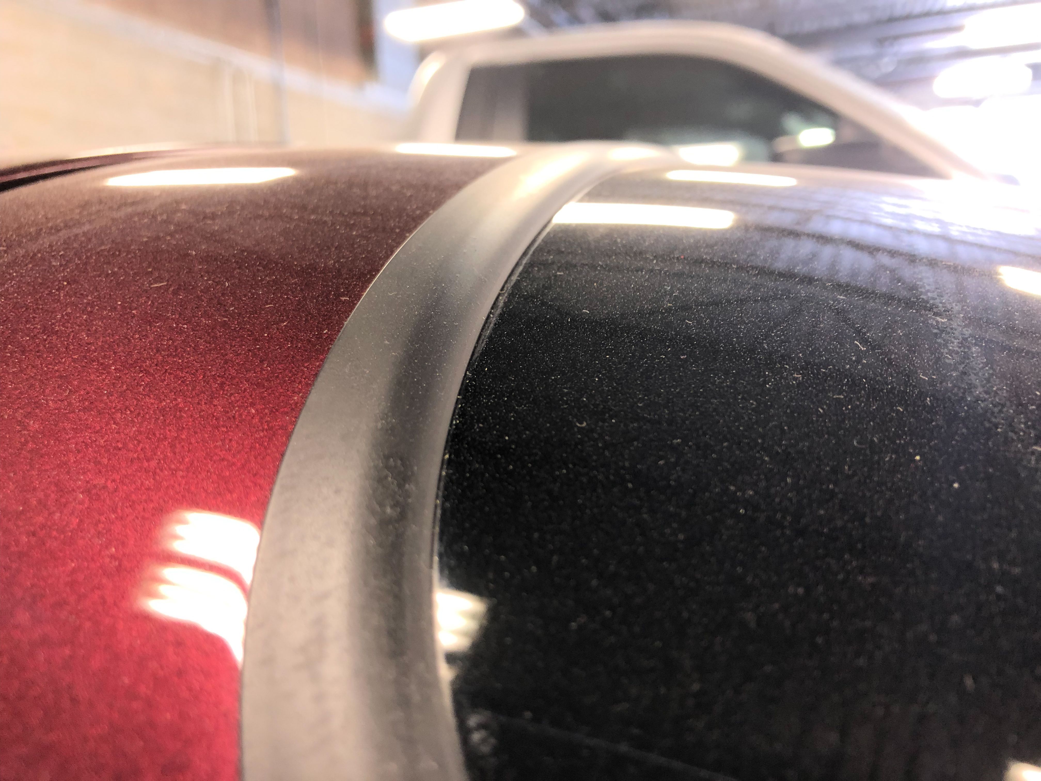

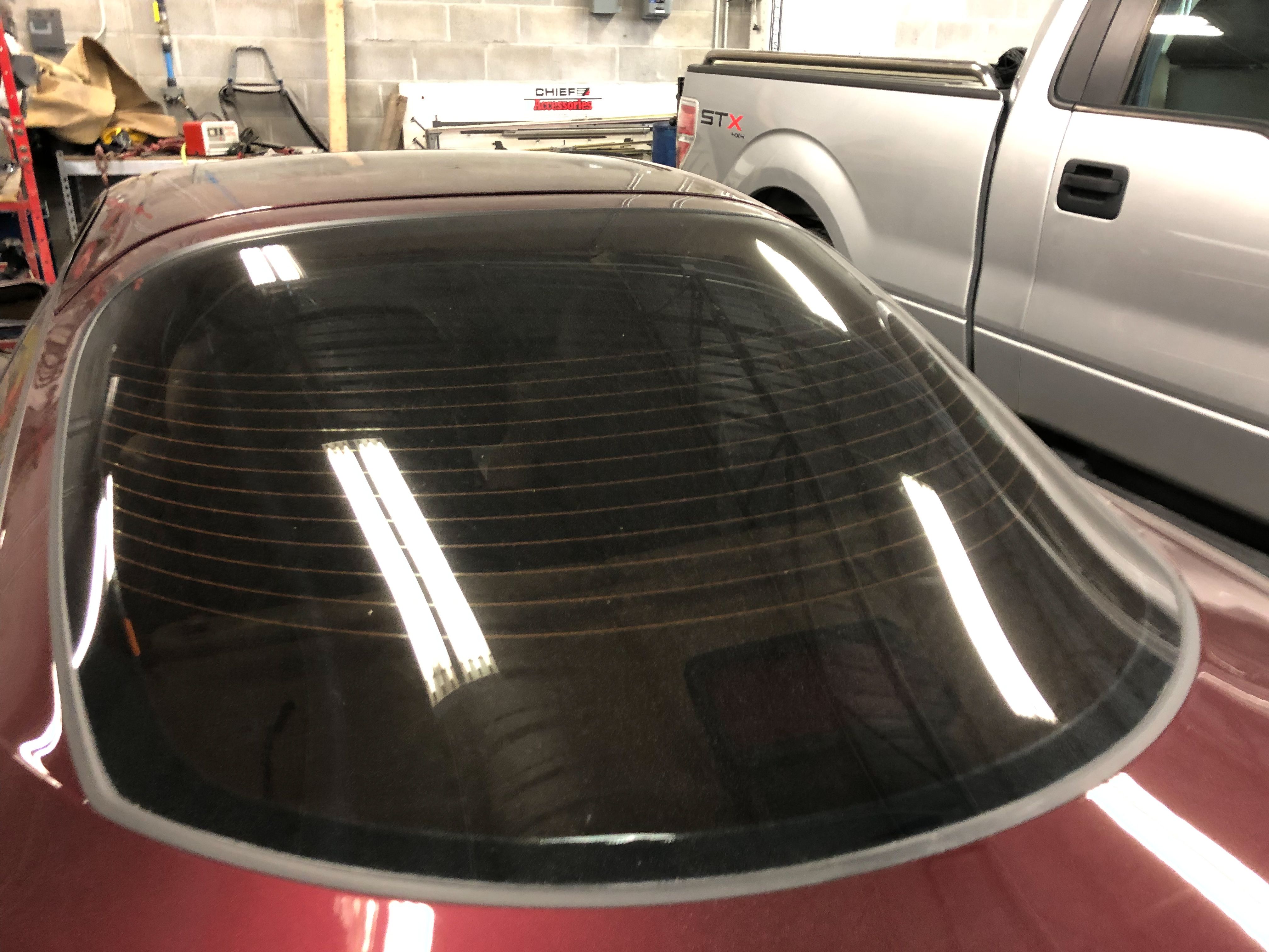

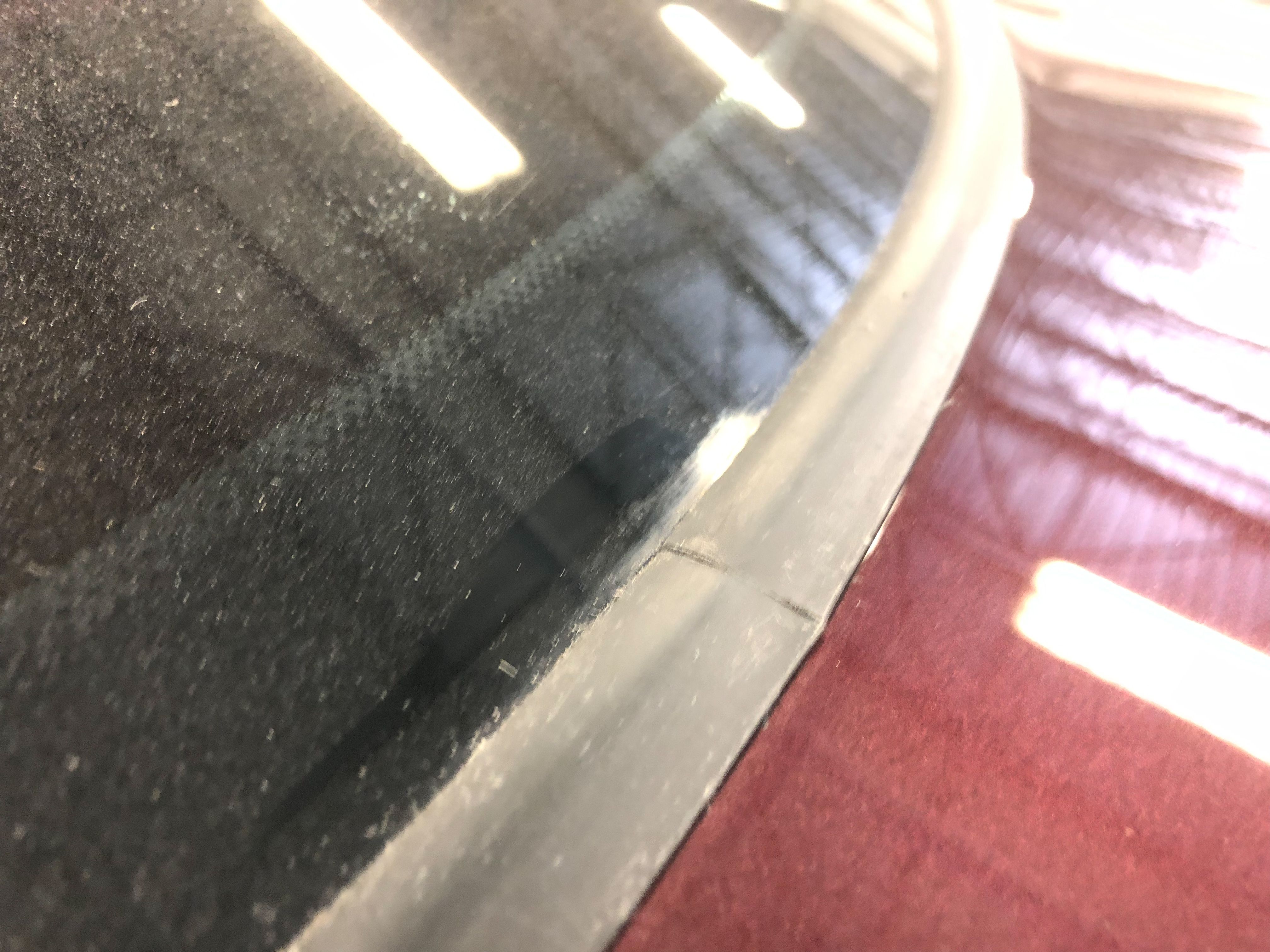

For those asking about replacing the trim for the windshield. This universal trim worked very well, no issues on sealing. The joint isn't the prettiest thing, but it's not that noticeable.

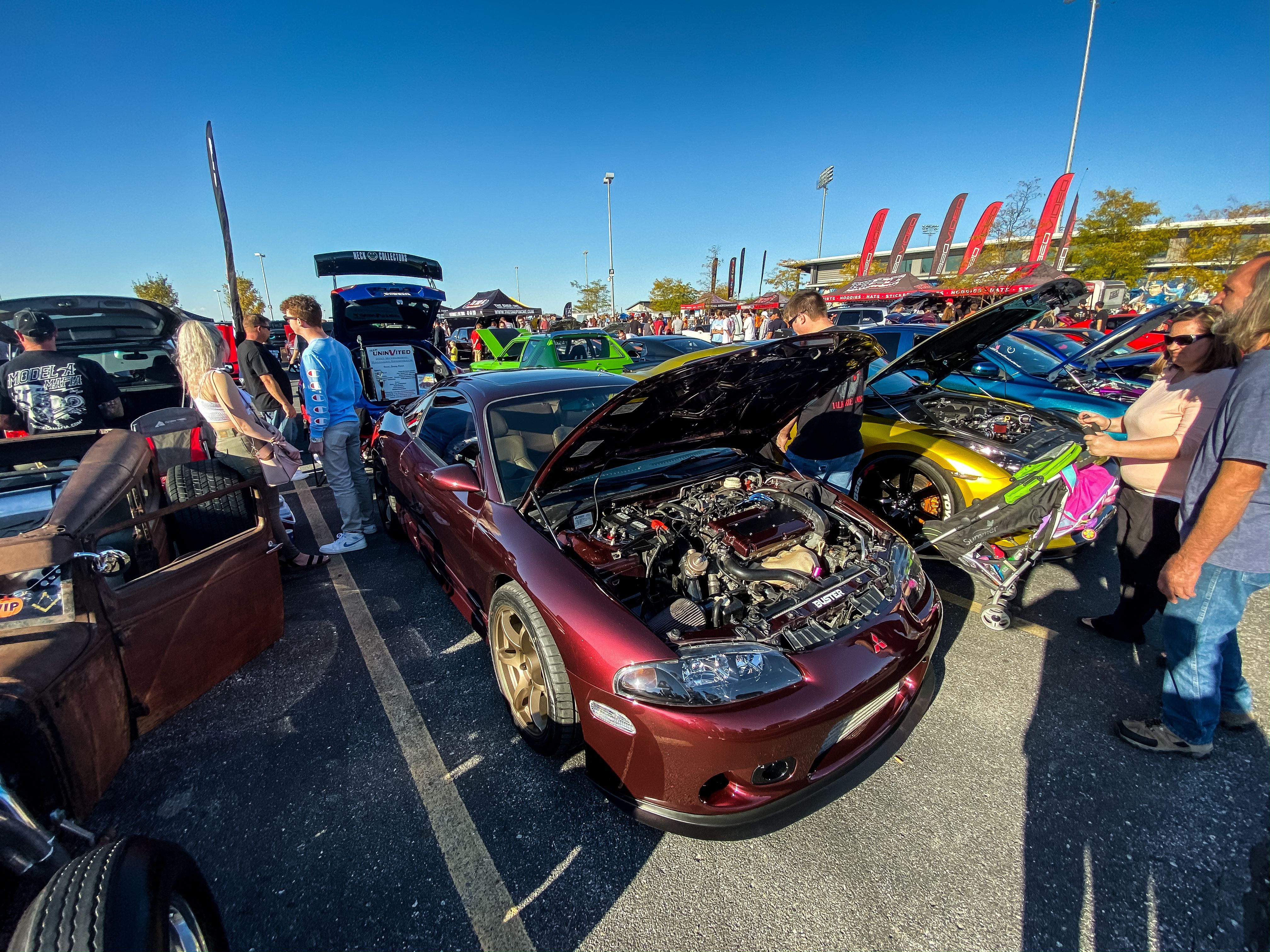

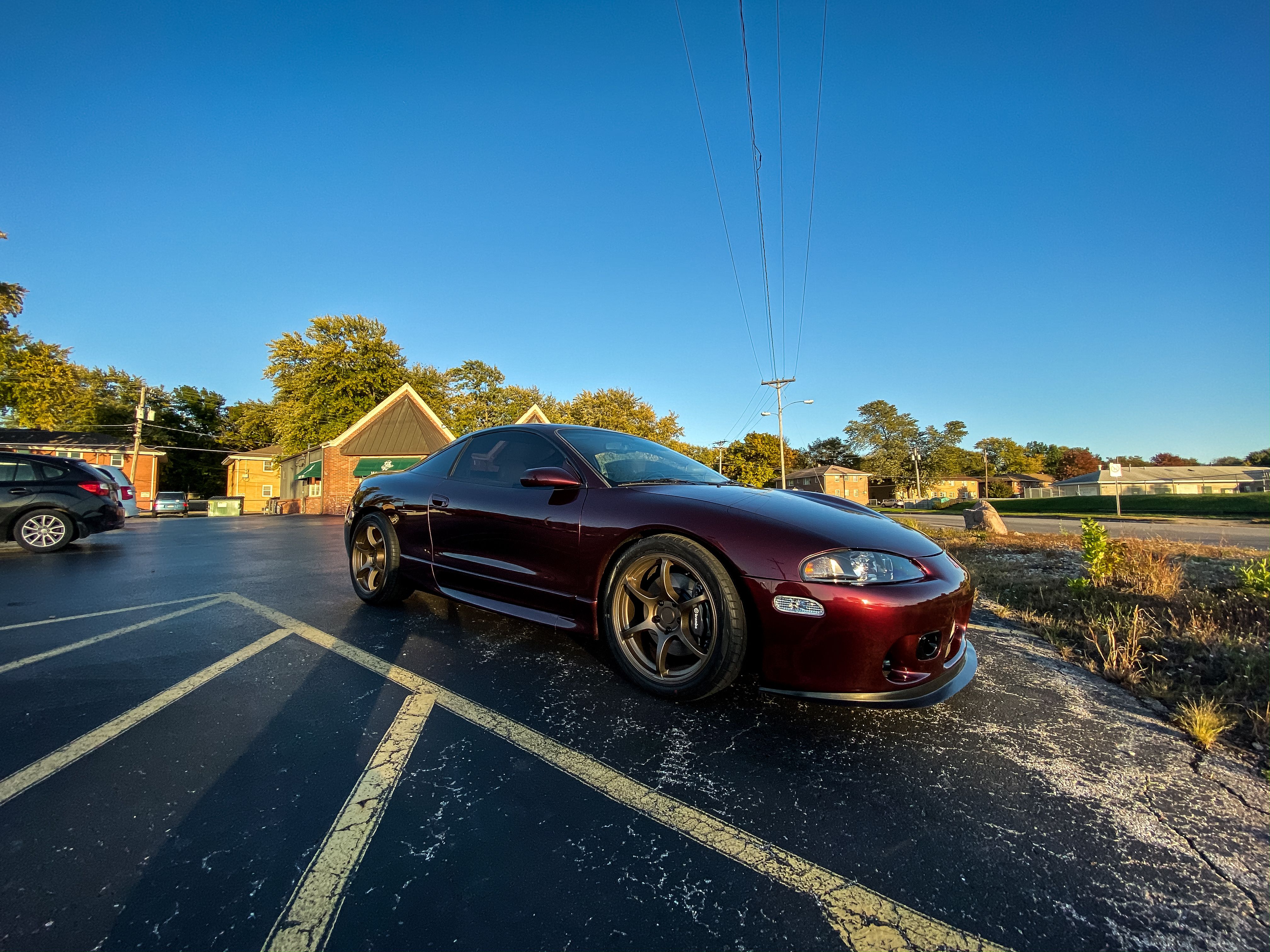

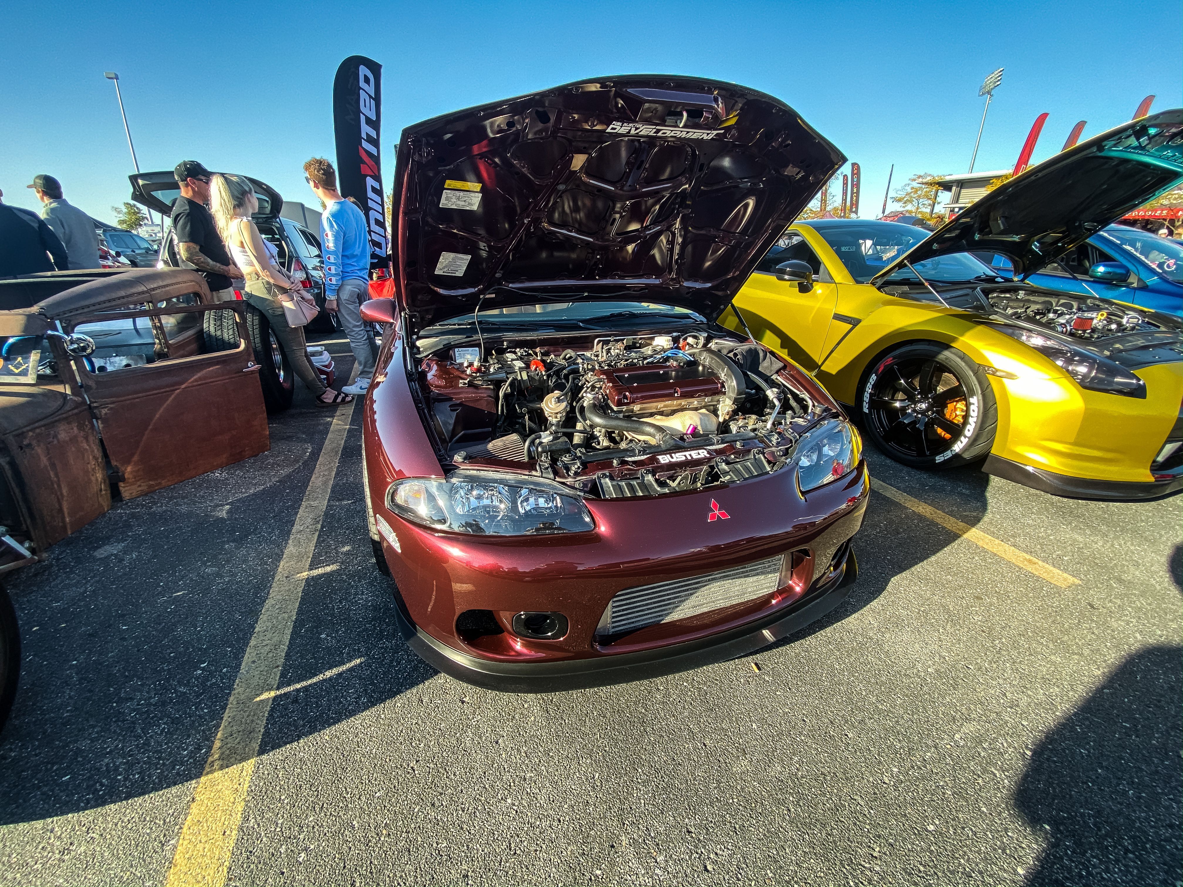

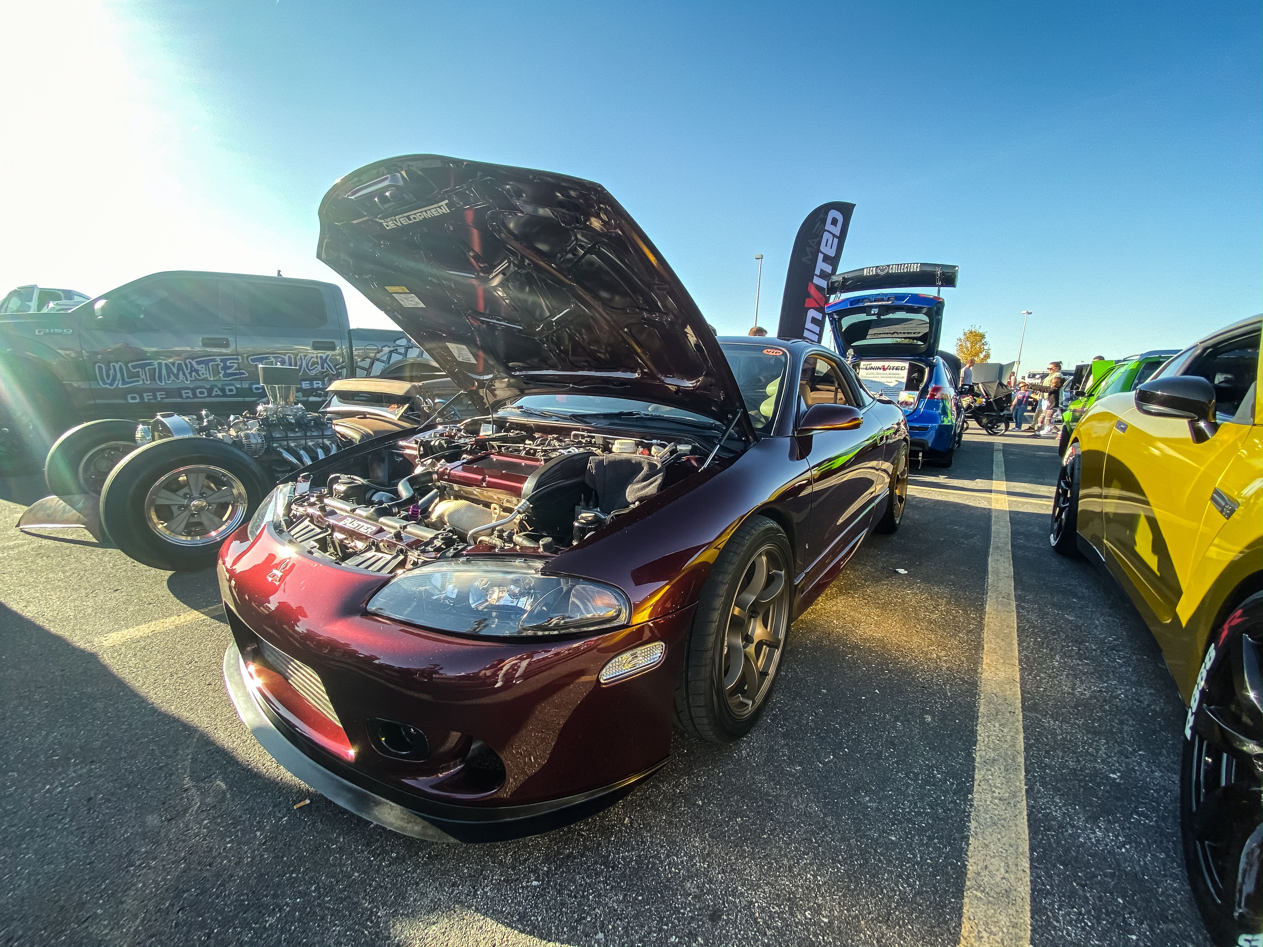

So, I did make it out to this years Ice Cream Cruise, one of the 1320Videos events they host here locally. They got started right where I'm at in Nebraska, so they put on a solid show every year. Secured a VIP spot up front! Here's where she sits so far. I'm really happy with the color scheme and how the overall look turned out. I also wanted to paint match the plastic center caps to the bronze powdercoat, so my paint guy used one of those color cameras to match and it's dead on :hellyeah:.

+1 on that question
Where do you get that? Looks nice
The glass guy I worked with said it's just one of the standard universal trims and that any glass installer should have it. I can ask for the exact size and if he knows the product name/number, but it's nothing special.

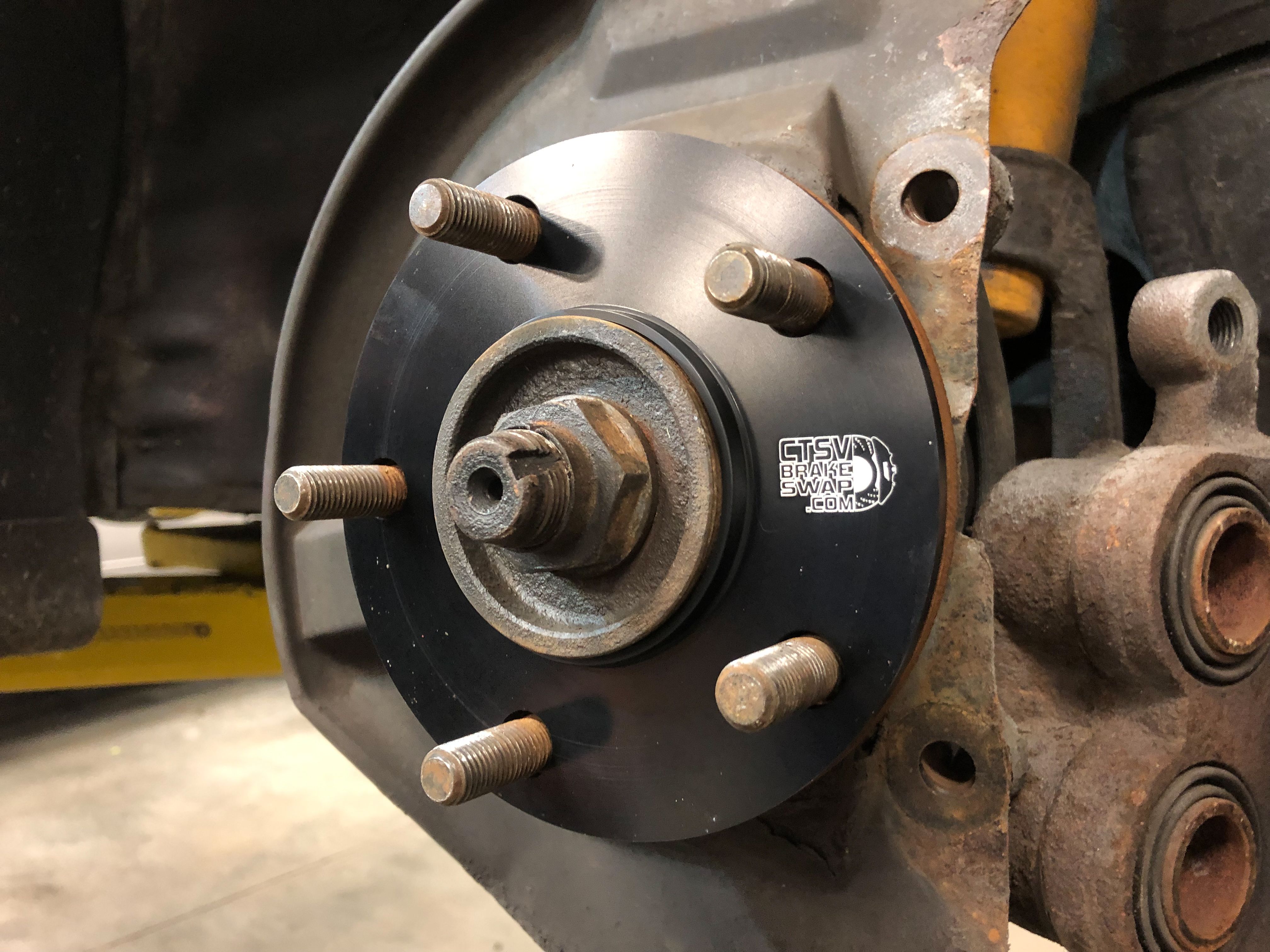

Havent seen those ctsvbrakeswap.com spacers before this..............what is there purpose exactly? just to help certain wheels clear? just curious.
You still have to use adapter brackets and grind the knuckle, or get JDM Galant knuckles right?
Judging by the orientation of the calipers, looks like you found some JDM knuckles. they look great btw.
Oh, no this is actually quite the opposite. No grinding, brackets, swapping knuckles, or anything of the like required here.
The purpose of the spacer straight from the website is "The hub-centric adapter spacer mounts between the rotor and the wheel hub to perfectly center the Mustang rotor in the CTS-V caliper."
It's technically bolt on. In total, the swap requires:
  1. Both front 04-07 CTS-V calipers + 04-07 CTSV Pads - $300
  2. 03-04 Mustang Cobra 12.99” front brake rotors - $80-250, depends on brand and style.
  3. Evo 8/9 stainless braided brake lines - Already had a set.
  4. 1G/2G Adapter/Hub-Centric Spacer - $120
I didnt know those bolted on like that.......I thought they where the same caliper as the evo8 just in silver haha
does everyone know this? makes them a better option

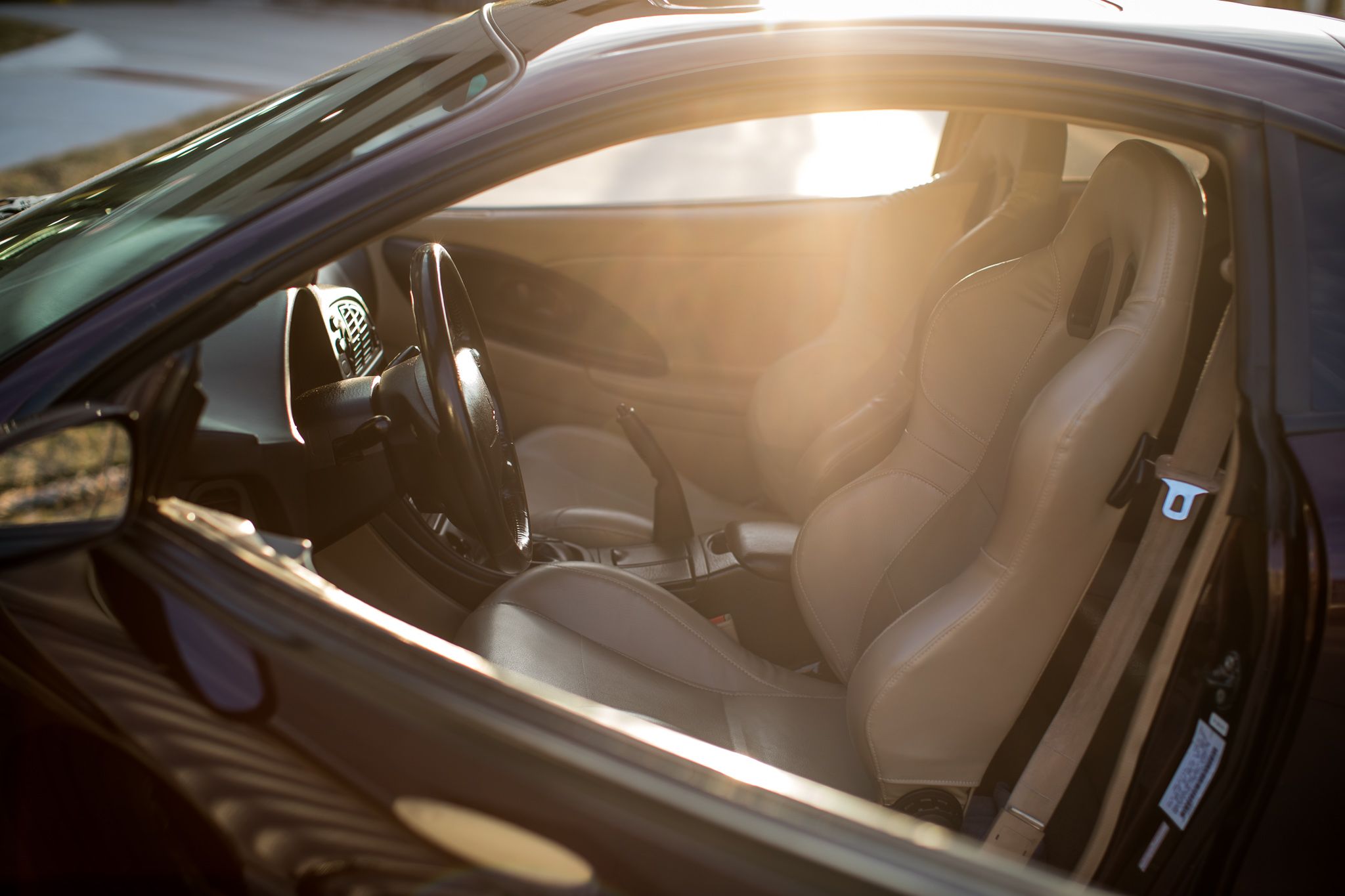

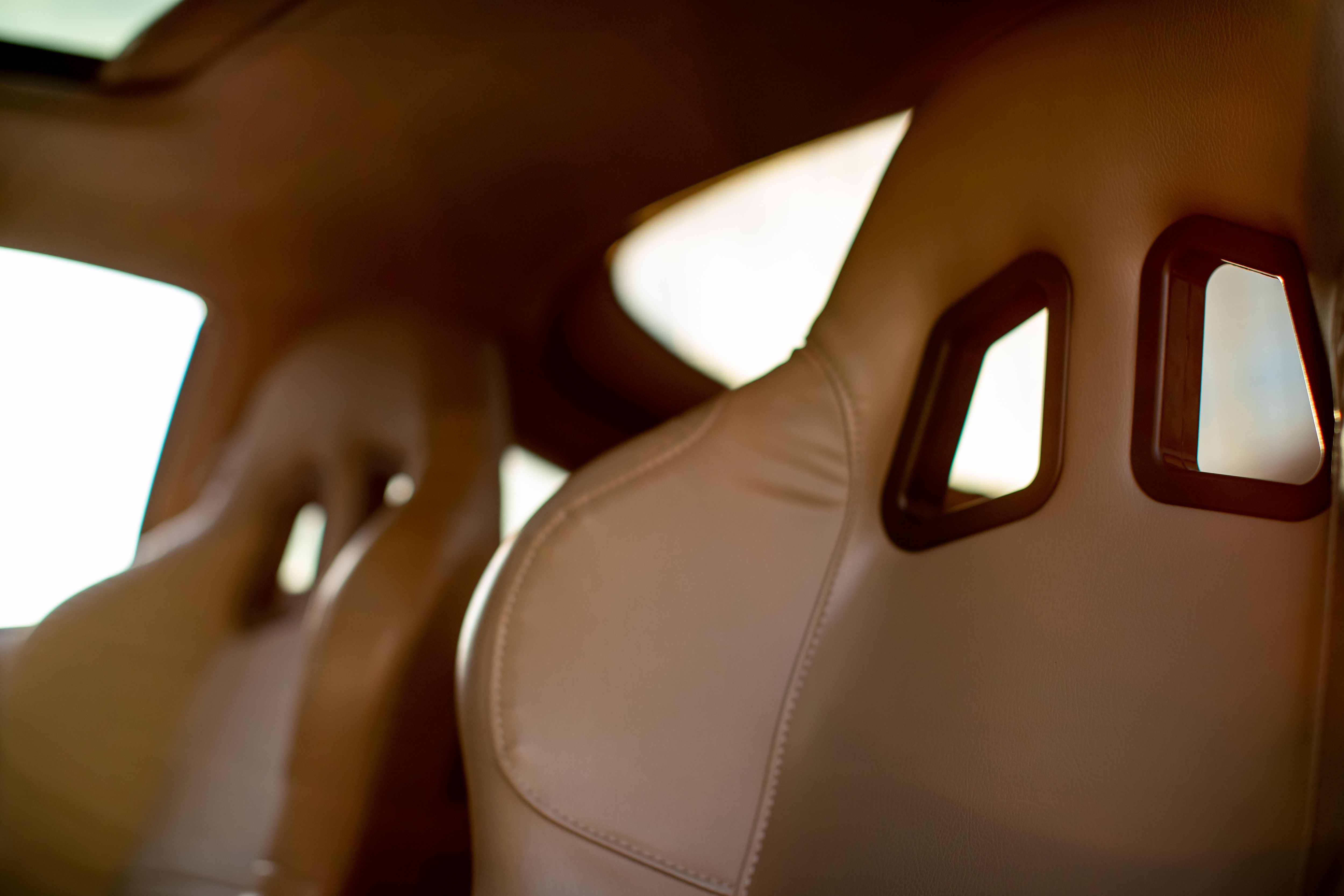

A quick update. I installed the Summit Racing seats and modified them to fit a set of stock manual sliders that I found at the junkyard, so I can raise and lower the front and back. I had power seats and wanted to get rid of that extra weight.
They look good. It's not a perfect match, but I'm happy with them and haven't seen these in a DSM before.

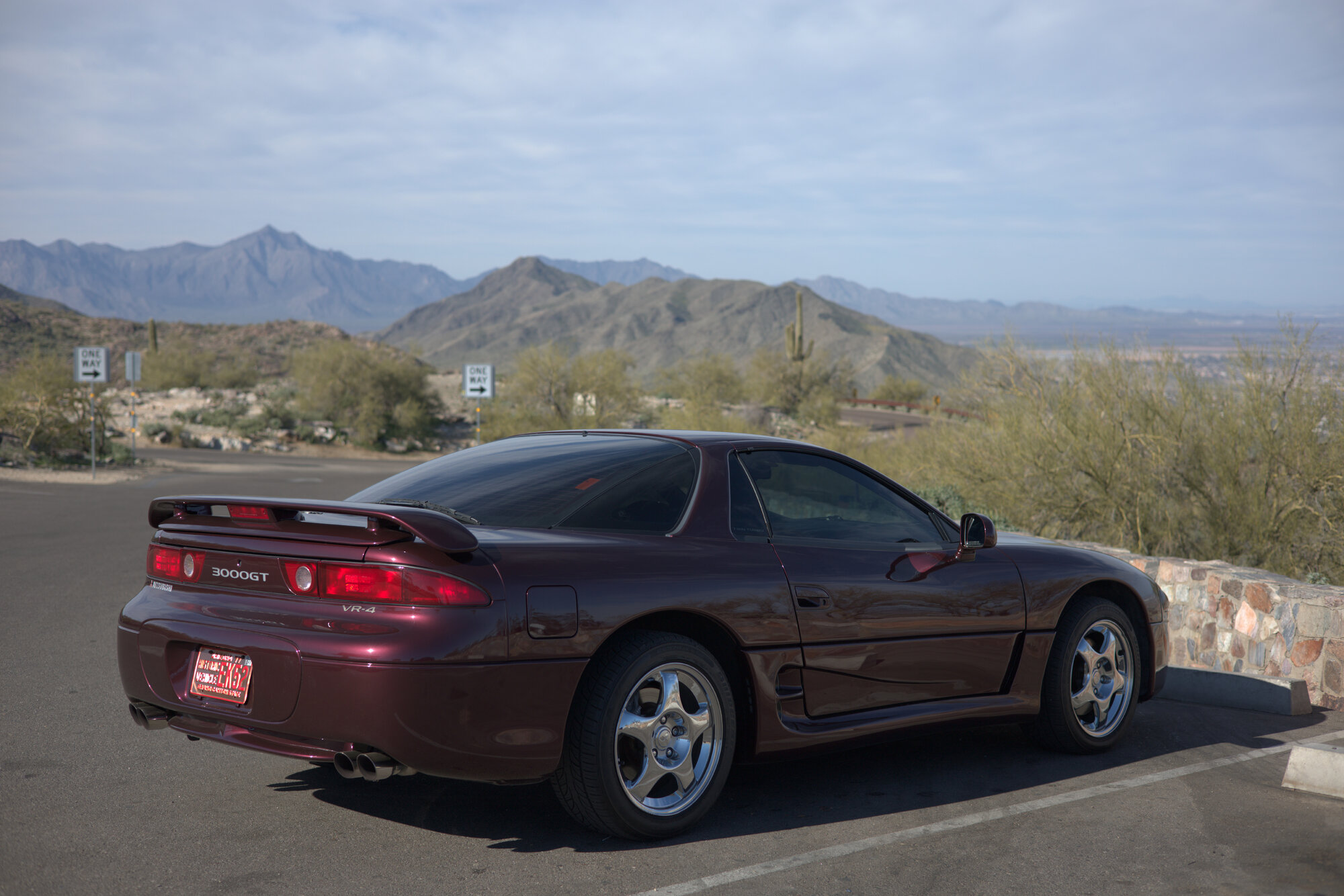

Small update. Added a VR-4 to the collection. Sorrento Red Pearl. I have a purple/red problem. :cool:
In a perfect world, I'd have a Pajero Evolution for the trio. I'd mix Sorrento and Barcelona together in the paint booth. Dark gray wheels, custom ralliart bronze mudflaps. It'd be really unique.
I like Evos, but that's just how I'd run my 3 90's Mitsubishi lineup.
