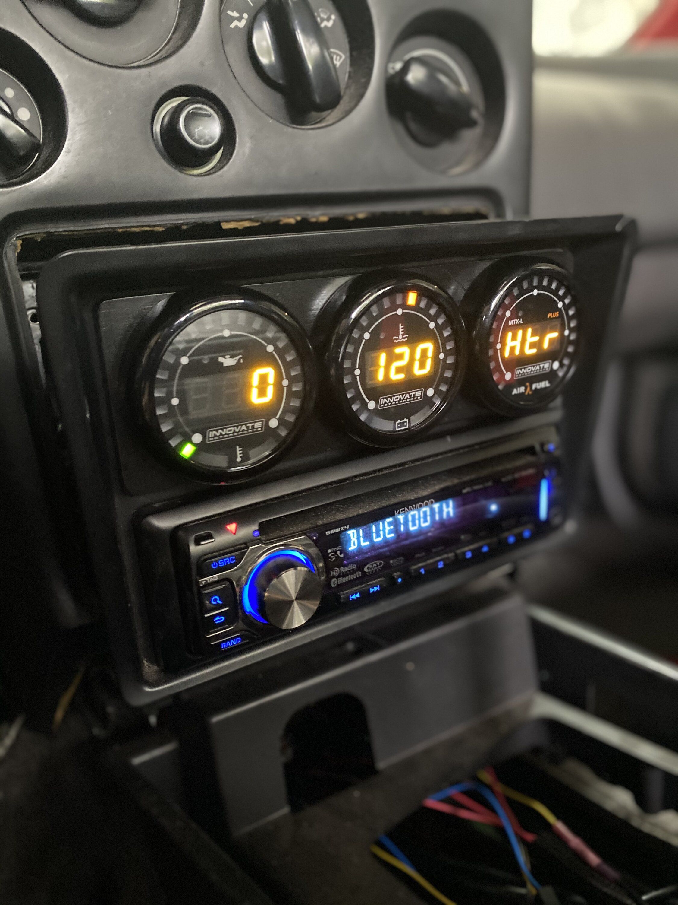

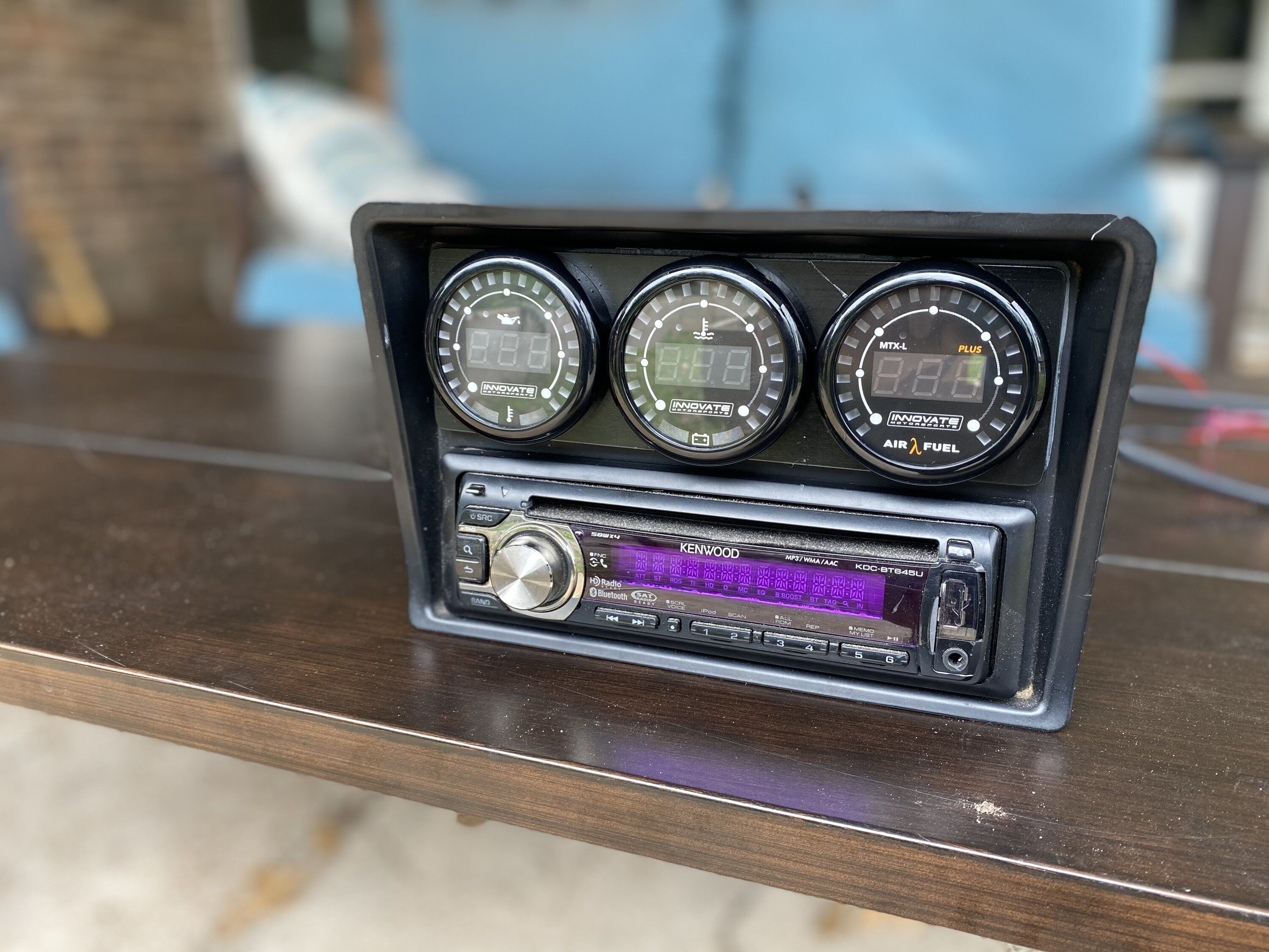

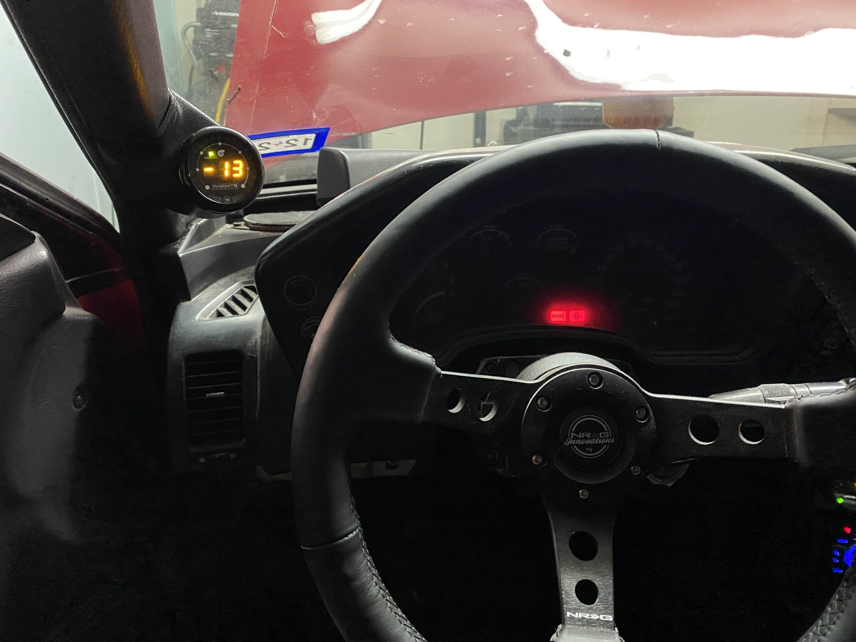

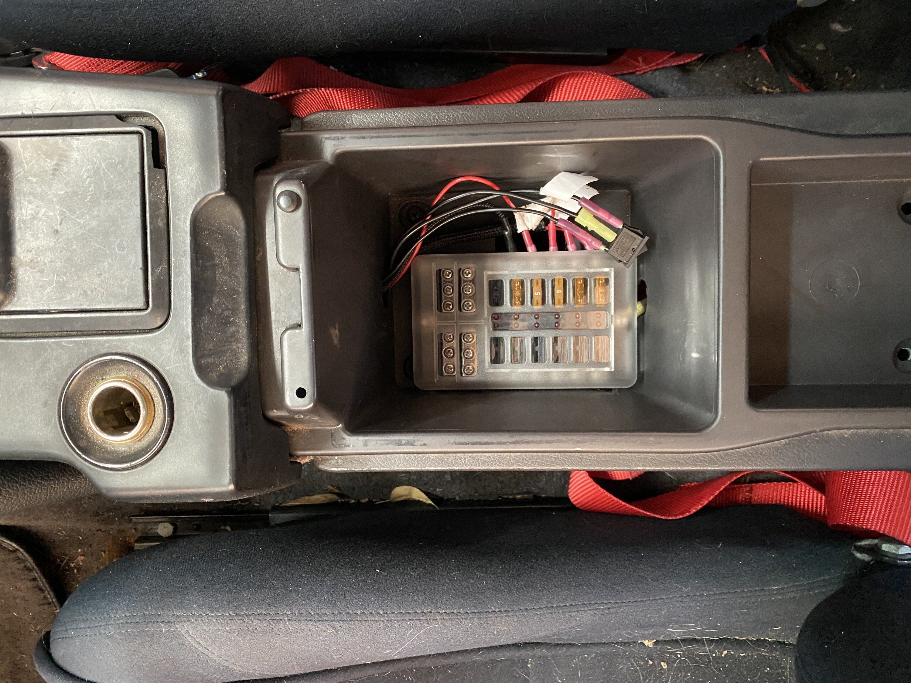

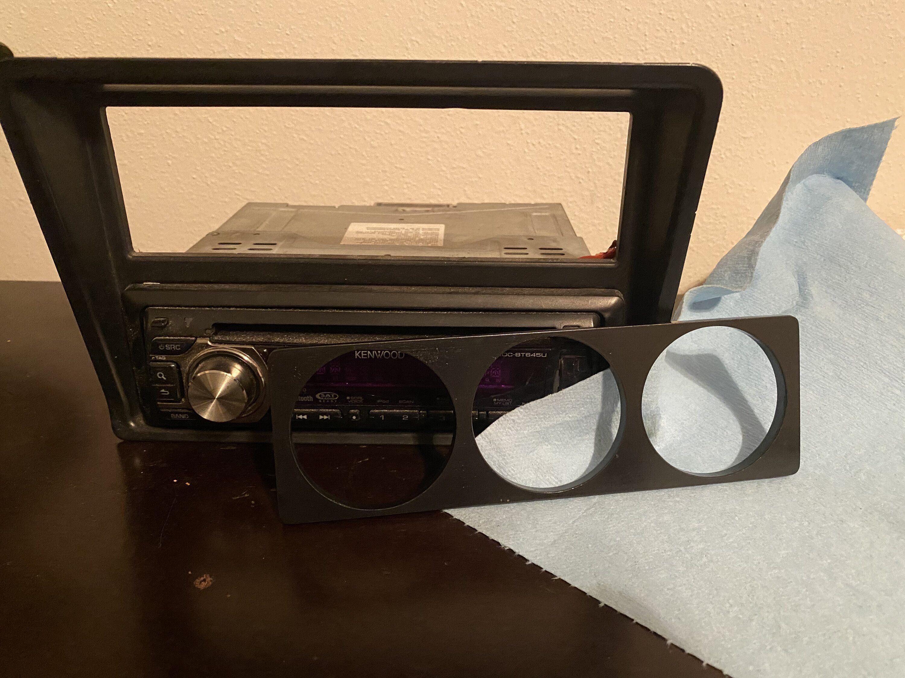

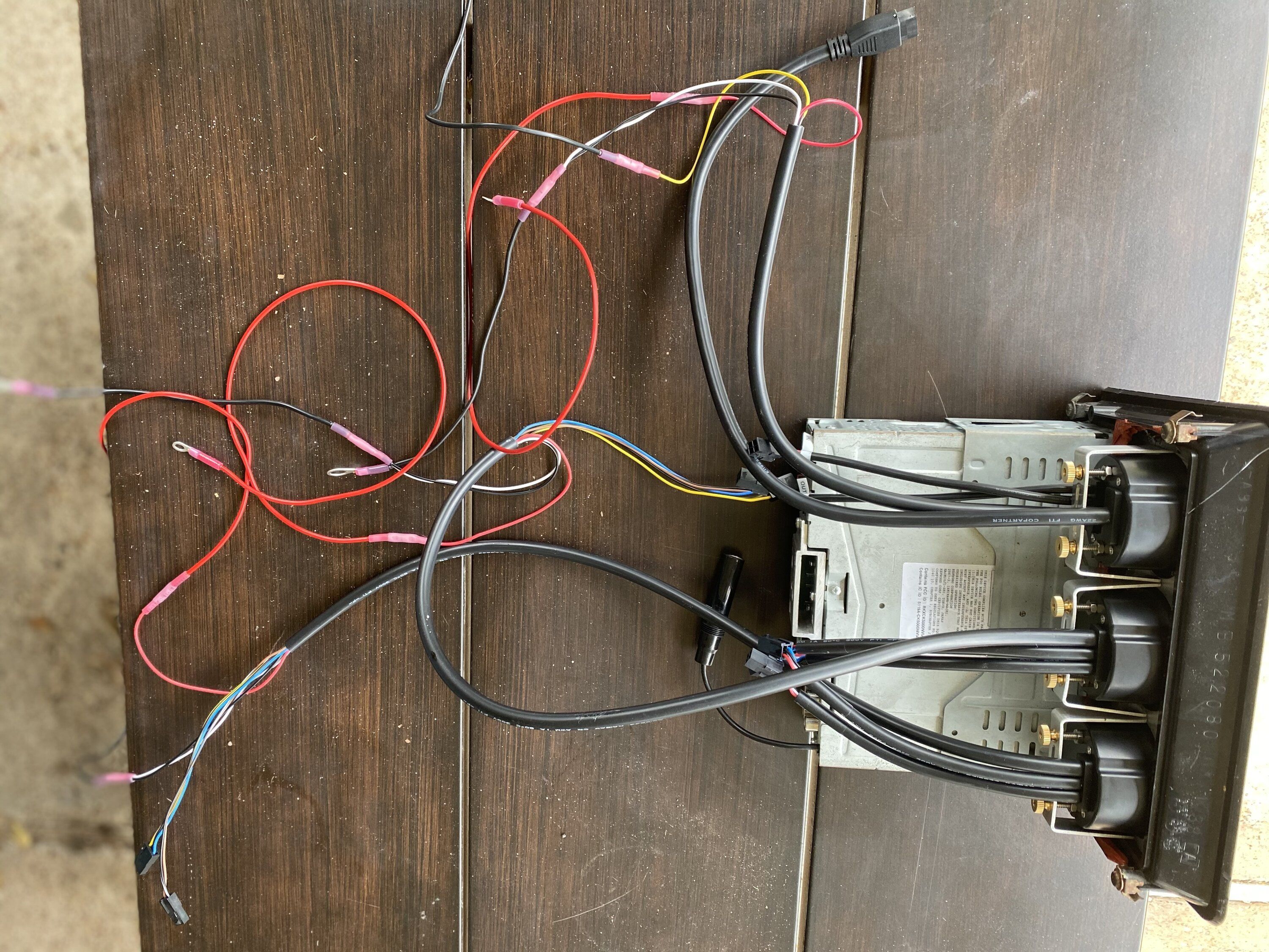

I decided to get all new Innovate gauges while also switching from the LC2 to MTXL-Plus wideband. I also put in a new switched relay/fuse panel in my armrest to control all gauges.

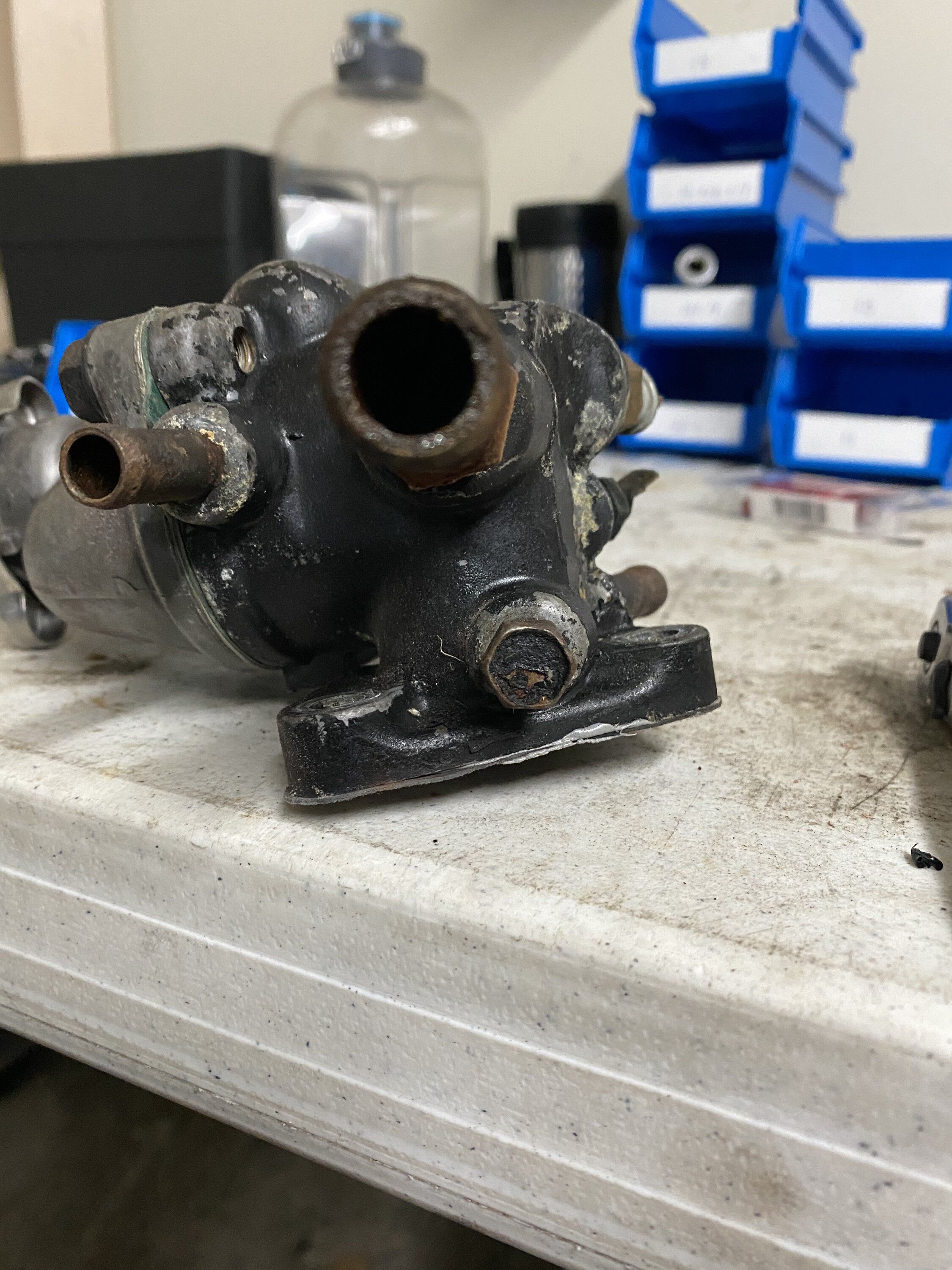

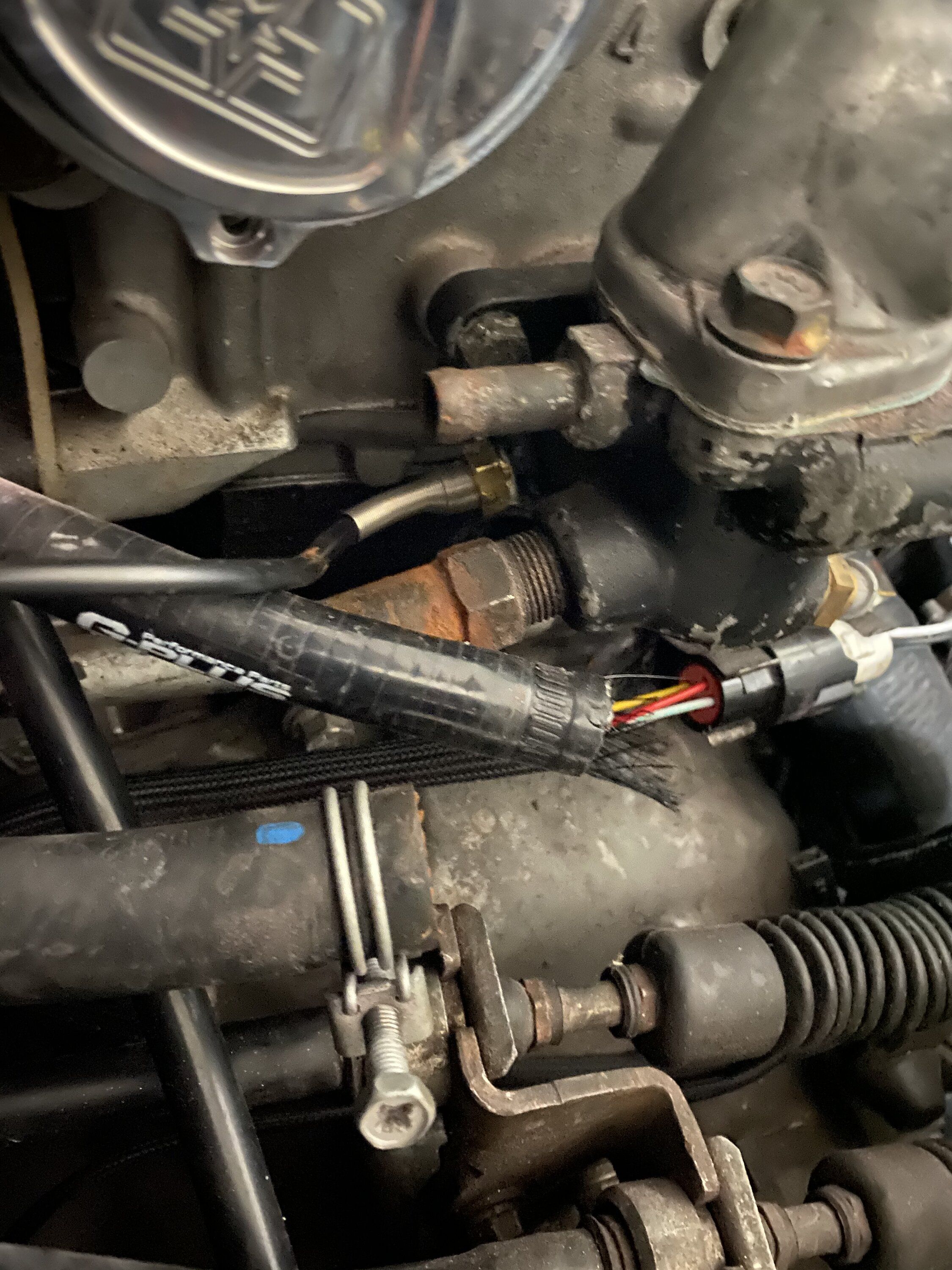

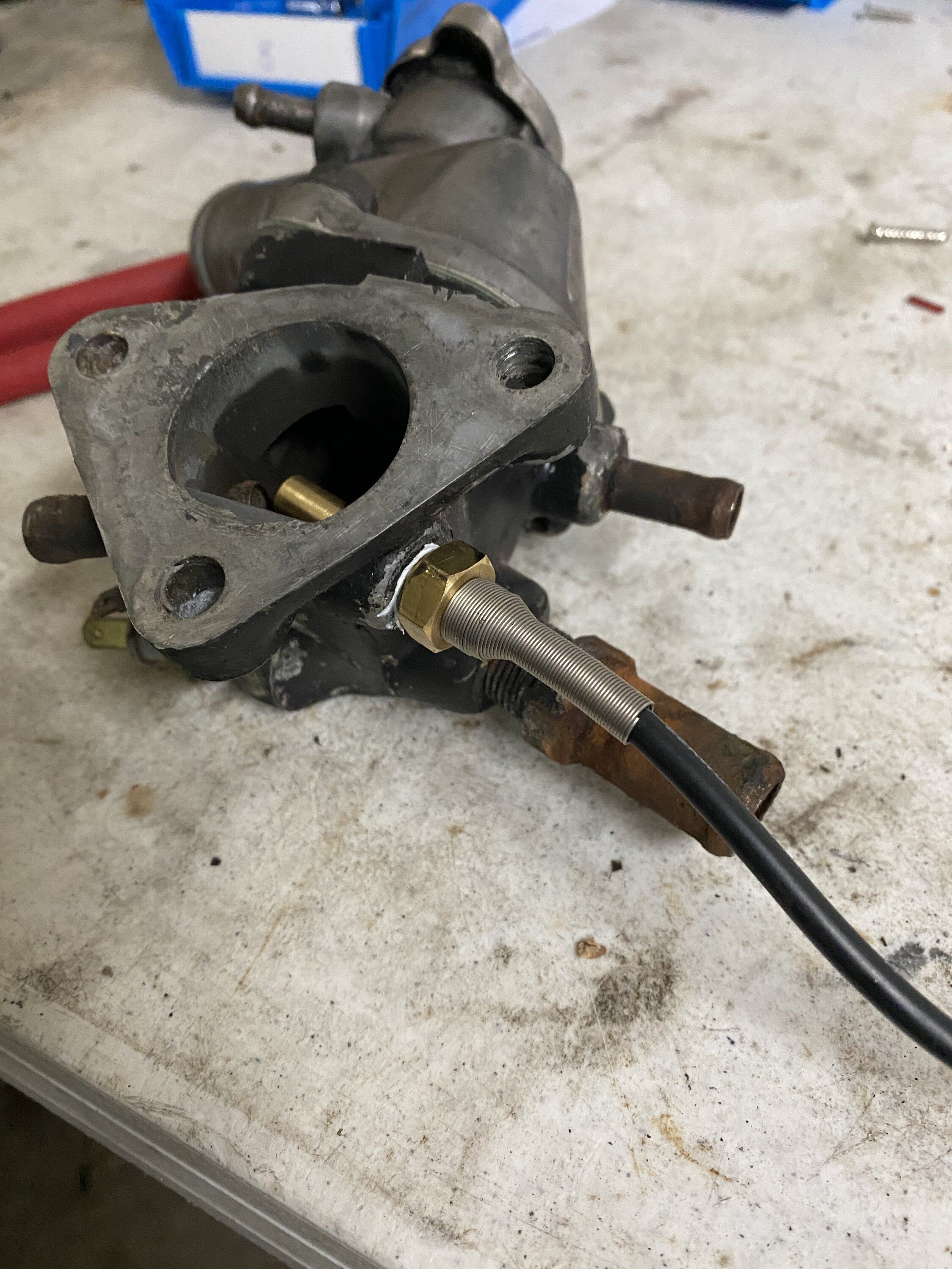

I located the coolant temp sensor in the back of the thermostat housing. It bolted right in without a struggle.View attachment 621557 View attachment 621560 View attachment 621561 View attachment 621562 View attachment 621563 View attachment 621564 View attachment 621565 View attachment 621566 View attachment 621567 View attachment 621568 View attachment 621569 View attachment 621570

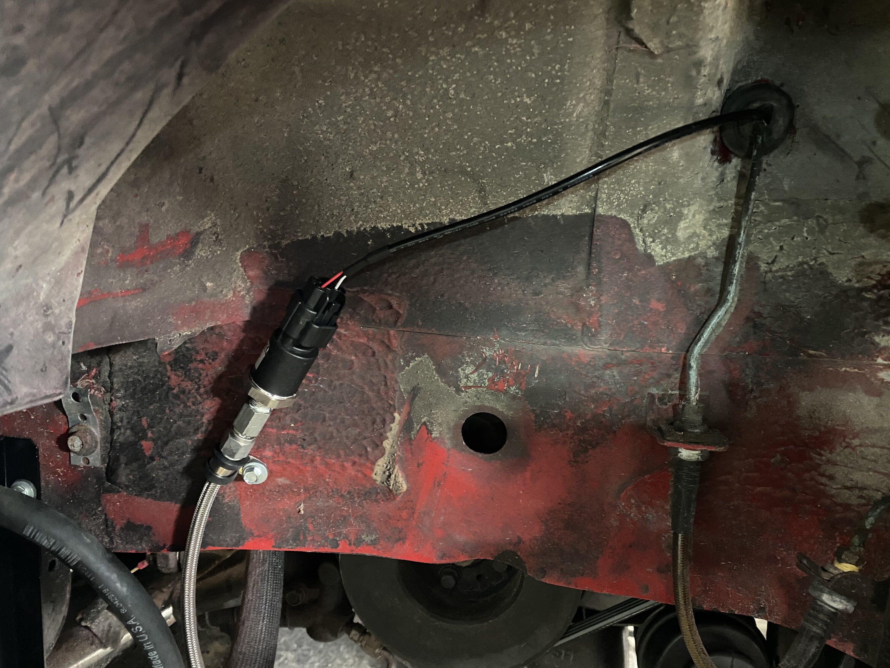

Quick ? on the Innovate oil pressure/temp gauge.
Did you only use the pressure sensor aspect of the gauge or did you throw the temp sensor somewhere as well ?
Thanks!
My thoughts too... LOL. Just double checking they are independent of each other and I don't need to install it for the gauge to function. Thanks!
