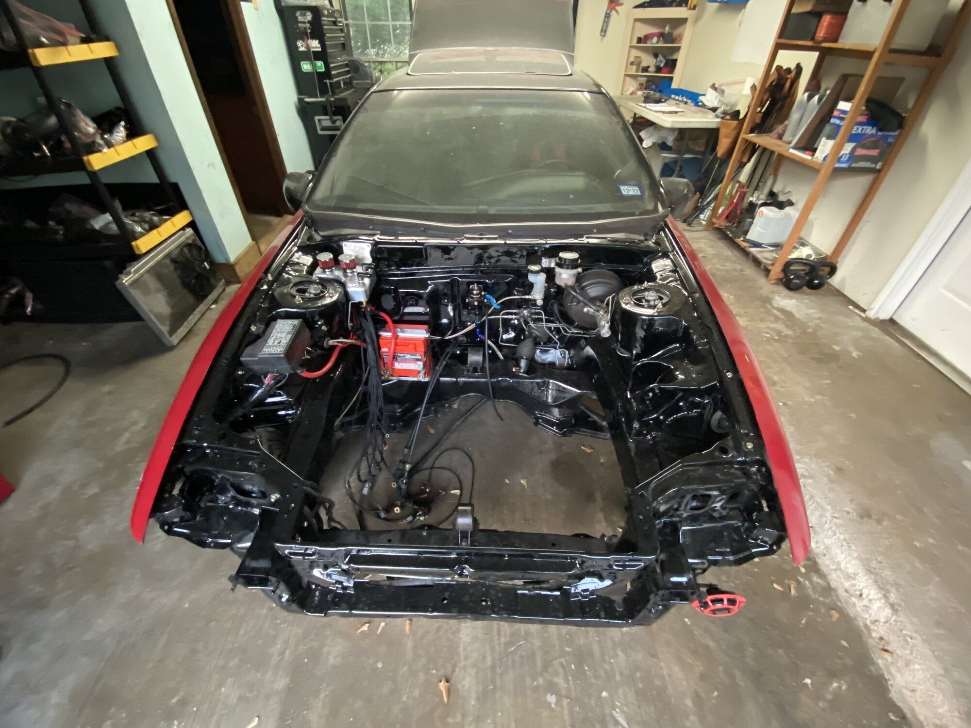

Well, the car is entering it's final form. I'm going all out with the engine out of the car. I stripped the car down further than I've ever stripped it before. Almost no interior, almost nothing in the engine bay. The car will be lighter and faster than ever with newer, better technology.
Updates to come:
1) new wiring harness
2) new battery/power setup
3) new engine
4) new catch can
5) digital dash with gps speed sensor
6) painted engine bay
etc etc

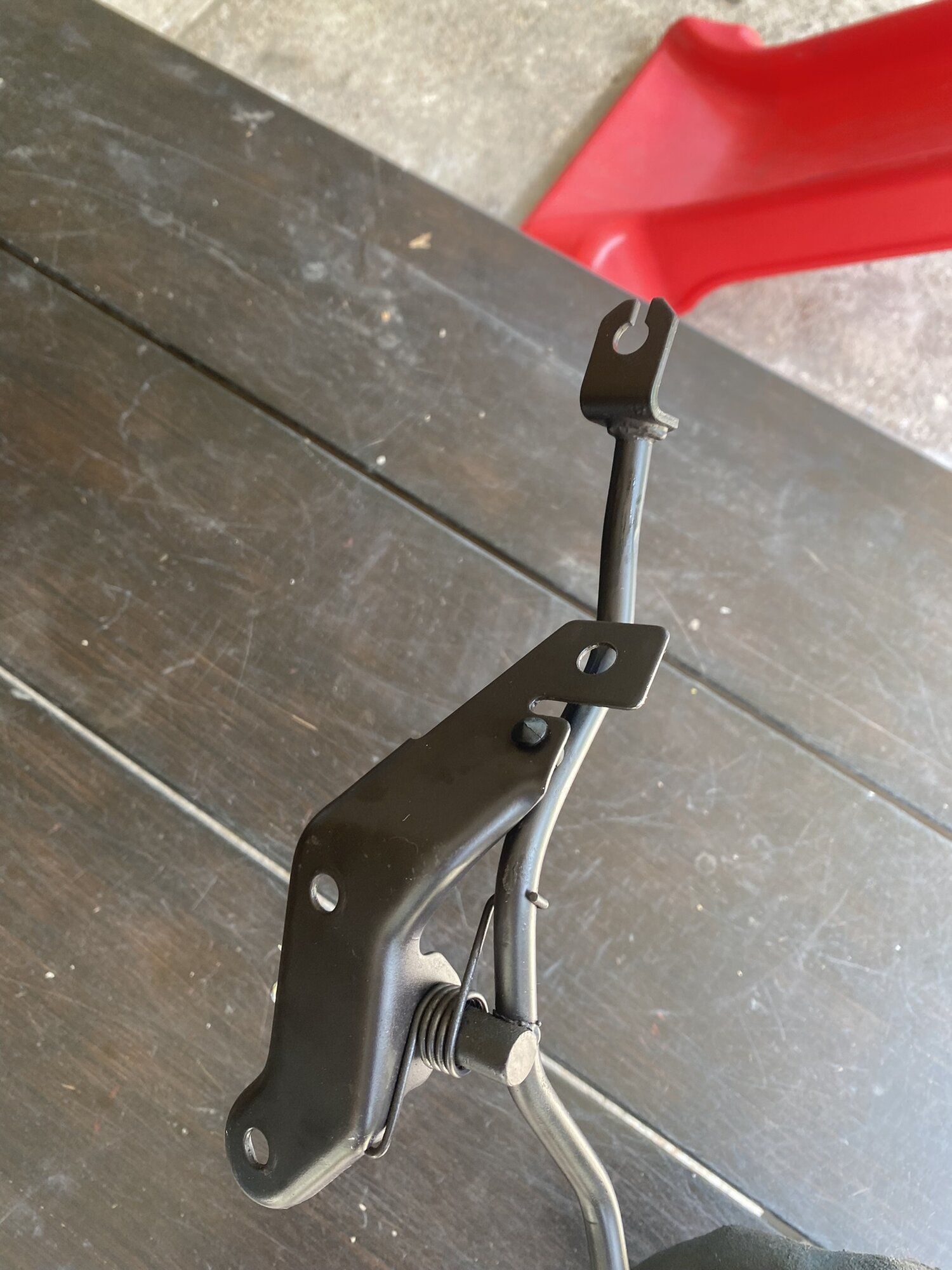

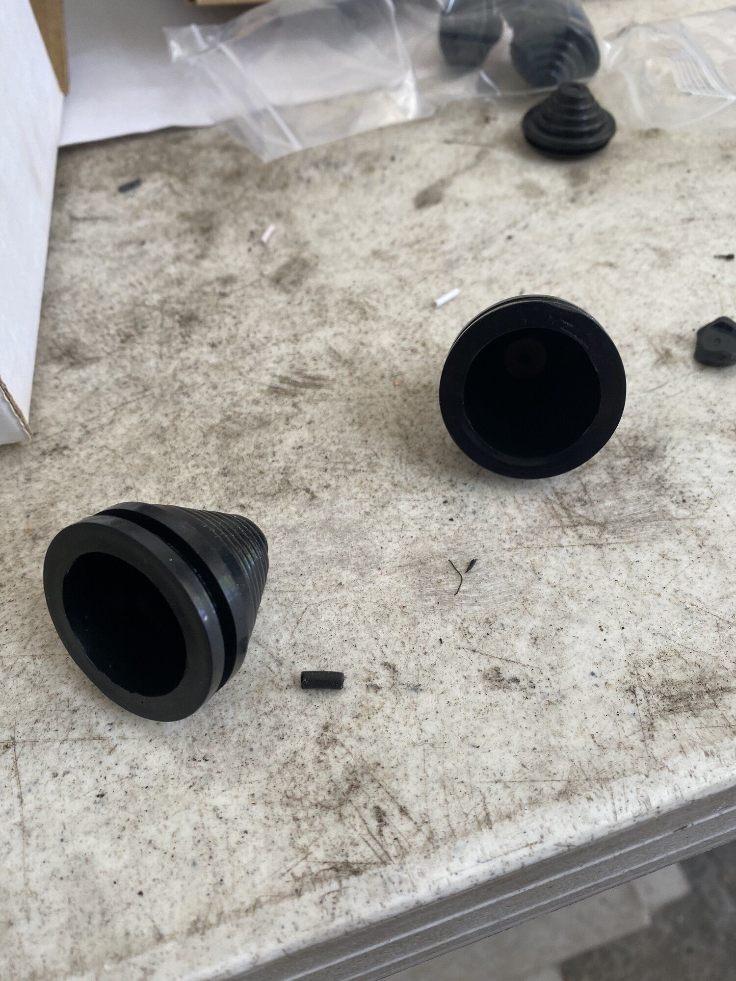

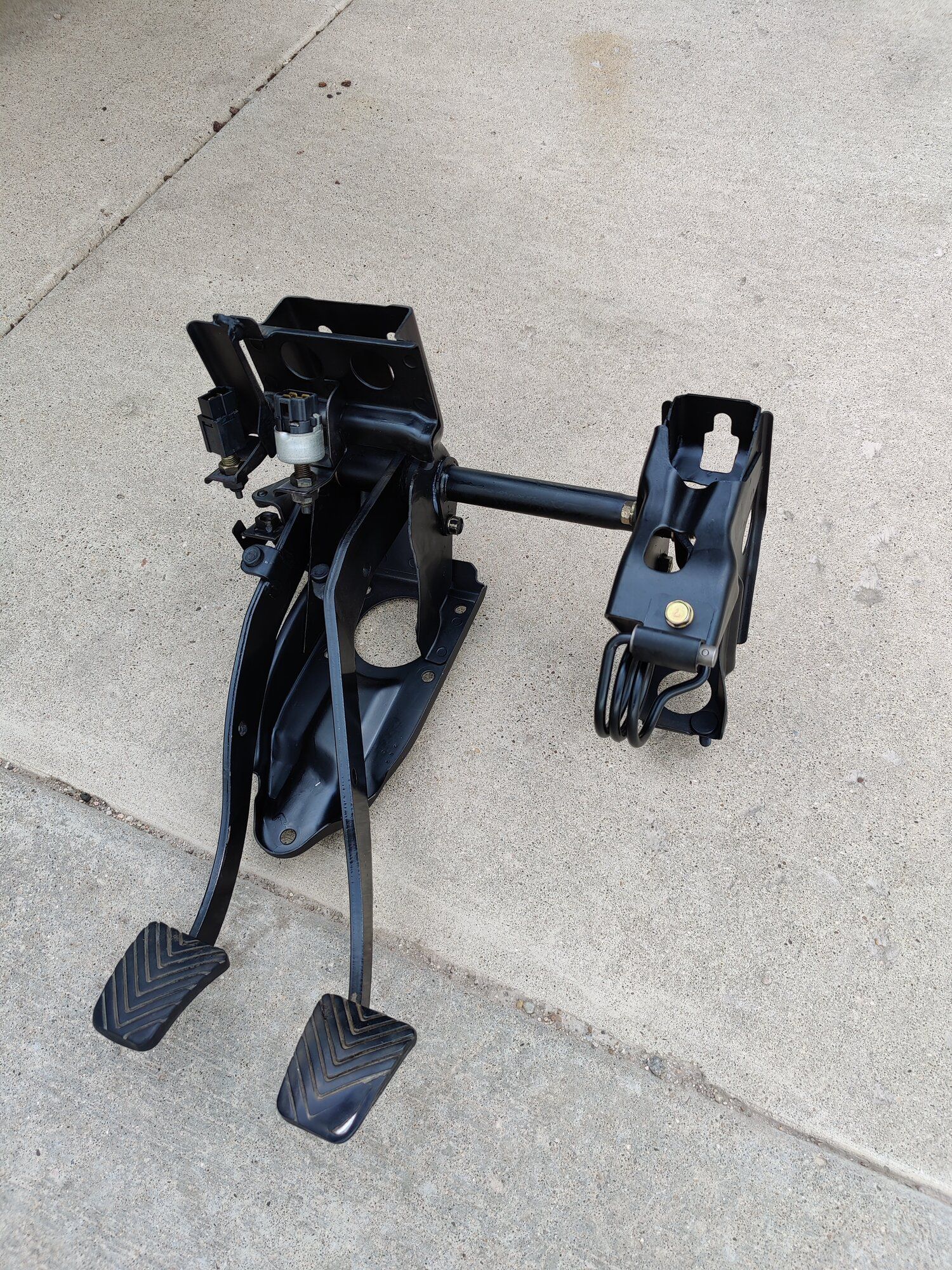

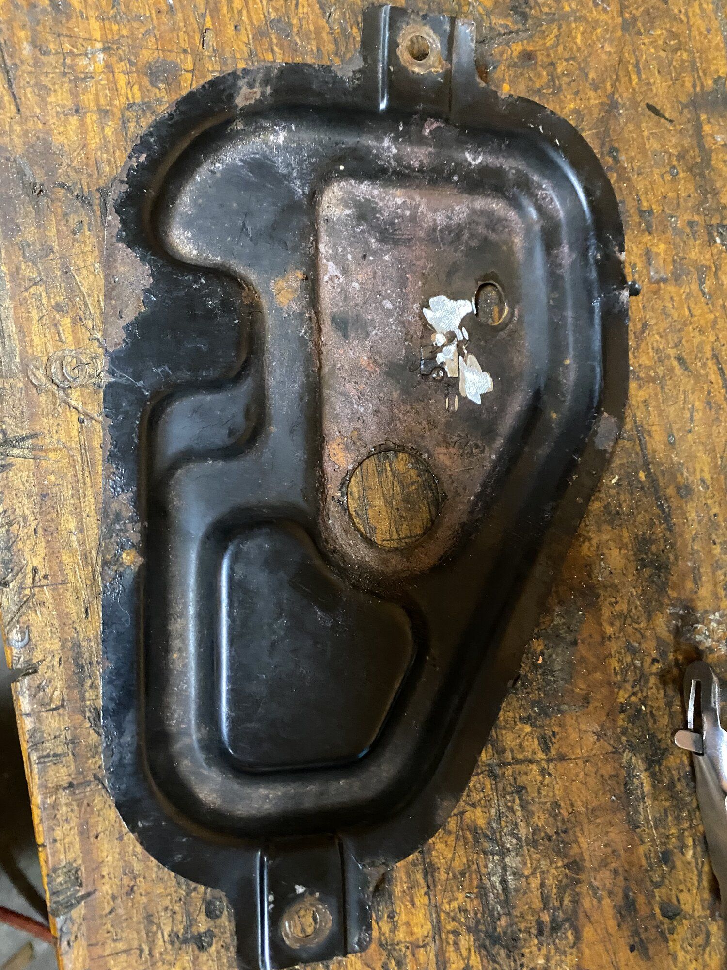

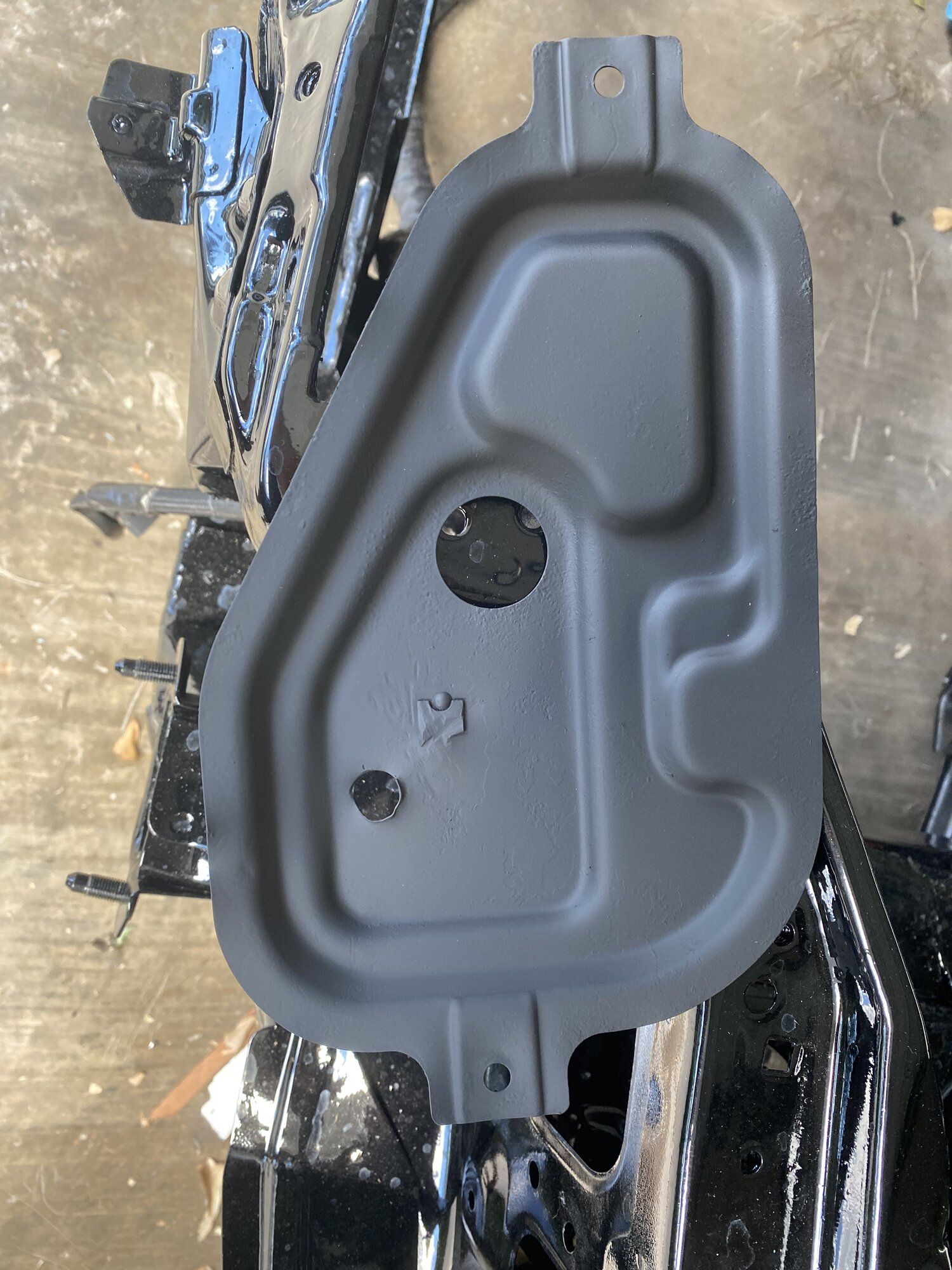

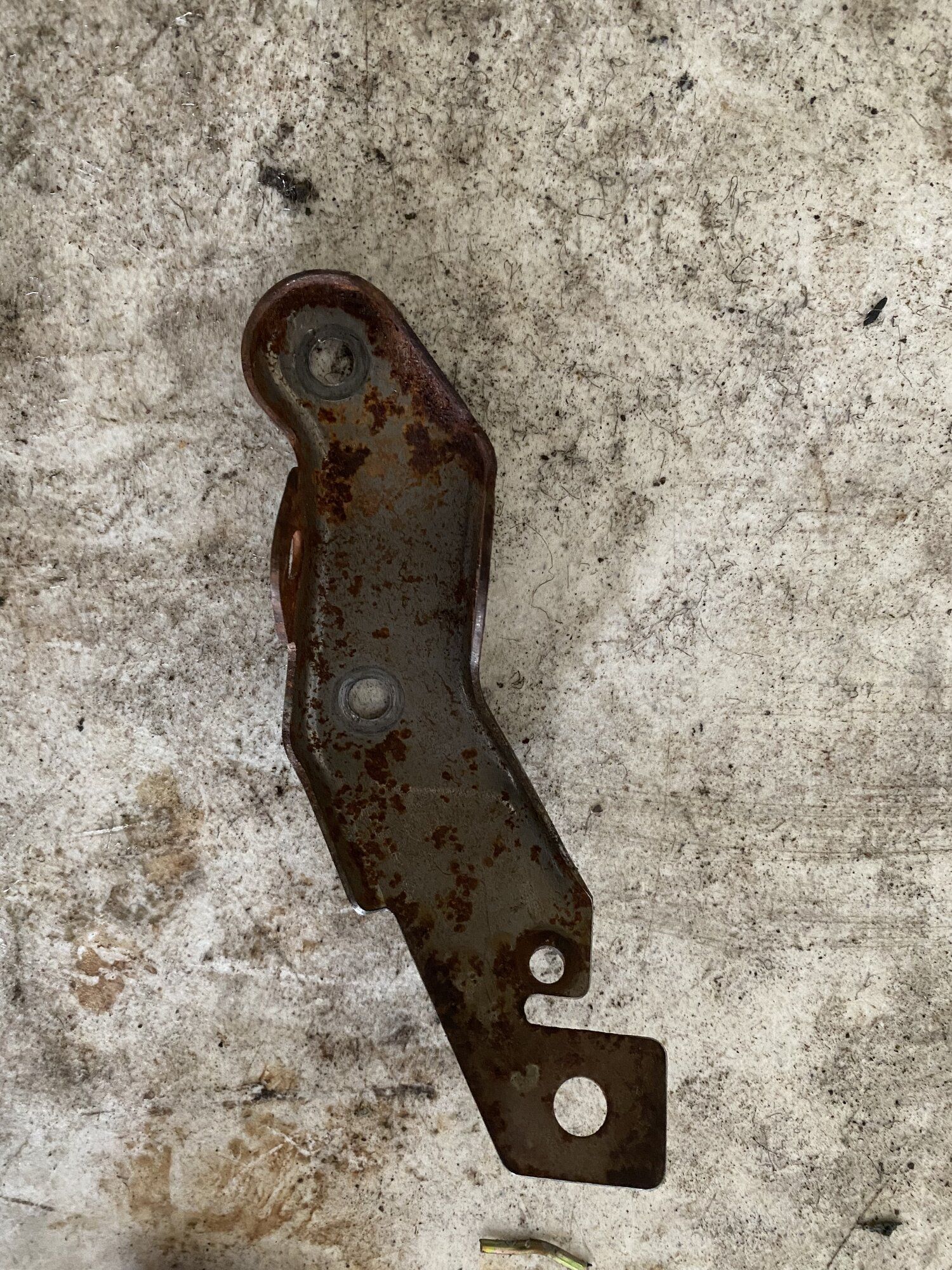

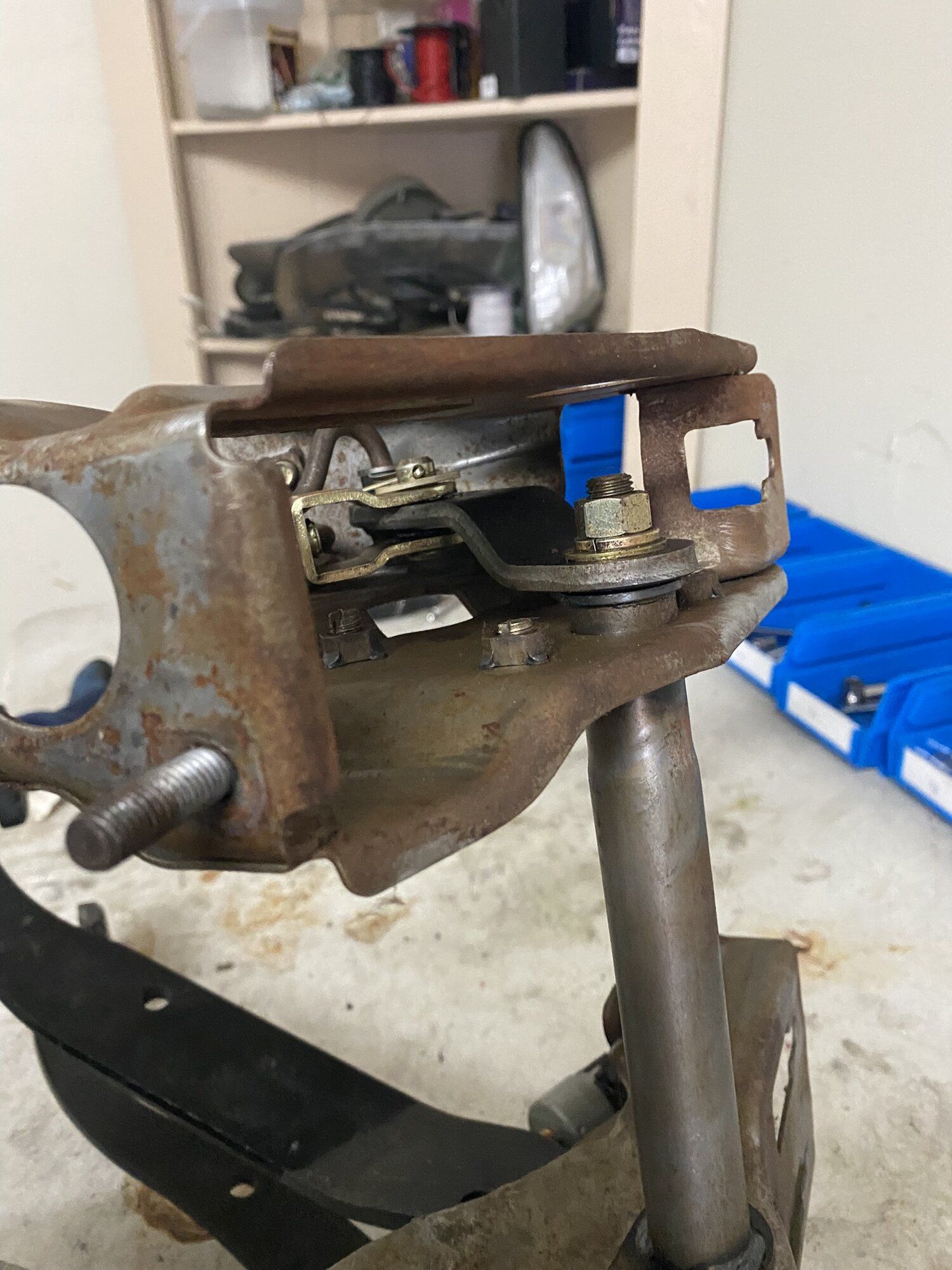

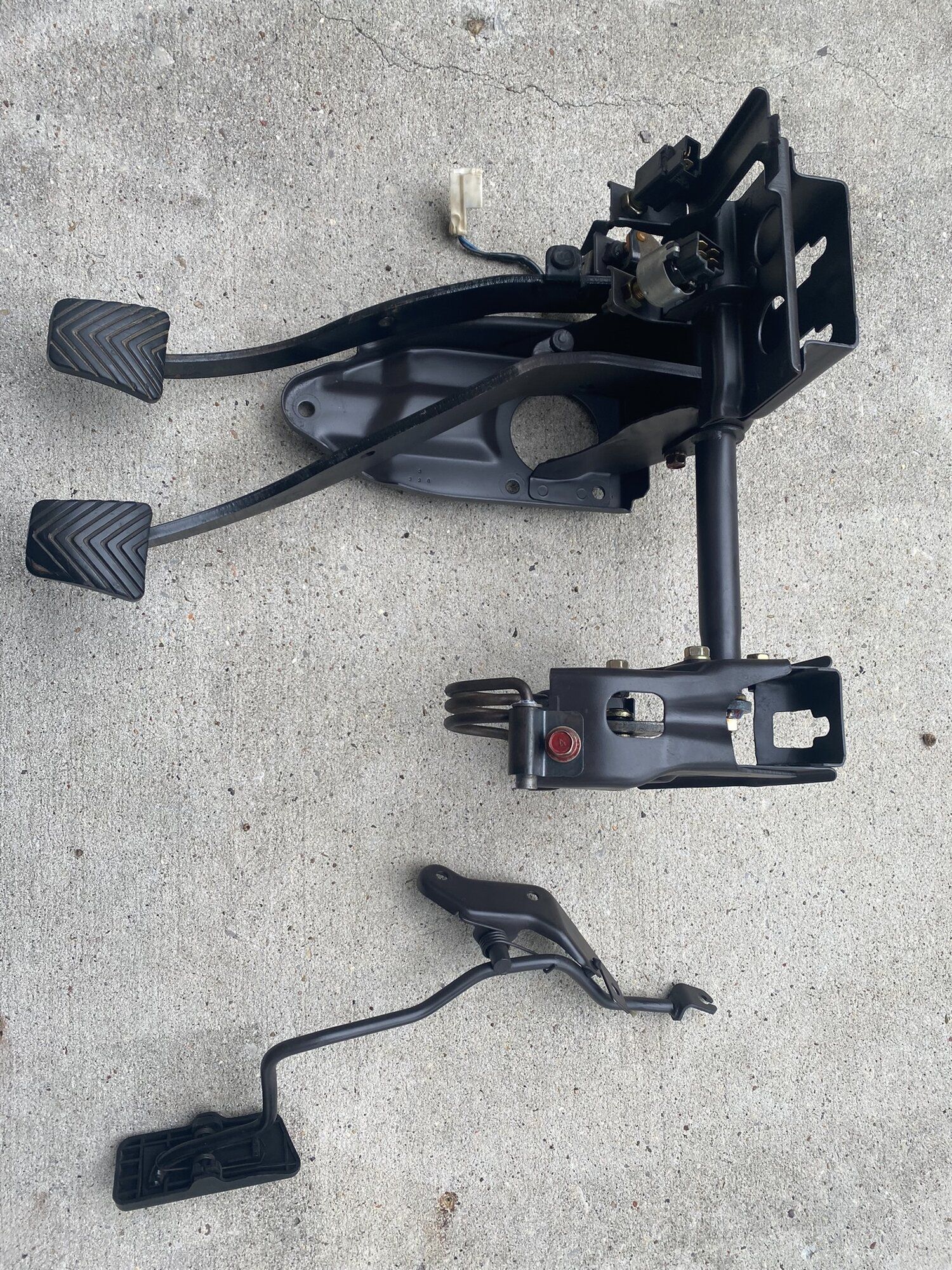

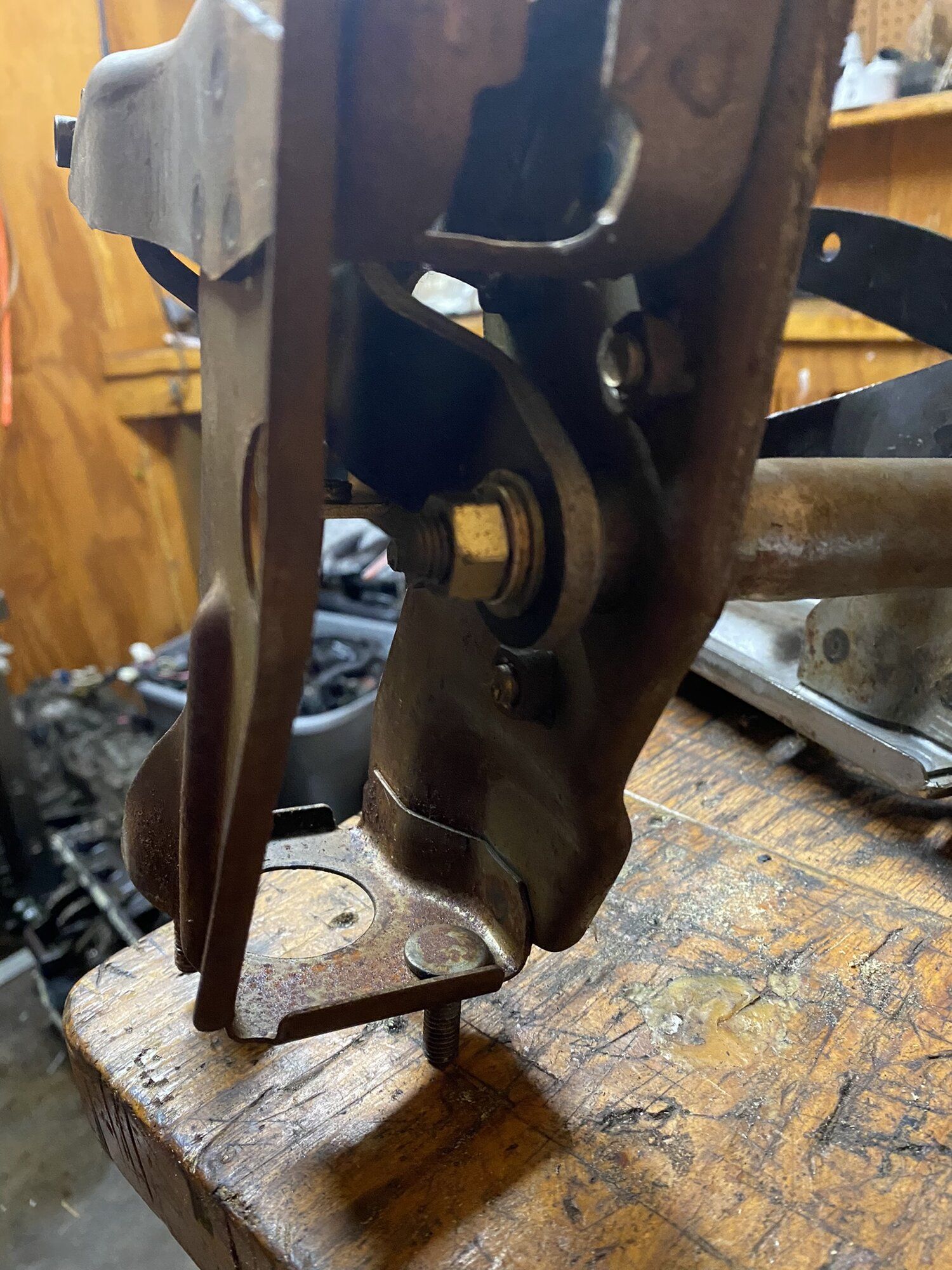

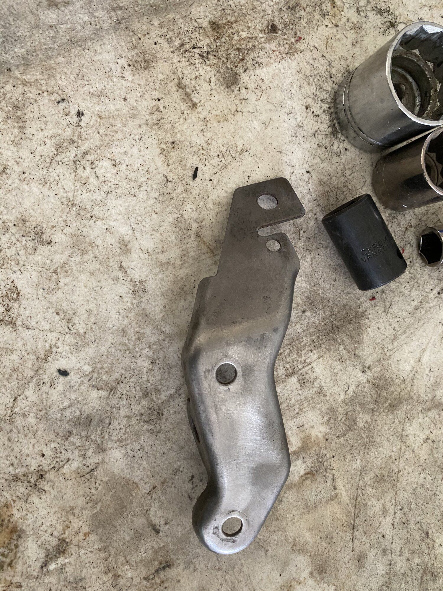

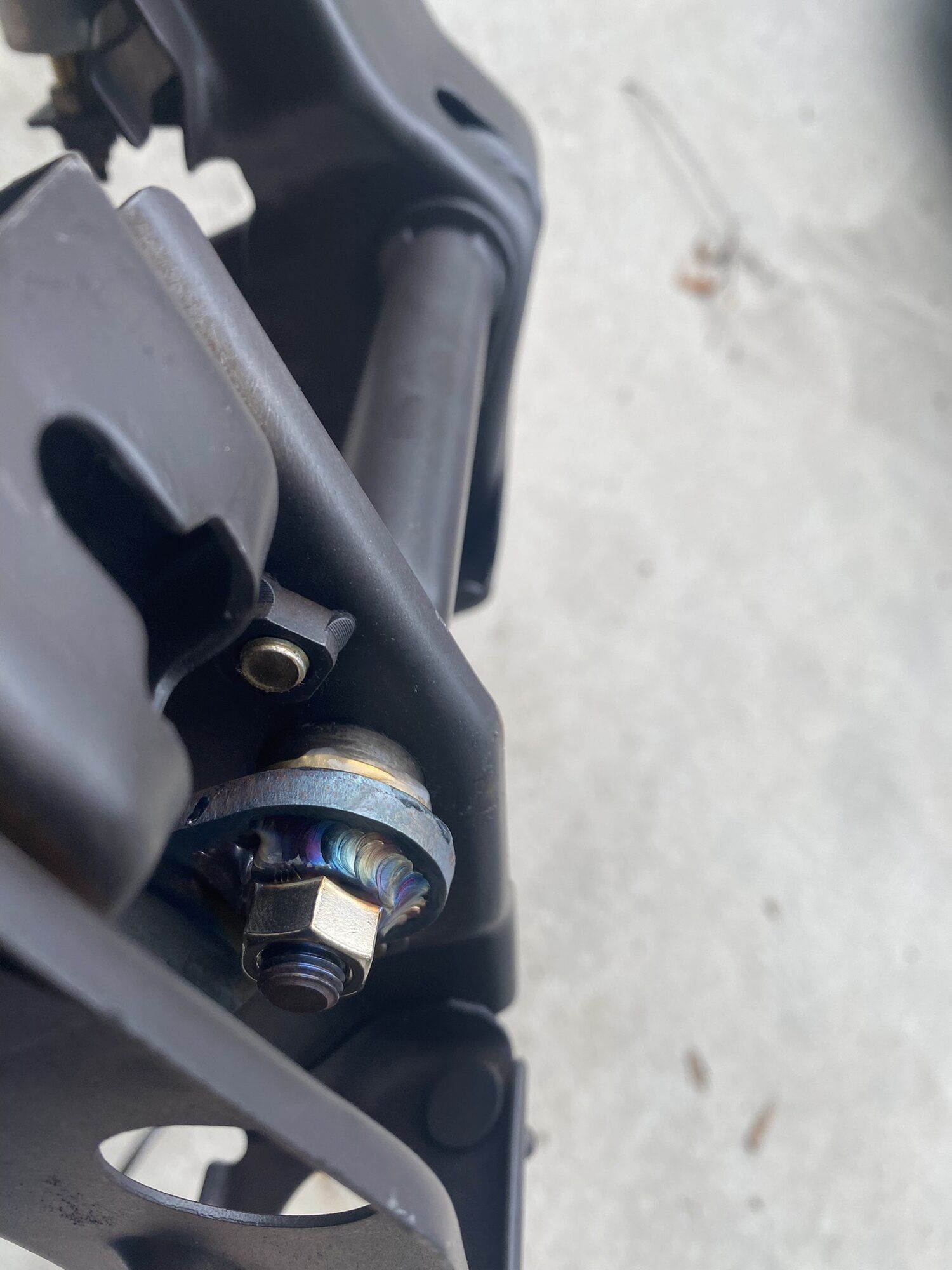

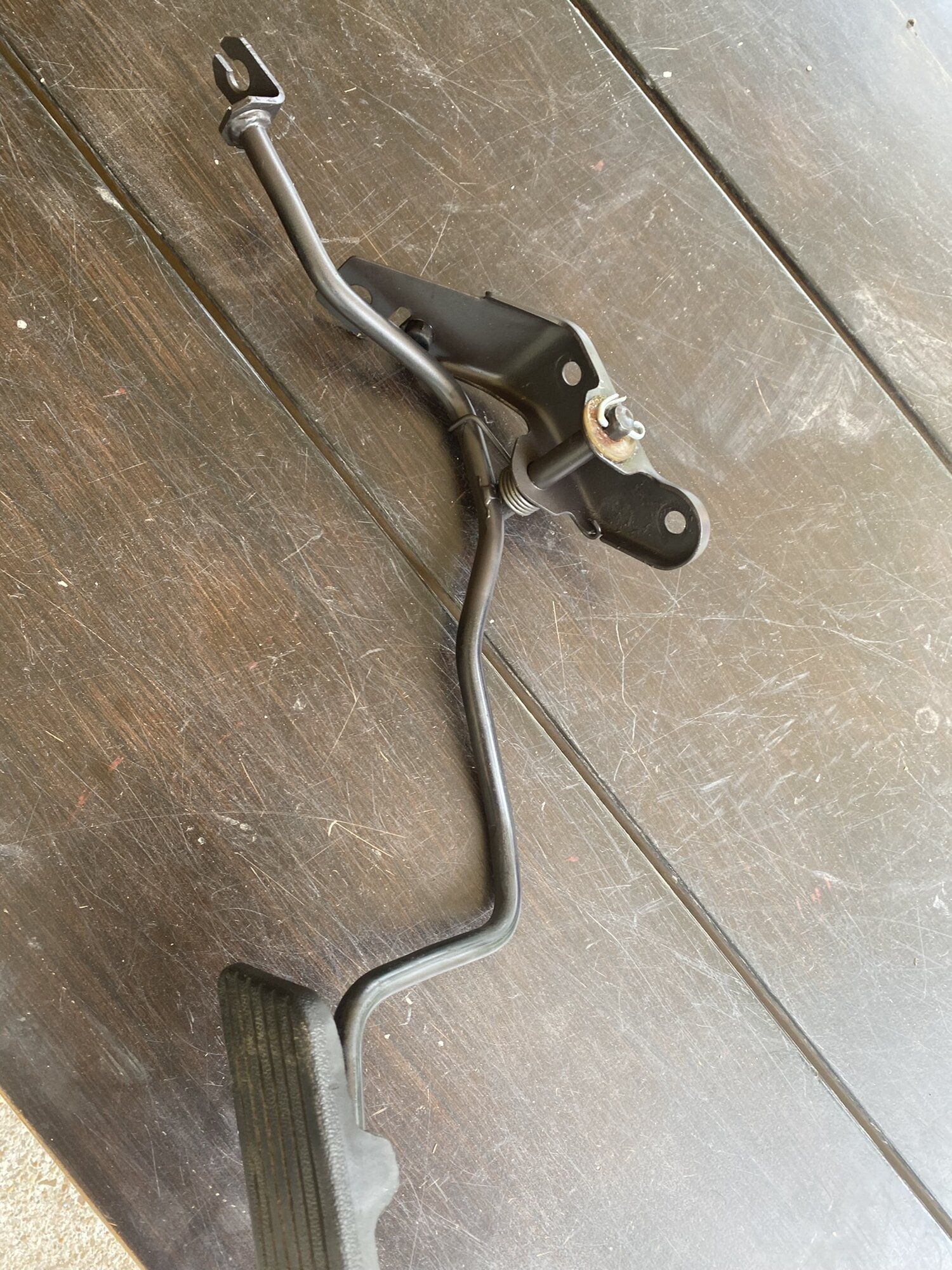

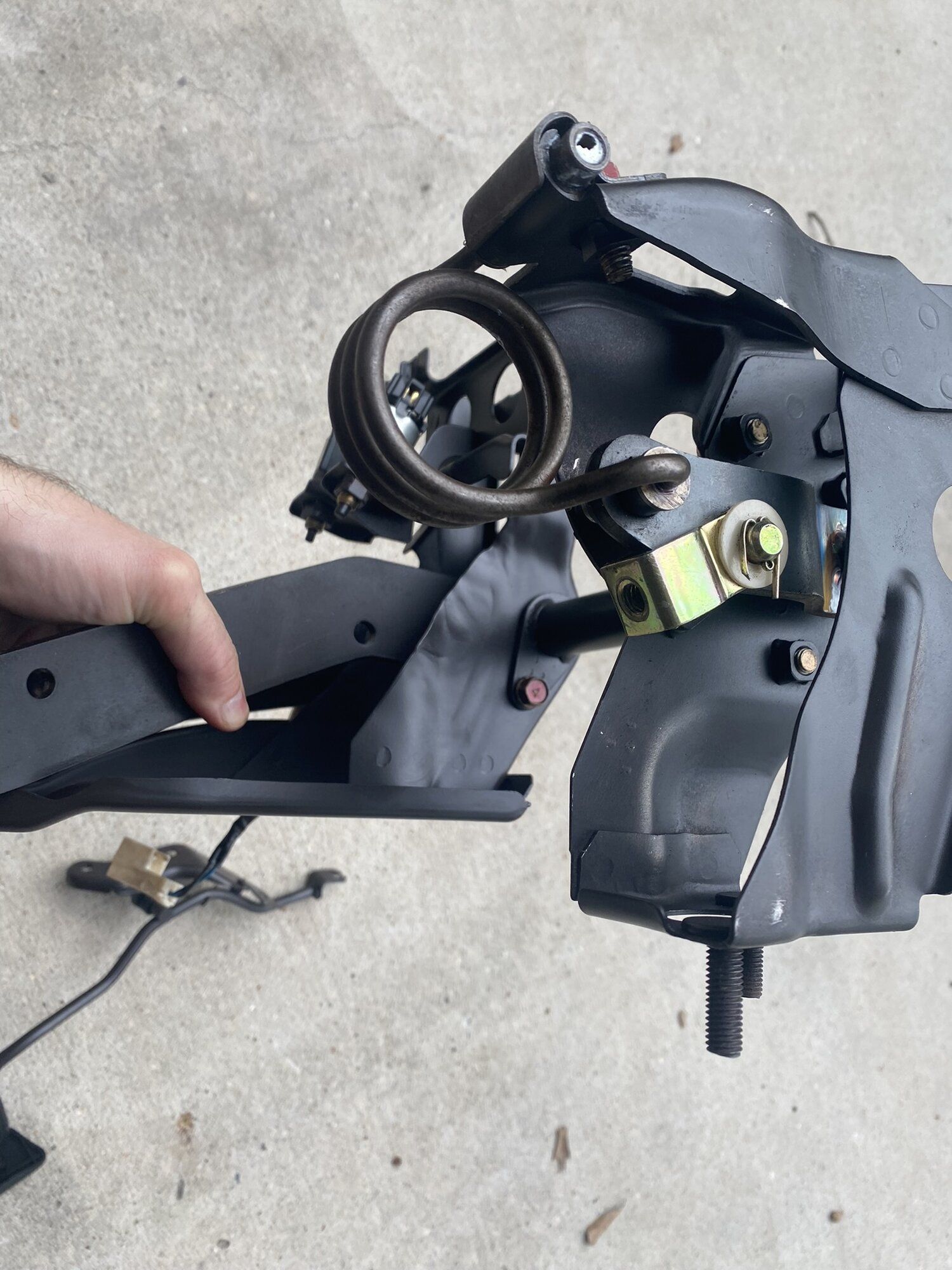

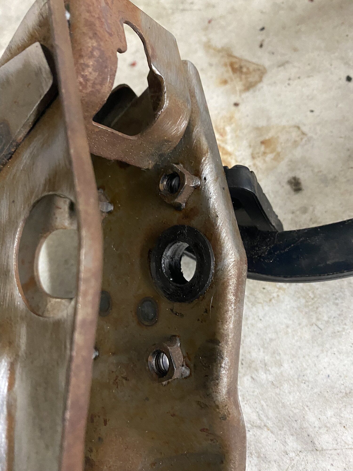

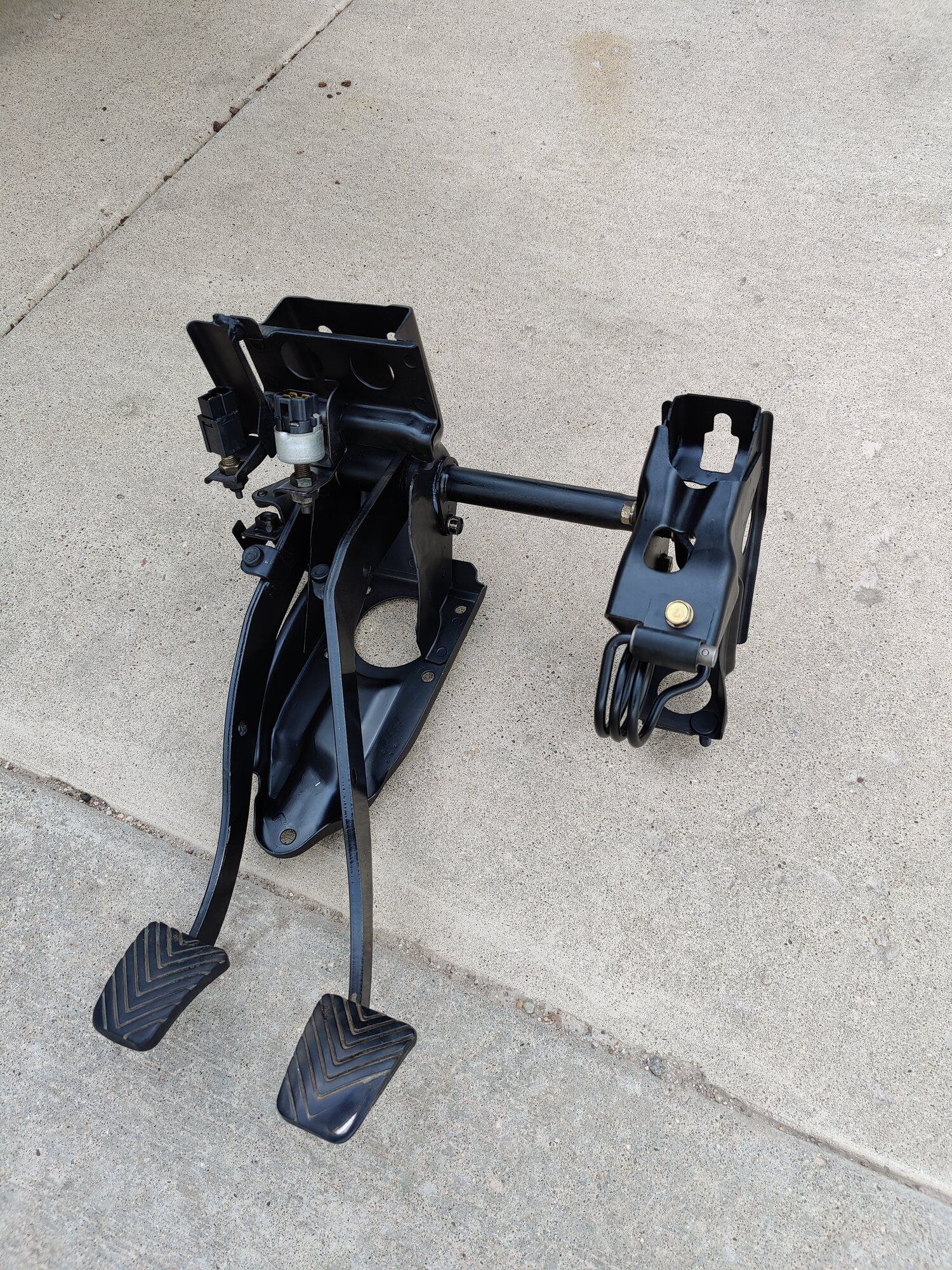

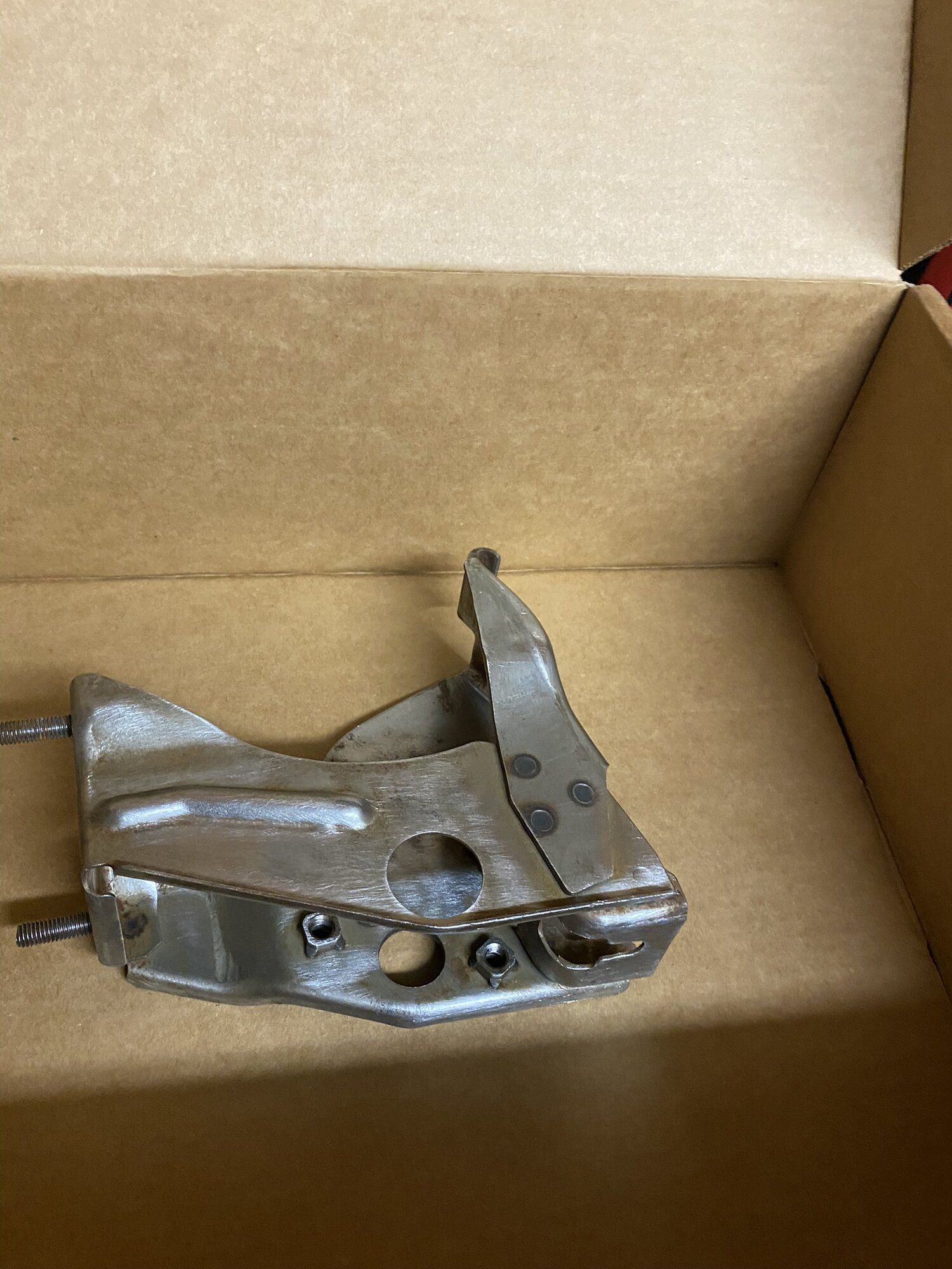

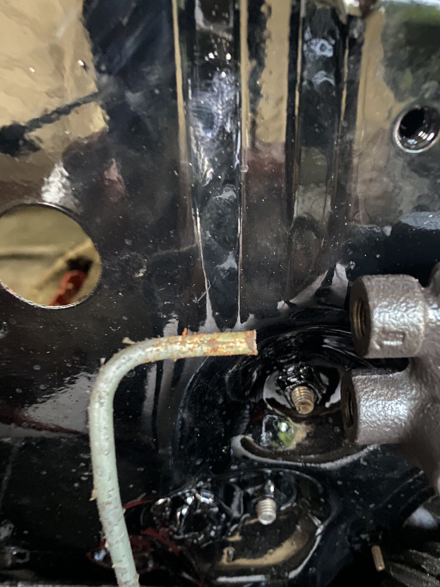

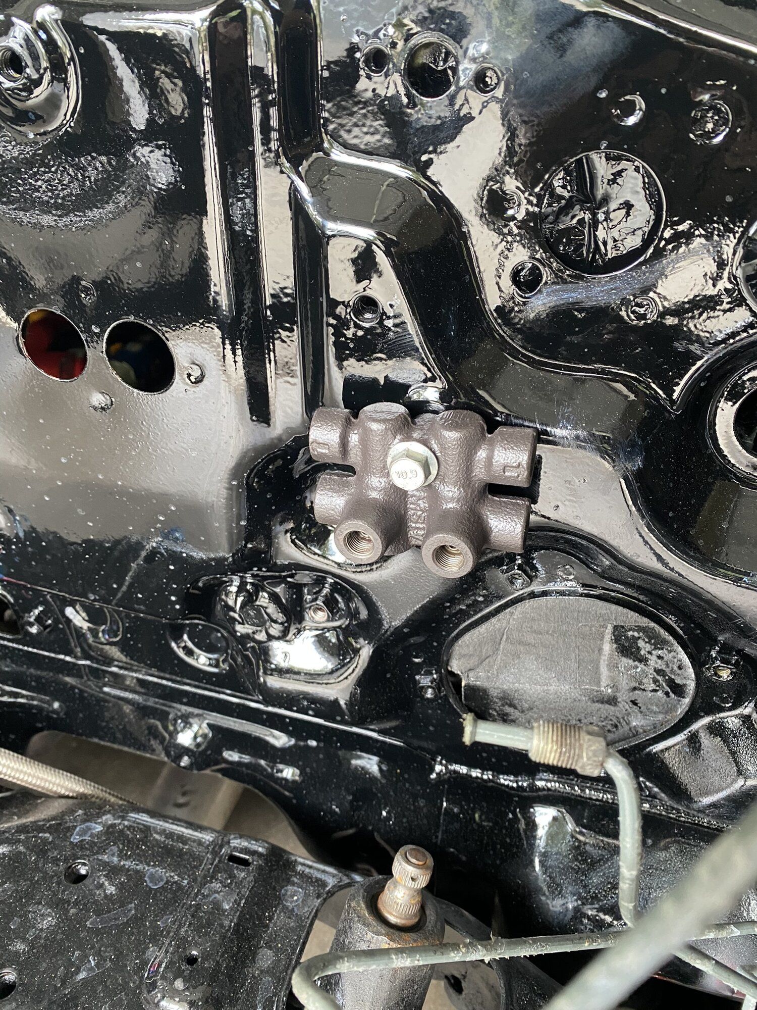

First on the list is a refurbished and welded clutch pedal assembly. Kind of a pain to takeout but all I have is time right now waiting on the new engine. I wire-wheeled each part down and hit them with the some rust treatment as well as Rustoleum 2x. Rustolem 2x is a great, cheap paint that tests very well in comparison with many other brands.
I installed a bronze clutch pedal bushing and had the clutch pedal welded in place. May I never have to do this again.

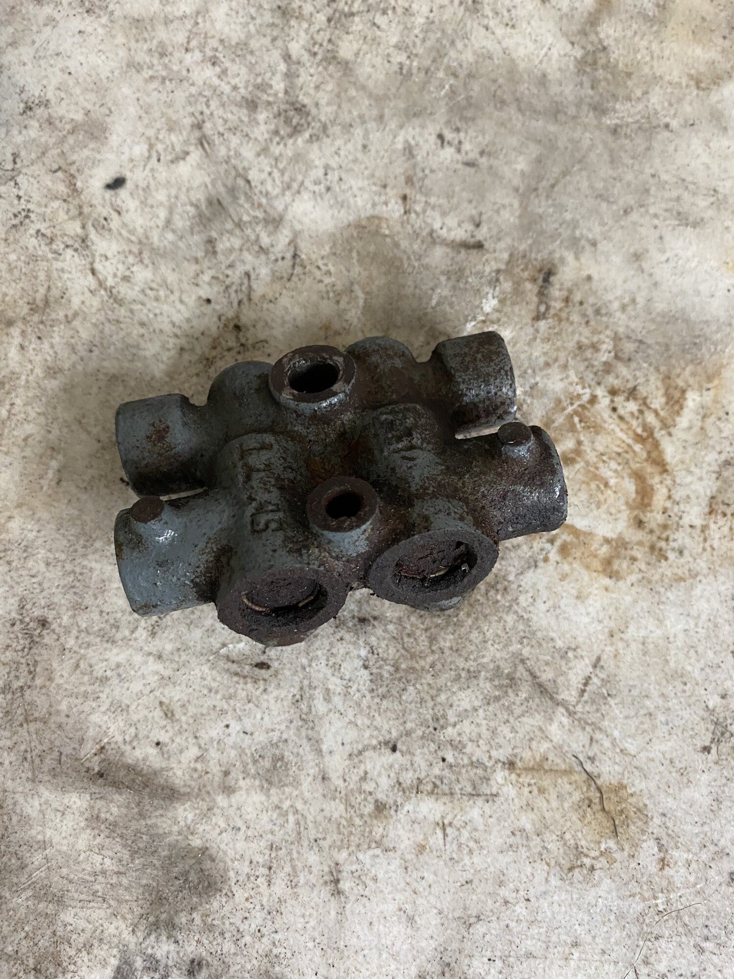

I did the same with my gas pedal and brake proportioning valve..

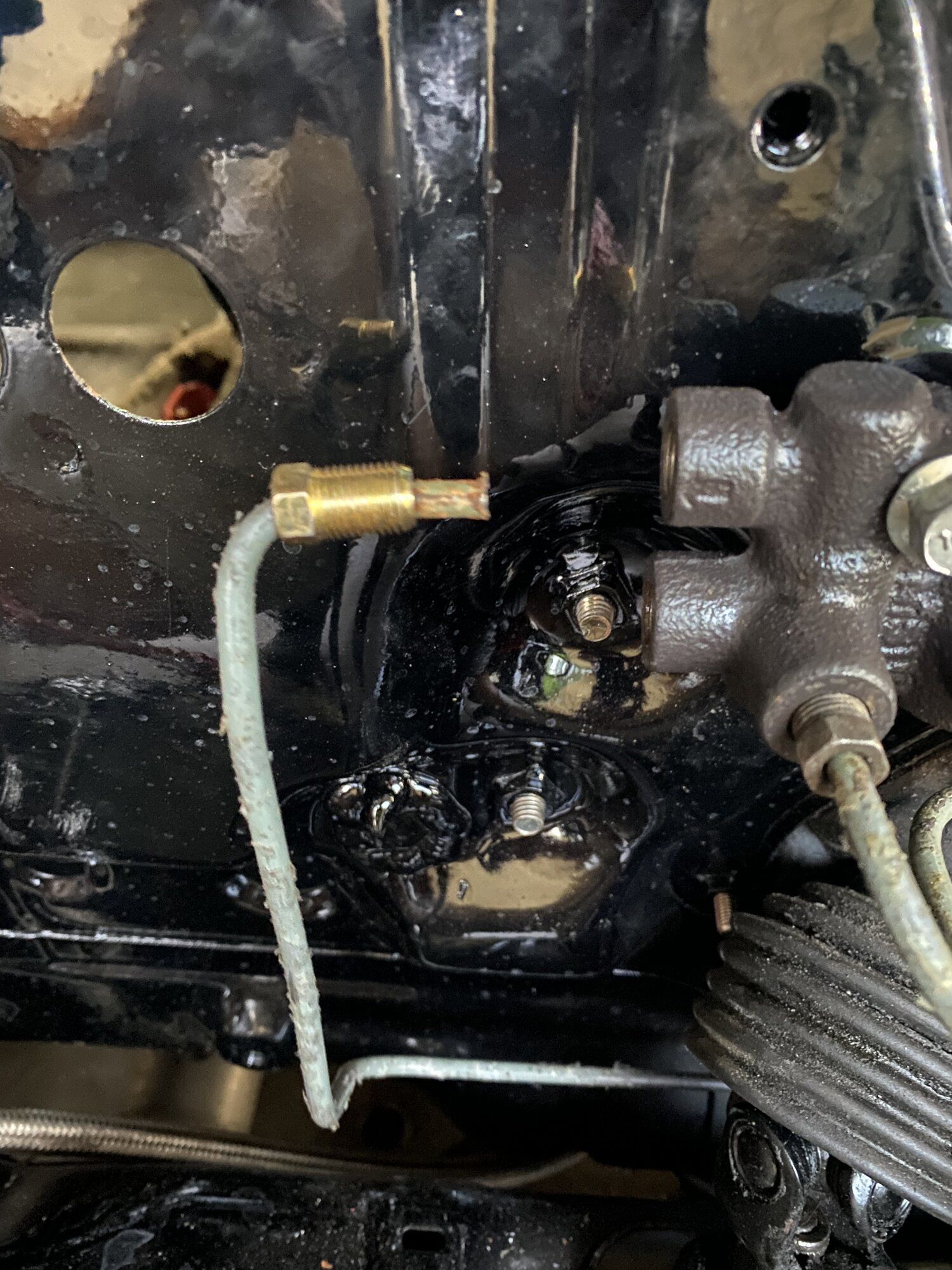

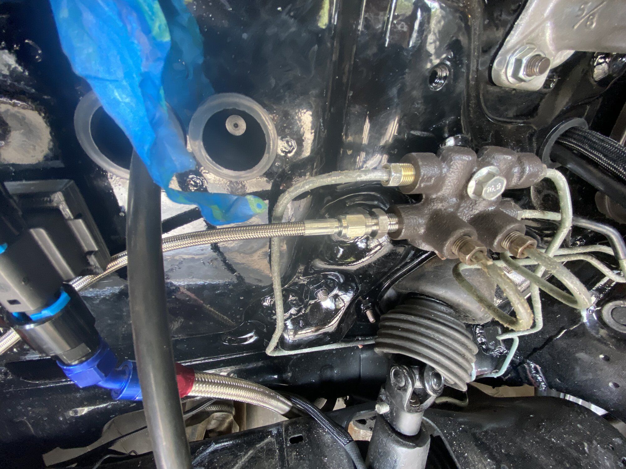

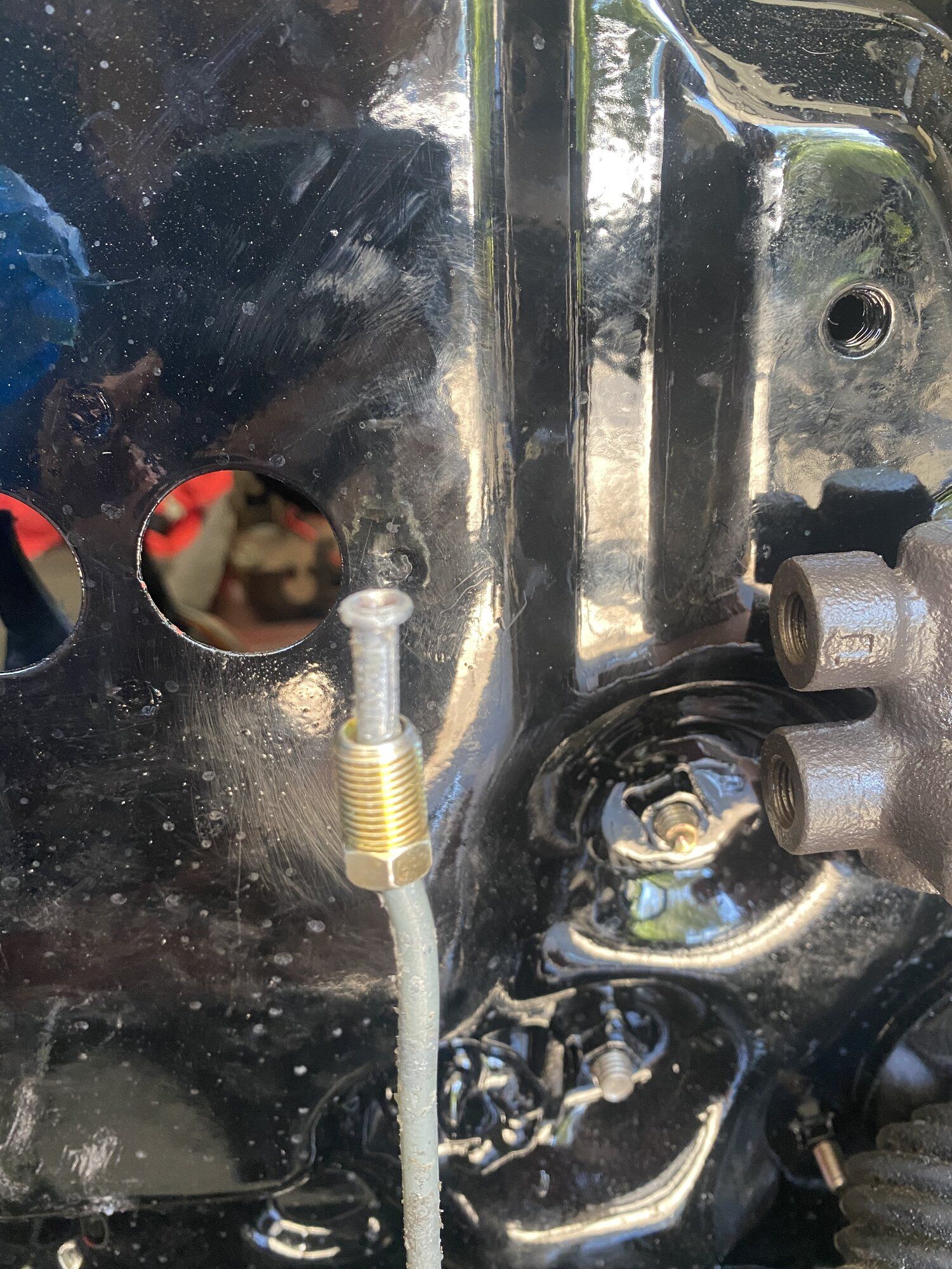

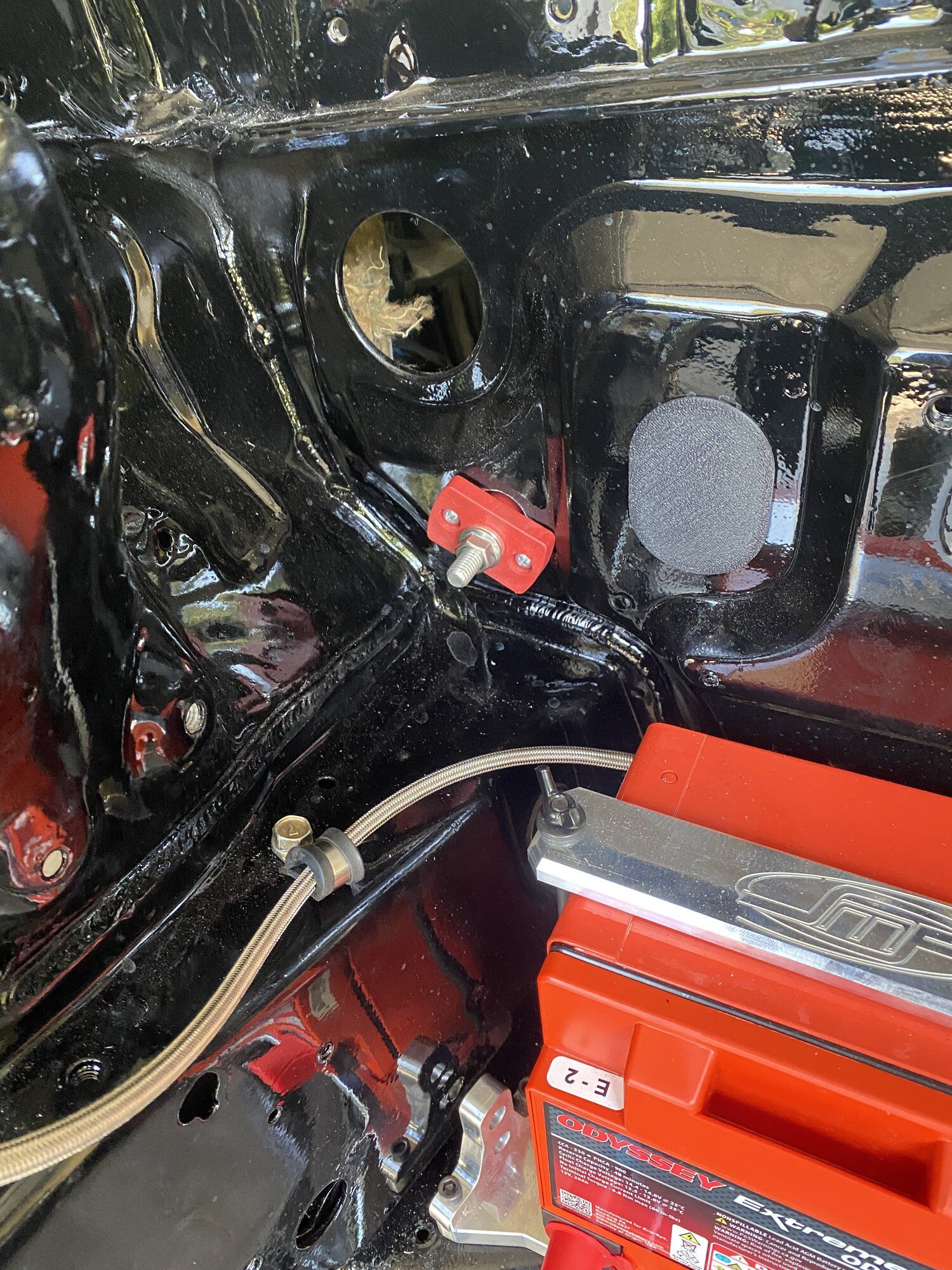

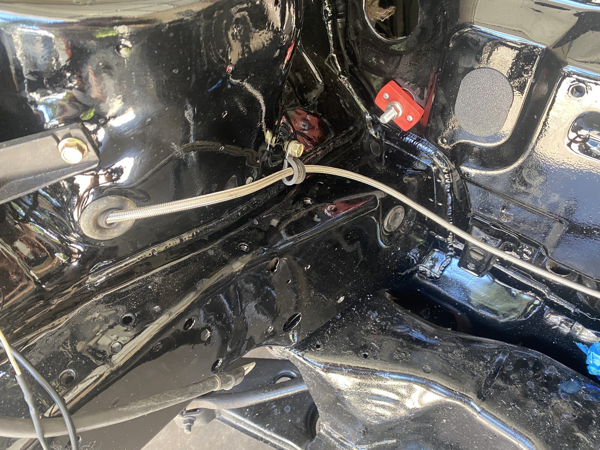

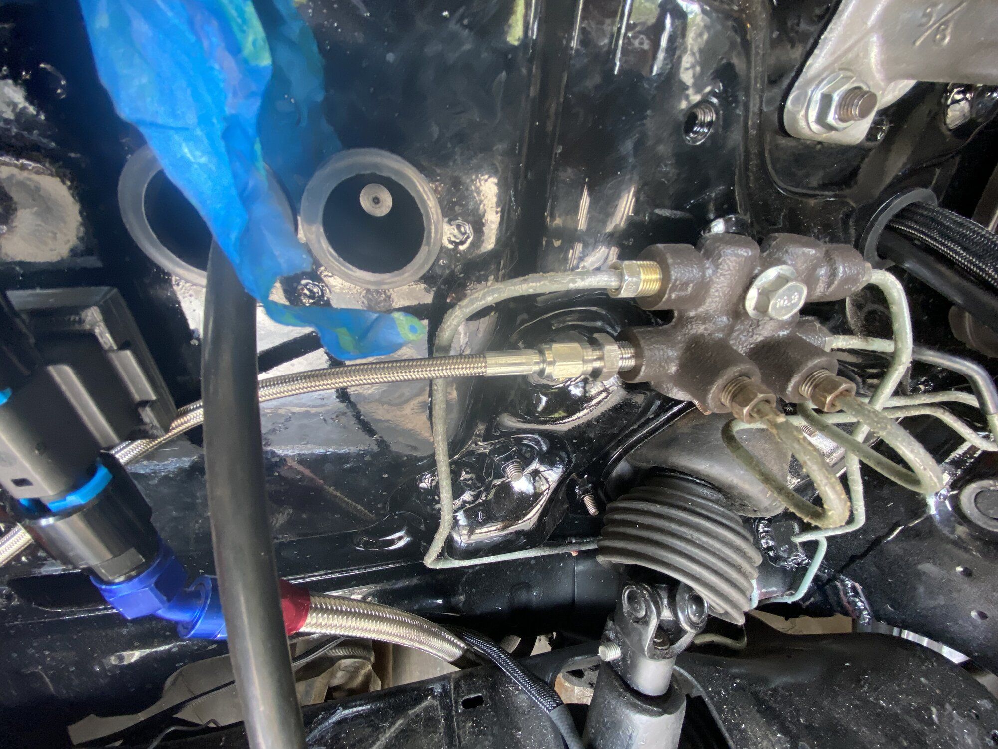

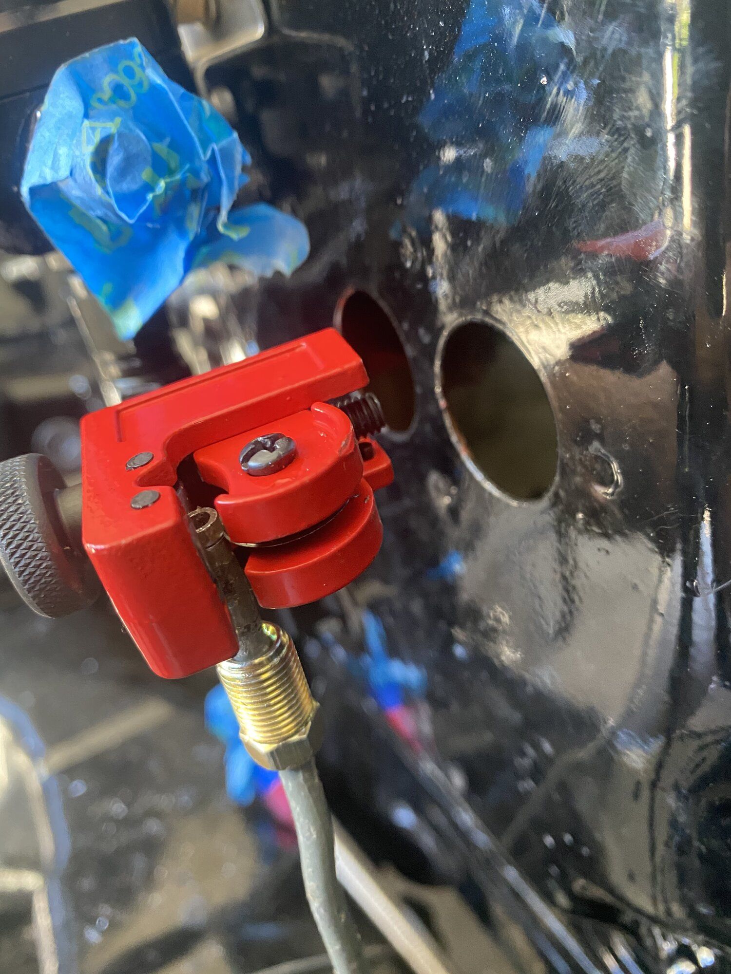

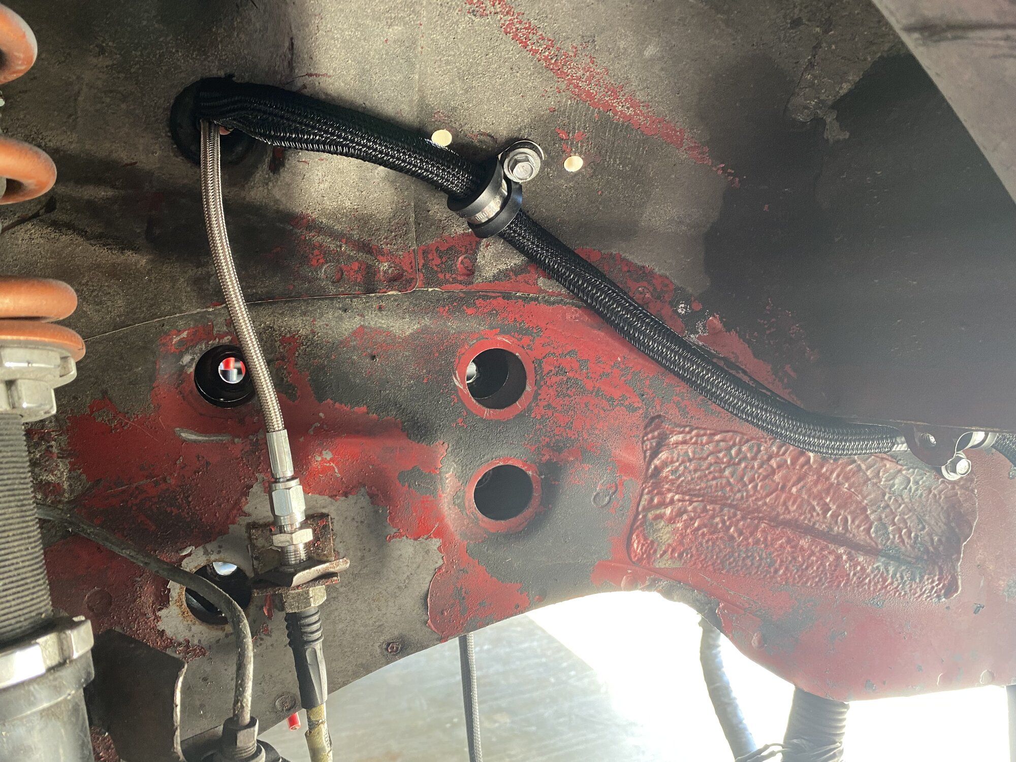

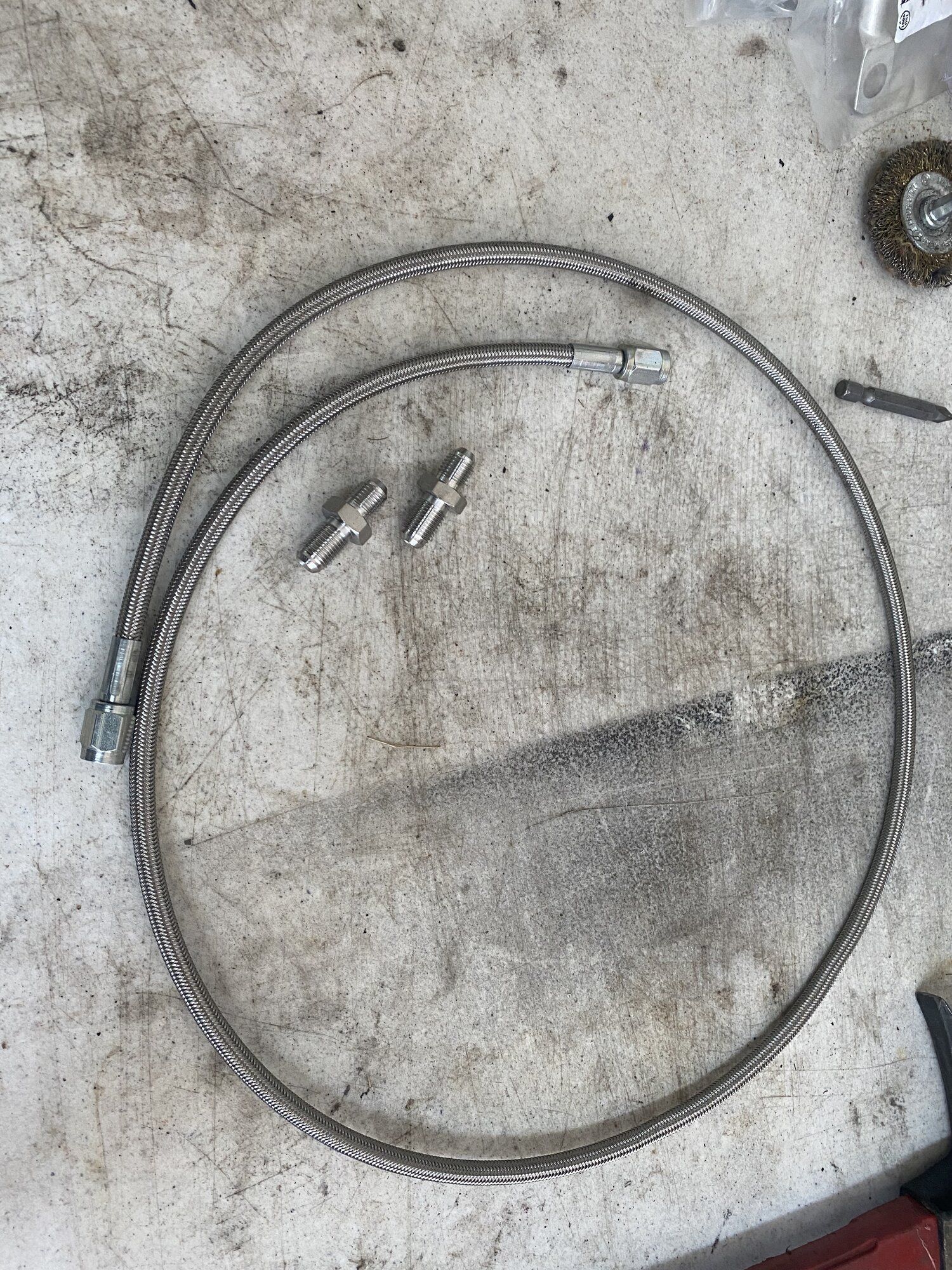

I didn't like how the front passenger brake line looked and sat in the engine bay. It ran right through my new battery setup, so I wanted to clean that up with some SS line with new fittings. I used 3an SS line at 42", which was the perfect length, and a 3an to 10mmx1 adaptor fitting. I secured it to the frame using existing bolt holes that were in convenient spots.
D81E749A-E3A4-4911-ADBE-B54512A637CE.jpeg42F990CF-A404-4333-8044-39F1F6379881.jpegAEEF9BB1-AC1B-4332-BE04-632EEB0546DA.jpeg7BA06510-C2E2-4CBB-AFE7-AEC292886B37.jpeg

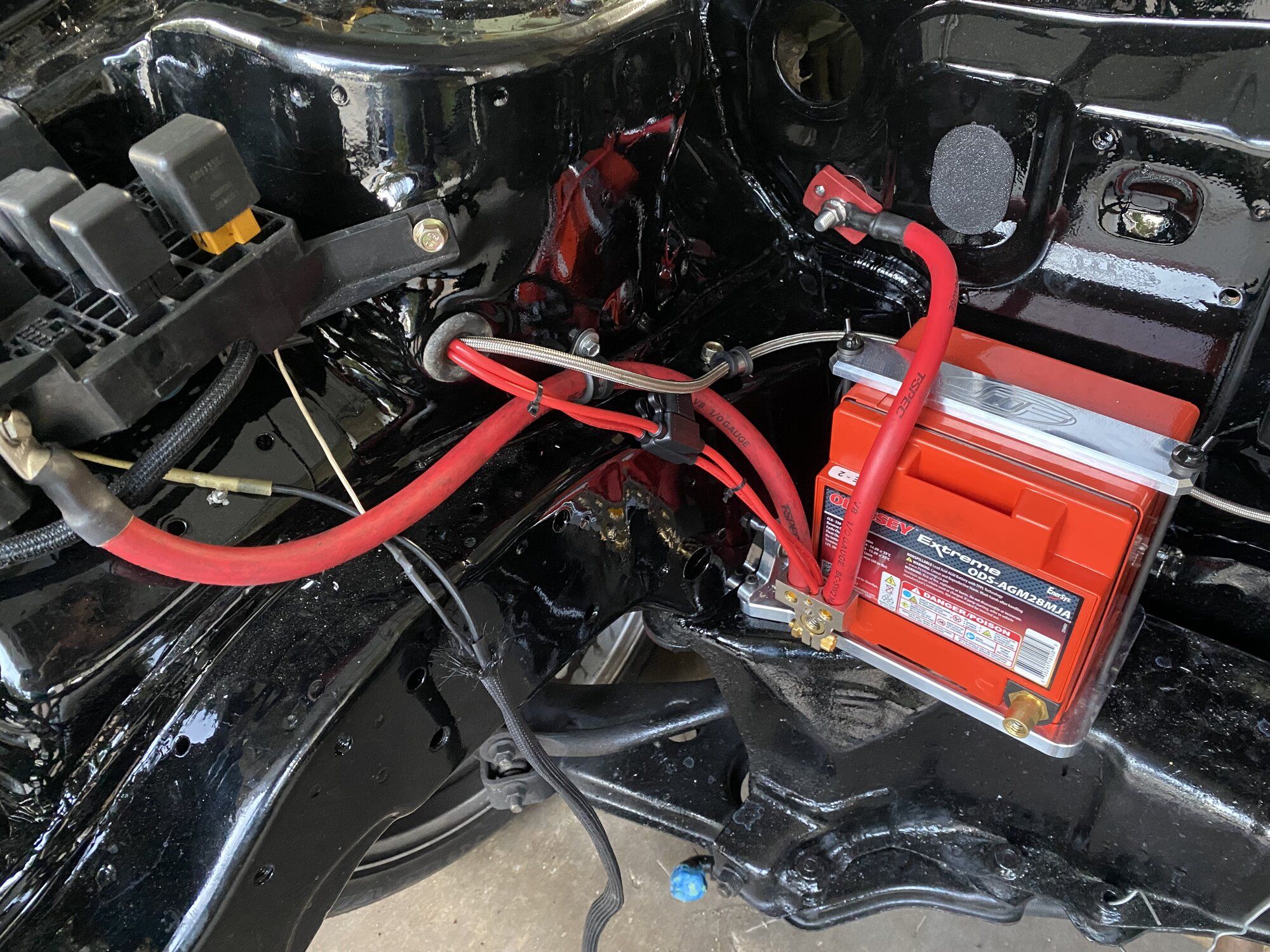

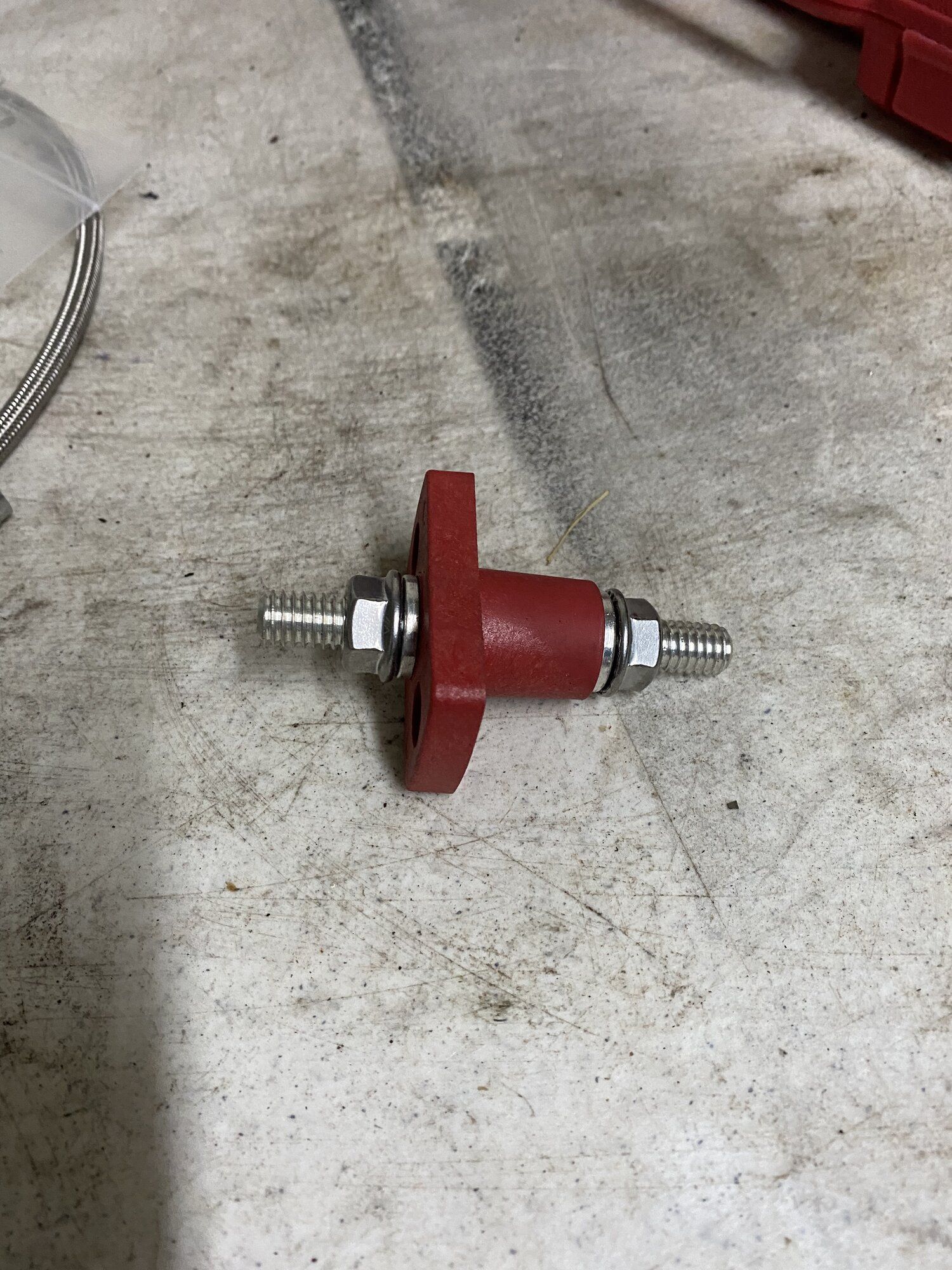

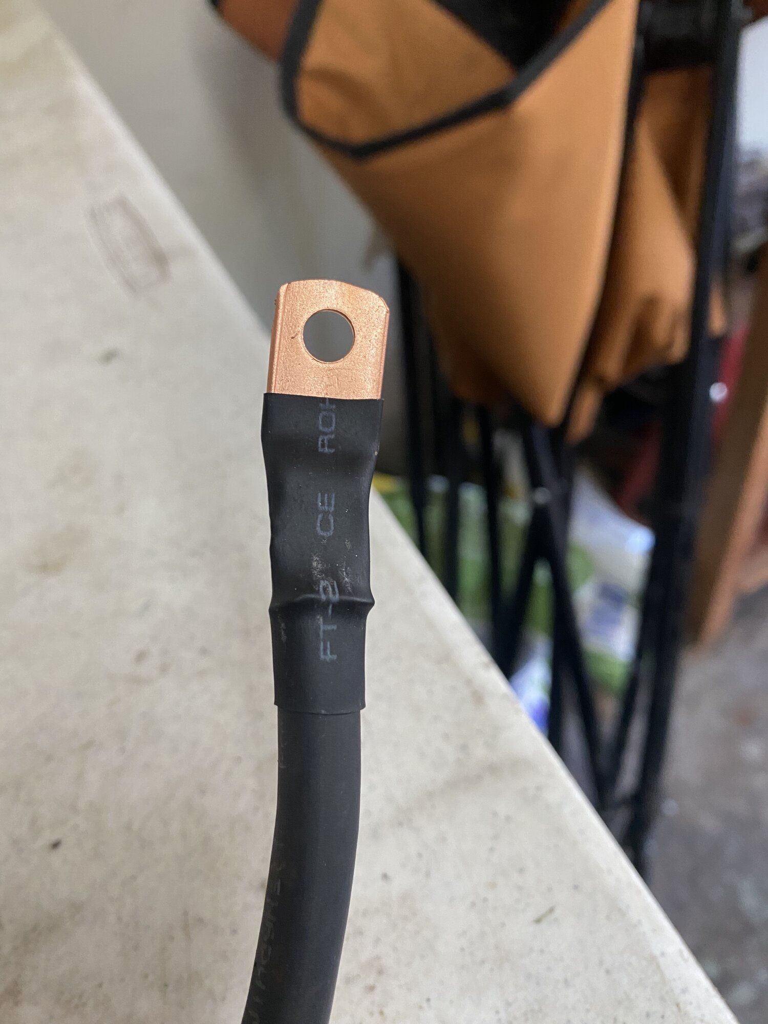

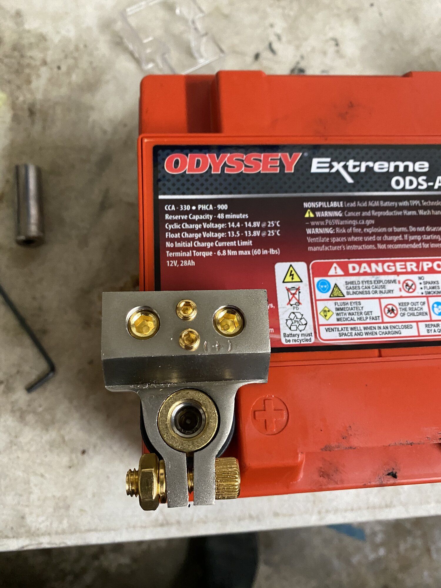

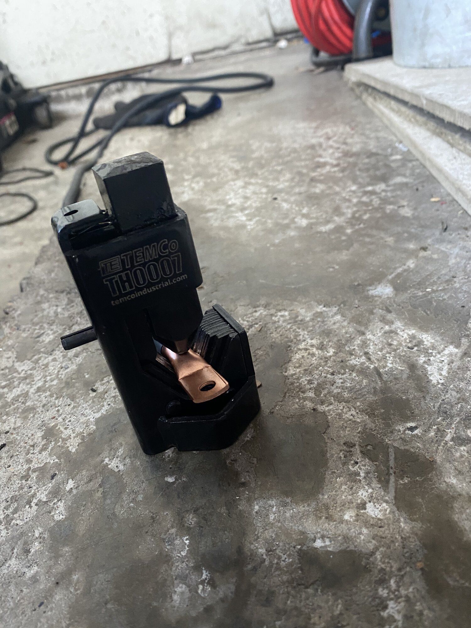

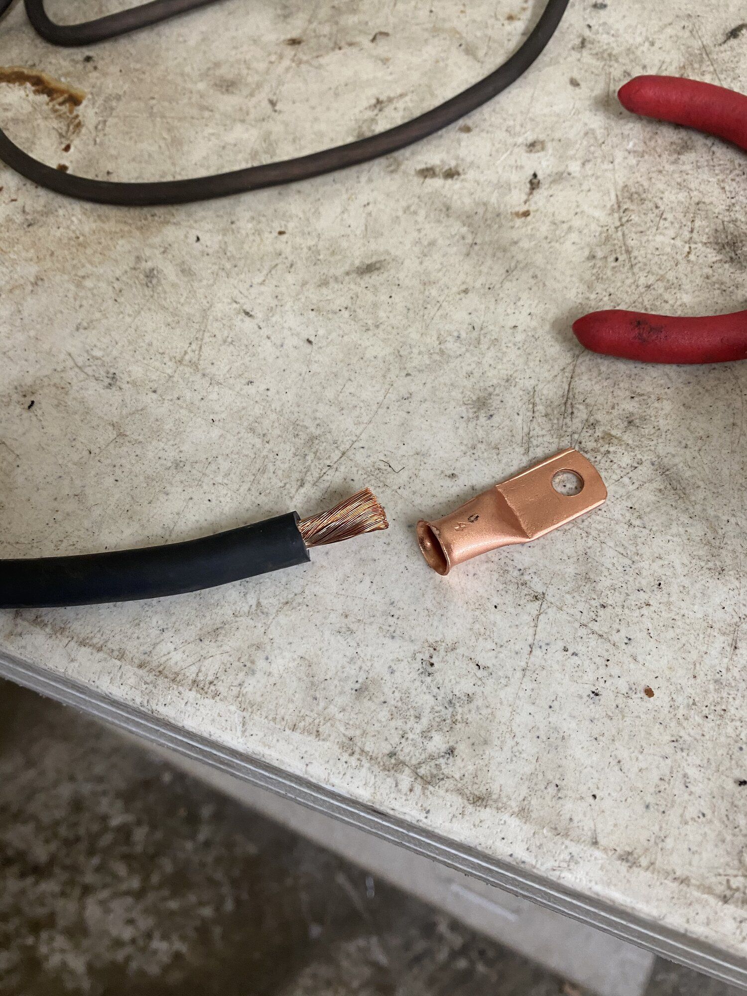

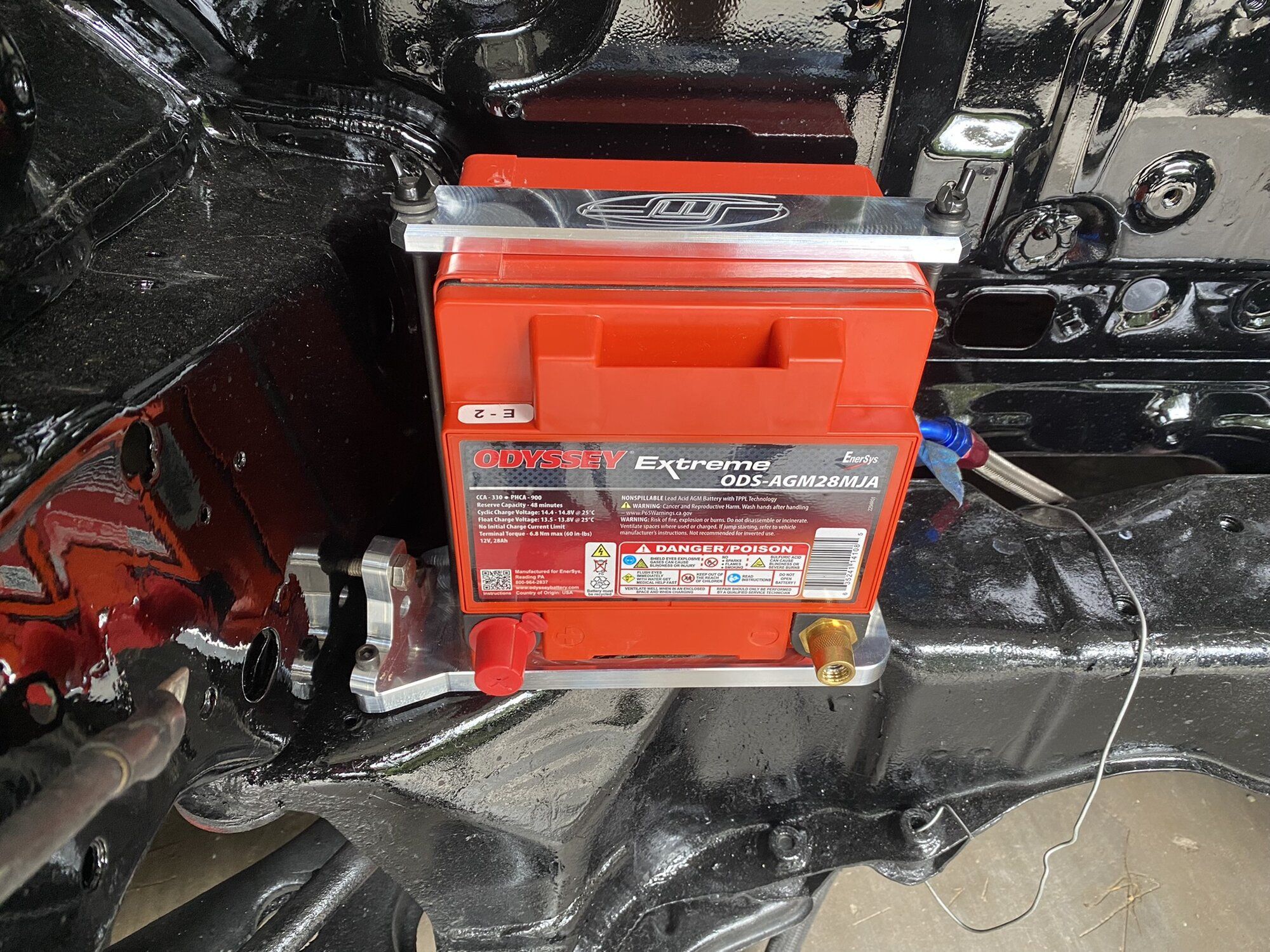

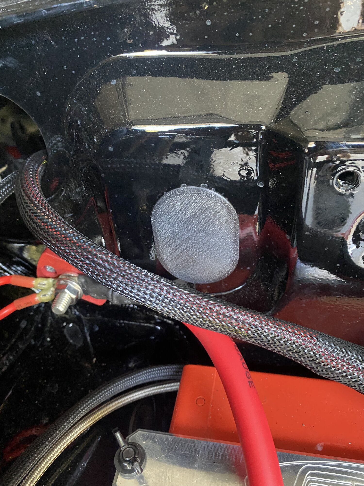

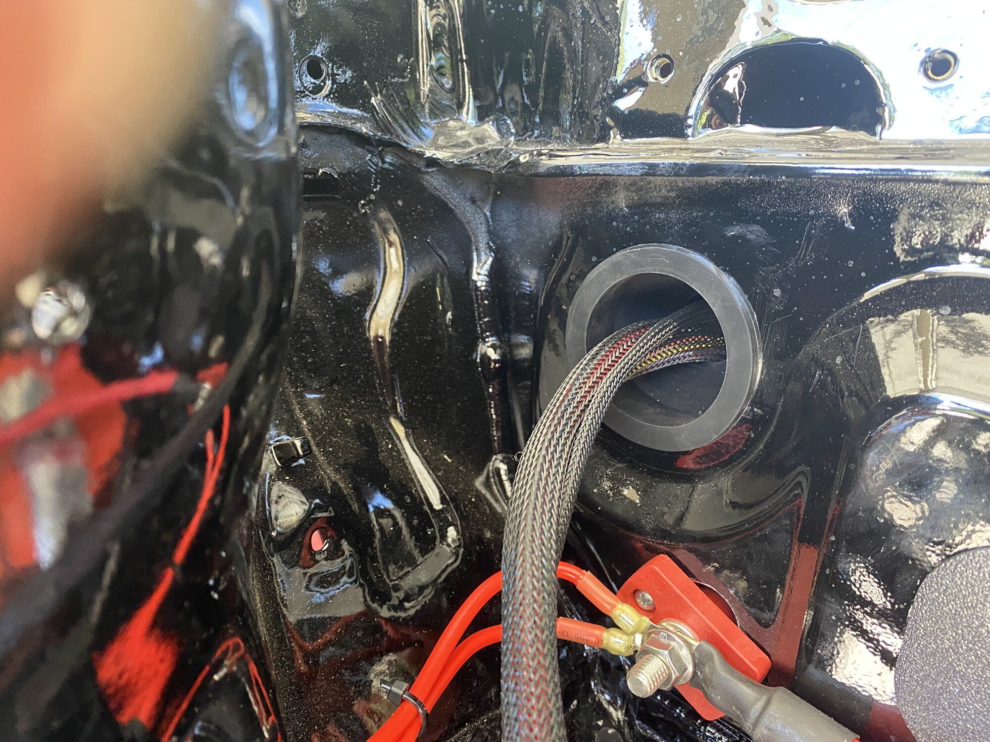

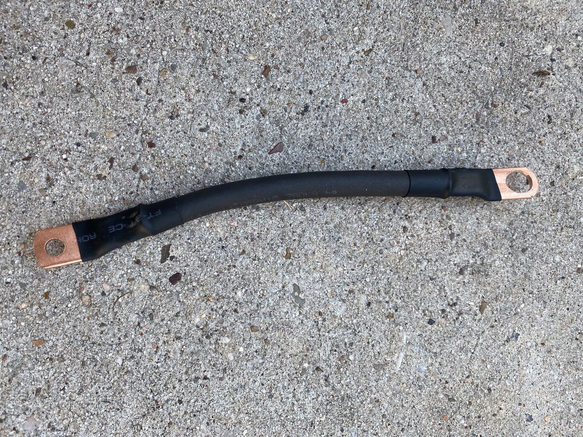

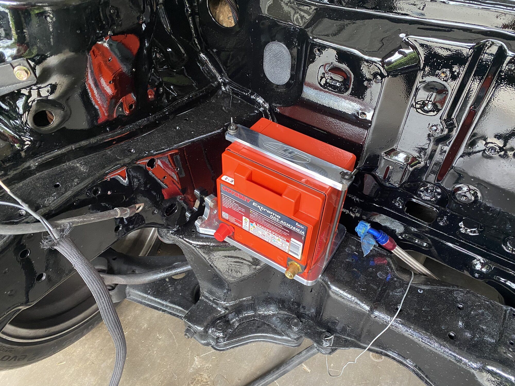

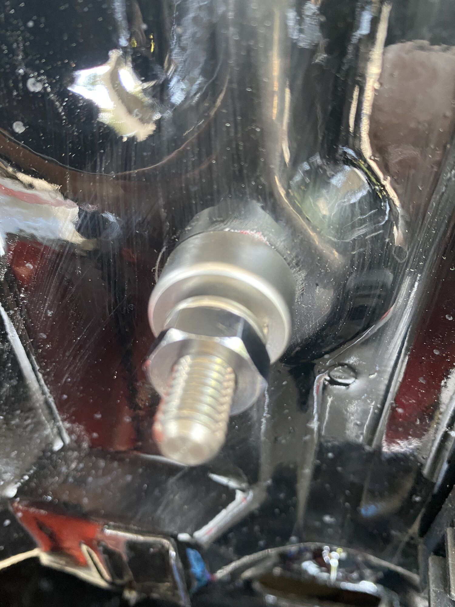

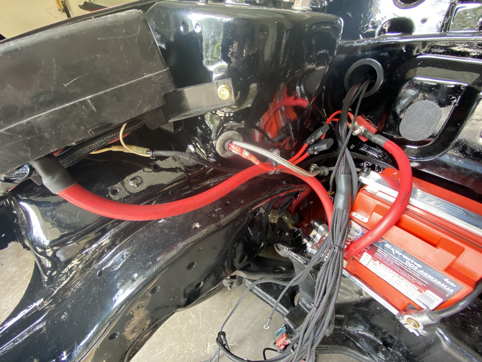

I switched from a rear battery setup to the JMF/PC925 battery setup with new connections. Don’t ask me why.

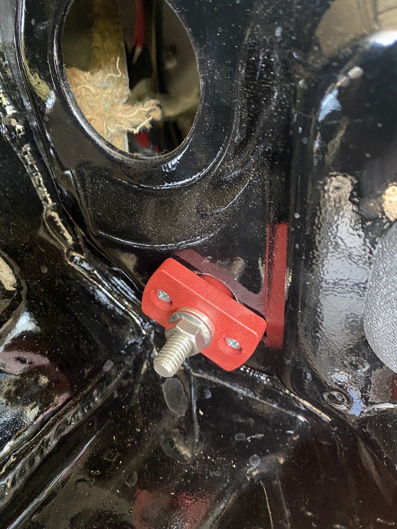

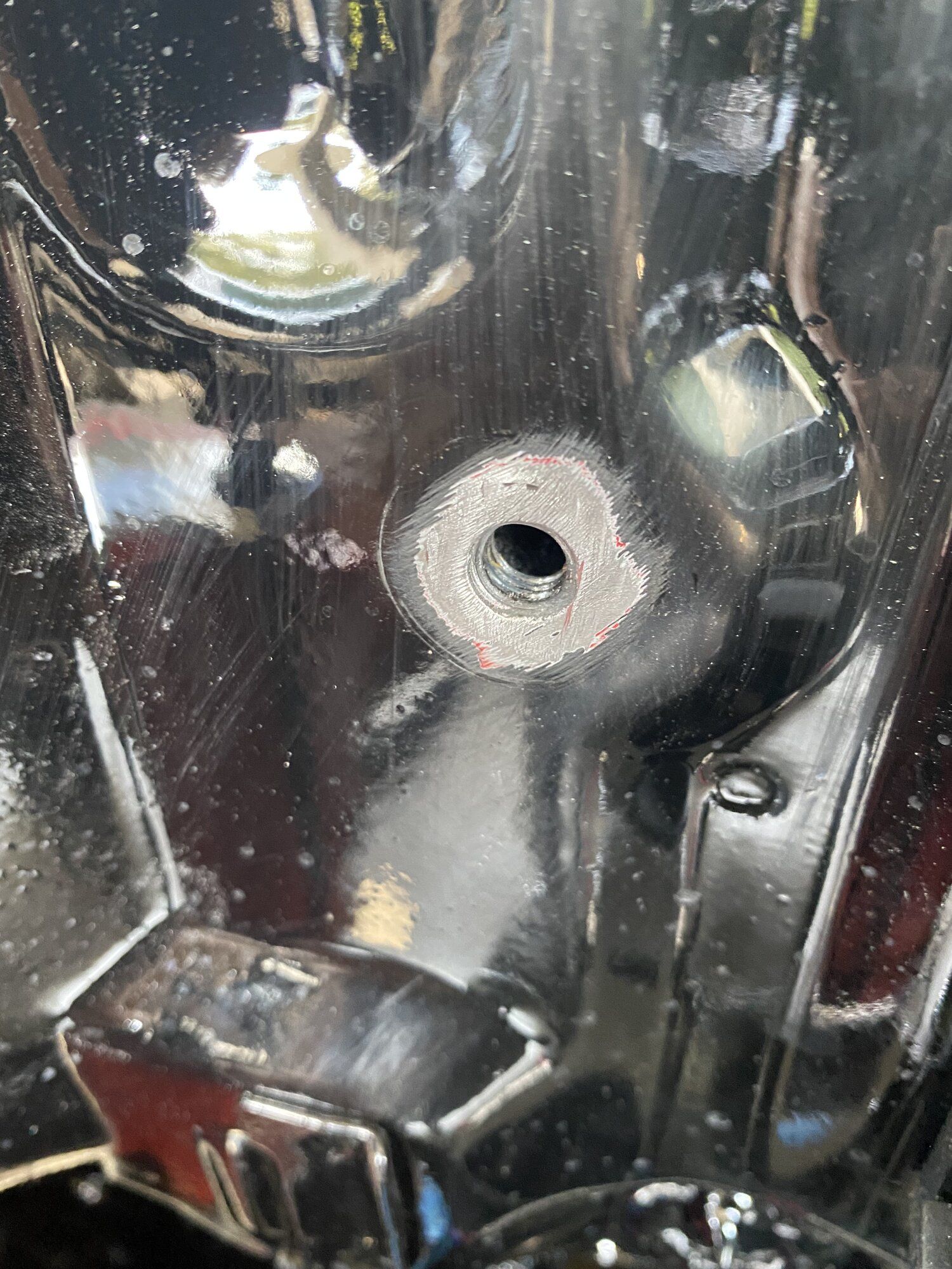

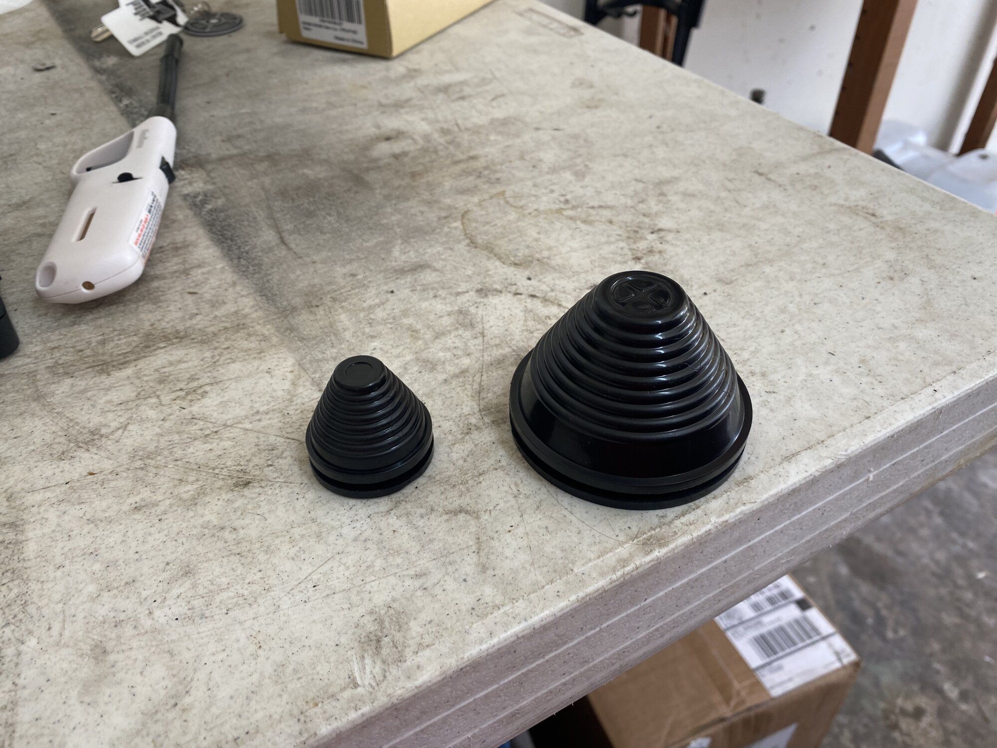

I had to rewire the fans and tuck that wiring under the wheel well. I added a nice ground lug from JL Audio. I ground off some paint to make a good connection to chassis.

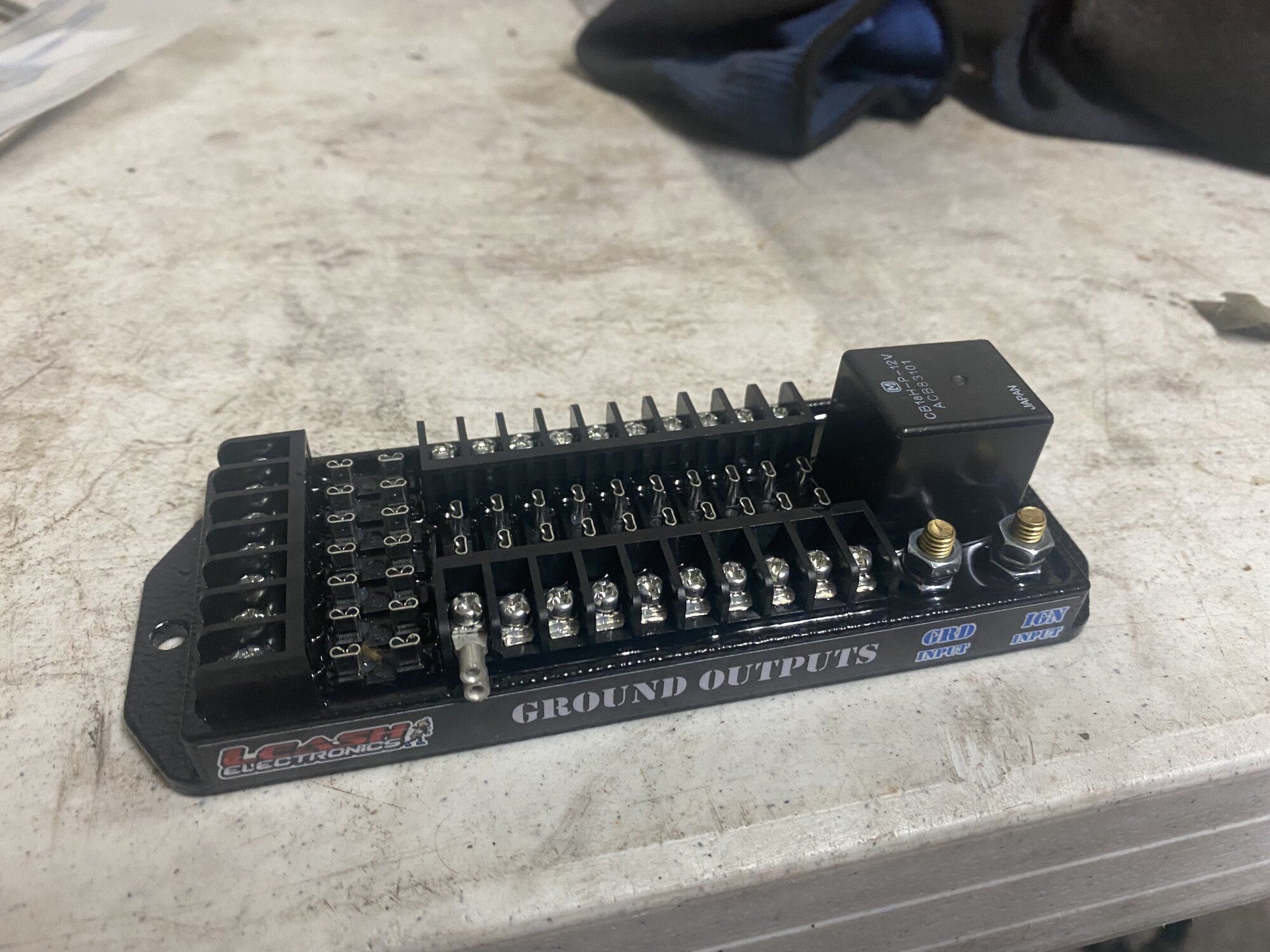

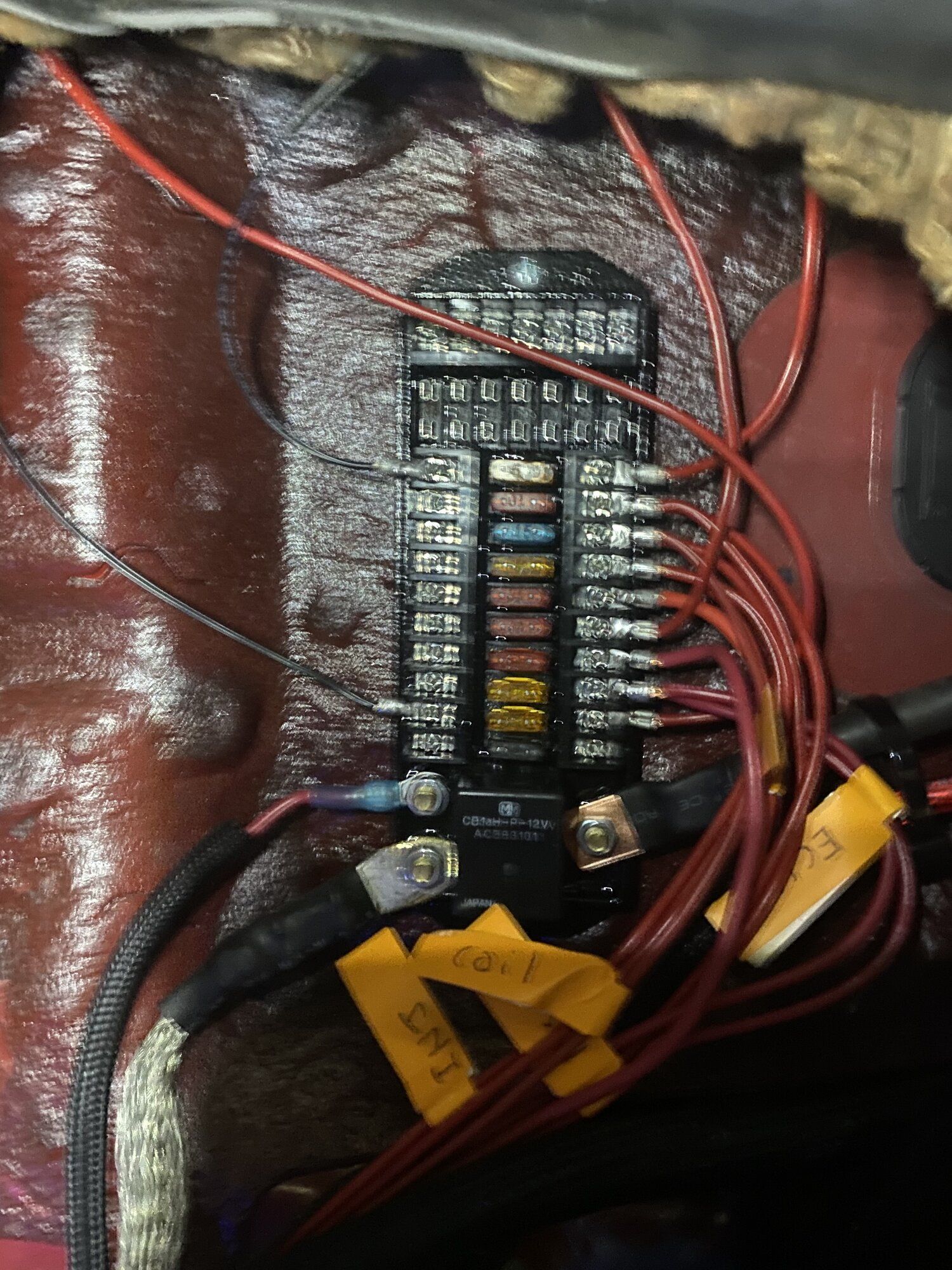

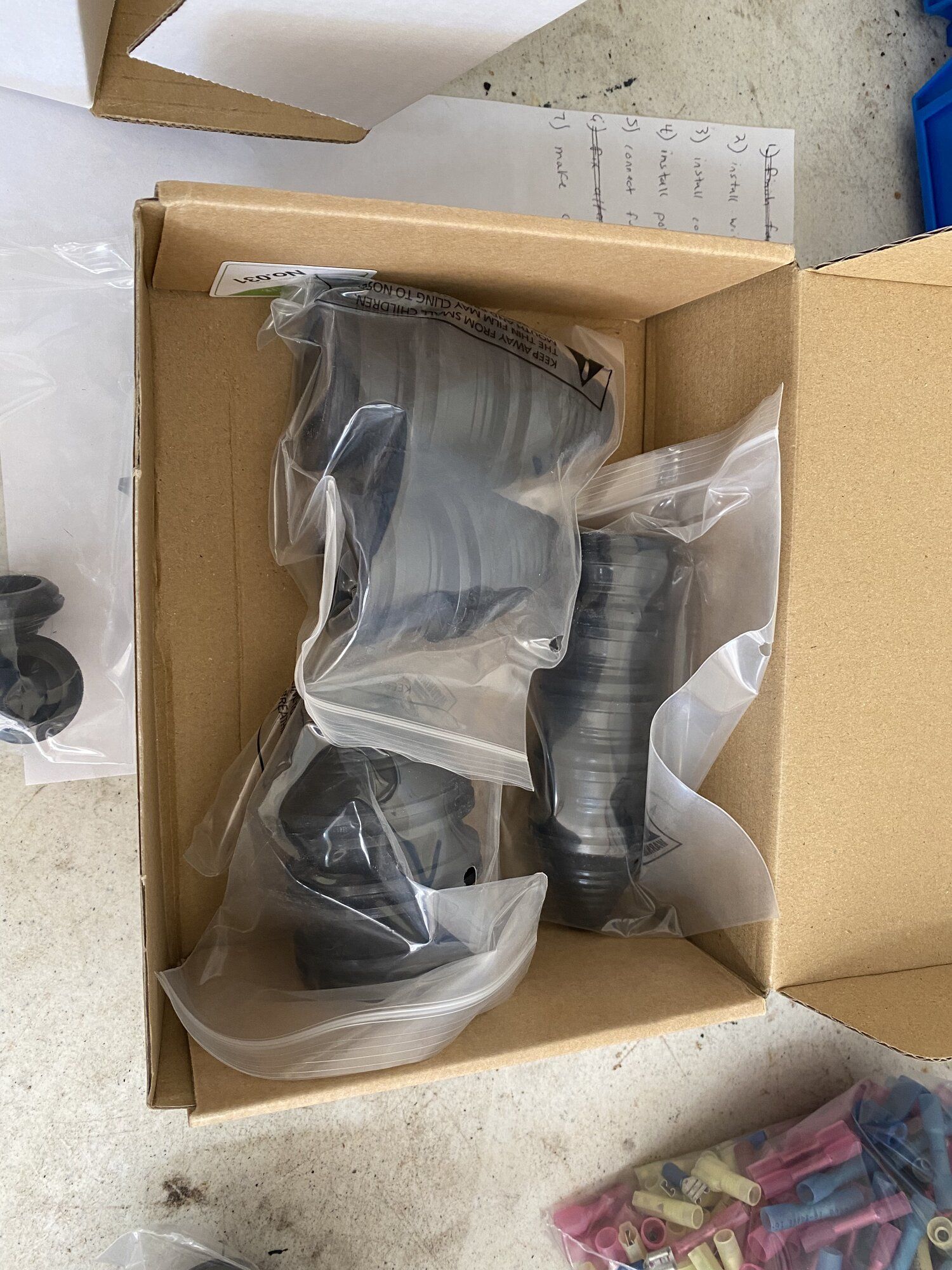

I had a new harness made by a guy I found through Facebook. Great price, however, I had a lot of issues with it. One thing I didn't know going in was that he replaced the whole MPI fuse/relay system with a 6-relay board. So instead of just plugging into the MPI I had to connect around 10 power wires for injectors, coils, ecu power etc etc to this big 12"x12" relay board. Plus, I had nowhere to put the stupid board. It wouldn't fit under my passenger seat and when I tried to anchor it to the firewall it completely shattered.
I found a nice replacement at Leash Electronics that was much smaller. I installed it behind the passenger glove box, and I'm running everything to this panel except the fans and fuel pump.

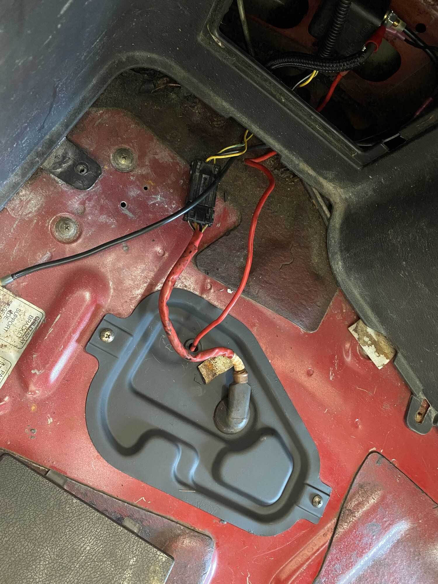

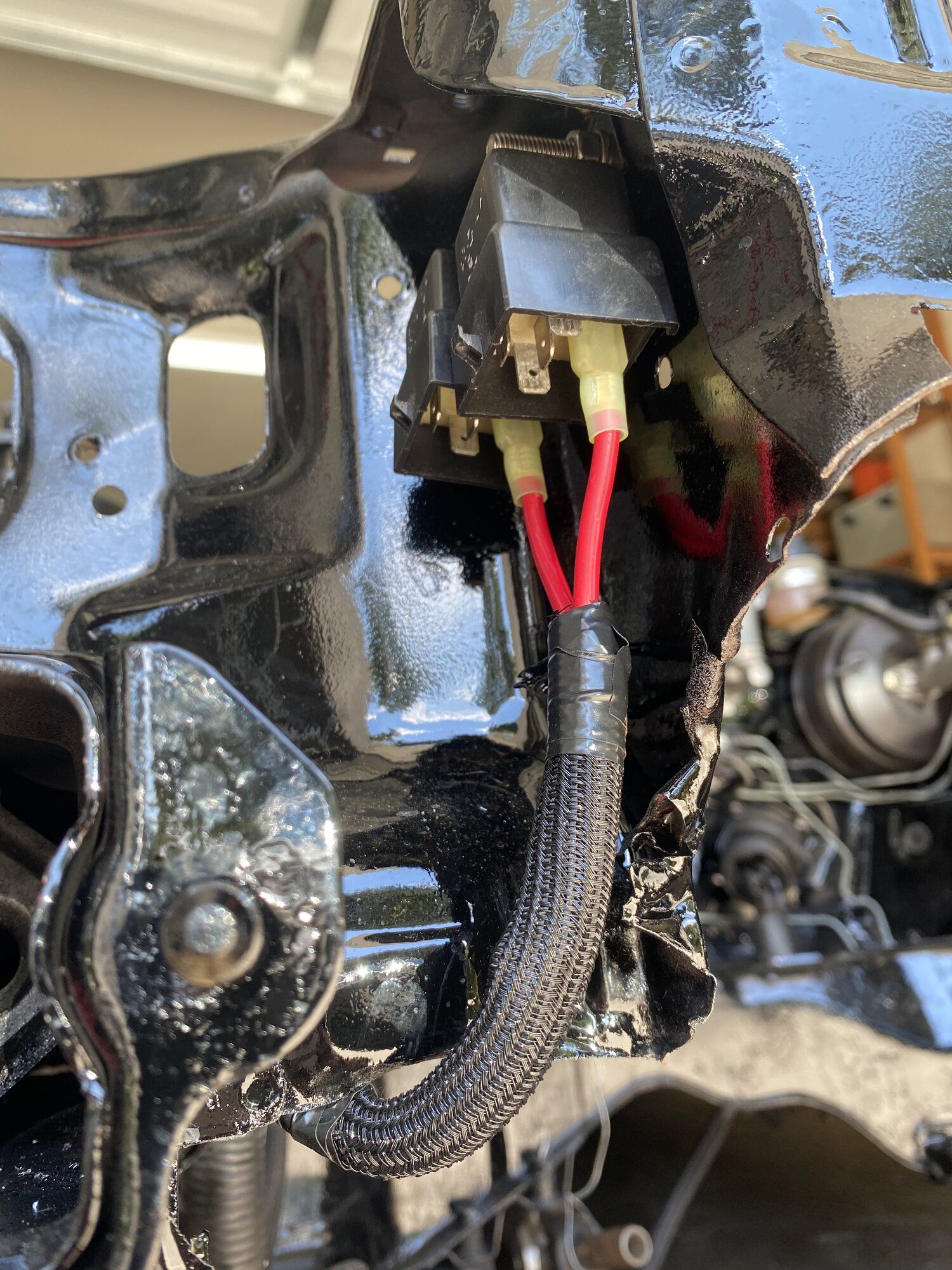

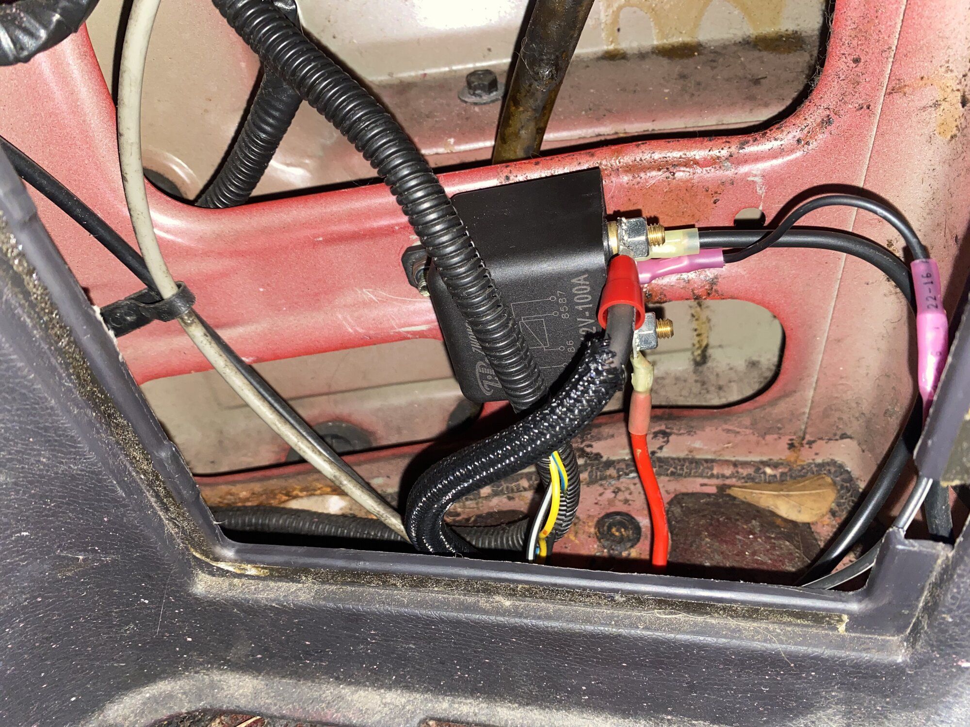

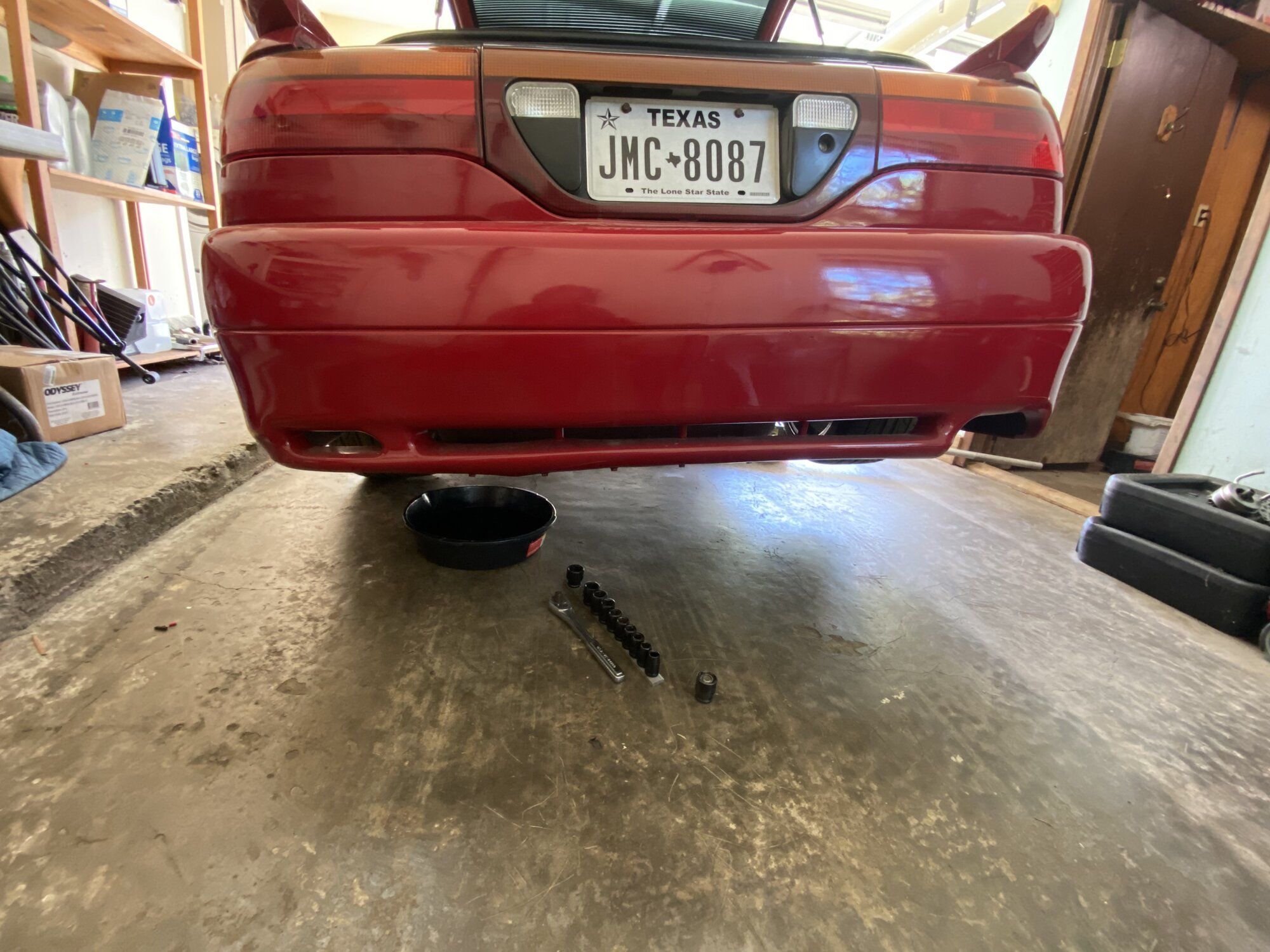

I wound up refurbishing my fuel sender cap with Rustoleum, redoing my fuel pump wiring and draining my fuel tank of the ethanol. It's interesting that even after draining the tank I had 1/4 gallon of ethanol left over. I had to jack-up the car at an angle to get the rest out.

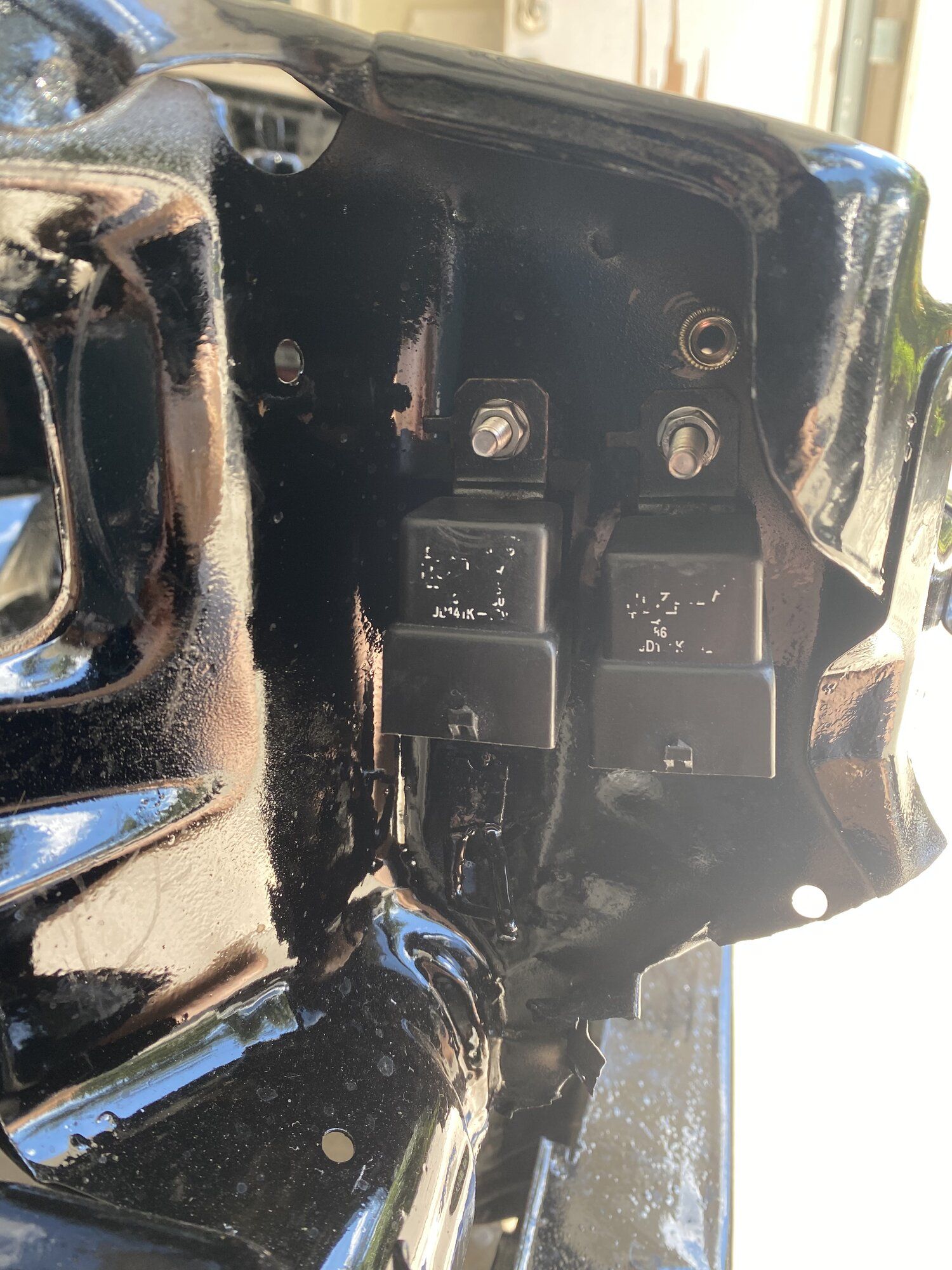

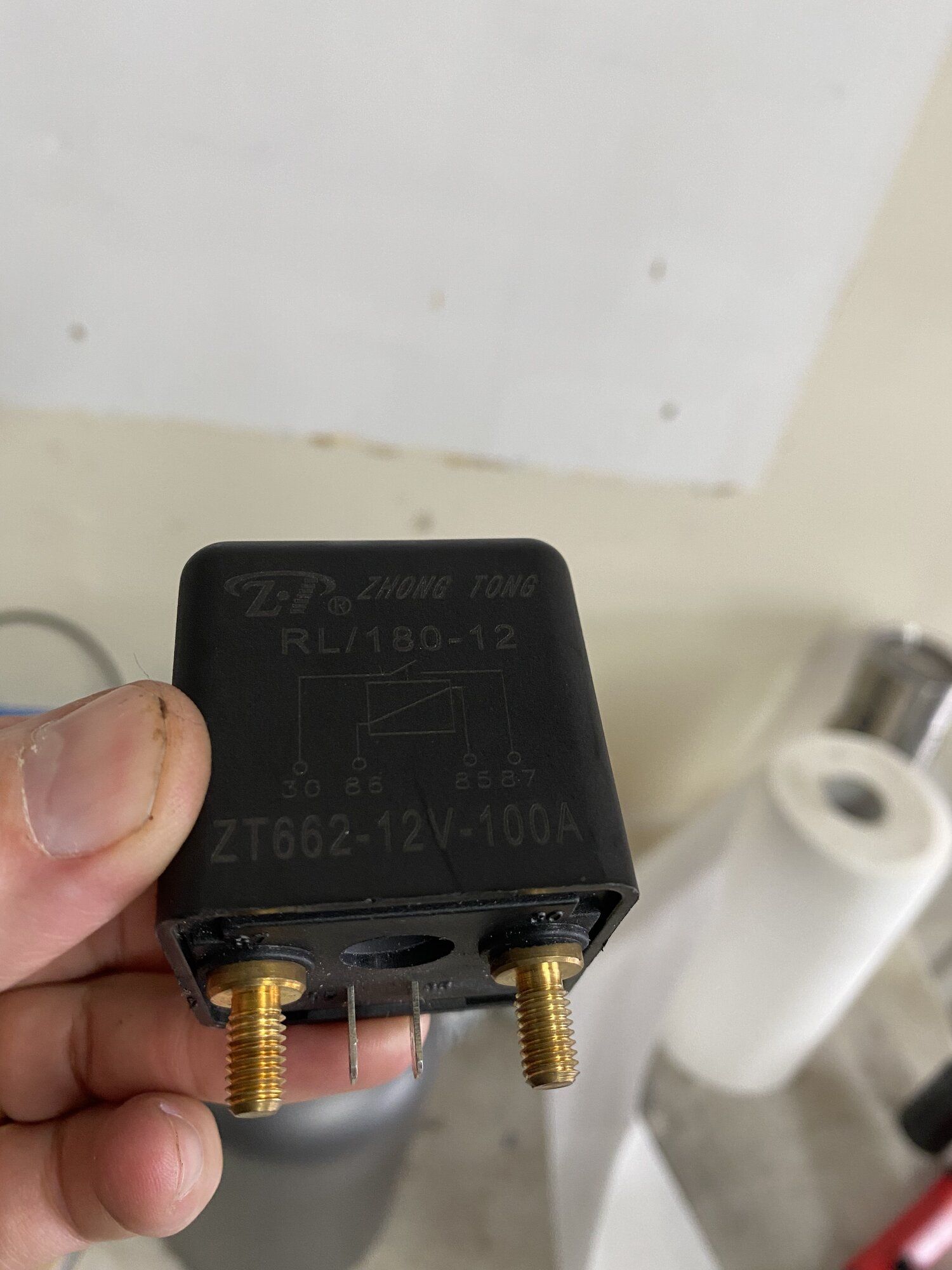

I had a heavy-duty relay I added just because and ran a little higher quality wiring for power and ground.
