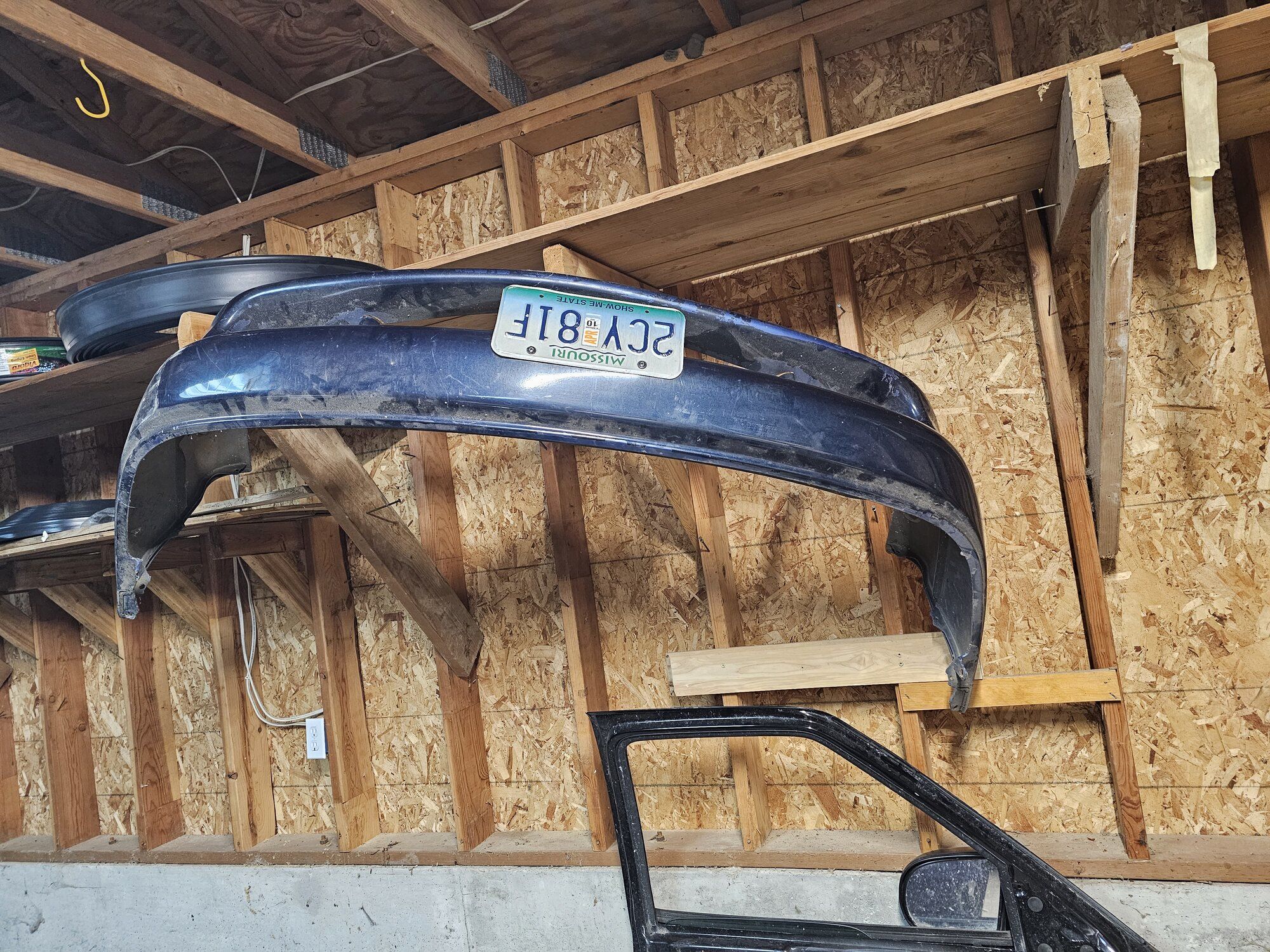

Don't know if you want to categorize this under 'inspiration' or not but it is incredibly HARD to get rid of a DSM. Especially one you have memories in. This guy was a Rollercoaster, like most are. Had lofty expectations, like most do. But aside from the 2 years I paid for storage space until I had a house to store it, it didn't COST me anything to just sit there in the garage. Well, I thought it didn't anyways. While I drove it 2,200 miles cross country (multiple roadside fixes naturally), once it was here in Washington I couldn't license it because of every single EPA device being removed/defeated so it sat. Once emmissions regulations ran out, I tried bringing it back but neglect reared its ugly head... Mice, specifically, had gnawed through an already iffy 1990 wiring harness at various points that I could (and couldn't) see. 18+ years ago it was fun to have a 'rough and riced up just enough to look slow' car to prowl around in but now... well now, ANY DSM is a rarity to see and stick out worse than a bright yellow '32 coupe. A decision had to be made about where to spend the money in order to 'get my money's worth back out of the built engine. As luck would have it, I found a 93 Talon tsi with a stack of maintenance records but the rods were hammering away, for $800. Under the dust and pine needles it was rust free though. A deep wash and wax revealed a less than perfect body (dings mostly and some peeling clear coat) but it did start and run which was more than the 90 could claim. Fast forward a few years and the motor swap still hadn't happened yet but was still planned. Couple more years to today and it's time to move cross country again and there are a finite number of spots for moving cars... I honestly considered selling the 93 for a trailer to haul a 'dead' car from the Pacific coast to the Gulf of Mexico because of the memories tied to it. Reality and a wife intervened and the compromise was made to pull the 'heart' of the 90 out, crate it and have it ready to transplant into the 93 once we're settled in Texas. I pulled the ECU (DsmLink V2.5) and seats for a little more feeling of 'home', even swapped those Enkei's over to the 93 but it's KILLING me postponing the inevitable call to the pickNpull to haul the remains away. My brain is screaming: There's still a LSD 4bolt! The rear calipers aren't seized! The 90 trans actually shifted without grinding! The windshield isn't chipped or cracked! SAVE IT! SAVE IT! SAAAAAVE ITTTTT! But we know it's time has come. Nobody is going to save a crappy paint DSM with wiring issues. So ask yourself, honestly ask yourself: Can you save it? Is it time to save it? How much time is left to save it? But the most important question is:Do you want to save it and/or handle watching it leave in someone else's possession and in what kind of condition when it does? Regrets suck.
Definitely should save the 90 trans and the LSD 4-bolt! Either to keep or to sell to somebody.
