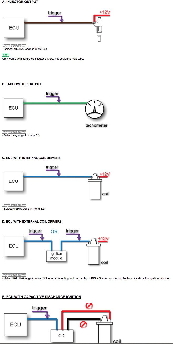

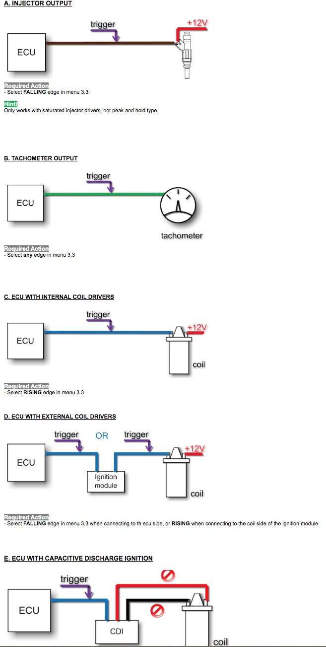

There is more than one way to read the engine speed. And I think @Vegas is sending the engine speed data from ECU to the dash via CAN BUS. I think he has a CAN BUS dash display.
Another link ECU question for ya. Were you able to get vehicle speed logging correctly in Link software? Mine is all over the place, super erratic. I've tried changing the calibration, slip filters, driven wheel speeds, rising and falling edges but it still just goes nuts.
Can’t say I ever looked at vehicle speed. I’m on gps now with no issues. Dont remember ever having an issue.

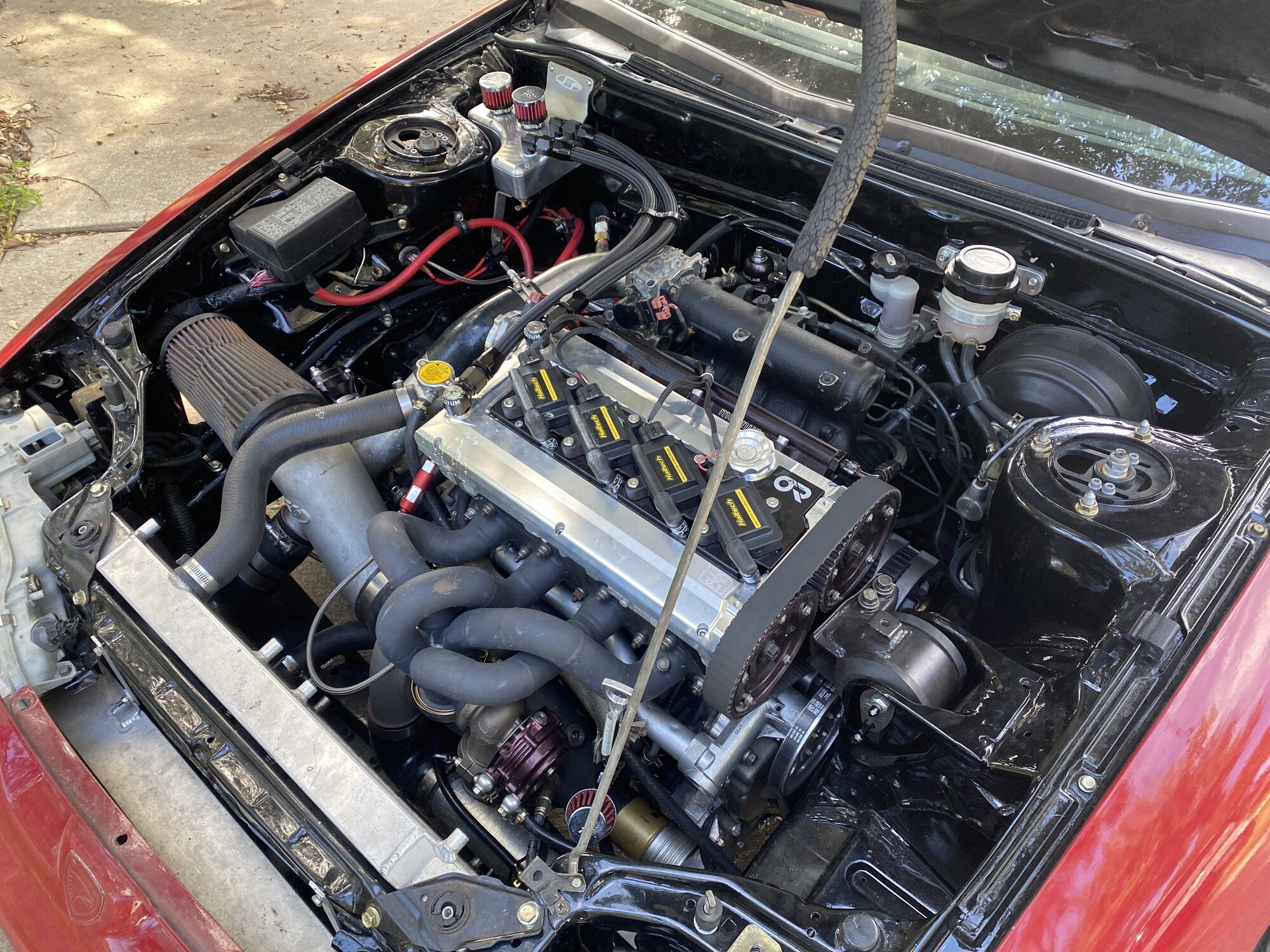

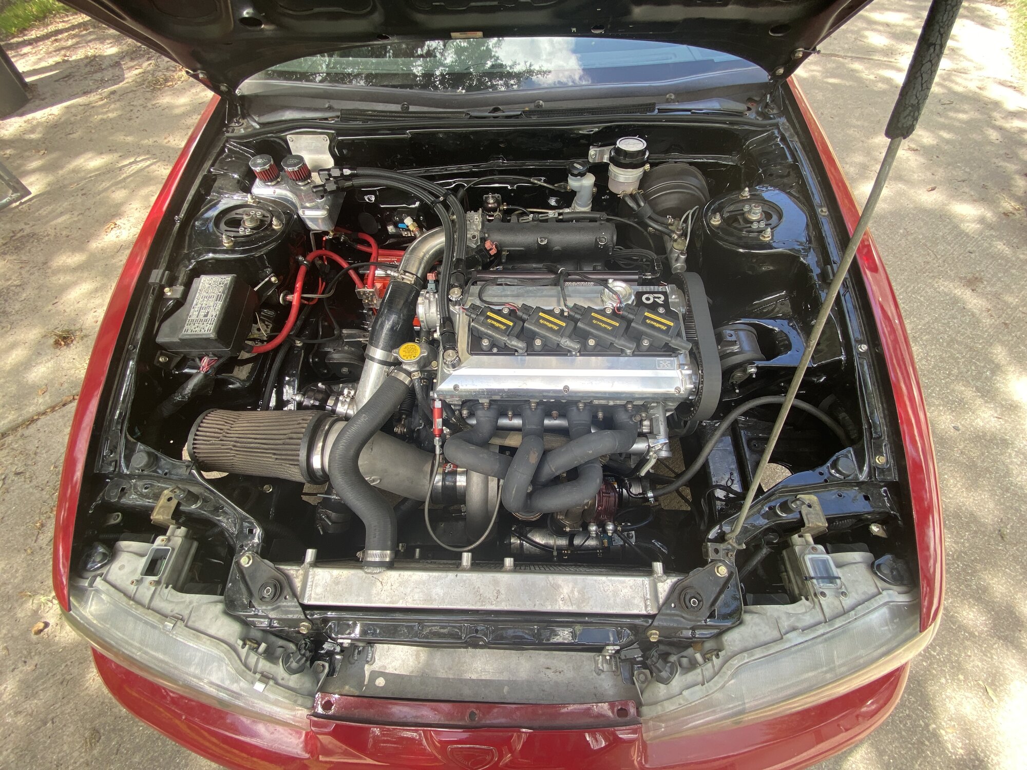

Well, a lot has happened since my last update. I was driving the car a lot last winter, getting miles on it. Then one night, the power started cutting out after leaving work. My battery voltage was low at 12ish volts and I figured maybe my alternator went out. I took a chance on making home without a tow, and it failed at a stop light. Long story short, I was stuck at a big hwy intersection with no power and nowhere to go but sit in the woods and wait on a tow. It was such a stressful experience I had to take a break from the car. It took me a few months to look into the car and determine what happened and it turns out my alternator stud just snapped off.

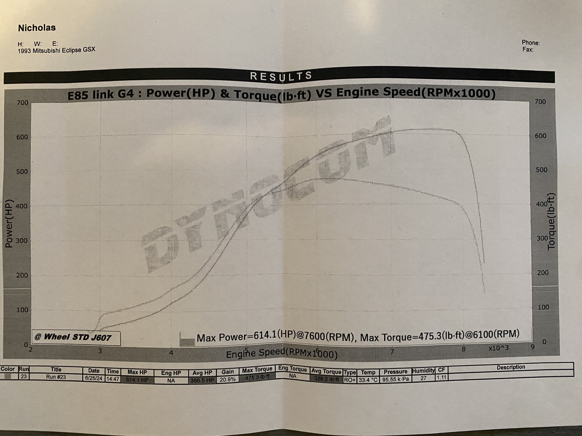

I took me a long time to get it scheduled, but I finally got a dyno tune. My last two remote tunes were super obnoxious, having to go out and do maybe 30ish test drives. Takes forever and isn't fun, so I said never again on remote tunes. I took the car to ASAA in Houston and told them to turn it off at 600hp. The car wound up at 615/475. Pretty happy with it. Time to enjoy it for a little.
