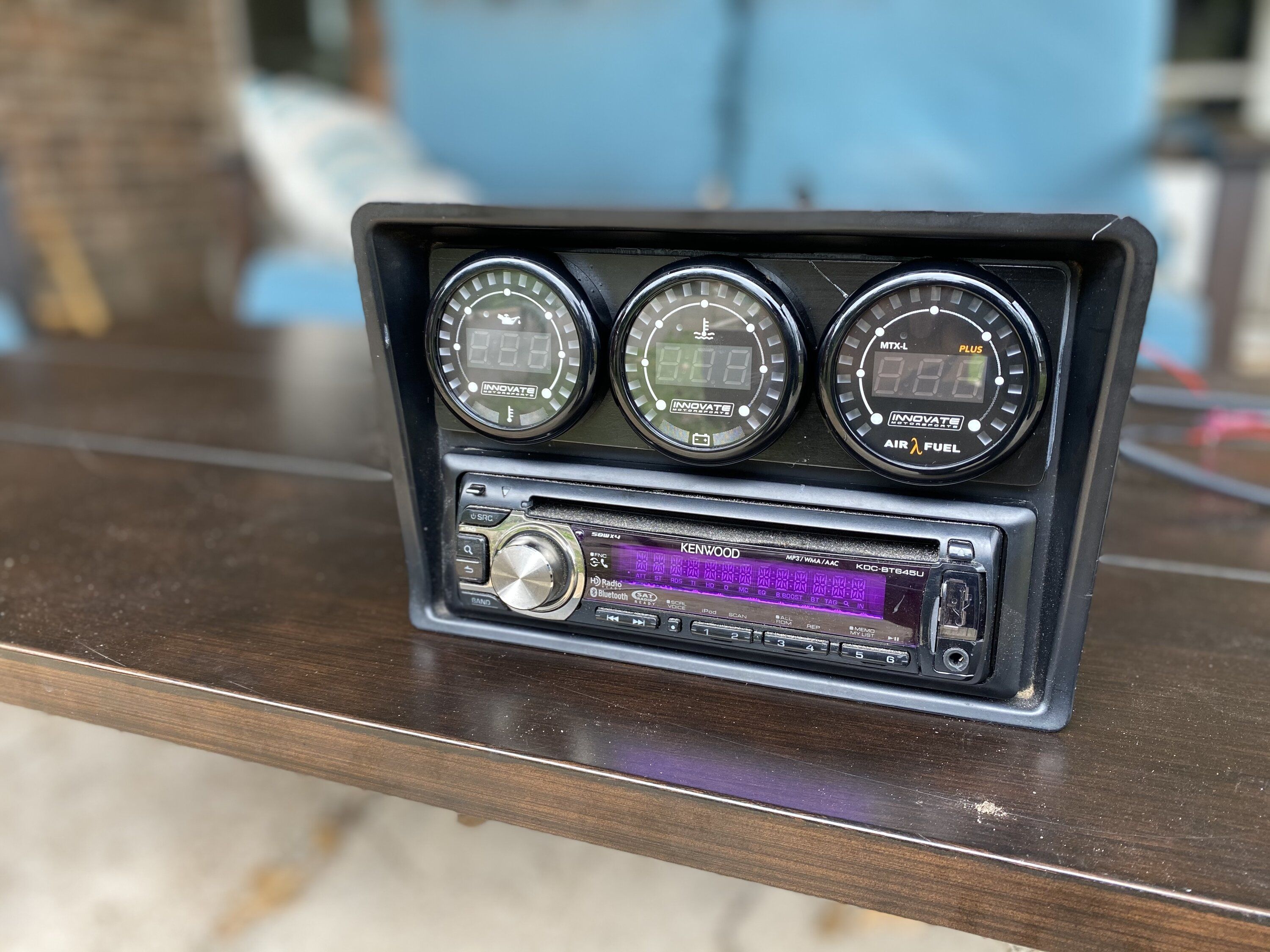

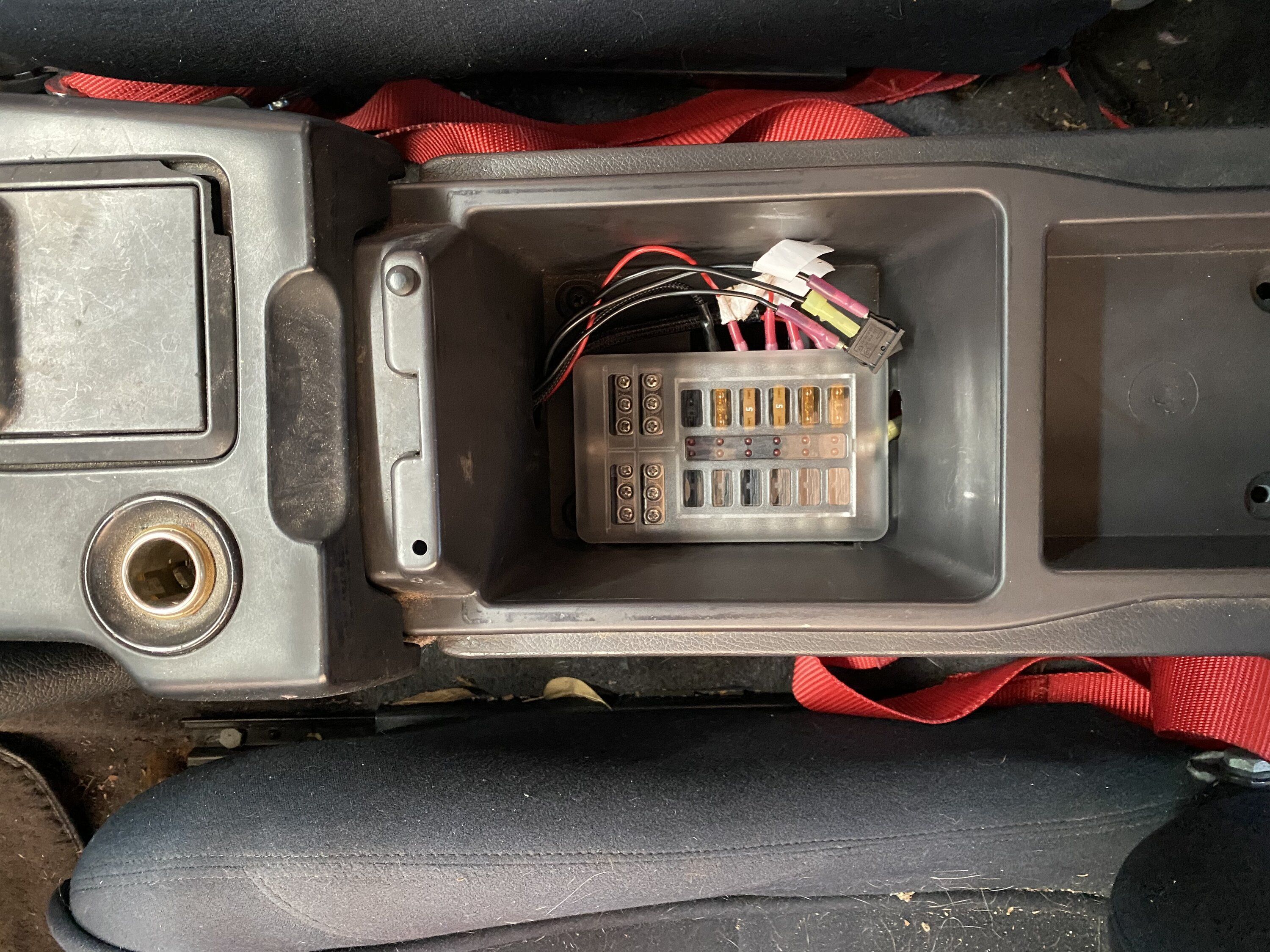

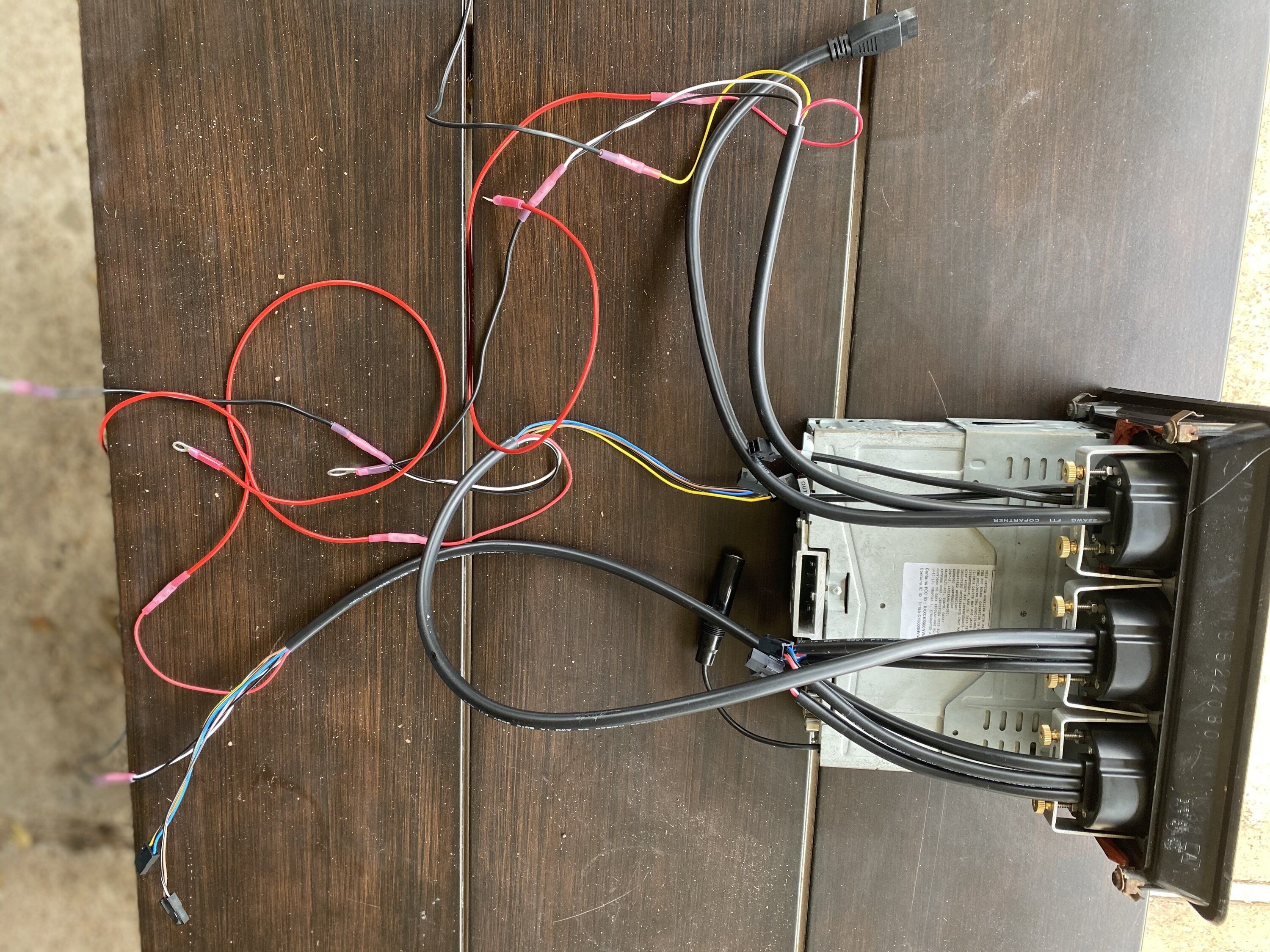

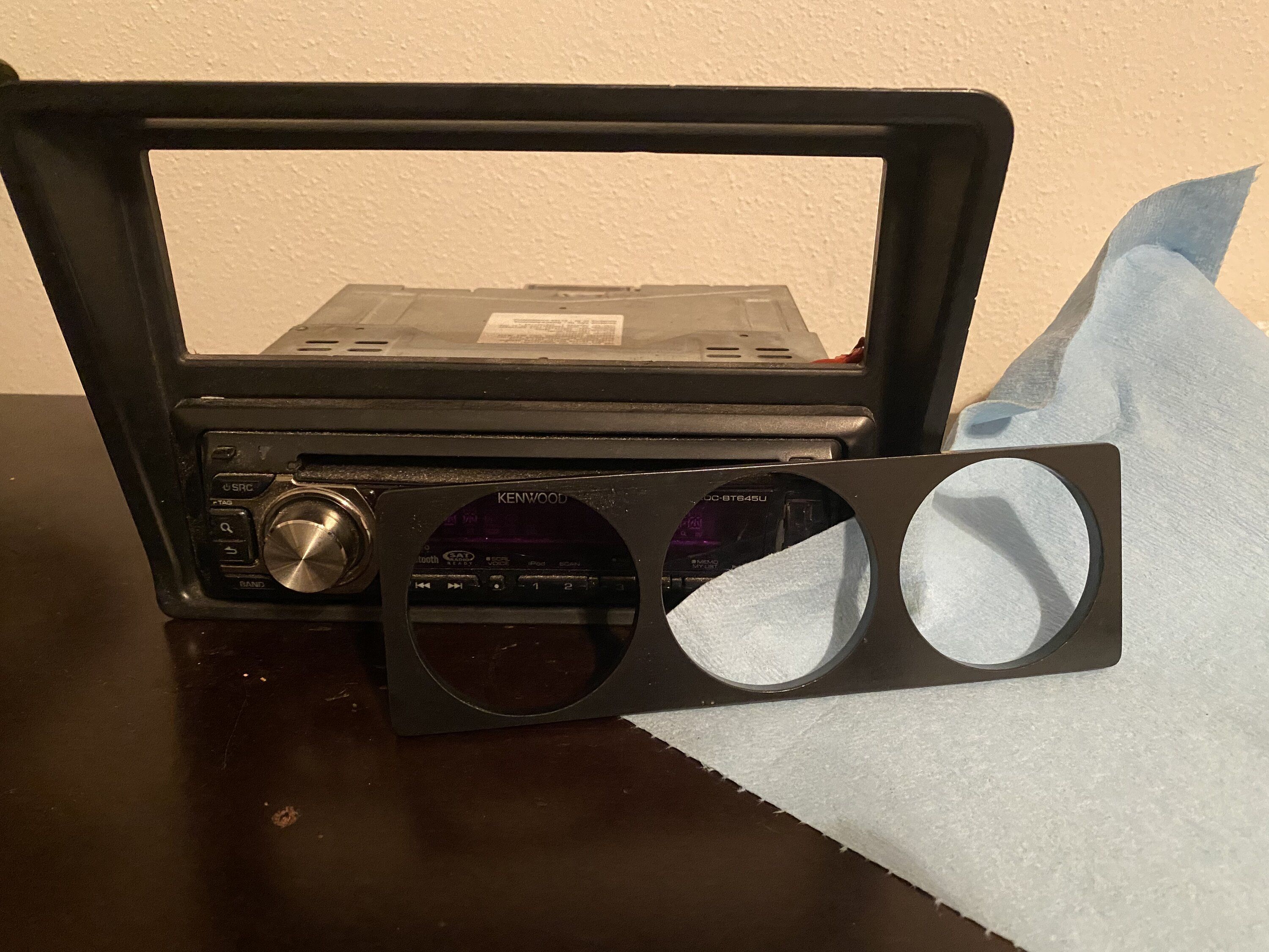

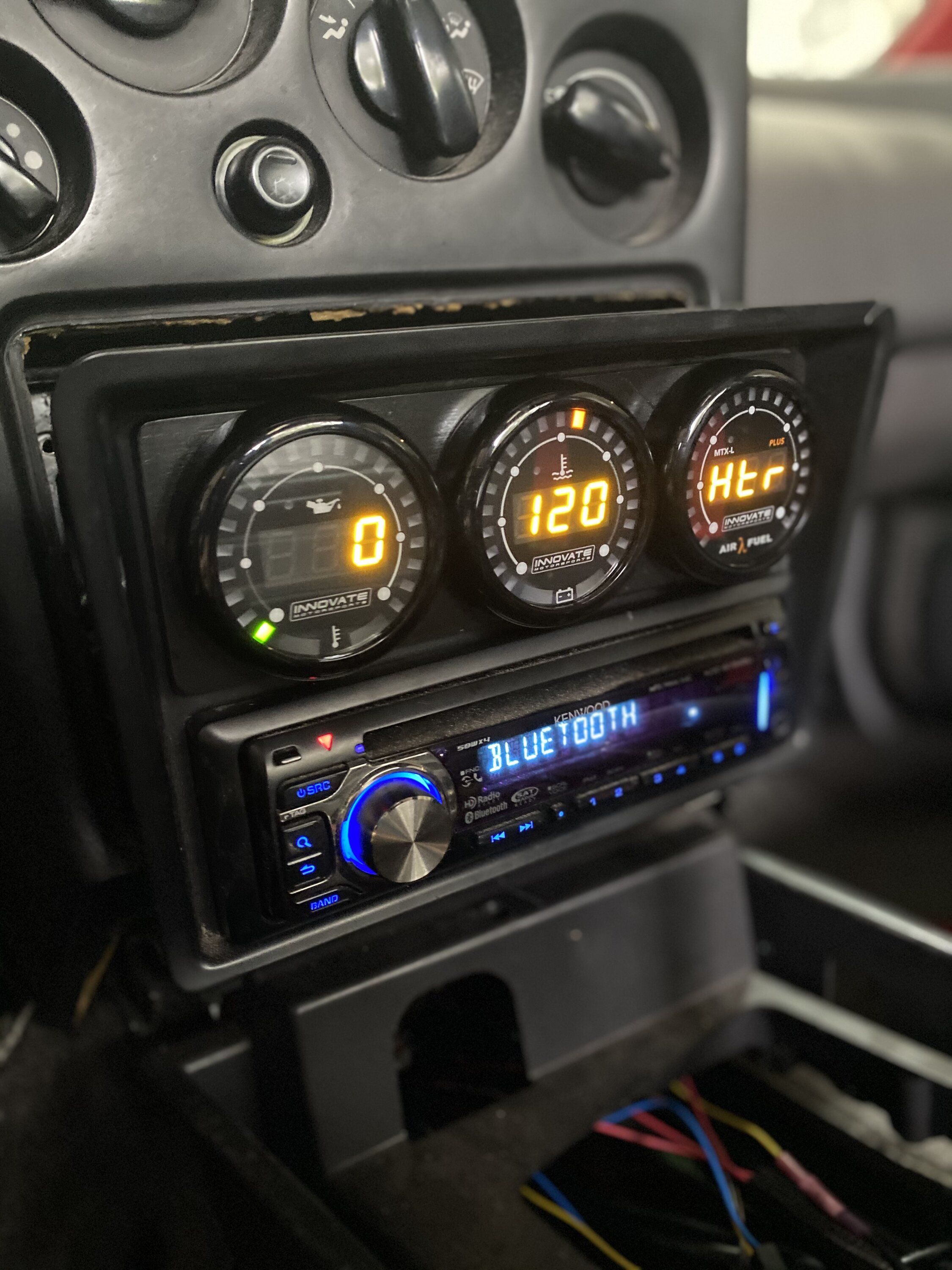

I decided to get all new Innovate gauges while also switching from the LC2 to MTXL-Plus wideband. I also put in a new switched relay/fuse panel in my armrest to control all gauges.

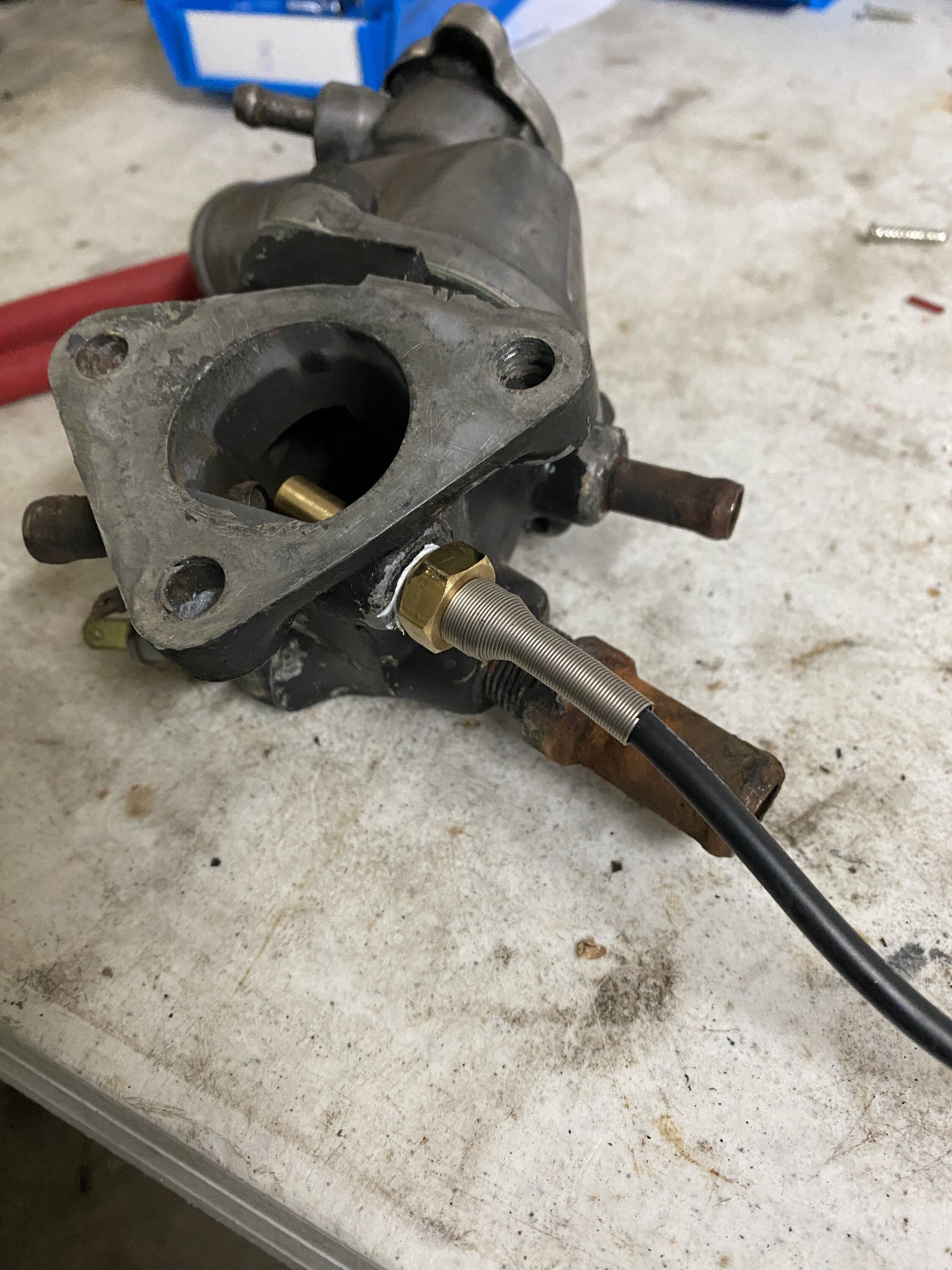

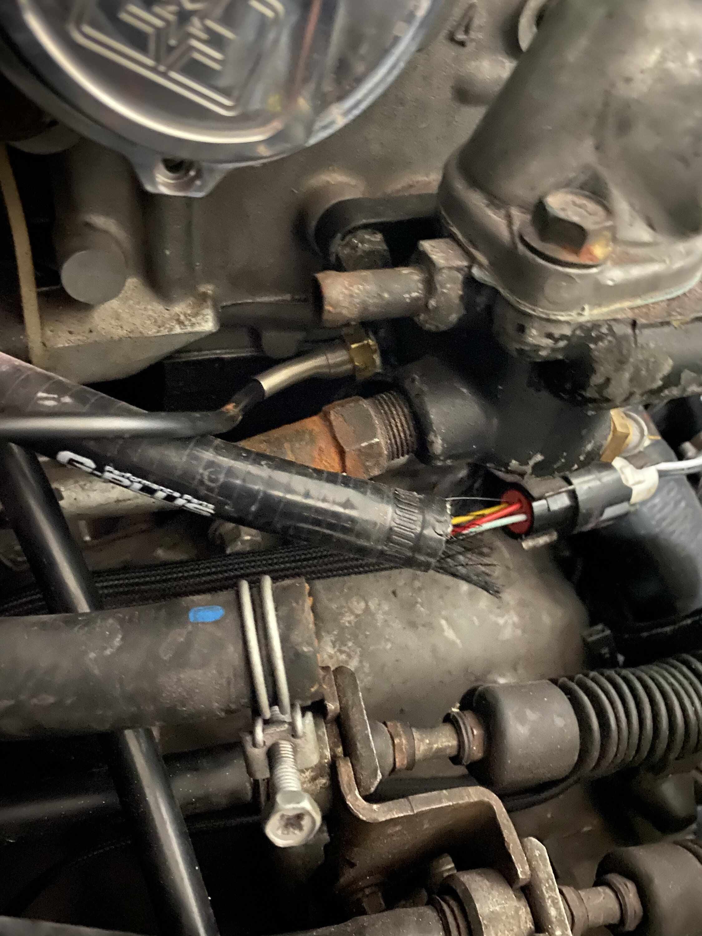

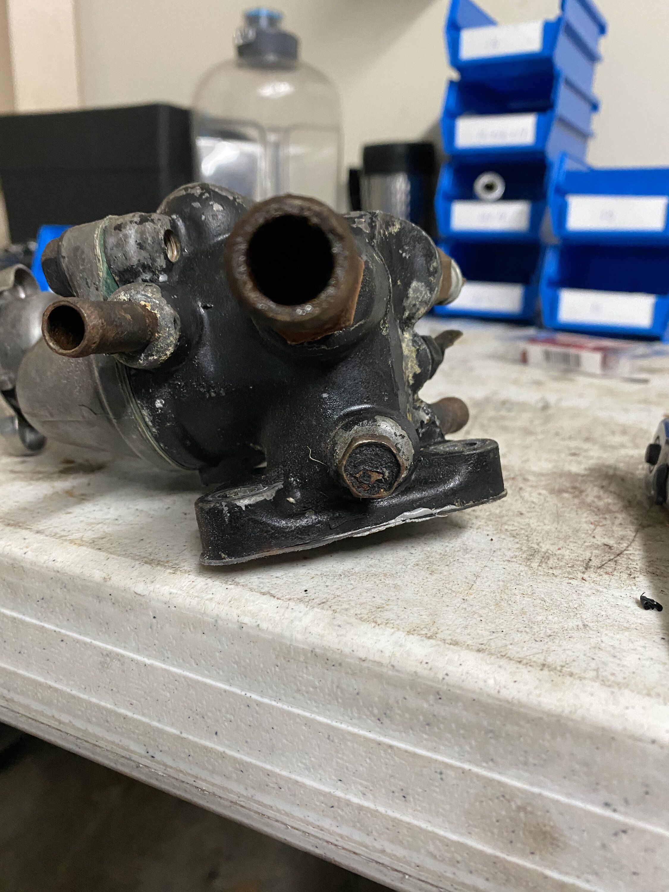

I located the coolant temp sensor in the back of the thermostat housing. It bolted right in without a struggle.

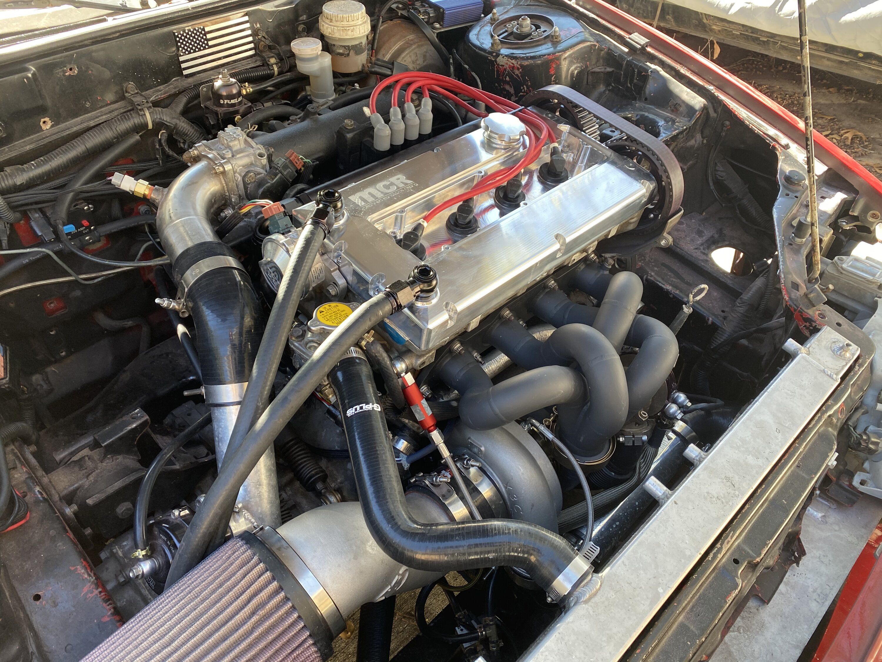

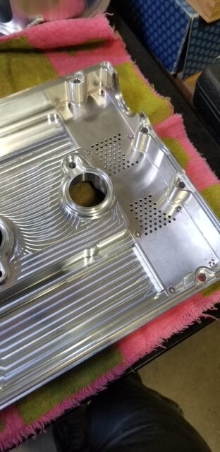

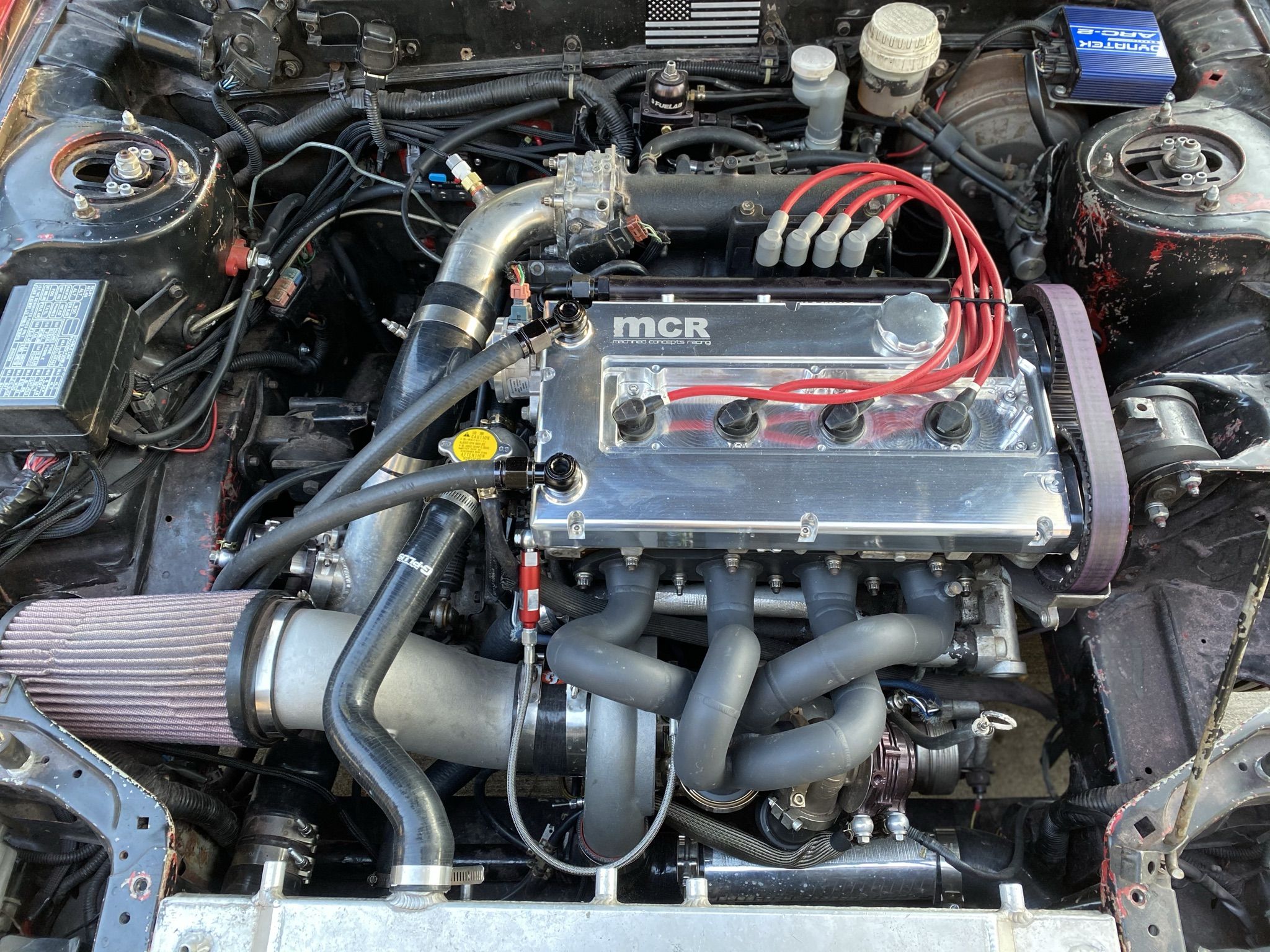

That valve cover looks super!
I'm confused by the MCR though.
The only MCR valve covers I see online look like factory covers. Yours looks like a Frontline Fab cover except that it says MCR on it.

It's a new a product that I just found out about. They're trying to make a website as we speak. I tried to get the FF billet cover but the guy jerked me around for 4 months until I got my money back.

Well I'm glad that MCR has something. Do you have any shots of what it looks like inside? I mean, mostly what I'd be interested in seeing is what there might be for baffles around where the 2 breather ports are.

Thanks for the info and these pics.
Good to see what they did for baffles in there. The perforated areas are not right underneath the ports at all. They are offset a ways. So anything that goes up through the perfs has to then turn 90 degrees and go sideways a little and then turn 90 degrees again to get up into the breather ports. Looks pretty good to me!

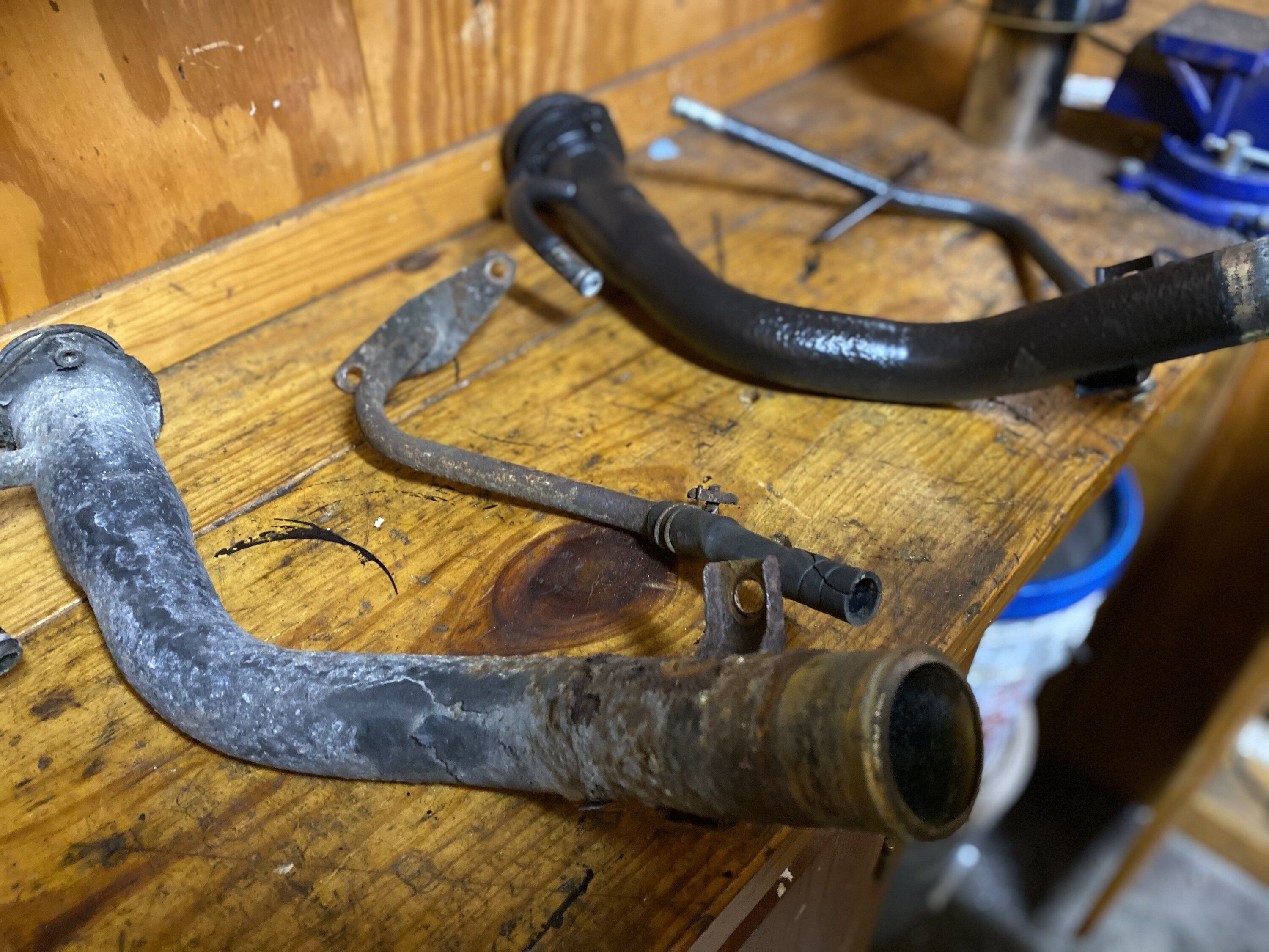

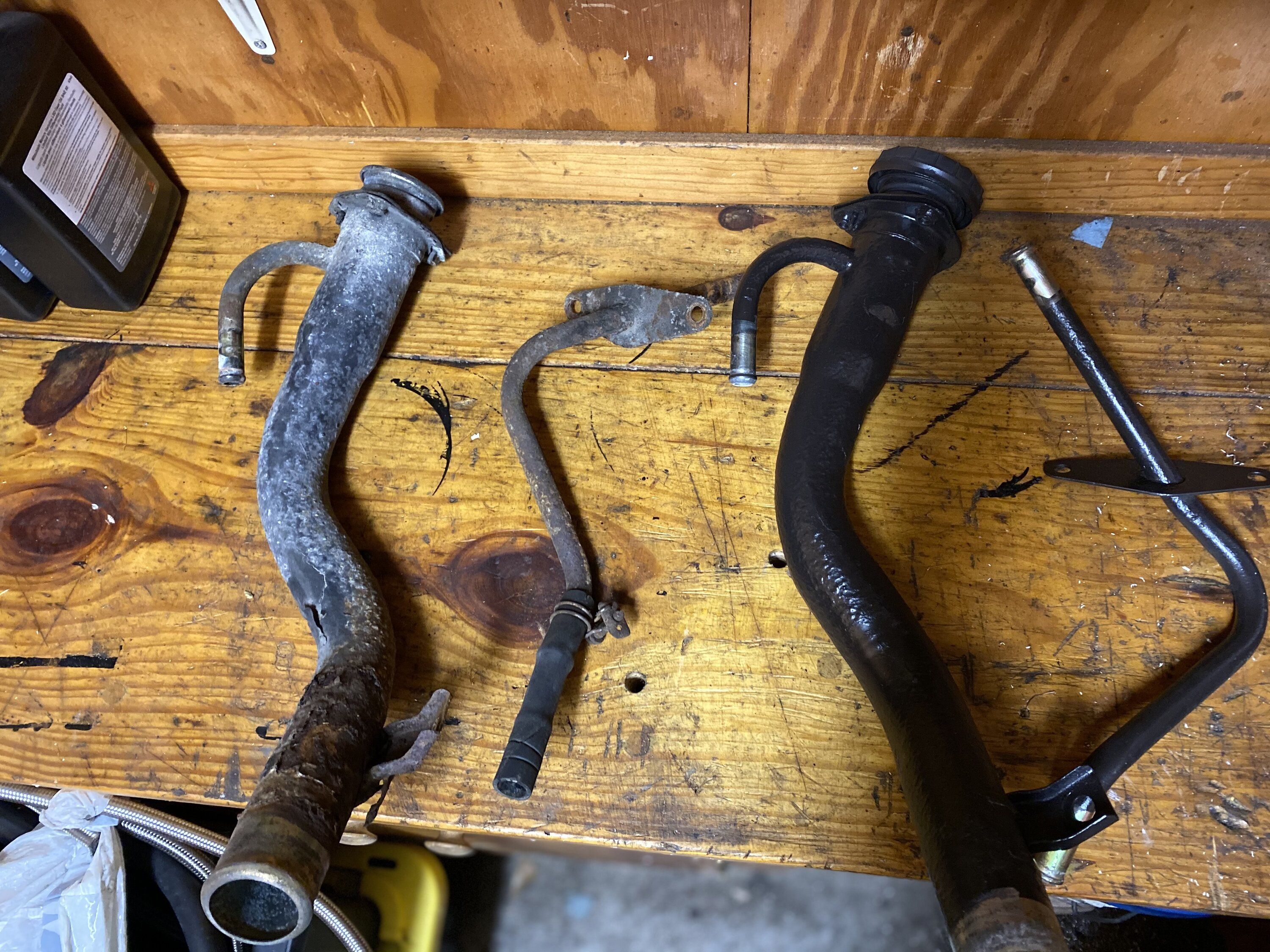

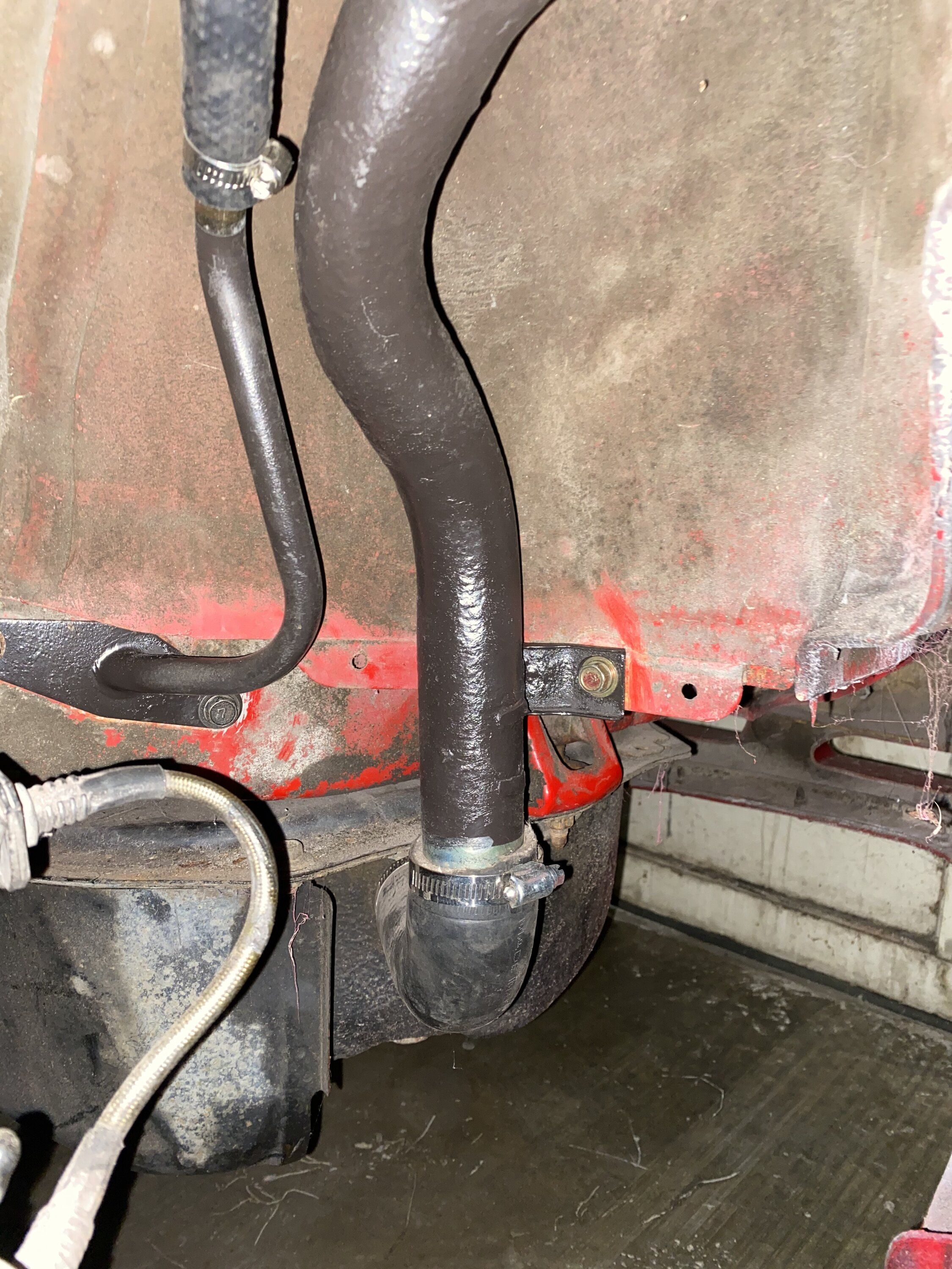

I finally got around to replacing my rusted fuel-filler neck. I took the one off my black shell and coated it with Rustoleum.

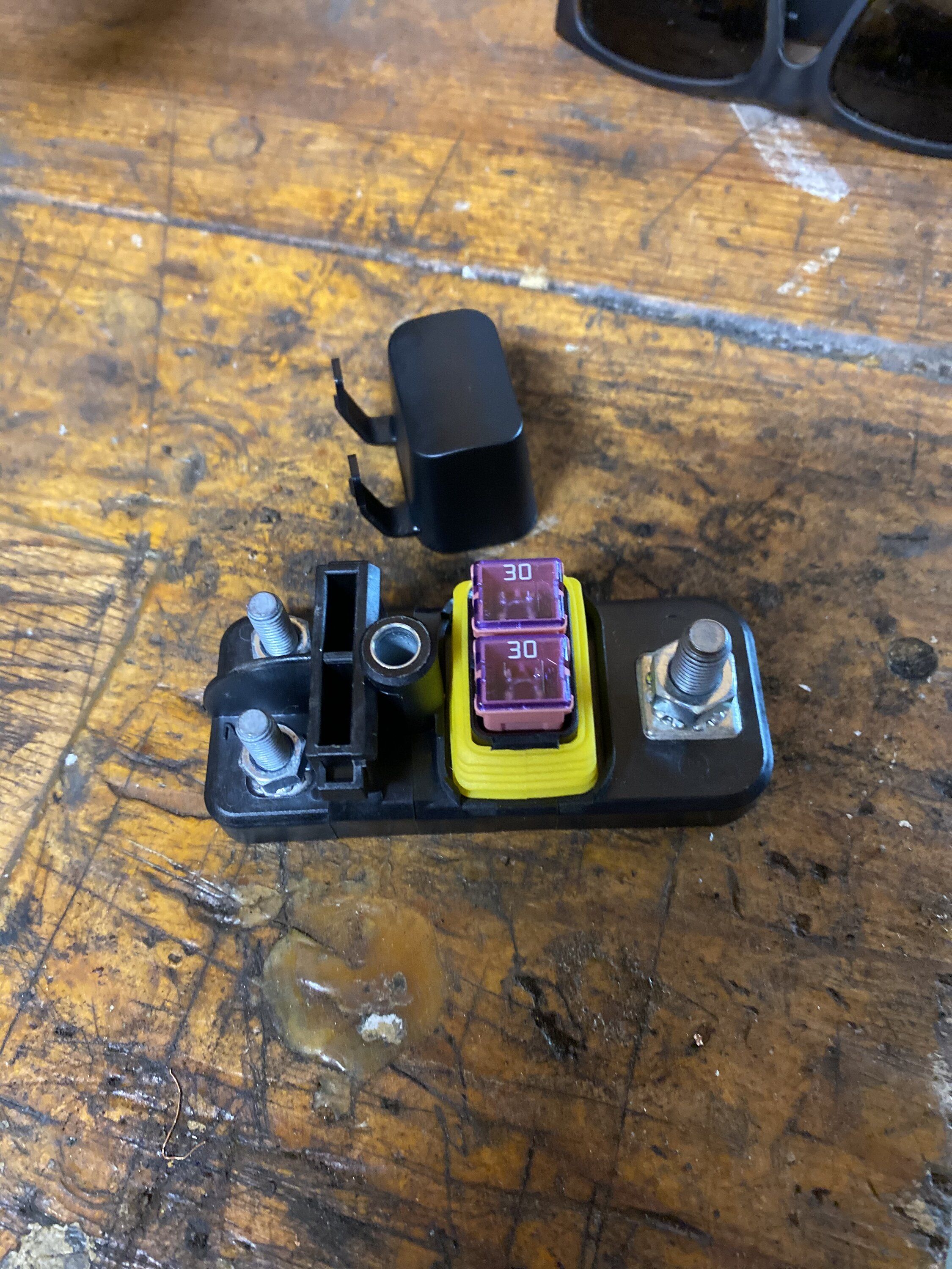

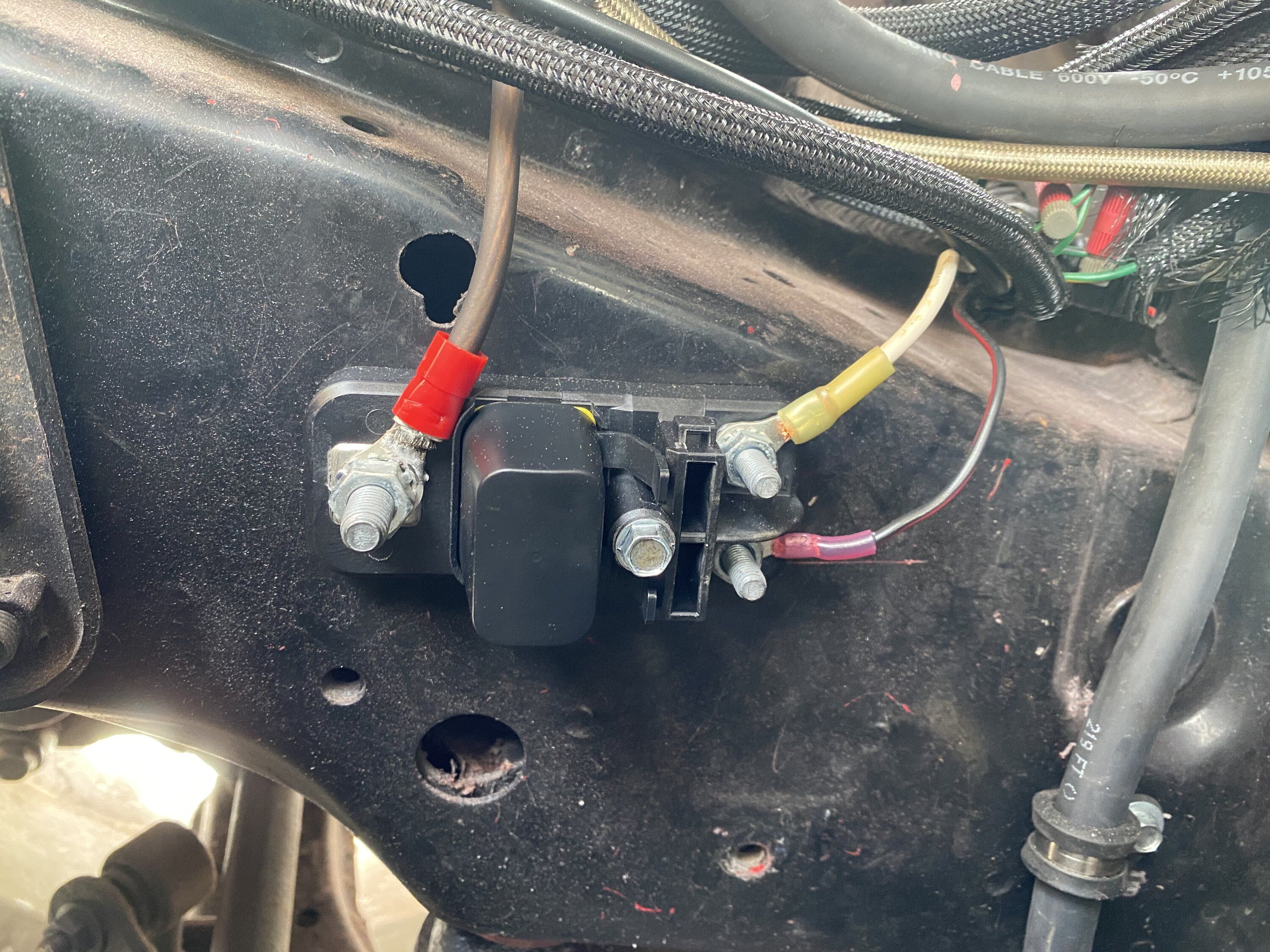

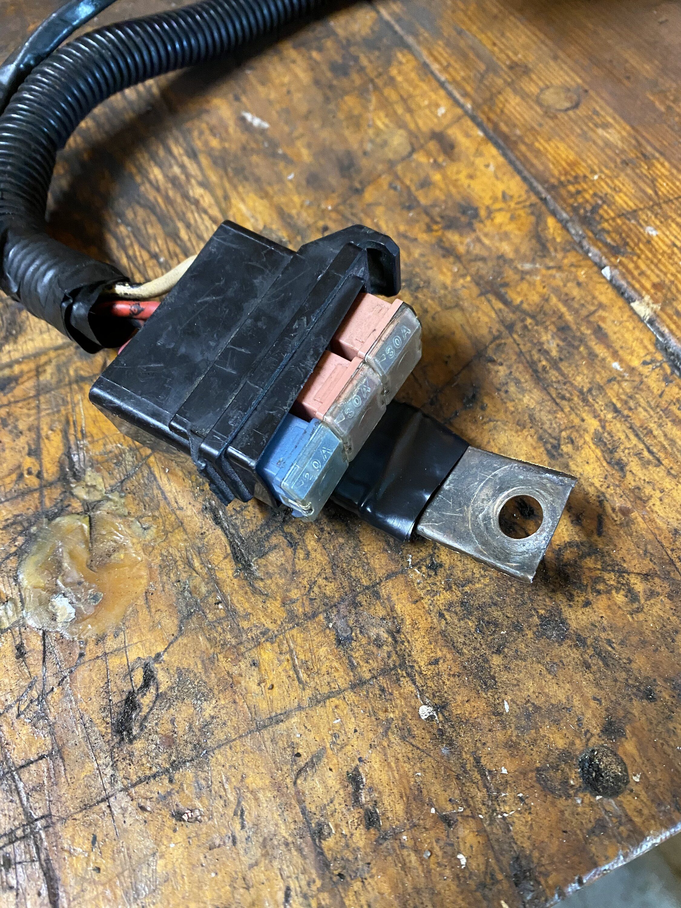

I also replaced the stock fuse panel off the battery with a new one. I was only getting 13.3v through that old connection and now I'm receiving 14.7v. Much better.

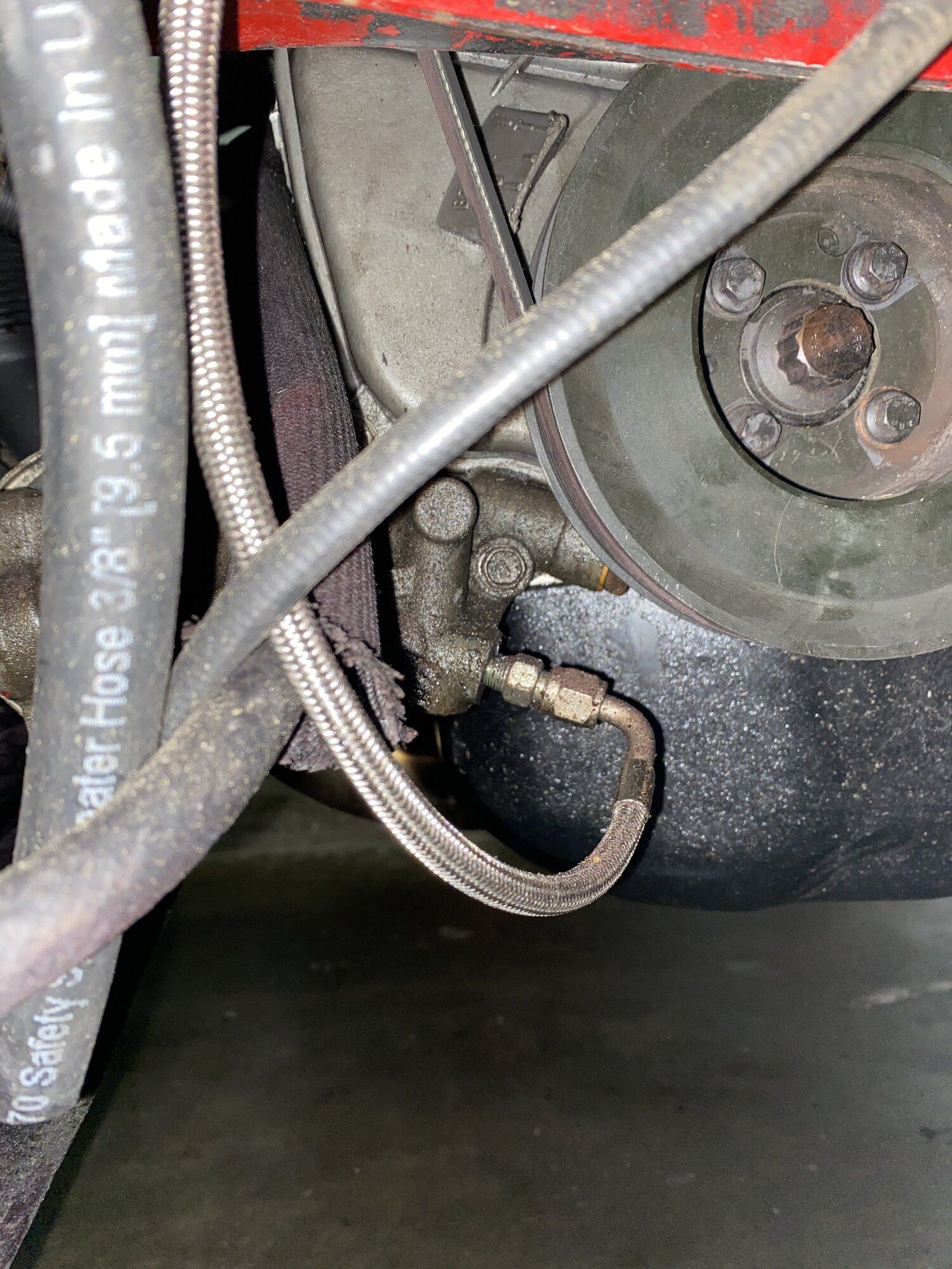

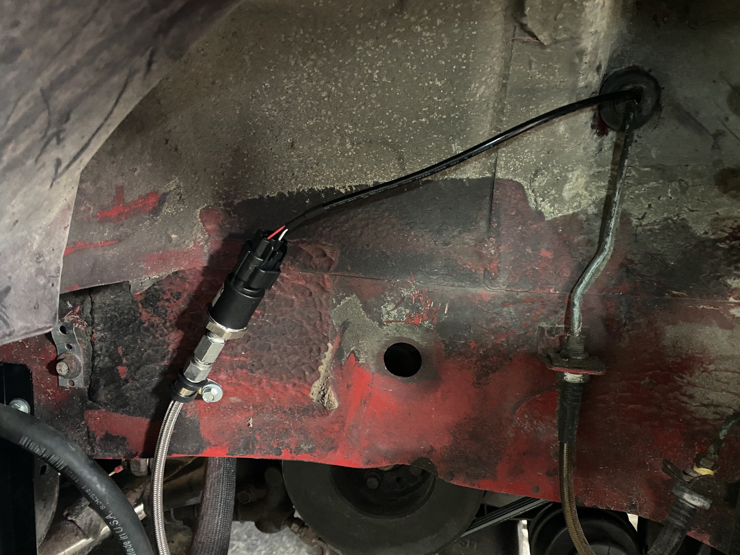

Can you post a couple pictures of the OFH and how you have the oil pressure gauge installed, looks like you have a 3an line or so screwed into the sending unit provided by Innovate; pic 2 of post 502.

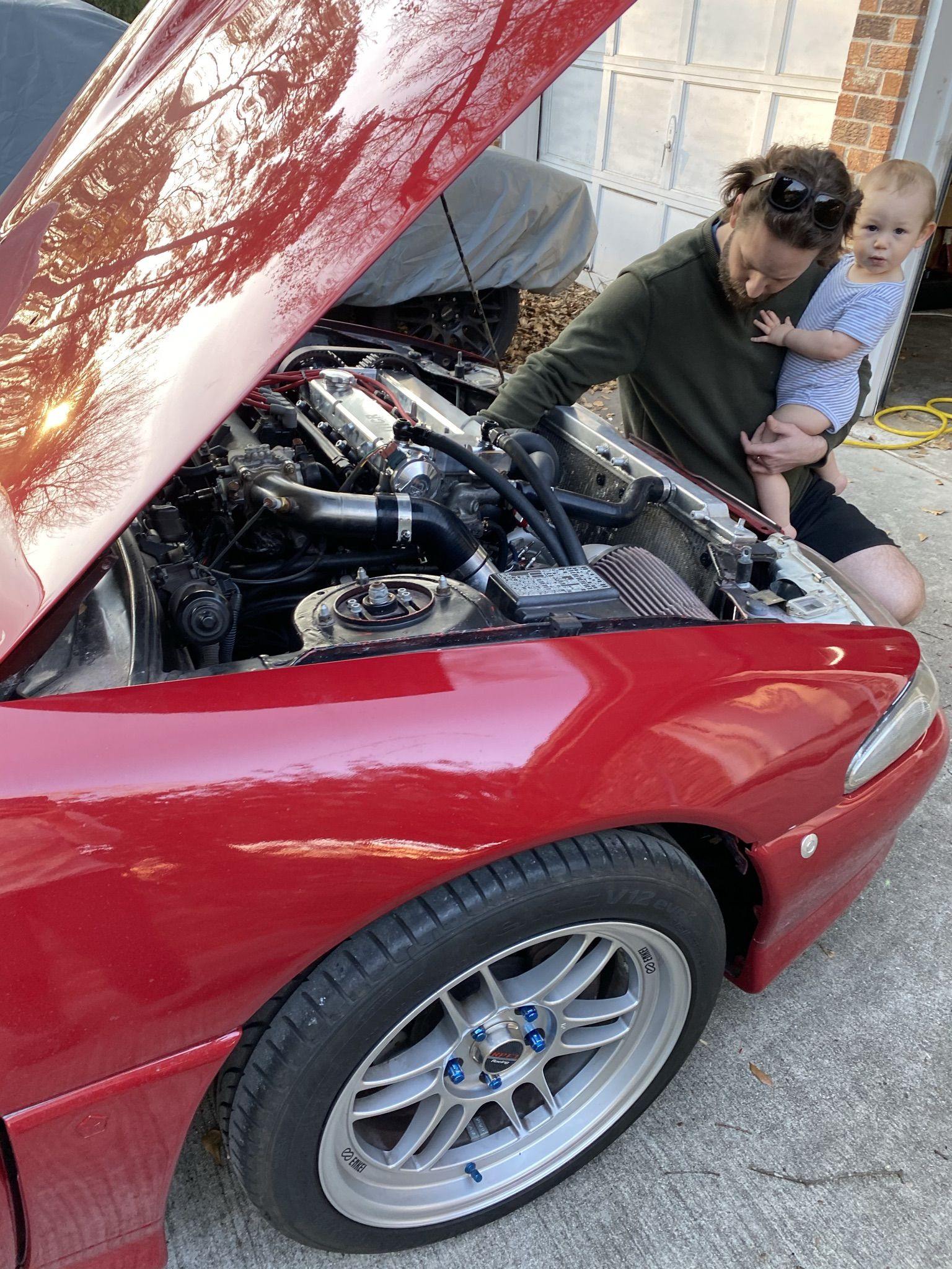

I think I used an stm oil sender relocation kit. It just converts , I think, 1/8bspt to 3an. I run the signal wire through the fender grommet and into the engine bay through the grommet above the steering column. Hopefully this pic will be helpful.
It does, so you have the 1/8 bpst to 3an adapter screwed into the housing, and I just viewed the innovate oil pressure gauge kit on their site, looks like there is something screwed into that to connect the line. It's a male 3an to whatever the threads on to the bottom of that connector, happen to recall what thread size that is?
It's a 1/8bspt to 3an adaptor screwed-in to the OFH then a 3an female to 1/8npt female SS line kit. Maybe 12-18" long? Almost all the oil pressure sensors are 1/8npt.
Edit: Now that I look at it again, it's a 3an line connected to a 3an to 1/8npt adaptor and that connects to the sending unit.
Emailed innovate moments ago and they confirmed it's the 1/8 npt. Thanks!
