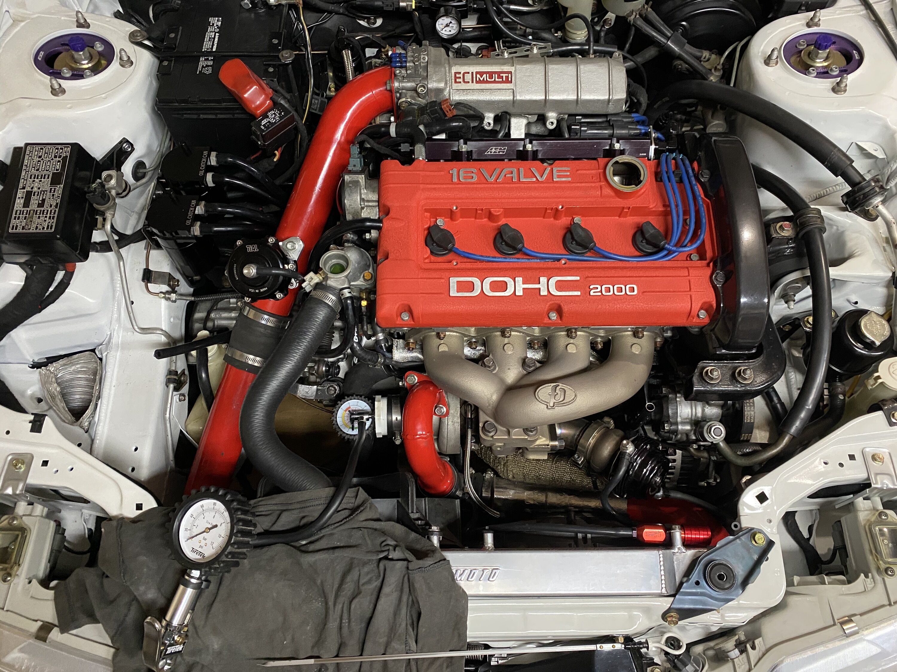

That's not the end of the world. Those seals are "dynamic" and will seal when there is oil pressure. At least, that's how it has been explained to me by FP.
I’ve read some threads and no one mentioned rebuilding the turbo. All they said was to blt after the turbo so i bet you’re right. Weird thing is it never did that before.
I got this turbo about a year ago and have no idea how many miles are on it. The rebuild kit from turbo lab is $65 and the process doesn’t look difficult so I might just rebuild it. Won’t be driving the car until all the snow and salt is washed away so I most likely will end up rebuilding it. We’ll see though
Tony, that's true. And it's kind of normal that you hear bubbling. Those seals don't seal perfectly when the shaft is not spinning fast. So the seals would let the air pass through if you supply the pressure from the turbo inlet and you would hear bubbling if you have oil remained in drain tube or oil pan around return port. (or maybe if oil is overfilled) . So it would be better if you would supply the pressure post turbo, from lower intercooler pipe inlet.
I'll do that and thanks for the explanation Hiroshi:thumb:

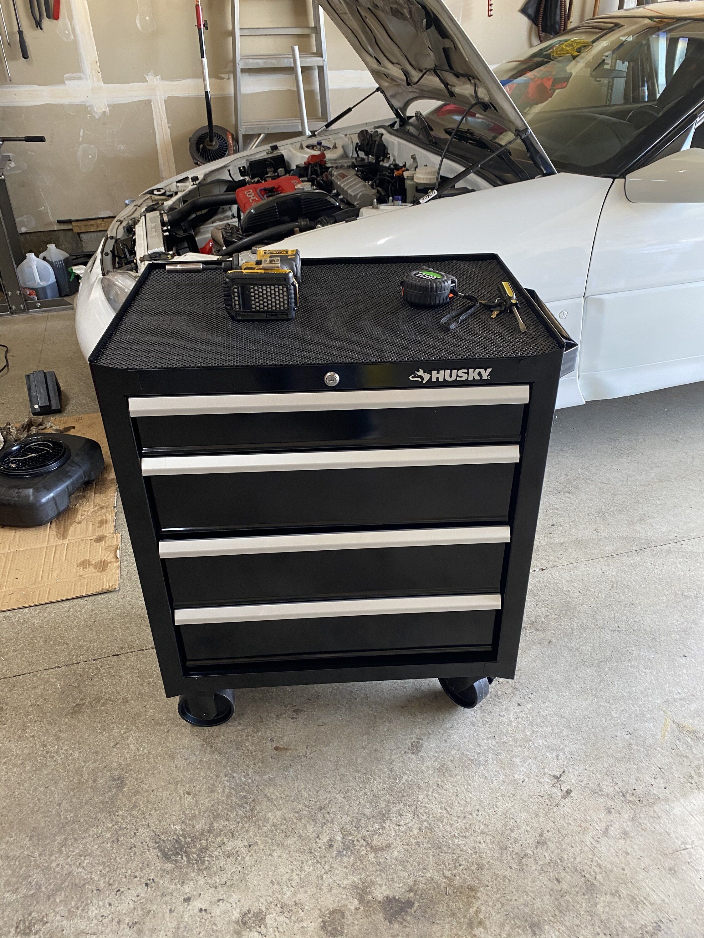

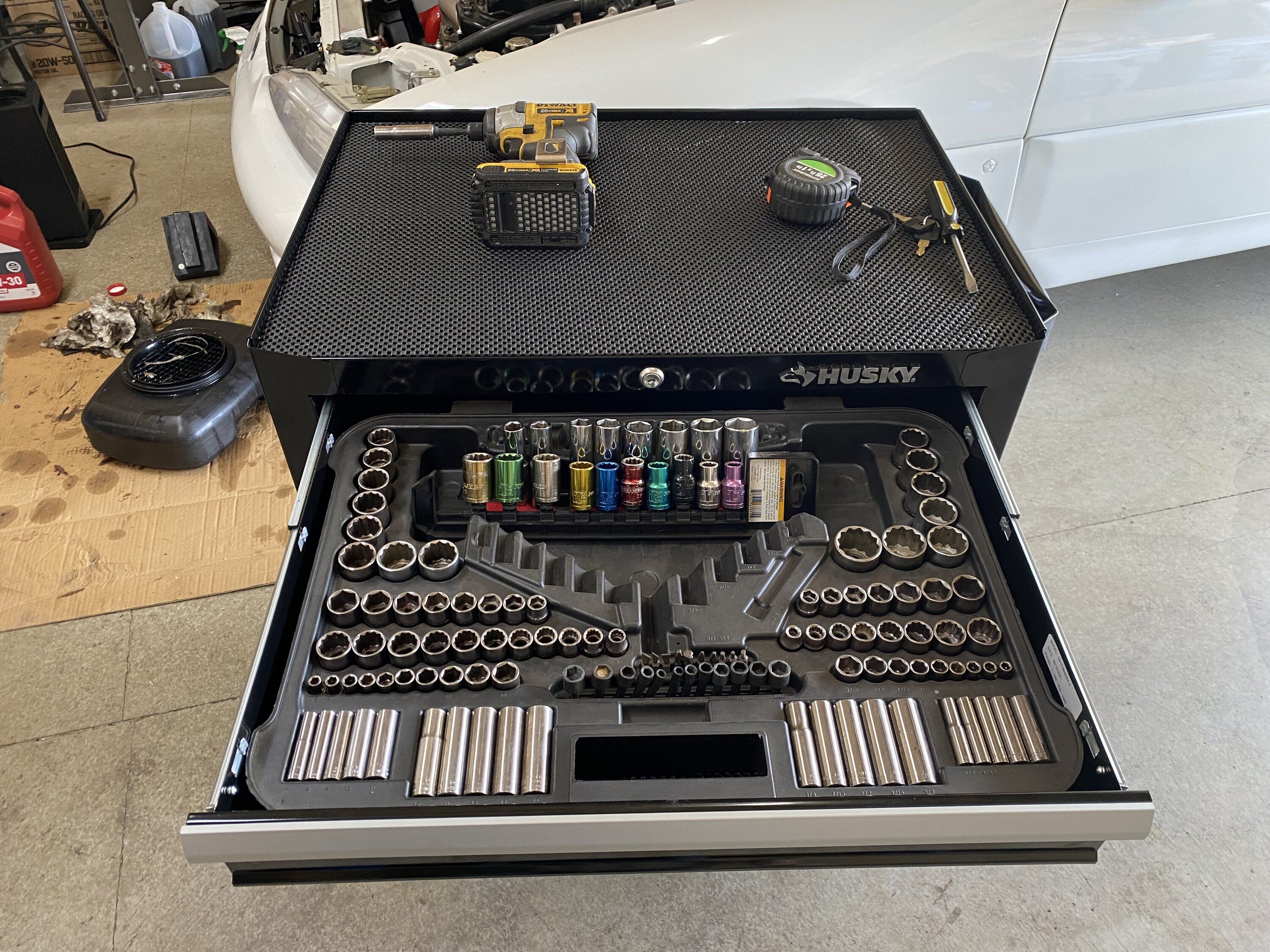

I’ve always wanted a tool cart and finally picked one up today as I had the day off. Didn’t even have to break the case for my sockets and it fits like a gloveeee! Now I wont be saying where TF did I put that 10mm LOL
