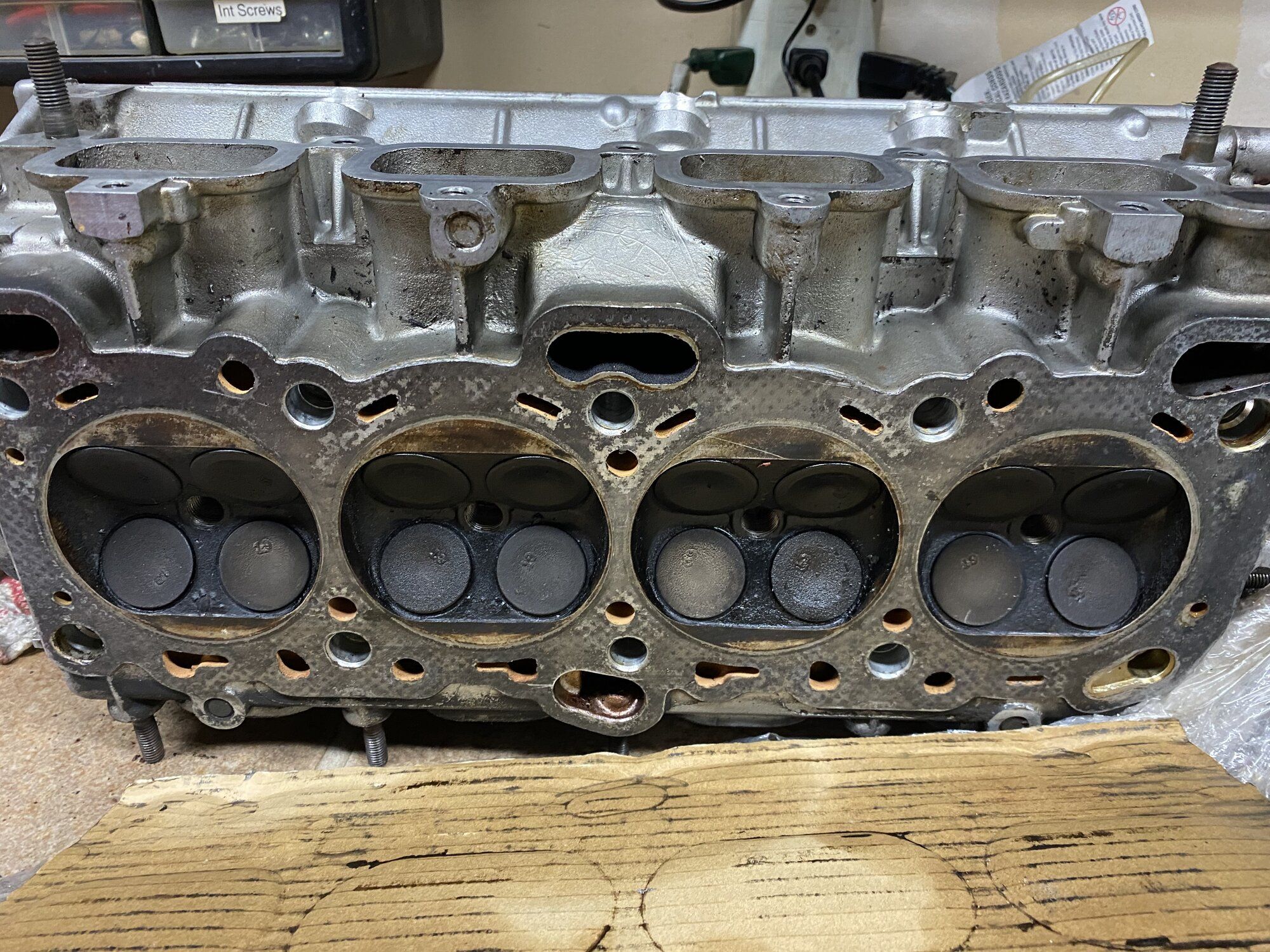

Picked up a virgin spare head. It will be getting new valves, kiggly beehives and a valve job by the end of the year. Cams and hla will be transferred from current head.

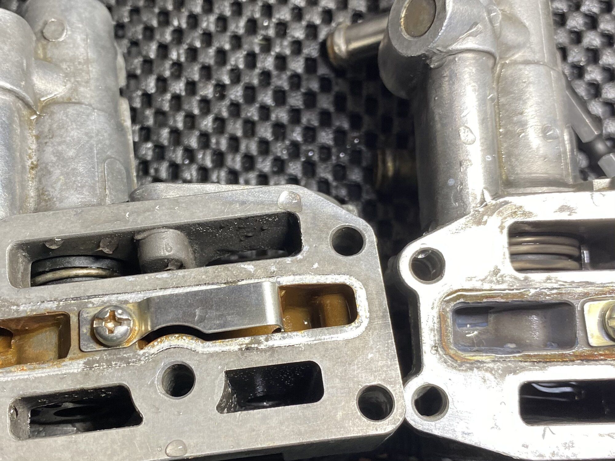

My buddy threw in a 91-94 throttle body since I needed a new idle switch. I also had a feeling my fiav wasn’t working properly since cold start idle seems little higher than normal and it would surge when coming to a stop. So glad this was the issue because I’ve been trying to track this down since rebuilding the engine. You can see the right fiav is stuck

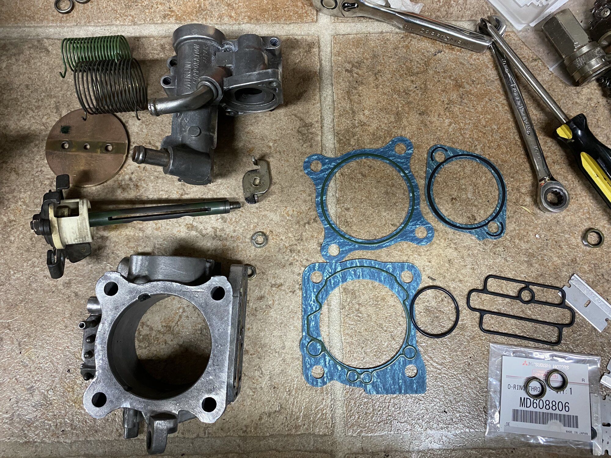

Rebuild the throttle body and installed. Just need to put coolant in and make sure the water pump doesn’t leak as it’s the 4th one after the rebuild. I do think it was my fault not throughly cleaning out the block. We shall see.

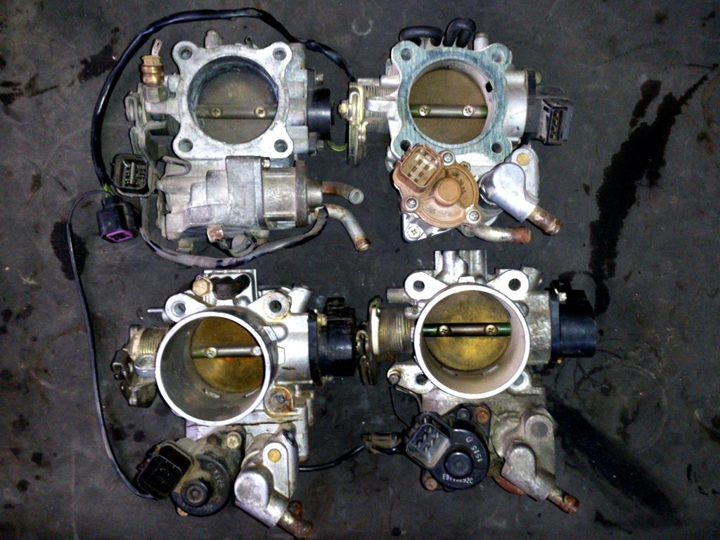

The NA TB has a bigger ID right? I saw the stock elbow they put on the 1gs why did they make it bottleneck like that?
The bottom left is a 1G DSM non turbo throttle body. The bottom right is an early EVO throttle body. Those have the same size, 63mm.
Top left/right are from JDM GVR4/90 Turbo DSM and 91-94 Turbo DSM. Those have 60mm.
thanks
Thanks that helps a lot, mine is actually the top right so i was wrong. Is that a pretty good upgrade over the stock 2g TB?

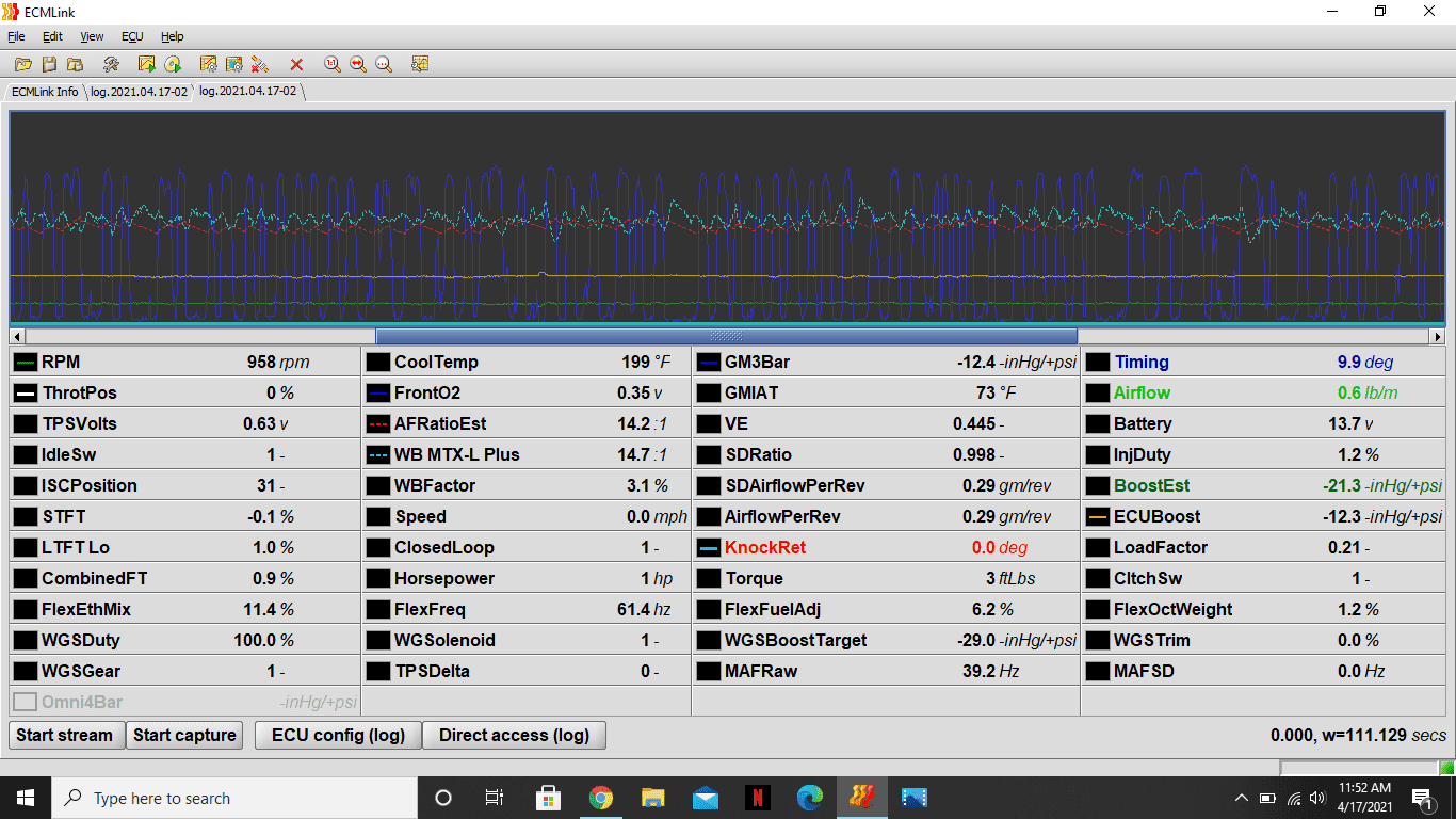

I've been hunting down lots of issues with the car and pretty much got ALMOST everything sorted out and I mean a lot. The latest issue to be resolved is that when the cooling fan would turn on, the idle would go low and idle seemed to surge ever so slightly. Did a BLT, check all grounds and check isc operation and it was all good. Thought maybe it the tune so I tried richening and leaning out the cells in the SD table when the fan comes on..., nope! I was reading the idle switch (IPS) procedure and it said to turn it in 15/16th after switch is grounded which I was unaware of. I did that and now my idle is perfect and doesn't drop when the fan turns on. You can see it in the log where the isc jumps above 30.
The displayed values are averages of the full log.

Good info, i struggle with idle every now and then, i think perfect idle with these engines is very hard to get. Nice work!
It’s been a battle man. Used to be perfect before the engine build. Hope it stays this way
