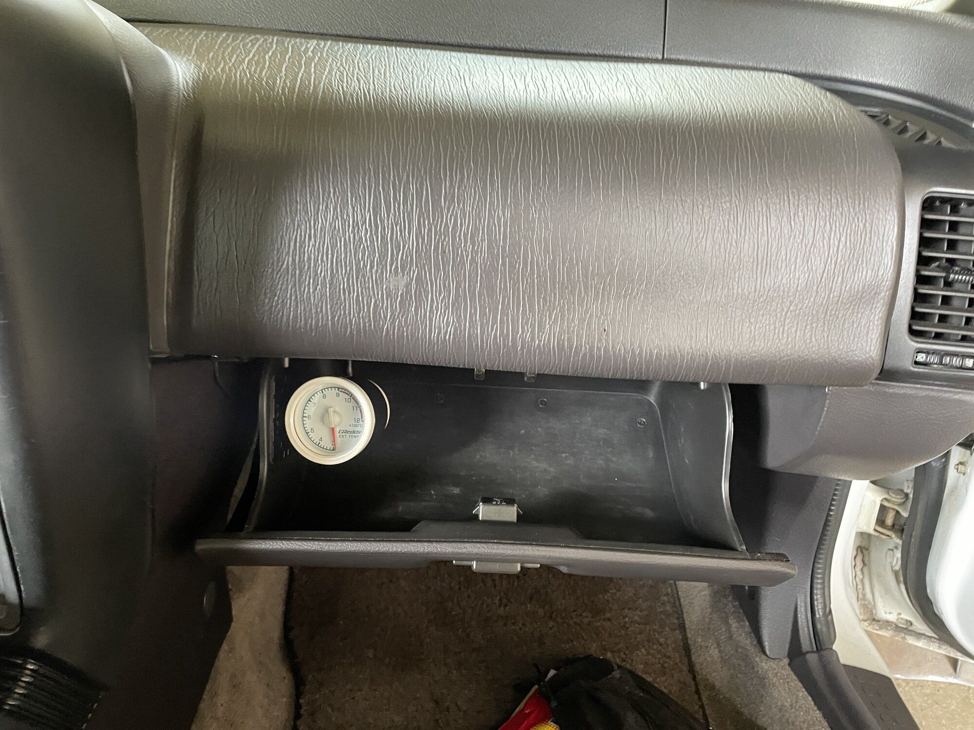

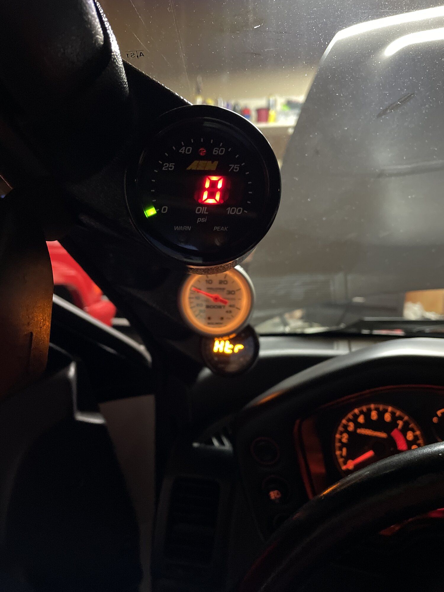

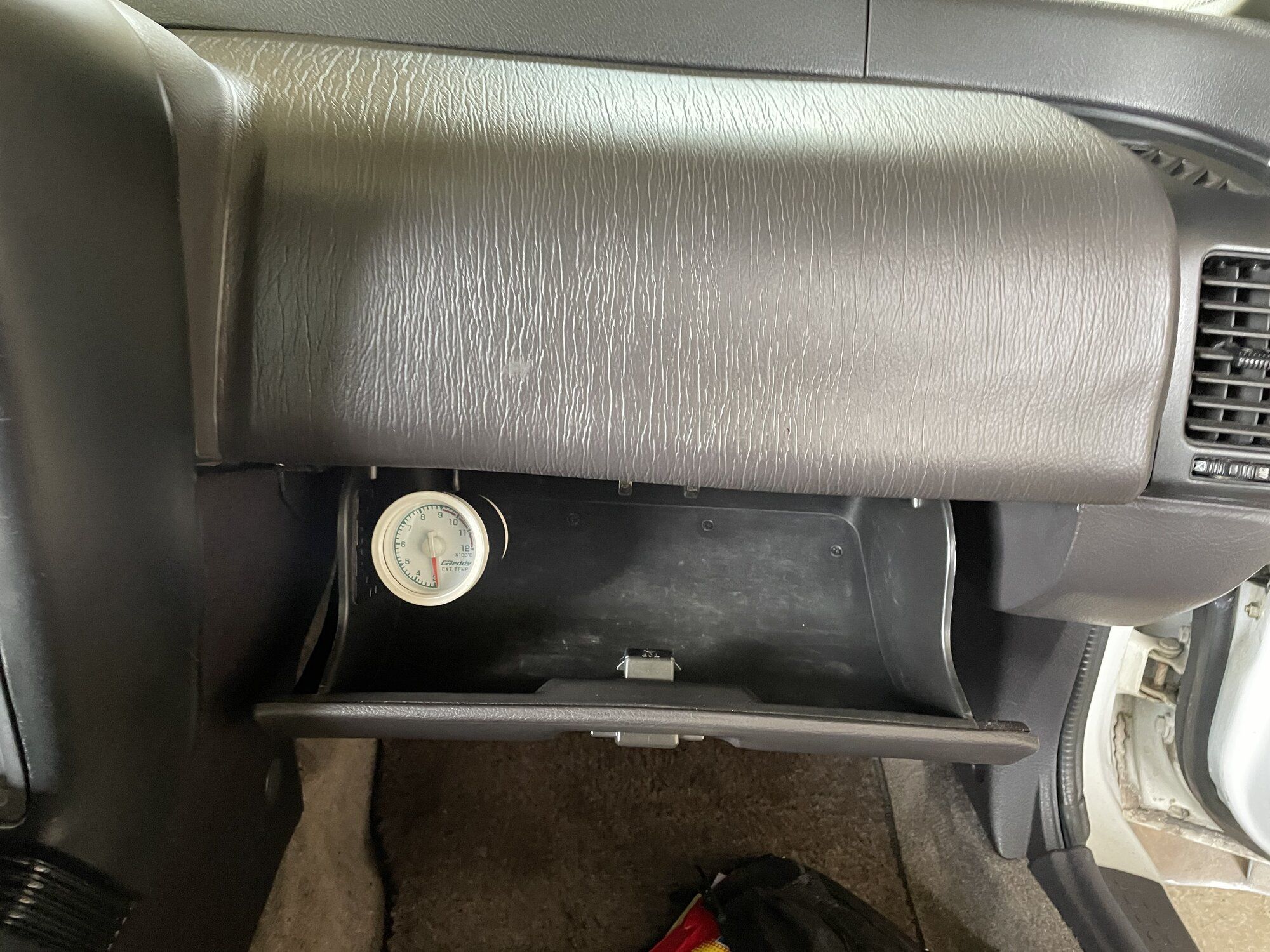

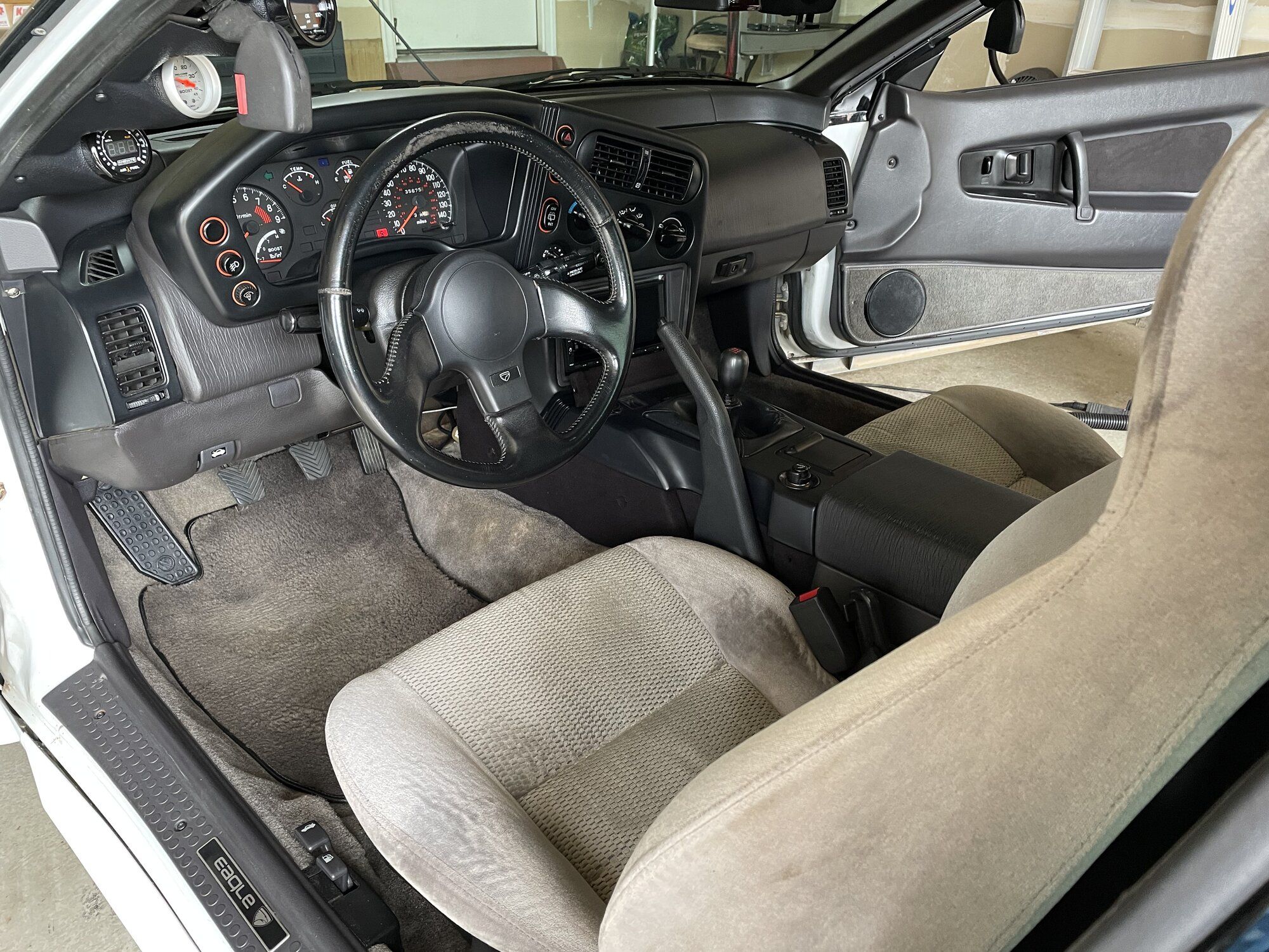

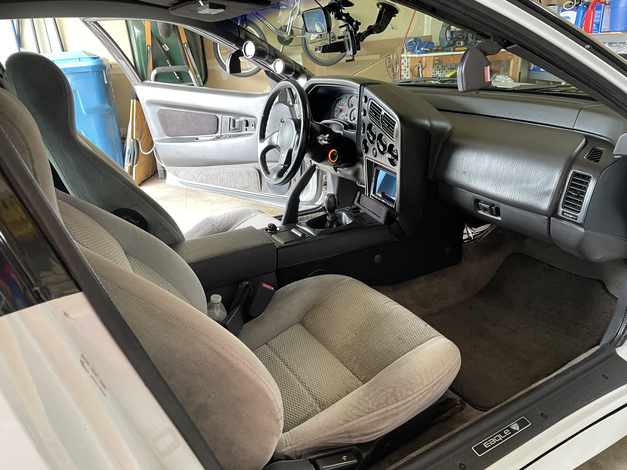

Nothing all that interesting here. Just cleaning up and moving gauges around. Since oil pressure is more important than egt, I moved the egt to the glove box and vacuumed.
Oil pressure is now good through the rpm band so I’m stoked about that.

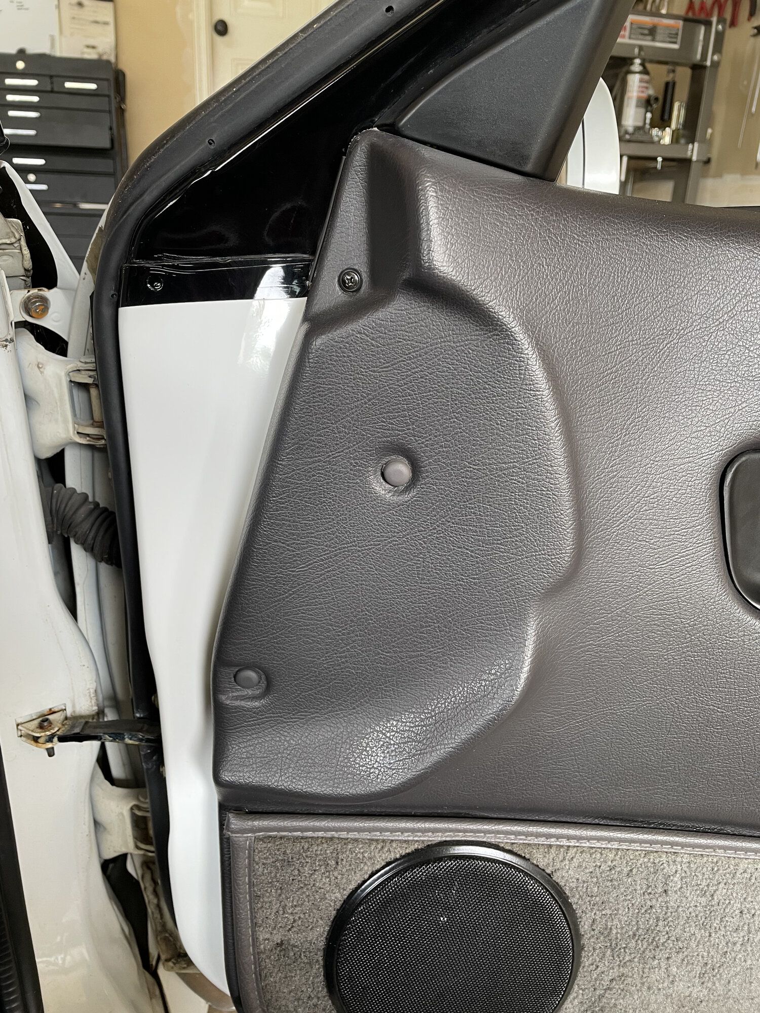

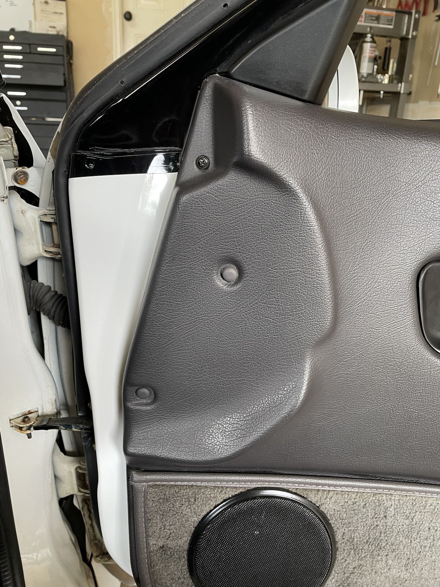

Waited 3 weeks for these door panel clips and now it doesn’t feel like junk when I open the door. Also picked up the original hardware for the door panels… oem freshness!!

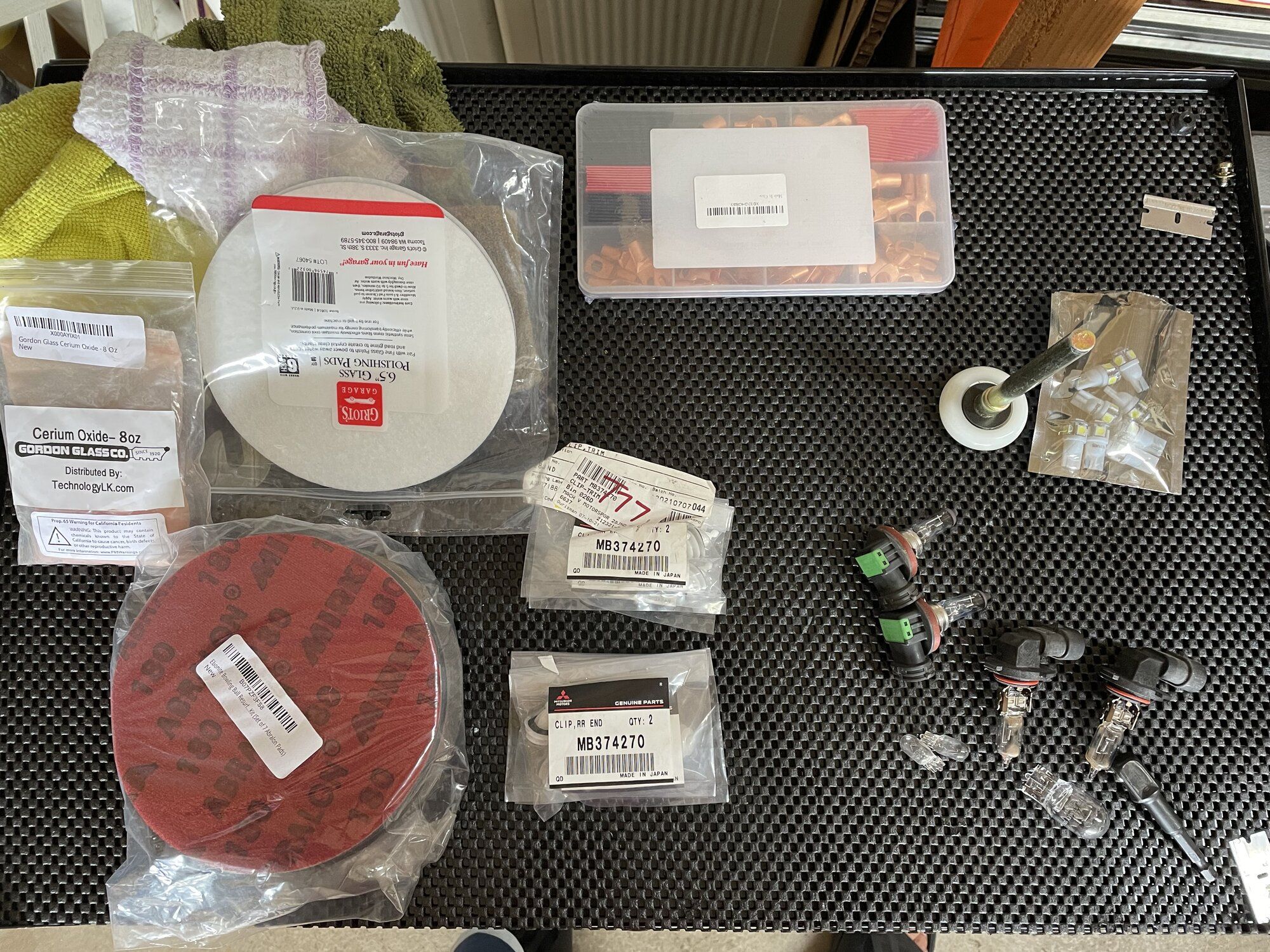

Spent $100 for led light for the TSX and another $400 for ceramic tint. Next I’ll be cutting and polishing the windshields on the tsx and talon because people clean windshields with sandpaper.
Dude your car is cleaner then clean! I’m jealous LOL, I’m putting all the bling in my engine bay but I hope to have the seats re upholstered soon along with a paint job one day :pray:. Also on your oil pressure gauge, I’m about to install my pro sport this weekend, with stm relocation oil line off the ofh, but I’m not sure where to mount the sending unit, may I ask how you did yours?
Thanks Jeremy! I had a pic but I must have deleted it. I used the adapter where the stock oil pressure sensor goes. So basically you remove the stock pressure sensor, install the adapter, stock pressure sensor and aftermarket oil pressure sensor.

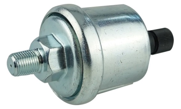

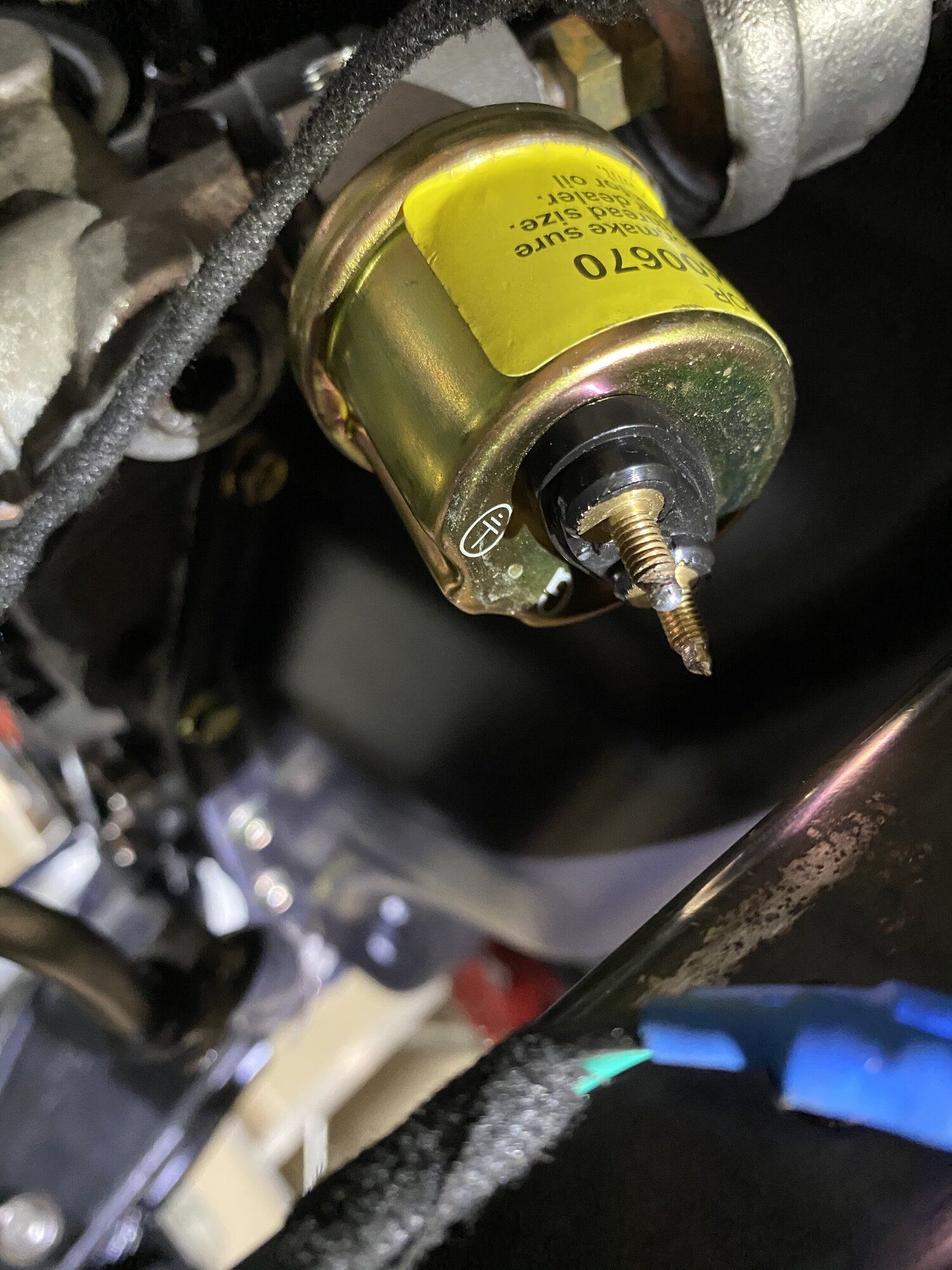

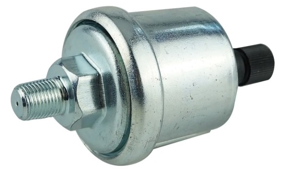

the aftermarket sender unit could fail due to vibrations at the OFH?
Not all aftermarket senders. VDO type pressure sensors are the ones that easily get failed with vibrations. (like the one that looks like the pic) The sensors that look like AEM's have no problem to be directly mounted on OFH.
Mine’s a pro sport which looks the same as TK’s in his pic, is that a VDO?
Yes. When I was using that type of sensors, I used to replace it very often (I was mounting it on OFH directly). But it stopped failing since I used a short -4AN line to mount it somewhere else.
Well I reckon I’ll use my relocation line then LOL, I’m curious did you mount it to the frame somewhere?
Glad I switched to aem 😅
Yes I was mounting to the frame side by a clamp w/ rubber. But IIRC I clamped the fitting part to make the sensor free to avoid to get vibrations.

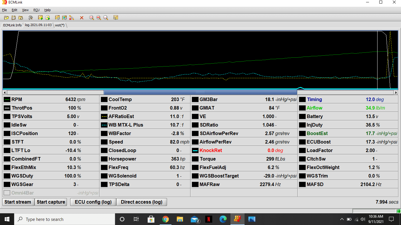

Finally got a wot up to 6500 with no knock, decent afr's and great oil pressure. Only 18psi as it's on gate pressure with up to 12* of timing (for now LOL). Idle is perfect but I see it needs just a bump in global. None the less, I am super stoked to finally be in boost.
