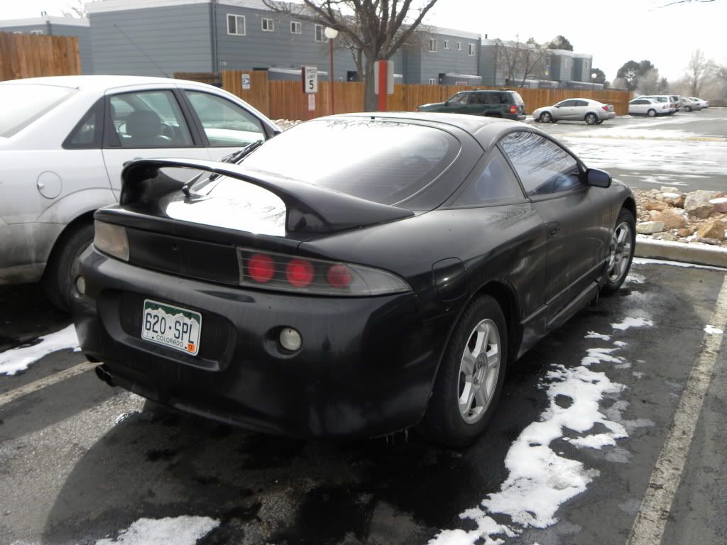

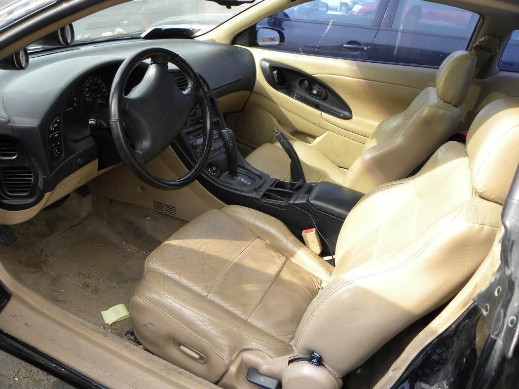

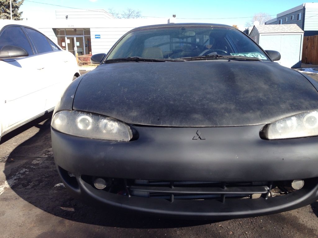

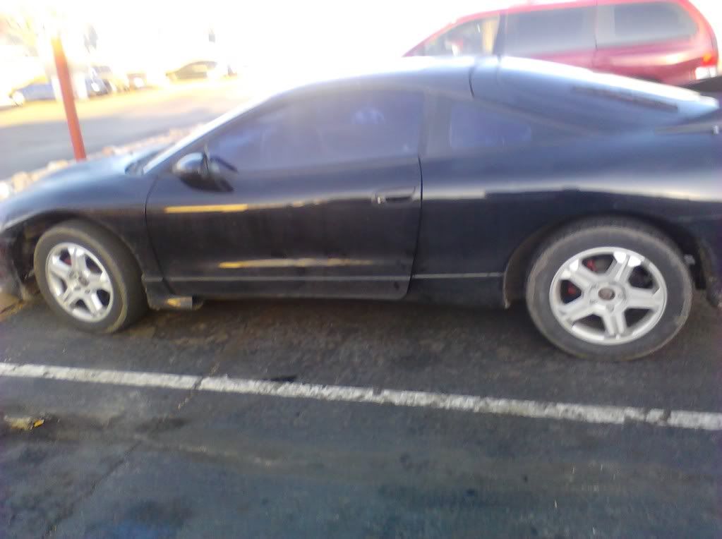

This is the car as it sat the day after I bought it. A little rough looking but it actually ran well (or so I thought).
So knowing that I was deploying soon I didn't really plan to do much to it before I left. I drove it around for a while and then parked it at my Fathers house while I was in Afghanistan.

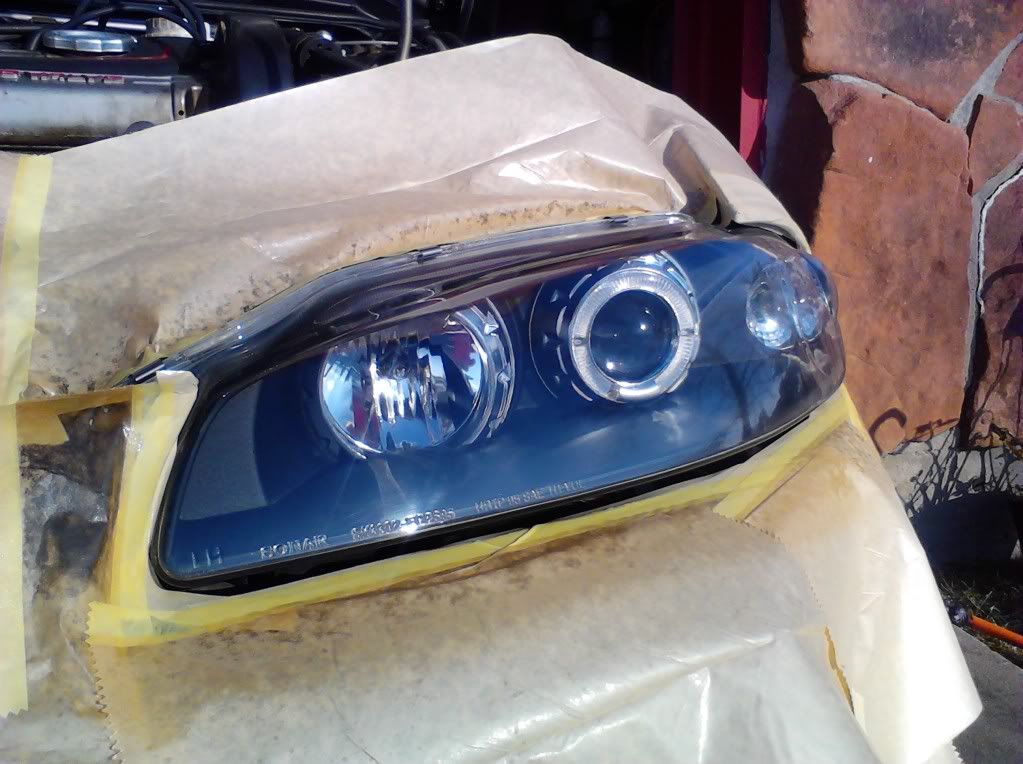

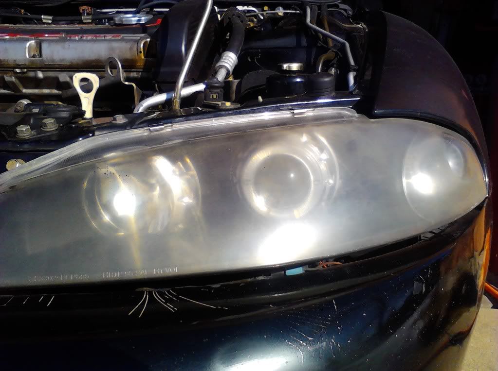

The headlights were very faded and yellowing and my Dad told me he had a fix for it. I think they turned out great.
Before
After
I couldn't believe how well the wet sanding kit made these look. Next on the list was the bumper.

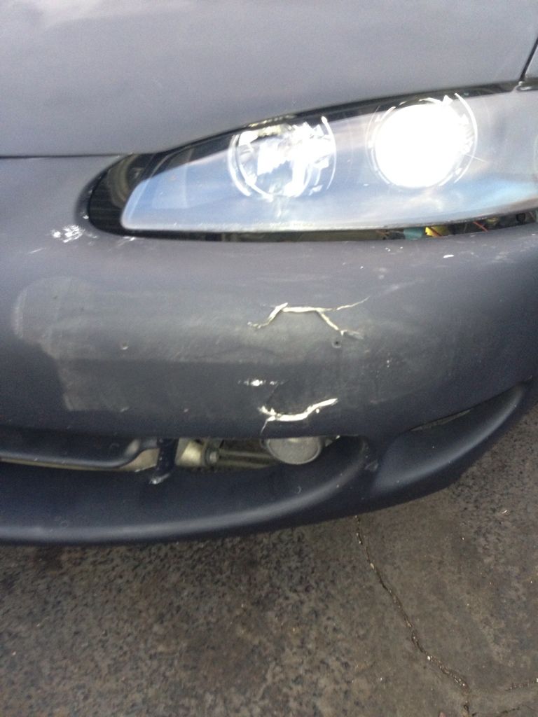

Unfortunately I hit a Lady that started to pull across an intersection and decided at the last minute she was going to wait for another car to pass. Since two vehicles cannot occupy the same space I needed a front bumper again.

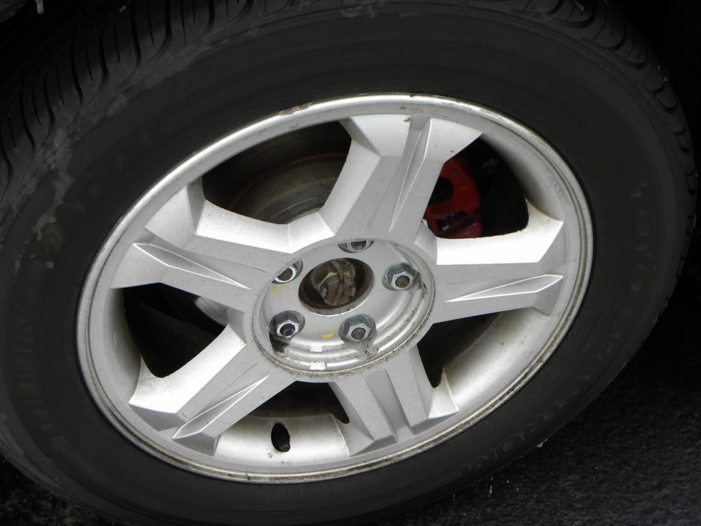

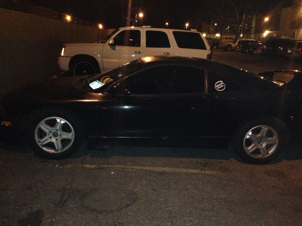

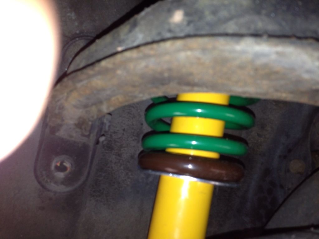

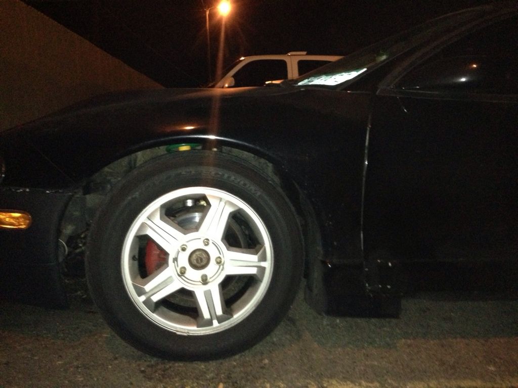

Instead of making the bumper a priority I decided I didn't need to go Off Roading in my AWD Eclipse and wanted to lower it. I found a great deal on some Koni Yellows and some Tein springs on Craigslist. Sorry for the night pics but it was late when we finished it all.
Next on the list was the Bumper again but I decided that since I was missing a side skirt and wanted a full kit, I would buy the whole setup. Again Craigslist hooked me up.

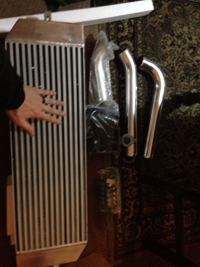

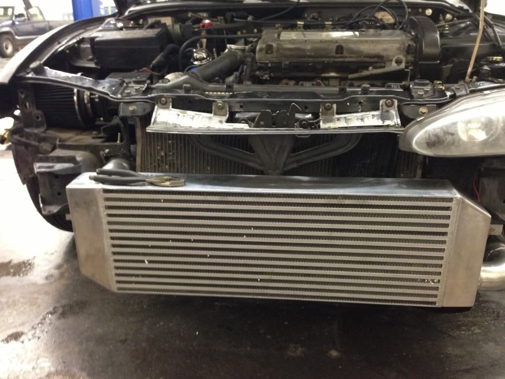

At this point I wasn't able to get the front bumper on without cutting it for the Intercooler and I really wanted the VRSF kit. Since I was wanting the Intercooler kit I waited to put the front on until the new IC kit was installed.

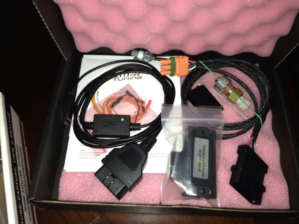

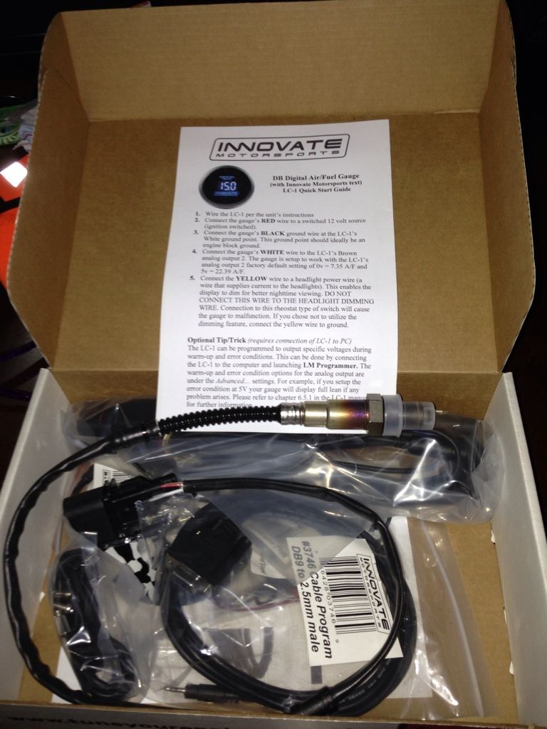

After I got my tax returns this year I bought some goodies for the car. DSMLink v3 Full, VRSF Short Route IC Kit, Speed Density setup with GM MAF Cable, and LC-1 Wideband O2.

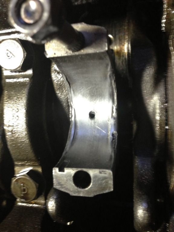

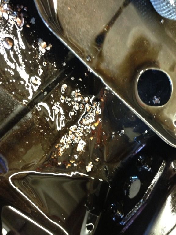

I installed DSMLink and put off the Speed Density, LC-1, and Intercooler kit for a week or so. I was sure glad I did. The Friday after I installed link I ended up spinning a rod bearing.

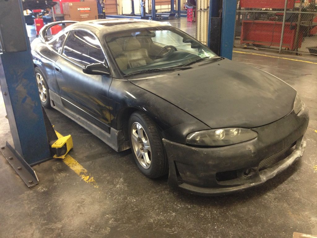

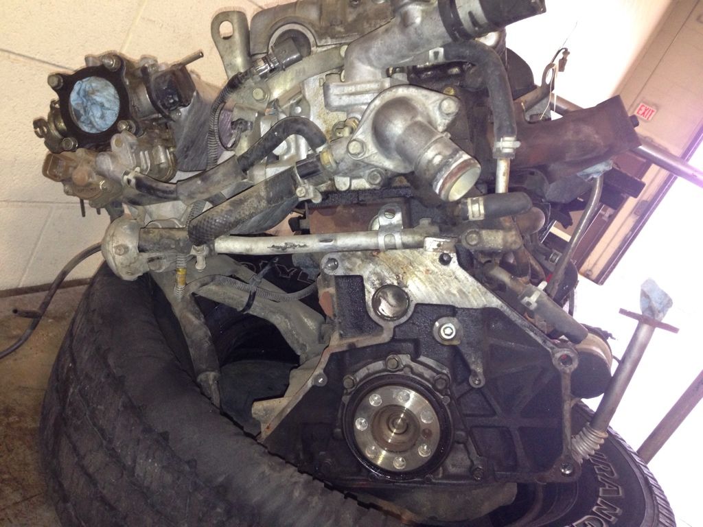

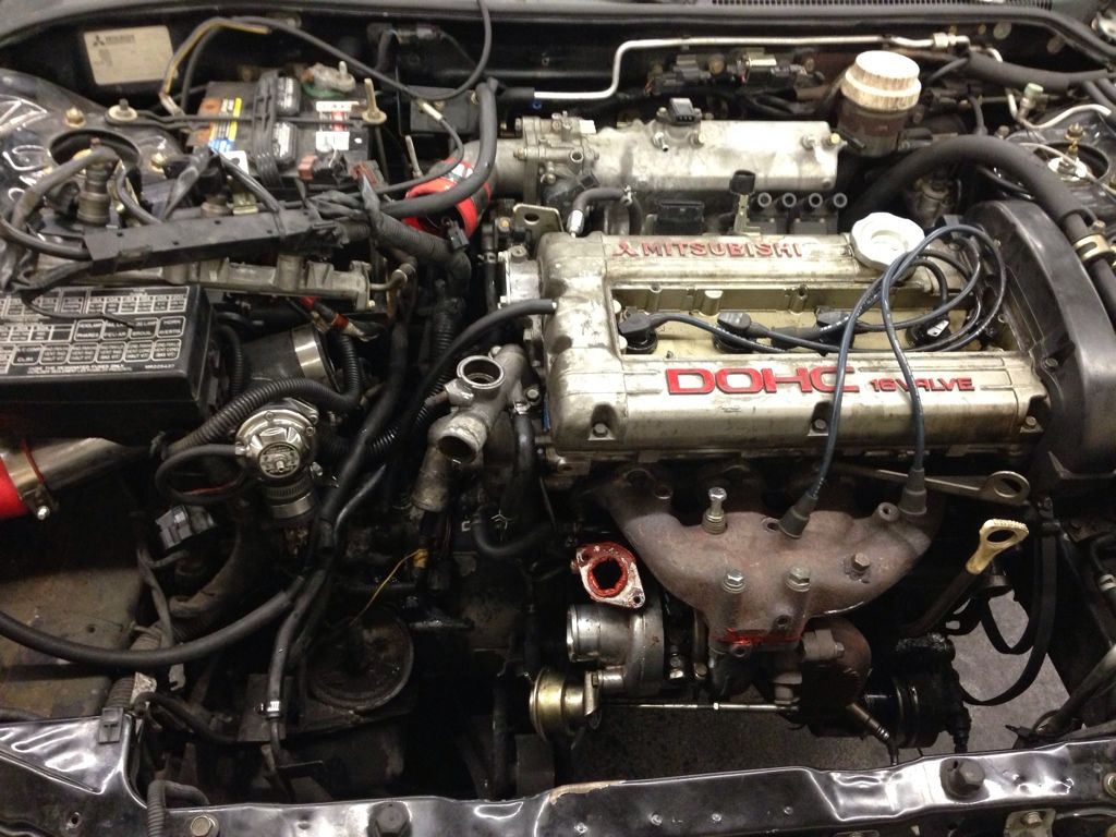

Me and my Father tried to replace the bearing and that didn't even get me home from the shop. Having spent all of my spare money on upgrade parts I ended up having to sell stuff so I could buy a motor to get my Daily Driver running again. Ended up selling all my new parts except the Intercooler kit to make the cash I needed for a running motor I found near me. It was out of a 95 TSI. I had a couple issues with the swap which I will explain after a couple pics.
"New Motor"
Pulling the Old one out

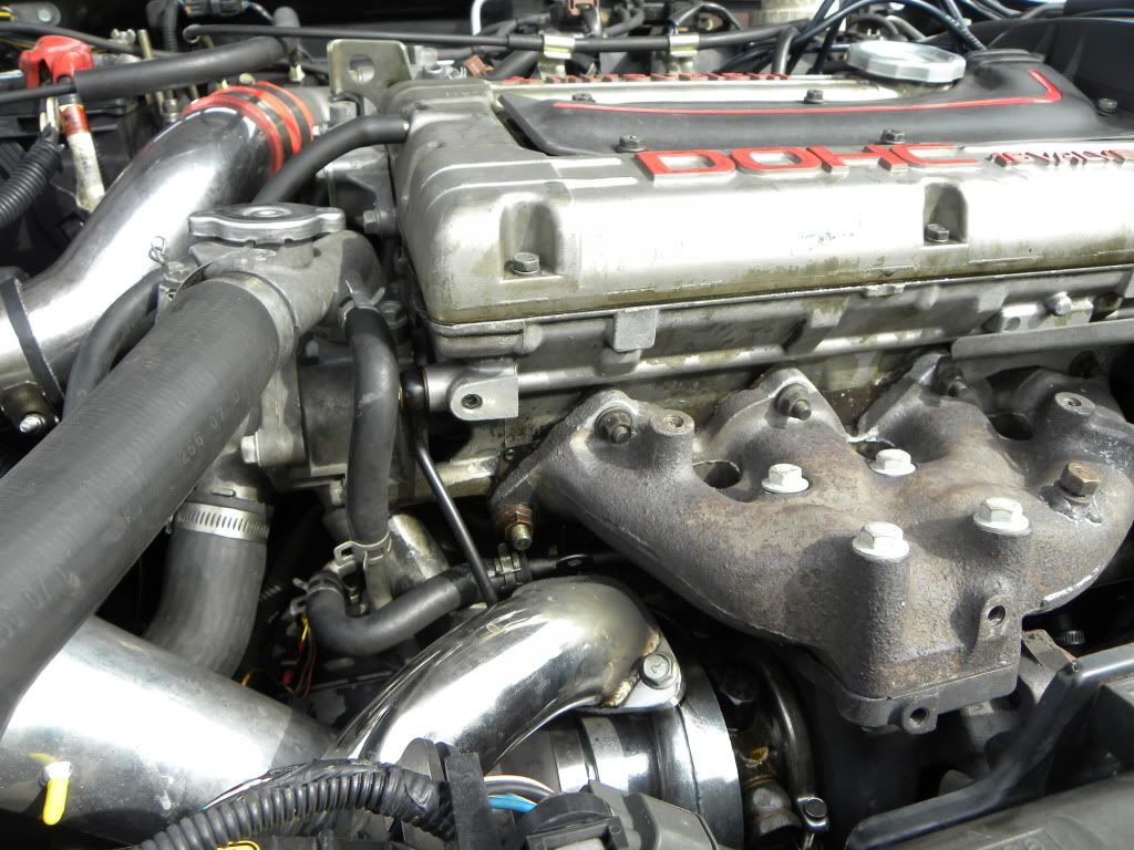

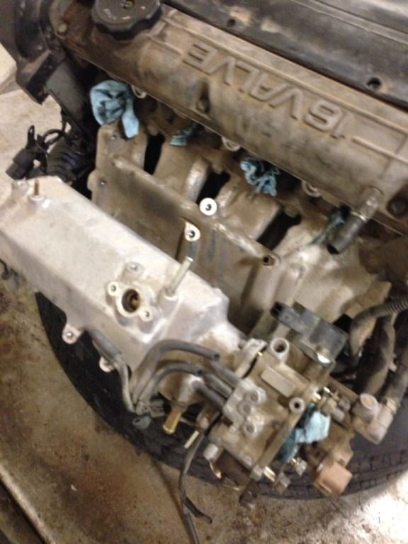

I didn't really take photos of the install process because it took much longer than I expected to pull the motor and I was working on a time crunch for the bay I was "renting" for the weekend. Ran into issues with the Cam Sensor from the 95 being on the timing side of the motor and the wiring harness having the connector on the Transmission side.
After a lot of phone calls and texts to some people from DSMTuners and some deliberation between swapping the old head to the new block, finding a 1g cam sensor and installing it to the new Valve Cover, and just extending the existing harness over and swapping the plugs around, I decided to do the last one and extend the harness. It probably wasn't the right choice but it was what was gonna get me on the road that day. I am sooooo glad for that whole experience to be over, but looking back it wasn't too bad for my first ever project like this. I think if I did it today I would be much better knowing how everything works.

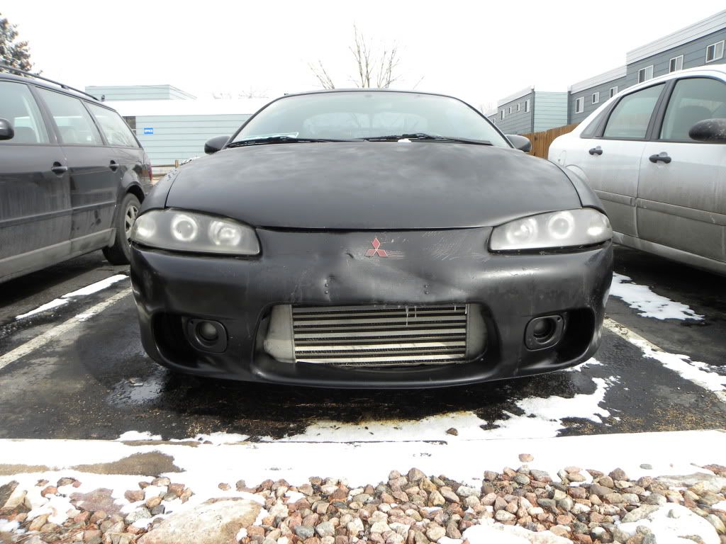

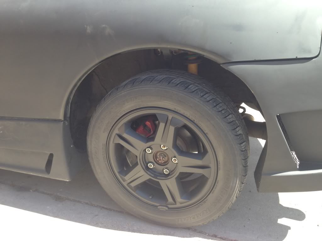

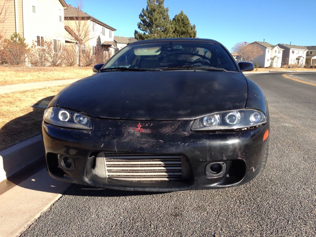

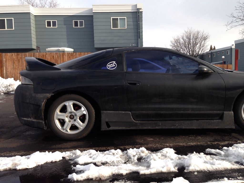

After the motor install and working out some small bugs I decided to finally install the FMIC and Front Bumper from my kit!

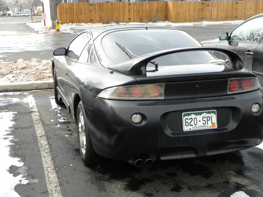

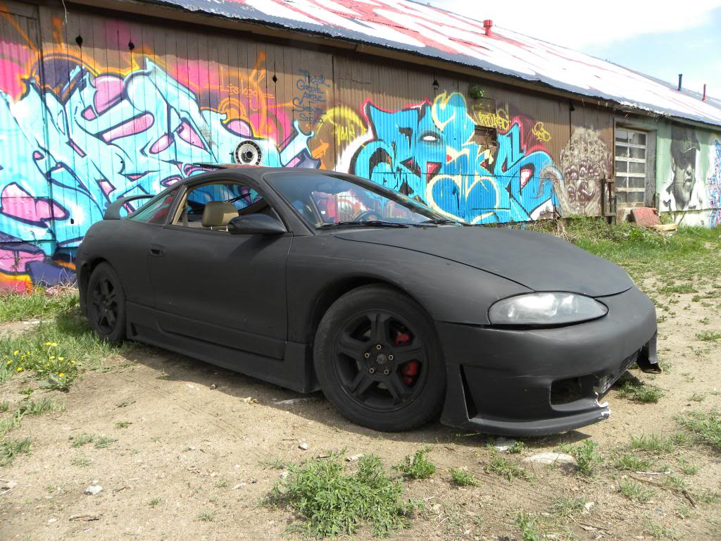

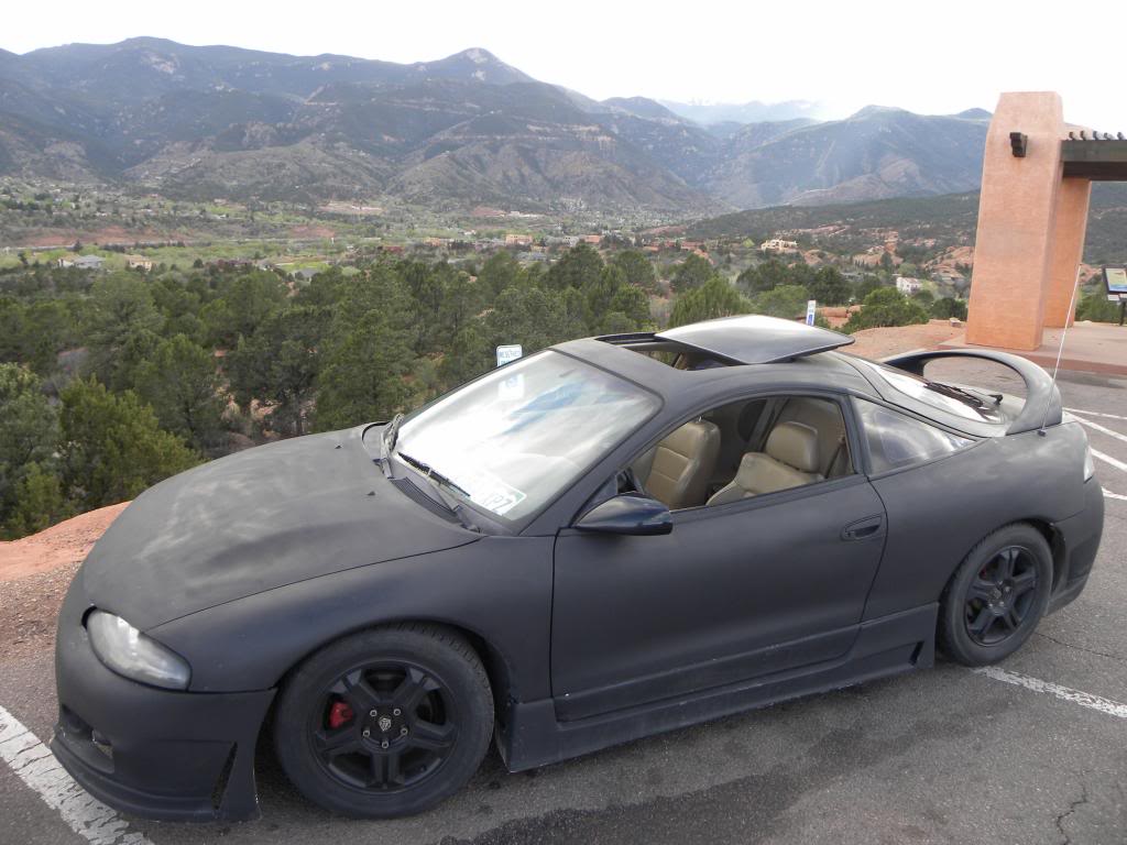

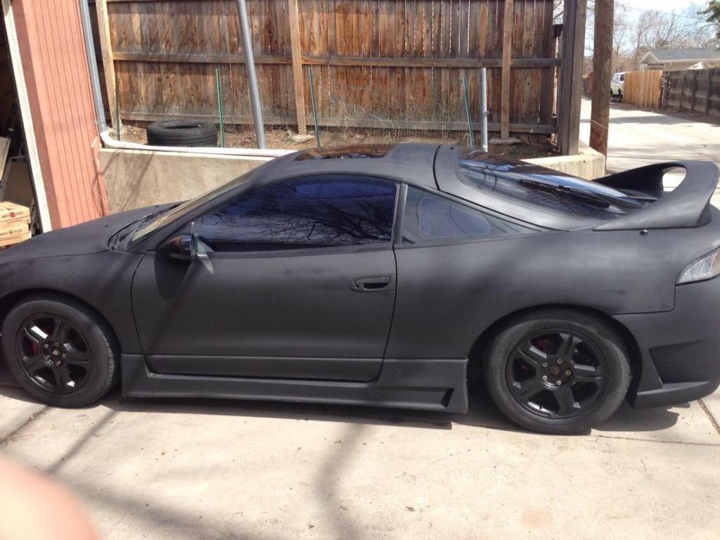

I also decided that the paint was horrible and couldn't be any worse if it was spray painted on with a rattle can so I did that also. I also Plastidipped the rims with a little help from my Daughter (haha she did the hard part)
All in all I think it turned out great for a couple cans of spray paint!!

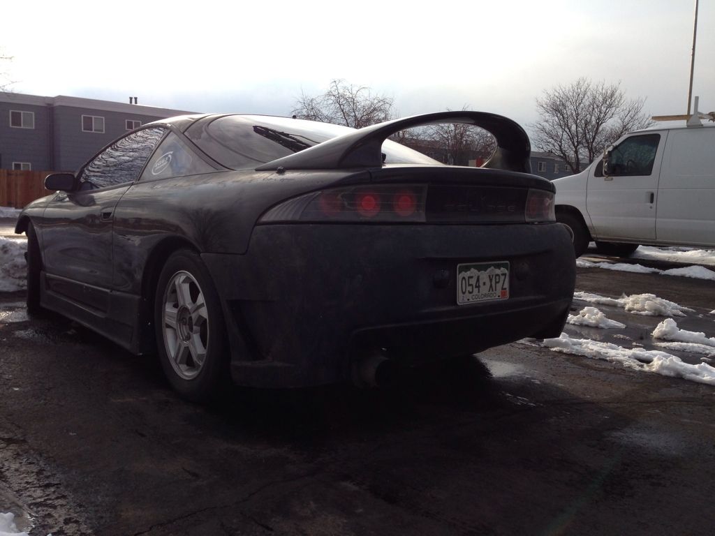

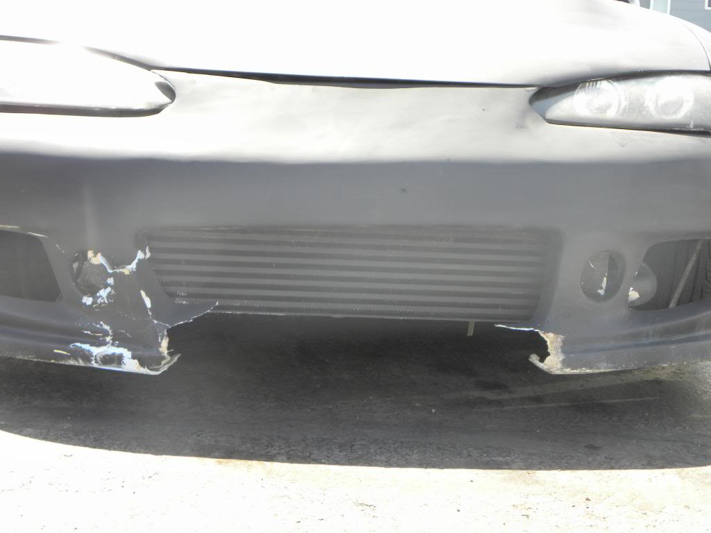

That is basically where my car sits today for the most part!!! I did tear off the lower part of the front bumper while doing a photoshoot. There was a tree trunk that I didnt remember about and it decided that it didn't like my bumper anyways.
So I have decided to hold off on replacing it again. I am planning on doing a full build this winter since I have a spare long block sitting my my Father In Laws garage right now. My car is about two months away from being a Garage Queen while I do a full build. I have gotten the wife to agree that it is no longer my daily driver and I need to buy something else so I can have months of downtime on this car while working toward its ultimate goal.
