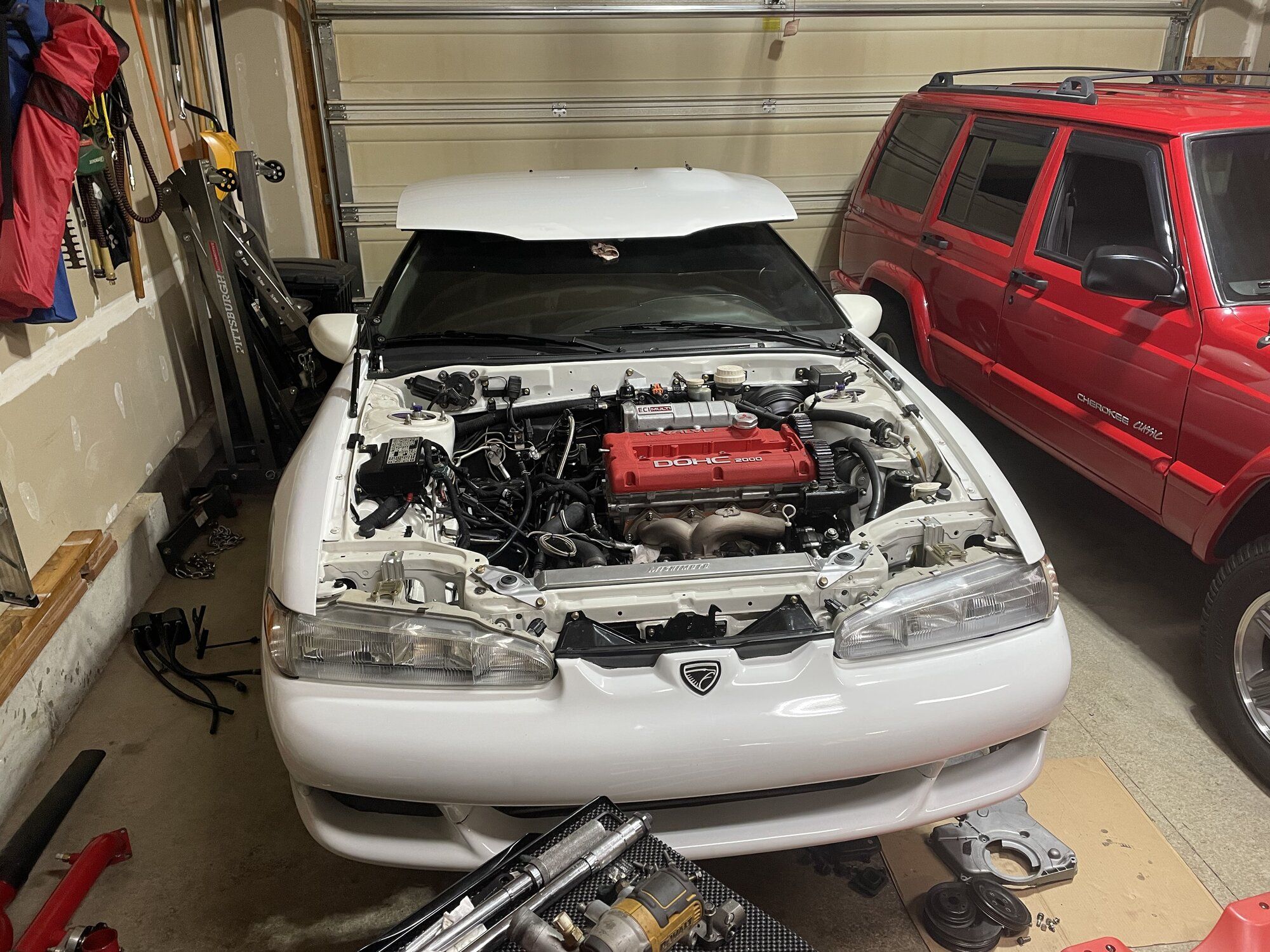

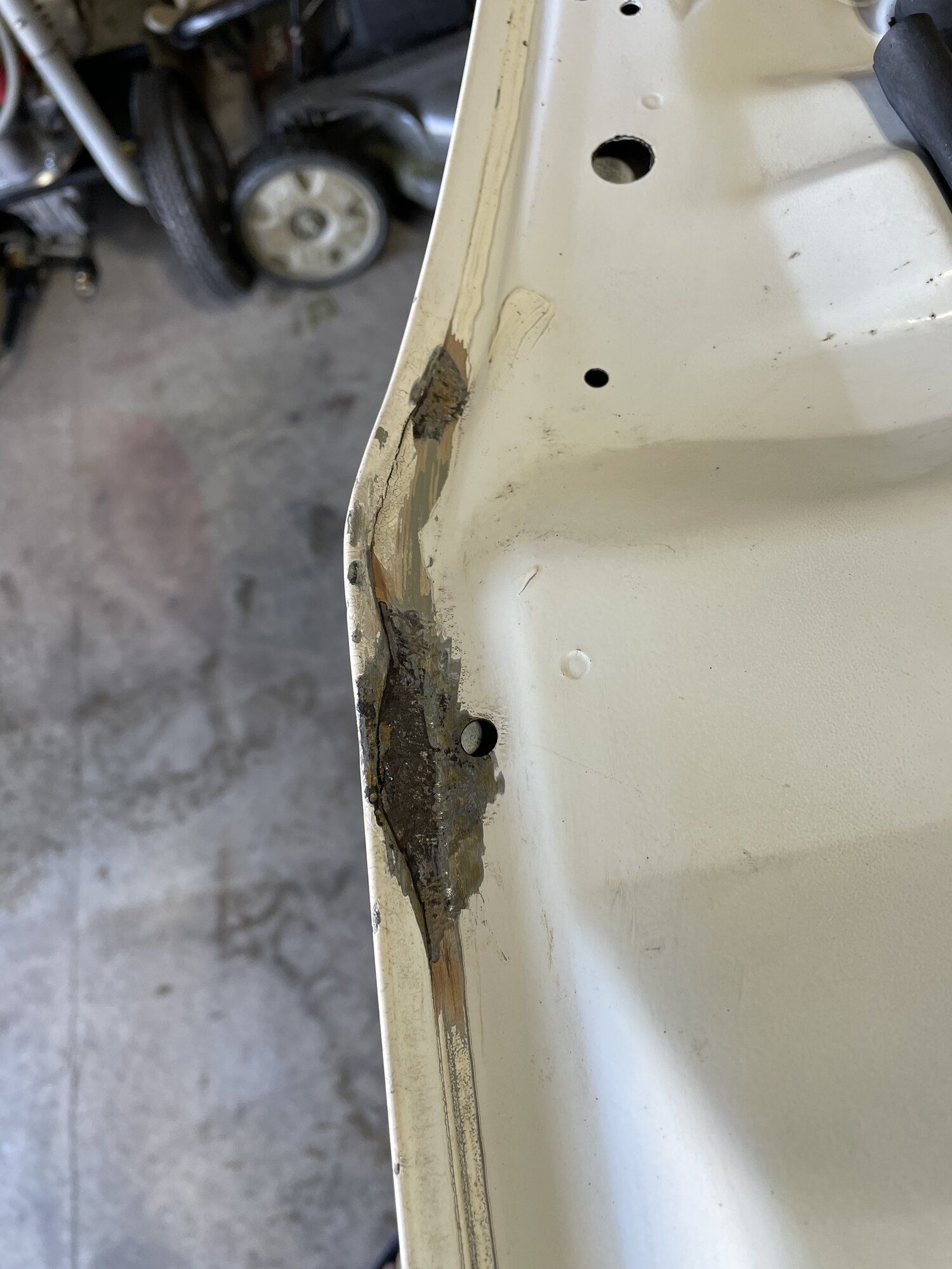

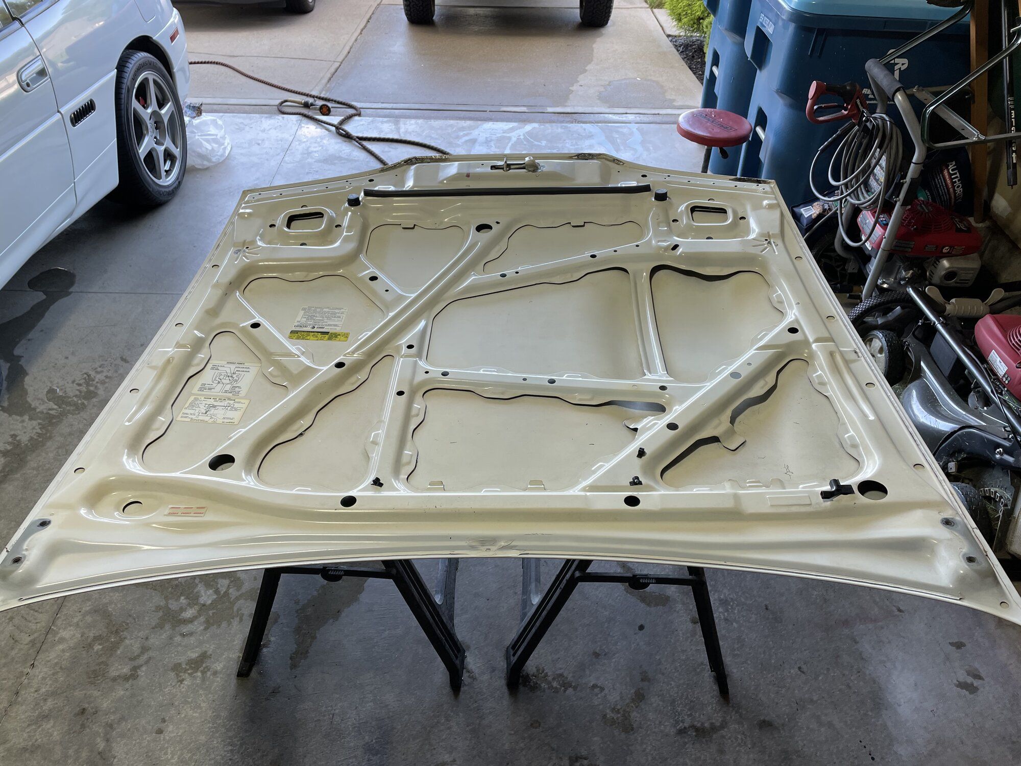

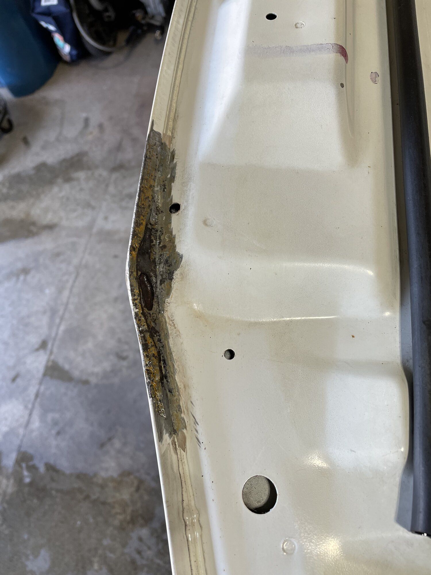

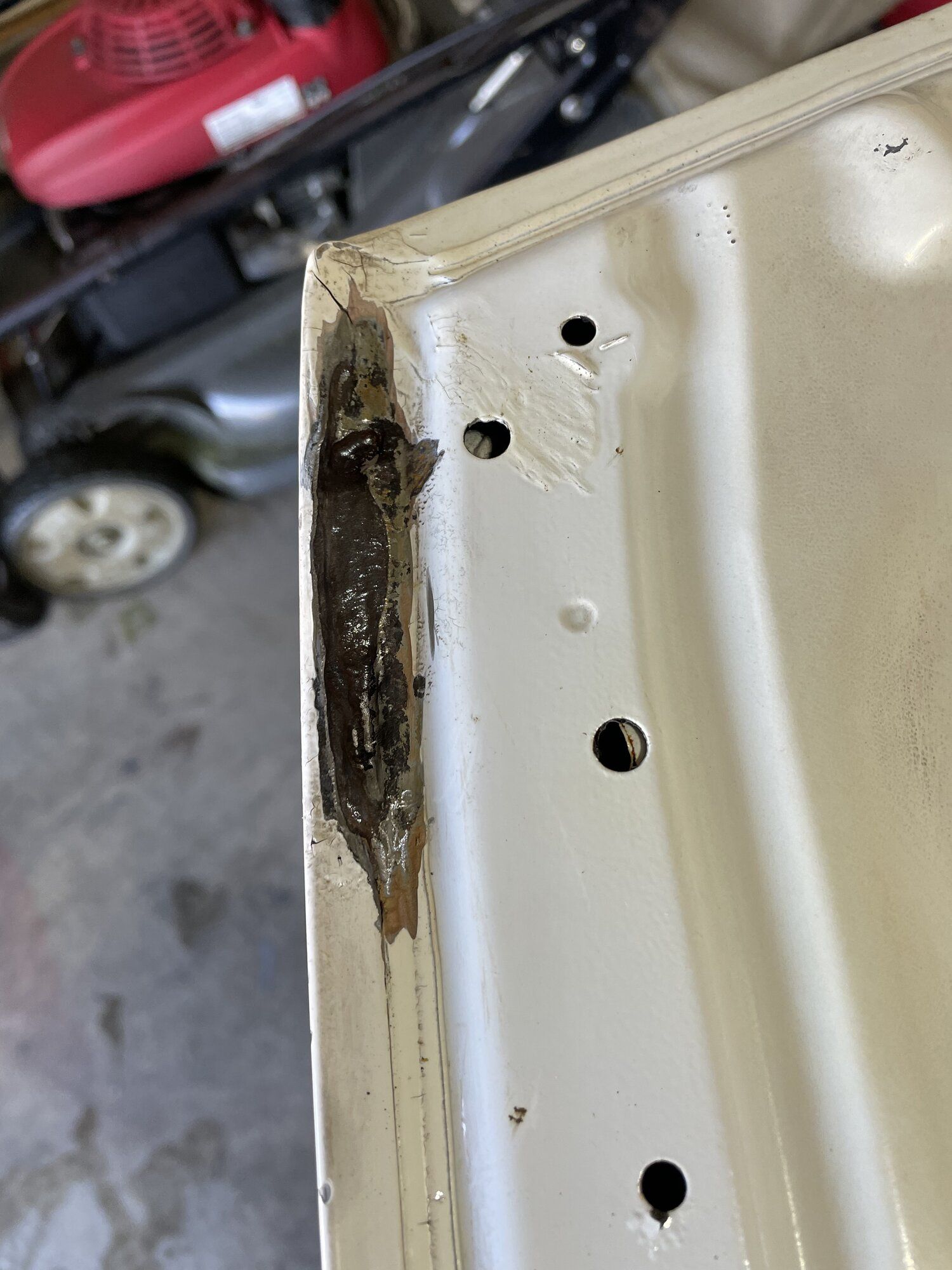

While the hood was off, figured I’d tackle the rust. Not sure how common this is or if it’s from the car having a hood bra at some point but it was annoying to look at when hood was open.
Got all the rust out, sprayed it down with Ospho, clean it, painted it and finished with matte clear. The hood is nowhere near perfect but at least it’s not an eye sore.

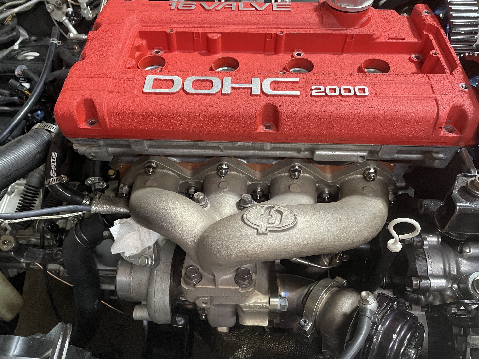

Going to start the engine today to check oil pressure. If it’s within reason, I’ll put the timing side all back together. Flush coolant and hope to drive it here in the next few days.

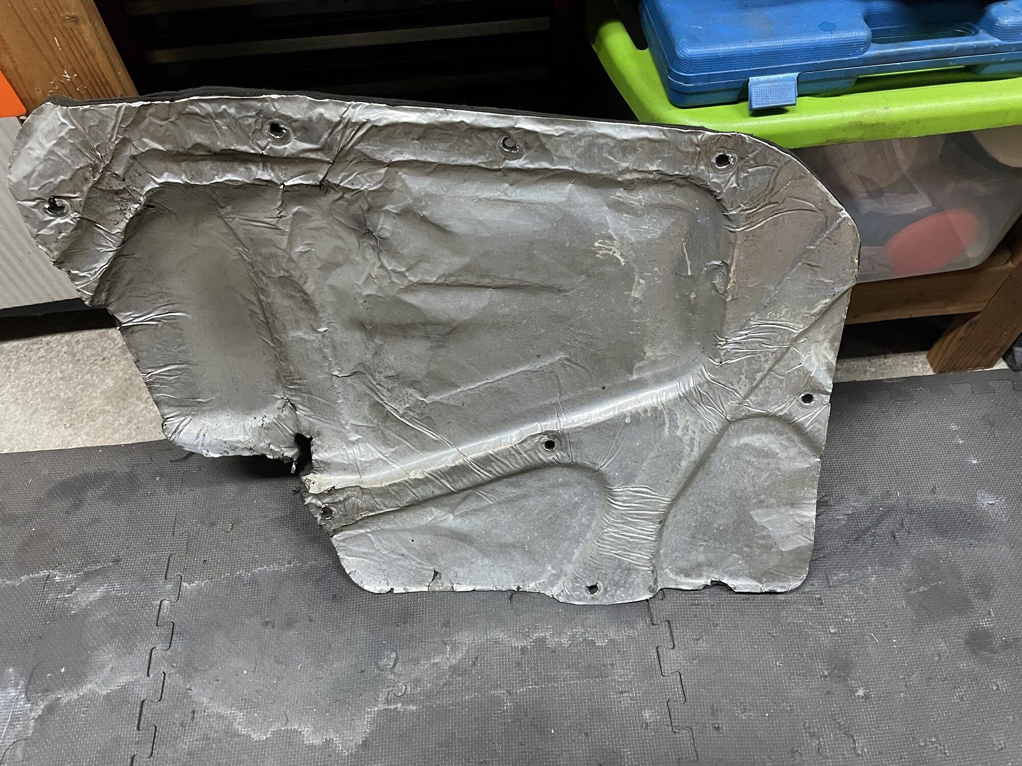

Next I’ll be looking to replace the hood insulator. Saw a great option on a previous post. Just have to find it.

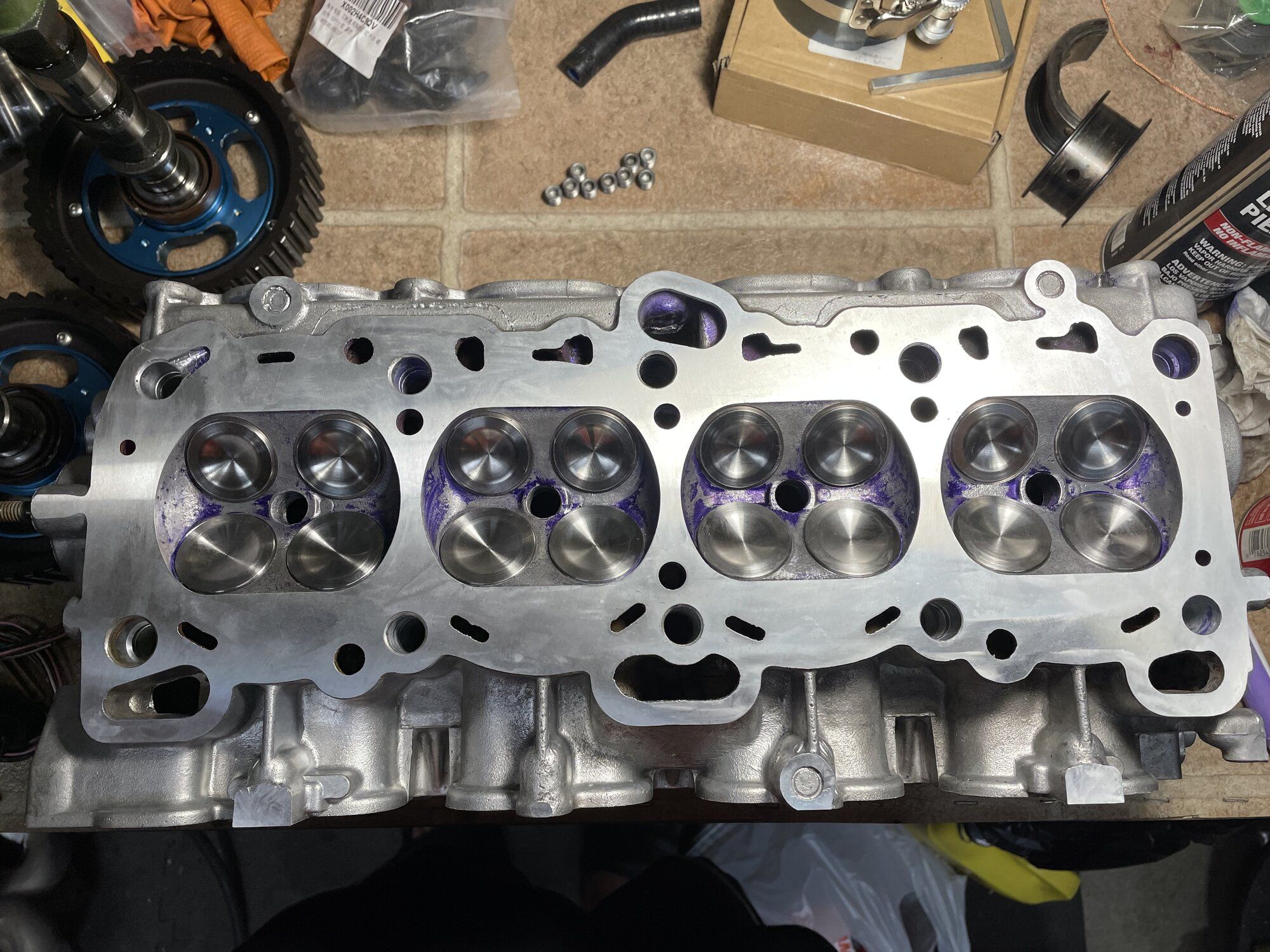

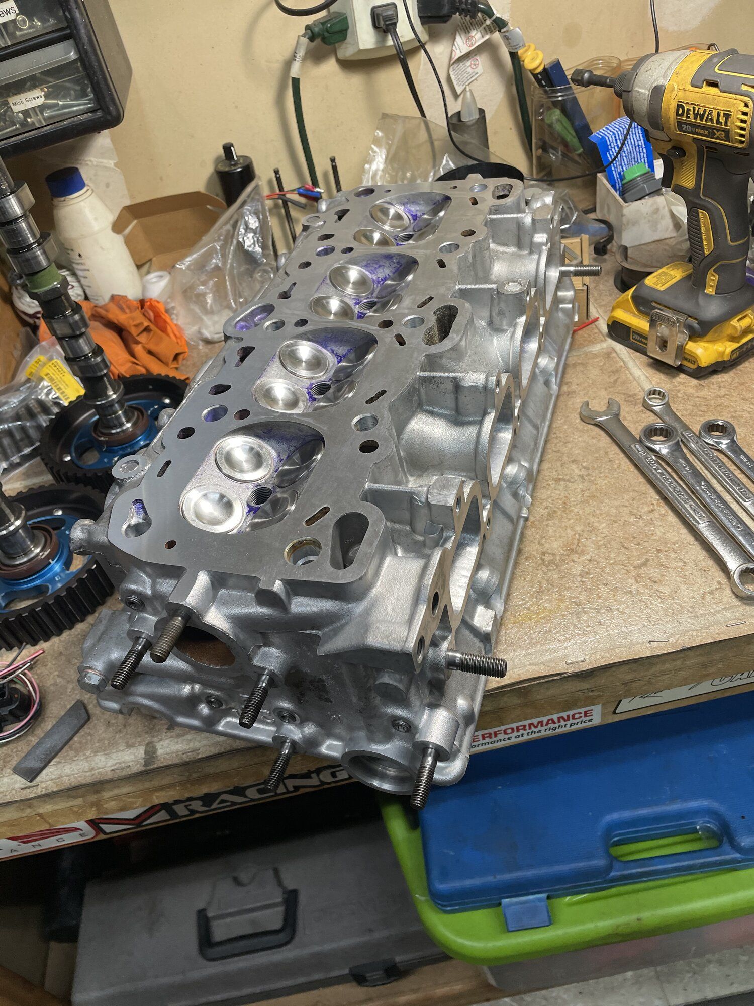

Flushed coolant at lunch and gave it a wash. All seems good except oil pressure above idle up to 3k is at 60psi so gonna drain the oil to port the ofh, inspect the oil and filter. It’s been like this since the BSE. Hope to get this resolved

Will shims/copper o ring lower the pressure on that one octagon bolt? Maybe add or remove shims before permanent grinding/porting.🤔
I know you know what you're doing, just suggesting before these permanent decisions/moves. Keep us updated T! Much love 🤘🏼
For sure. It’s good everywhere else, idle and above 3k so I just need to remove a little at the opening. Just can’t over due it LOL. Much love Lorenzo!!

Ported the ofh yesterday and it about normal.
Just have to install the timing cover and a few other things.

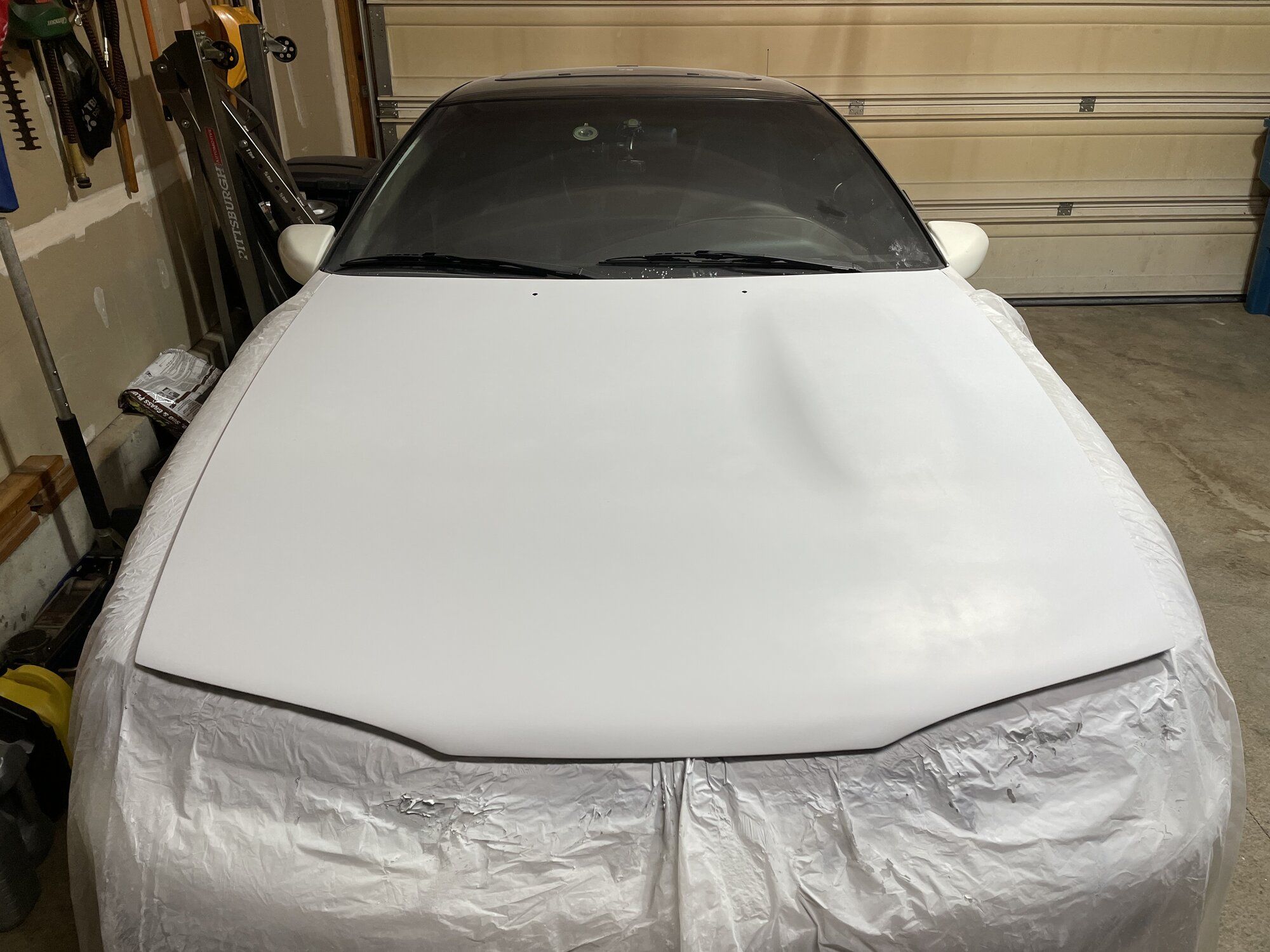

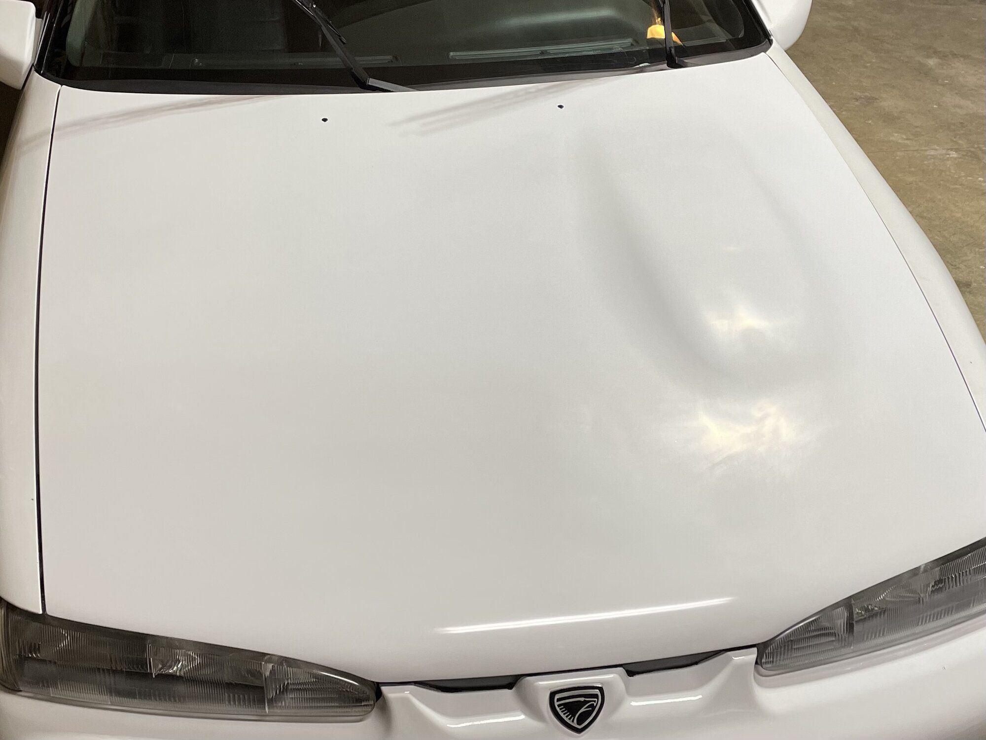

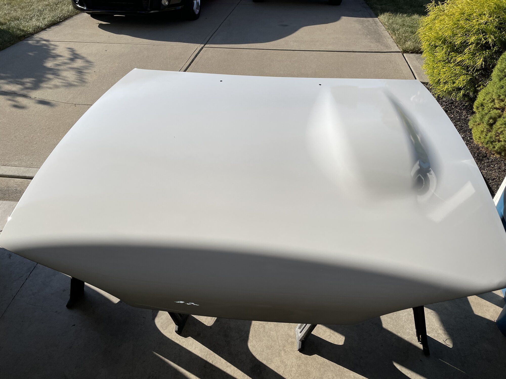

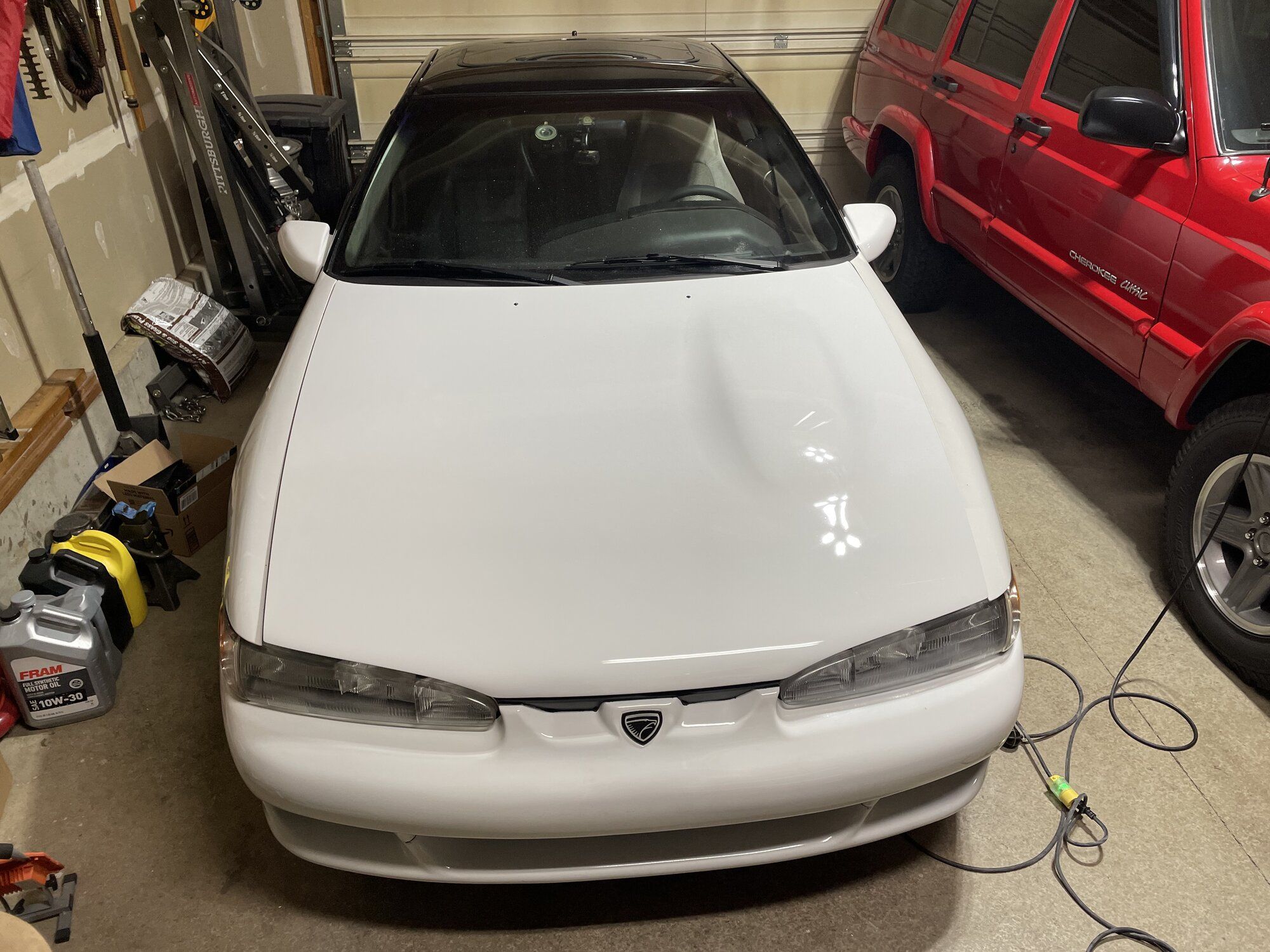

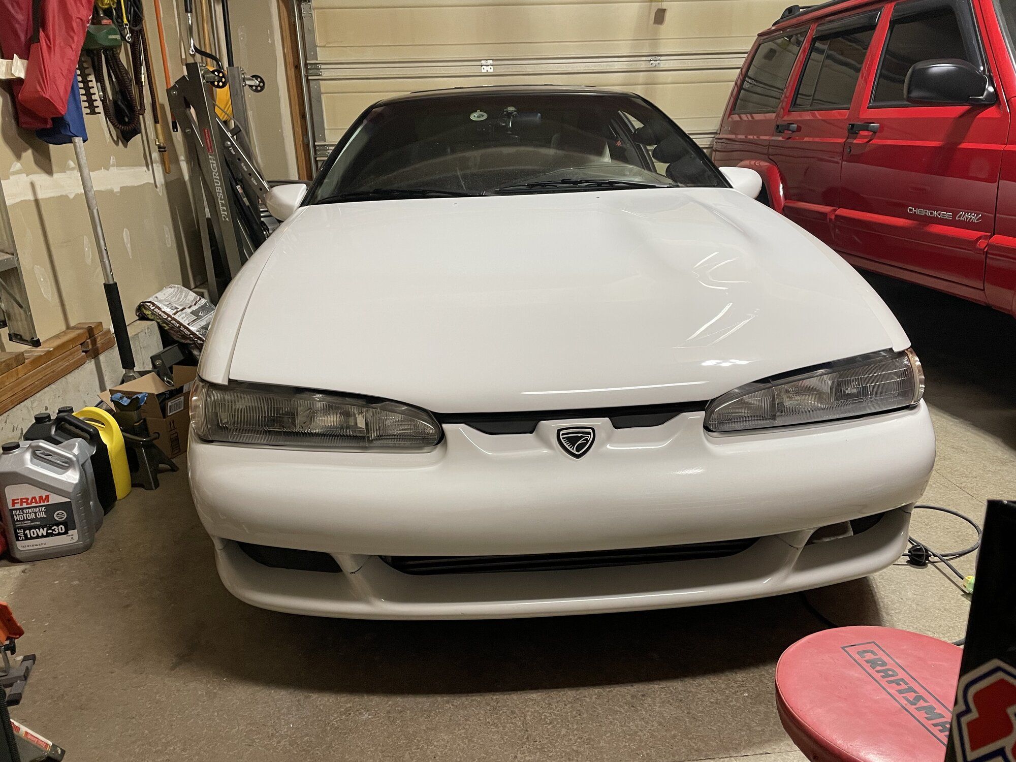

First time doing a blend job. Came out pretty decent after putting in 20+ hours on this hood and 3 trips to the paint store.
Before
During
After
