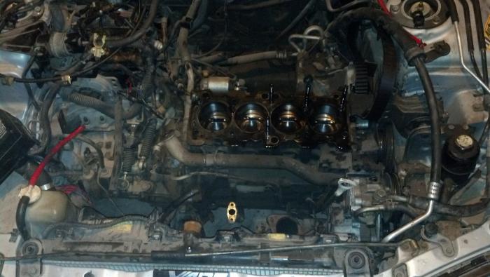

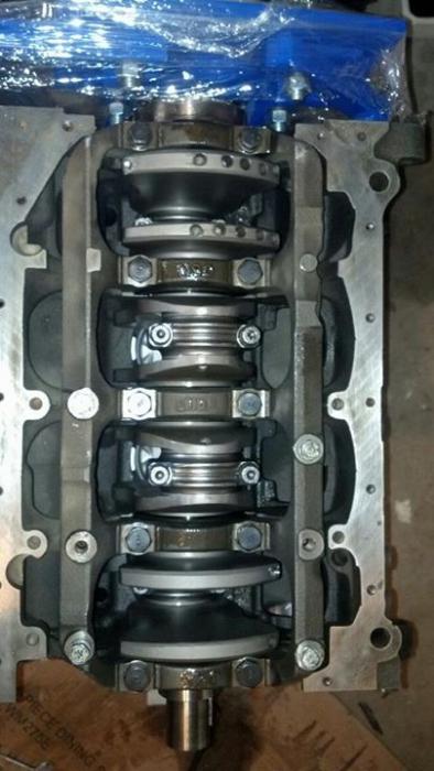

As of right now i pulled the motor and tranny and just took it to a machine shop to be checked out, balanced, new bearings, rings and whatever else they see needed. I plan on assembling the rest when i get it back.

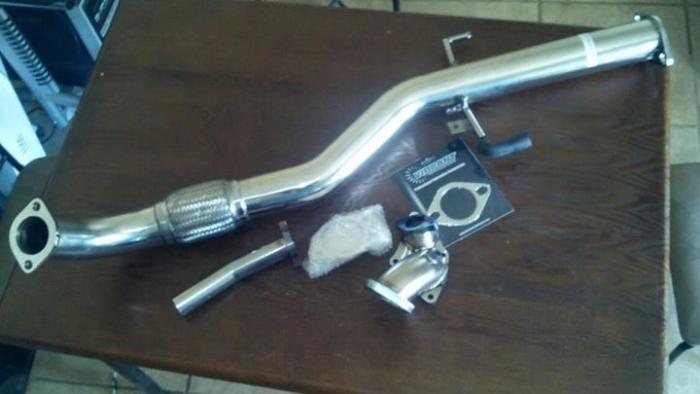

Probably 1200cc inj. Or bigger and hx40 later on. Unsure about a/r and header still. Oh and 3" exhaust with punisher dp. Haven't decided on cat back brand yet either.

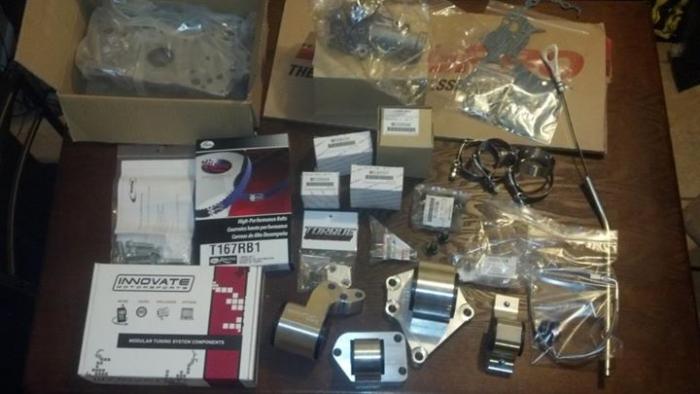

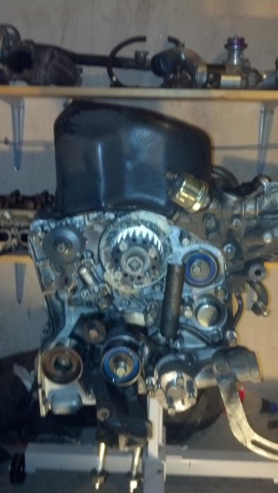

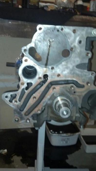

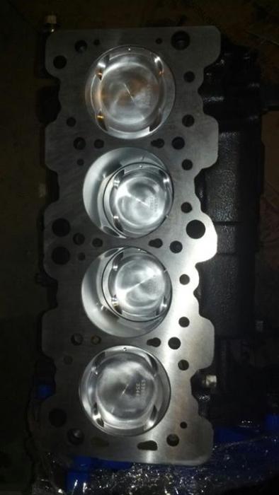

Will download some more pics next time I'm on a computer. Had a collapsed piston so it's gonna be bored .040 over with some wiseco 9:1s. Everything else checked out good. Head is being built by magnus and should be done sometime in the next few weeks. Got a new ecm link v3 light, avid 75 motor mounts, oil pump, timing belt kit, innovate oil psi and oil temp, water pump, fluids and a bunch of random bolts and gaskets. Only thing I still need is a head gasket and to send my tranny to shep. :D I'm ready to start putting this sucka together.
Not much to update. Ordered a new throw out bearing and a fluidamp harmonic damper. Which will be in next week. New head and smim better be in next week or I'm going to ####ing blow a gasket.

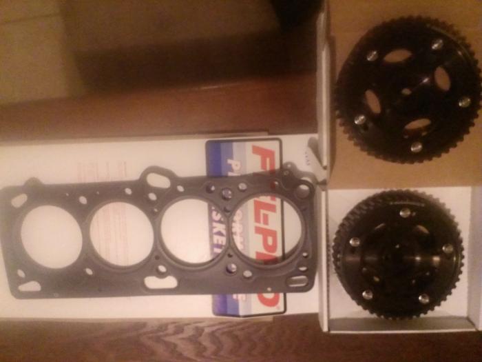

Received my fidanza cam gears and perma torque head gasket finally.

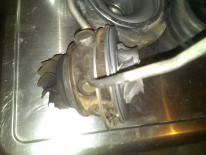

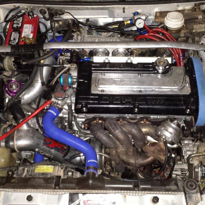

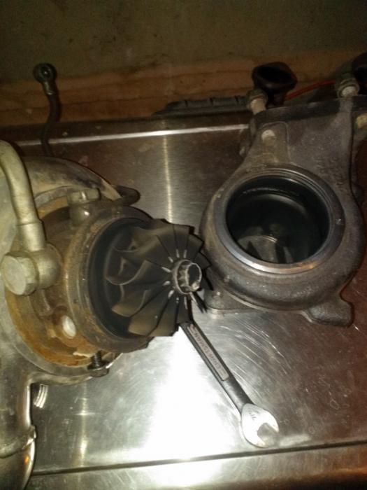

Decided to inspect my turbo and confirm it was a td06h. I'm learning tons on this build. I love it.

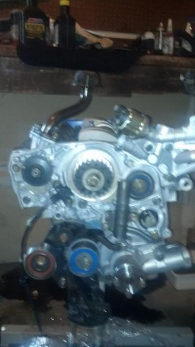

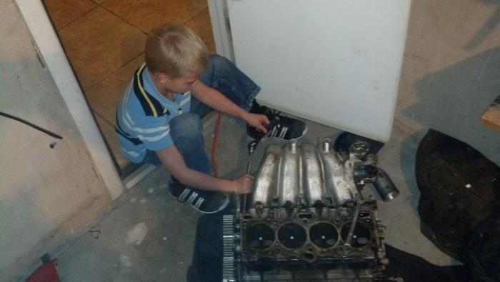

Completely assembled by me. She starts, drives and no leaks so far. :hellyeah: couldn't of done it without everyone on here. Now to break her in and keep upgrading. Bye bye 20g and hello black. ;)

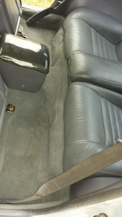

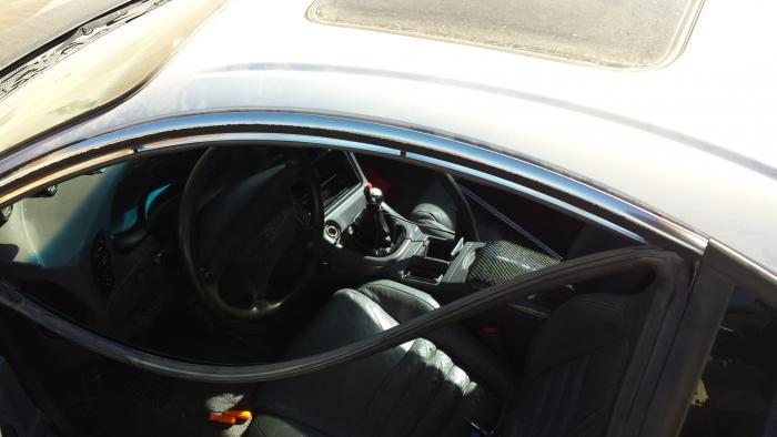

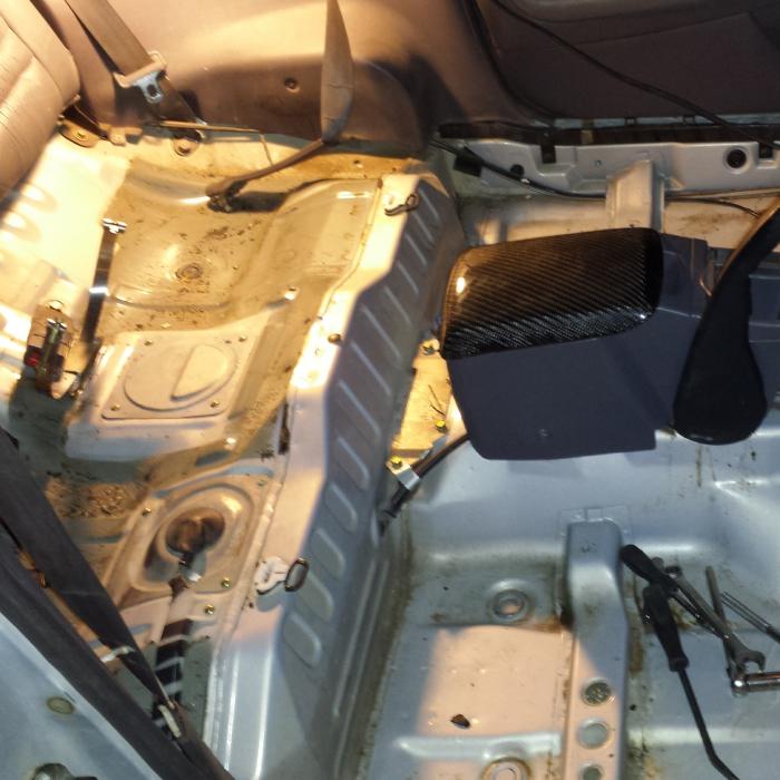

Time for a little interior work.
Should have the interior done today. :)

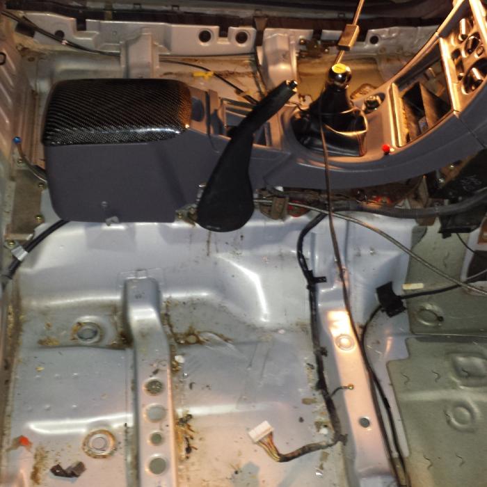

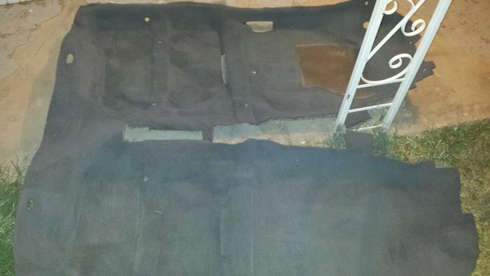

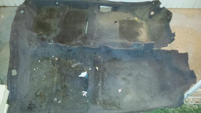

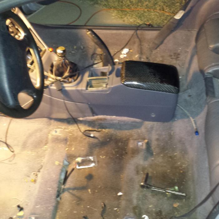

All gutted and sound deadening material removed.:hellyeah:

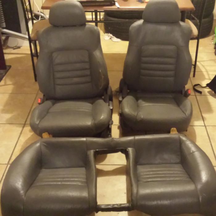

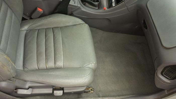

Seats all cleaned up and ready to go back in.:D
I had the hump in the middle removed and reupholstered. My nitrous bottle mounts right there. I also had the part they took out reupholstered so when I take the mounting brackets off I can put it in.

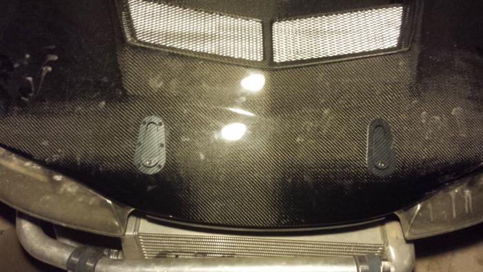

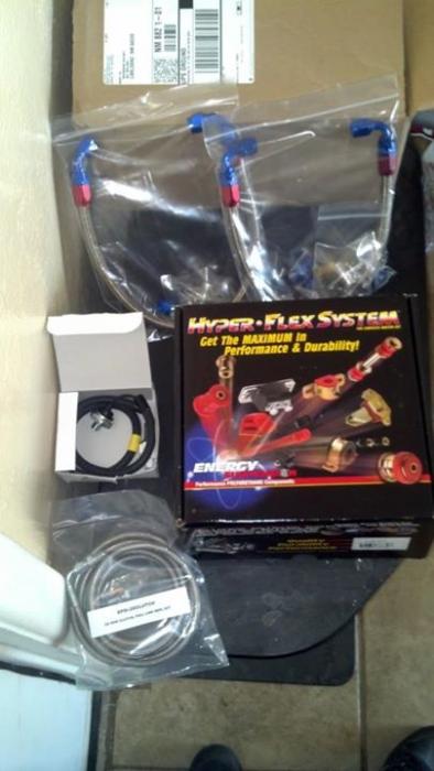

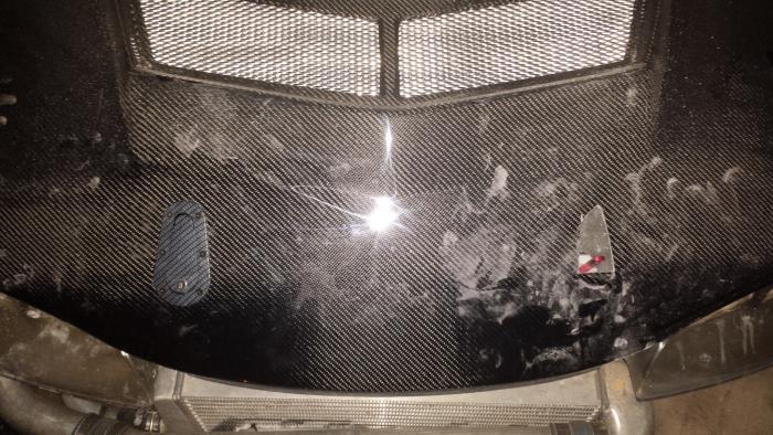

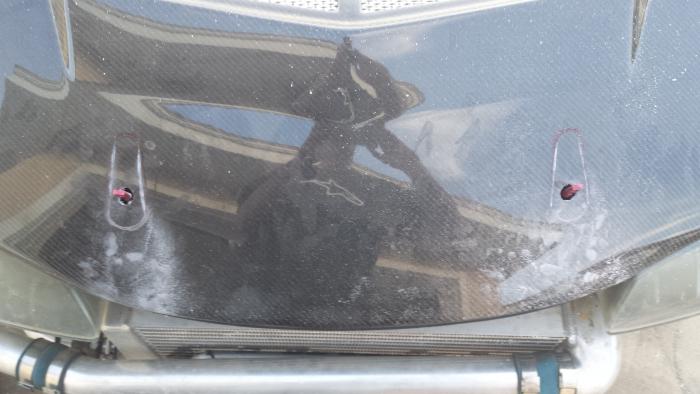

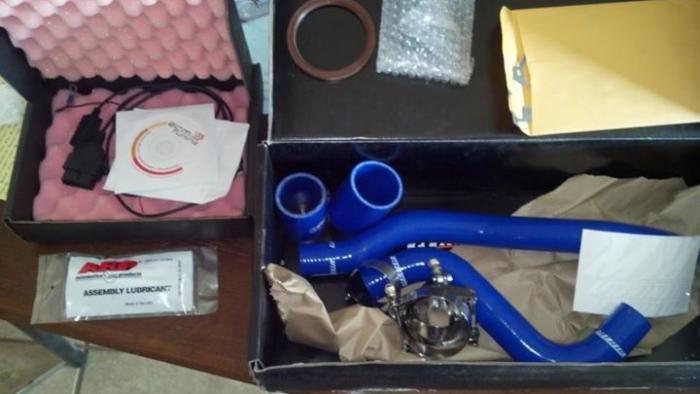

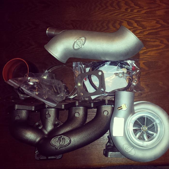

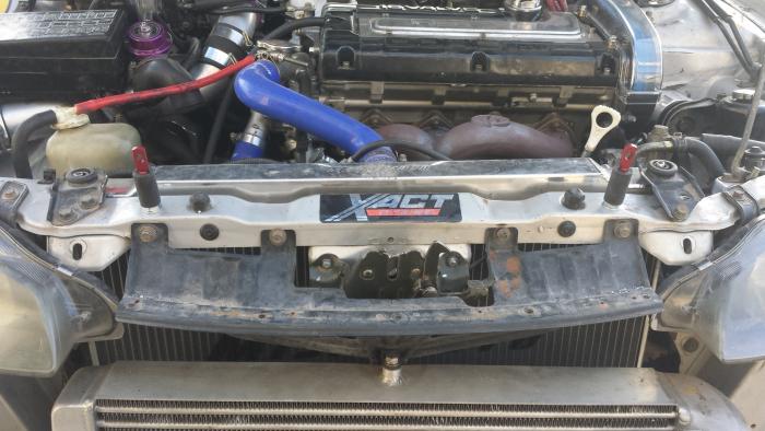

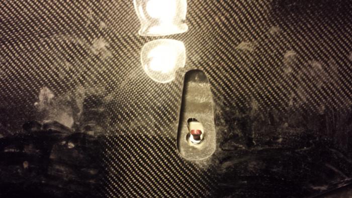

Got some new goodies in today. I'm so excited to put everything on tomorrow. I think next I'm going to be upgrading fuel pump and lines. Also recently installed was a carbon fiber hood, fic 2150s, moshimoto aluminum radiator, fabed up an afpr bracket for the firewall, mid timing belt cover, flywheel cover and a clear cam gear cover. Oh and I still need to put my aerocatch latches on. I'm dreading putting holes in the new hood.

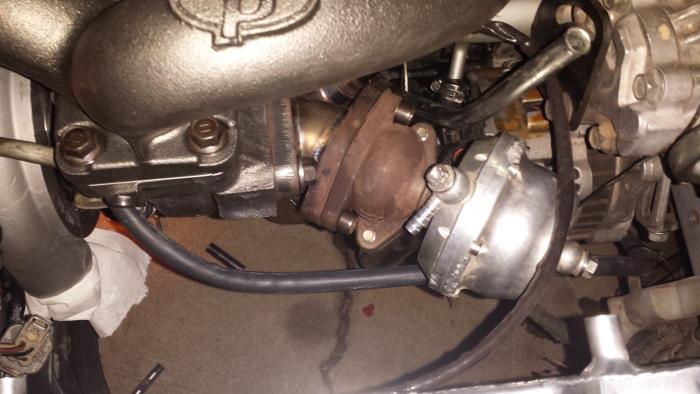

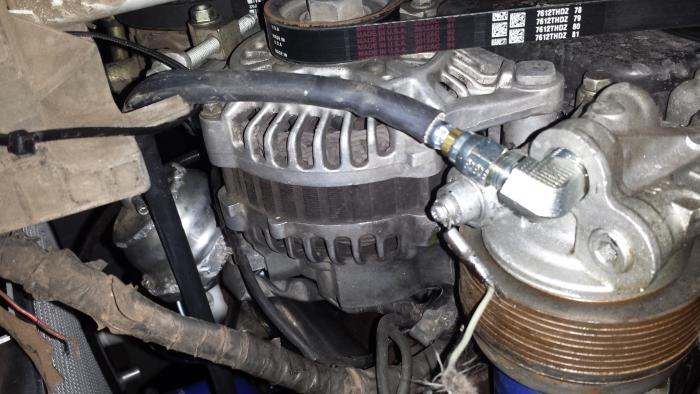

Almost got everything hooked up. Just waiting on a 2" 90° coupler. Was just curious if my oil feed line will be fine like this? I wasn't really sure where to hook it up on the ofh. I'm pretty sure I have to clock the turbo a bit too. Any advice or input?

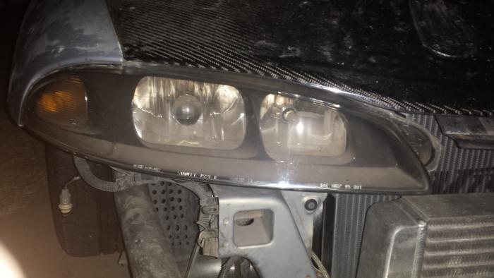

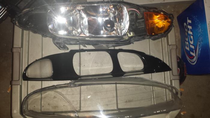

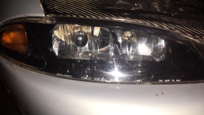

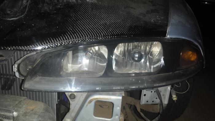

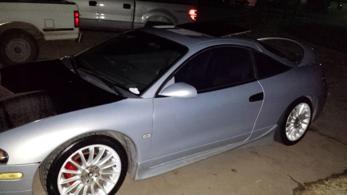

I used the 3m kit and they turned out really good. The passenger side headlight has a lot of dirt inside of it and the driver side has some in it. I'm going to do some research and try to disassemble them to clean out. Hopefully do the drip molds tonight as well.

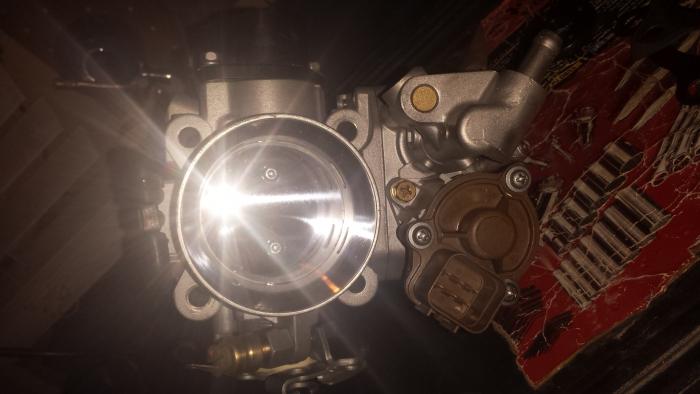

Got one done and it looks good as new. Also got my built tb back. ;) A blt without a single leak. Finally. Ha ha

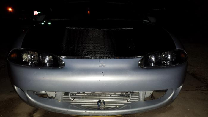

Washed the car for the first time in a long time. I definitely need a new paint job, the righ front bumper, rear bumper, fenders and some stock side skirts. I hate the damn lights on the fenders. Headlights look really good and taking them apart was a piece of cake with the heat gun.

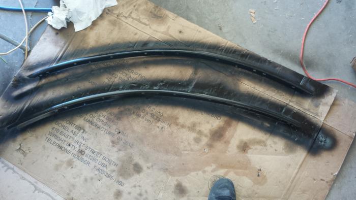

Drip molds were easy to remove and I used a razor blade to remove the remaining rubber on them. I then repainted them with a black rubber spray. I'm happy with the results. I'll get a closer pic of them installed tomorrow. Now I just gotta finish getting this thing running right. Idk what is going on with it. I have a tuner (my1gdsm) helping me with that though. Next on the agenda is body parts and some shift cable bearings. Oh and probably another oil change.:hellyeah:

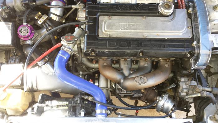

Nice build so far!!! I see that you have you BOV recirculated. Just curious as to why you don't run speed density an run it atmospheric? Again, nice build!!
I will eventually run gm or speed density. I pretty much built and put all this together this year so I'm trying to limit what I'm new with. When I get everything running good and some time with it under my belt I'll upgrade. Thanks man it's been a long process but it's getting there.
