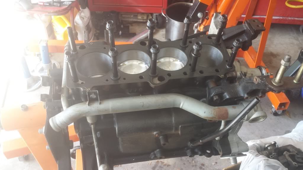

2.3L Stroker:
Eagle rods
Wiseco Pistons .020
OEM 4G64 Crank (This will probably change)
2G Head:
Ported Exhaust/Intake

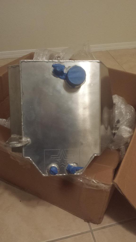

I was able to get my hands on a Frontline Fab 12 Gallon Fuel Cell
It has:
Feed: 2 x -8AN bulkhead (sumped)
Return: -6AN bulkhead

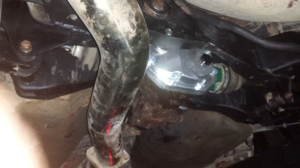

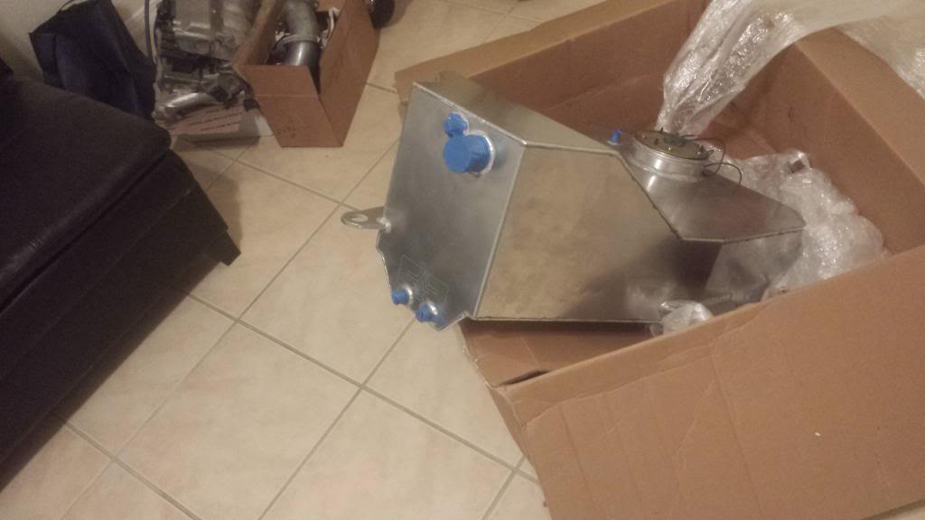

And look what I found on a local craigslist ad. This plus 2 x Bosch 044's is my alternative to the full blown double pumper. Honestly, I just really dislike the saddle bad design of the 2g awd, plus this is much more stylish and goes along well with the FF diff cover.

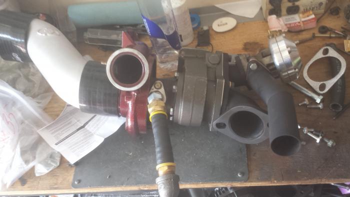

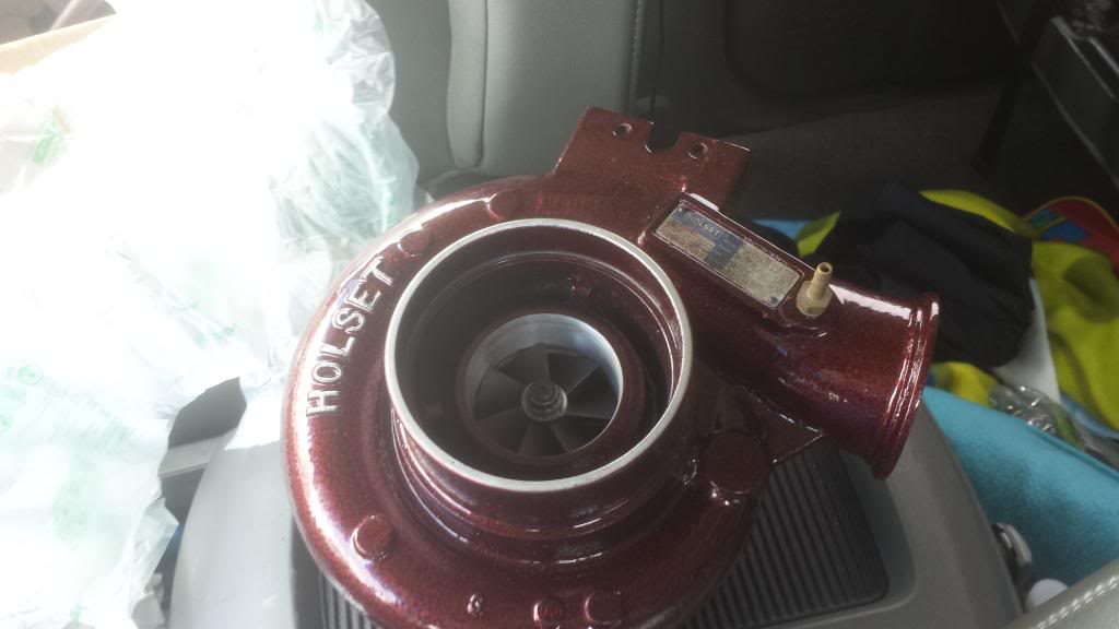

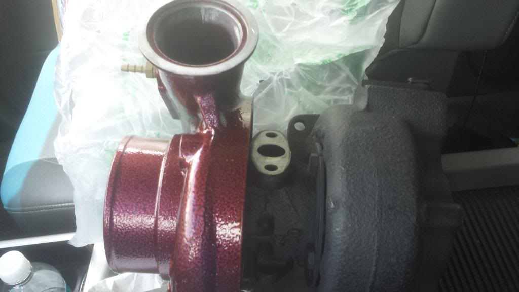

Annnnddd And HX-35... Dont mind the mess in the car :)

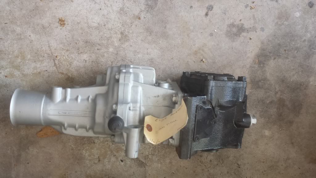

Look at what I found on my doorstep when i got home from work.
It was brand new in the box. Picked it up used from a member in a dsm marketplace group on FB for an excellent price.

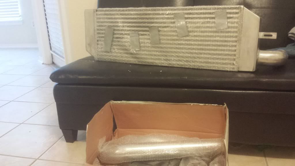

The VRSF core is fitted to the car (pics coming soon). We ran into a bit of a issue on the day we scheduled to install the engine/trans, apparently I miss-placed the oil pickup screen/tube, so I had to order a new one. Unfortunately my buddy will be at the shootout this weekend, so dropping the engine will have to happen the weekend after next.

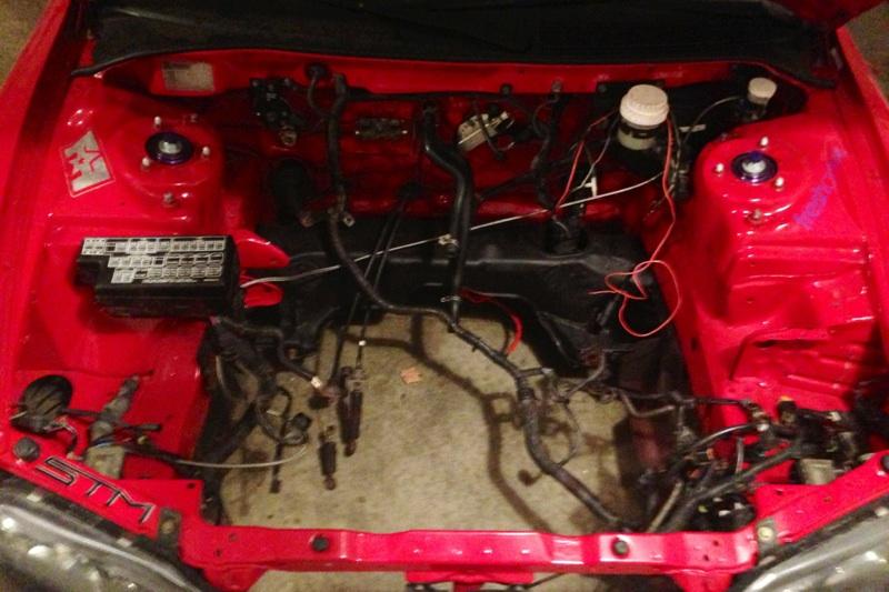

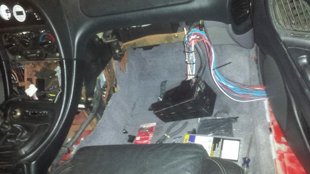

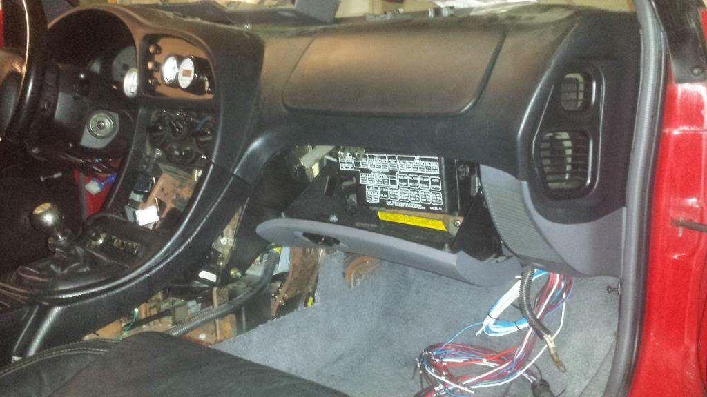

A Buddy of mine helping me out, he suggested a fuse box relocation (to the glove box) and then commenced the relocation. We'll be hiding the engine harness as best as possible as well.

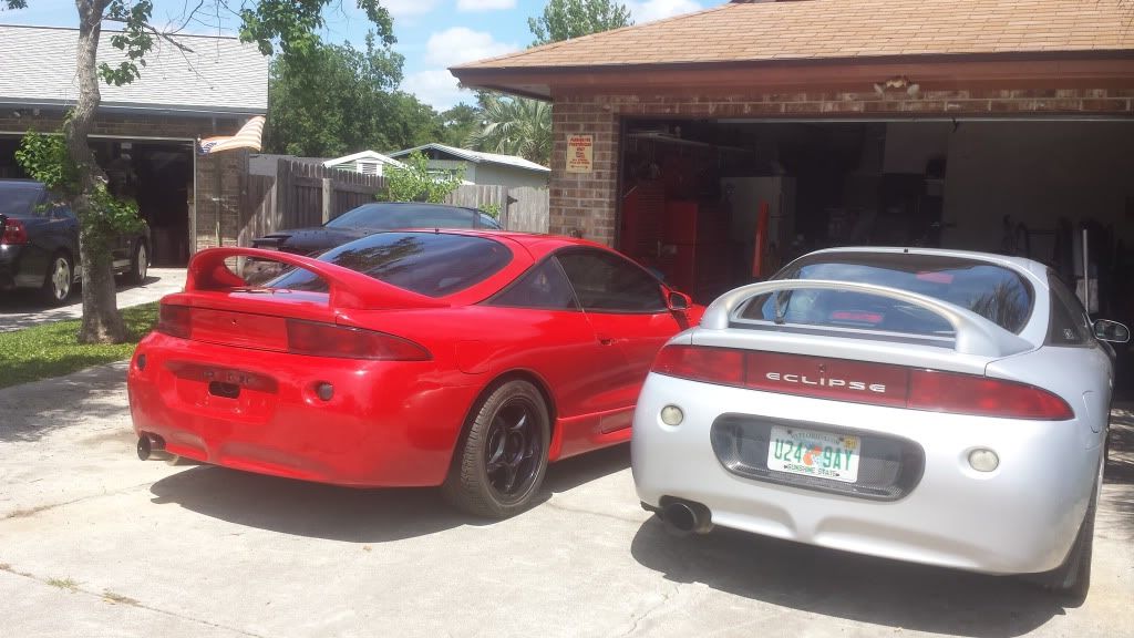

I purchased this battery holder via the tuners classifieds, I wasn't satisfied with the location by which it was meant to bolt to, so I retrofitted it to bolt to different location. Sorry, the car is a bit dusty.
And yes, that is by buddies Red 99 GSX in the other garage spot. Its sort of sexy.

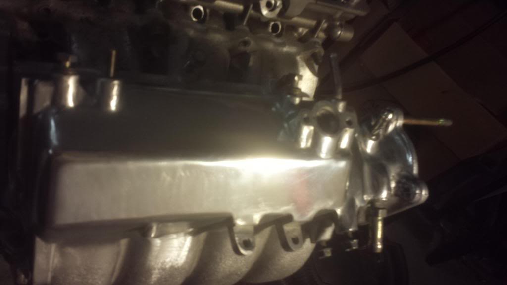

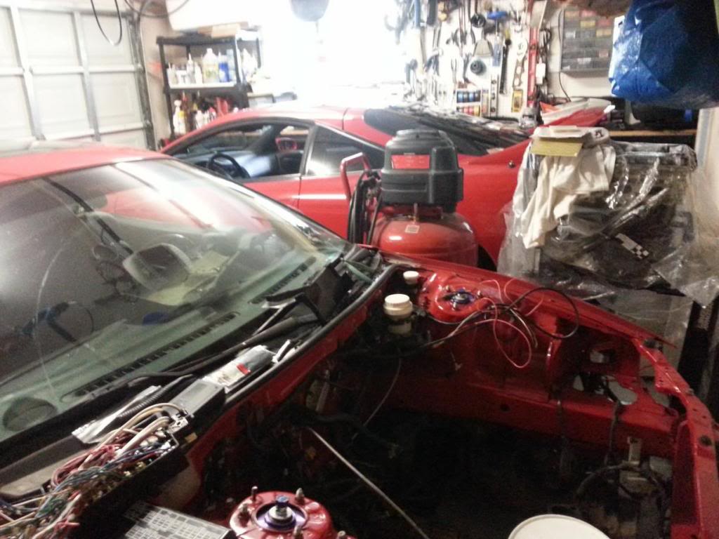

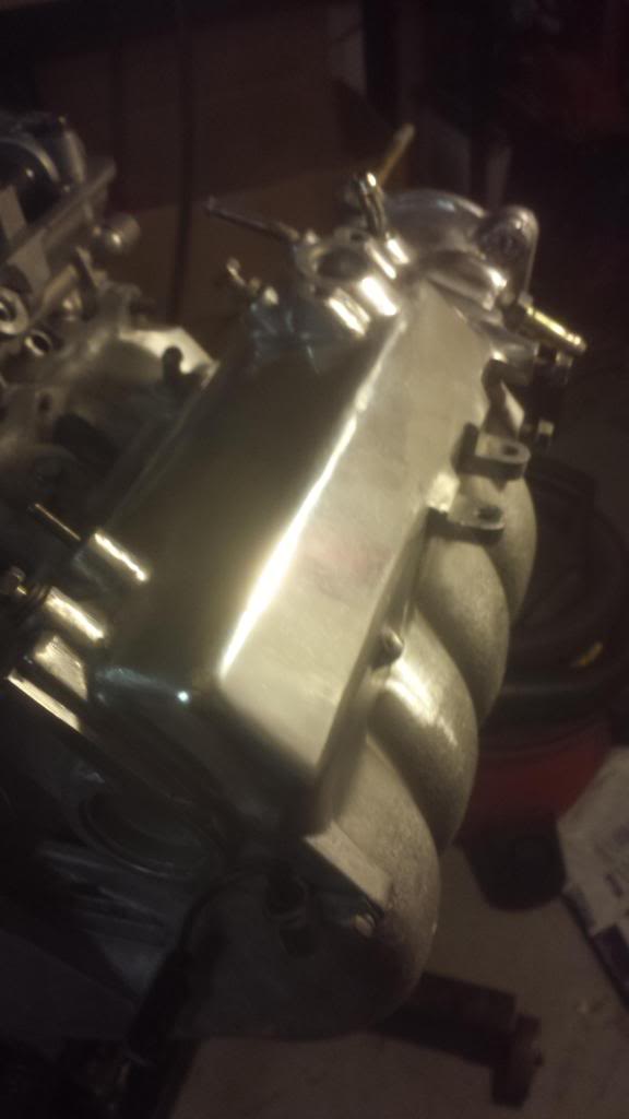

More progress. My buddy Cory was working on the new location for the fuse box, and removing EGR/ABS wiring in the engine bay. I sanded down and polished the intake manifold, then started on the valve cover.
Most of these people will never appreciate how long or how much effort truly goes into polishing the intake manifold. I did the same thing you did, and I know firsthand how long it takes. Looks like you did a great job on it as well. The funniest part is it looks like you started polishing one of the runners like I did before saying f*ck this LOL
I see you ended up using the same motor mounts I did. A pity one of mine was defective, the insert was brittle and it crumbled quickly, but other than that they seem to be of good quality.

Yeah, this was my first time polishing anything (on of my buddies started me off) so I started on the back of the runner because if i messed up, or did like it then I could just say "screw it". I might polish it a little more, but for now I think most of the unpolished areas wont be visible really.

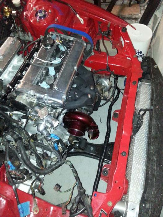

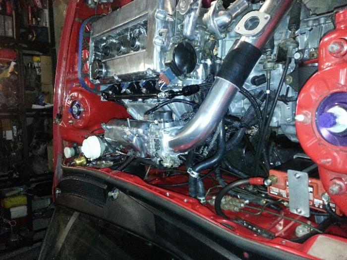

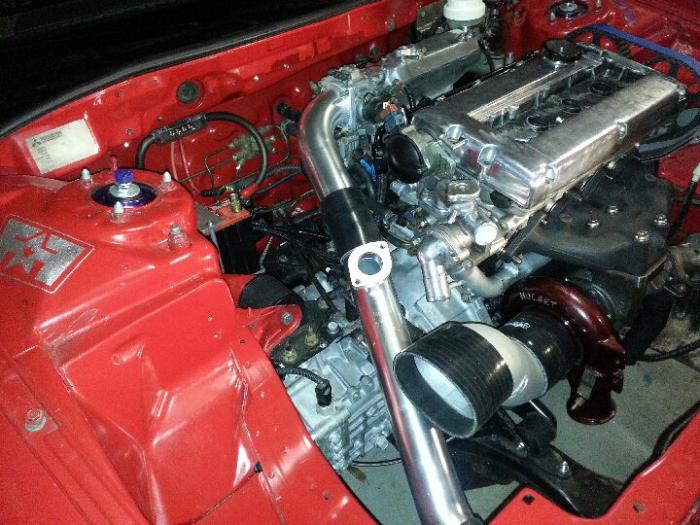

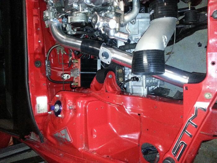

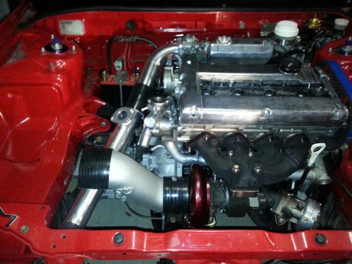

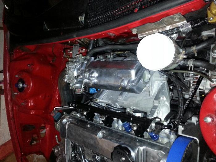

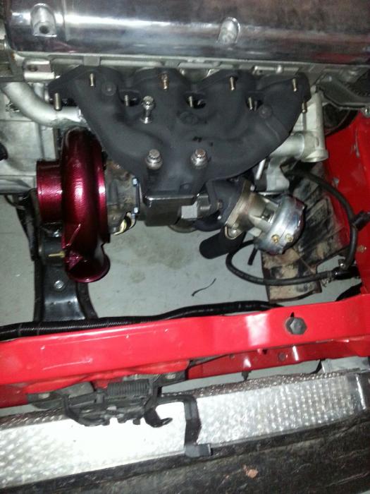

Another update!
Engine is finally in the car, my friend Corey did the turbo rebuild, and made the harness look incredibly nice, we're still tweaking it a bit. I did get around to finishing up the fuel pump rewire to the inline pump, also figured out the fuel tank level/low wires and splicing them into the correct wires on the harness.
