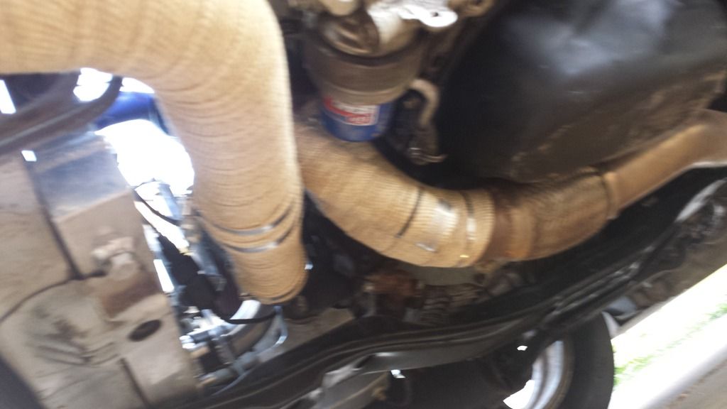

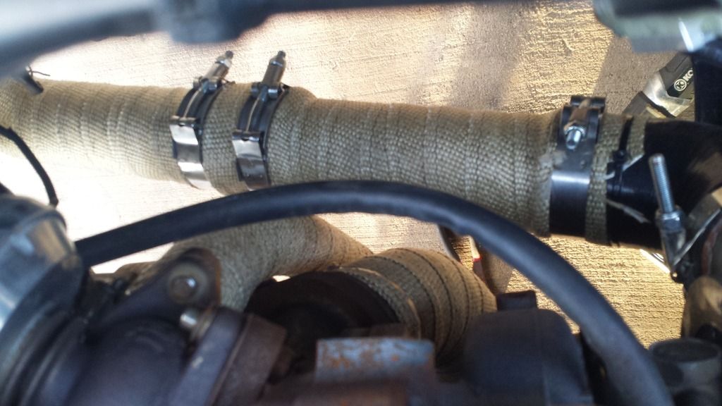

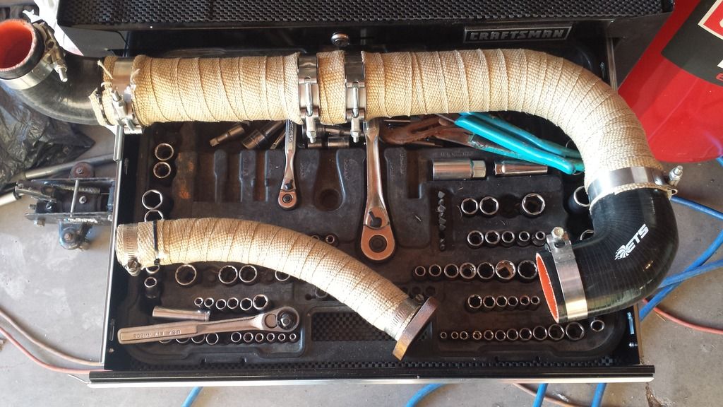

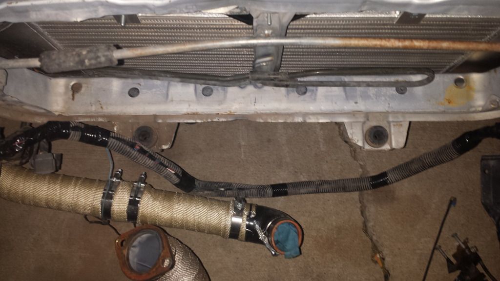

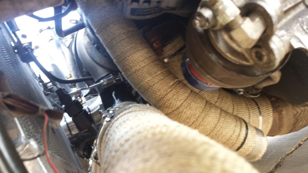

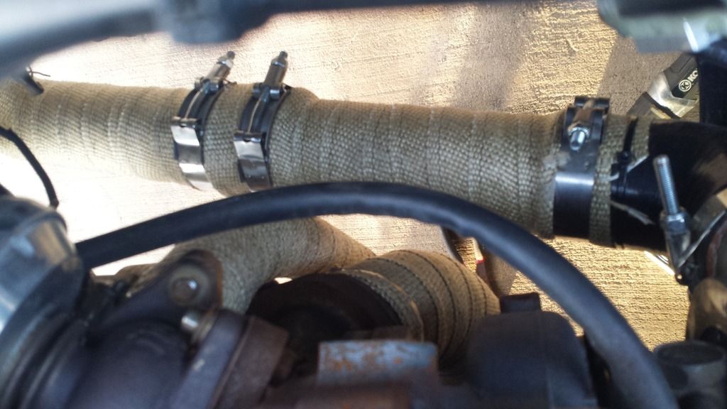

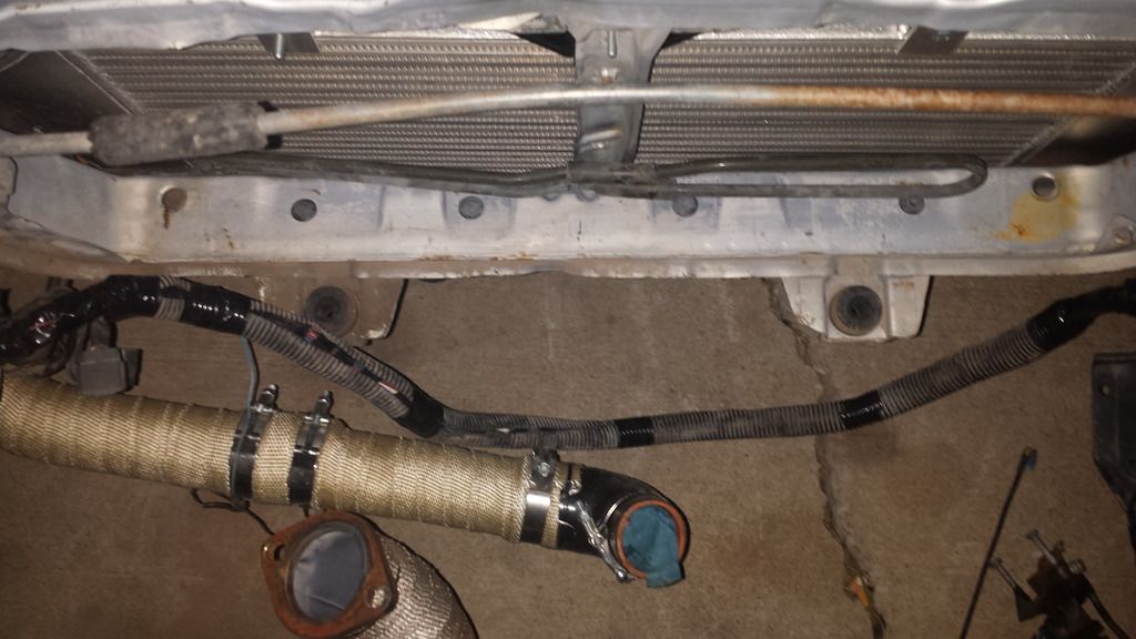

Fixed my wastegate dump that was blowing on to a coupler and did a little heat wrapping.
[URL=http://s273.photobucket.com/user/brandonleehulsey/media/Mobile%20Uploads/20150323_183612.jpg.html]20150323_183612.jpg[/URL]
[URL=http://s273.photobucket.com/user/brandonleehulsey/media/Mobile%20Uploads/20150323_183547.jpg.html]20150323_183547.jpg[/URL]
[URL=http://s273.photobucket.com/user/brandonleehulsey/media/Mobile%20Uploads/20150323_183538.jpg.html]20150323_183538.jpg[/URL]
[URL=http://s273.photobucket.com/user/brandonleehulsey/media/Mobile%20Uploads/20150323_182208.jpg.html]20150323_182208.jpg[/URL]

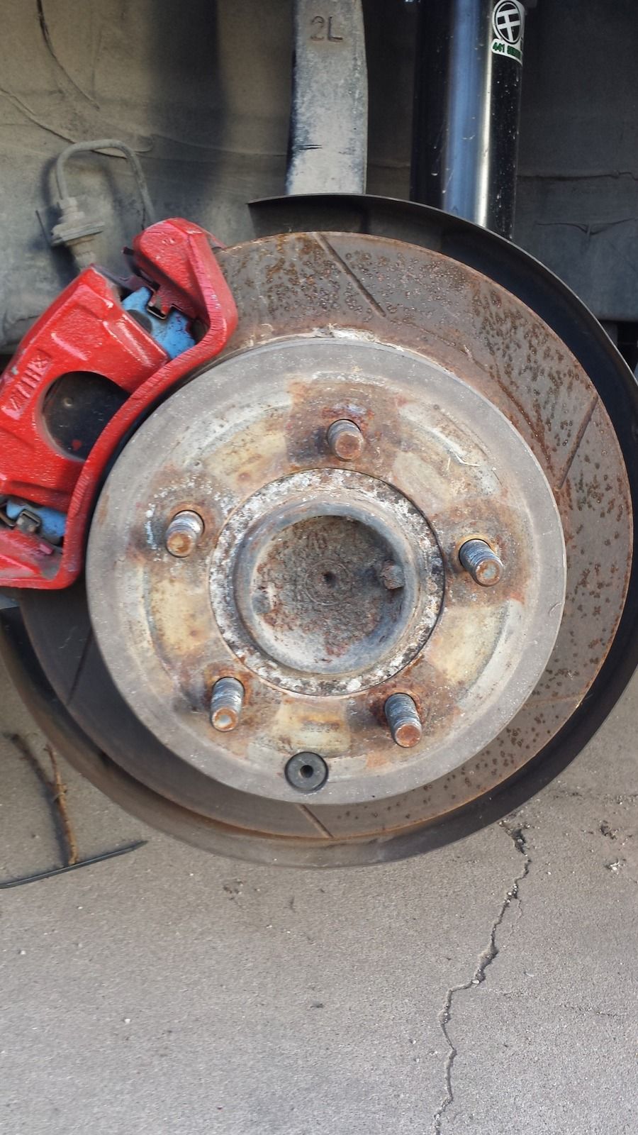

Also just realized i don't have any bump stops in my suspension. Explains why my car rides so damn rough LOL. So im looking into either dg konis or feal coilovers. Anyone have any suggestions? Will be finally getting some e98 tomorrow.

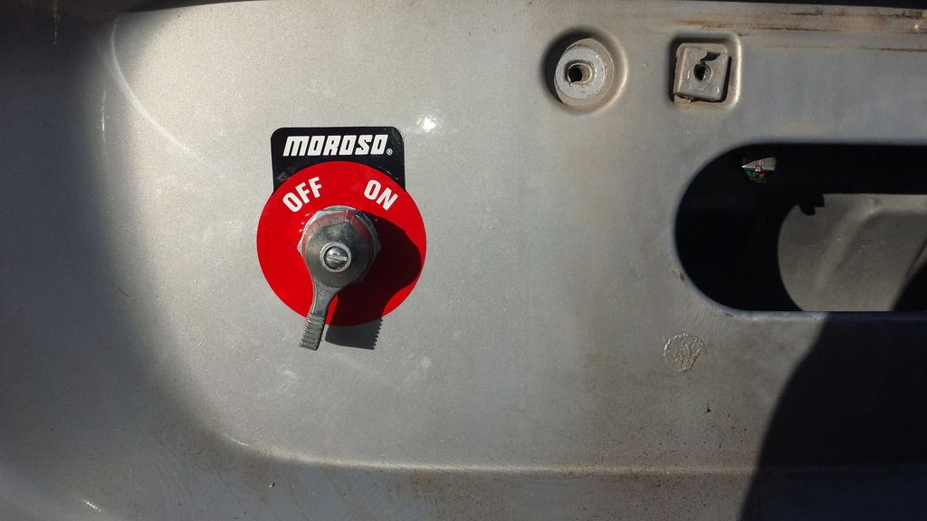

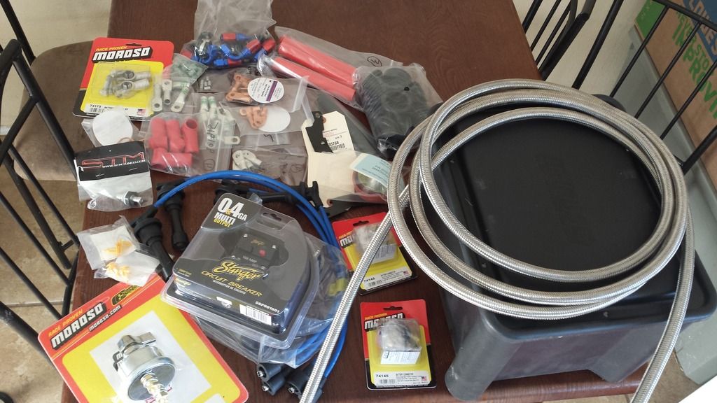

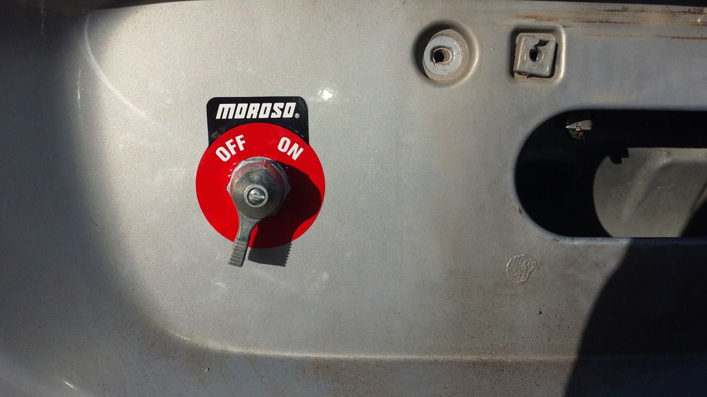

Been getting a bunch of new parts in. Relocating my battery to the trunk with 2 gauge wire and kill switch. Useing gofers shopping list and diagram. So big thanks to him and turbosax2 for the help. I'm going to try to take a lot of pictures.

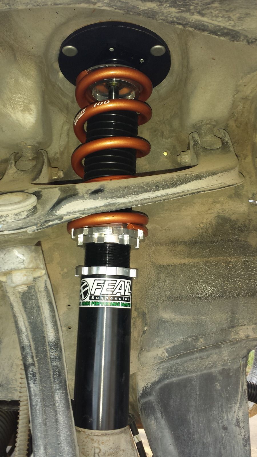

Still waiting on coilovers. Ended up ordering a set of feals from sim. Said they should be done monday. I've definitely got my work cut out for me LOL now I need some days off.

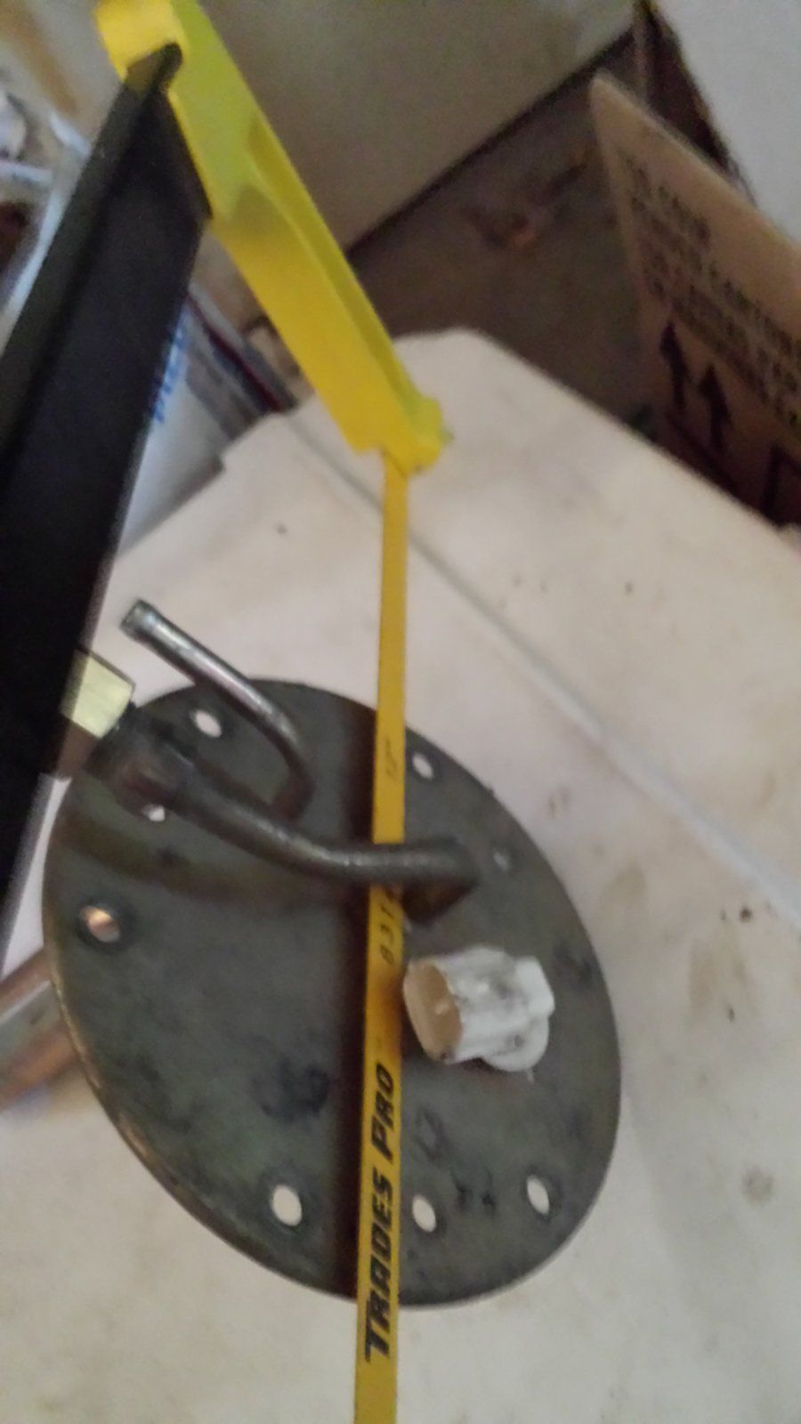

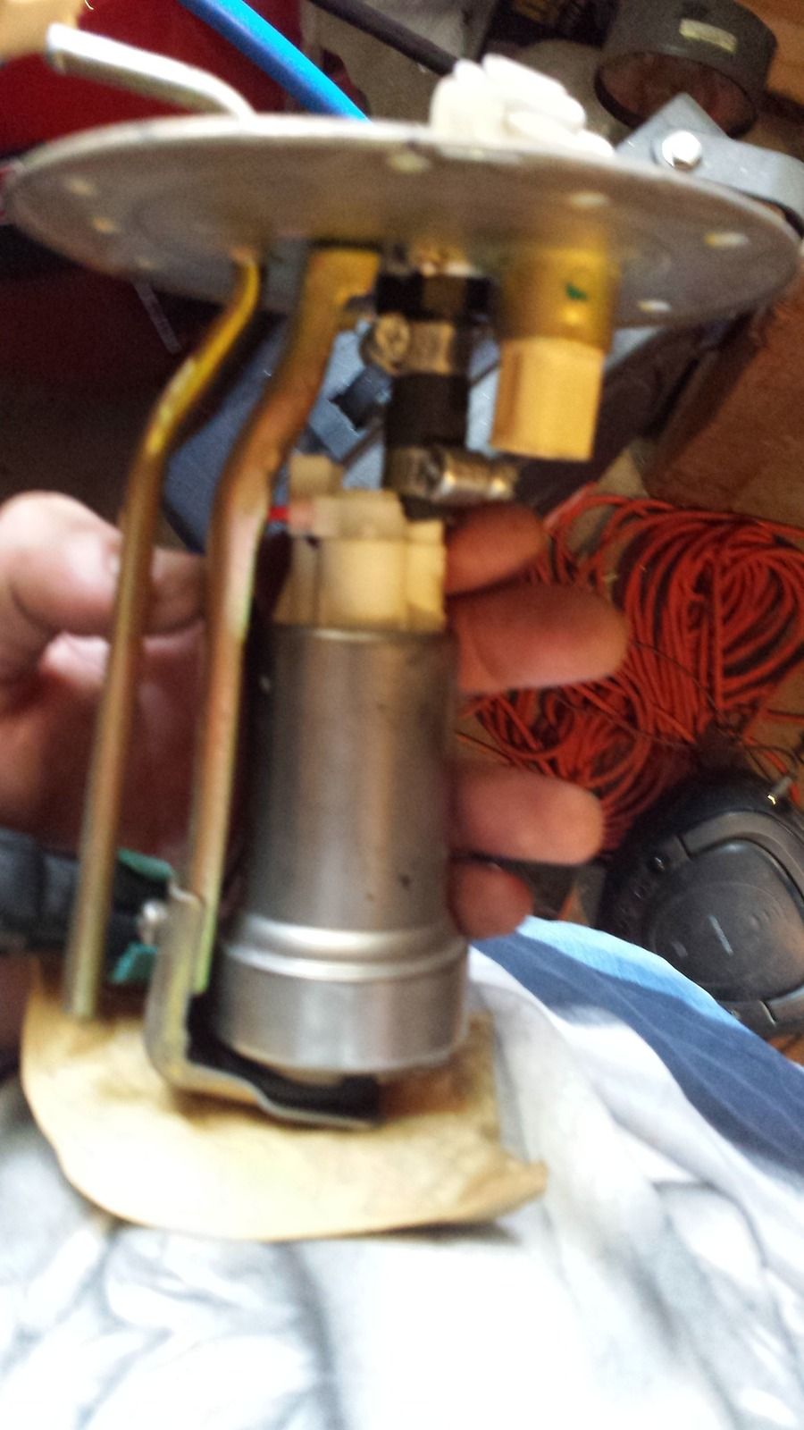

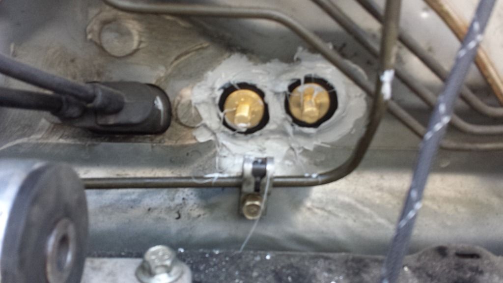

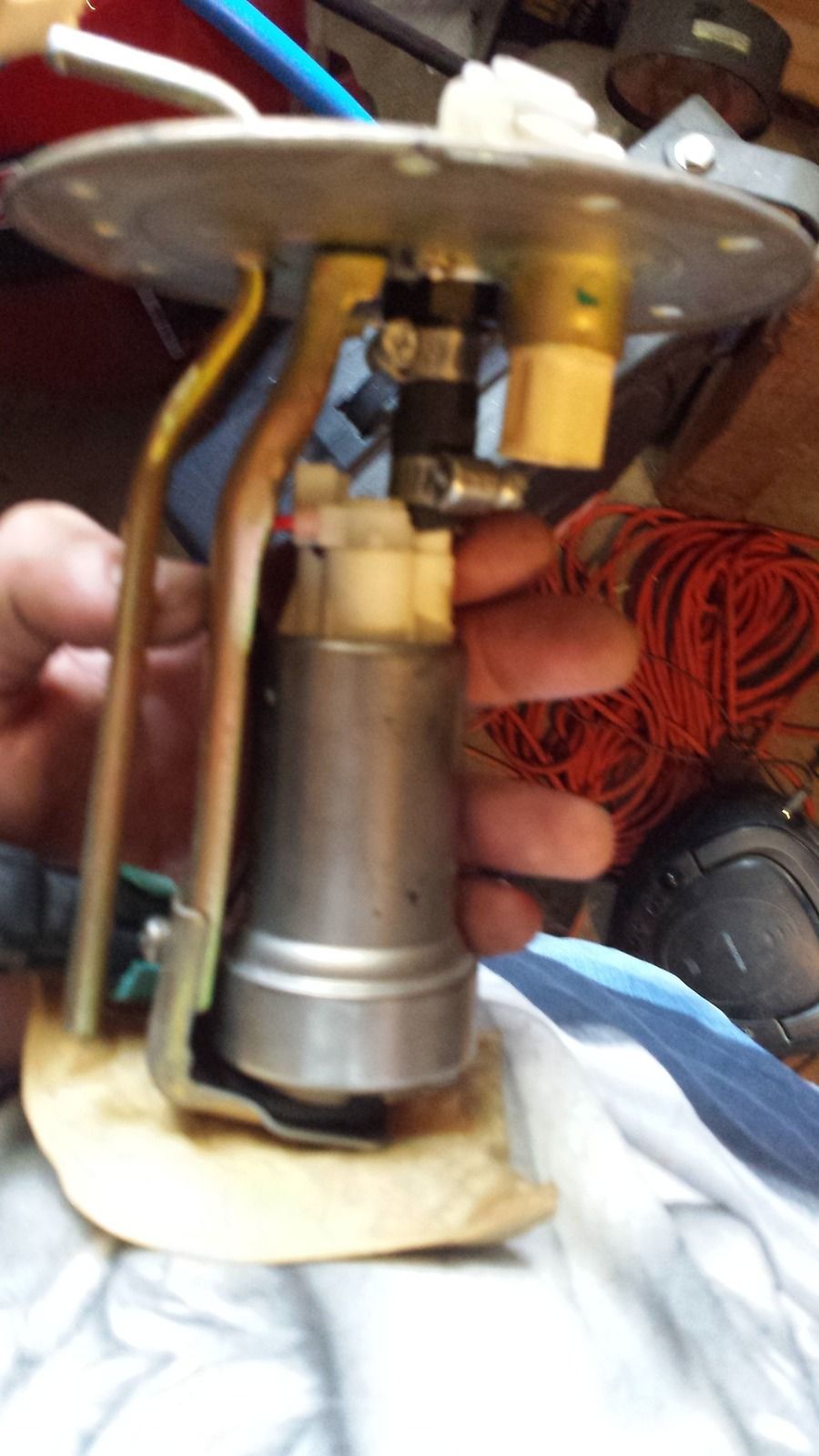

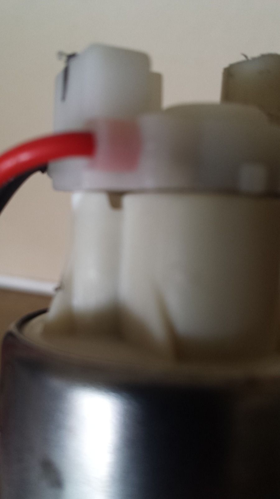

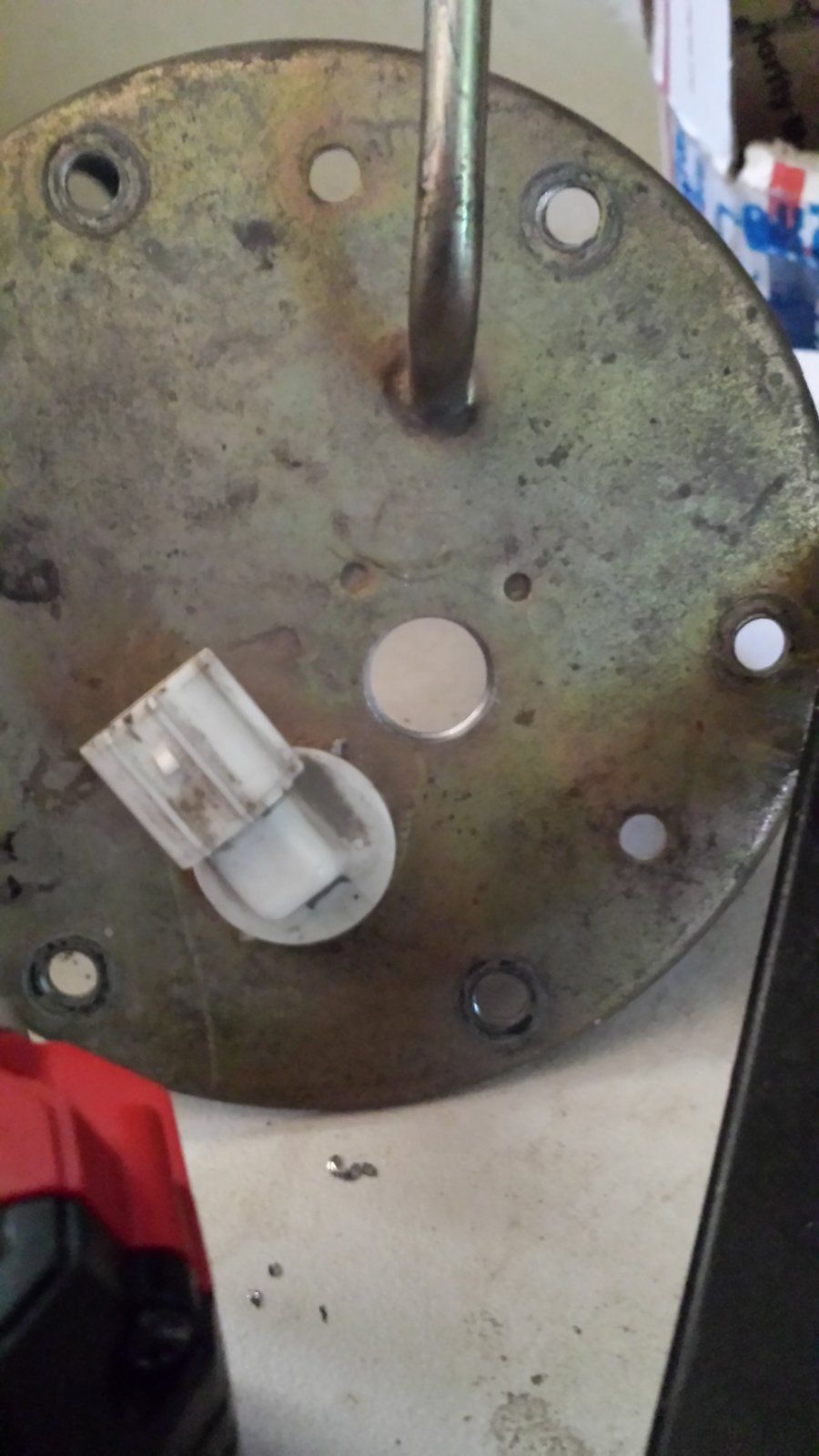

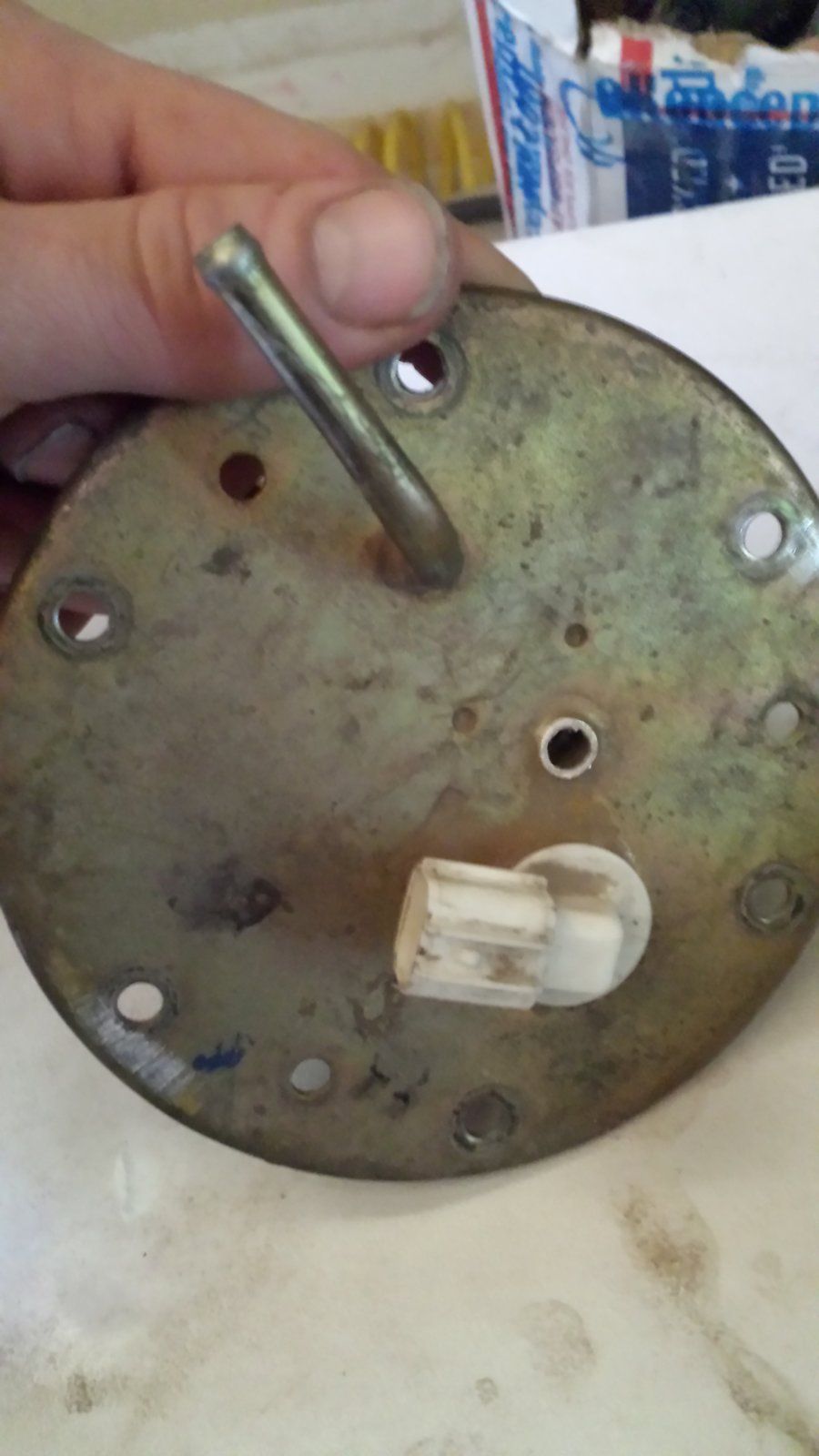

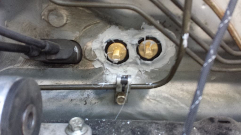

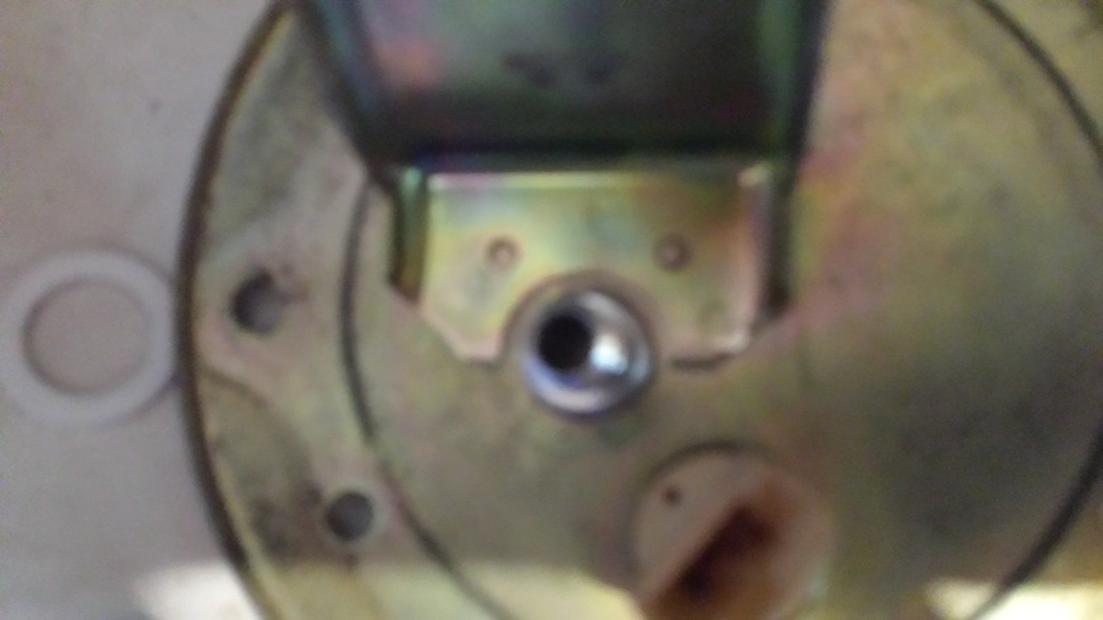

Got a day off so I finally got a Lil bit done. Chopped off my stock fuel line on the hanger here.

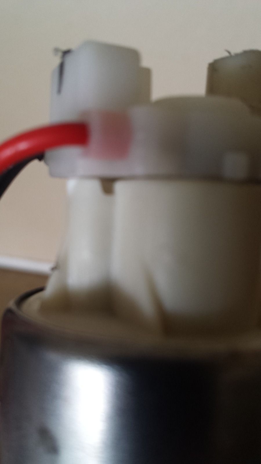

Drilled it out to fit the 6an to barb fitting I got from stm.
As you can see the gasket won't sit flush on the hanger so I had to grind some of the fuel pump bracket off.
Pump installed.

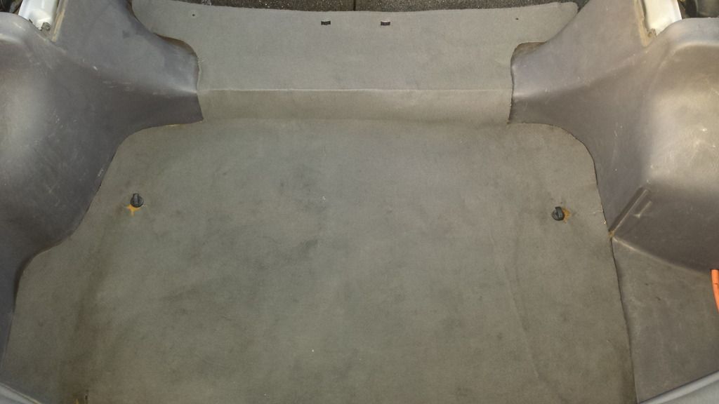

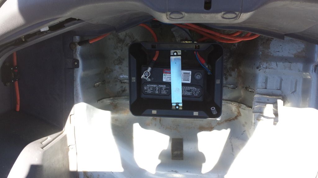

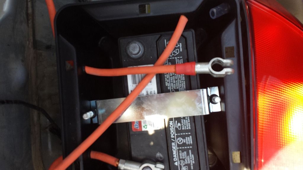

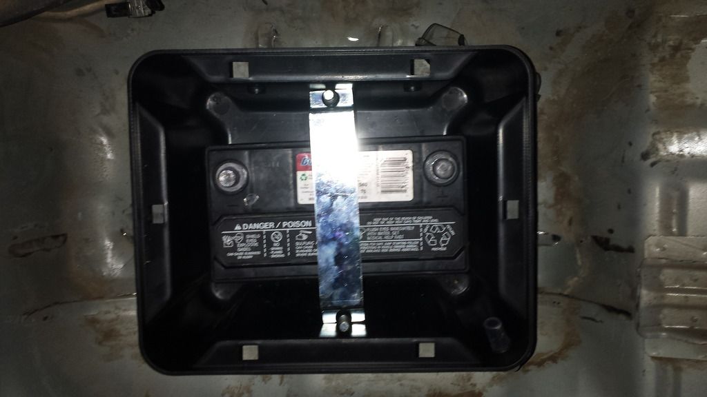

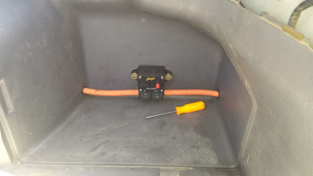

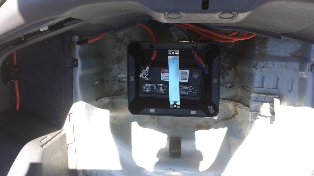

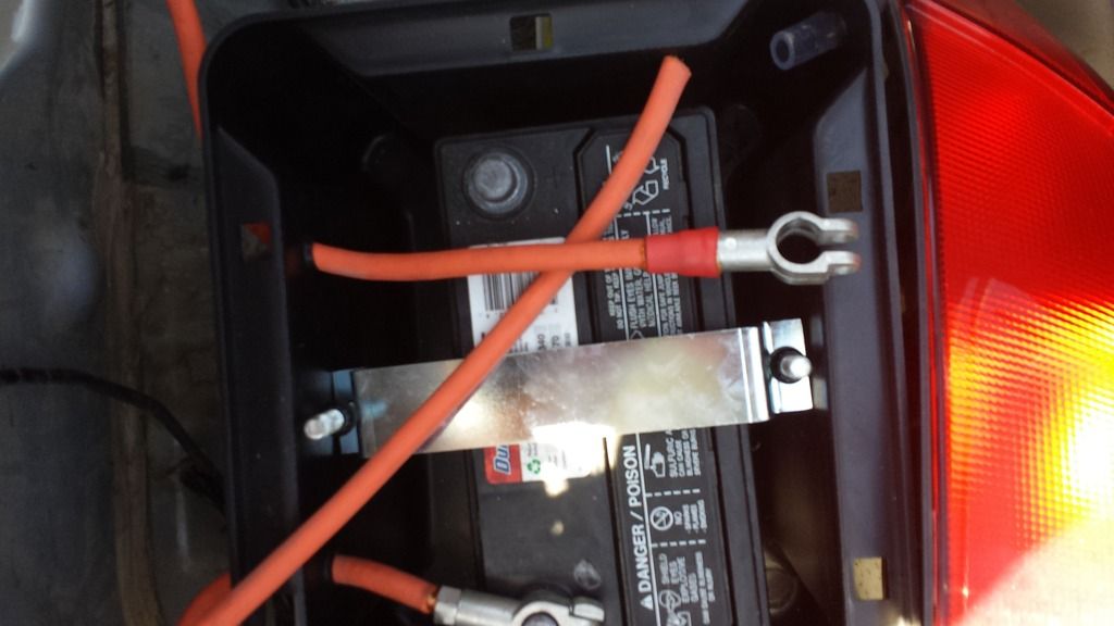

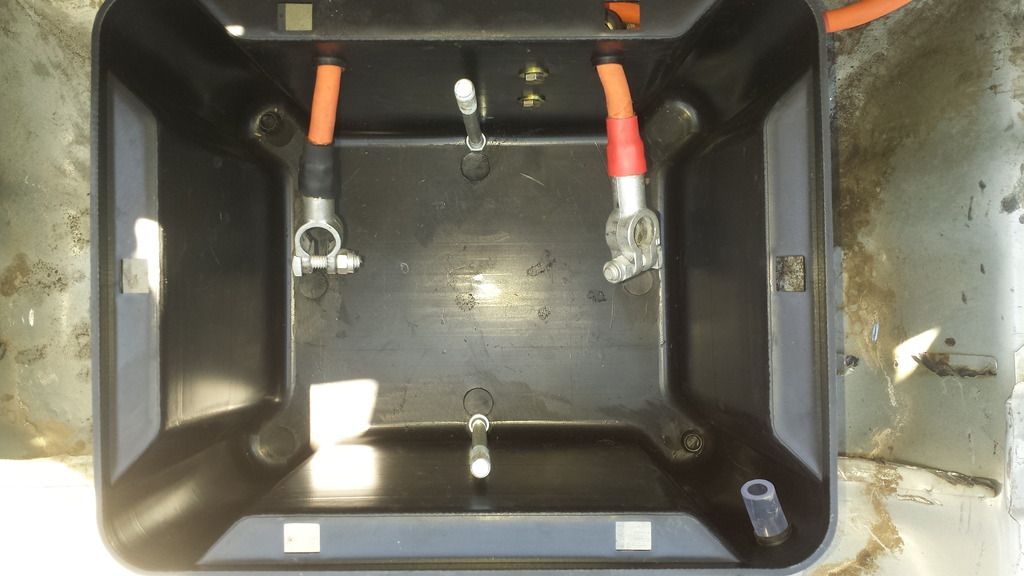

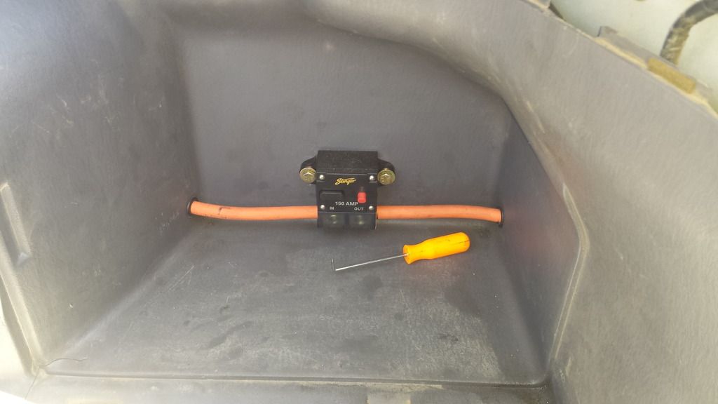

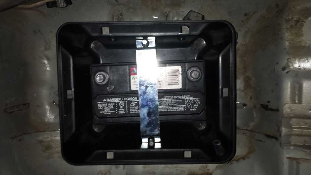

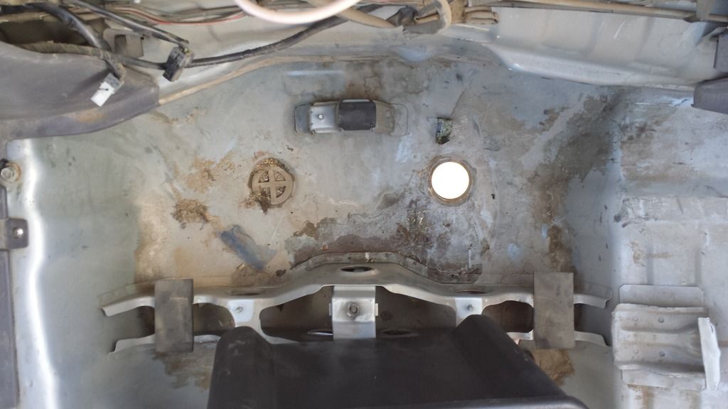

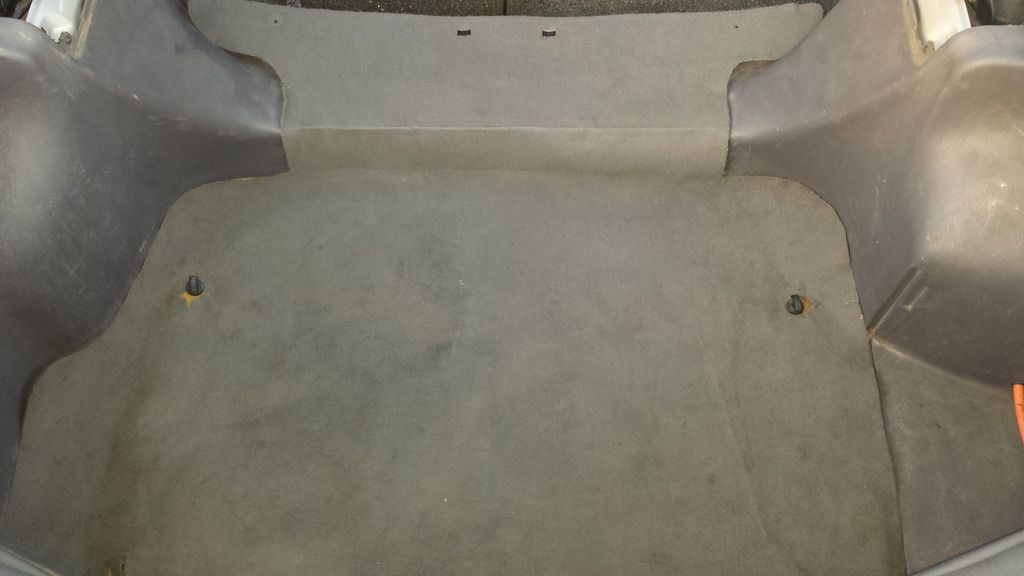

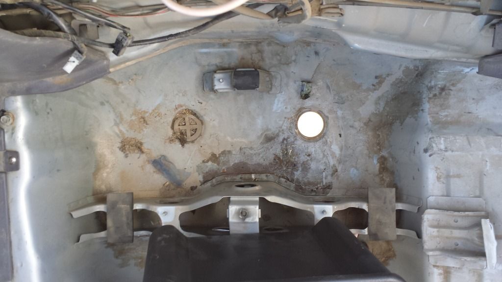

decided to mount the battery where the spare tire goes.
[URL=http://s273.photobucket.com/user/brandonleehulsey/media/Mobile%20Uploads/20150418_171013.jpg.html]20150418_171013.jpg[/URL]

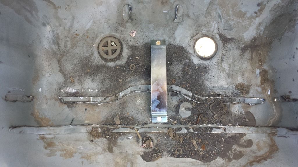

Chopped it all out and put the battery bracket in to make my marks to drill.
[URL=http://s273.photobucket.com/user/brandonleehulsey/media/Mobile%20Uploads/20150418_181521.jpg.html]20150418_181521.jpg[/URL]

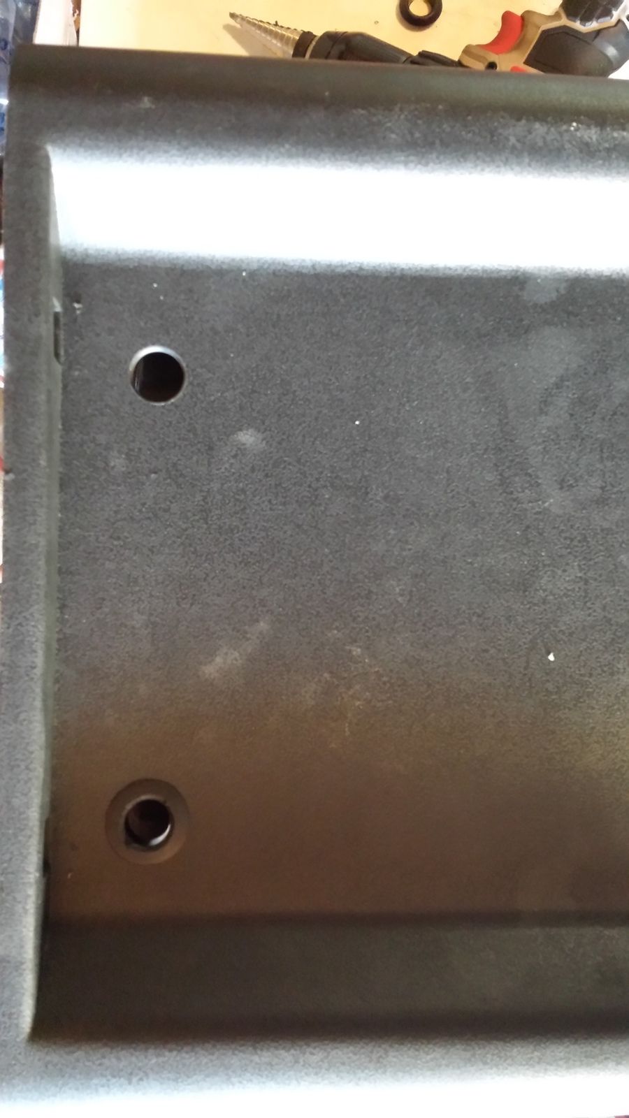

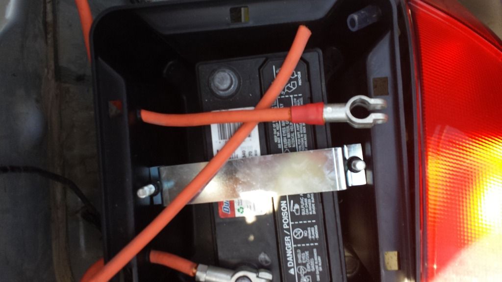

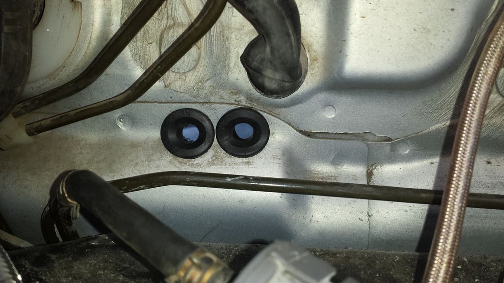

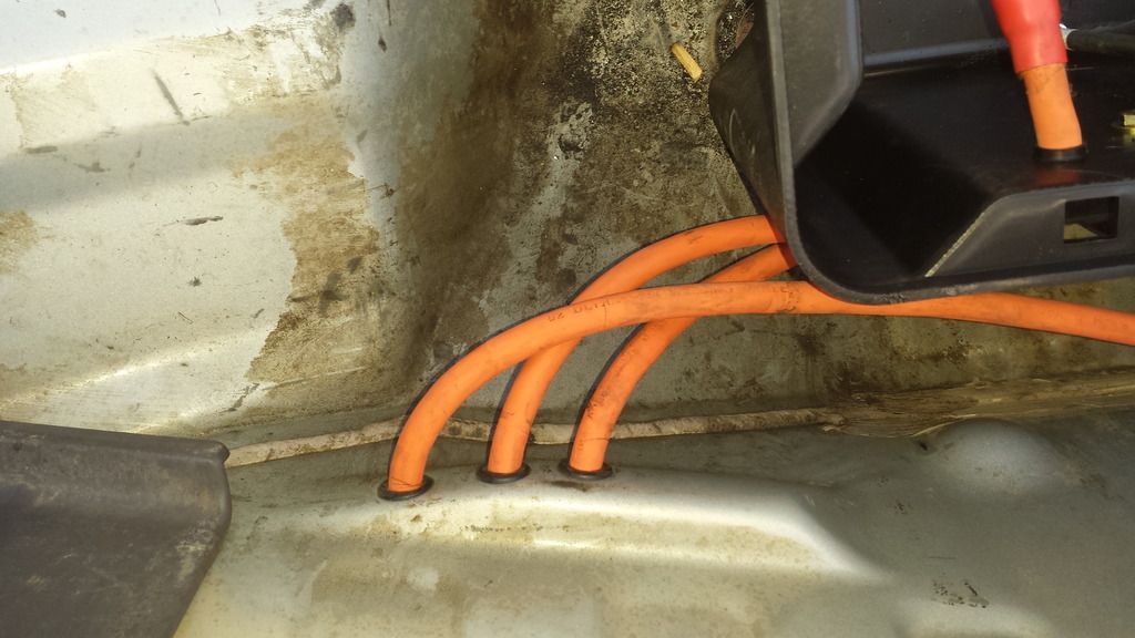

Drilled the holes for the battery cables.
[URL=http://s273.photobucket.com/user/brandonleehulsey/media/Mobile%20Uploads/20150418_183723.jpg.html]20150418_183723.jpg[/URL]
Got it in and snagged up. Now waiting on n cable and I can finish it up.
[URL=http://s273.photobucket.com/user/brandonleehulsey/media/Mobile%20Uploads/20150418_200235.jpg.html]20150418_200235.jpg[/URL]
forgot to get pictures of some of the steps but it's pretty easy. Hopefully get it finished up this week.

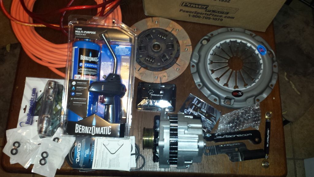

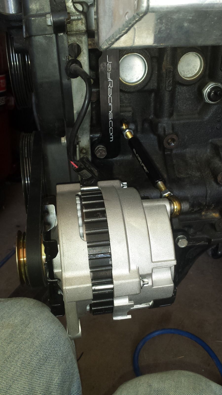

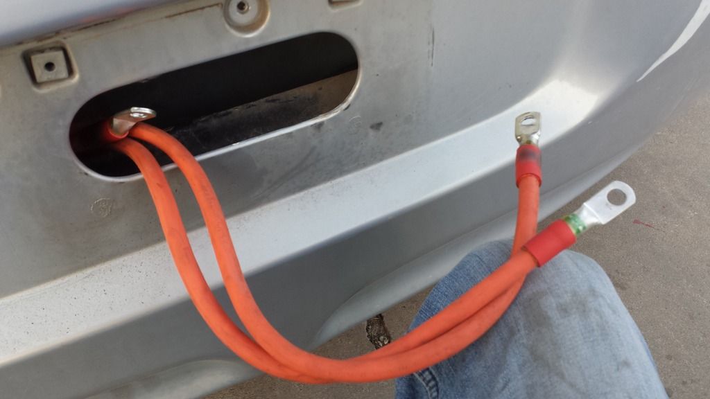

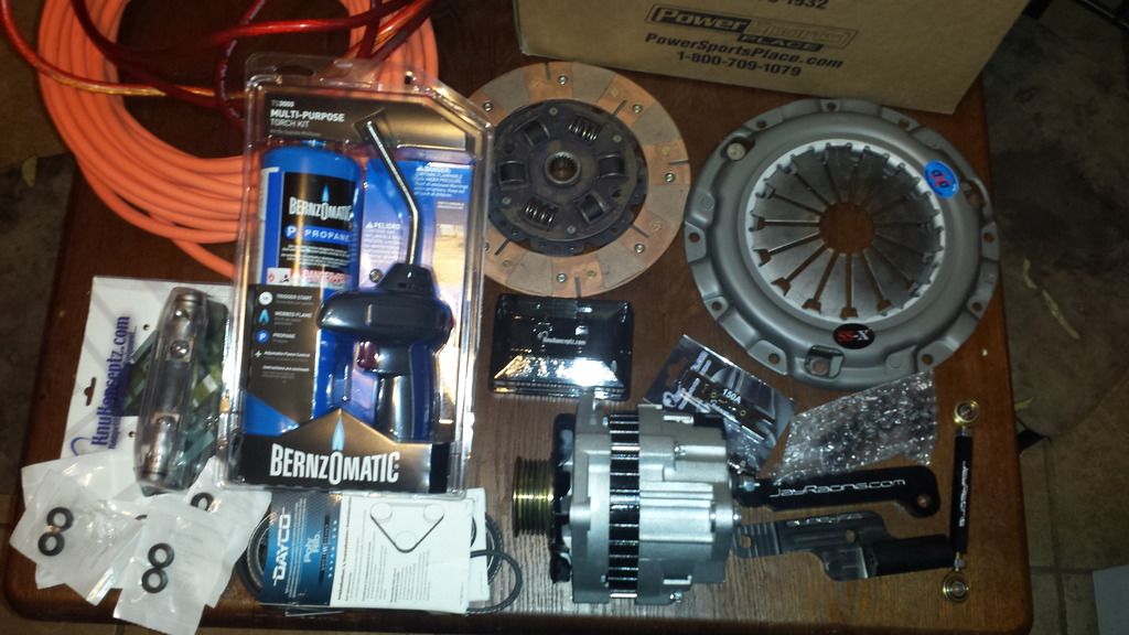

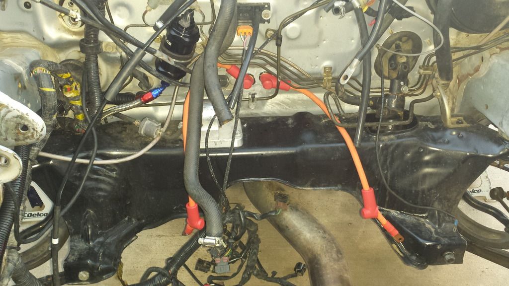

Got some more of my goodies in. 160 amp 1 wire saturn alternator, Jays racing alternator relocation kit, distribution block, 150 amp in line fuse, 2 gauge welding cable, 4 gauge power wire, little torch for solder, new sbc pp and full ceramic disc and some grommets I picked up at lowes. Gonna drill individual holes for the wires.

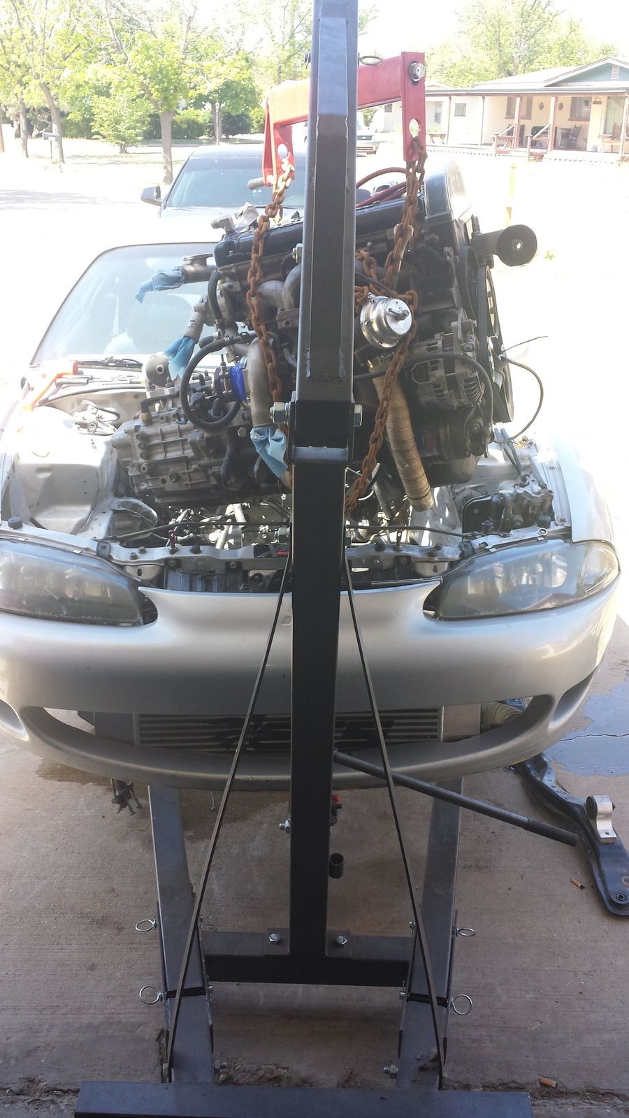

Got a few days off starting tomorrow soo I'm going to be busy for sure. Gonna finish pulling the motor tomorrow, install alternator and kit then do my wiring Friday. Hopefully get everything put back together Saturday afternoon. [URL=http://s273.photobucket.com/user/brandonleehulsey/media/Mobile%20Uploads/20150421_201638.jpg.html]20150421_201638.jpg[/URL]
Did a little work yesterday.
[URL=http://s273.photobucket.com/user/brandonleehulsey/media/Mobile%20Uploads/20150422_105755.jpg.html]20150422_105755.jpg[/URL]
Jays racing alternator relocation kit with saturn 160 amp alternator.

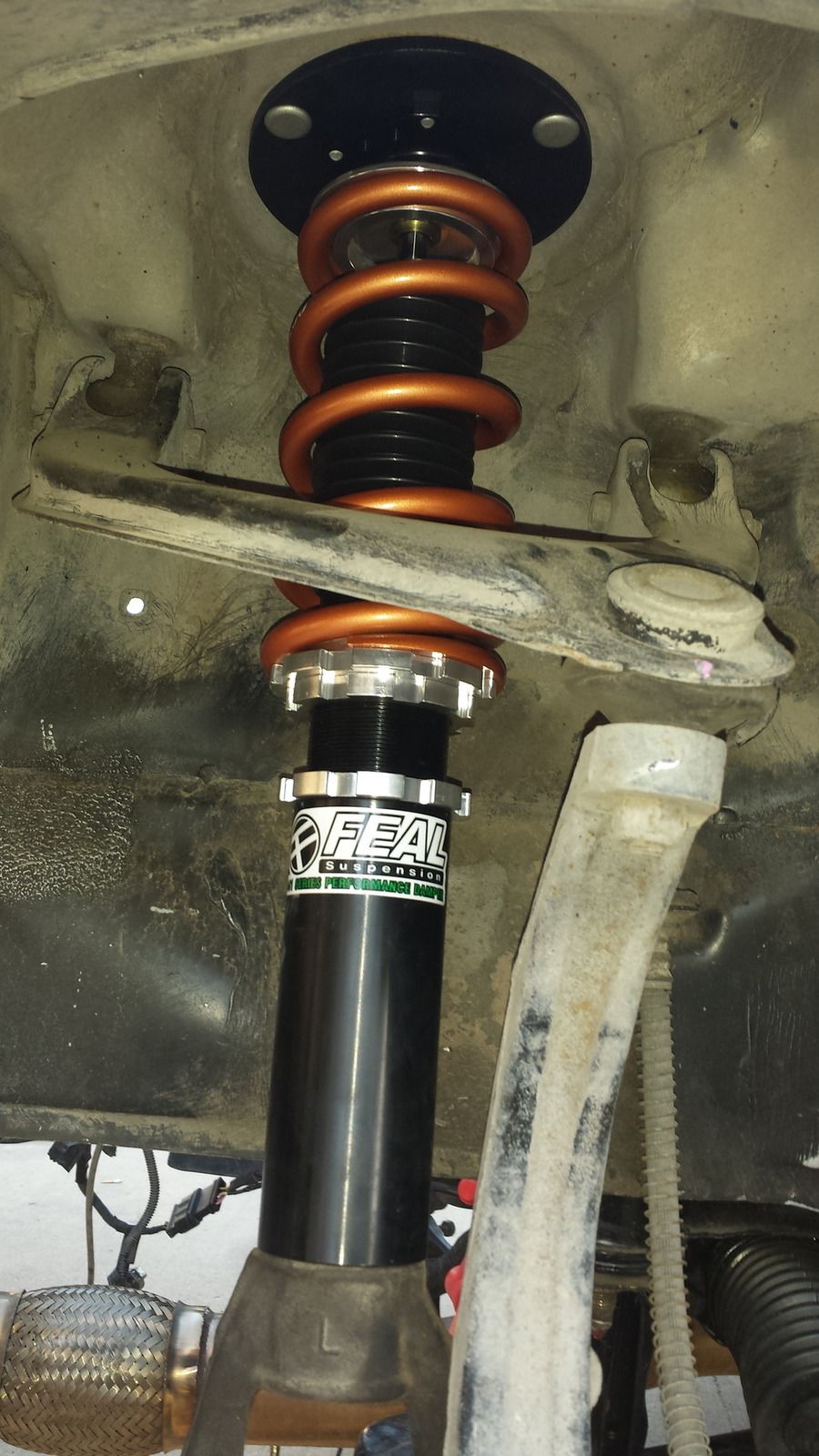

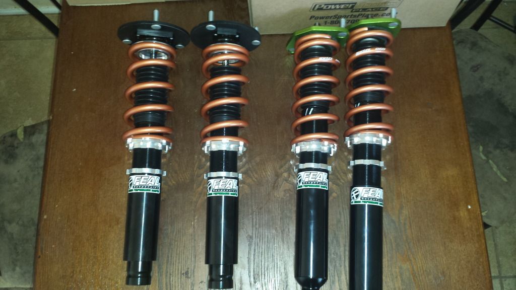

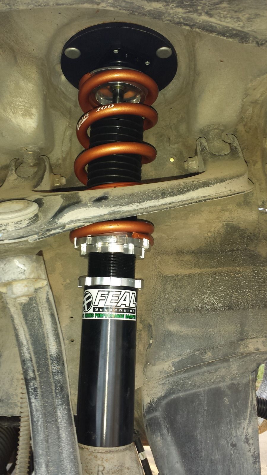

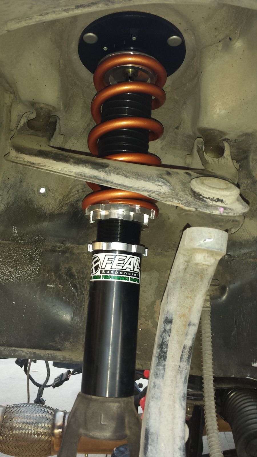

And the coilovers are finally here.
[URL=http://s273.photobucket.com/user/brandonleehulsey/media/Mobile%20Uploads/20150422_142731.jpg.html]20150422_142731.jpg[/URL]
Going to finish up my wiring and battery relocation tomorrow. Hopefully have everything by Saturday

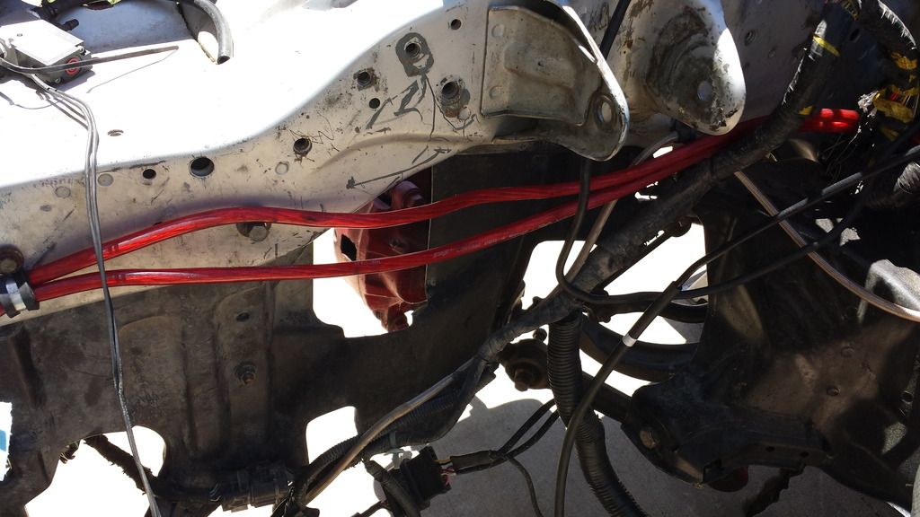

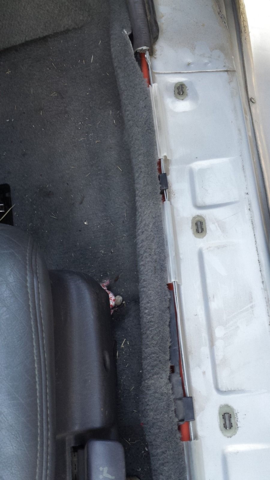

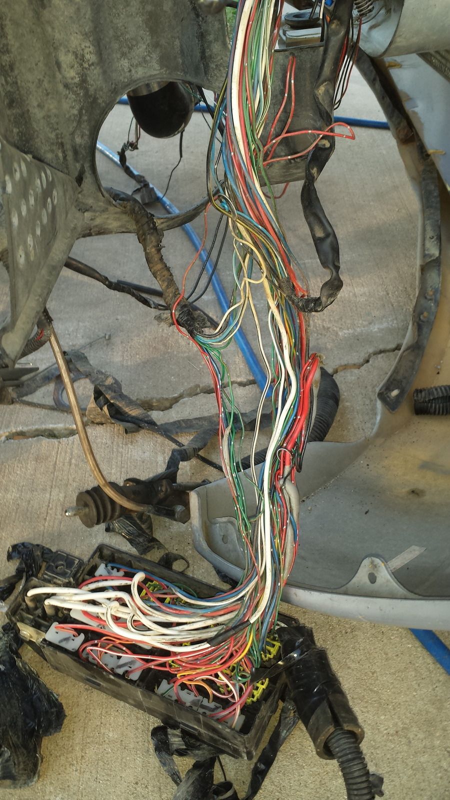

Well I'm officially tired of wiring. Son of a b that battery relocation took a lot longer than I thought. Pretty much 2 solid days all by myself. Here's some pictures. :)
[URL=http://s273.photobucket.com/user/brandonleehulsey/media/Mobile%20Uploads/20150425_123522.jpg.html]20150425_123522.jpg[/URL]
[URL=http://s273.photobucket.com/user/brandonleehulsey/media/Mobile%20Uploads/20150425_141632.jpg.html]20150425_141632.jpg[/URL]
[URL=http://s273.photobucket.com/user/brandonleehulsey/media/Mobile%20Uploads/20150425_141640.jpg.html]20150425_141640.jpg[/URL]
[URL=http://s273.photobucket.com/user/brandonleehulsey/media/Mobile%20Uploads/20150425_141646.jpg.html]20150425_141646.jpg[/URL]
[URL=http://s273.photobucket.com/user/brandonleehulsey/media/Mobile%20Uploads/20150425_145020.jpg.html]20150425_145020.jpg[/URL]
[URL=http://s273.photobucket.com/user/brandonleehulsey/media/Mobile%20Uploads/20150425_163606.jpg.html]20150425_163606.jpg[/URL]
[URL=http://s273.photobucket.com/user/brandonleehulsey/media/Mobile%20Uploads/20150425_163622.jpg.html]20150425_163622.jpg[/URL]
[URL=http://s273.photobucket.com/user/brandonleehulsey/media/Mobile%20Uploads/20150425_182828.jpg.html]20150425_182828.jpg[/URL]

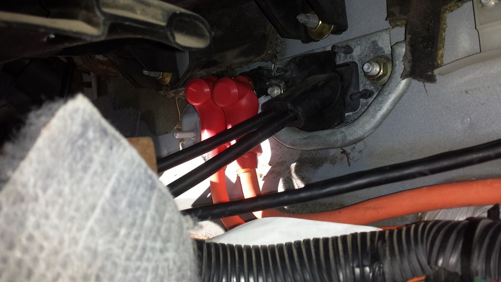

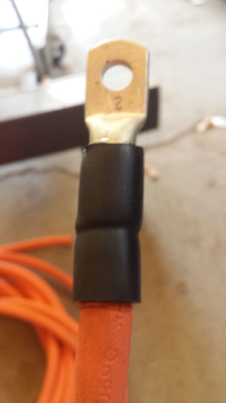

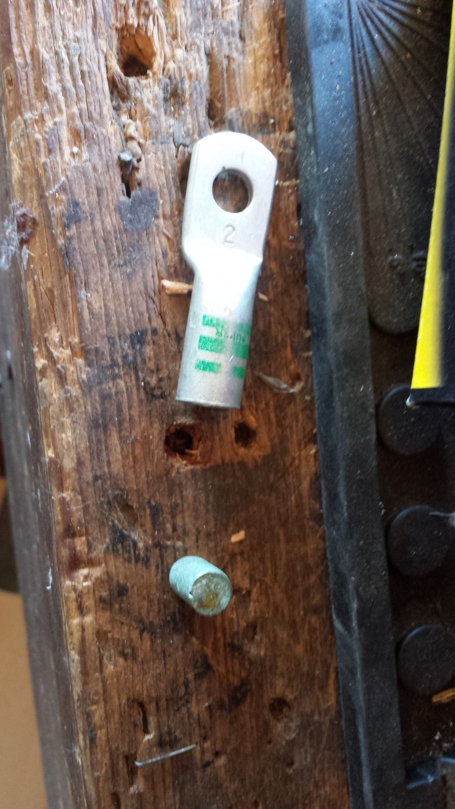

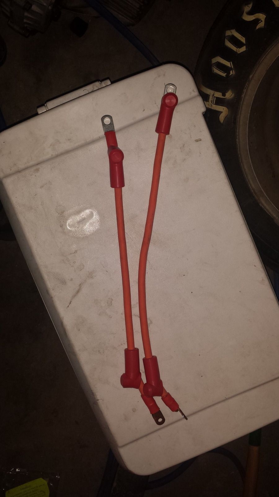

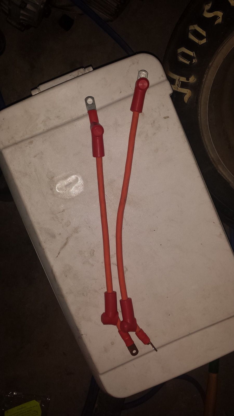

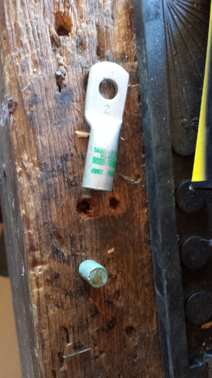

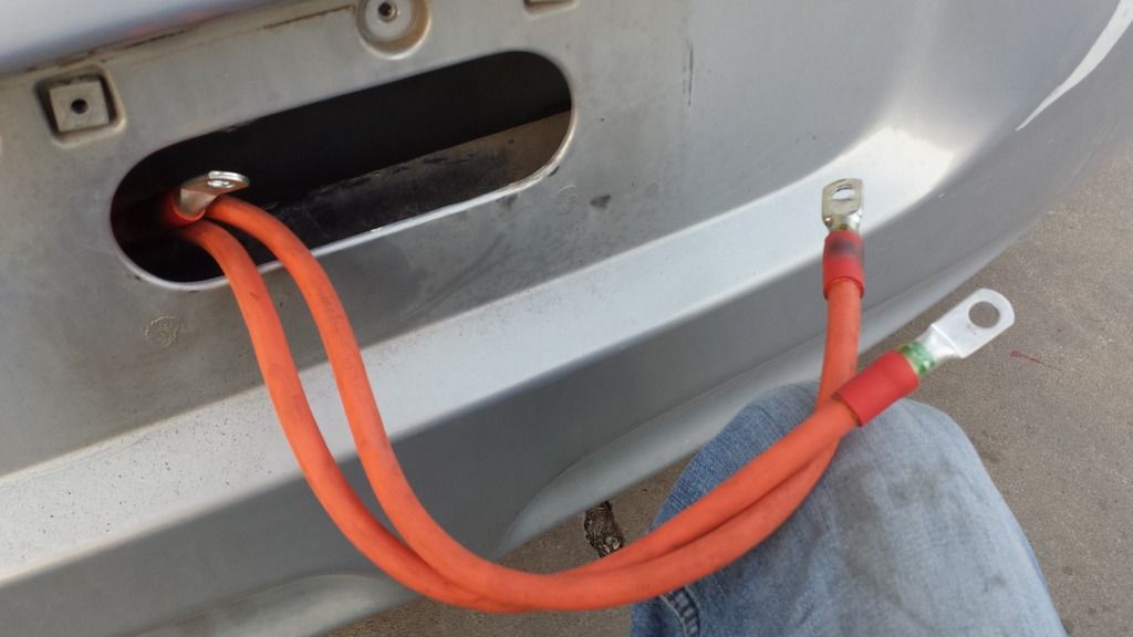

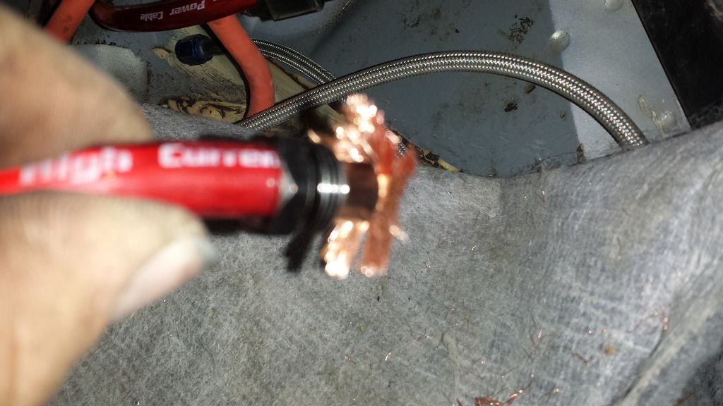

These are my starter and alternator wires. Have to order some little terminal protectors for the alternator and starter.
[URL=http://s273.photobucket.com/user/brandonleehulsey/media/Mobile%20Uploads/20150425_182844.jpg.html]20150425_182844.jpg[/URL]

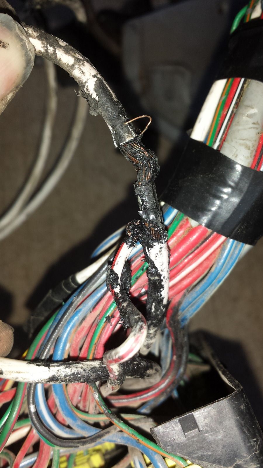

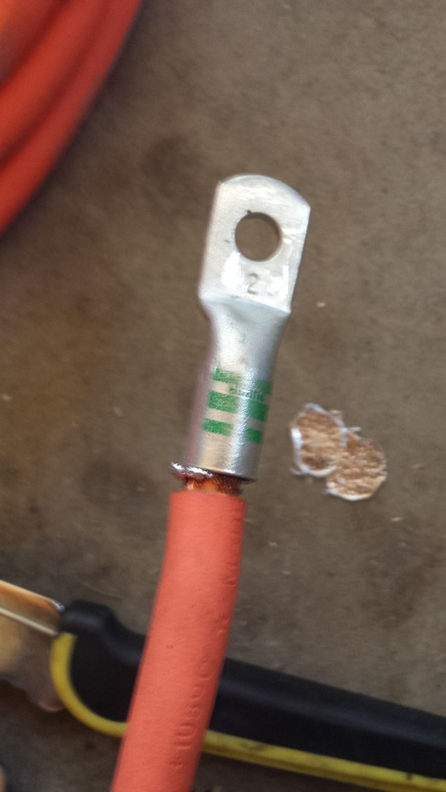

Removing the old wires for some 4 gauge.
[URL=http://s273.photobucket.com/user/brandonleehulsey/media/Mobile%20Uploads/20150425_184245.jpg.html]20150425_184245.jpg[/URL]
Gotta figure out what I'm going to do about this still. Seems to be spliced in there?
[URL=http://s273.photobucket.com/user/brandonleehulsey/media/Mobile%20Uploads/20150425_190714.jpg.html]20150425_190714.jpg[/URL]

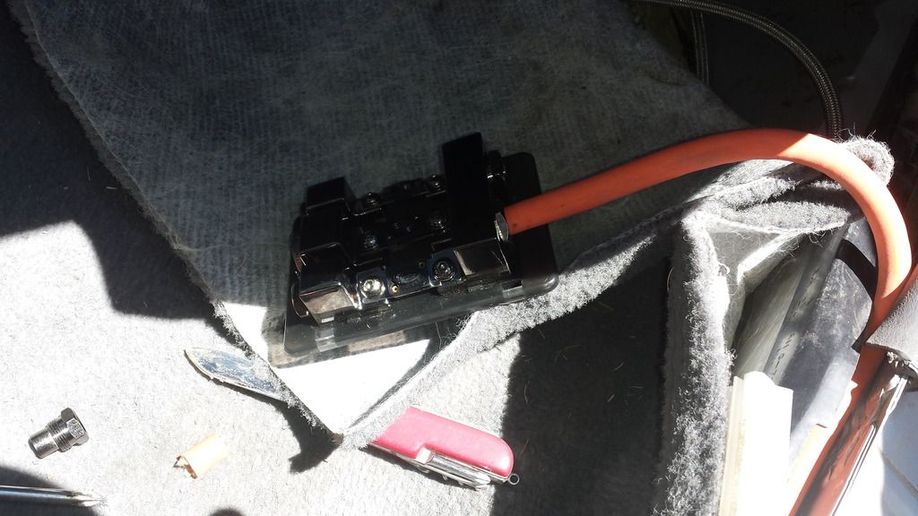

4 gauge going into the distribution block
[URL=http://s273.photobucket.com/user/brandonleehulsey/media/Mobile%20Uploads/20150425_192450.jpg.html]20150425_192450.jpg[/URL]

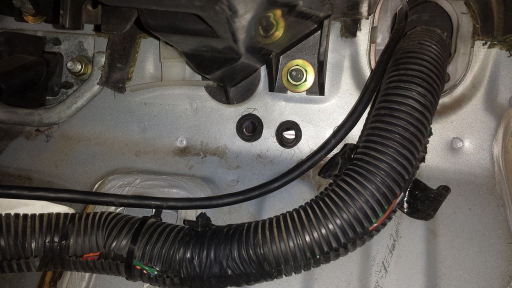

Thinking about looming these.
[URL=http://s273.photobucket.com/user/brandonleehulsey/media/Mobile%20Uploads/20150425_193958.jpg.html]20150425_193958.jpg[/URL]

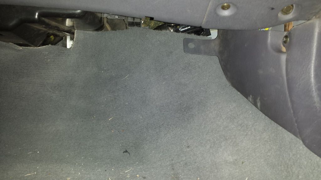

and after I finished with the interior back in place.
[URL=http://s273.photobucket.com/user/brandonleehulsey/media/Mobile%20Uploads/20150425_194412.jpg.html]20150425_194412.jpg[/URL]

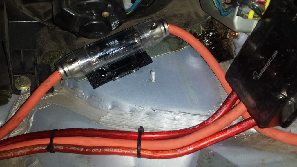

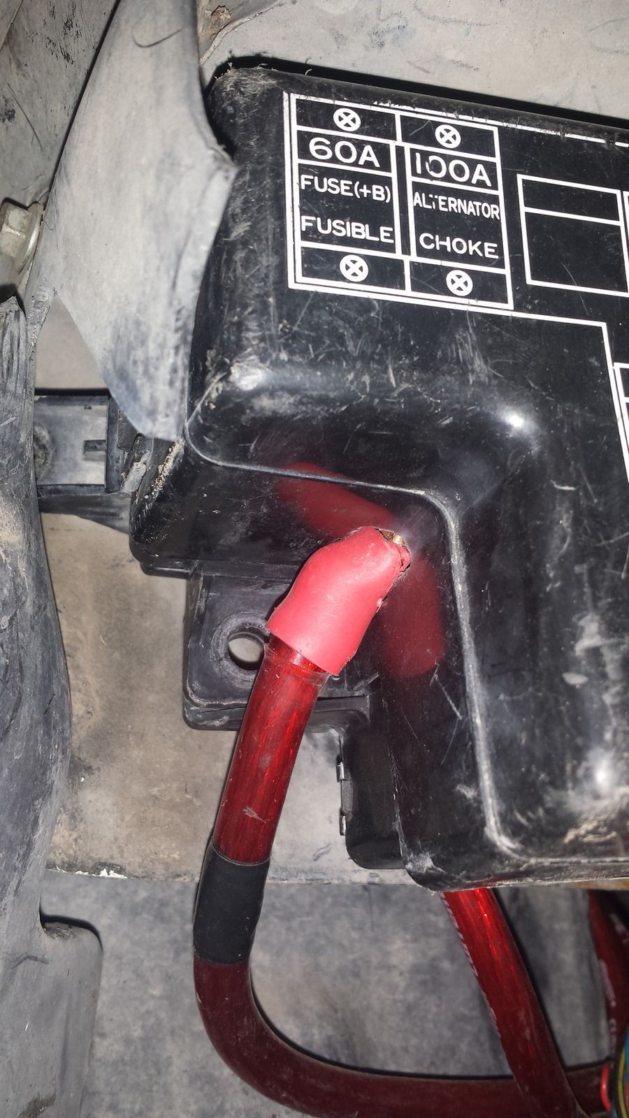

all I got left is starter ground and to connect the 4 gauge to the fuse box. New flywheel should be here in a few weeks. Then I can get her all put back together. I pray everything works LOL
[URL=http://s273.photobucket.com/user/brandonleehulsey/media/Mobile%20Uploads/20150430_123204.jpg.html]20150430_123204.jpg[/URL]
ran these wires to the fuse box. Going to loom these tomorrow for protection. New flywheel shipped today hopefully have it in next week. Ready to get this suckered going. Hopefully everything works good all out call out in Albuquerque is June 6th. Be my first time tracking it. Going to put it in the big boys class. 12.8 to 11.5. I would hope I can make at least a 12.8 LOL

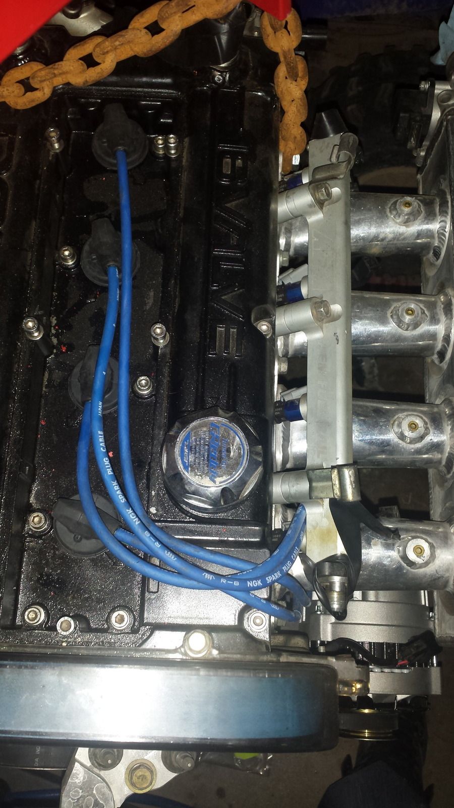

Here's the new ngk wires
[URL=http://s273.photobucket.com/user/brandonleehulsey/media/Mobile%20Uploads/20150505_195858.jpg.html]20150505_195858.jpg[/URL]

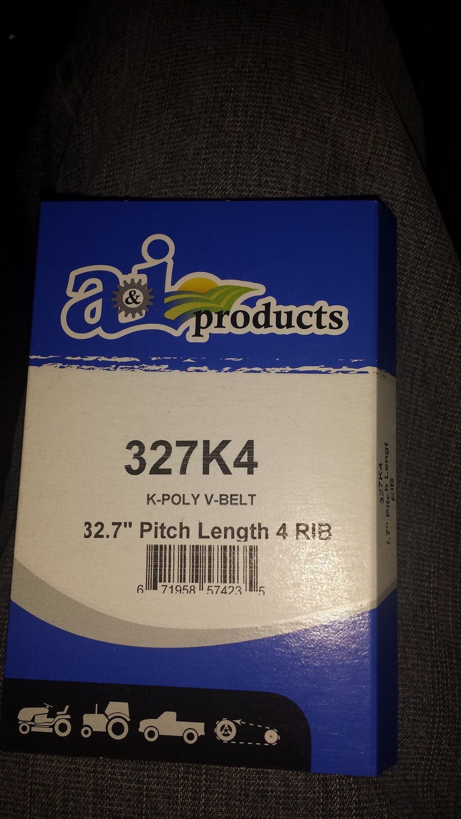

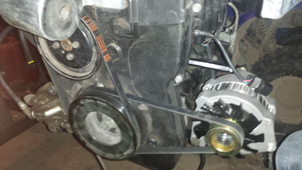

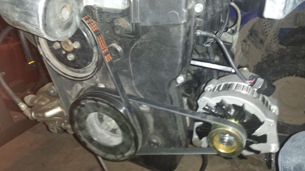

the alternator done finally. Had hell finding the right belts.
[URL=http://s273.photobucket.com/user/brandonleehulsey/media/Mobile%20Uploads/20150505_195908.jpg.html]20150505_195908.jpg[/URL]
Here's the belt size I ended up using for the water pump and alternator.
[URL=http://s273.photobucket.com/user/brandonleehulsey/media/Mobile%20Uploads/20150505_195917.jpg.html]20150505_195917.jpg[/URL]
Here's my wires re loomed. Ready to go back on.
[URL=http://s273.photobucket.com/user/brandonleehulsey/media/Mobile%20Uploads/20150505_201712.jpg.html]20150505_201712.jpg[/URL]

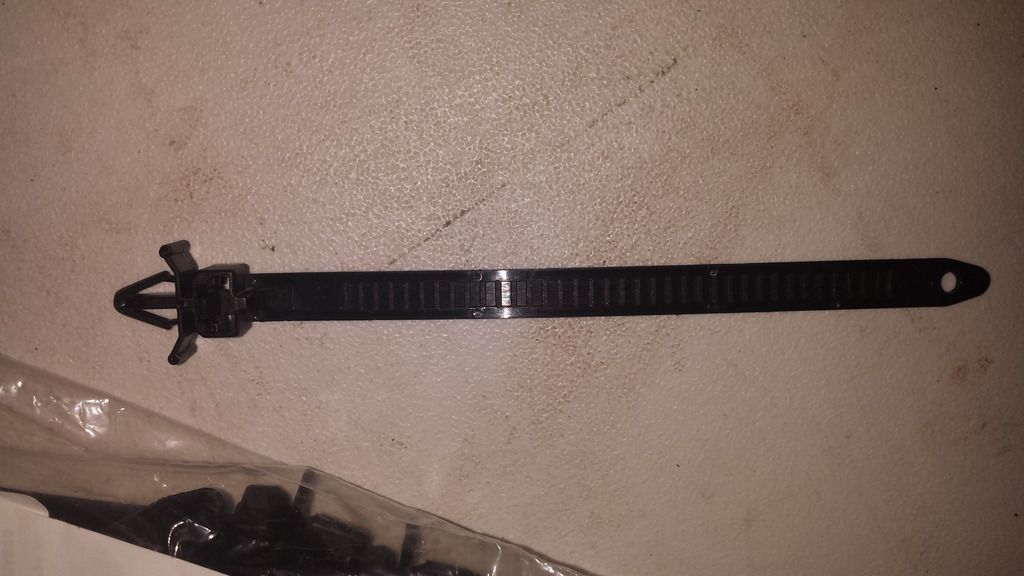

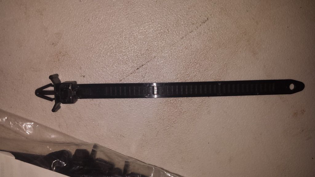

Here's the zip ties I found at fastenal to clip the wire loom back into its original place.
[URL=http://s273.photobucket.com/user/brandonleehulsey/media/Mobile%20Uploads/20150505_201729_1.jpg.html]20150505_201729_1.jpg[/URL]

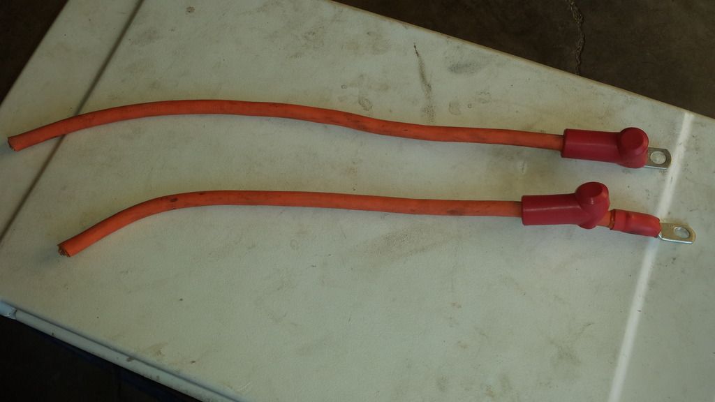

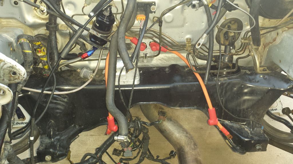

Alternator and starter wires finished up and ready to install
[URL=http://s273.photobucket.com/user/brandonleehulsey/media/Mobile%20Uploads/20150505_201929.jpg.html]20150505_201929.jpg[/URL]

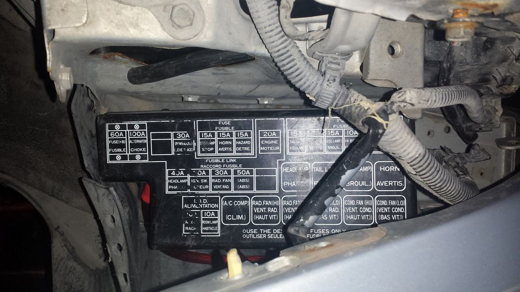

Fuse box behind the bumper.
[URL=http://s273.photobucket.com/user/brandonleehulsey/media/Mobile%20Uploads/20150505_202107.jpg.html]20150505_202107.jpg[/URL]
One of the 4 gauge power wires going in.
[URL=http://s273.photobucket.com/user/brandonleehulsey/media/Mobile%20Uploads/20150505_202134.jpg.html]20150505_202134.jpg[/URL]

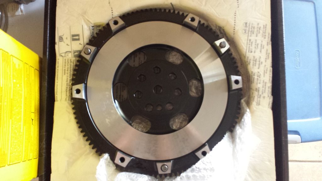

New flywheel.
[URL=http://s273.photobucket.com/user/brandonleehulsey/media/Mobile%20Uploads/20150507_164433.jpg.html]20150507_164433.jpg[/URL]
[URL=http://s273.photobucket.com/user/brandonleehulsey/media/Mobile%20Uploads/20150507_164449.jpg.html]20150507_164449.jpg[/URL]

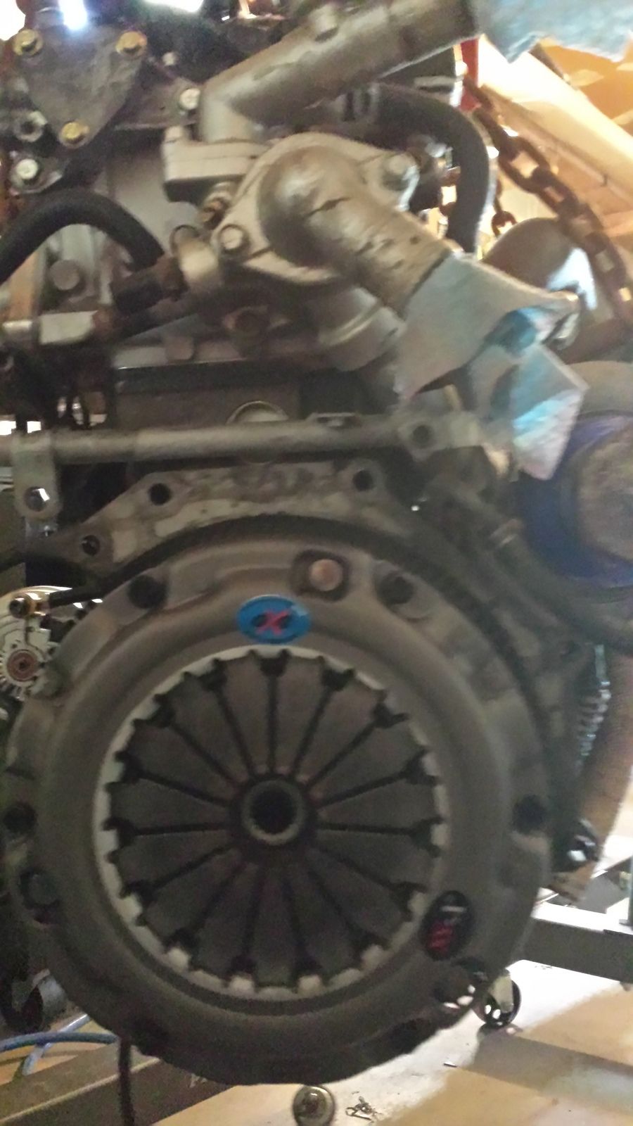

Installed with new pressure plate and clutch.
[URL=http://s273.photobucket.com/user/brandonleehulsey/media/Mobile%20Uploads/20150507_174555.jpg.html]20150507_174555.jpg[/URL]

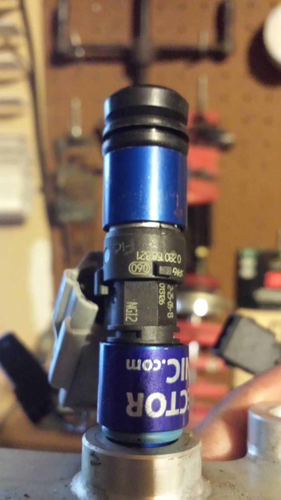

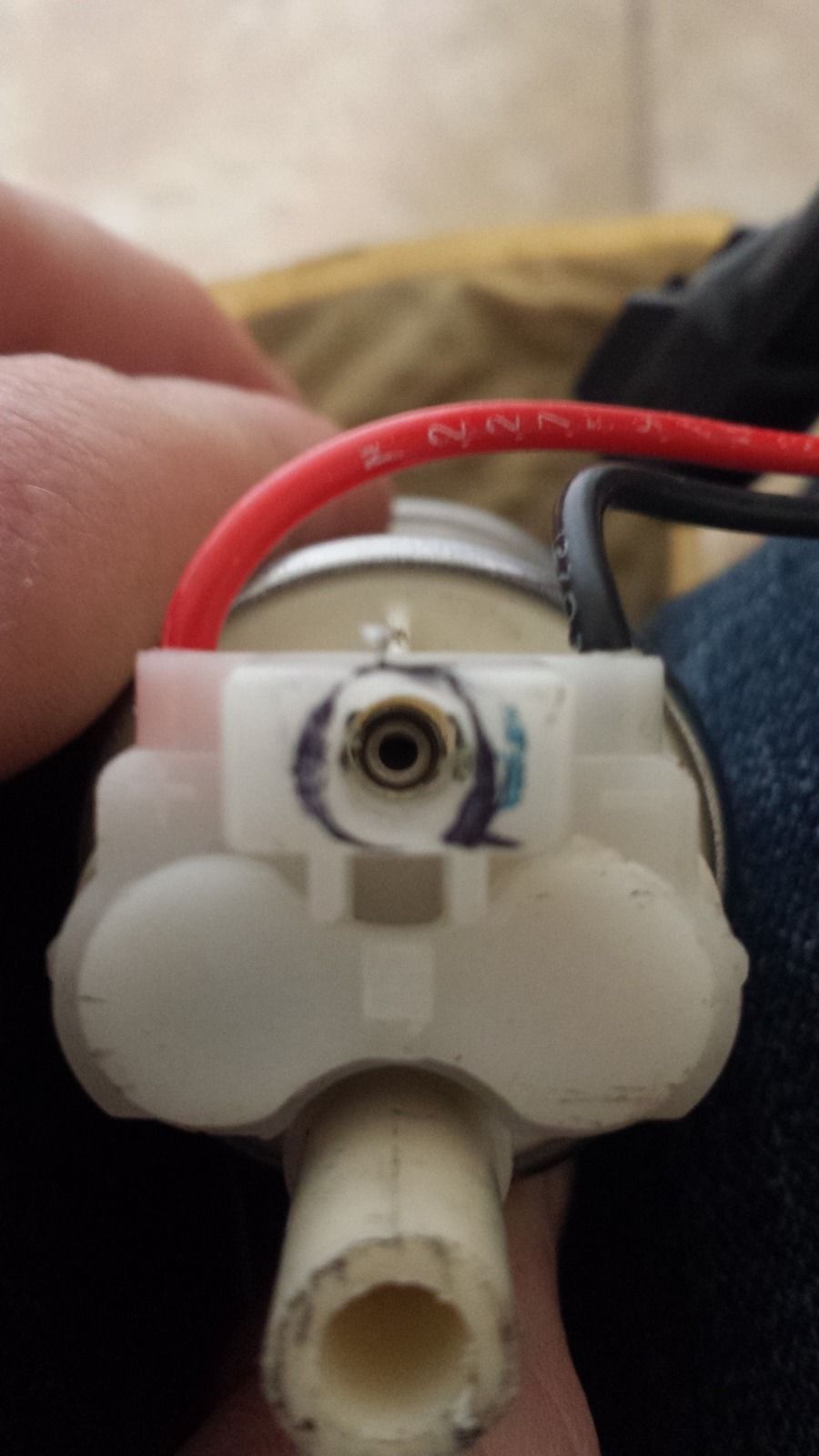

I've been having hell getting my lower injector seals to hold so I bought new seals again and this time put the old o ring under the fuel rail as a "spacer" and some grommets on the other end. Hopefully this will fix the issue.
[URL=http://s273.photobucket.com/user/brandonleehulsey/media/Mobile%20Uploads/20150507_193642.jpg.html]20150507_193642.jpg[/URL]

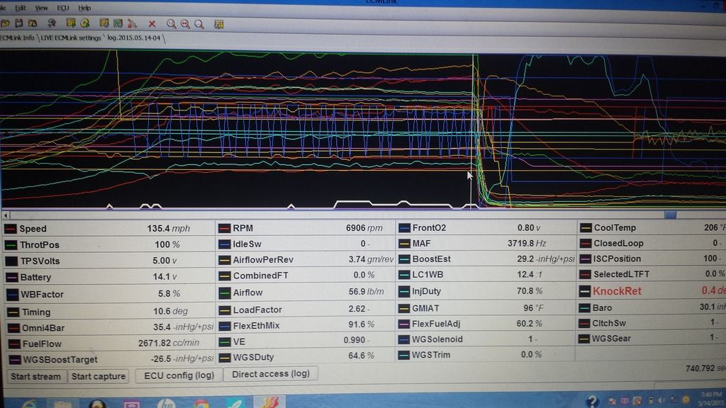

Got the clutch from @twicks69 broke in and it's holding great. Also been tuning with @MY1GDSM and the car is running better than it ever has. Logging 50 lb/min and pulling great. Gonna take it to a local track tomorrow to see what kind of times my no driving ass can get LOL also a big thanks to @gofer and @turbosax2 for the help with the battery relocation. Everything works and turned out great.

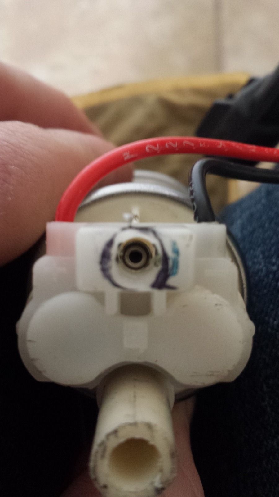

Got on the relief valve punch mod today. I moved it about 1.5mm. Hopefully it is good and does the trick. Well here are the pictures I took of it. You have to drill completely through this top section to the visible tube below it. That is where the relief valve is. There is some sort of metal in that section I'm not very sure what it exactly is for.
[URL=http://s273.photobucket.com/user/brandonleehulsey/media/Mobile%20Uploads/20150520_101916.jpg.html]20150520_101916.jpg[/URL]
[URL=http://s273.photobucket.com/user/brandonleehulsey/media/Mobile%20Uploads/20150520_102030.jpg.html]20150520_102030.jpg[/URL]
Really isn't much to it, pretty simple. I reinstalled the pump and it still starts and idles good. I am waiting on new tires now. All the tuning on the highway destroyed my qtps. They started showing the rope or whatever it is under the rubber. Have 2 new ones headed here and another street tire so I can drive without killing my slicks.
