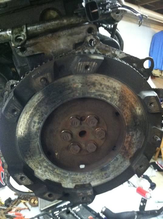

Wish i would have taken more pics while i was rebuilding the engine, but it was an oem rebuild so not much to see really. this was the first time i have pulled a motor and rebuilt so i had a few snags. then when i was finished i realized i messed up the timing steps and bent the intake valves on 1&4, so after getting the head reworked i put it back together again.

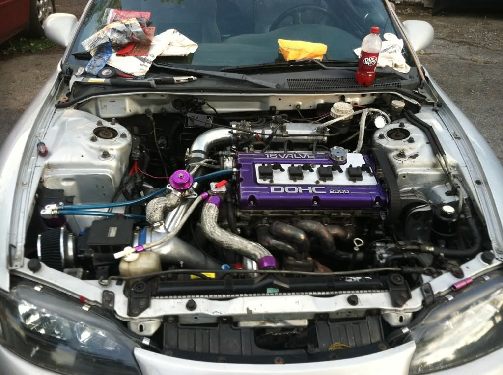

The t25 was blown of course so i went ahead and got a ebay 16g kit, i know don't say it i took a chance and it is working great so far. threw in a evo 9 pump and AFPR. Also bought a socketed eprom ecu off a member to be ready for the big step.
after it was running good another weird problem started going on with power lose and weird idle, after trying everything i could think of to figure it out i went ahead and put in the eprom with a chip the guy included that he "tuned" for 16 psi with this setup. I also put in a hallman and turned the boost up to 16 to match what he tuned it for. Fixed the problem and is running great.

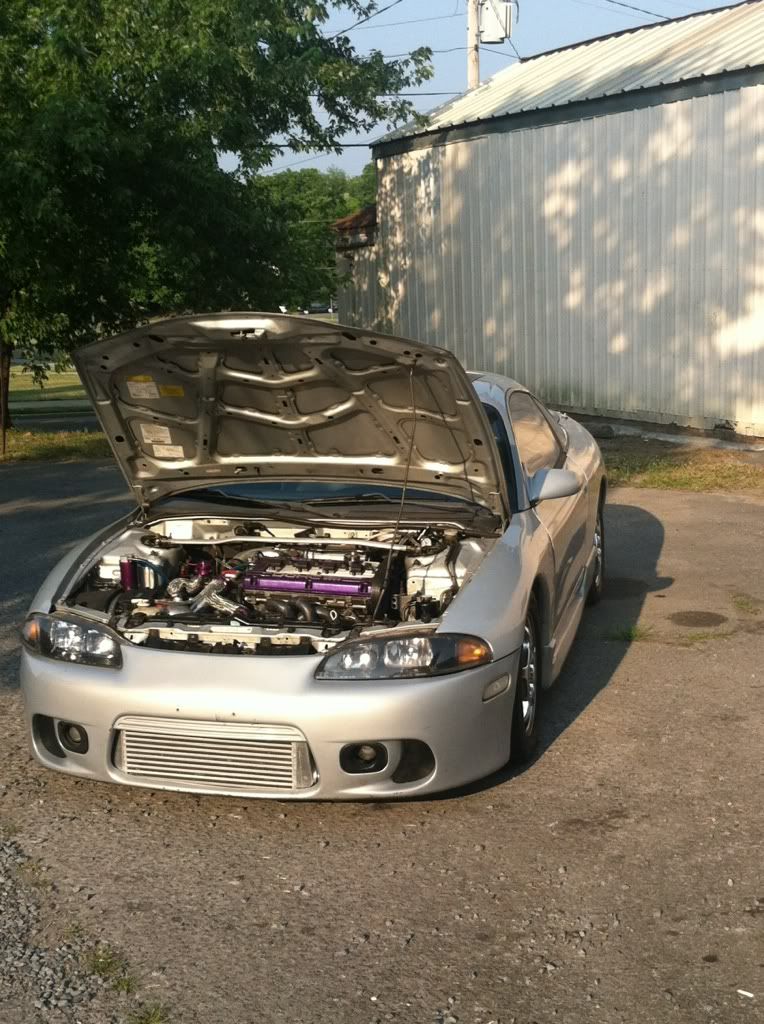

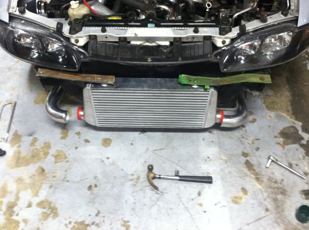

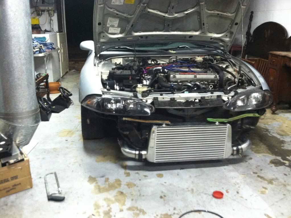

Next came the PR FMIC.
now before you say something about the mounts, the kit i got didn't come with mounting bar and these were the first stage and they ended up looking pretty good wish i would have snapped a pic of the after but forgot.
Next i really hate to run with no bumper, so i went ahead and finished the 2gb front end.

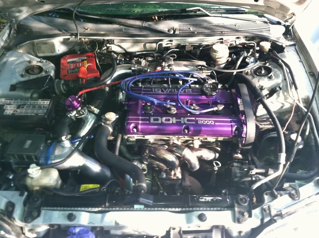

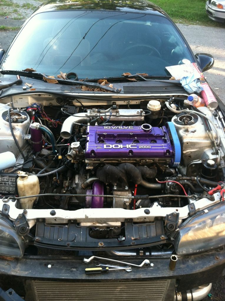

Then i did some easy stuff like painting up the valve cover "HKS" purple and cleared it and threw it on with some ss bolts.

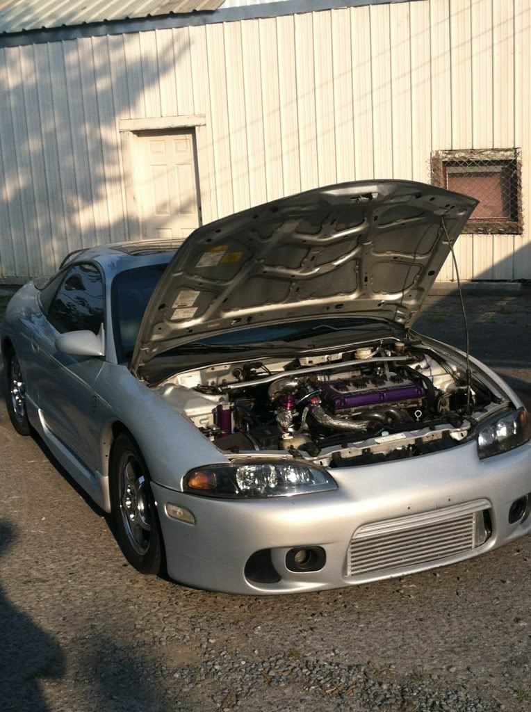

That's how it sets as of right now hopefully i should have an update soon when i get link so i can put in my evo injectors.

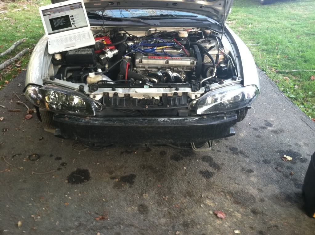

Going from memory here after this I got link and installed it. Threw some 680cc injectors in, 3in exhaust and cat delete DP.
then moved on to cleaning up the engine bay. Relocated the Battery, deleted AC and Cruise control, and finally relocated my fuse box to under the IC piping.

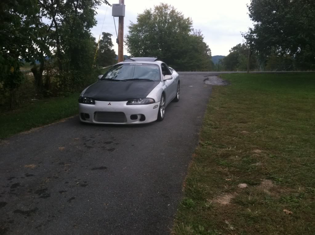

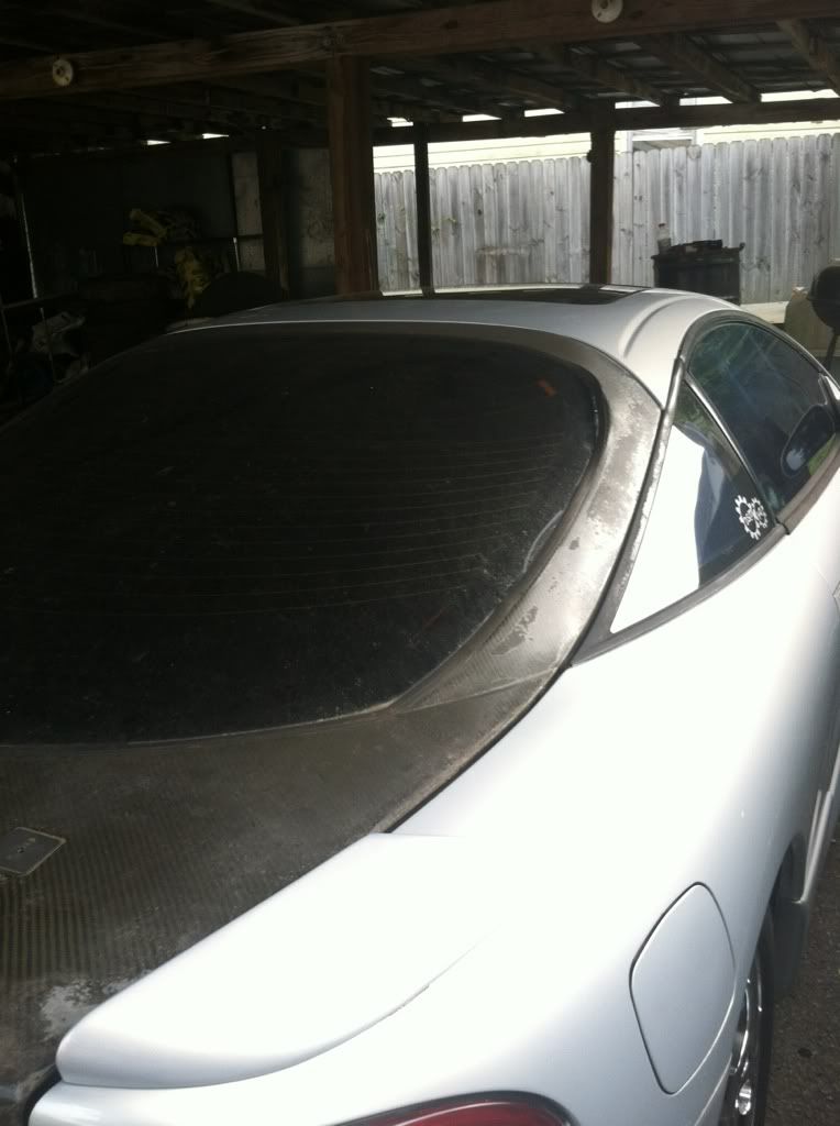

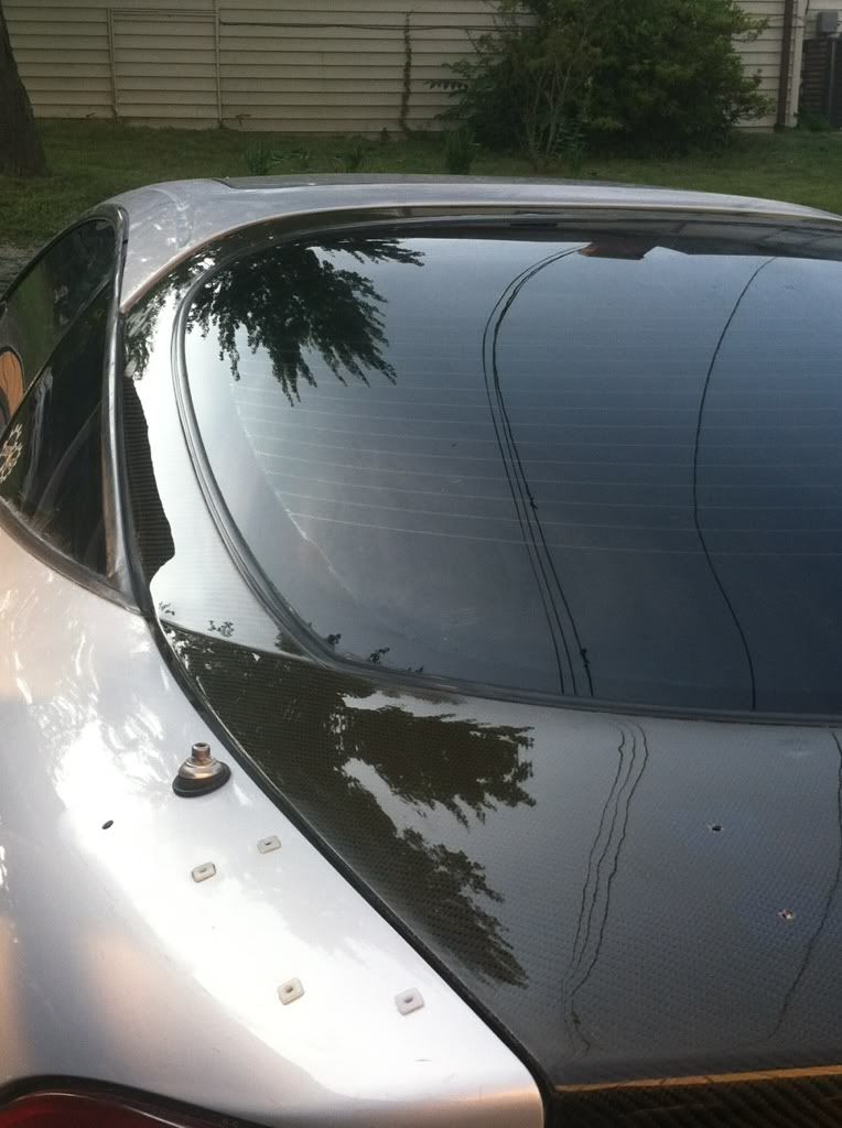

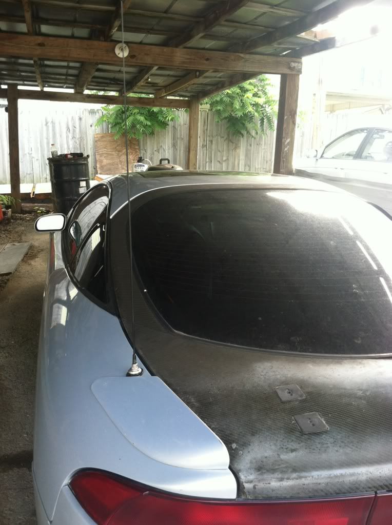

After this I got a carbon fiber hatch in rough shape. Wet sanded it and buffed it.
Before:
After:

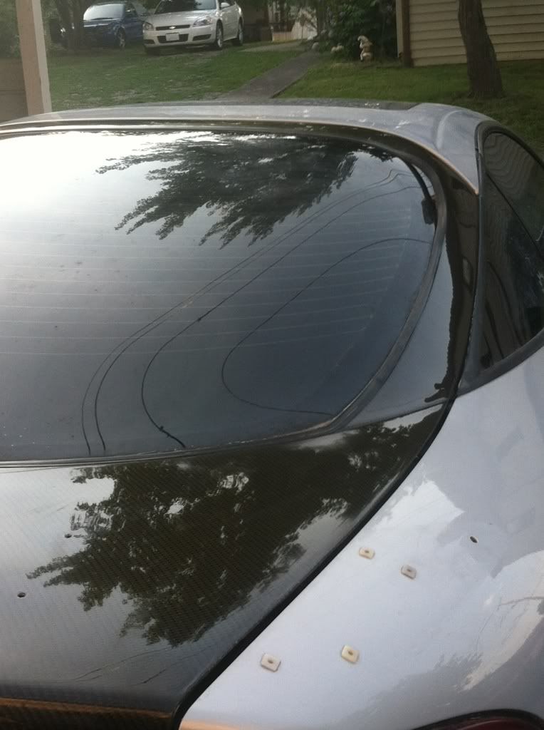

Then decided to paint it black.
Before:
After:
Will replace this with some better ones when I upload them.

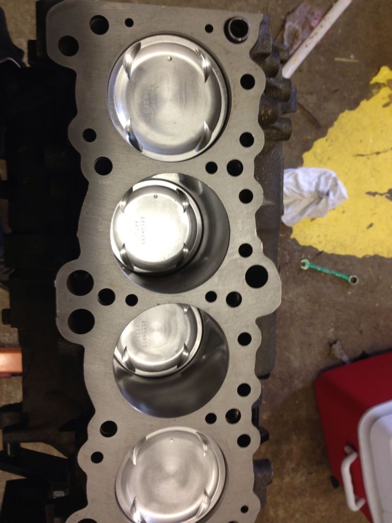

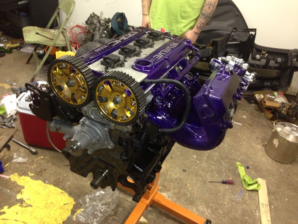

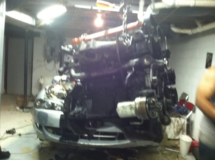

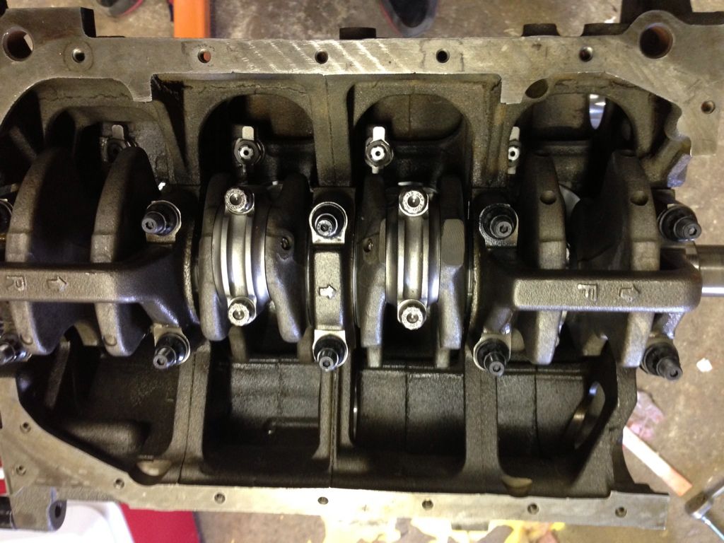

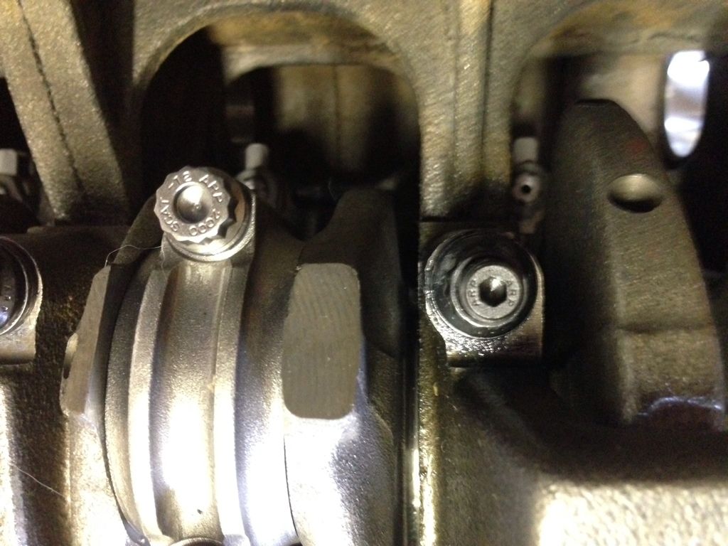

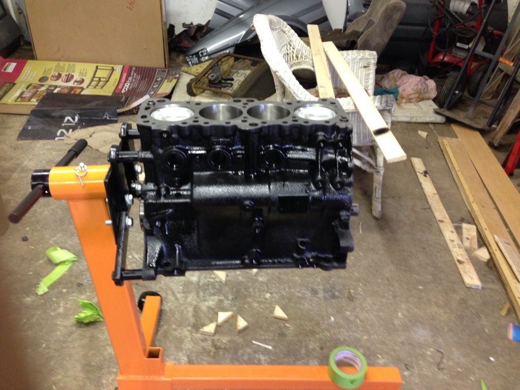

Fast forward to now I bought a freshly rebult shortblock with 0 miles. It has wiseco pistons, scat rods, BSE, and ARP everything.
I also bought some BC cam gears, New Gates waterpump, New bolts for the oil pump and water pump, 6an tank to rail, revised lifters, supertech valve stem seals, and crower springs and TI retainers. The machine shop I bought the block from also included a Brand new still wrapped set of ARP head studs and a brand ne Cometic HG. I also bought the fittings to run 4an line from my comp housing to wg and from my bov to the RRE mdp adapter.

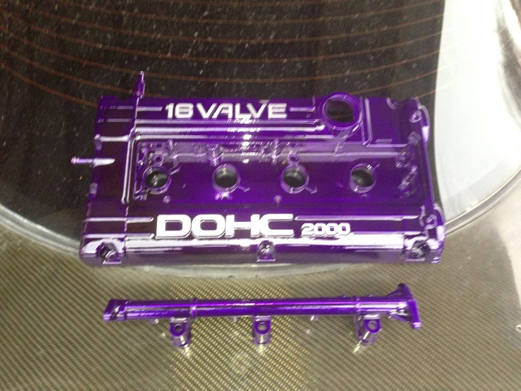

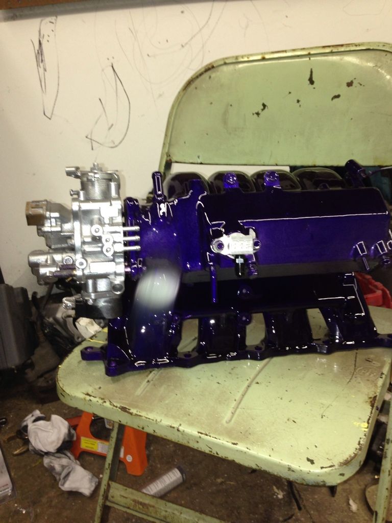

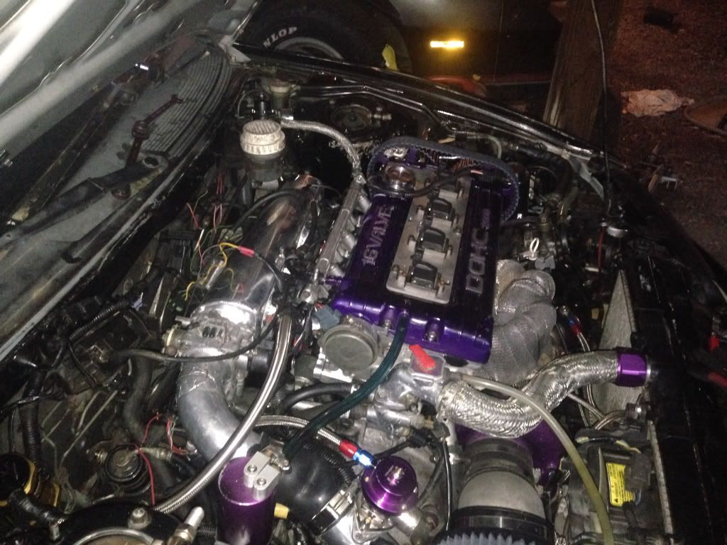

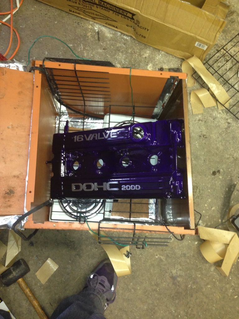

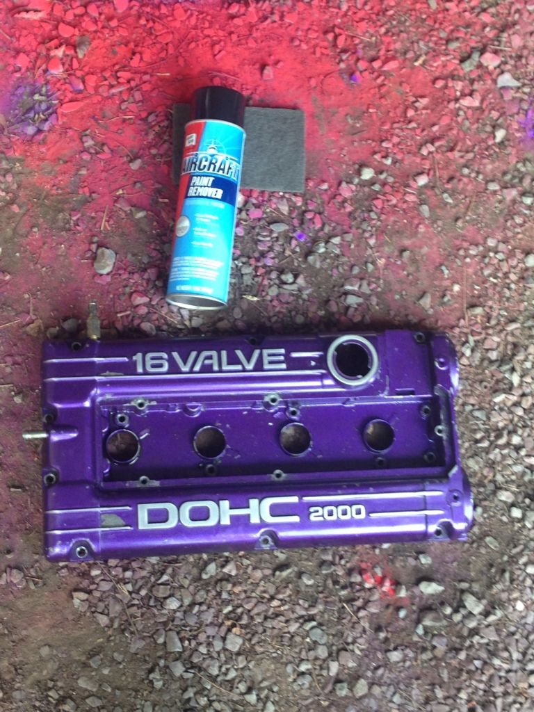

I decided to try my hand at powder coating. I coated my VC, fuel rail, Intake manifold, and throttle body.
VC Before:
During:
After:

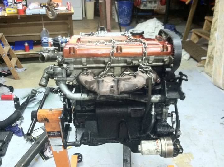

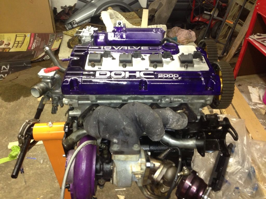

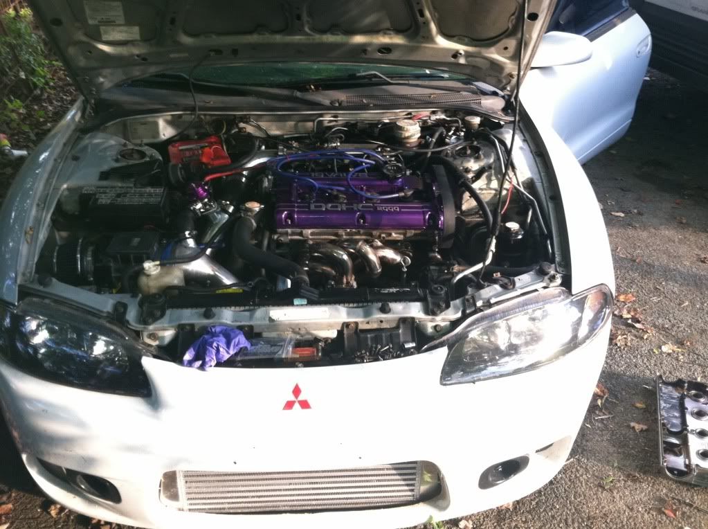

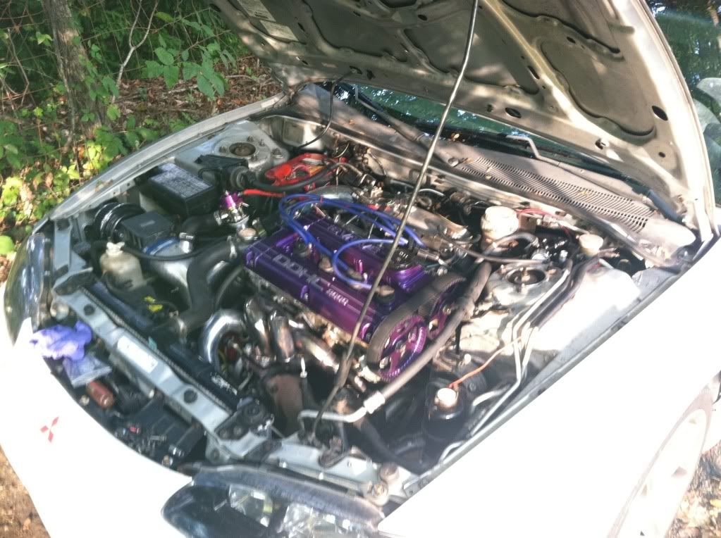

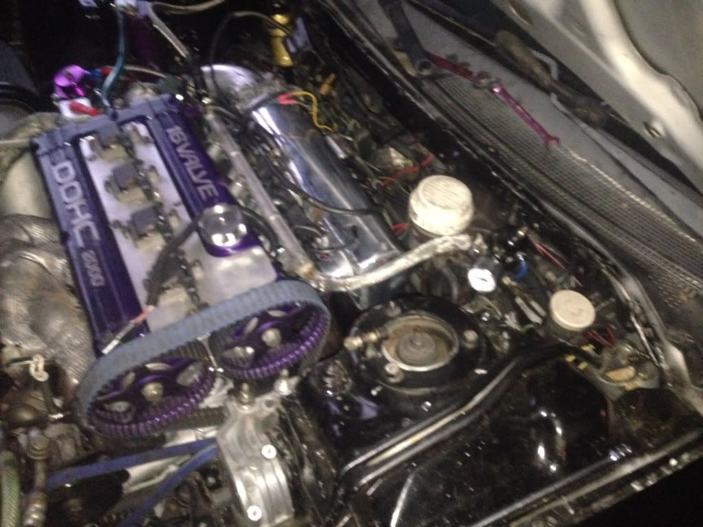

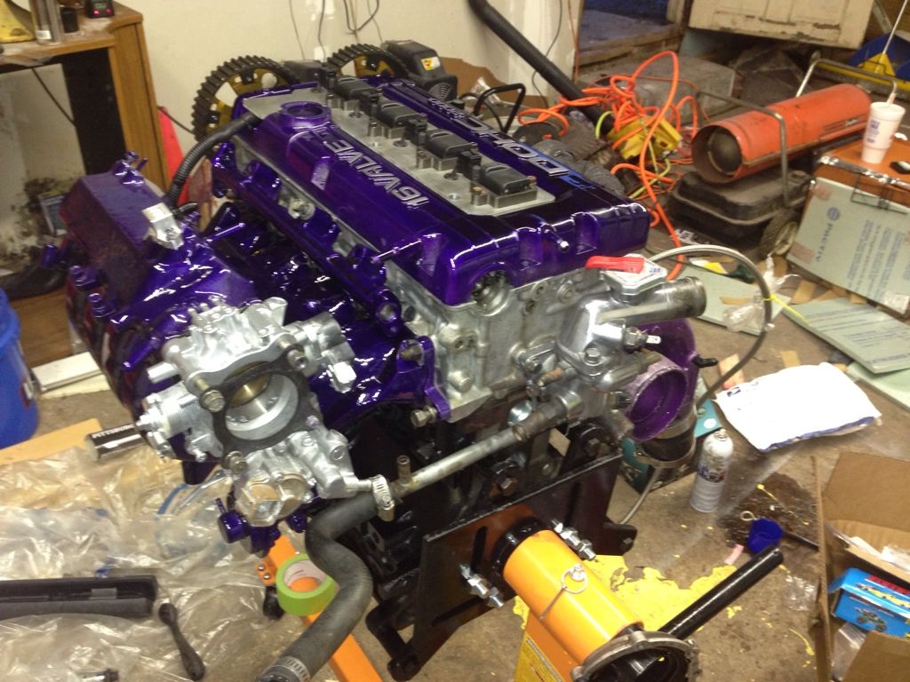

I started assemling the rest of the engine today got the head torqued down, water pu,p. water pipe, thermostat housing, Exhaust mani with turbo, and the intake. After that I was tired and was done so I sat the VC on the head for a couple pics to see if the powder coat was worth it.
I think it was LOL.
Tomorrow I plan to do at least the oil pump, oil pan, bolt in the cams, VC. I might try to go ahead and time it. Then it should be ready to go.

1) The manifold the same color of the valve cover makes it look "overdone" this is just opinion. :)
2) If you got that block from someone else make sure to check all the clearances if you got it done for a shop same thing ask for clearances, a motor making power over stock obviously got to have a little more loose clearances.
3) The coil on plug if you don't have something to run it right like (MSD or Dynatek, you are better of with stock coils and plugs, i know it makes it look cleaner but the 11s are more exiting. :)

Thanks for the input and kind words. The manifold I can't decide if I like yet or not kinda do but kinda don't. I may end up taking the purple off and leaving the bonded chrome powder on it like the throttle body.
The shop gave me the Clearances on a build sheet I have to find.
The cop is mostly for looks LOL. I am planning on getting a msd off a guy I know just haven't decided yet.

Just an update: I finally got my car tuned over the weekend and made 418hp on 23 psi. The clutch started to go some we backed off the boost and ended the day at 388 hp at 15 psi all on pump gas. The torque is is at 332 to 11s is definitely achievable. Once the clutch is changed, we will up the boost to 25 psi and take it to the track.
