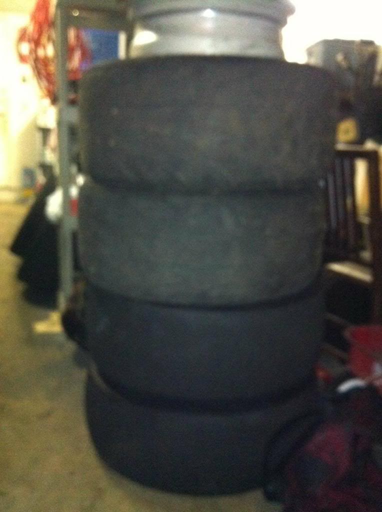

Here are my drag radials for the street and slicks for the track. Picture sucks though LOL

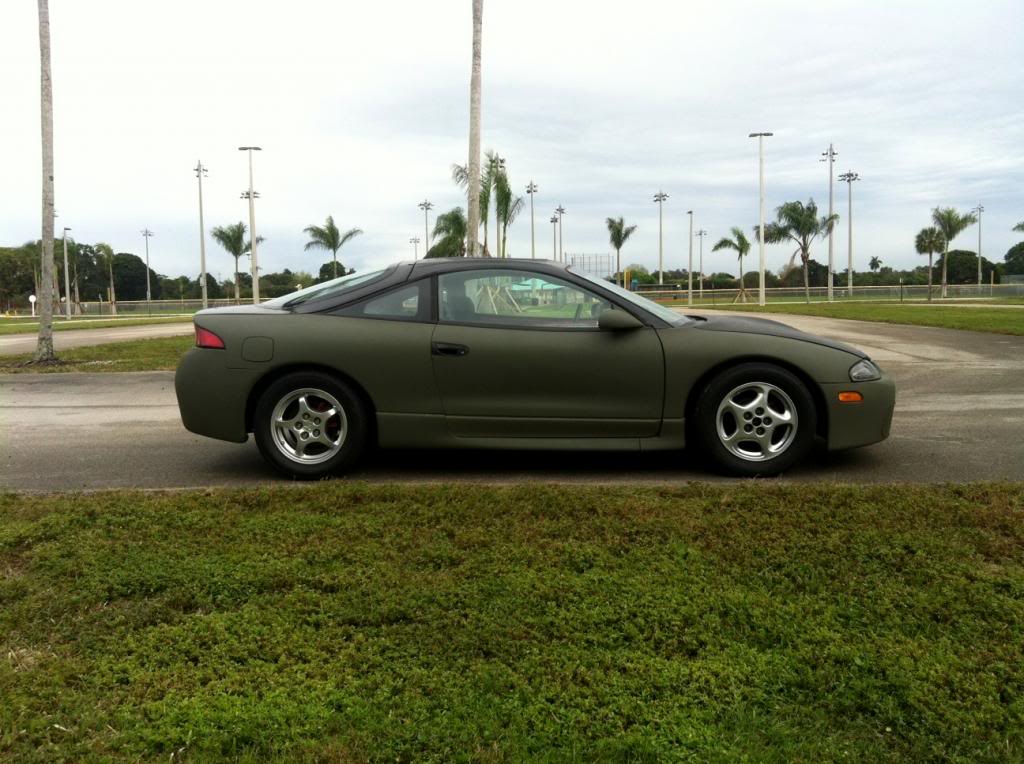

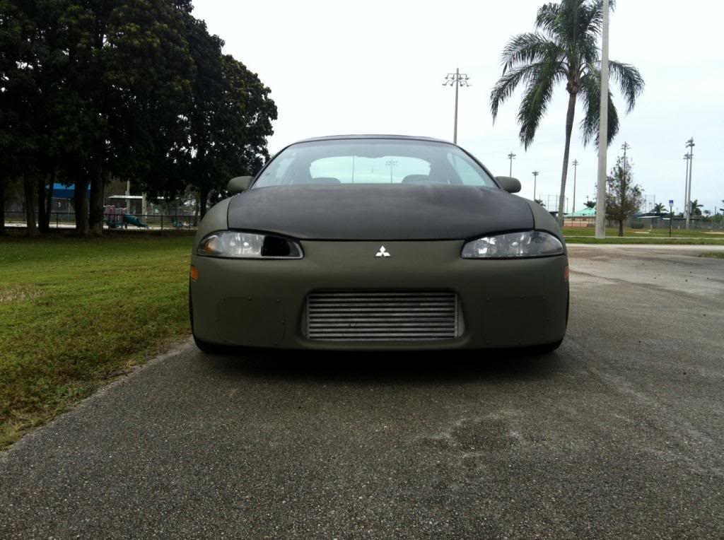

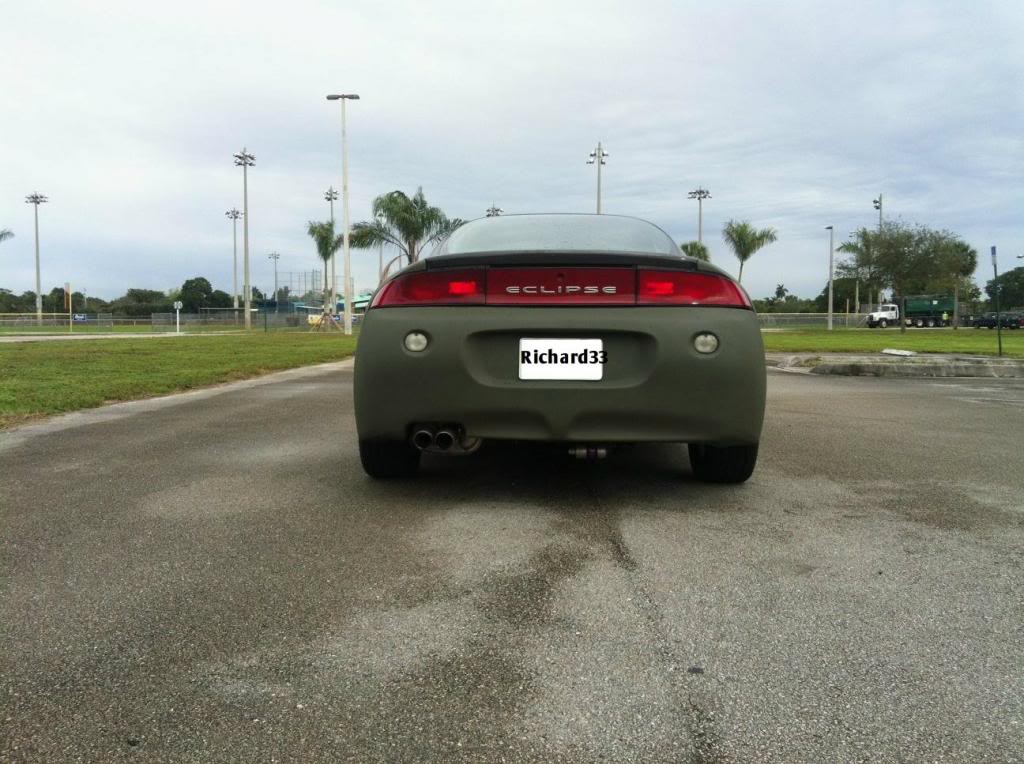

I finally painted the car. I hated red and my paint was in the worst shape since the PO got some cheap paint job. Here are some pics. Let me know what you think..
Wow, really liking that color. How soon until you're able to hit the track?
I've gone to two track events so far but they are not timed. They are Street Racing Made Safe events which is where you street race at a track pretty much. You can do digs all the way up to 60 rolls. I go to these things to hang out and mess with the boost curve, shift points, stuff like that so when I do go to our 1/4 track everything is dialed in except the launch. I will be going next wednesday or friday. I got a vacuum pump installed so I'm hoping that will hold the car back at the line.
Mean green looking nice...paint that fmic up for the super sleeper look
How can ya drive around on the steets with dr's do you just never hit boost ..haahaha
thanks. I don't like to beat on the car much on the street but it hooks from a 50 roll good enough with the boost turned down to about 30lbs.
It looks good, the green really makes the race car look/function appear. Must be that military color that gives it the edge of looking almost unstreetable race car vibe.

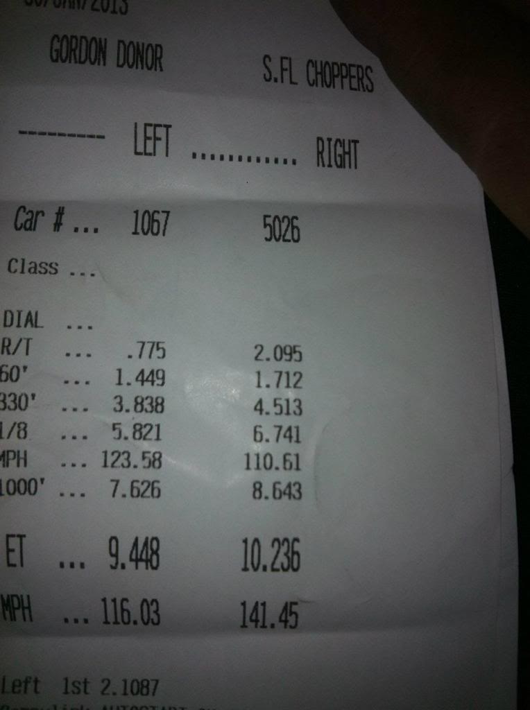

I finally made some decent passes down the track tonight. Went 10.95@138, 10.6@139, 10.5@141, and my last pass which was my best, 10.2@141. Im pretty excited since all I changed was the auto and picked up a bunch. I think there is more in it too with a better 60ft. I didn't spin at all so I think I can leave more aggressively.

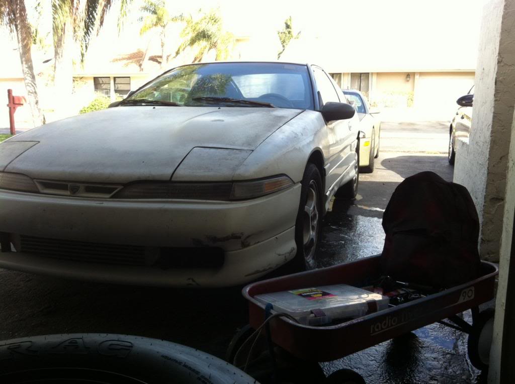

not bad for a car built out of my garage LOL. You can even see my tool cart. (A wagon)
