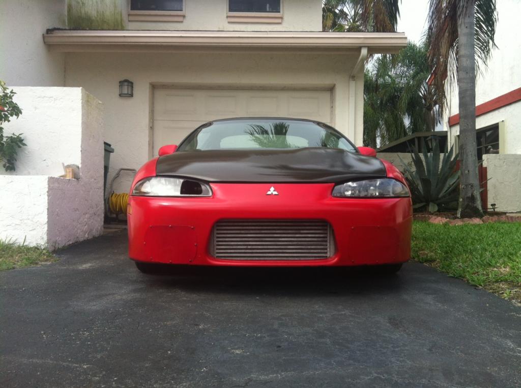

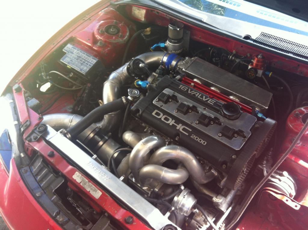

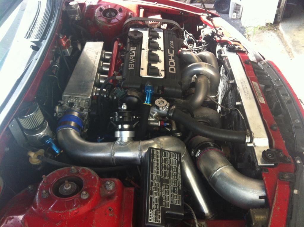

Here are some recent pics of the car.

Race car for sure:applause:
The engine bay looking clean, must wipe it down every time you drive it.
