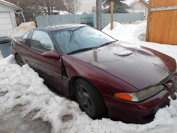

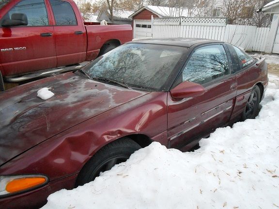

Brother picked this up 2 years ago ,1994 eagle talon fwd, fresh rebuild (had no proof) fmic , 3' exhaust , maft and maf , with bov, 16g,kyb gtr2 suspension ..Wouldn't go into gear $600 no body damage $300 for tow 3 hours away
Pulled the trans off found out the act clutch spring fell out and master was leaking (found out it had a n/t transmission)
Brother has me put in an center force dual friction clutch in, along with a master and slave ..Well that lasted 100kms , thats when the drivers fender got kicked a bunch of times ...Thats when i was given the car :hellyeah:
I then installed and act 2600 clutch , shortly after the break in ...I dumped the clutch for a launch ... :nono: no more clutch limped it home at 5km's
After that i ordered and act 6 puck unsprung race disk , paired that with the act 2600 pp and it held up :thumb:
Finally i decided it was time to start building a talon for the track and stop playing on the streets ,

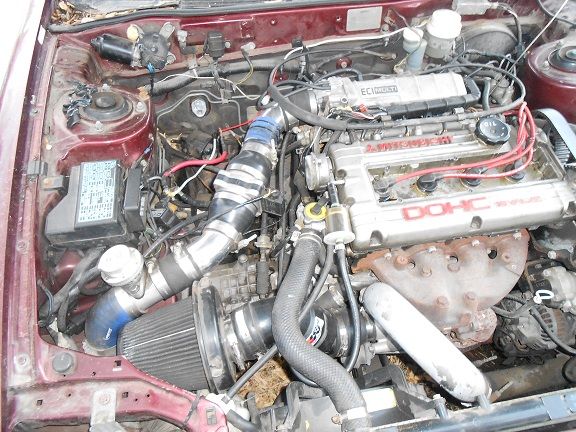

Winter time came , and i came across a hx35 :hmm: picked it up and decided to upgrade all over winter
Bought
valve cover and new valve cover gasket hx35 , rc 1600 cc injectors ,Turbonetics T3 Cast Exhaust Manifold (real not the ebay knock offs) ---Pics of all will come soon
Next to buy
innovative lc-2 , 38mm TiAL F38 wastegate. , new mbc , afpr ,qtp slicks , and get an 02 housing fabbed to exhaust
Quick post to this
Installed manifold and hx35 , had to dent the water pipe some ..Pulled it off found a friend of a friend to port the hx35 and sand blast it ,..just waiting for that to be done at the end of the week
Also picked up the hx35 5 bolt - dsm flange 02 housing , 38mm waste gate , 4 an oil feed from ofh and fittings,some high temp heat wrap for the 4an oil feed line , hx35 flange and 10an 45 degree push flange and high temp hose for it ..And a fpr :hellyeah: pics will come soon
All that is left is a 4" filter , 4" boost leak tester ,..Of course some slicks and crank the boost and get it tuned
