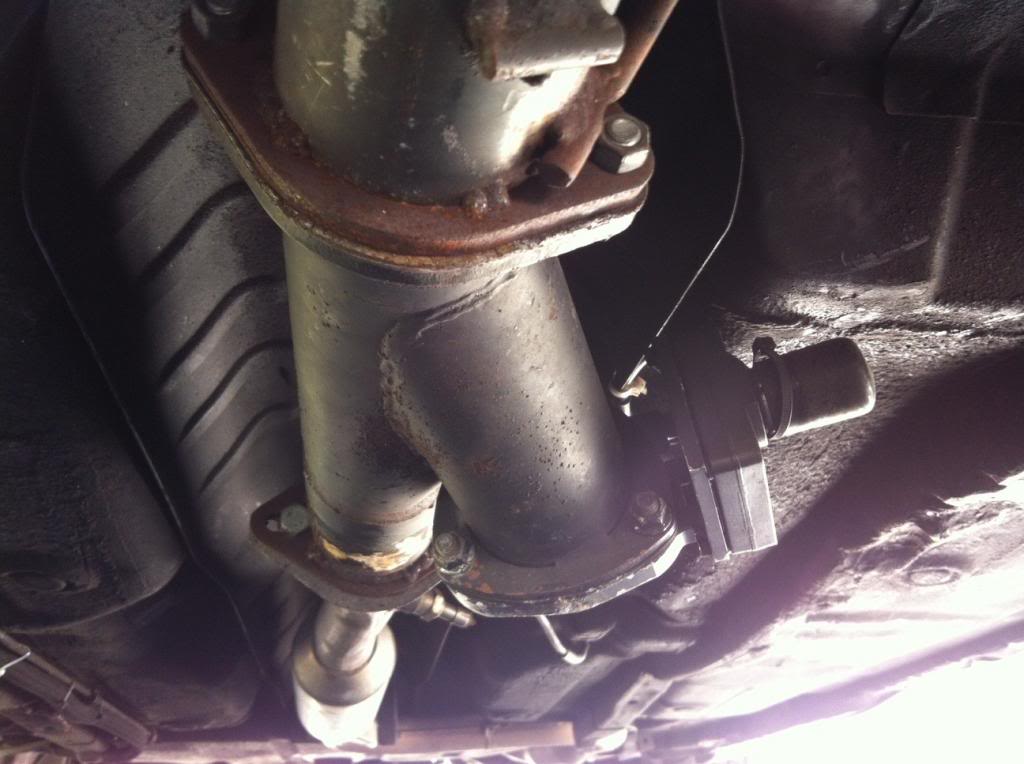

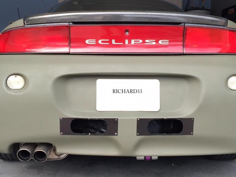

Is this on a stock EXHAUST? WTF
Ya it's the stock catback. But I have a 3in downpipe connected to a 3in e-cutout. I like driving the car around on nice days or to meets and open downpipe got really annoying. My neighbors didn't like it either LOL

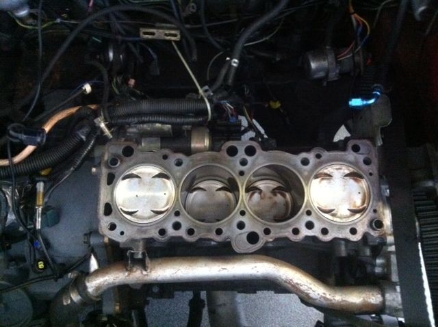

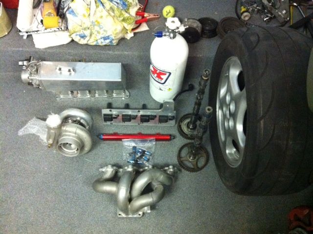

update! Finally I'm home and have been working on the car again. I got the head off to change the head gasket since last time out it was pushing a little bit on high boost. I also got my turbo rebuilt by jusmx, my shift box upgraded by forcedfour, and hawk hp plus brake pads installed. With these brake pads, my audi vacuum pump, and one other thing the car should stay at the line for days. Here's some pics of my parts out for the head gasket job and how my pistons look after about 5k miles and a quick wipe down.
Car is ready to go. It made 620whp at 34lbs Thursday when I brought it in to check the tune and sync the timing. Its running great with no issues. I am going to get the car ready for this weekend now FL2k13.com. It should be fun running the 10.5 index class. After the event if the car makes it out alive, Ill go back to the track for that single digit pass.

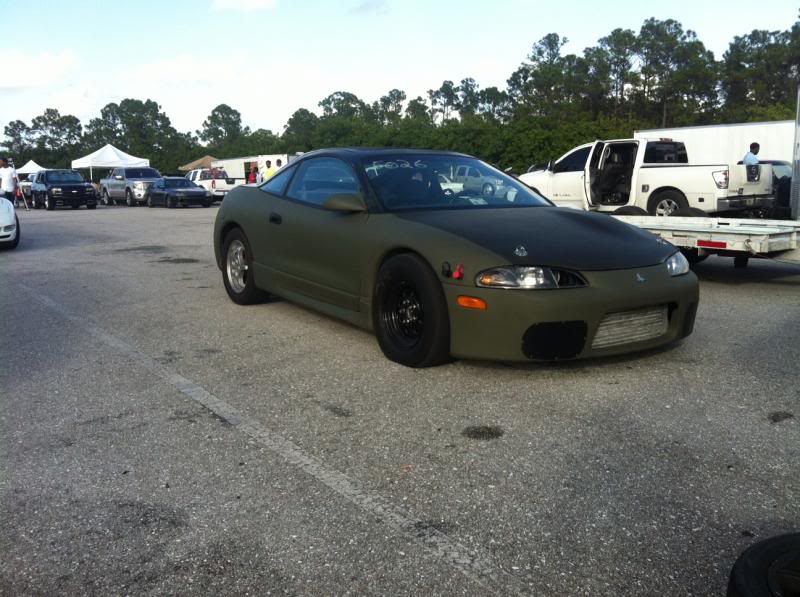

I just got home from FL2k13 in Bradebton FL. I signed up for the 10.5 index class to have some fun. My first testing pass I didnt touch anything just to see where it was at. Well, I ended up cutting my best 60' of 1.65, my best 1/8 of 6.62 and would have been a new best e.t. if it werent for the intercooler pipe that popped off. I hit the brakes and ended the run with a 10.4@111. Next pass I turned the boost down to 29lbs to try to get close to 10.50. I still went too fast with a 10.3@138. I was getting nervous cause the wastegate is 25lbs! I got up on the converter and got on the beams for my last pass. Right before I let off the brake the axle broke ending my day. Im pretty excited now because I know the car has 9s in it for sure.
I havent updated my page in a while! Ive been on the pursuit of that single digit pass for a couple months now. I was breaking passenger axles everytime out so I contacted CVJ axles (CVJ Axles - Remanufactured Axles & Power Racks) to build me some axles that will work. I also got a restalled converter from here- Florida Torque Converter I also had a dynatek arc 2 box start to fail on me last time out. I hopefully got all the issues squared away and it should be ready to rock. We are having some nice weather down here in South Florida so it should make for some good track conditions. In the 40s even!
The car is still running strong with the hx40 turbo and eagle/wiesco shortblock. The ATFspeed.com trans is still shifting as well LOL.

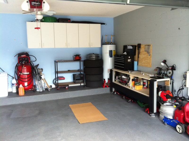

My new garage with plenty of room to work the car now. No more drive way building LOL

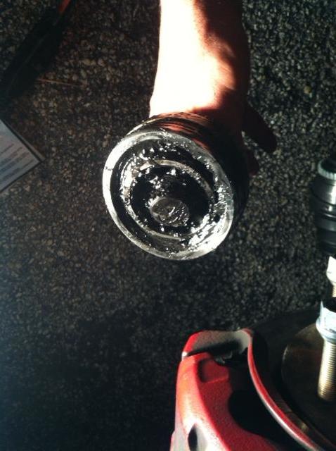

One of the axles I broke on the stall
