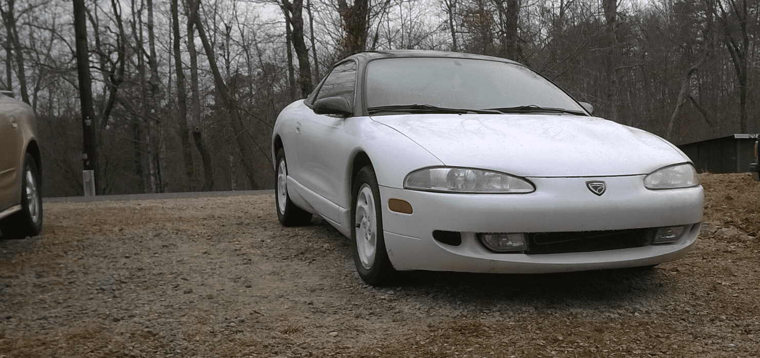

So I've been kicking around the idea of picking up another DSM if I found one within my price range. Well it just so happens that a guy on a local car page on Facebook posted the car up for sale a few weeks back. I messaged him and offered him an old rifle, a welder, and a little cash for the car. After playing the waiting game, he replied yesterday afternoon, and my father-in-law and I went and picked it up last night.
I'm the 3rd owner, 4th if you count the guy that bought it just to fix and sell it. It just so happens that the car was fixed by a friend of mine earlier this year, and put up for sale around June. At that time there was no way I could afford it, but 6 months down the road, it's sitting in my driveway, haha.

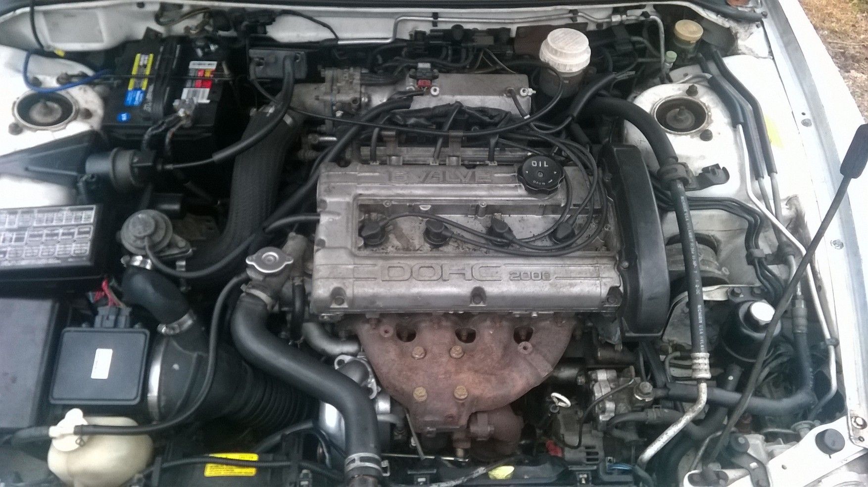

The car is 90% stock. It has an eBay 16g and a 1G BOV on the OEM 2G piping. It's sitting at 153,xxx miles right now, but it has a rod knock... Other than that, it still has the original privacy cover and cargo net!
A little back story; I picked up a 1995 Eclipse GSX rolling shell back in 2011. I've been collecting parts for that car for the past 3 years, and have just about everything (and I mean everything) to get it put back together. So the plan is to assemble the engine I have for the GSX and swap it out with the knocking motor that's currently in the Talon. As long as all goes to plan and the engine is running well after the break-in period, I will pull it back out of the Talon, and drop it into the Eclipse. In the meantime, I plan on having the Talon's original motor pulled apart, and all needed machine work done.
I'm going to tear into the car on Monday, and I'll snap some more pictures then. Until next time guys, peace.

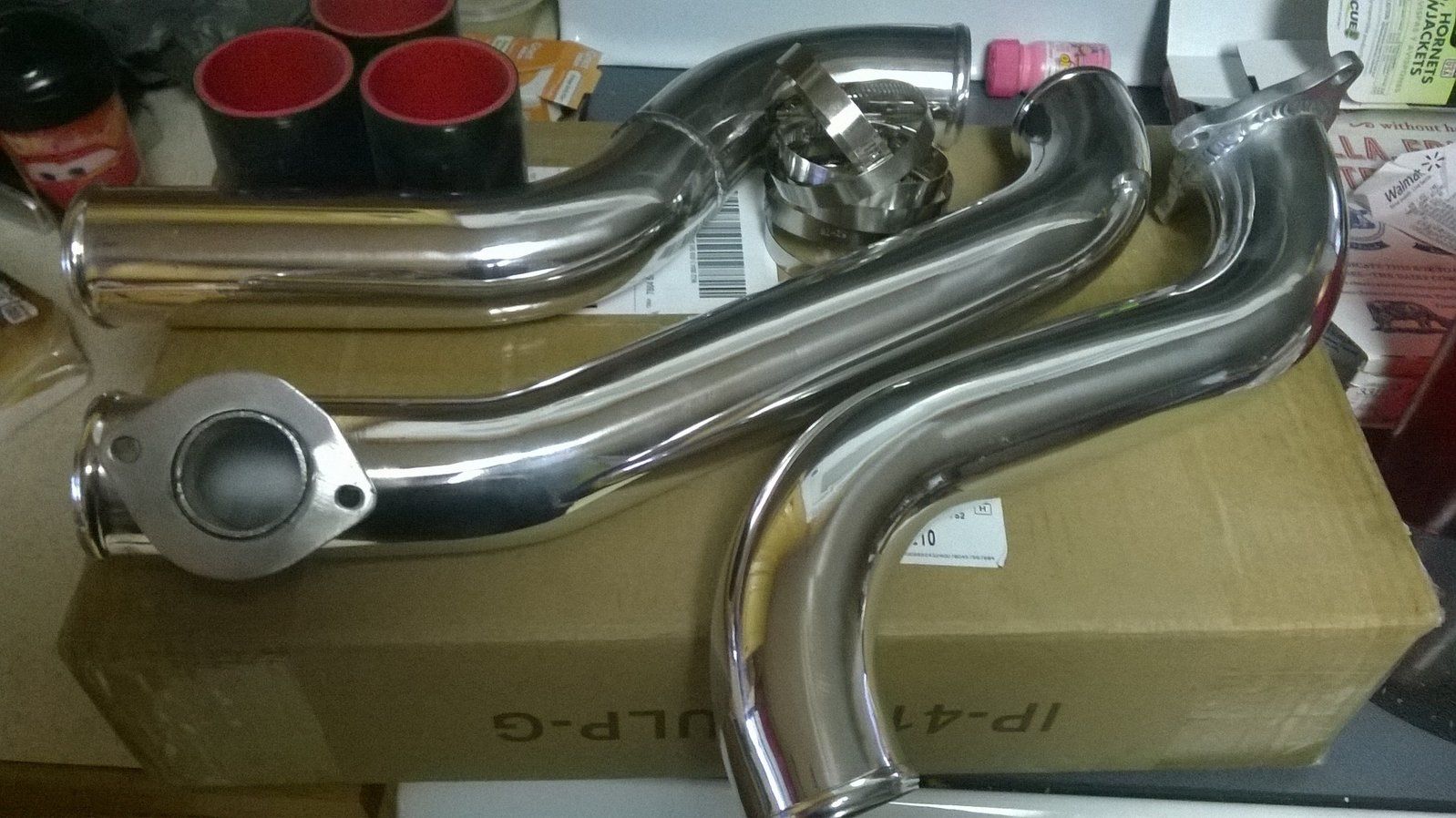

Not much at all has changed with the car besides ordering some parts. I bought an SRS stainless downpipe, a set of ST Suspensions lowering springs, and replacement OEM radio harness. One of the previous owners cut off the original plug to install an aftermarket CD player instead of buying one of the adapters... Why must people do such stupid things? Anyways, until next time, peace!

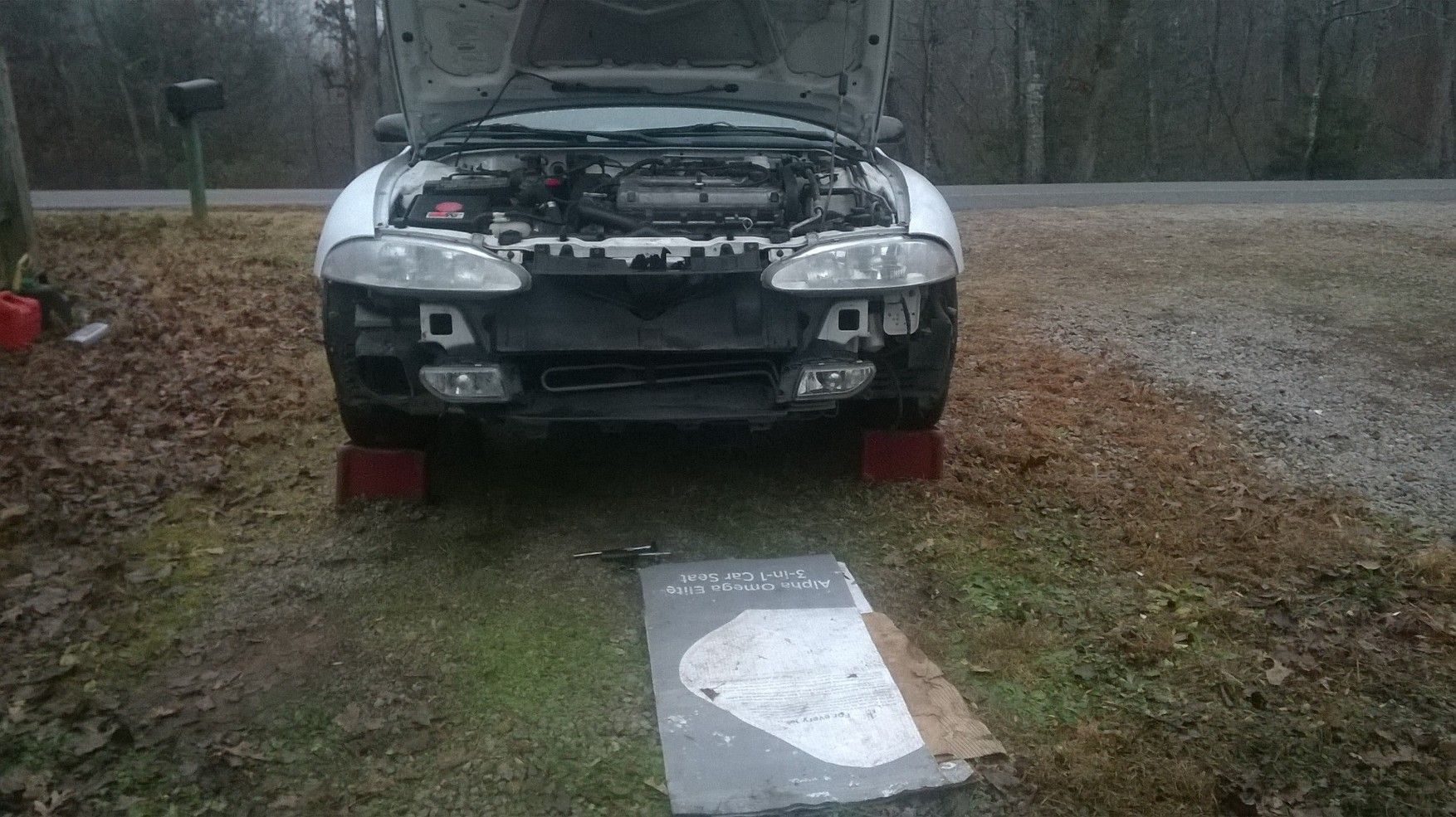

In all honesty, not much has taken place in the last month. I've got everything pulled out from the drivers side front suspension, and in doing that I've discovered a bunch of parts that need to be replaced. But as my wife keeps pointing out, it's a 20 year old car that nothing has ever been changed on, and things are bound to be worn out. I haven't touched any other part of the suspension besides the drivers side, and so far I need an ABS sensor, axle, lower lateral arm, shock, shock mount, shock insulator, tie rod end link, sway bar link, ball joint boots (the ball joints are fine, I tore them myself), brake dust shield, wheel hub, and the bolt that mounts the shock fork to the lower lateral arm... So my quick project is turning into a bit of a headache, but we'll see how it goes.
New parts arriving tomorrow are KYB Excel-G (GR-2) shocks and struts, KYB strut mounting kits, Moog tie rod ends, and Moog shock insulators. I still need two more insulators if any other side is as worn out as the drivers side. I've also picked up an SRS downpipe, Torque Solutions shift cable bushings, a new OEM timing belt, a carbon fiber shorty antenna, and an OEM Evo VIII/IX/X shift knob. I've also got a "slightly used" ABS sensor in the mail. And maybe one or two more things that I'm forgetting.
Anyways, I'm hoping to get the block and trans pulled out soon. I'm not sure on when though, we've got some really cold weather moving in, and no garage to work in. But hopefully I'll get a day above freezing soon and I'll get it out of the bay. Well, until next time guys, peace!

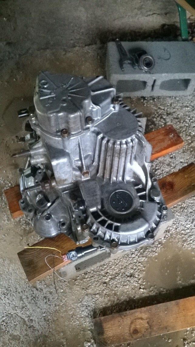

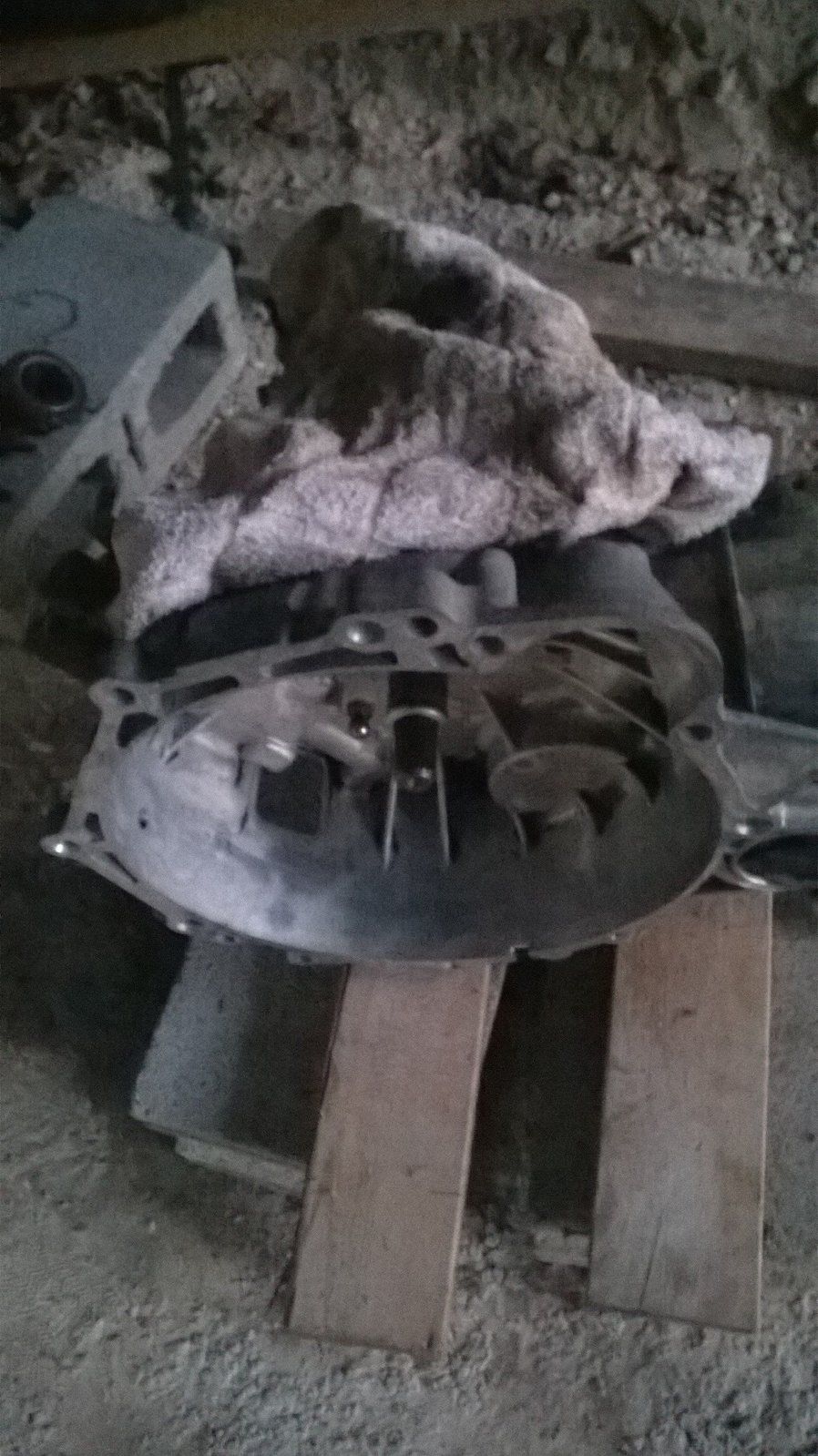

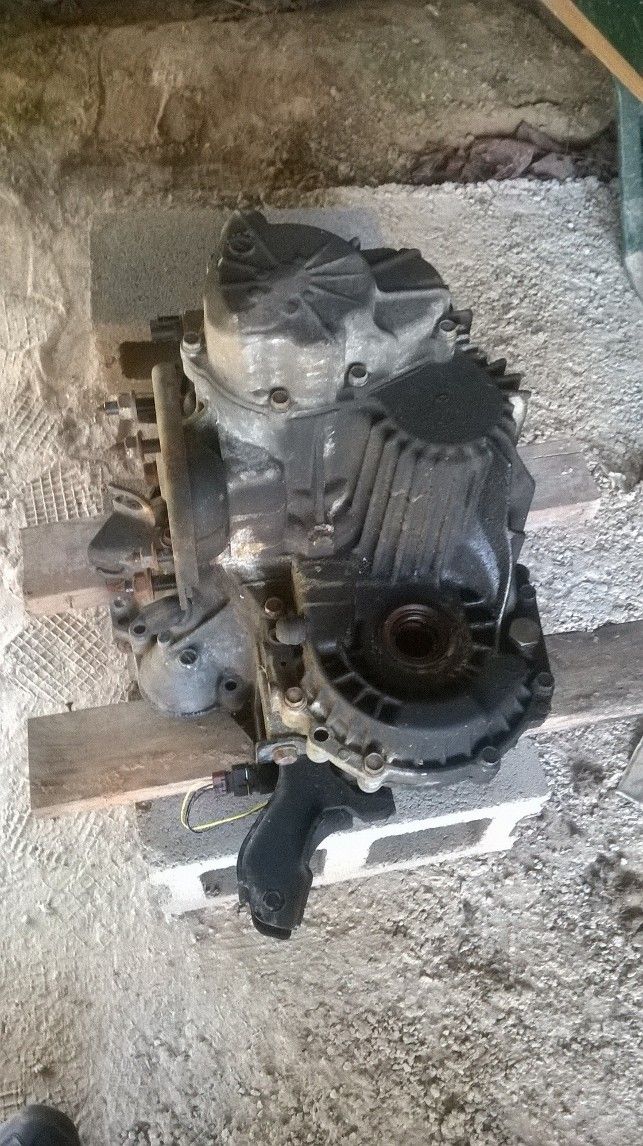

Other than the suspension, I've purchased a low mileage T25, aluminum SMIC piping, a Thermal R&D cat-back exhaust, transmission seals, and various small parts and gaskets. I also cleaned up my transmission a few days ago. The picture really doesn't depict how caked in grease and grime it was. So I found some plugs the same diameter as axle seals, and went to work with some purple power and a pressure washer. I'm extremely happy with how it turned out. I also took my head to a local machine shop and had them lap the valves, and install my new BC valve springs. So I'm hoping to get the head put together any day now. Then I'm going to move onto the block. Until next time guys, peace!
