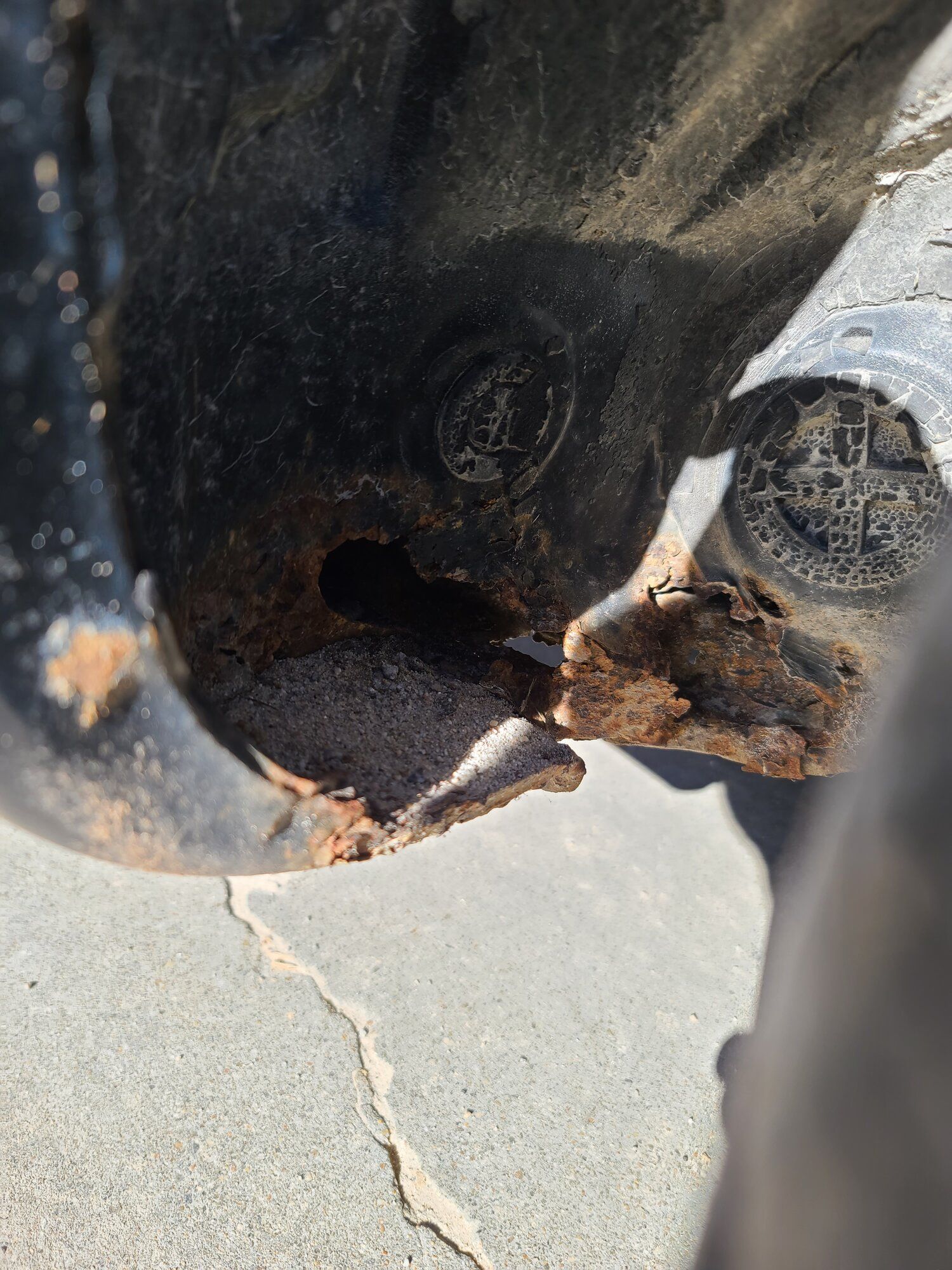

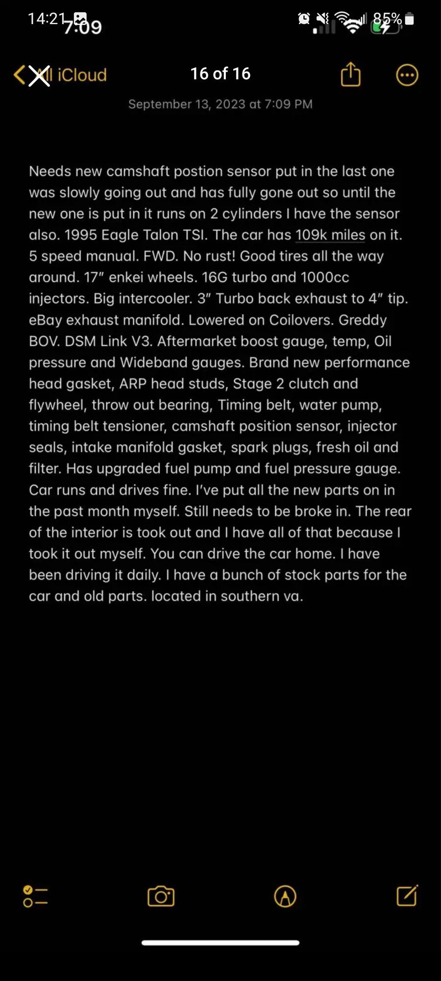

I had seen the listing on Facebook marketplace which claimed "NO RUST" and "CAR RUNS AND DRIVES FINE" for a FWD TSI. The car had to be pushed downhill...onto the trailer as it wouldn't start. =) Off to a good start.

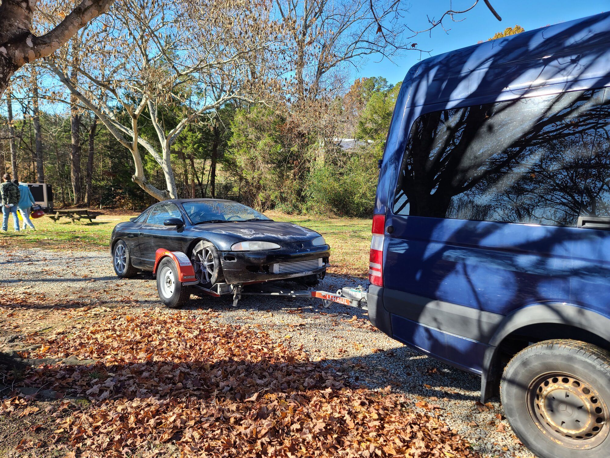

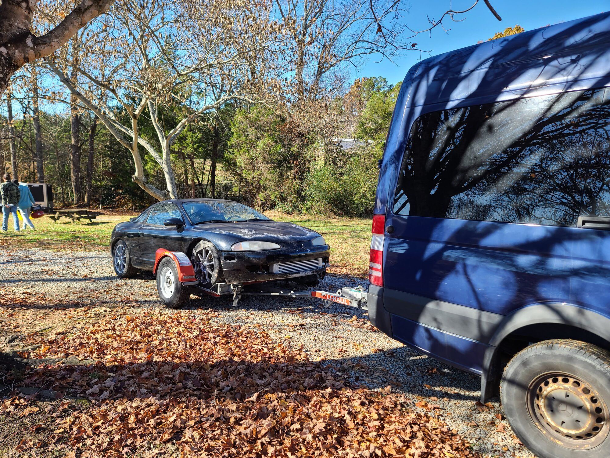

Here is a picture of the Talon hitched up to our Sprinter for the ride back to Canada.

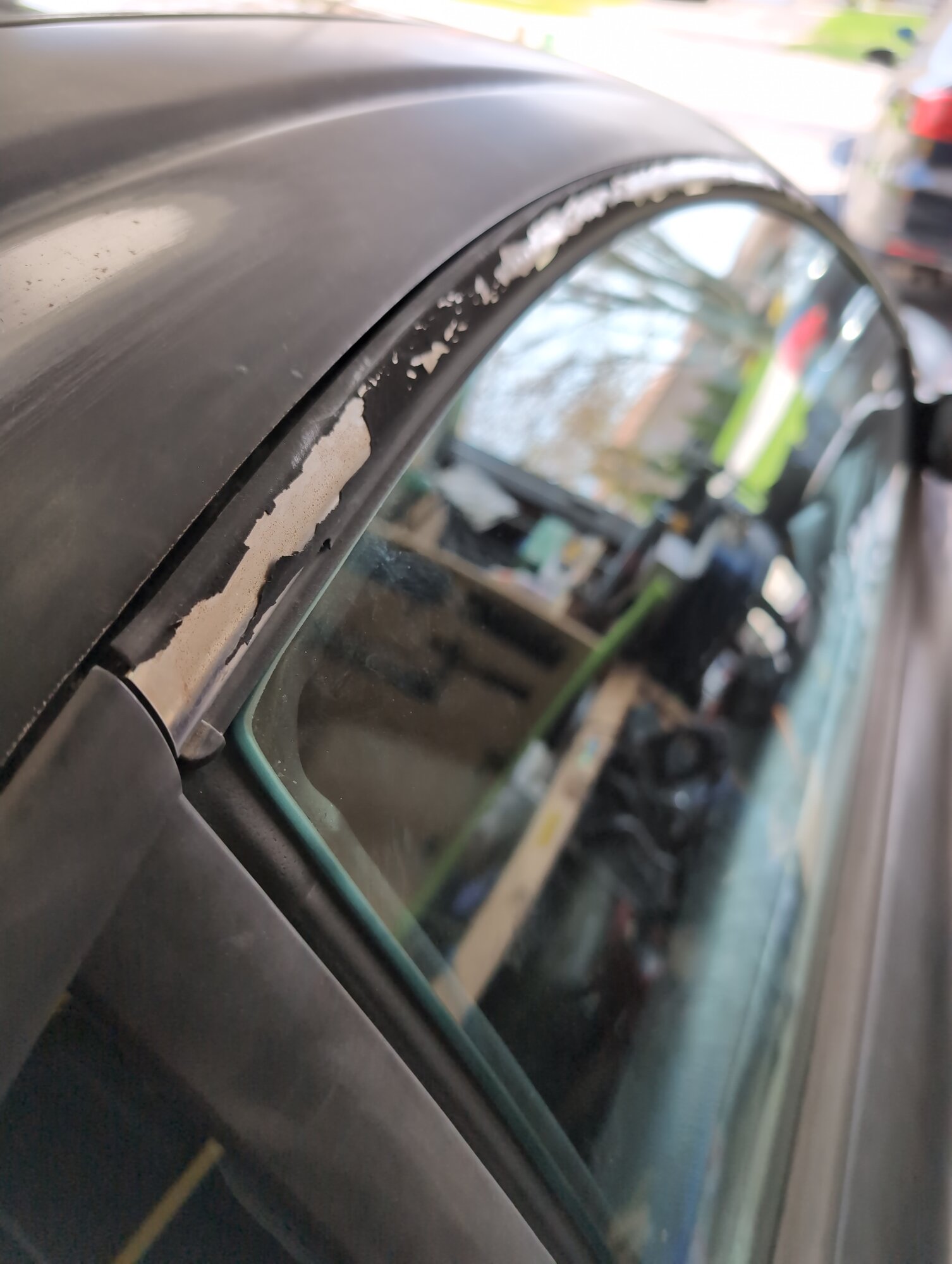

"NO RUST"
I had used a customs broker to help with exporting the car from the United States and importing into Canada to hopefully mediate/mitigate any issues we may have. Not sure I can post links, but I used clearit dot ca, and the process went relatively smoothly. We offloaded the car onto the street, as we (my father, the neighbour and myself) could not push the car up the driveway.

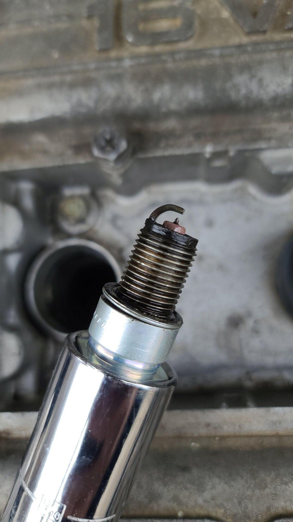

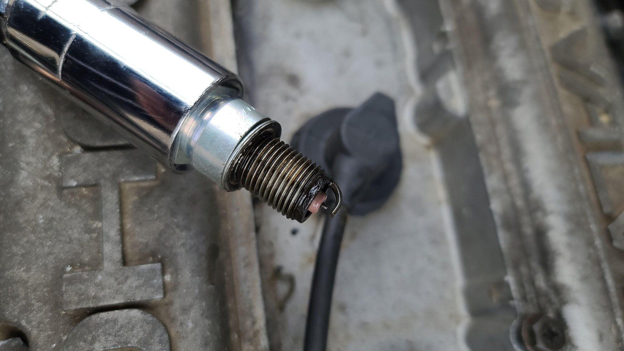

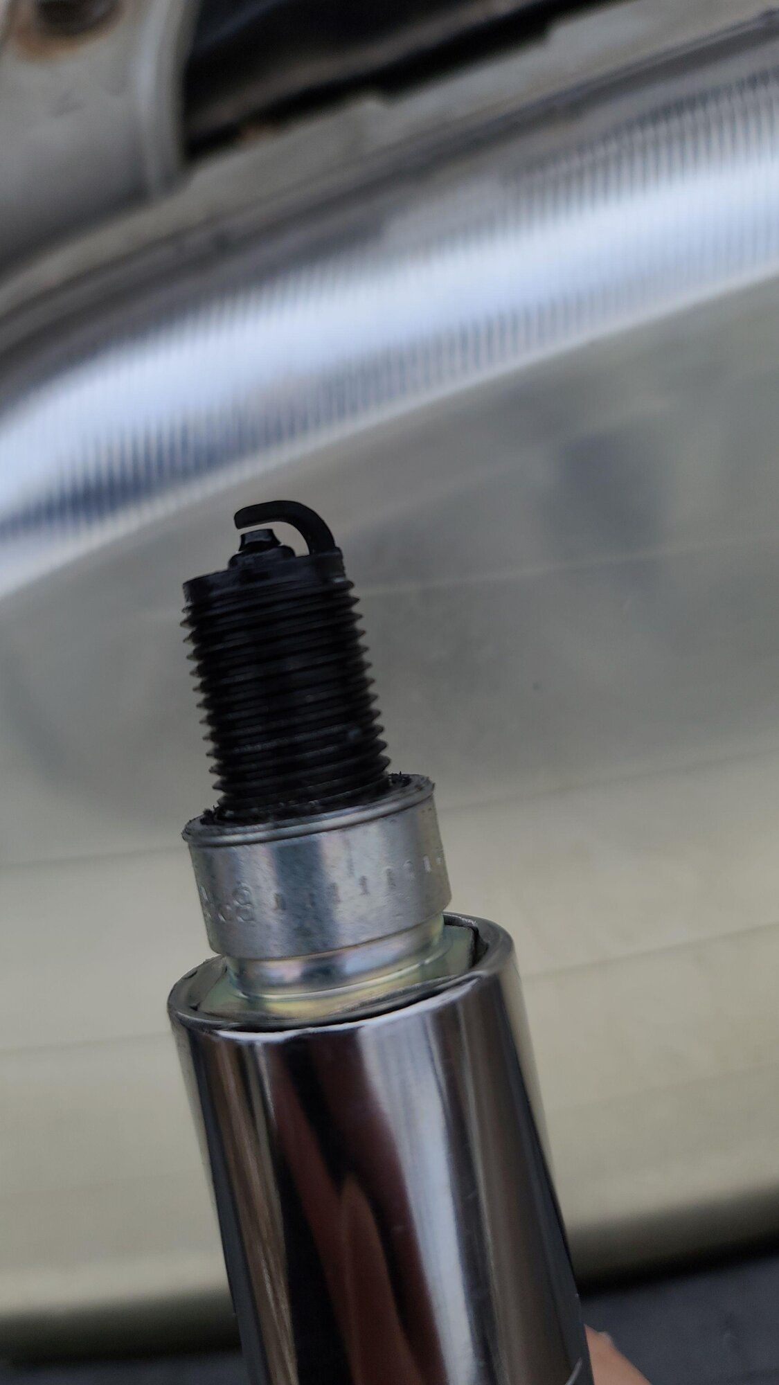

Check out these spark plugs... Some copper, some iridium, the gaps were all different and the spark temp ratings were all different as well. What the heck?!

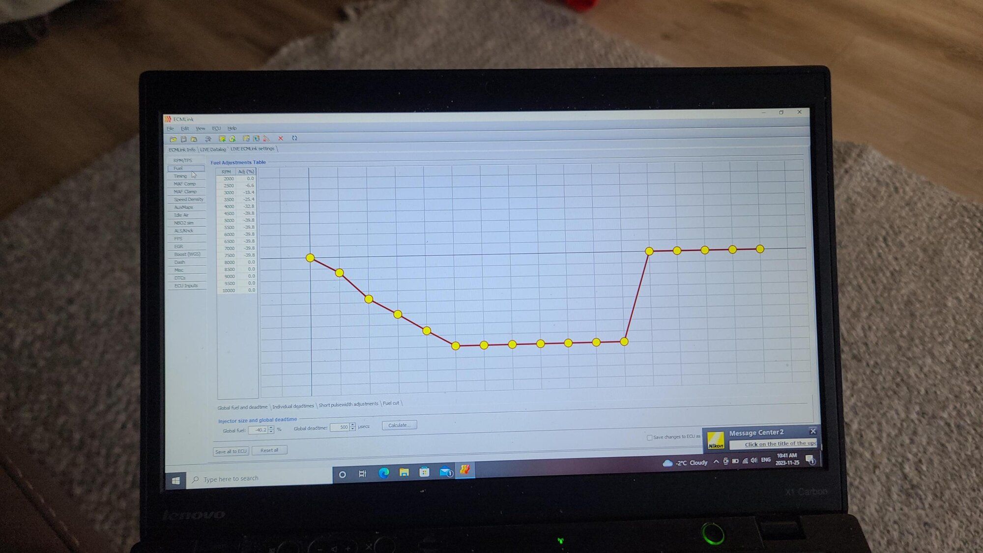

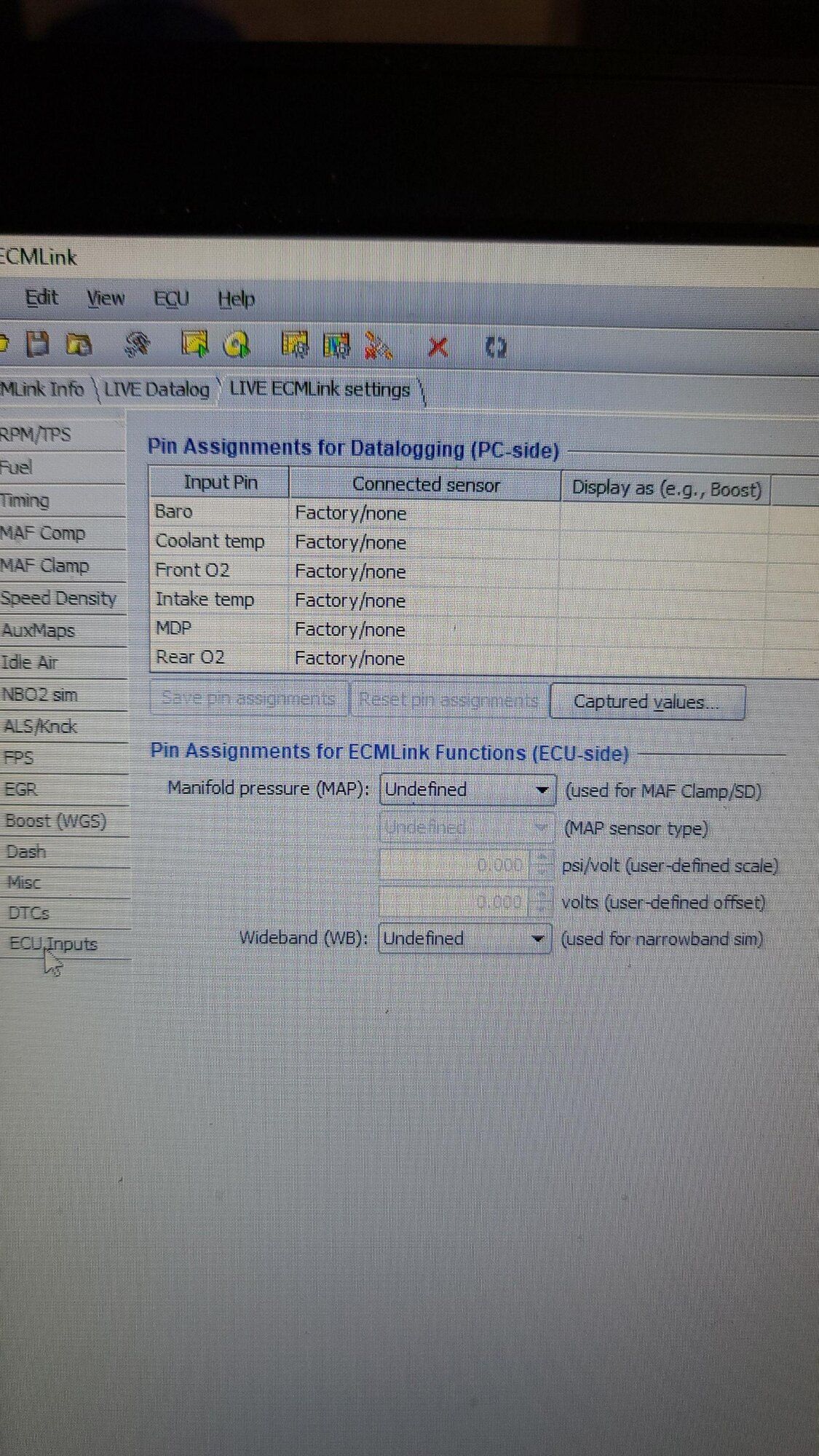

OK, so I replaced them with a set of NGK bpr7es, and I connected my laptop to the car to see what ECM Link could tell me...wait what?
I verified the serial numbers on the injectors were PTE/Delphi 1000cc injectors, but the previous owner had set them to 750cc, and then pulled up to 40% of fuel on the Fuel Adjustments Table. WHY!?
Also, he has an AEM wideband installed, but... not connected to the ECU for any logging. No wires to the ECU, and obviously no ECM Link configuration.

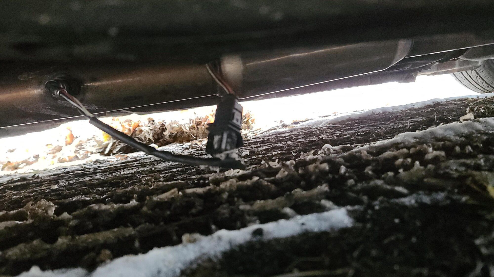

Speaking of the wideband sensor.. for whatever reason is way downstream...with it's wire, just dangling there.
After making the necessary adjustments to ECM Link, replacing the front o2 with a brand new one, and a new Cam Position Sensor (95/96)... we have life. Still needs A LOT of work, but the car runs, and has a healthy compression of 180 across all four cylinders!

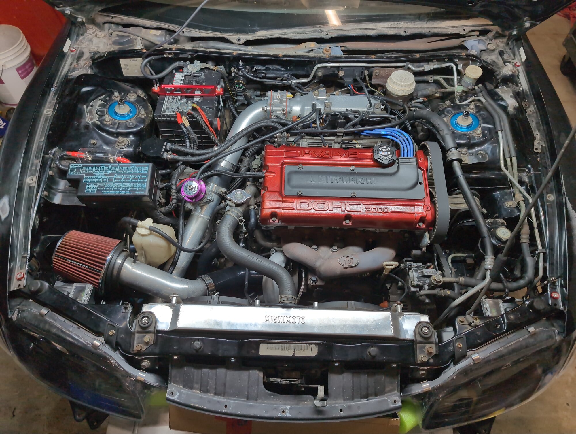

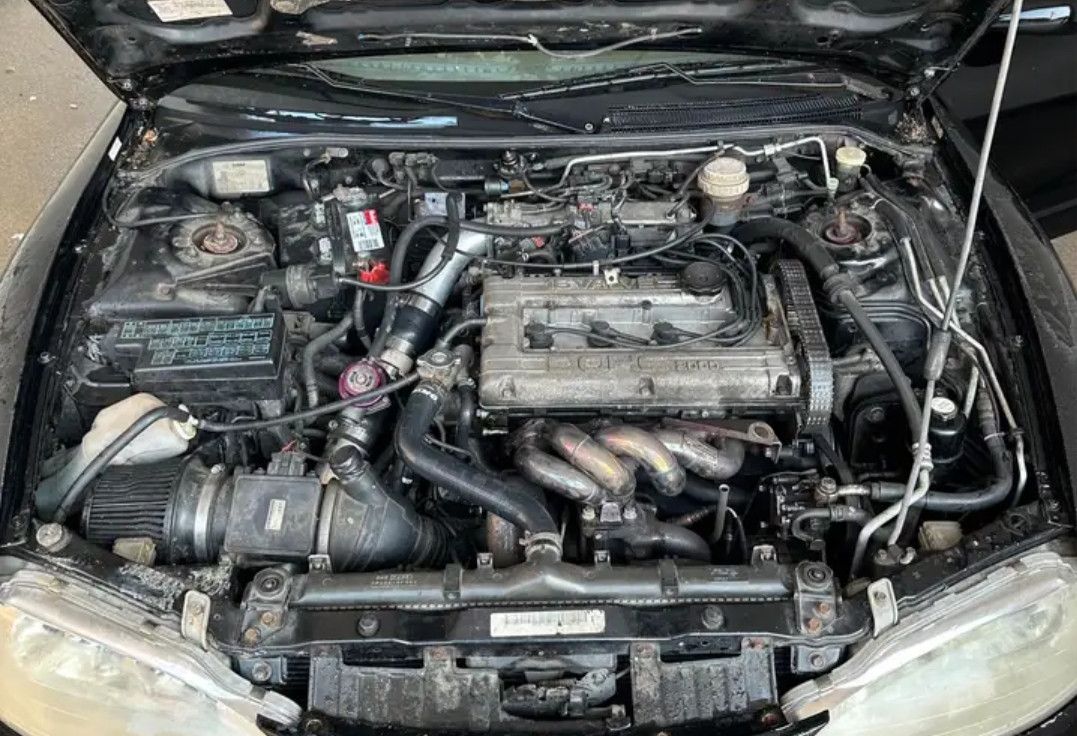

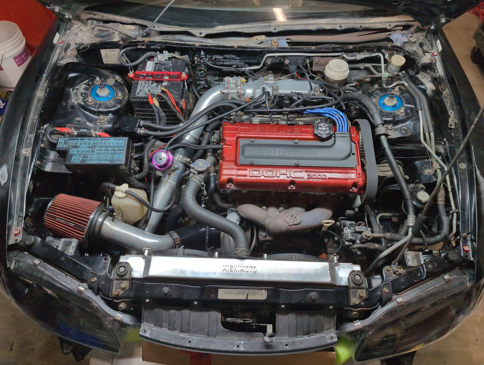

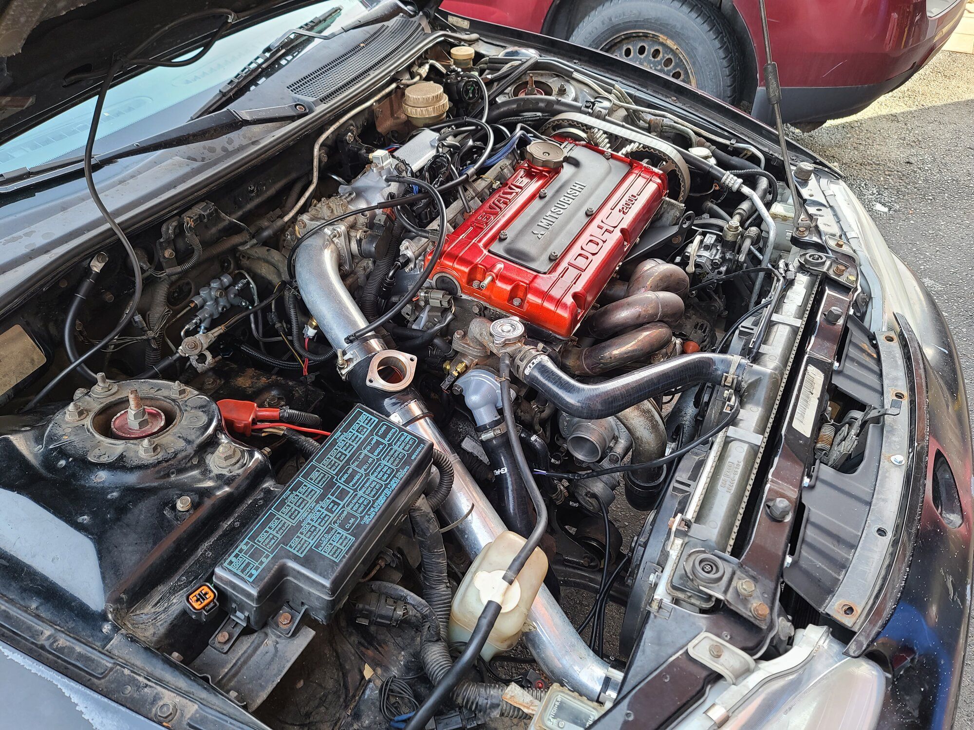

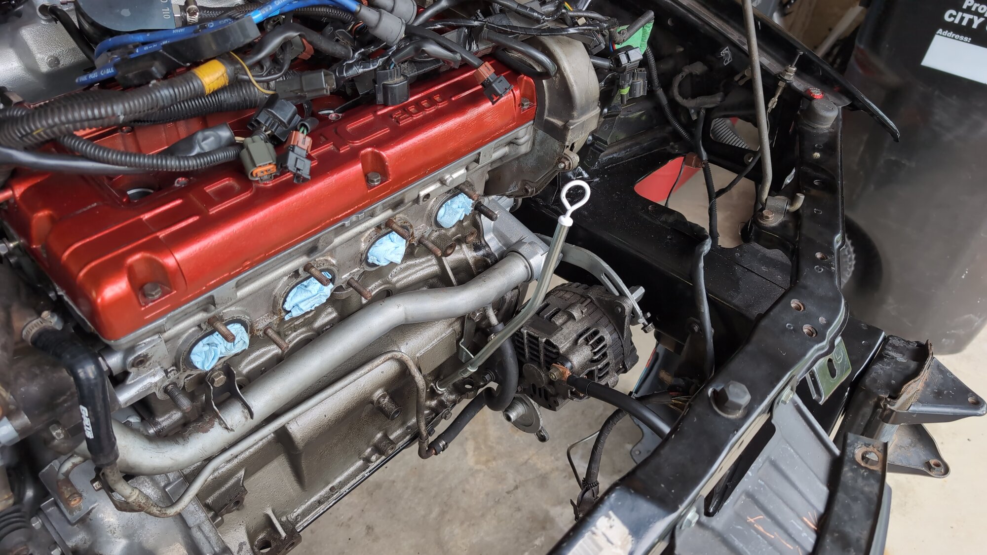

Here is a picture of the engine bay, from the listing. If you look closely you can see some PVC piping....(between the BOV and throttle body elbow) it's going to take a lot of love to restore this car to anywhere near where my old 98 Eclipse was.

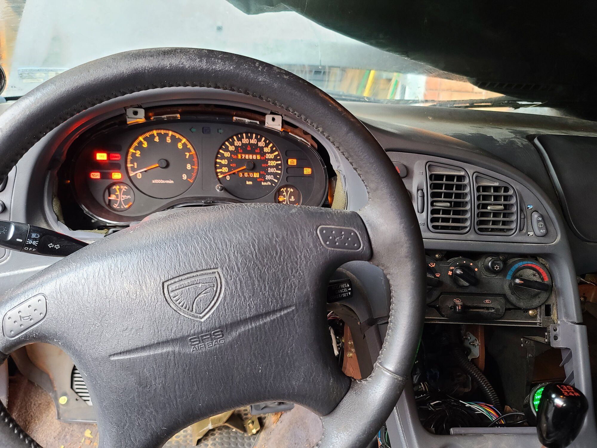

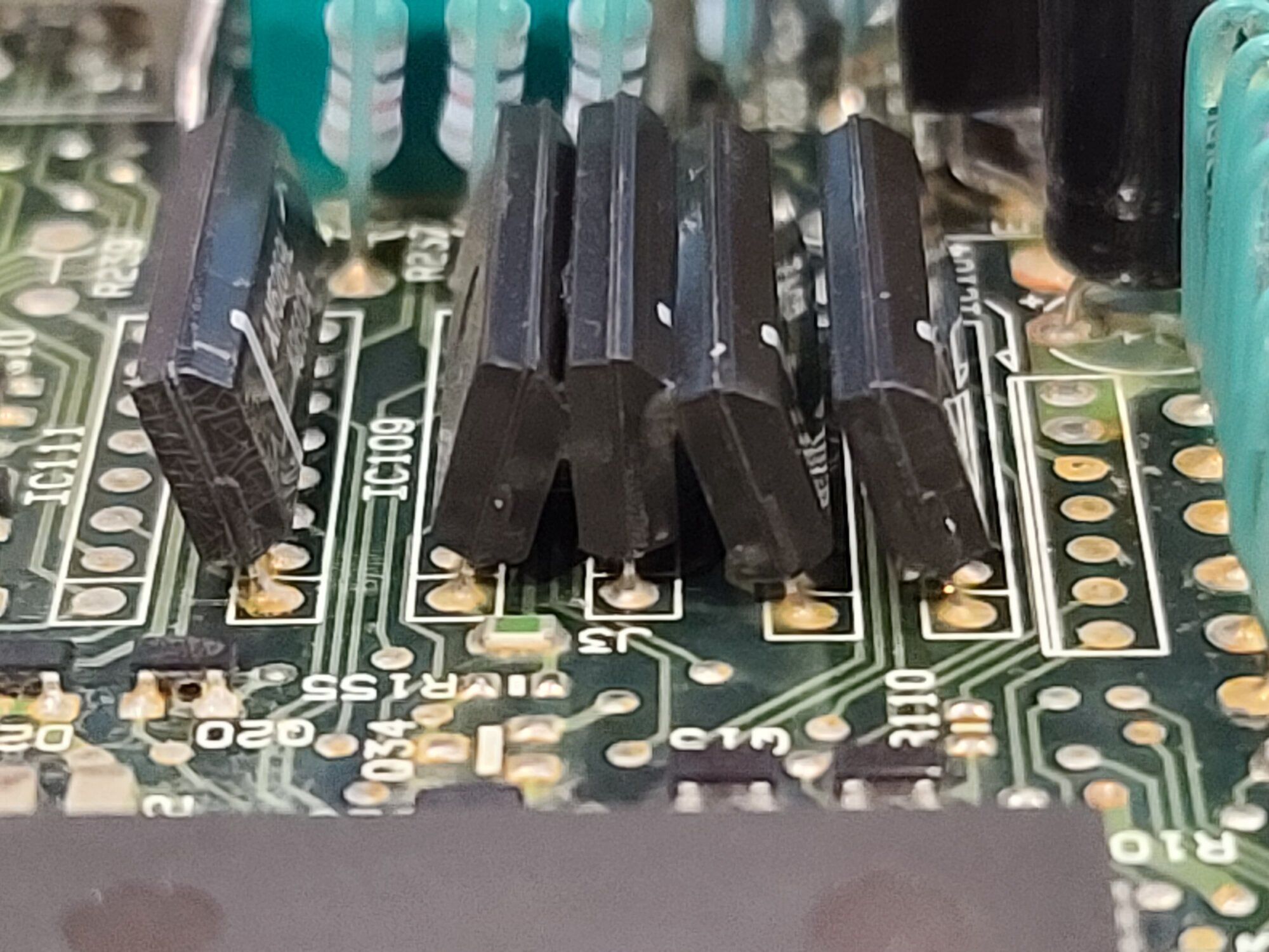

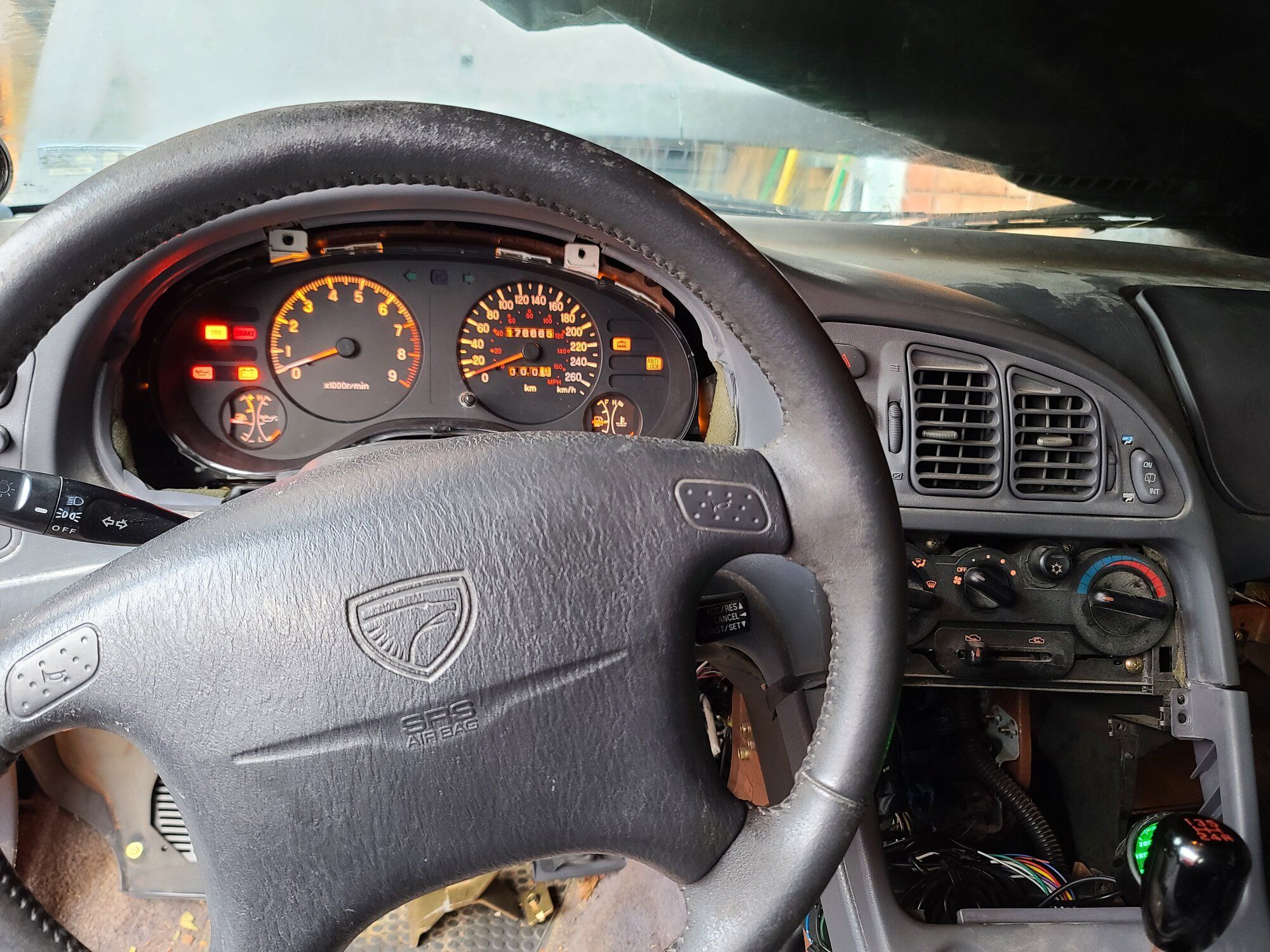

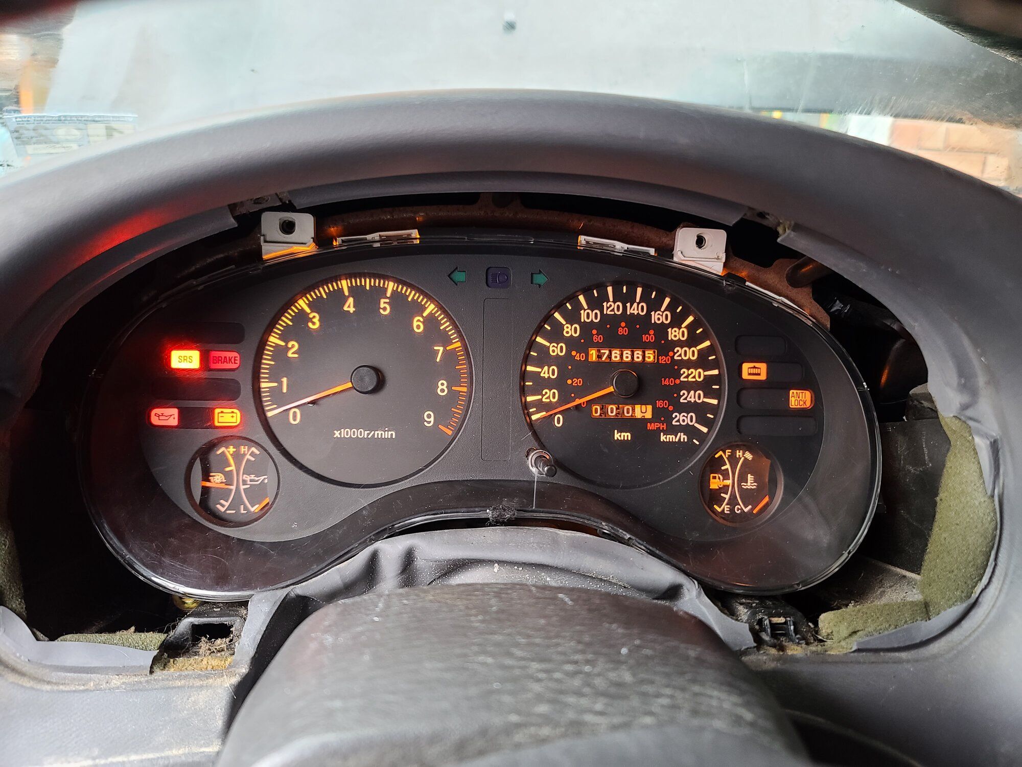

I had some cluster backlighting issues; to which I replaced the bulbs with leds, verified all fuses were in their right spots and not blown. I confirmed power and ground at the connectors on the behind the cluster, and ended up fixing one ground...but still, no backlight. Finally decided to try bypassing the dimmer switch, and we have light!
You may also notice it now reads in kilometers now... I had purchased a known working cluster, but it wouldn't work until I bypassed the dimmer. Took the speedo from that one and switched it into the Talon's instrument cluster.

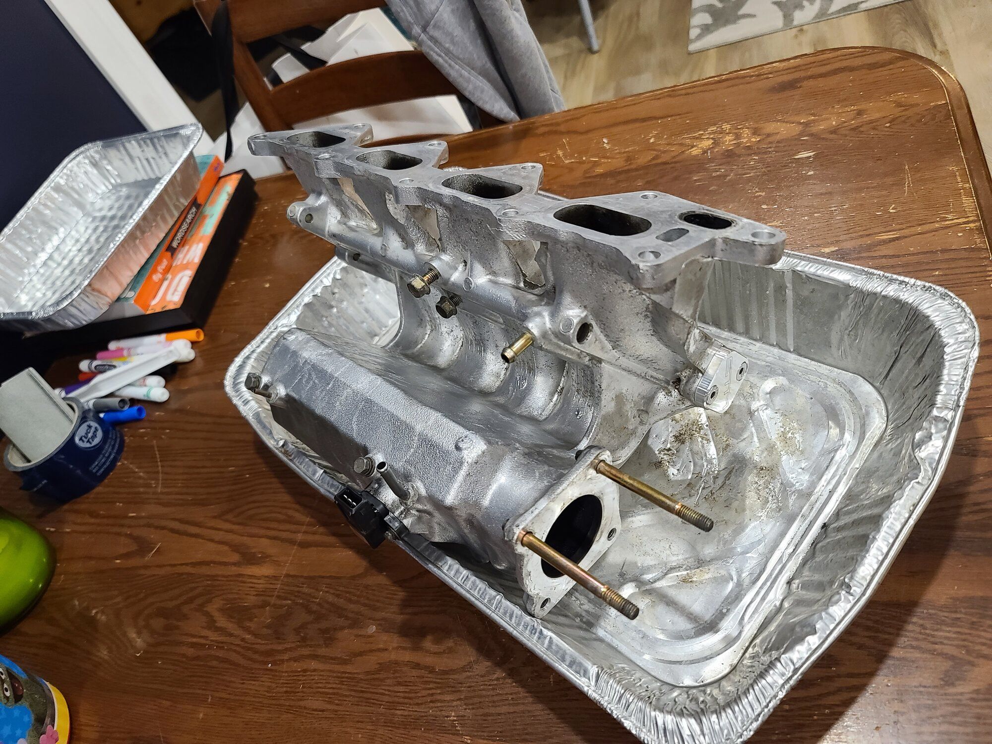

Might as well giver a bath in some degreaser and elbow grease. I might consider painting it, but haven't done so yet.

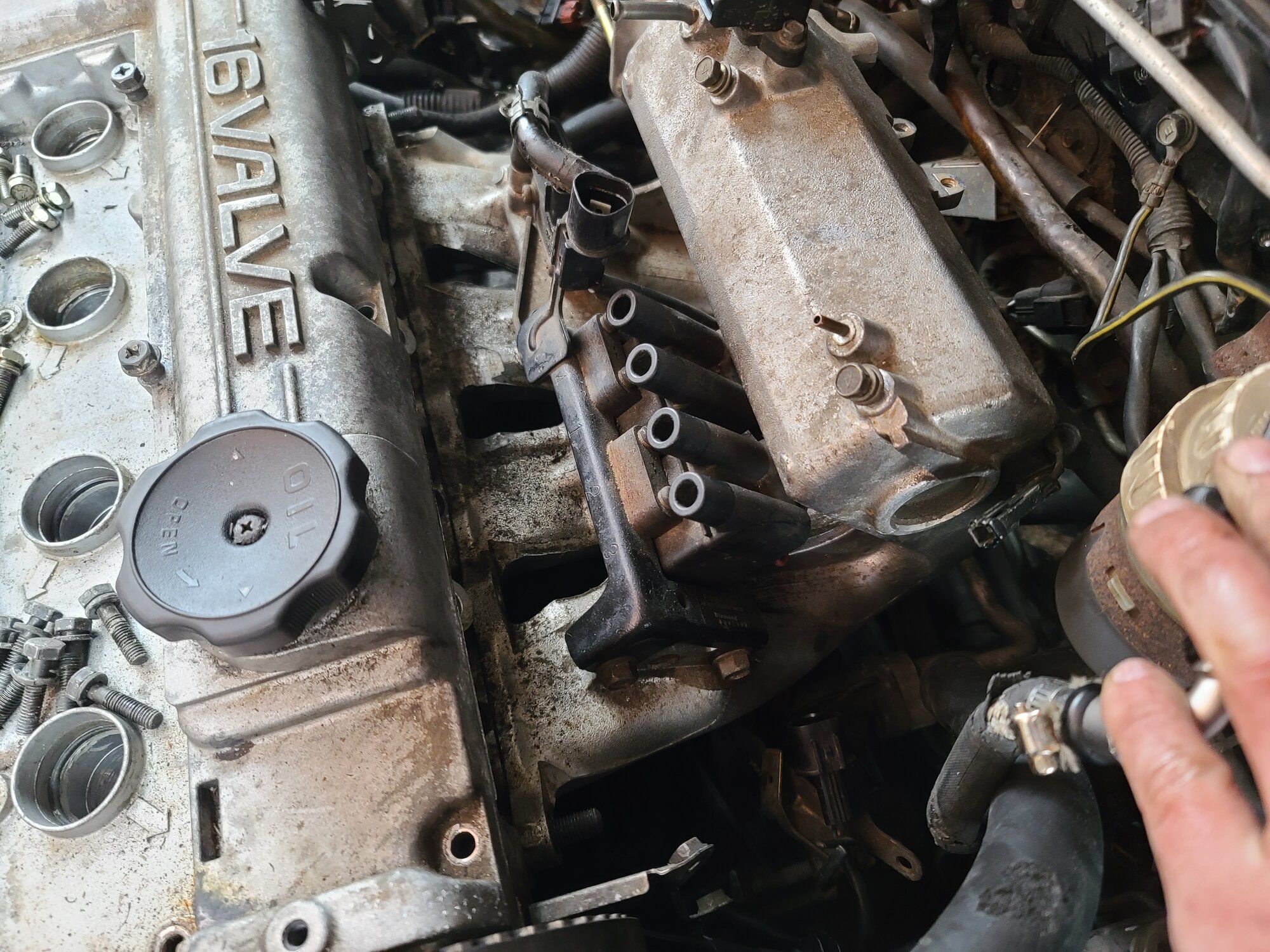

I got under the hood and inside the car yesterday. Ended up removing the abs proportioning valve as I intend to remove the ABS. While I was there I removed the charcoal canister under the battery tray and the valve cover. I want the engine to clean of any oil and grime, and although it's too cold to clean the engine, I can give the valve cover a facelift.

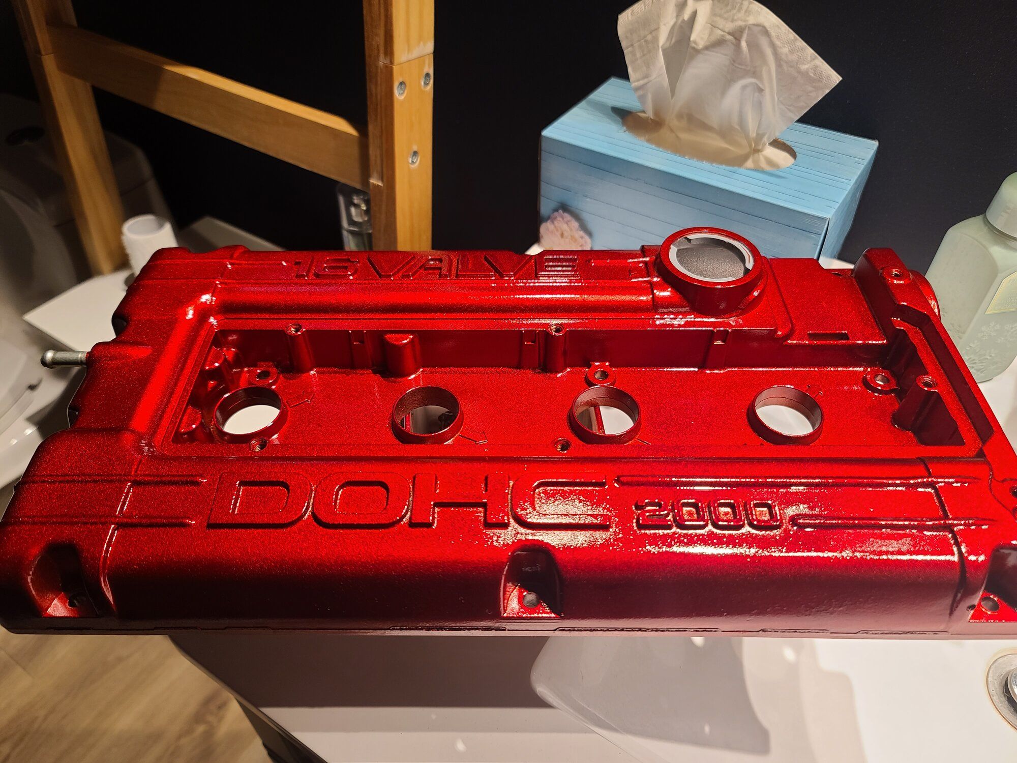

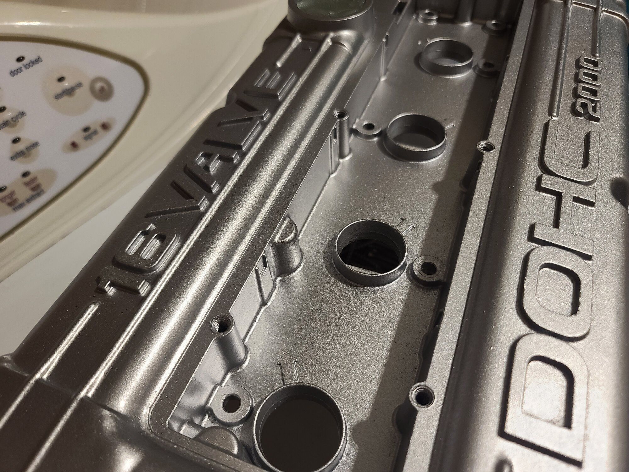

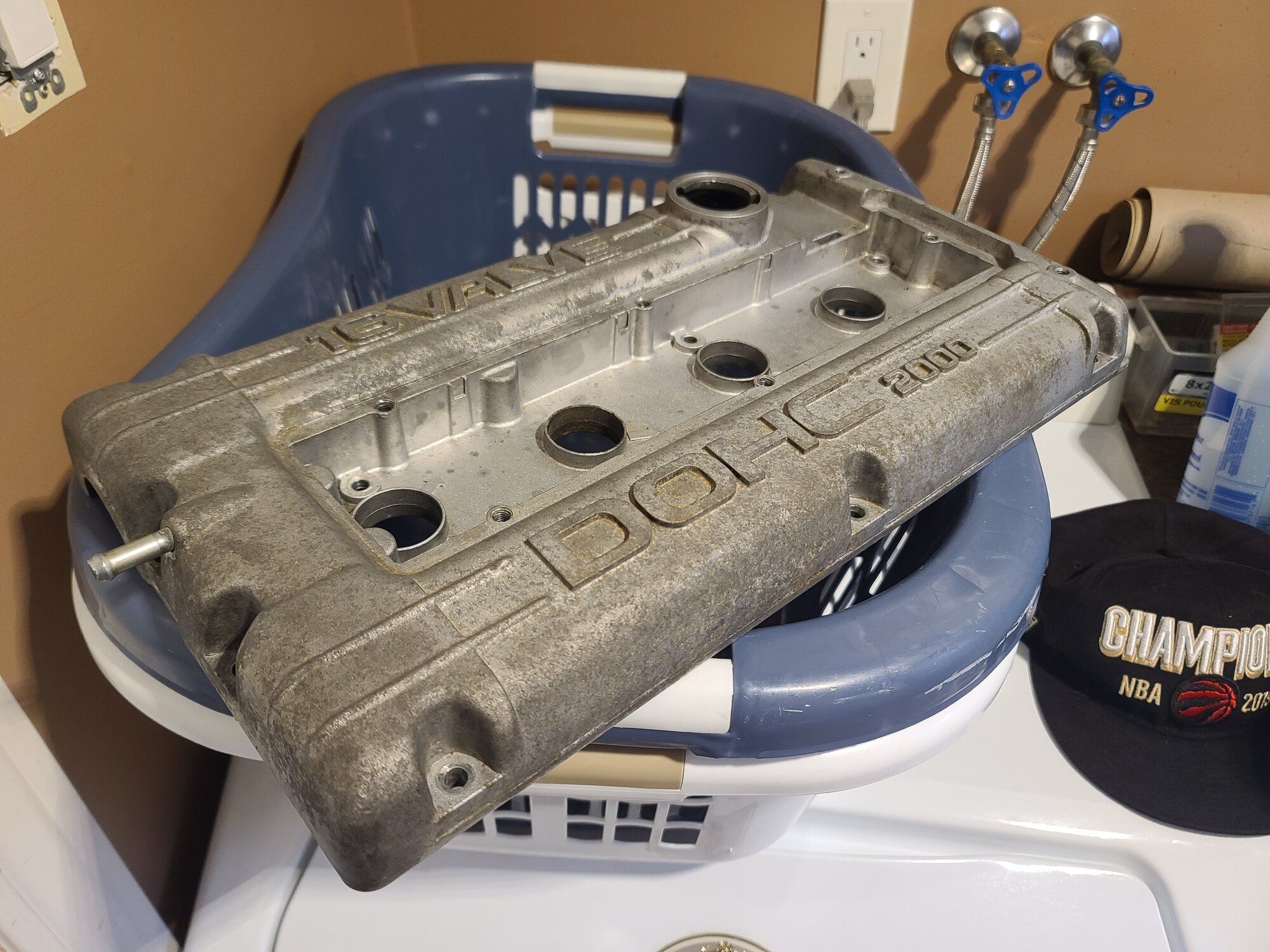

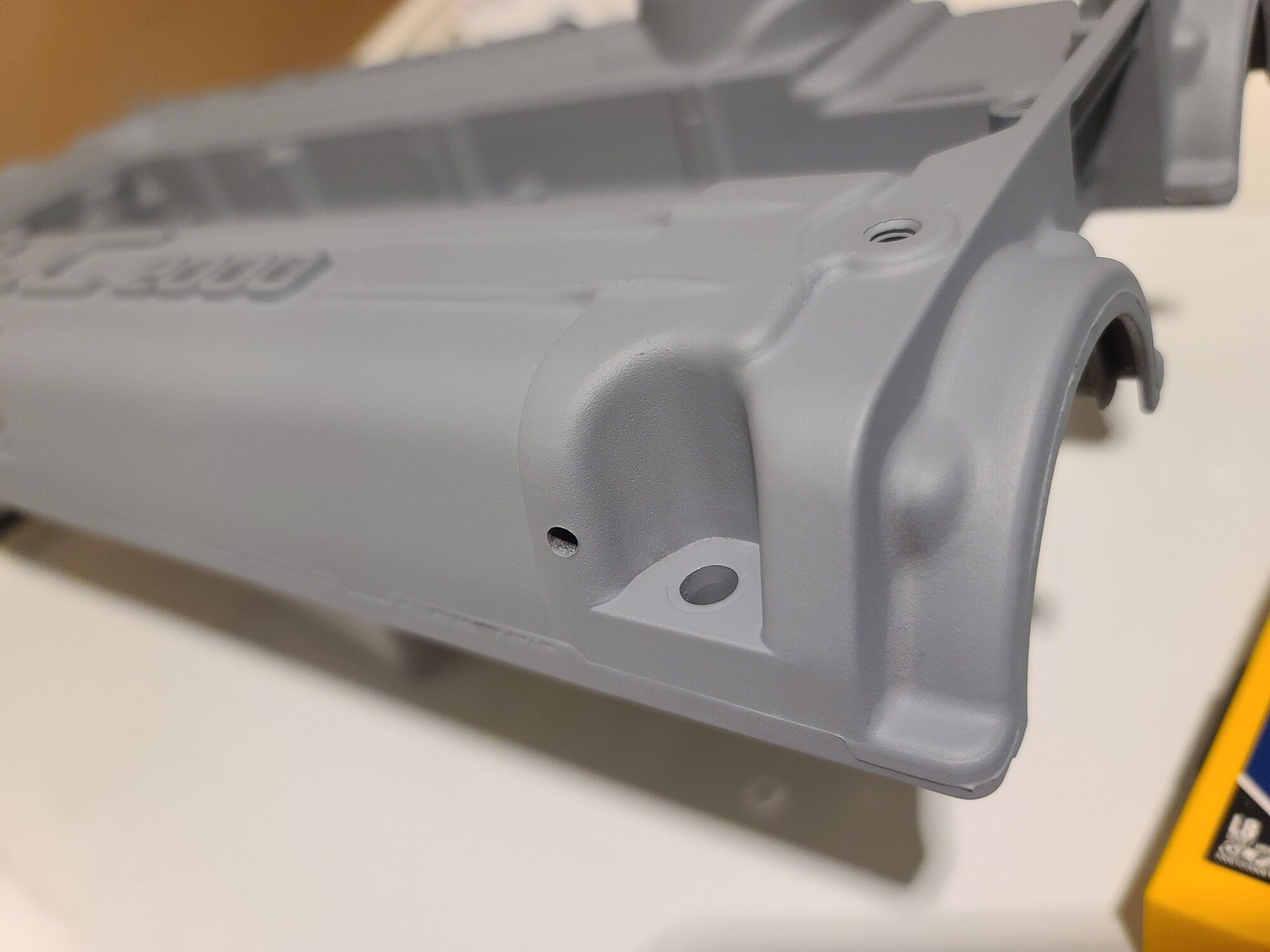

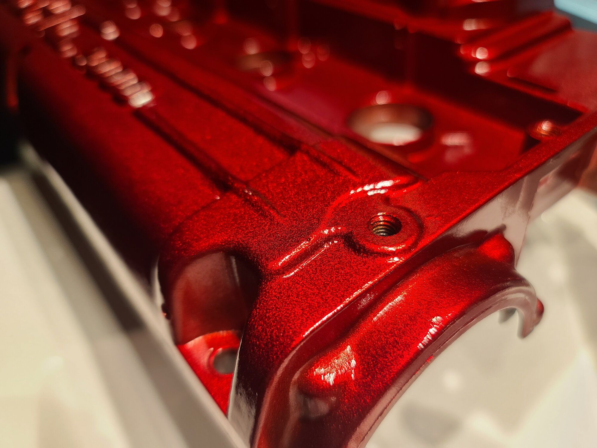

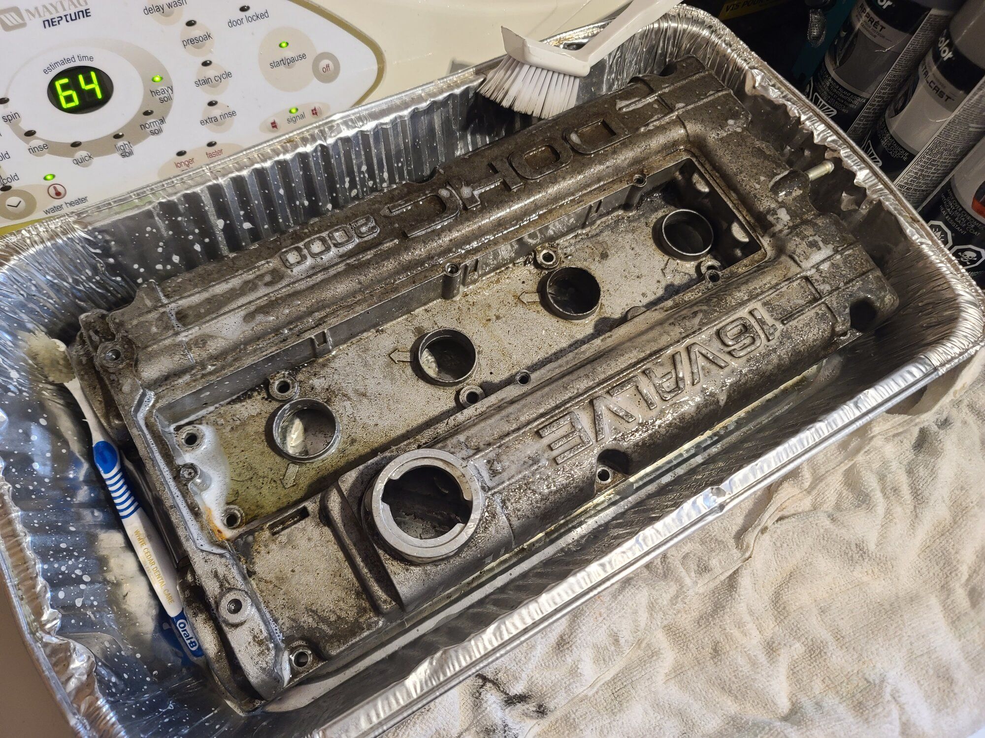

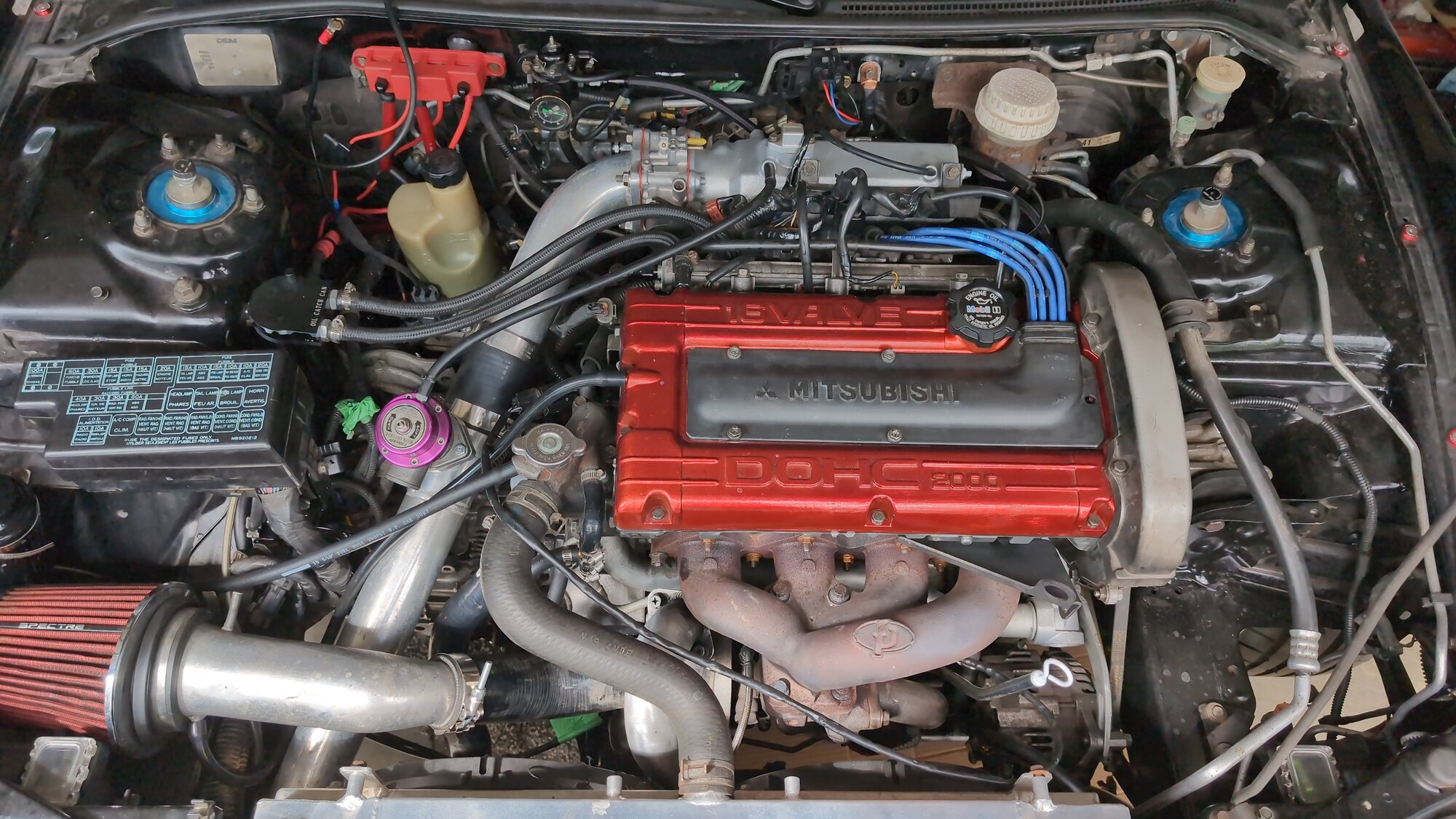

The pictures, I included are the original state of the valve cover.
After a thorough de-greasing I primed the valve cover with an engine primer followed by 3 base coats and and two color coats.
I'm pretty pleased with how it turned out, the de-greasing was my least favorite part, took me 2-3 hours until I was satisfied. Worth the effort. I've since cleaned the threads on the valve cover.

What was the paint type you used? Can it withstand heat and prolonged oil contact? It's a beaut colour
I used DupliColor engine enamel primer with ceramic, capable of handling temps of 500f/260c.
I then used their Metalcast line of paints, base coat and anodized coating.
Should have no issues with the oil or temps, but time will tell.

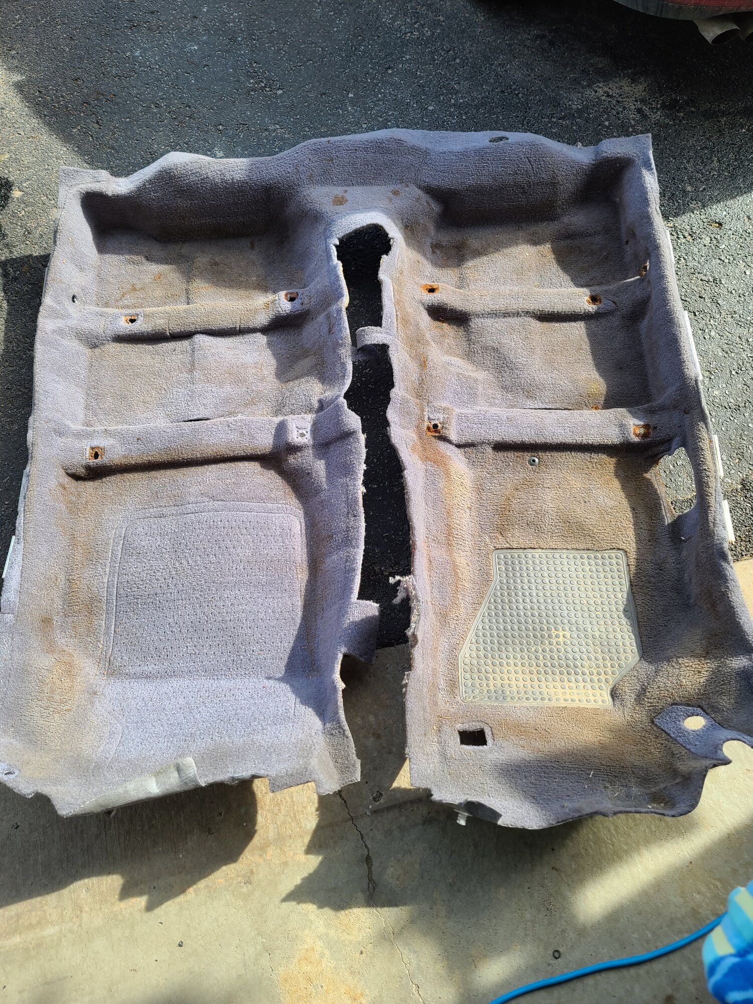

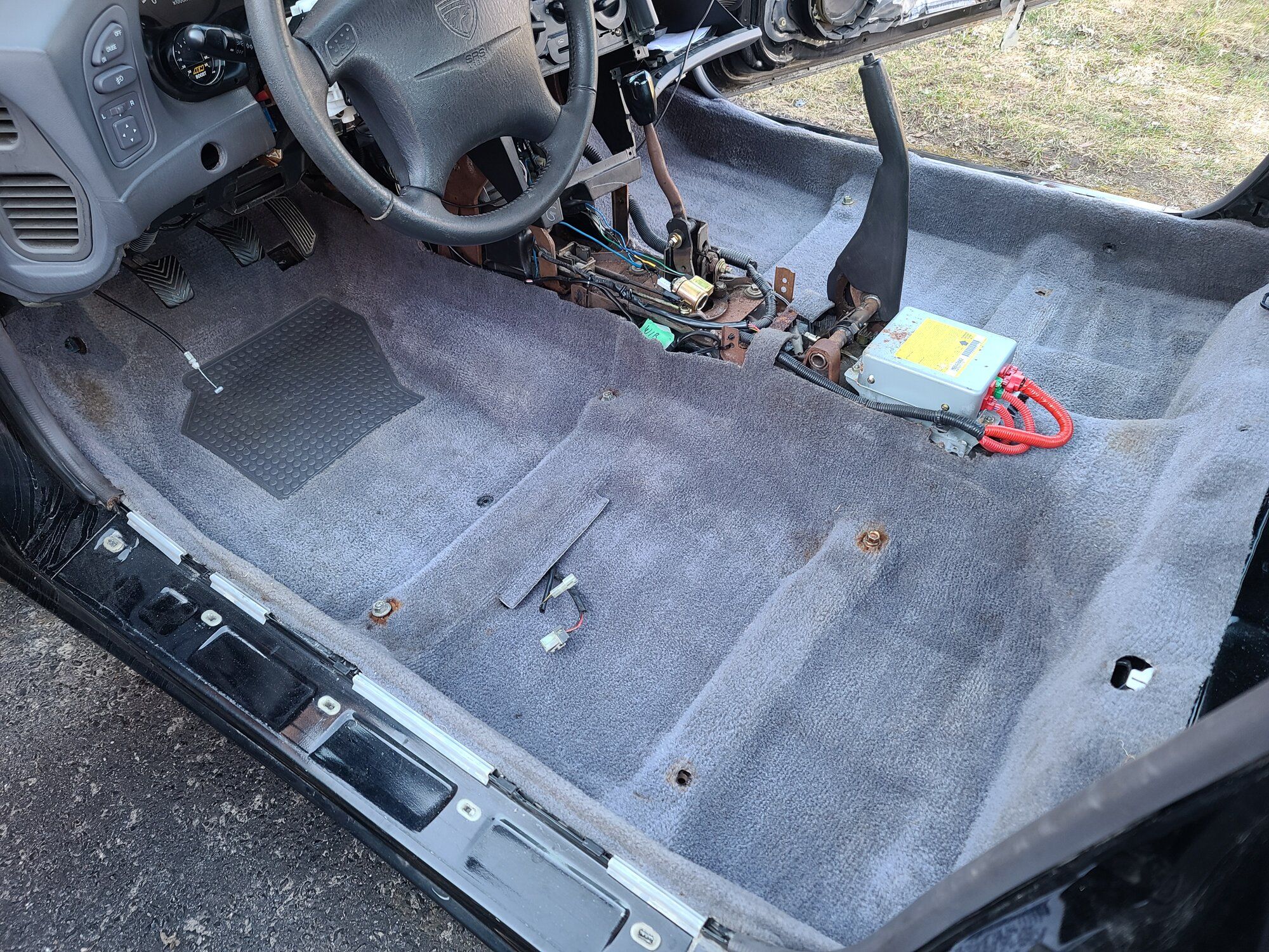

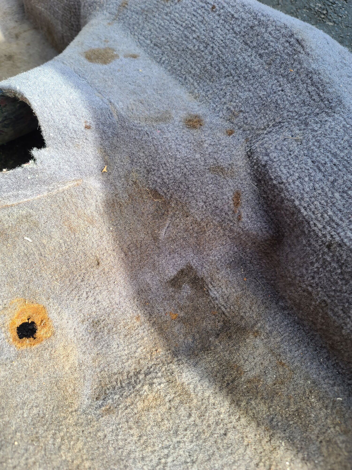

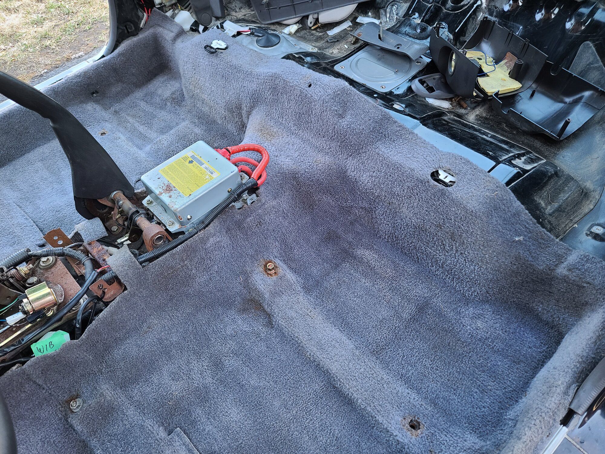

The carpet was pretty ugly and stained.
Gave it a quick bath, some de-greaser and a brush on a drill to agitate it. Came out better than expected, not perfect, but WAYYY better than before.

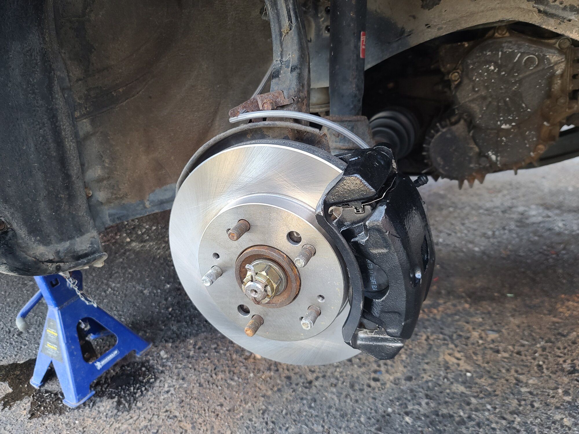

Also had the brake calipers rebuilt for piece of mind while it was cold and still winter time. New pads and rotors to go along with the refreshed rebuilt calipers. Purchased STM's ABS delete kit as well, and cleaned up all of the ABS related stuff from the engine bay/fender area.

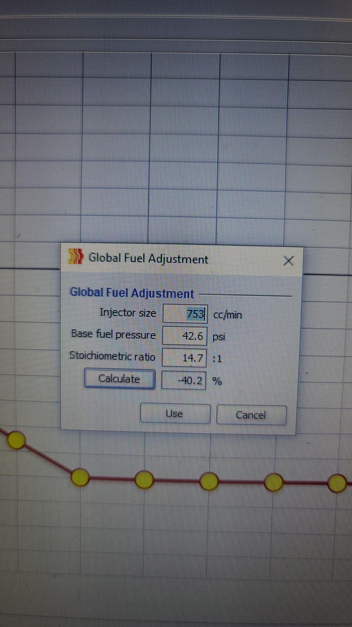

About a month or two ago, I had my 1000cc injectors cleaned and flow tested.. Less than ideal results. 840cc, 820cc, 720cc, 720cc
So... I ended up purchasing some new FIC 1220 low z injectors.
Switched to speed density and got rid of the MAF. Finally able to start my car since the new year and I had some idle surge issues. I busted out my multimeter and found my ISC had a burnt out coil. Resistance in the other 3 coils were around 28ohms. Figured I'd check the ECU while I was diagnosing this idle issue. Drivers look like they saw some heat, but the guys at ECMTuning had a look over and assured me everything was fine and working as it should.

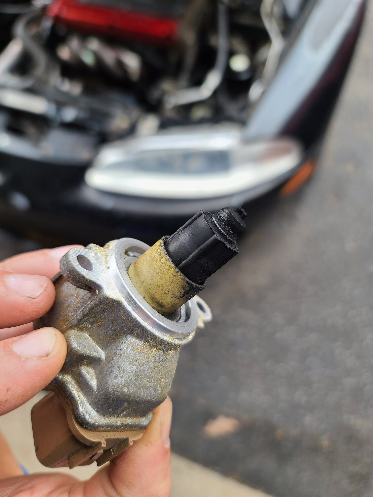

I replaced the ISC and my idle surge was gone.

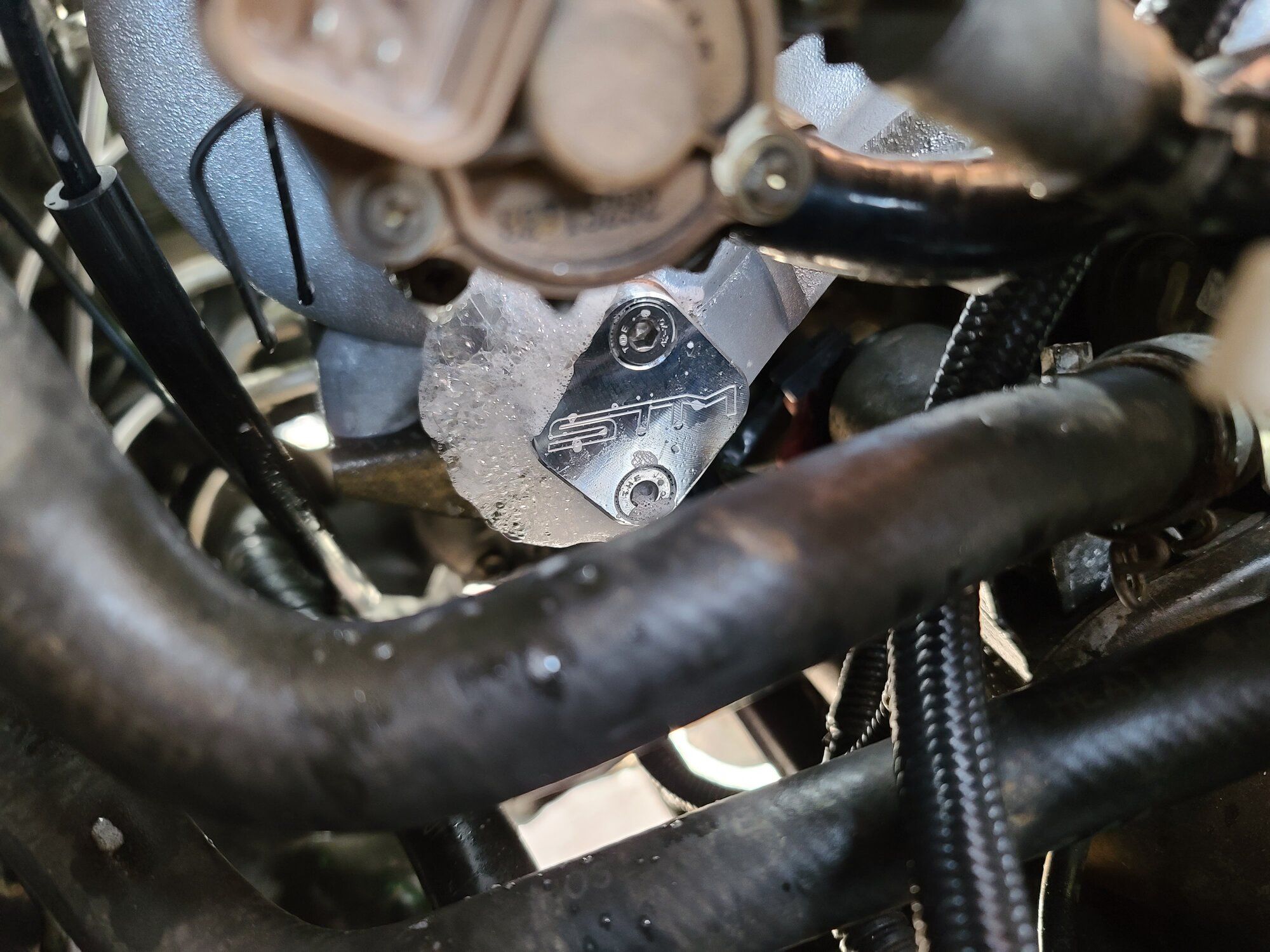

Found a leak. Look at all those bubbles!

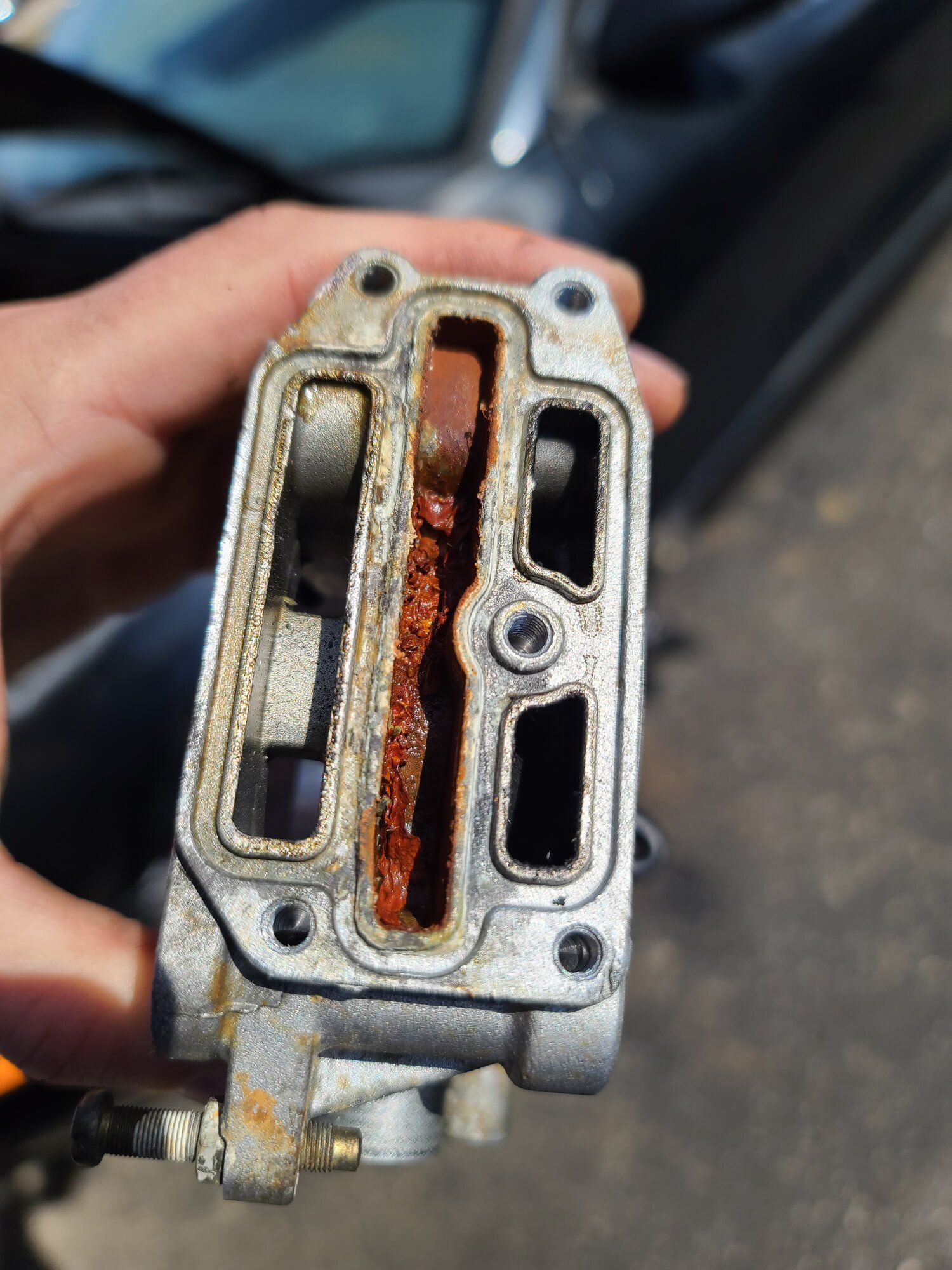

I ordered another OEM EGR gasket, however it still leaked. I put high temp RTV on both sides and no more leaks.

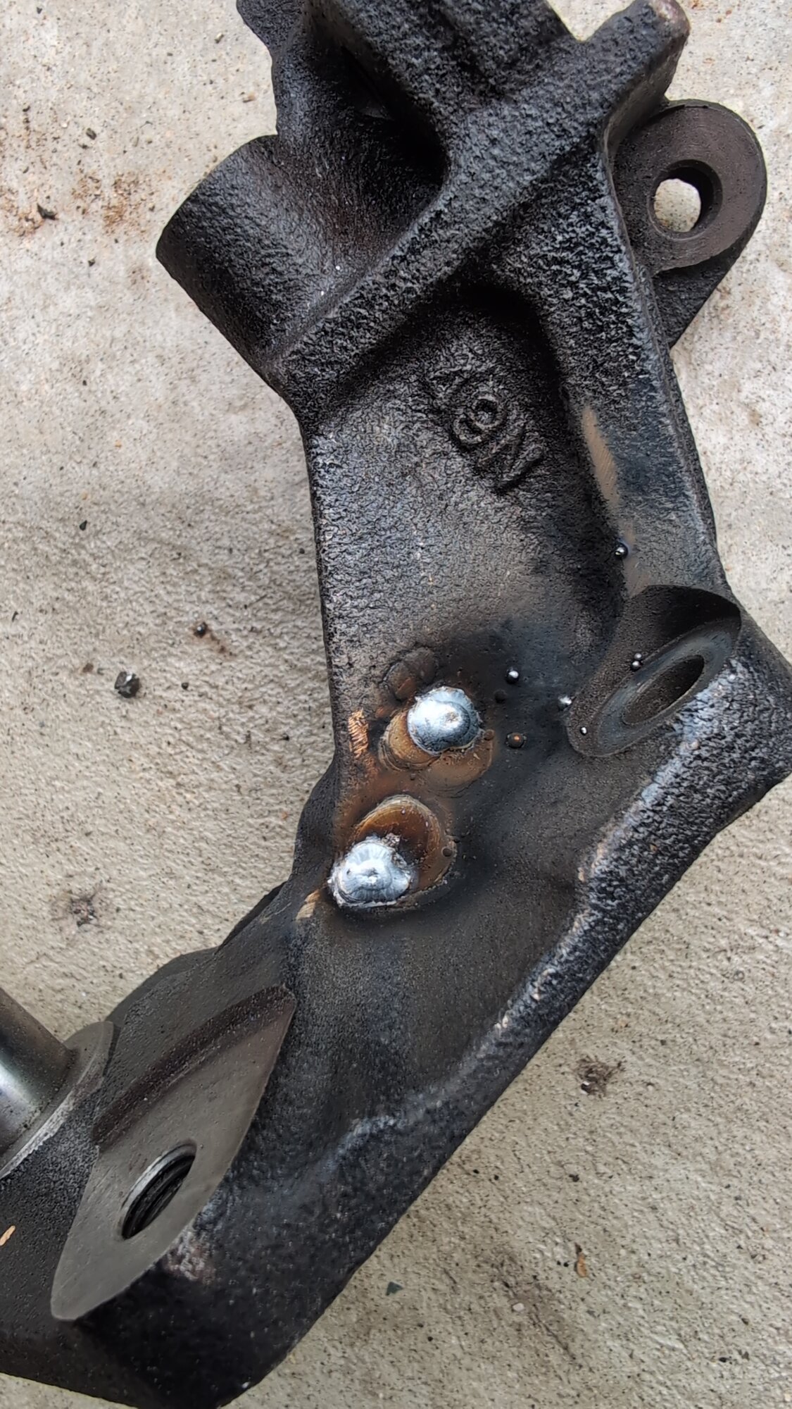

Found another.. The flange didn't blow off, but it didn't take much for it to pop out either.

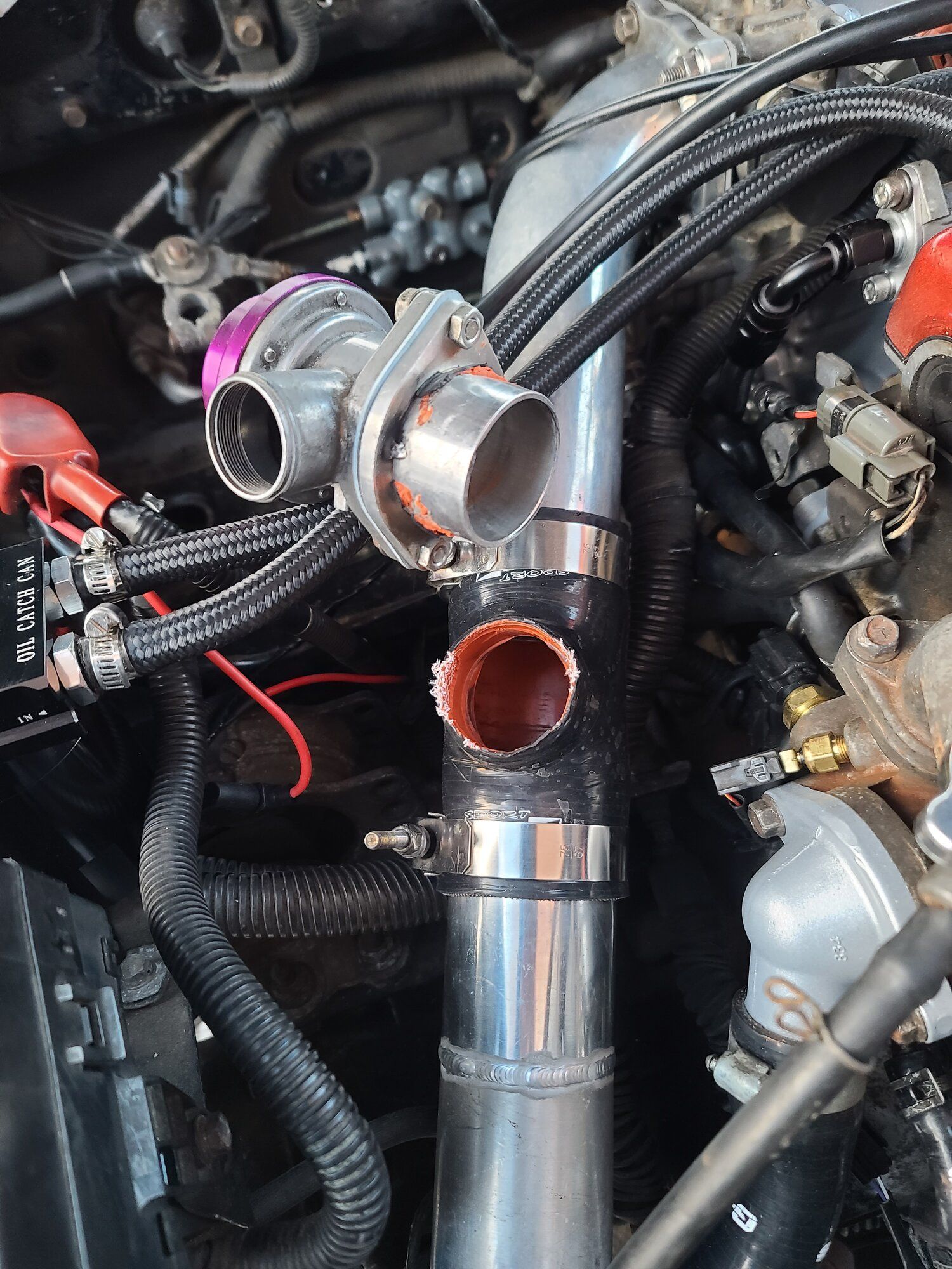

The BOV adapter coupler was shit, I knew it when I bought the car and it leaked like crazy. Had someone weld on the adapter to the aluminum pipe and no more leaks there either.

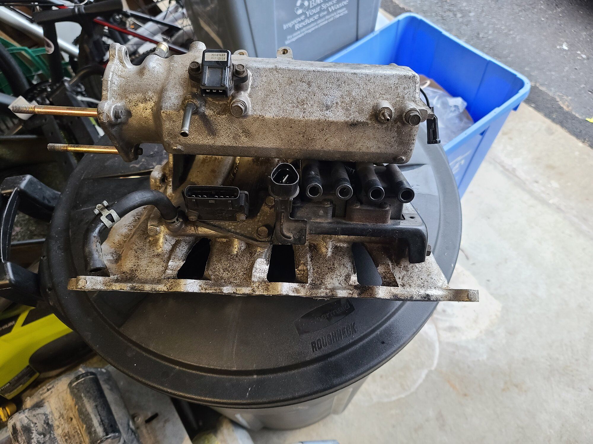

Also found leaks around the throttle body seal, so I got a new set from STM, and installed those carefully. Cleaned out the throttle body as it needed it desperately. Can anyone tell me WTF was in the coolant?
The picture is the bottom of the throttle body, FIAV.
In terms of boost leaks, it's no longer leaking in those areas, and boost seems to hold okay. Still leaks a little around the fuel pressure regulator adjustment screw and vacuum line to it.

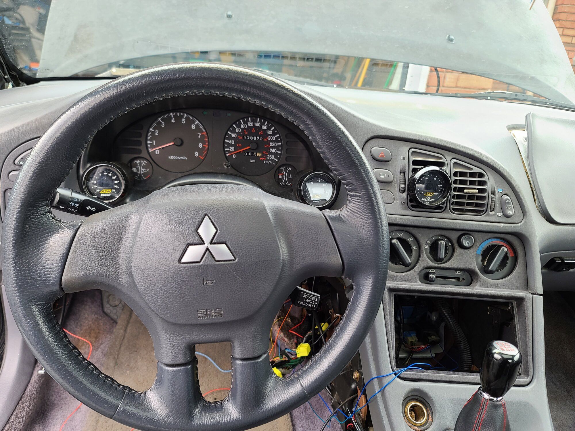

Went to a local pick apart junk yard, and grabbed a new steering wheel as my old one was really worn. 4th gen bolts up relatively easily, minor cutting needed to fit the cruise wand.
=( The airbag cover lifted again. UGGH
Don't pay attention to the spaghetti under the dash. I was trying to figure out why my power locks were not locking/unlocking with the alarm system I put on. It's since been cleaned up.

Adjust your BISS to fix the ISCPosition

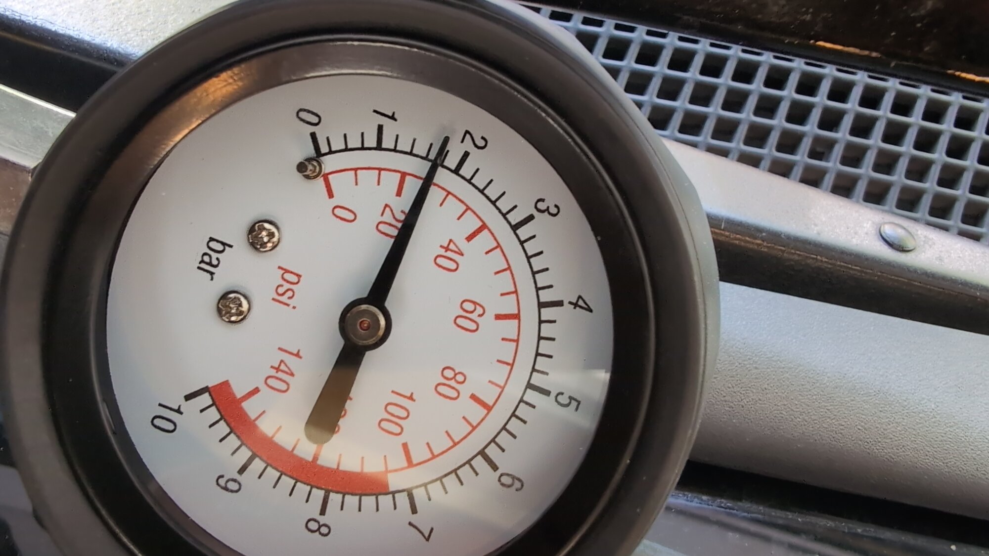

It took 1:22 to go from 30 to 10? I'd say that's successful. I don't even test that high and I generally look for 1:30 from 25 to 10. After that, the less pressure, the longer it should take until you're bored and you call it good.

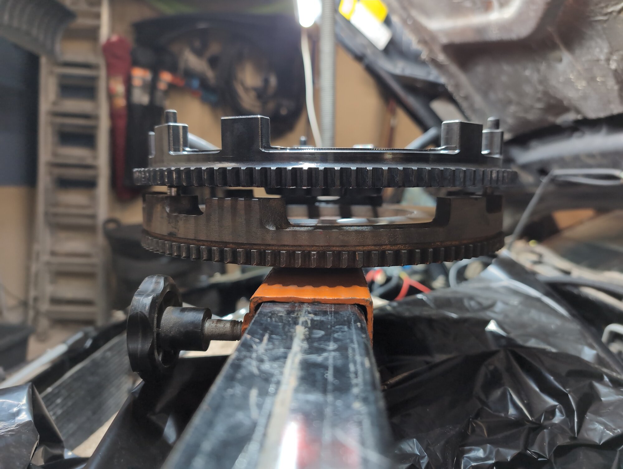

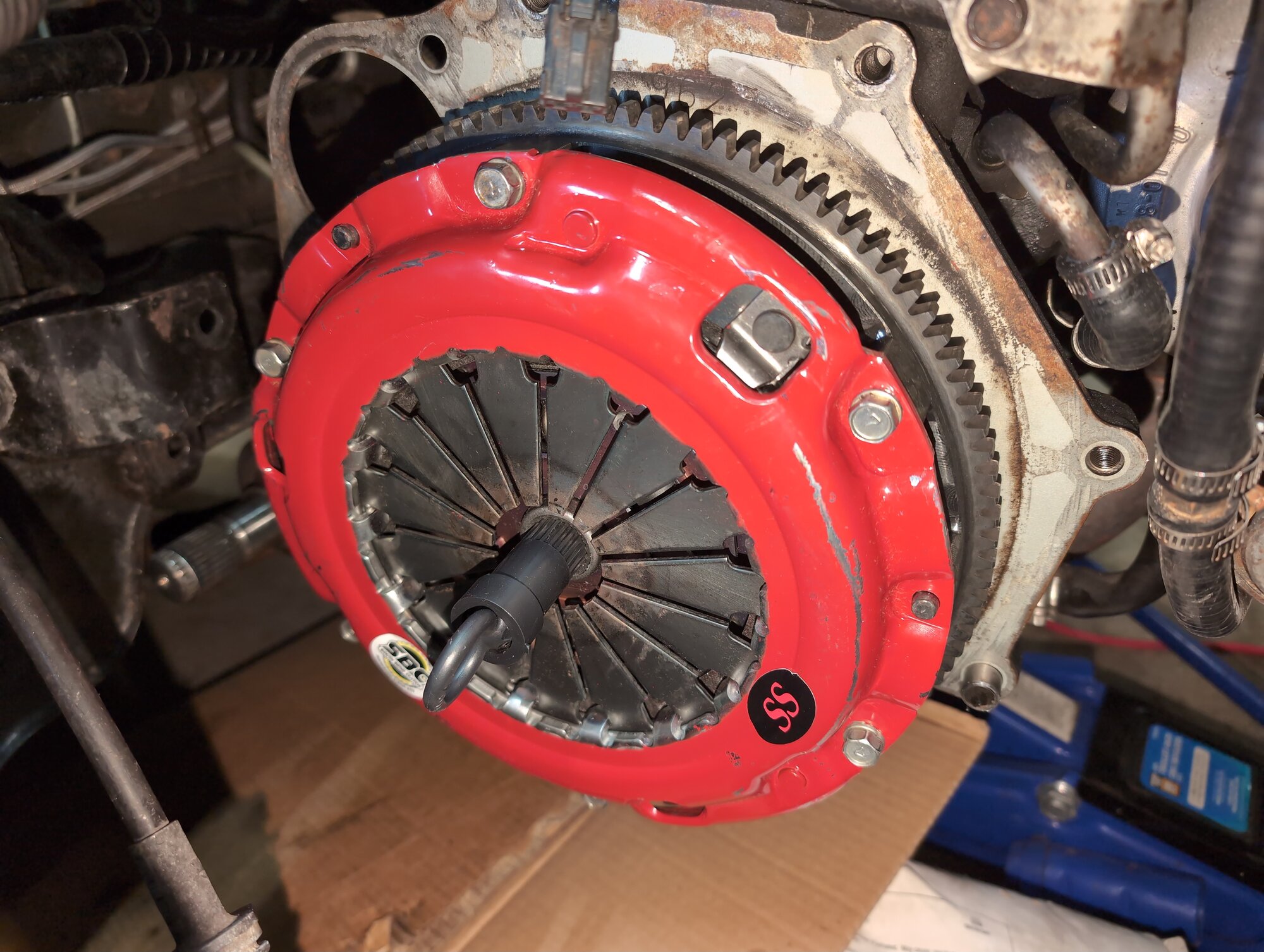

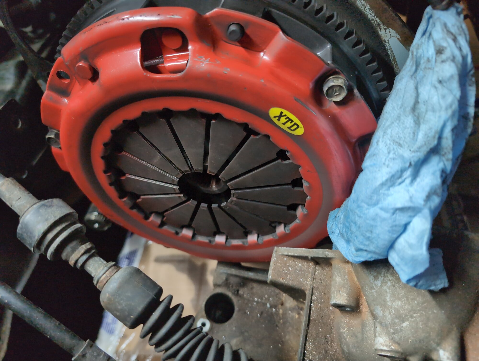

New issue arrives, my clutch is slipping like crazy under moderate boost...yay. This was the end of my driving season, and start to a long and cold winter.
Previous owner decided 4 bolts was enough to hold this e-Bay clutch in place. Most likely the reason why it was slipping.

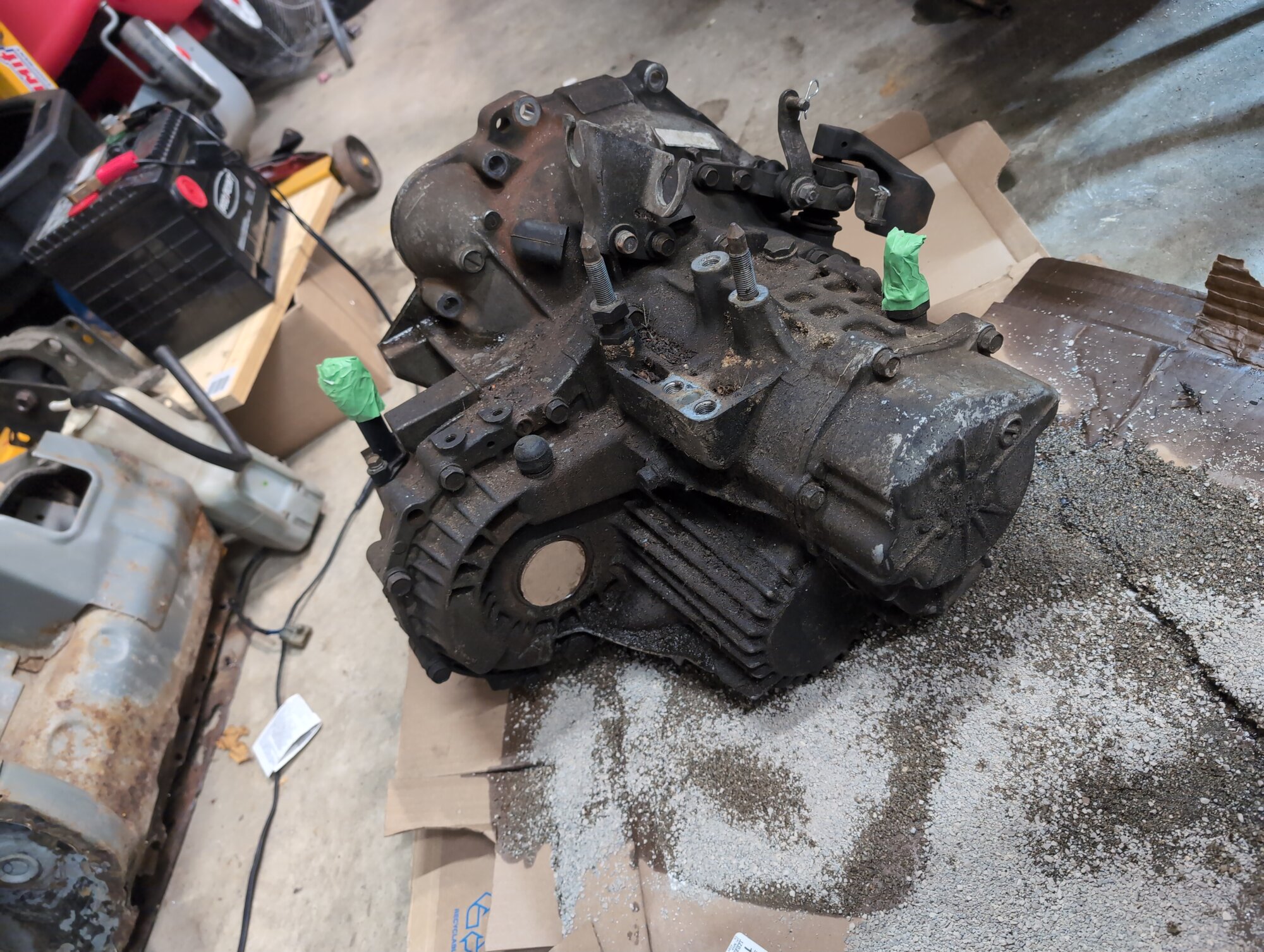

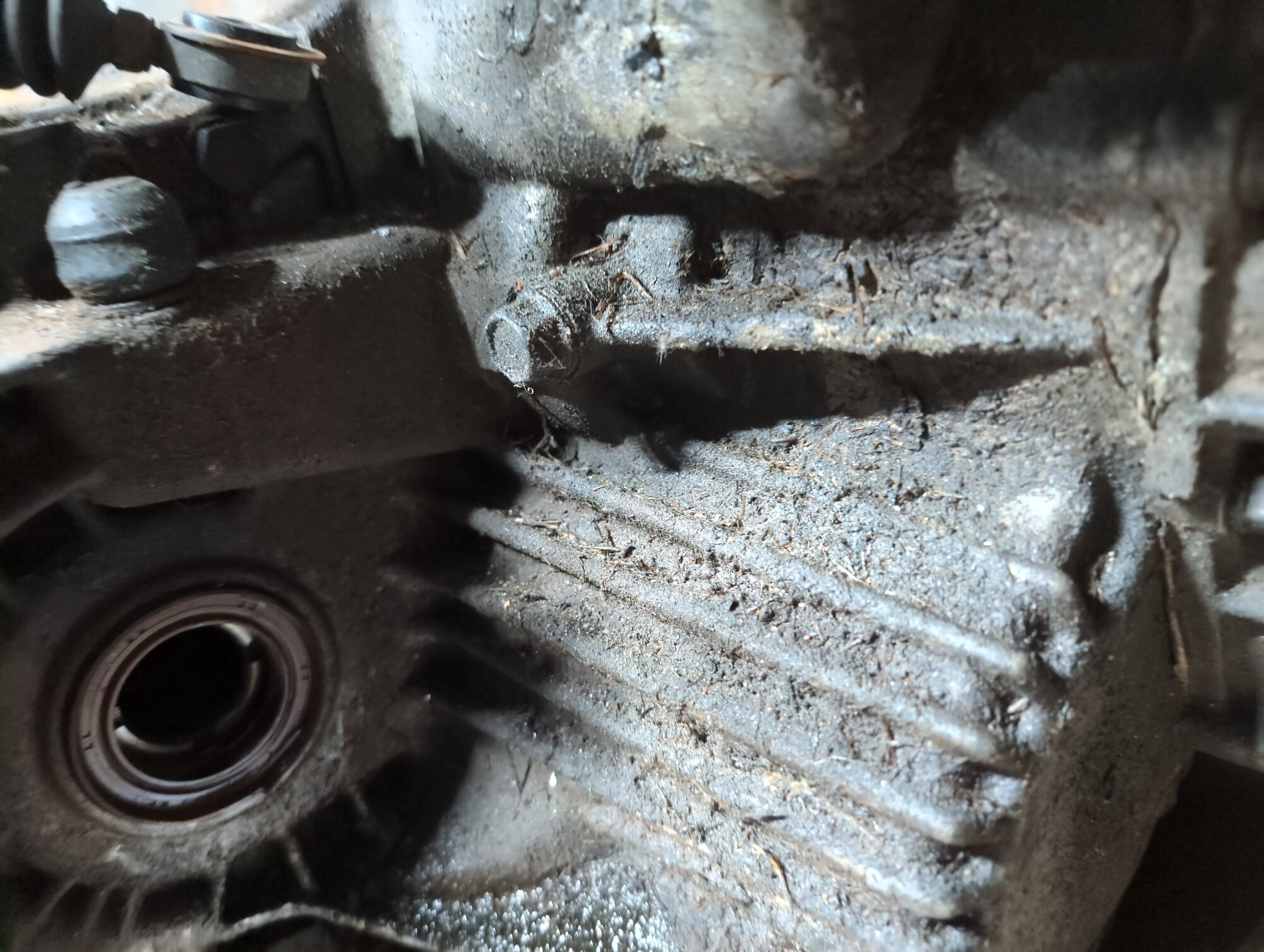

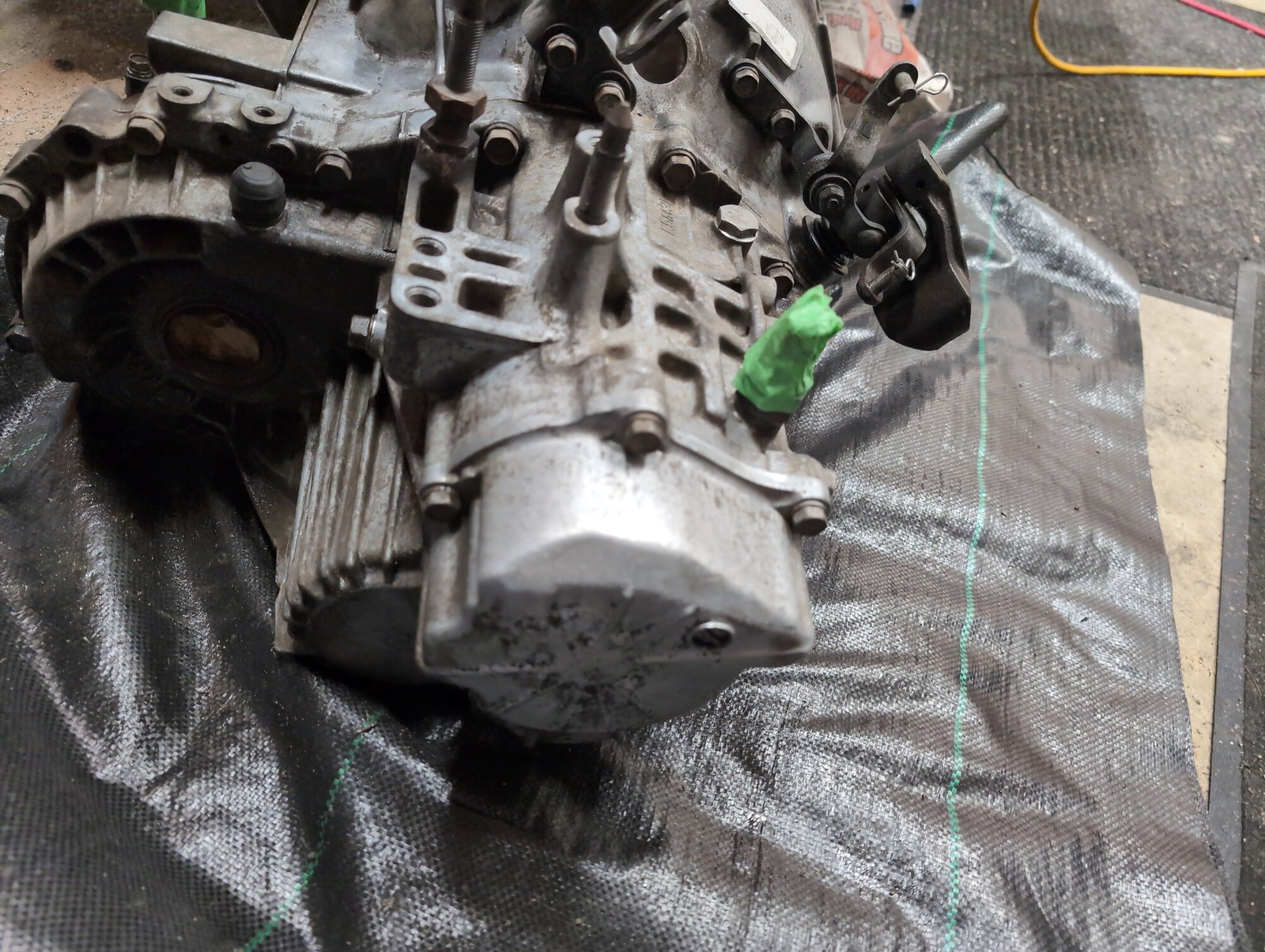

Transmission was a little bit dirty.
Gave it a little cleaning. Nothing crazy, but at least I could now touch pretty much anything in the engine bay and not get oil or grease on me. Small win.
While you're in there...might as well clean this up too and replaced the rear main seal.
I replaced the clutch with a SouthBend kevlar clutch and pressure plate. I didn't want to reuse the xtd lightened flywheel that came with the car, so I purchased the first 2g oem clutch I saw on Facebook Marketplace and got it resurfaced. Called a buddy of mine over to give me a hand installing the transmission back. Only after installing it, and wiring everything back up, and trying to start the car I realize I might have a problem. How come no one told me there is a difference between AWD and FWD clutches?
Or better yet...why didn't I think to ask or research this before making the purchase? FFF!! 🤬 I go to start the car and I hear the starter try to engage...but nothing. Well fk.
Whats more fun than doing a clutch job? Doing it twice, of course, and this time without my buddy. Finally got the clutch and flywheel back on. The poor pressure plate took some abuse when I took the transmission off the second time.

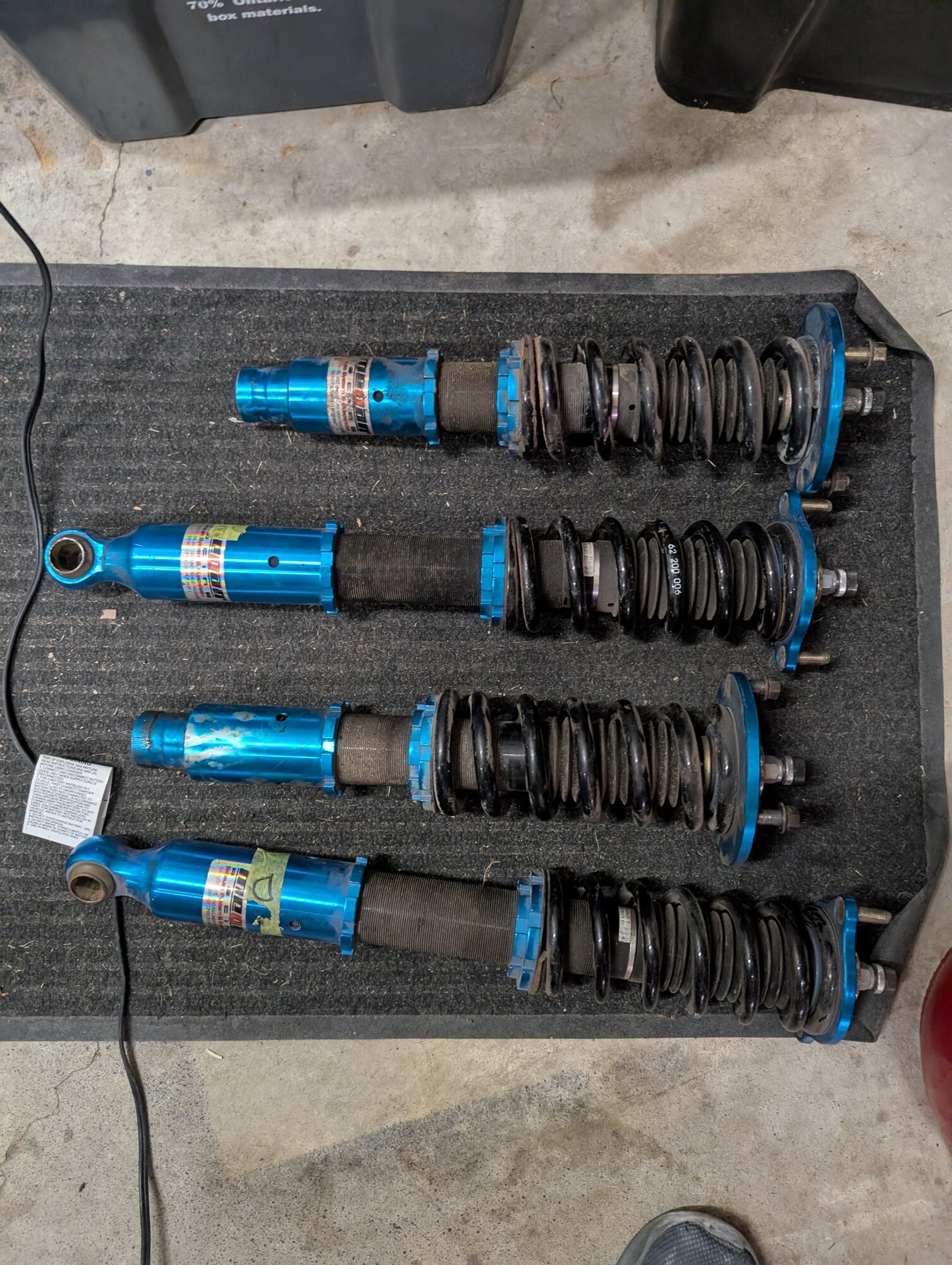

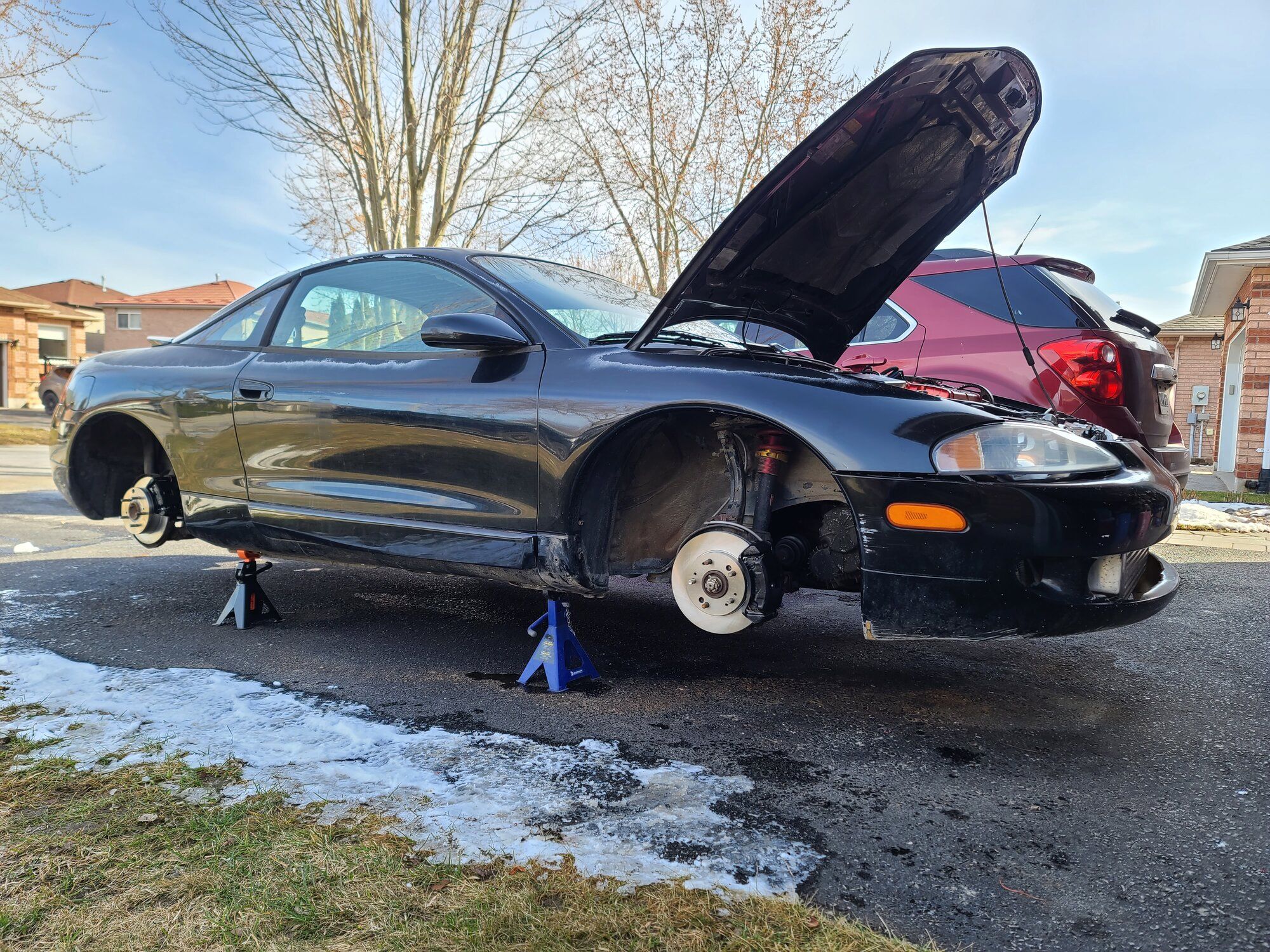

Sometime during all this, I got a deal on some used coilovers as my current suspension was shot. Little upgrade, nothing fancy.
Making progress!! While I had everything apart, noticed just a little bit of oil coming from the cam seals...ha... replaced those as well.
Lookin crusty.
Glamor shot...things finally put back together. Pay no attention to the sanded strut towers, or missing windshield cowel. I assure you it looks better now and everything is back where it belongs.

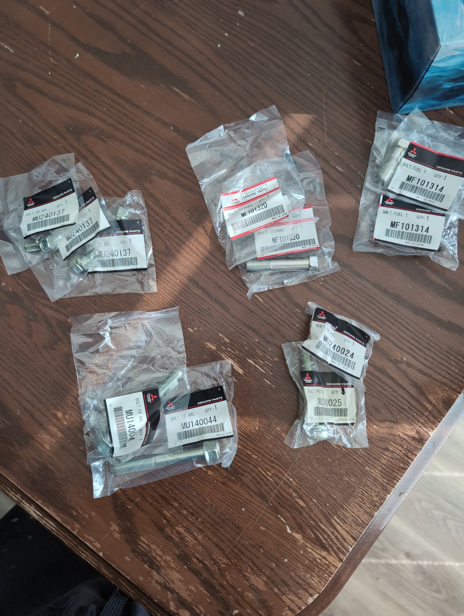

These were some goodies I ordered from Amayama, to replace the rusty and crusty...or missing bolts.

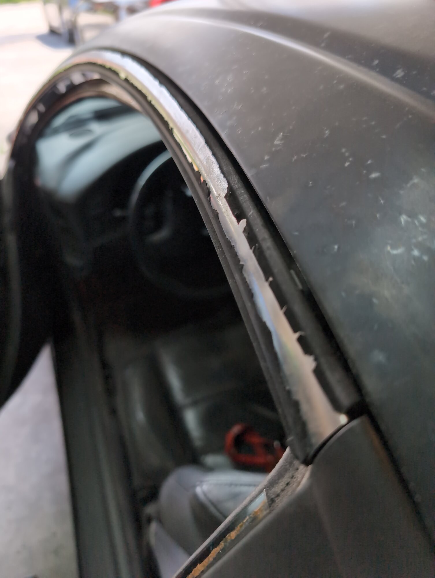

Got a sweet set of drip rails from a friend parting out locally... Thank you Mike!
Before
After

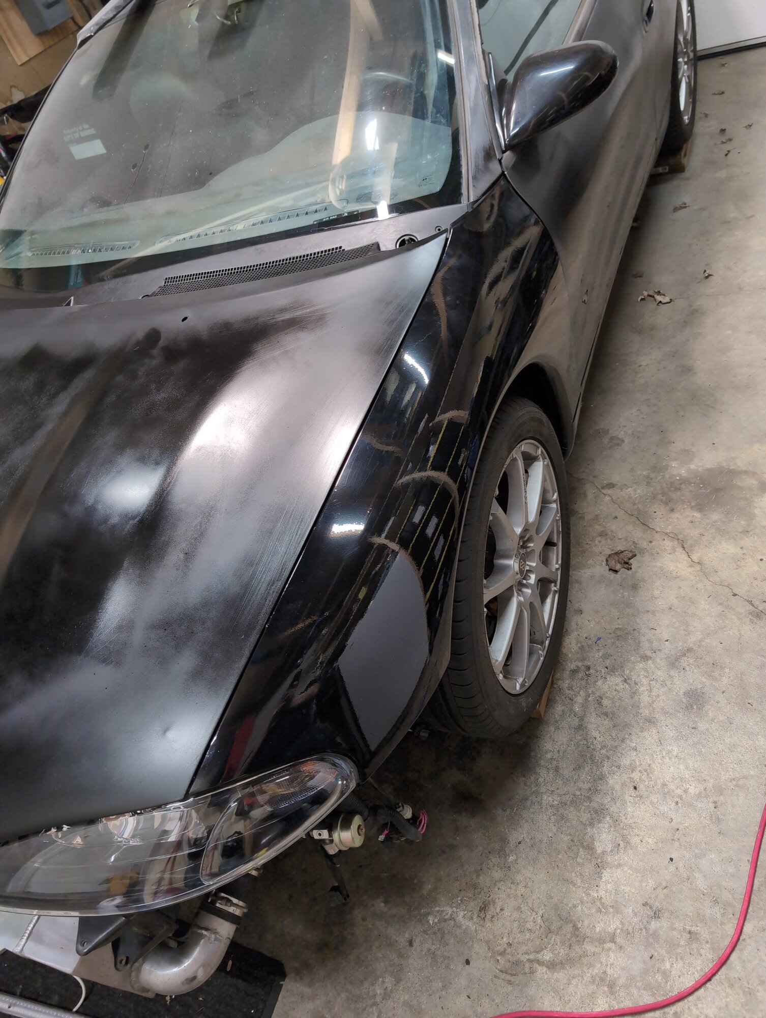

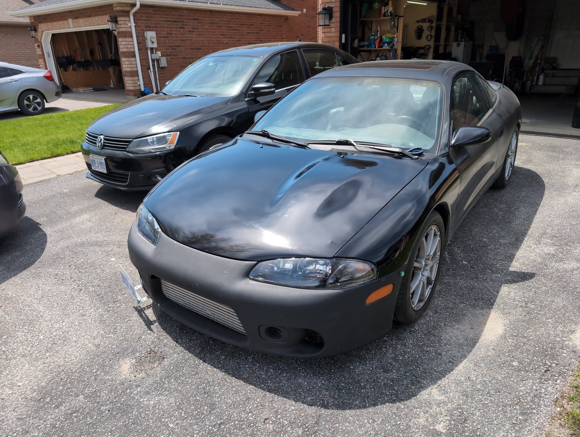

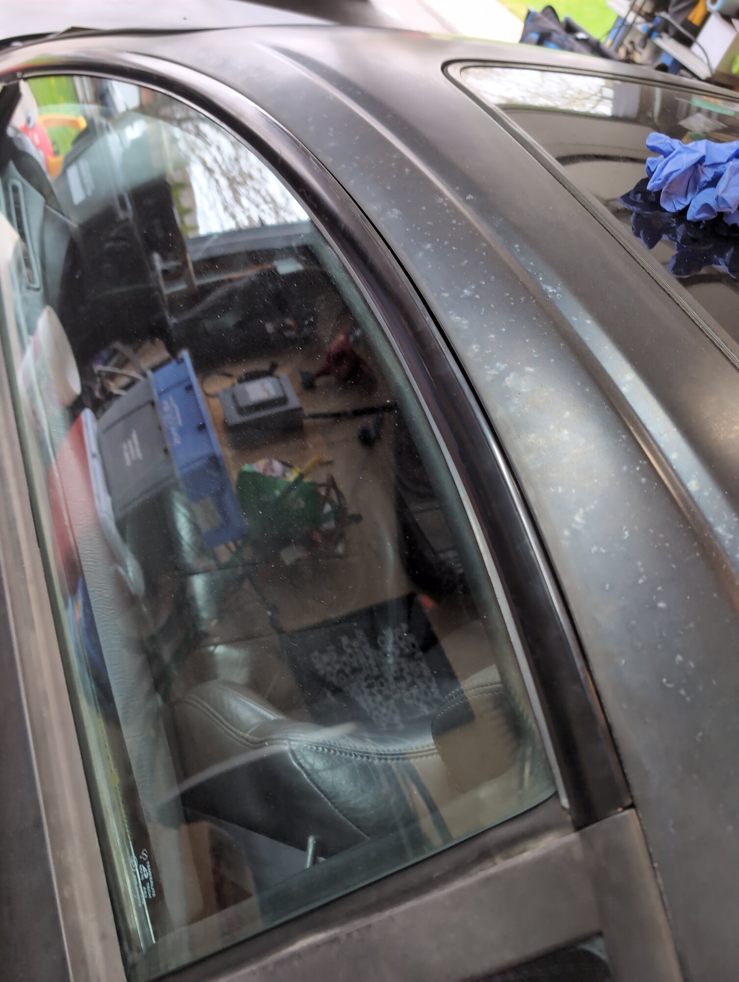

Ordered a ppf vinyl roll from Alibaba, and waited until the weather got hot to try my hand at wrapping the car. Doesn't look great, but better than before. 😙 "If you squint...it's mint!"

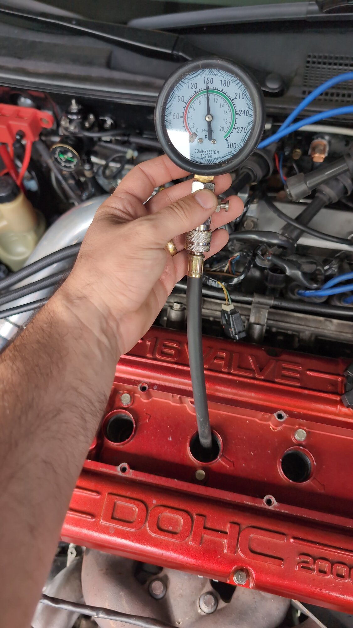

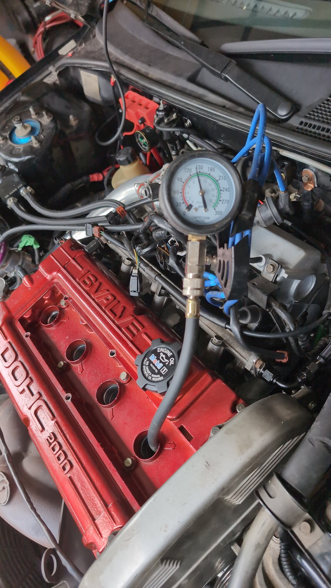

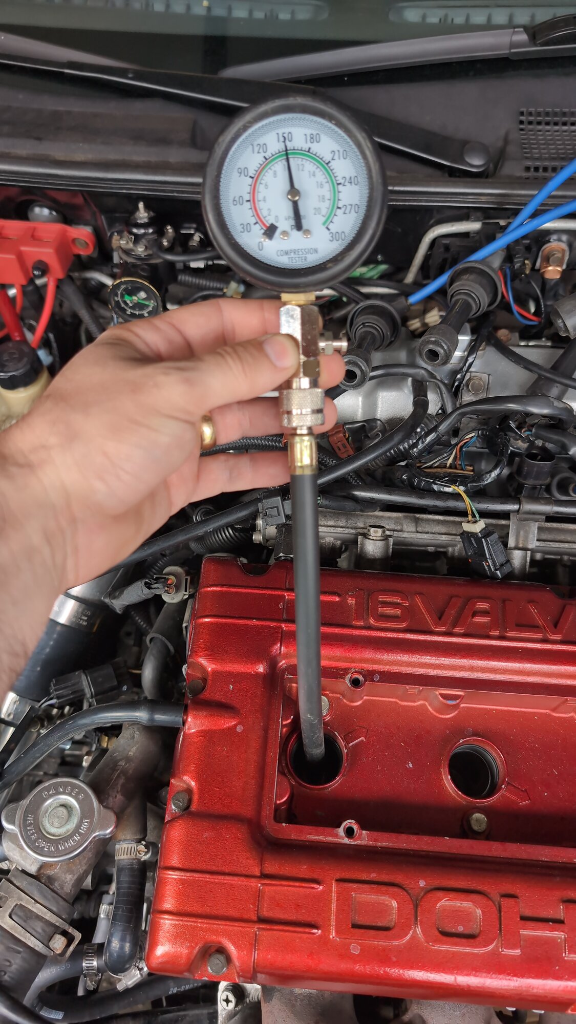

I had noticed my oil pressure was low...kinda always has been. I've been trying to fix it various ways. Cleaning up any oil leaks I'd find, replacing the oil filter housing, pressure relief valve, thicker oil, lucas oil stabilizer, but nothing seemed to help. I made a post on tuners not that long ago, link below.
https://www.dsmtuners.com/threads/low-oil-pressure.550583/

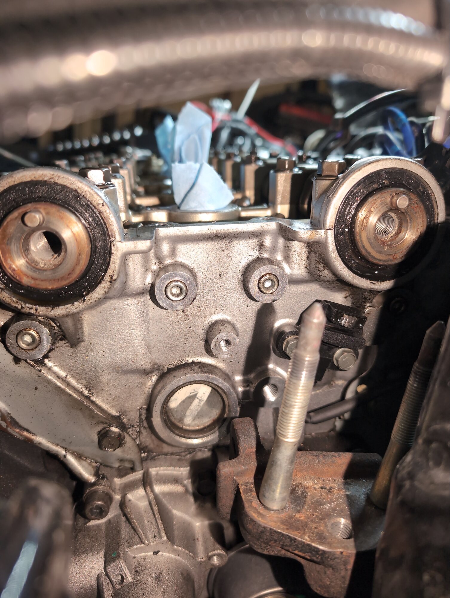

TLDR: Car has crankwalk, probably always had it. I had dropped the pan earlier in my ownership to fix the oil leaks, clean the rust and repaint, but never even thought to check the crank for play. Drove it recently 40 miles, and at idle I was sitting at 0psi of oil pressure. Played with the gas pedal to keep the rpms high to not starve the crank, and drove it home. Dropped the pan, and the crank moves a good 2-3mm in either direction.
I had found a 6 bolt at a local pick-n-pull, two years ago, as something I'd eventually build.
Turns out, this one spun a bearing, oil squirter had broken off. Cylinder walls look good, same with the crankshaft, however I am going to get it inspected, polished, and cut if needed. Will probably need to bore it out to 85.5", the block was all original from a 91 Eclipse GST/X (I don't remember).
I have no clue how to build what I want, and could use some advice from you fine knowledgable folks.
I'm looking to have something capable of handling 500-600hp. (Probably closer to 500)
I don't know what pistons, rods, bearings, springs, cams, etc... I need to achieve this goal. I have no idea what I should expect to pay for it either.
I do have the possibility of buying from an OG dsmer, a motor capable of 1200hp, easily handling over 60lbs of boost for $10k CAD, but it's overbuilt for my application.

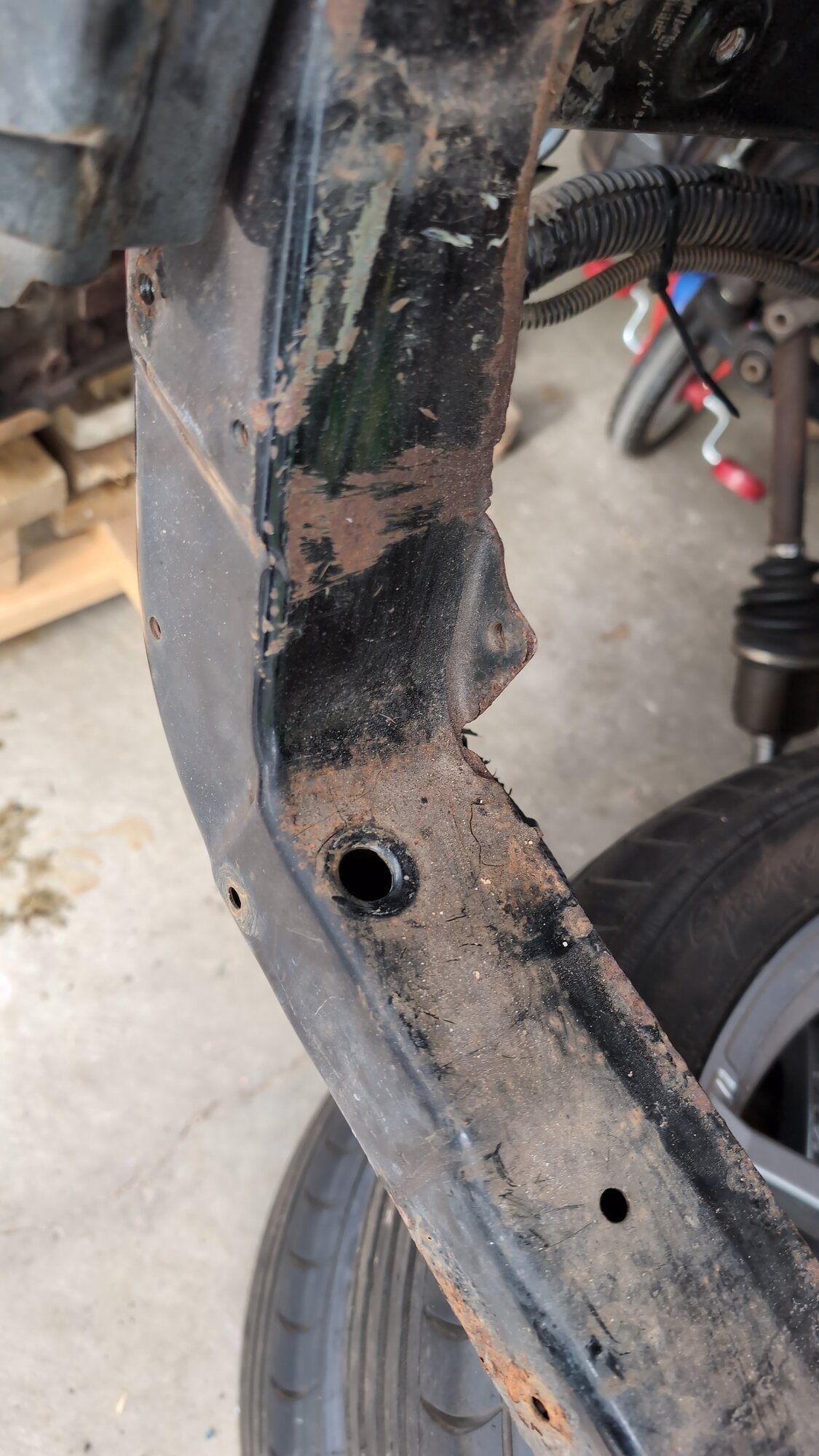

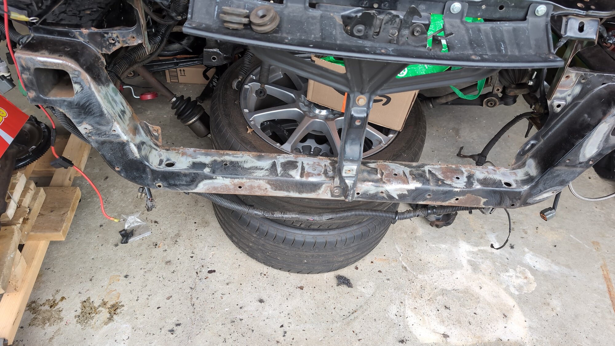

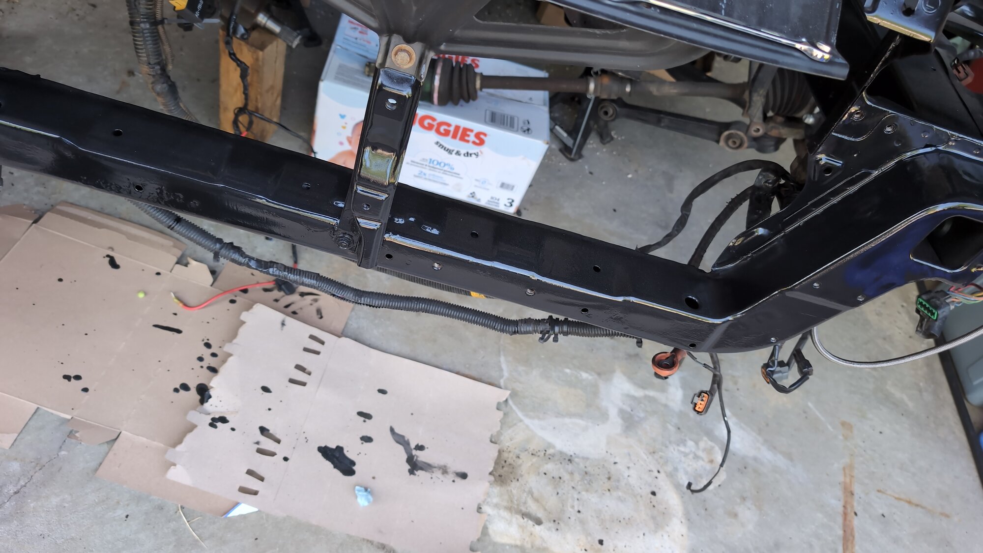

Before I put the motor in, and since I had a big gaping hole...where the engine used to be. Now is a good a time as any to clean up the engine bay, take care of any rust.

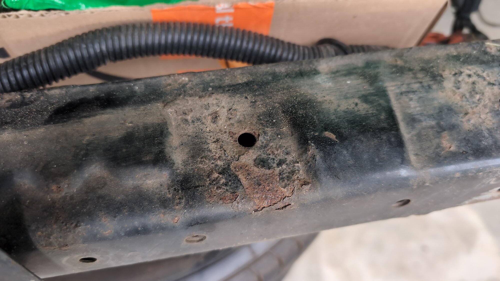

That rad support looks awful.
Not TOOOO bad, but ..after some por15, it looks brand new!
First time using it, I want to do the whole undercarriage of the car now LOL.

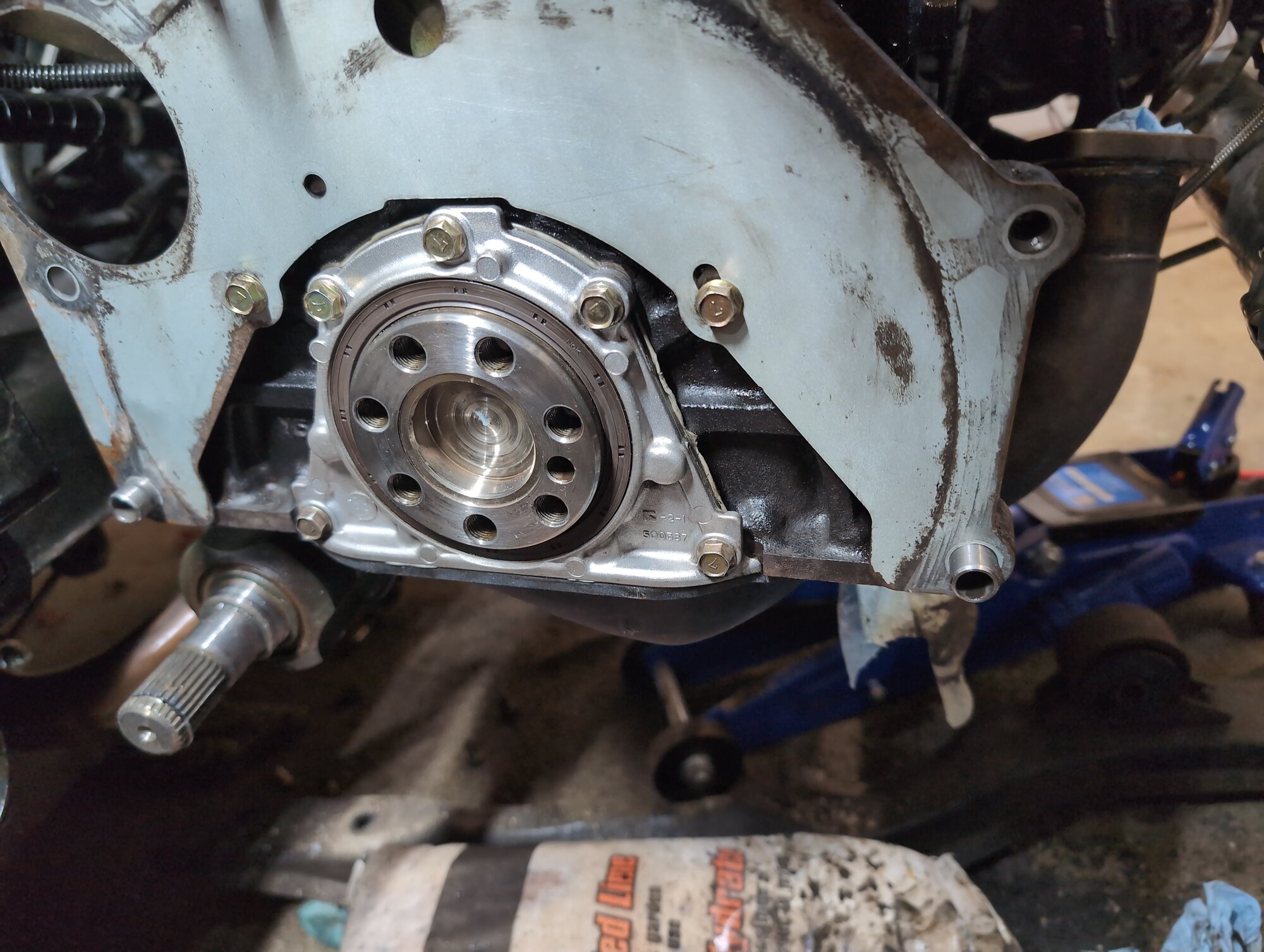

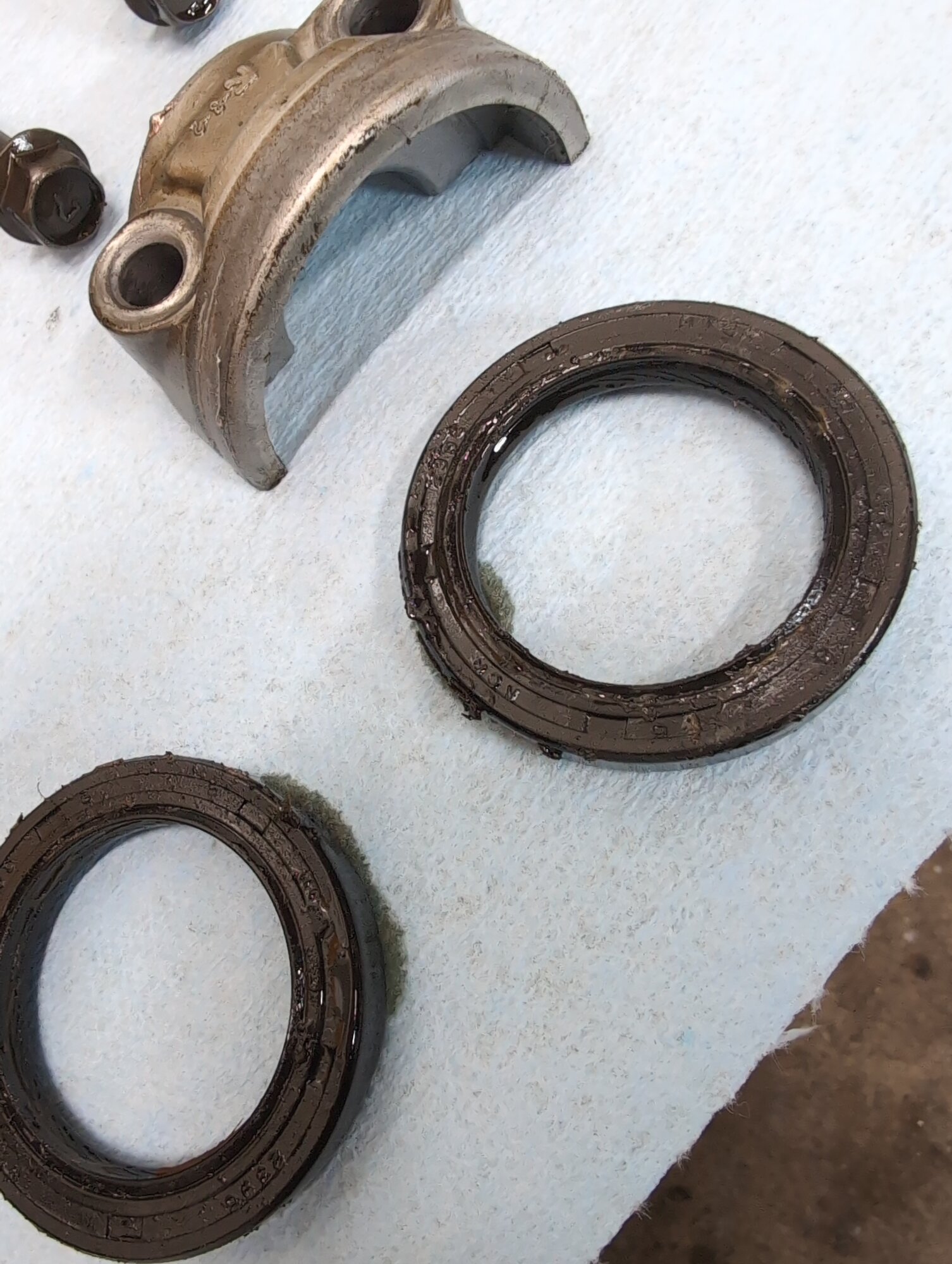

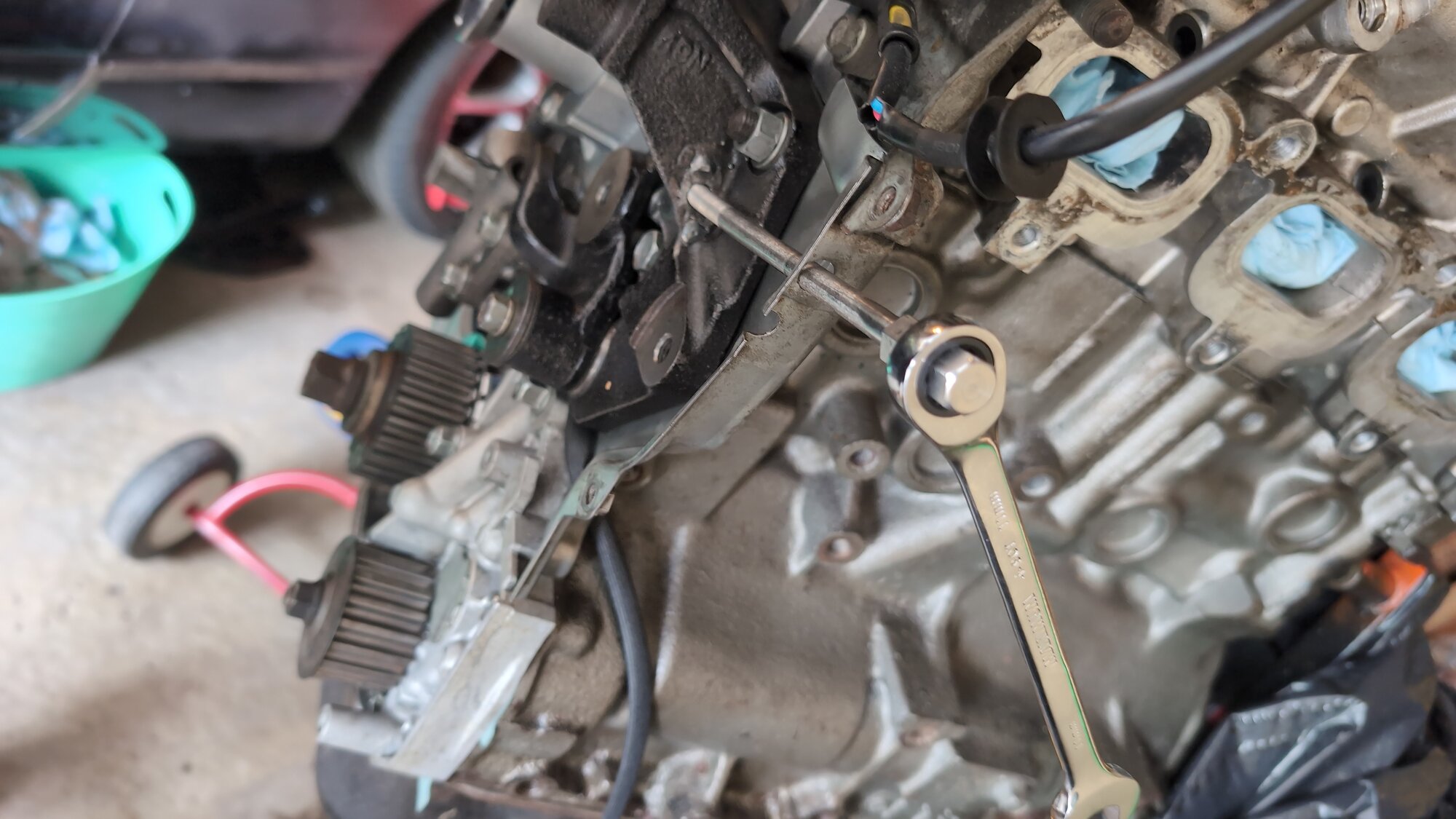

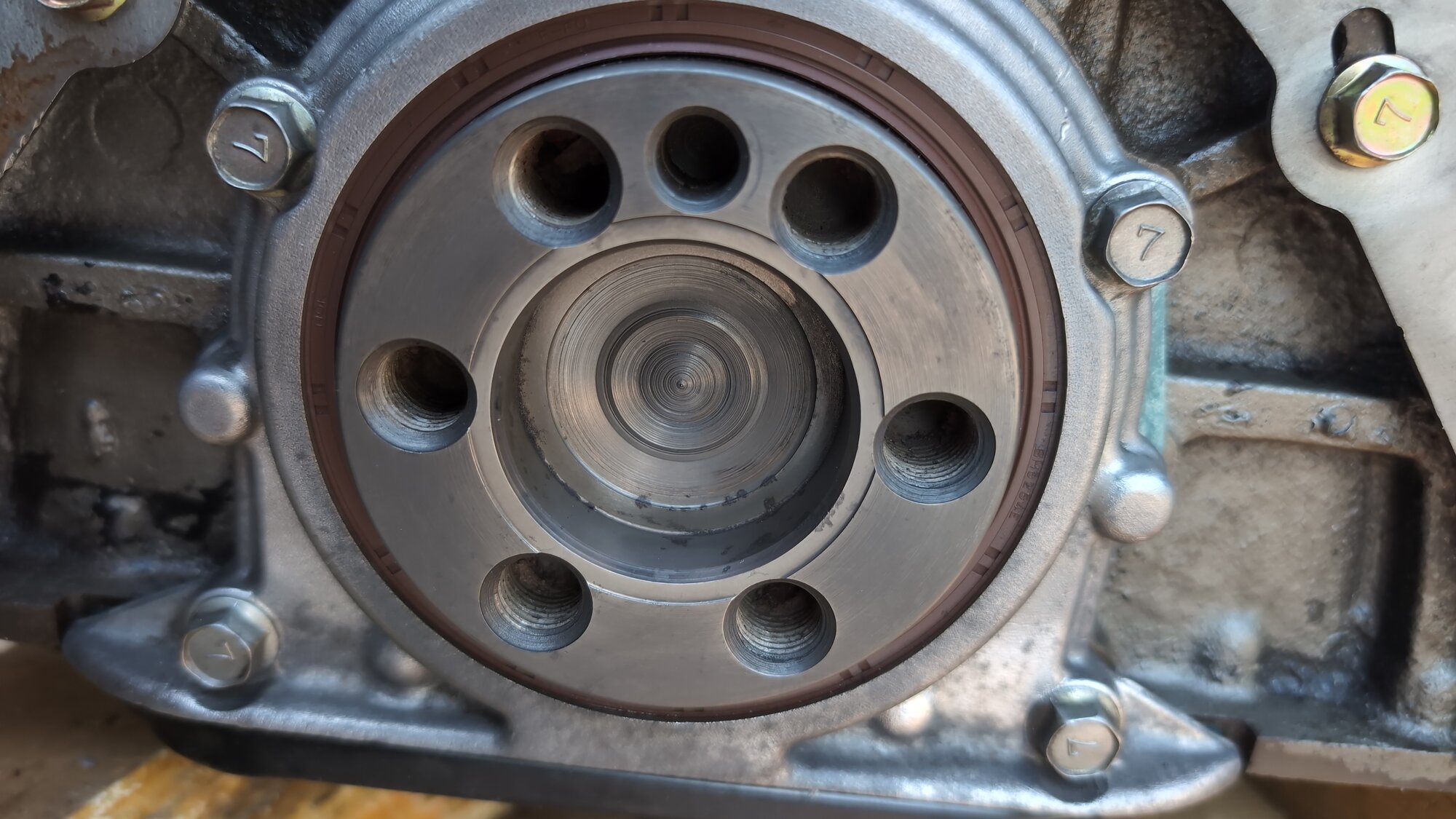

After taking care of the engine bay and rusty areas, I turned my attention to the block and head.

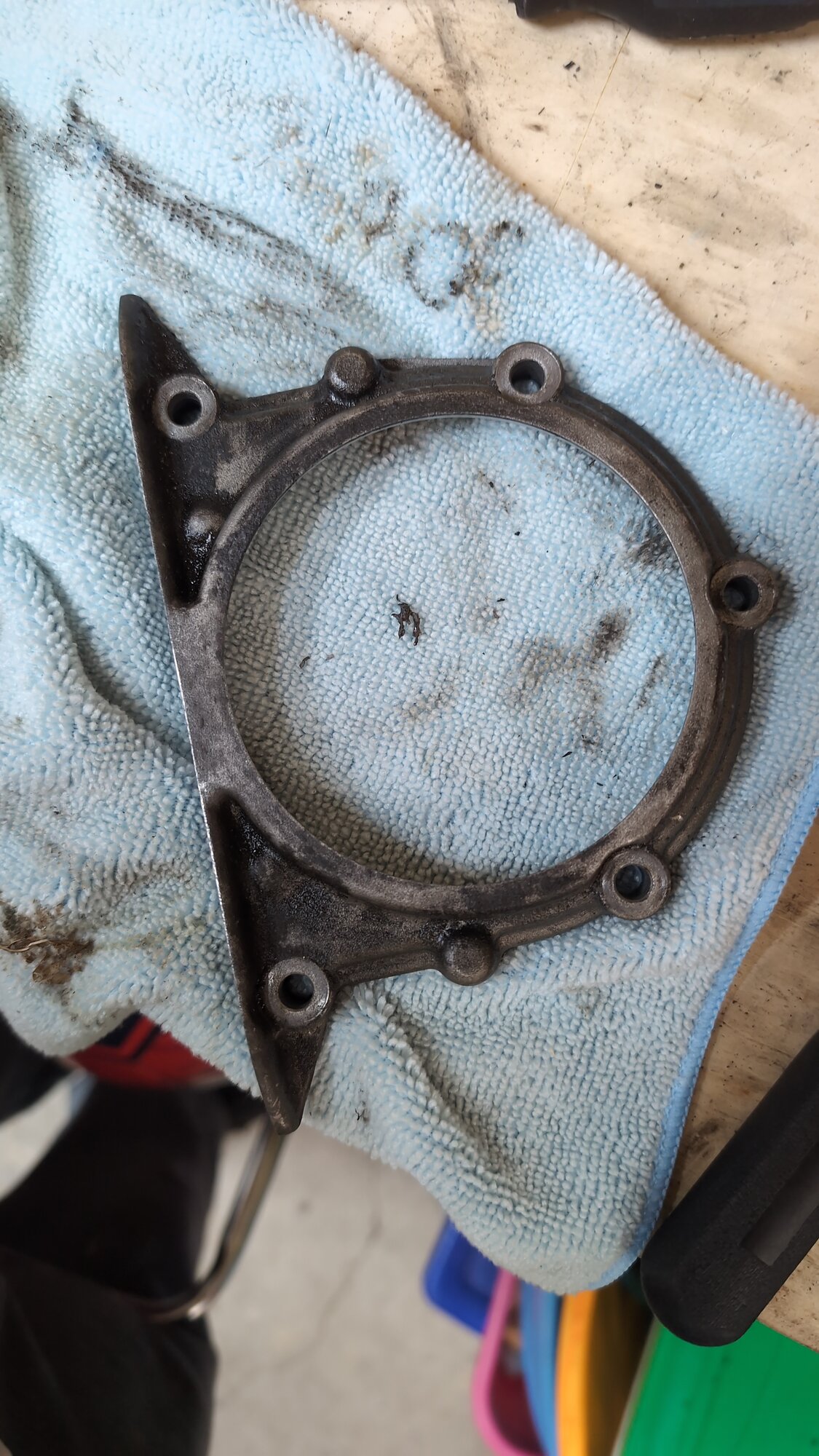

Gave the block a good de-greasing. Replaced the front and rear main seals.
So I decided to keep my 2ga head, and mate it to the 6 bolt bottom end. I've been told you need to drill out the headstuds to 12mm-1/2inch. I purchased drill bits to drill said holes, and the bits went right through without drilling.... pretty odd right? I guess someone had this head on a 6 bolt already? I'm not 100% sure, but yeah, I didn't need to widen any to get the 6 bolt arp headstuds through. Got myself an OEM composite headgasket from Amayama. New oil tube pick up gasket, new oil pan, new oil return gasket, new waterpump, new waterpipe gaskets, new, new.
Got the motor and the transmission united again and dropped my shell onto the motor. Didn't have a cherry picker, but this worked rather well with two jacks on either side of the car.
You might have noticed that big ass alternator wire...
While you're in there hit me a few times.
Decided to get rid of the oem power steering setup and switched to a volvo eps, put it where the battery was originally, and moved the battery to the trunk.
My battery relocation setup
TRUNK ---------------------------------------------------------------- ENGINE BAY ---------------------------------------------------------------------- ALTERNATOR
[Battery] - 0awg wire - [150a circuit breaker] - 0awg wire - [4 post bus bar] - 0awg wire - [100a circuit breaker] - 0awg wire
That bus bar supplies power to the starter (same gauge as oem), volvo eps pump, fuel pump rewire (I'll eventually move it back).
I used 0awg wire from the chassis to the intake manifold for a ground, and from the chassis to the transmission where the accumulator use to be. I also have two 0 awg grounds coming off the battery to the chassis.
With this setup, it fires up without hesitation from a cold or hot start. But I'm out of space for more pictures, another post incoming.

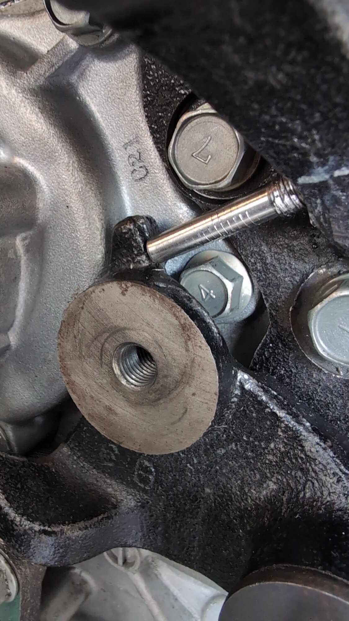

Oh, I forgot to mention, I wanted to retain the timing belt tensioner tool functionality from the kit I got from extremepsi. 2g mount on a 6 bolt block it wont line up. Thanks to jaffro and his video on modifying the mount, I was able to modify my mount and get it to work. It took more than one try, and several drill bits and taps later... but it works! I had to weld the original hole, and the first one I did as it didn't line up. Made two plugs from spare bolts. Torched the mount for 10 minutes before welding, put my mig on its highest voltage and sent it.

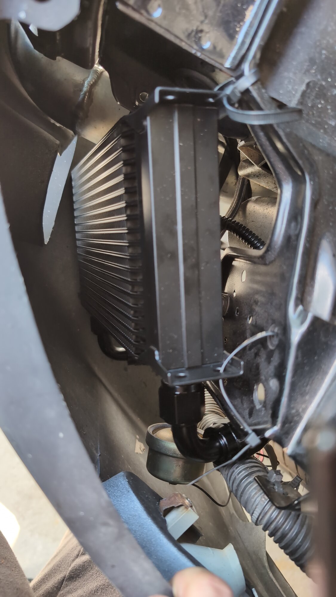

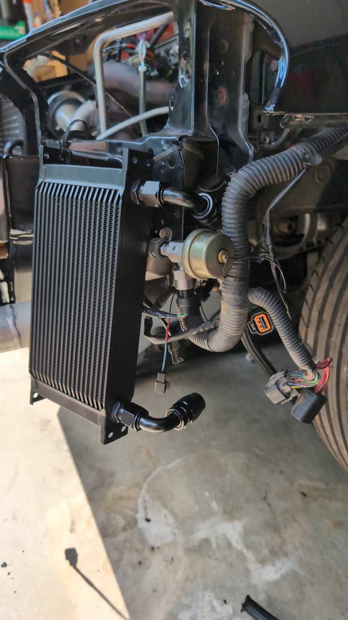

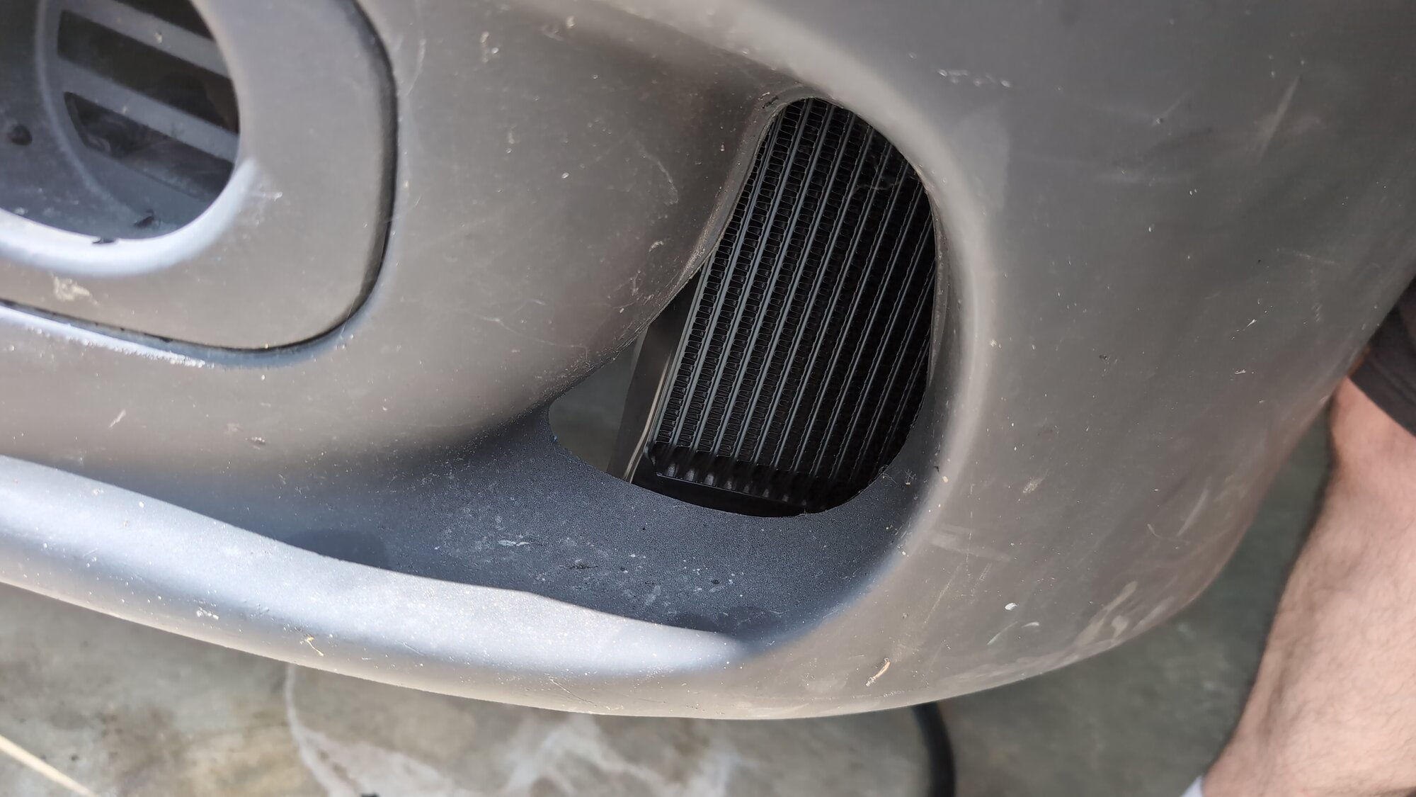

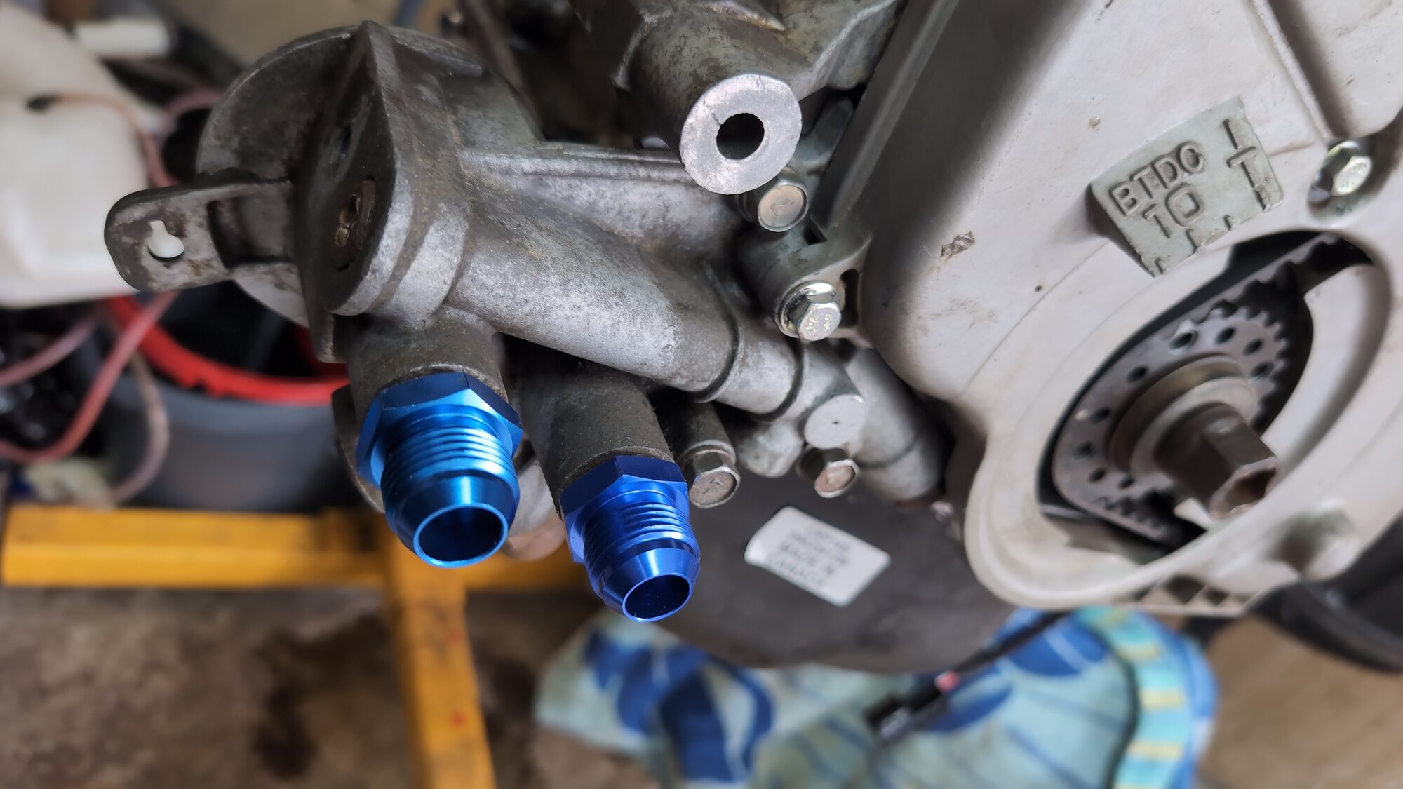

So I have a 6 bolt that needs an oil cooler now. Got me some fancy blue things to put on and some thick ass -10an line.
Positioned temporarily with zip ties to figure out a good position for the oil cooler. I ended up making 3 brackets to hold it firmly in place. Unfortunately I don't have those pictures available right now. There are two mounts that hold it up top, and one on the bottom that connects to the rad support area.
Added in all my fluids, checked for leaks, didn't seem to have any, so... fired it up.
Let it go through a heat cycle to bleed the coolant lines. Everything seemed to be fine. Engine sounded real healthy compared to my last one.

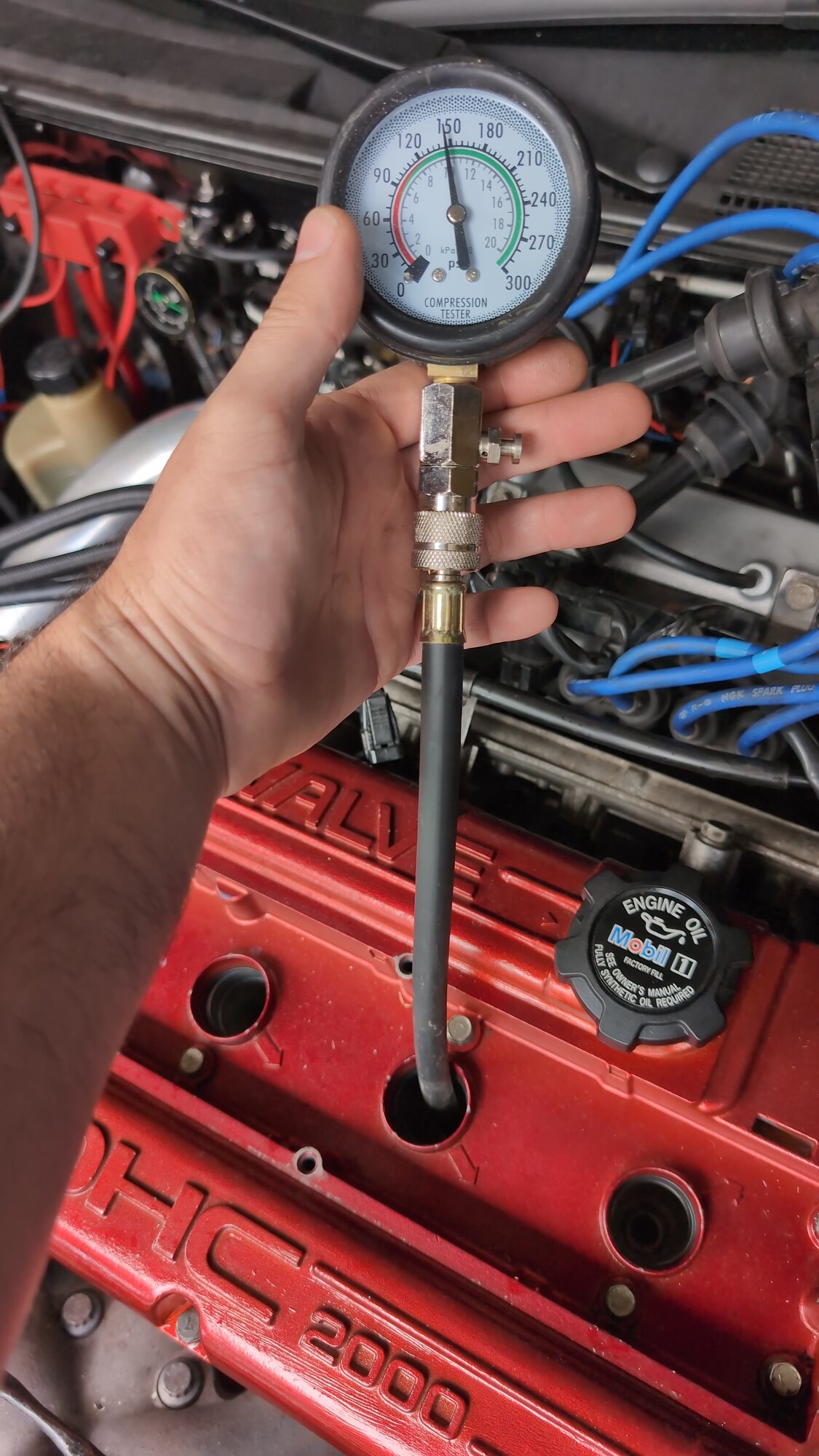

I checked the compression, and just like Mike said, 143-149 across the board.

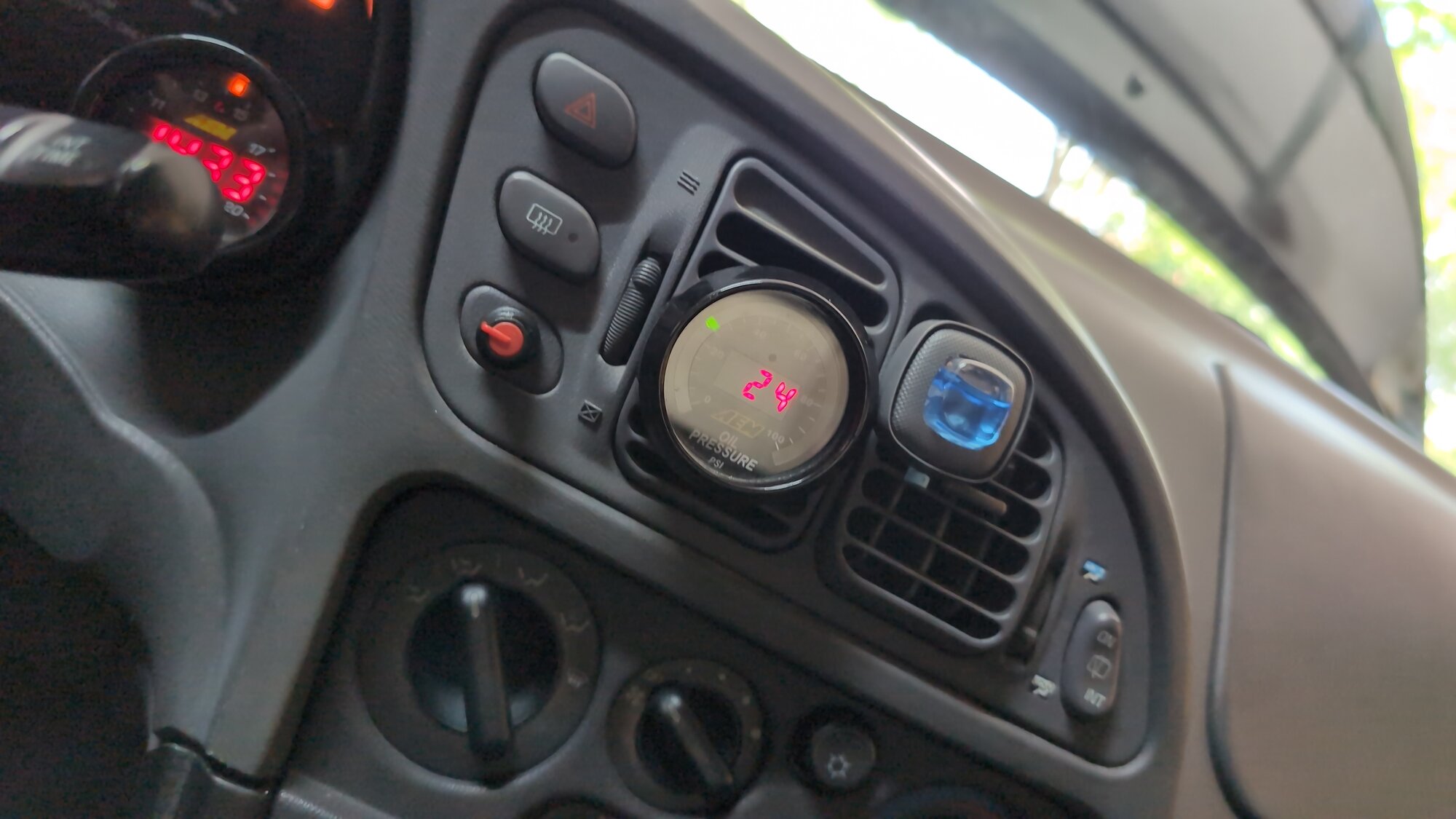

So.... one other thing, going back a few posts about the low oil pressure.
I took it for a little drive (I still have some 400 miles to break the clutch in), and after about 25-30 minutes I returned home and noticed my oil pressure reading 8-10psi.
This block has balance shafts eliminated. I expected it to be much higher, but I wasn't ....freaking out, just a little worried.
I had intentionally kept the remote oil sensor mount as I had previously as a test of sorts.
I bought a mechanical gauge to check the electrical gauge one, and both gauges read the same (they were tied into the same multi-port adapter).
Great, so I can verify the sensor is reading accurately.
I moved the mechanical gauge to a spot right off the OFH, and the numbers jumped by 5 psi-7 psi, putting me closer to 13-17psi at idle after the oil got hot.
So... oil pressure is good, engine is healthy.
I have a leaky valve cover gasket I cheaply bought off amazon that I'm replacing with a felpro one Monday. Hope to be driving it again soon and breaking this clutch in.
Going to need a retune with the compression ratio change...but clutch first.
