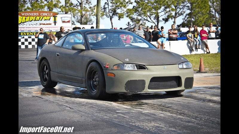

Update, I went to the track last night. Had some issues with the shift box but still went 9.90@143. Got my 60ft down in the 1.5x range with a 1.57 and 1.59 so that's good too. This will be my last time out for my season so I'm glad I ended with a 9sec pass.

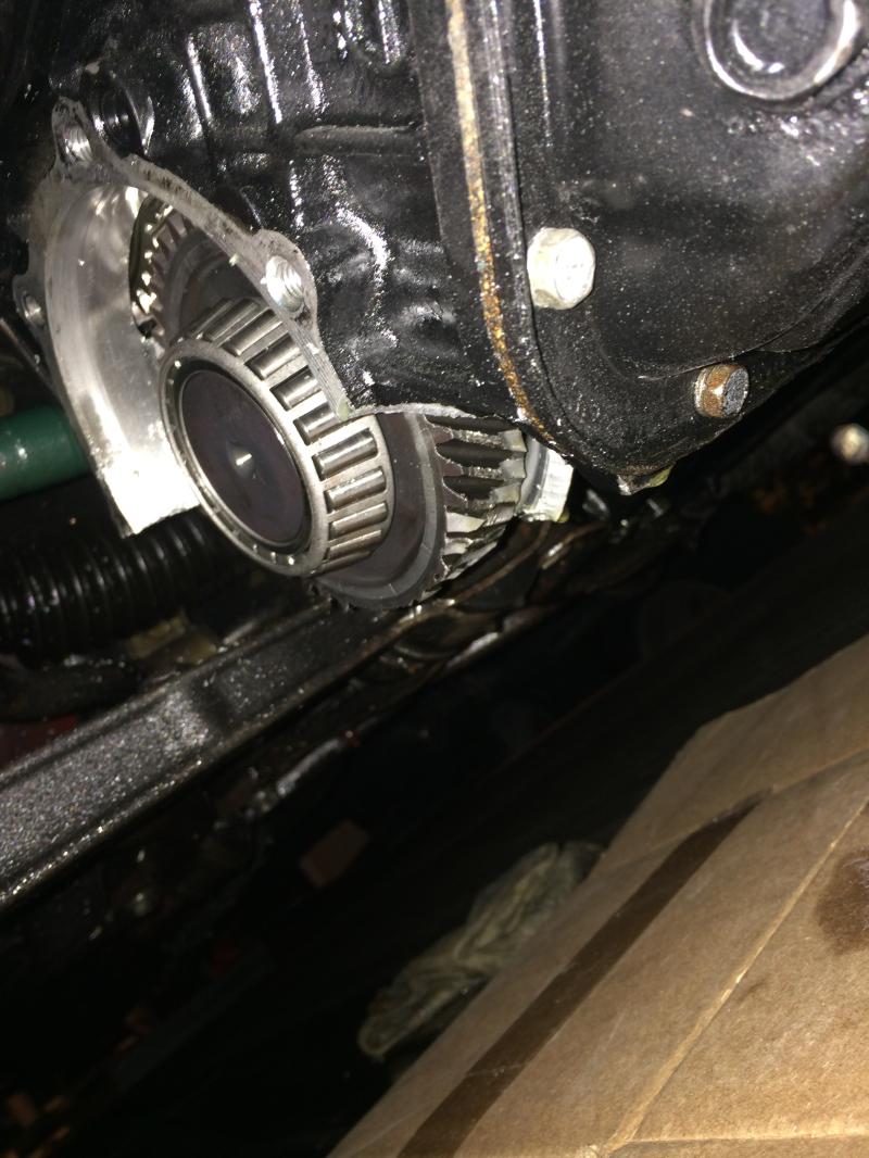

I havent really updated this is a while. The car has been on the same setup for years. Last time out at the track I was going 10.0@140 spinning. I had to drive the car to the track so it was 100 pounds heavier than my other passes. On my last pass it wheel hopped and broke the diff. While I have the trans out for repairs Im going to freshen up the block, do some head work, have the converter gone through, hopefully paint the car, and do some more weight reduction/aero work. I want to get a 9.5 pass out of it.

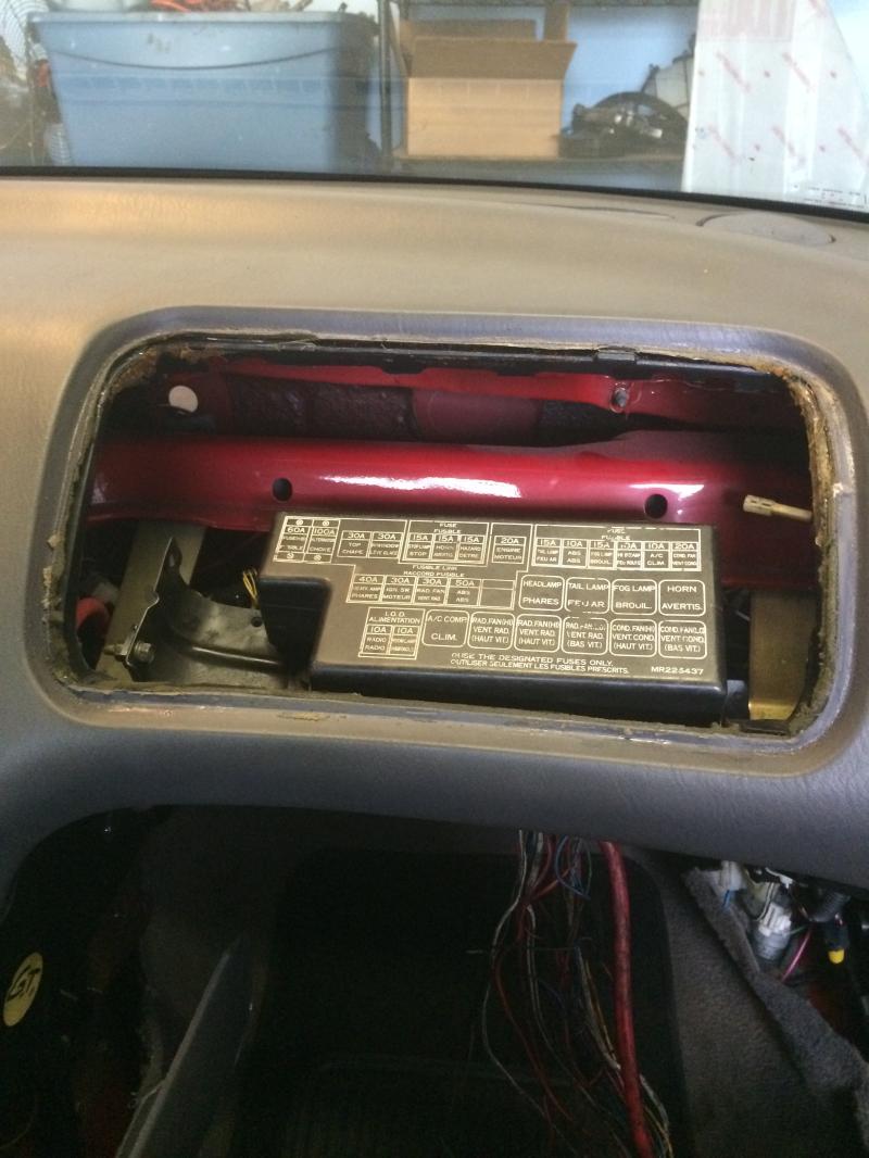

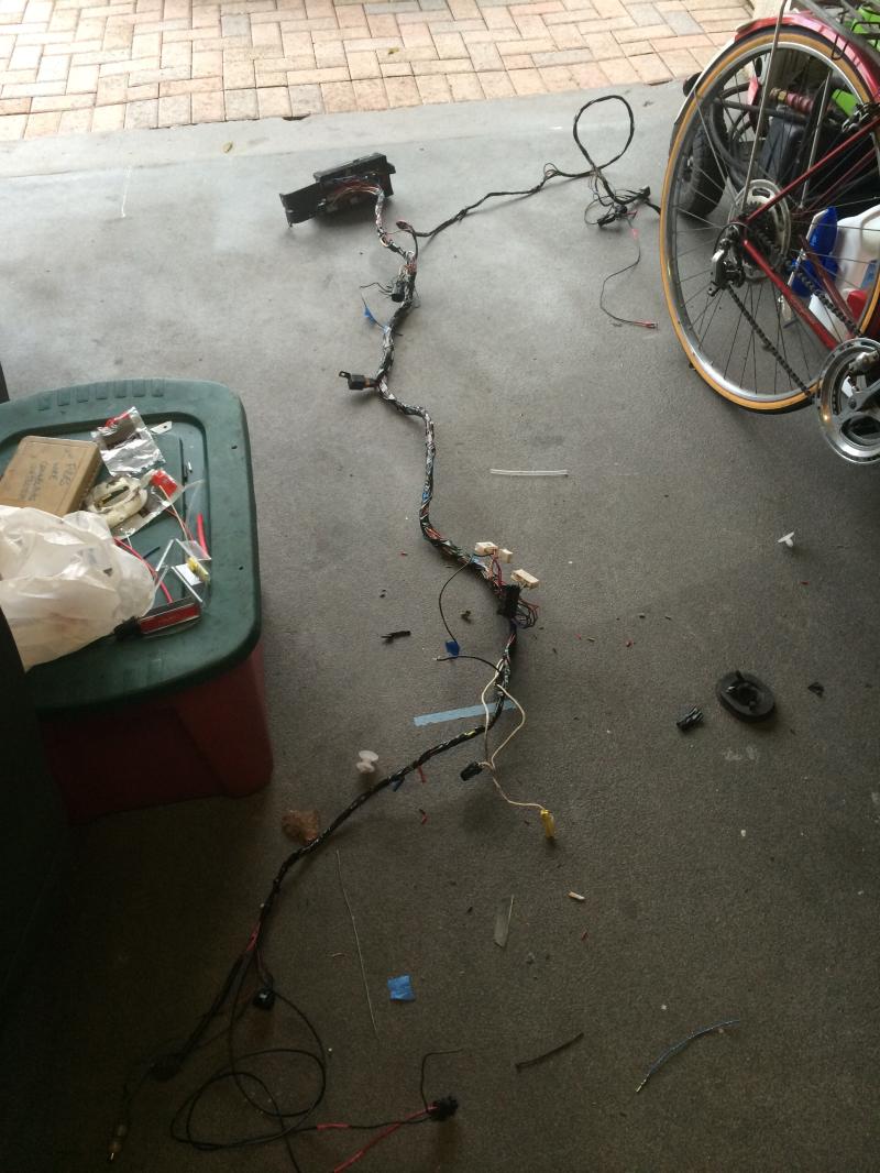

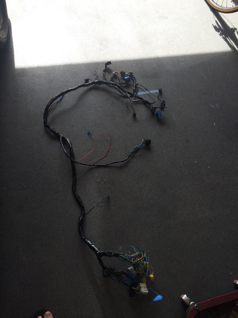

After the 9.6 pass the freshly rebuilt transmission decided it wanted to destroy itself. I think when the diff broke from wheel hop it cracked the transfer gears too. When they rebuilt it they didn't catch it. Anyways, while the car is down I've redone the engine harness.

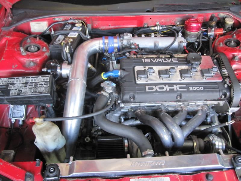

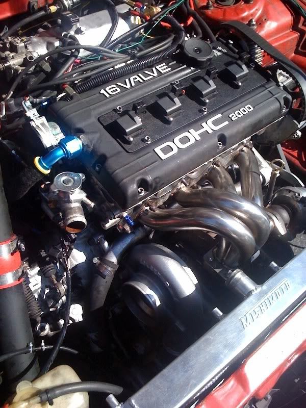

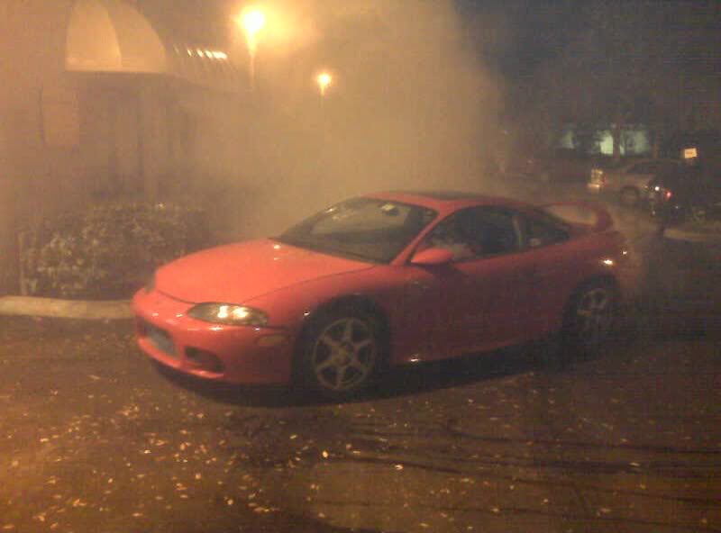

So, I picked up my first hx35. I used the stock divided back housing with an ebay t3 open manifold. Didn't do a ton of research about the oiling unfortunately. Went to tune and at 25lbs it felt good, turned it up to 30lbs and pulled harder. Well I wanted to see what the turbo was capable of. Turned it all the way up to 40lbs and couldn't get good logs cause I was still spinning the tires in 4th to about 120mph. I did a couple pulls and that's all it took to blow that turbo since it was being fed from the head.
This is how bad the turbo was smoking when I pulled back into the shop the first night I had it on.

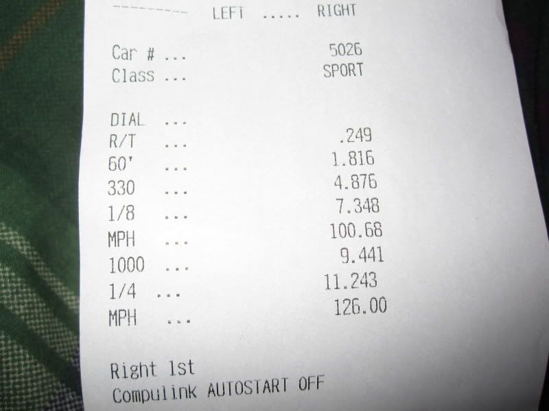

My first pass was 13.1@120 missing 2nd gear. I was pretty excited with the mph though and was thinking I was so close to 12s. I have never made a 12 sec pass with any car so this was a big deal LOL. The night got a lot better for sure. My next pass I hit 2nd and went 11.9@125ish so I skipped right over the 12s all together. I ended the night with my best pass being 11.4@125. This was on about 27lbs. It turns out my ebay manifold was cracked and a leaky BOV so the boost wouldnt go up.
Headed back to the track the next week and had another personal best of 11.2@126

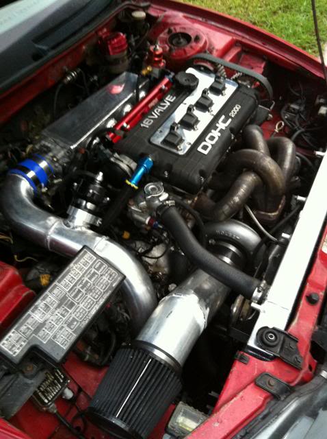

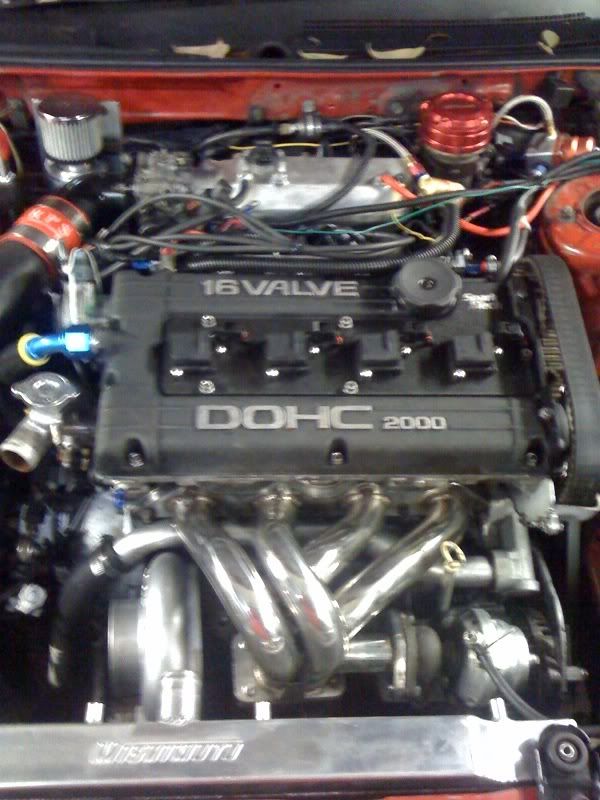

Changed the setup around a little bit. I added an evo3 intake manifold, 3in FMIC, tial BOV, and new piping

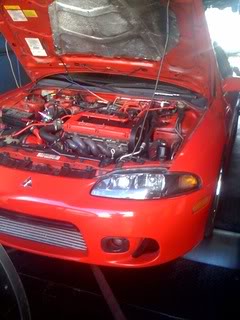

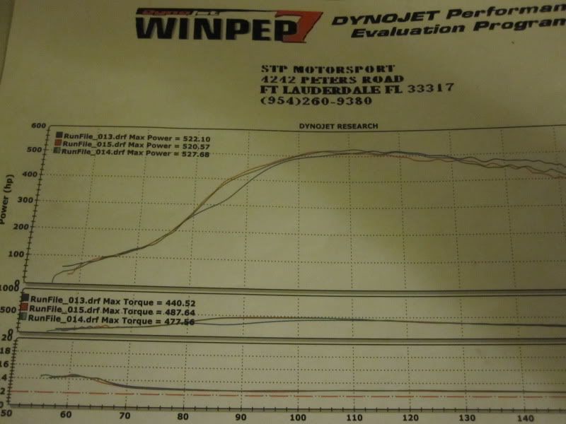

I then went to the dyno on the one walbro pump and 1600 injectors on e85. I made 527whp

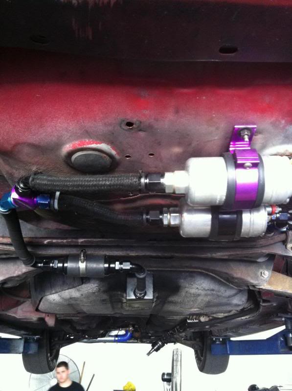

I was out of fuel though at 33lbs so I added an bosch 044 inline to run more boost. I turned it up to 38lbs and went back to the track.

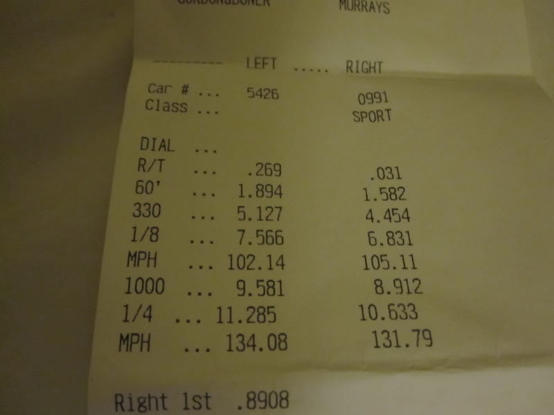

I new I had the power to run 10s and at this point no one had gone 10s with the hx35 yet. Well I was having some driver issues and it didnt happen tonight. I managed an 11.2@134.

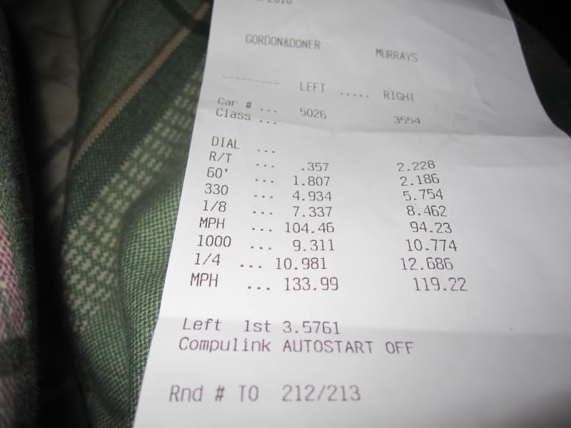

I wasn't the first to run 10s with the hx35 but I still did it about a week later. I went 10.98@134

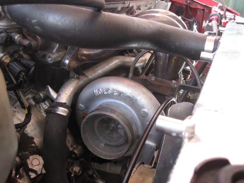

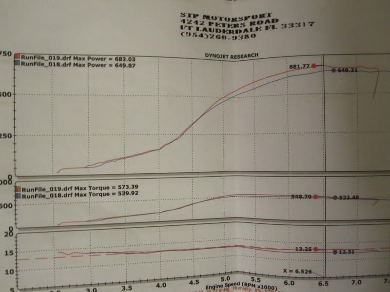

I thought I had figured out the oiling issue but I was wrong. I went to the track with this turbo and blew it the first pass. I then got another one and went to the dyno. Everything was good but turned it up to 40lbs again and snapped the shaft making 682whp.

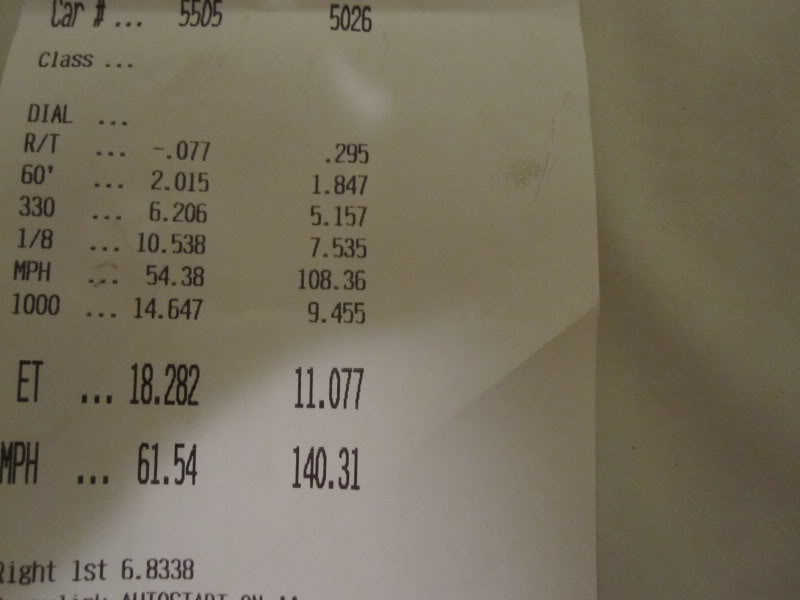

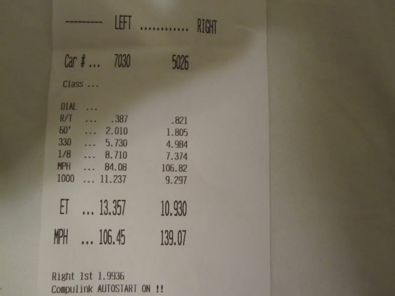

So I got an AEM oil pressure gauge and started logging oil pressure after the restrictor and now I have it perfect. Went to the track and ran 10.93@139 and 11.0@140.

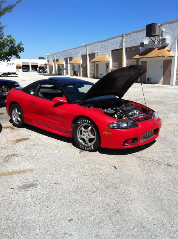

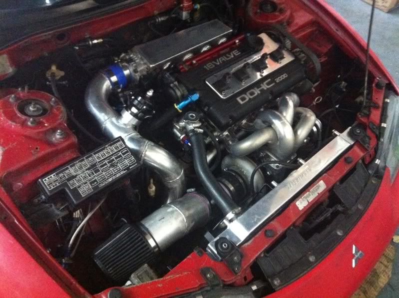

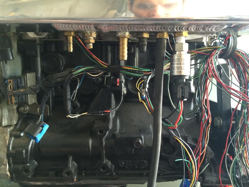

My choices were to get a twin disk or sell my 5speed tranny and go auto. I picked the auto swap. Another change in my setup and I ended up with the auto tranny with a IPT valvebody/shift kit, roadsurge shift box, rebuilt n/t throttle body by throttlebodies.com, and I switched to AEM EMS from DSMlink. Thats about where I'm at now. Im waiting on the shift box to come in so I can get the car running again and back to the track with the auto and some true slicks. Ill keep this updated as things happen. Here is the most current pic of the engine bay
