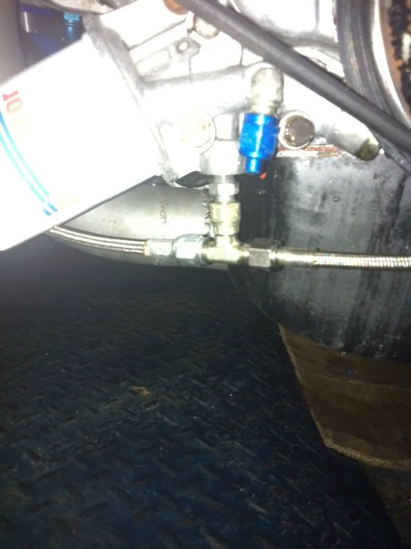

This probably isn't the best way to do it since it leaks a little but it works for now.

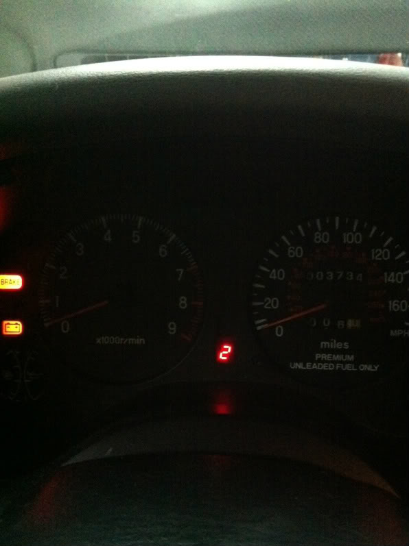

Also, I got the roadsurge shift box/digital delay box wired up and the car shifts great. Everything works which is exciting LOL. I just need to get the car tuned then its time to get ready for IFO in Bradenton.
Here it is running and driving. Still waiting on the tuner to get back in to town on sunday to get the tuning done. He did some drivability stuff already so it drives fine, I just cant floor it:(

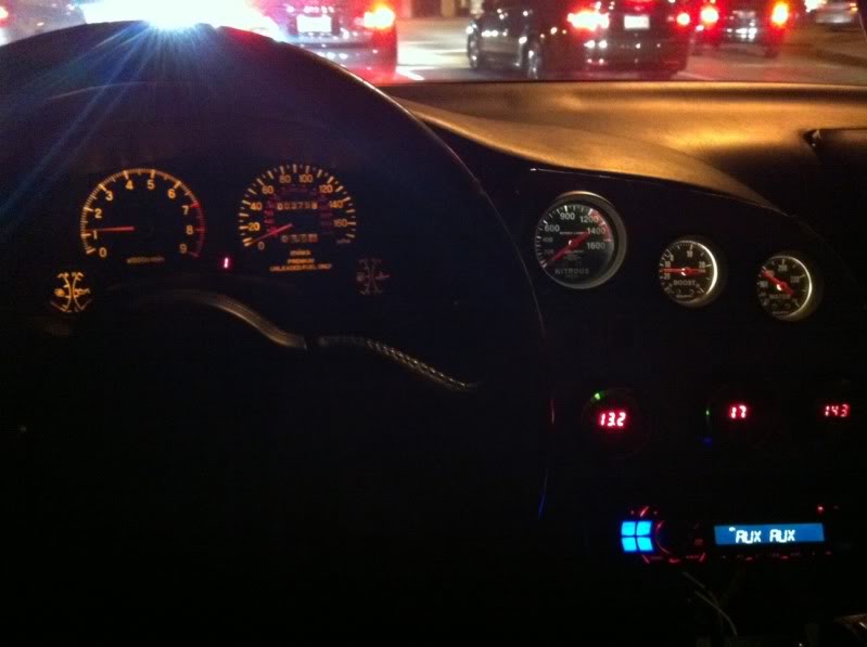

I like gauges LOL
Autometer nitrous pressure, boost, and water temp
AEM wideband, oil pressure, and trans temp.
