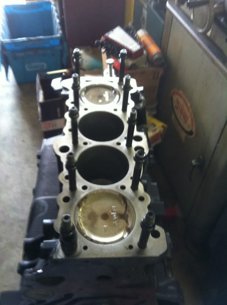

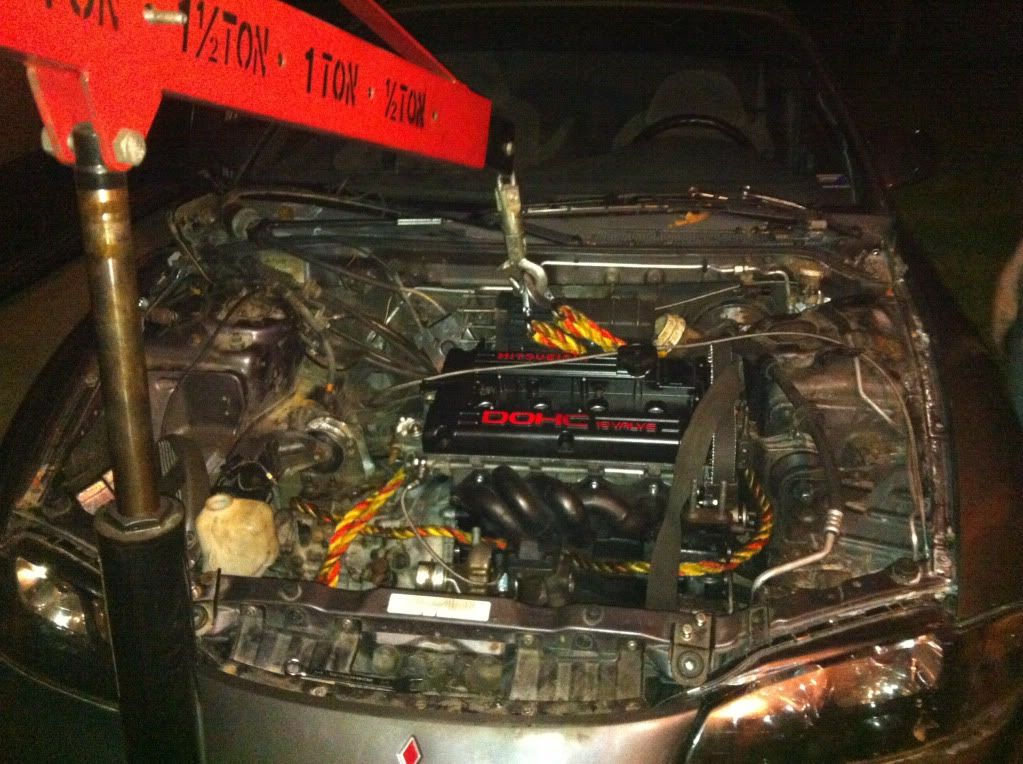

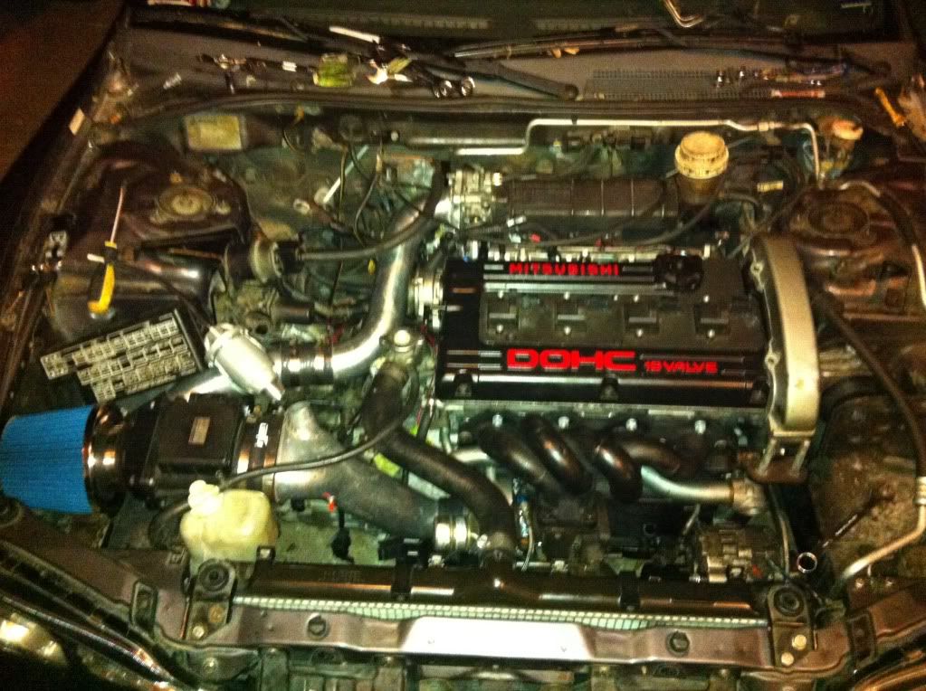

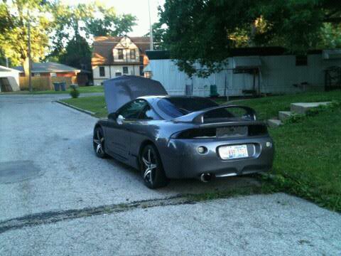

well i have here a 97 Eclipse GS-T this is my first DSM ive ever owned and now my first build ever in my life since it jump a tooth thank goodness no valves were bent:hellyeah: my goal is to have a mid to low 13 second street car just fast enough to piss off a few V8s hehe this first 3 pics is when i first got her off a friend when it ran right aha
had to pull the motor out the car:cry:

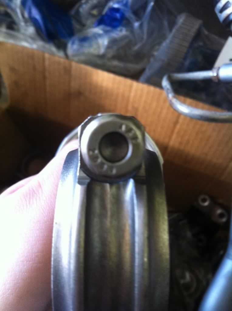

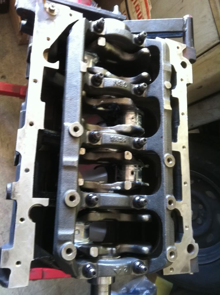

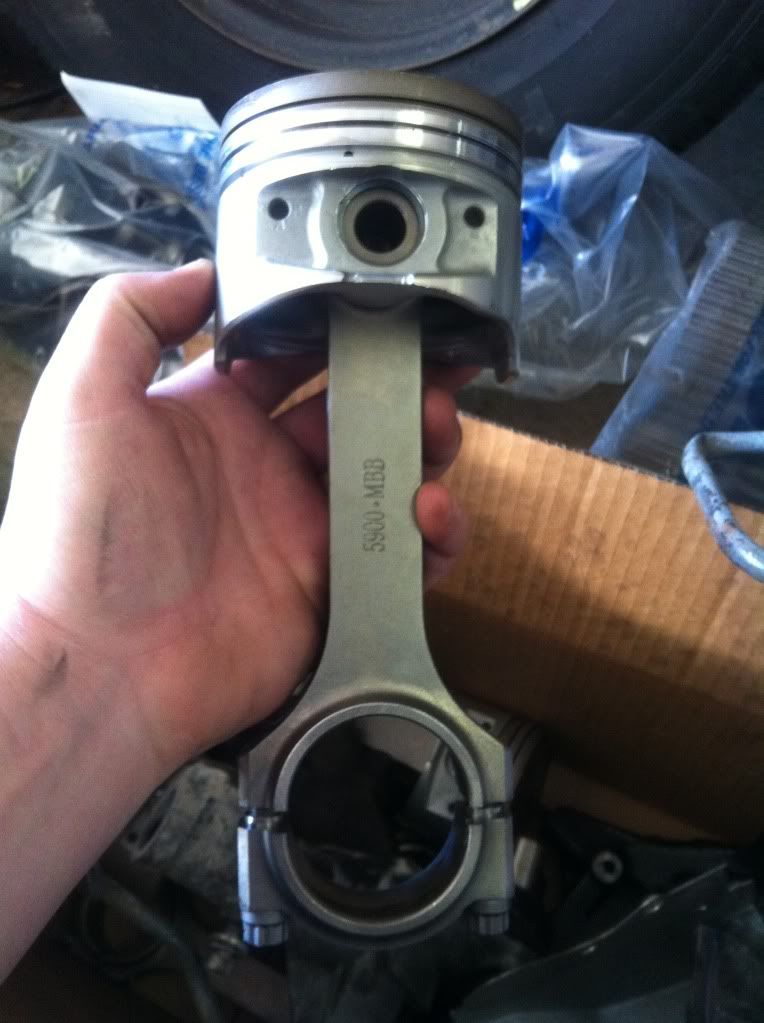

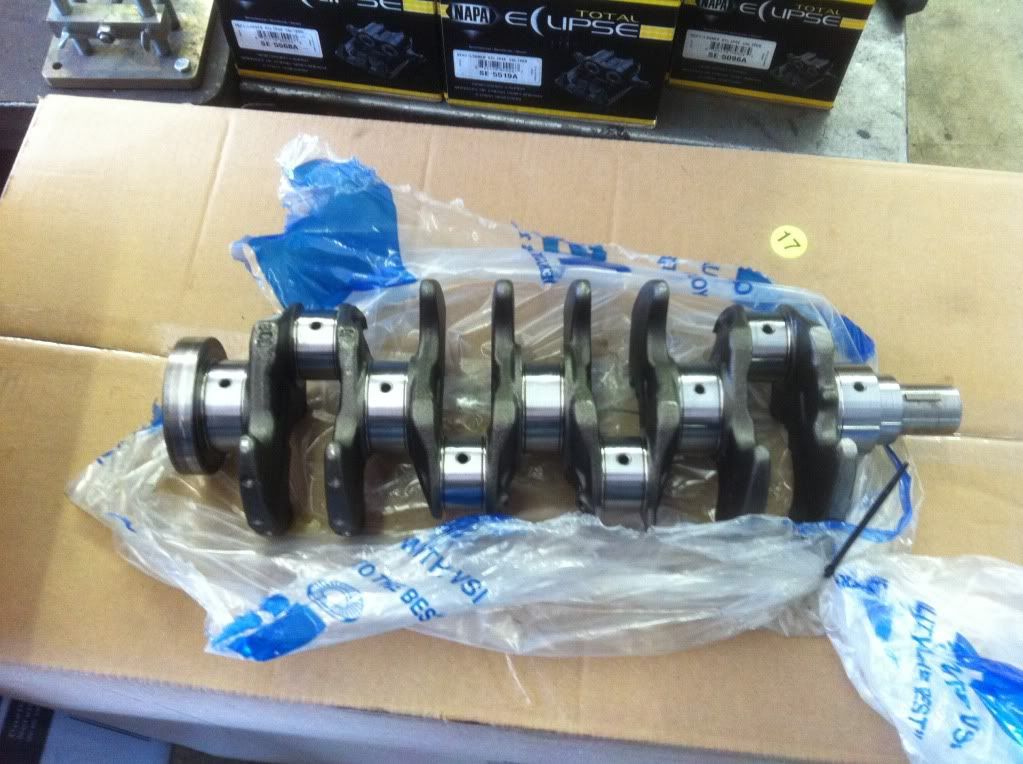

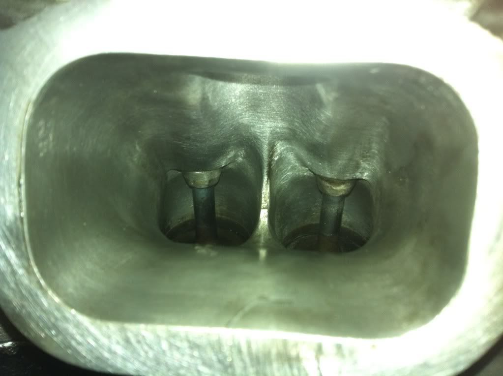

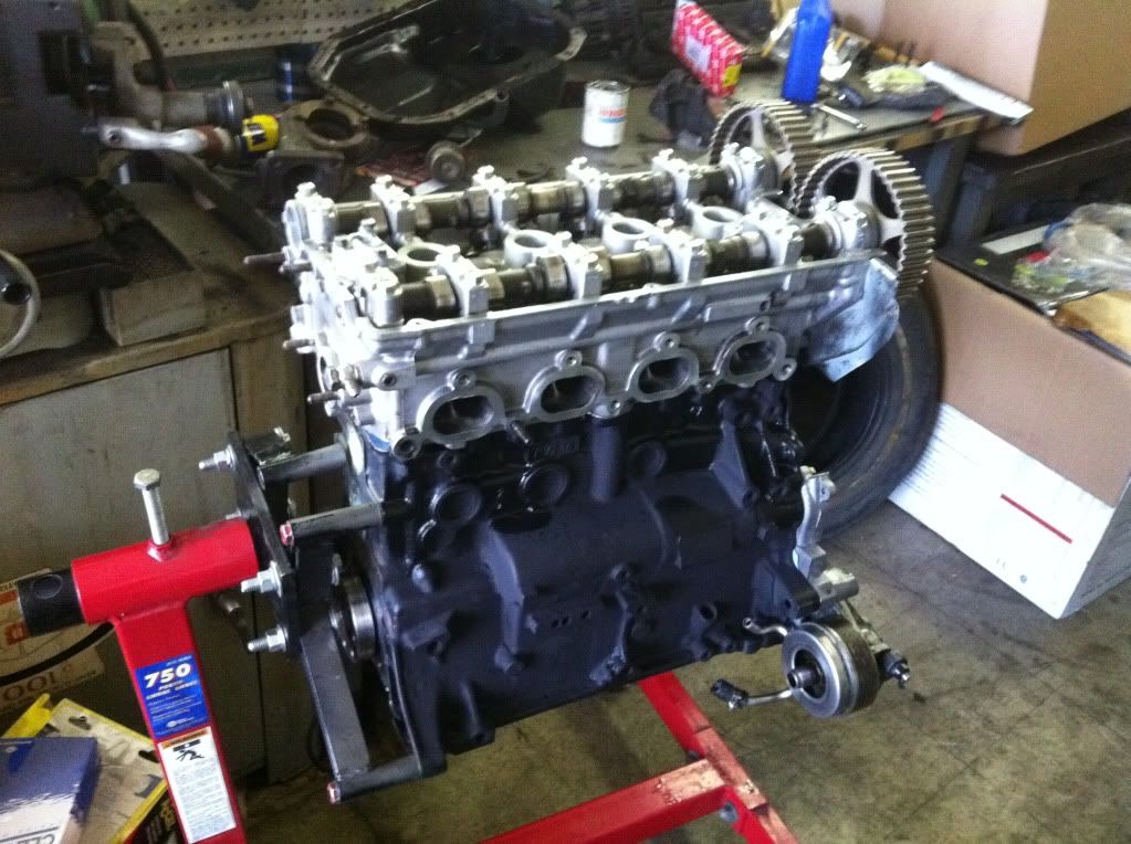

After taking it apart at work since i work at a parts store and have a machine shop to my disposol hehe i got all the tools i need but i didnt do none of the machine work bcuz i would of broken something but i did find h beam eagle rods and ported head which is a 1g and all arp hardware so off to a good start money i dont have to spend ya! machinist did everything to that motor hone cylinder walls reconditioned ect ect.had to get a valve job on a few valves ugh! but only ended up spending 250 for everything since i know the shop on a personal level but i took about a month and a half to get it back :( currently have your basic bolt on all injen piping hks ssqq v3 bov supra side mount and stock t25. here is a few picks when i got it back from the machine shop finally
this is were my car stand as of looks i love the stock body of the car only thing i did was get new rims! stock 17 from the gsx brand new in the box when i got these still in the mitsubishi box when they were made in 98 and of coarse there on the car

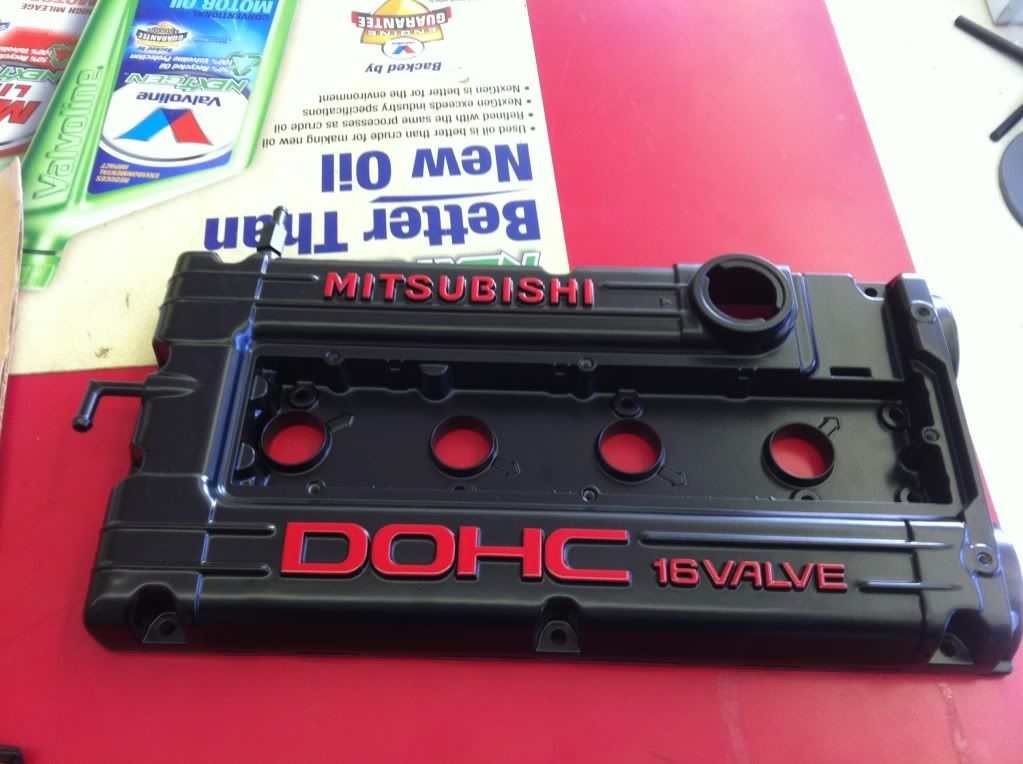

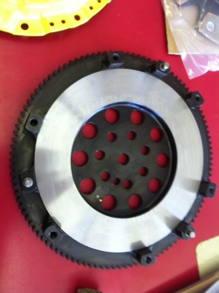

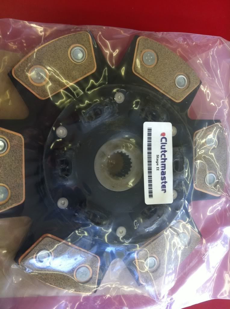

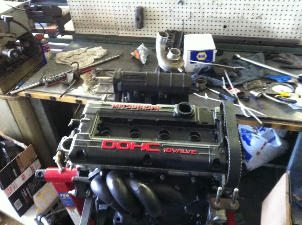

current state of the motor its still at work just waiting on taxes to finish her up only things i need is the tensioner pulley for timing and clutch and flywheel and need a new valve cover since the car had a crack valve cover and thats basically it when i get her running def will post the vidoes up and hopefully run her at the track my set goal is around 16-18 psi
