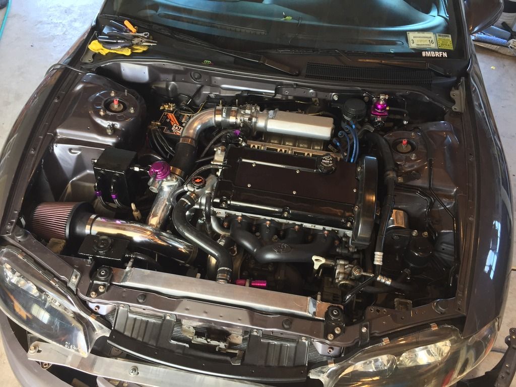

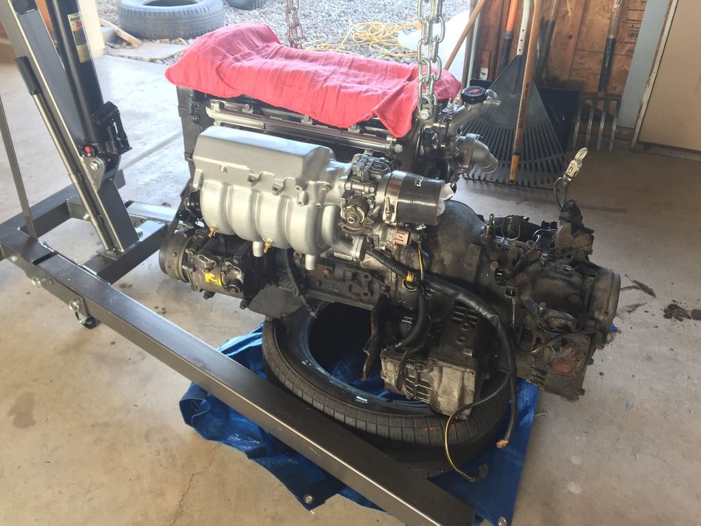

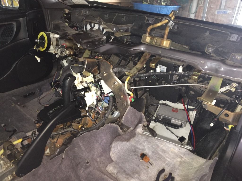

This is my 1997 Eclipse GST, I've owned this car since I was 18, started off stock doing just maintenance and then put a 16g on it, right now I'm redoing the engine bay. The car has a new rebuilt head with hks 272's, 3g lifters and a evo 8 valvetrain. The power steering lines are already tucked, and this spring I'll be swapping non-abs brake lines, putting the battery in the trunk, and tucking the air conditioning lines. It has a full -6an fuel system with a rewired 255. The car also has a tucked milspec harness, and will be running on ecmlink with speed density.

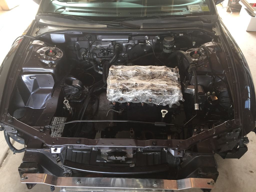

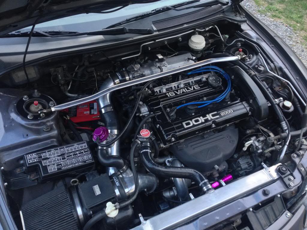

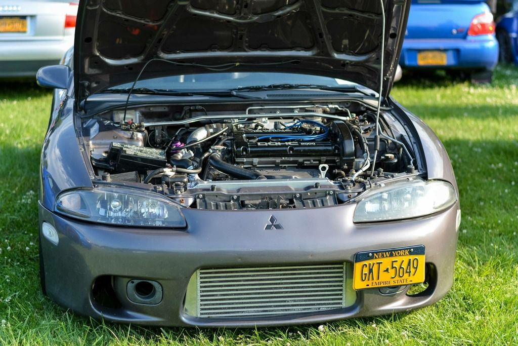

Pictures of the car running are from 2014 with the older maf setup, bay pictures are from my current build before I decided to pull the engine and start over.

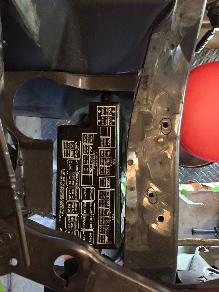

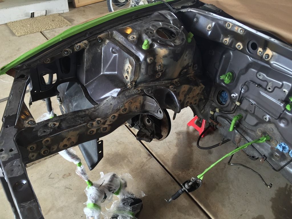

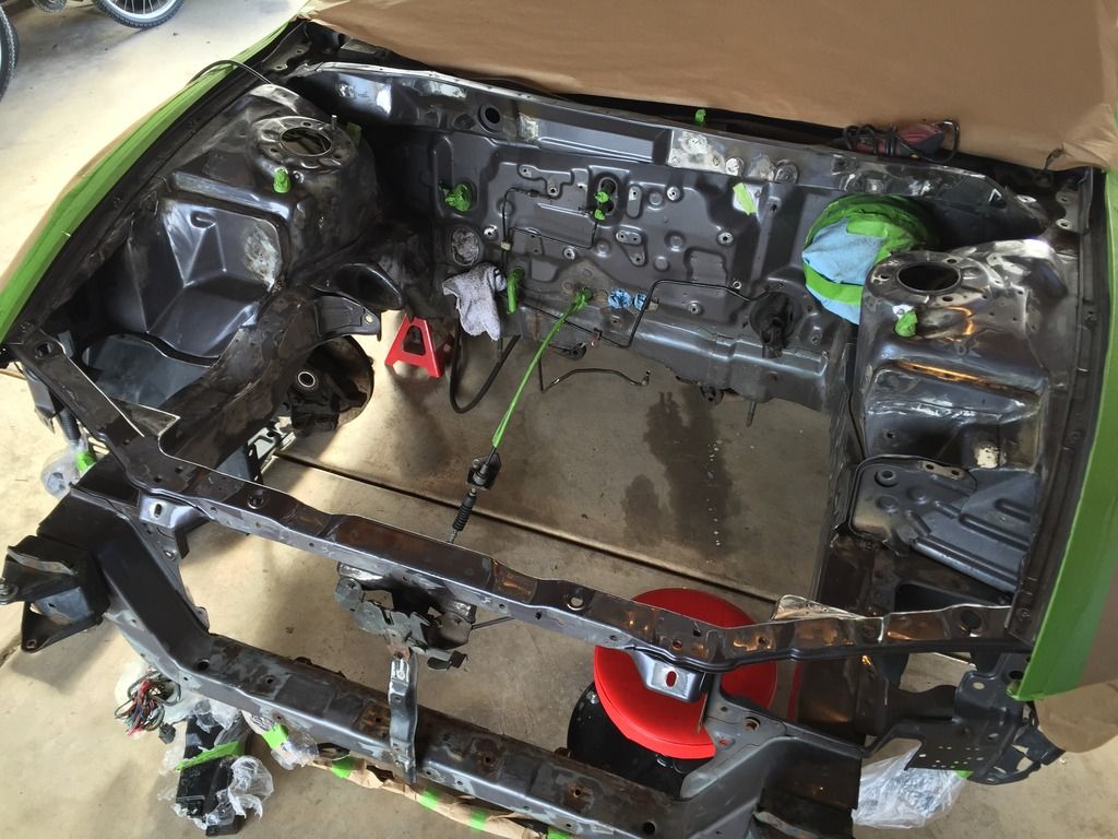

Been doing a lot of sanding and grinding, welded shut all the unused holes. A bunch need to be gone over again, but I'm making progress.
Fuse box mocked up..not sure how I'm going to trim the rest of the sheet metal yet
