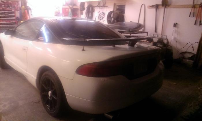

my sick 96 Eagle Talon TSI AWD street build

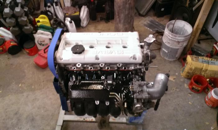

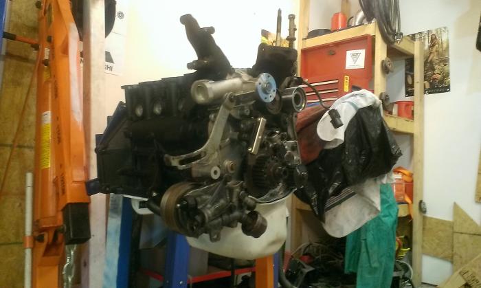

well I got my new crank and king bearing droped into my block today. starting to come together. also got my OFH ported as well. I had 2 trys at this since I had 2 OFHs, 1 from the engine I just got, and then the 1 from my engine originally. I was planning on using the one from my engine originally for the simple fact that it is cleaned and everything looks good on the coolant connections as apposed to the 1 that was on the engine I just got, 1 of the coolant hoses is kinked pretty bad and would chance putting it on my fresh block.
well heres pics.
IMAG0259_zpsacc23a84.jpg Photo by countryDSM | Photobucket
IMAG0262_zps699d1d97.jpg Photo by countryDSM | Photobucket
IMAG0267_zps8b1dfbd3.jpg Photo by countryDSM | Photobucket
IMAG0266_zpsbecc31fb.jpg Photo by countryDSM | Photobucket
let me know what you guys think. not able to bolt the girdle on just yet, waiting on my ARP main studs

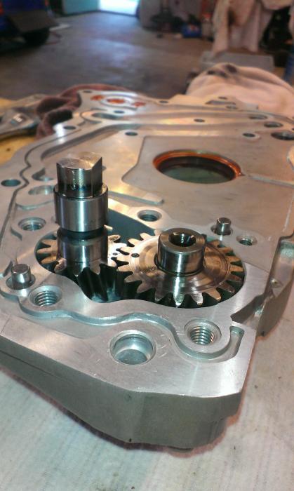

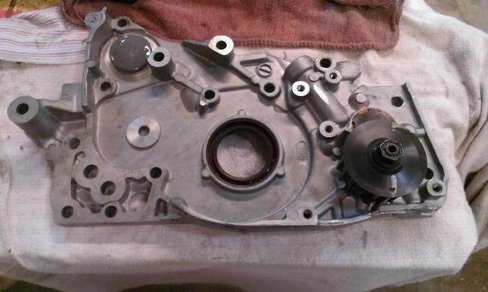

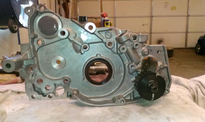

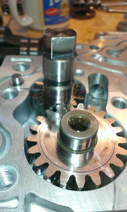

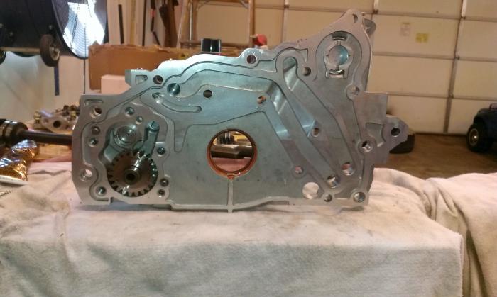

heres a short update of my build. the engine I picked up for parts had a brand spankin new front case, oil pump, and water pump. so I processed to take the new front case apart because it also had the BSE kit done to it. I was going to see if I could have gotten lucky to get another GOOD stub shaft. not the cheap ebay 1. well I wasn't that lucky. it had the bad stub shaft. would have seized up within minutes. but I did take my good parts from my original front case and put them on the brand new case. the guy that did the kit on the new front case didn't seal the metal plug very well so I made it right with some jb weld on the front and high temp copper gasket sealer on the back, don't want that to be leaking ofcourse once everythings put together and running. :thumb::D

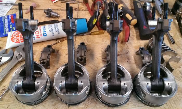

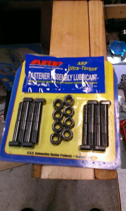

got these arp rod bolts from Matt. thanks buddy.

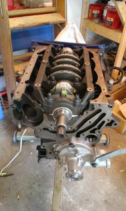

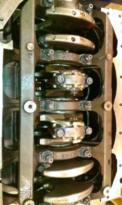

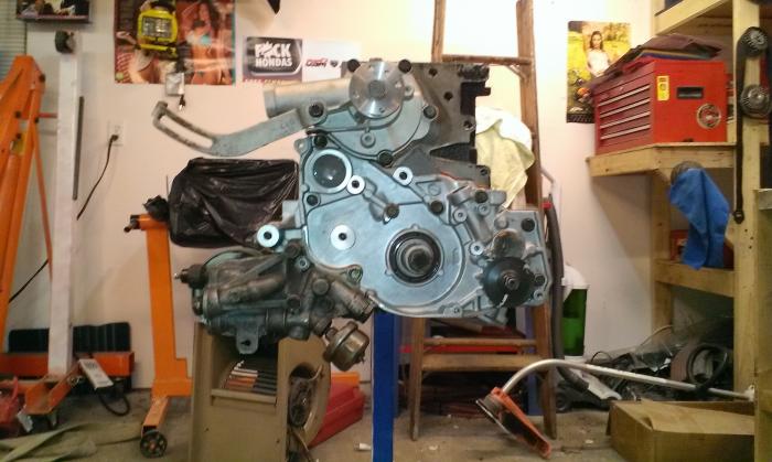

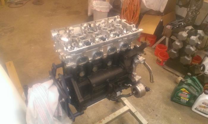

today I finally after waiting awhile because of my DD breaking down, was able to put on my main girdle and get it torqued down. and yes I did the torque to 60 in 3 steps, (20, 40, 60) then loosen then repeat x5. wasn't for sure if the ARP mains studs are torque to yield so I did it anyways.

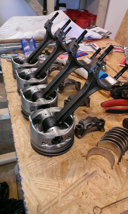

I also got my ARP rod bolts put into the rods. so tomorrow they will finally go into the block.

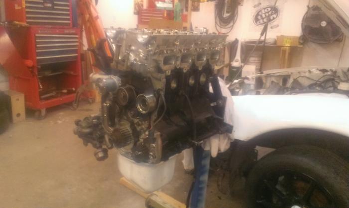

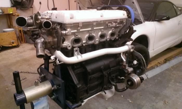

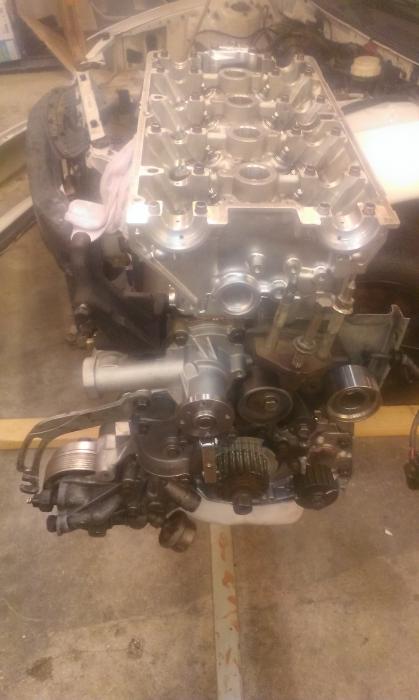

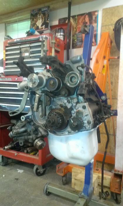

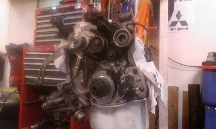

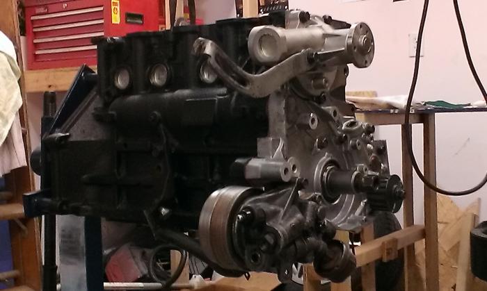

I'm sure you know, but as a friendly reminder, in your last 2 pictures, your alternator bracket is upside down on your water pump ;)
yes thank you. I noticed after I put the water pump on. when I was setting the water pump the gasket sealer was drying rather fast so I was in a rush to put the water pump on and just slapped the alt bracket on
ive also had to take everything apart due to a broken main bolt as well. so these are taken after the bottom end was put back together.

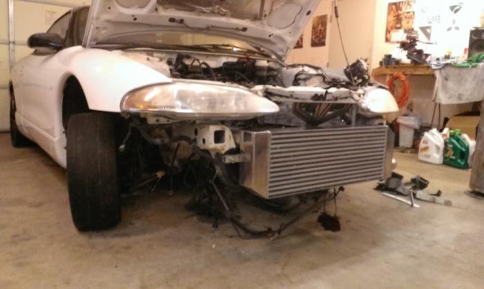

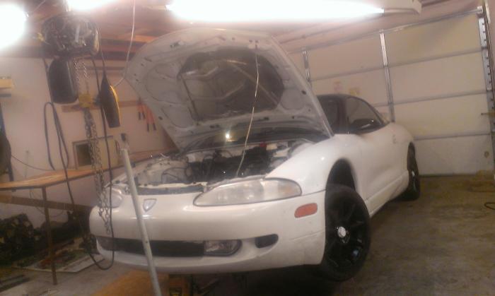

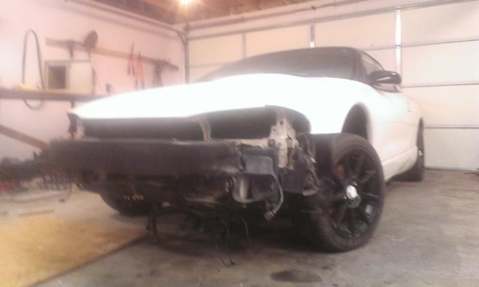

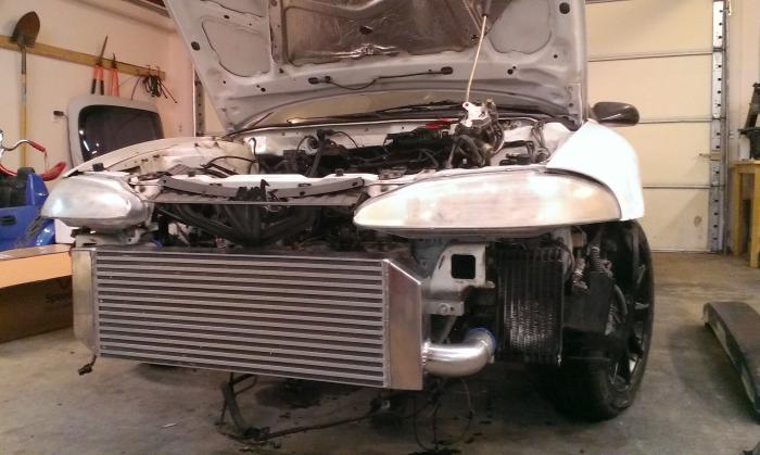

Over last weekend i got around to having some time to mess with my talon. I went ahead and got a new crank trigger plate since mine was pretty wallowed out in the center and it was farely cheap. I got the front umper and headlights all taken out and ready for a FMIC when i get one andalso deleted the A/C

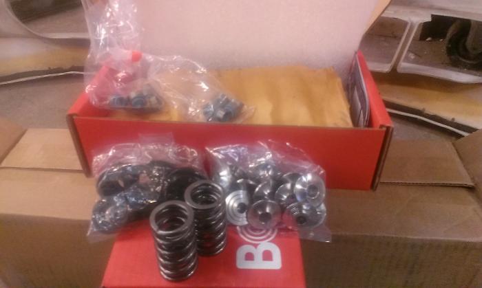

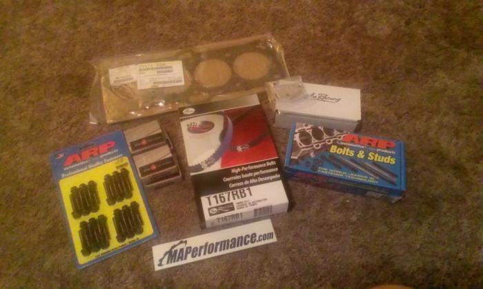

I havent posted in a few day. But lately ive been doin a few little things things with the taling build. Found a new "new to me" hatch to replace the primered 1 that i had before. The old 1 had rust underneath. And got in my new bc cams, bc dual springs and Ti retainers, bc valve stem seals, kiggly HLA, gates racing timing belt, ITM revised 3g lifters, ARP cam cap bolts, ARP head studs, and head gasket. Will be getting the AEM True time adj cam gears and BC billet steel keepers soon, then everything is going to the machine shop to get ported, polished, 3 angle valve job and assembled.

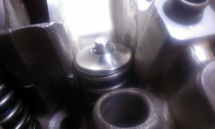

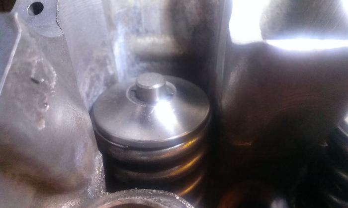

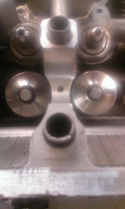

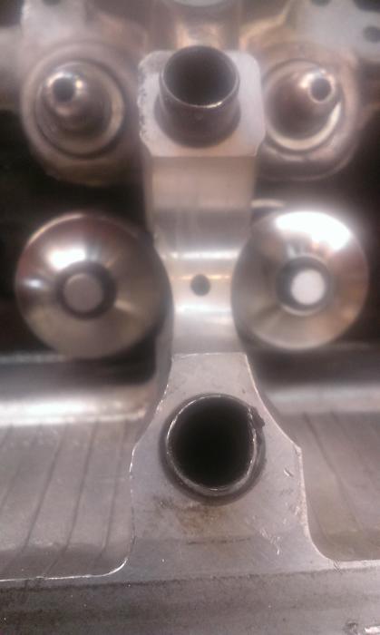

I haven't posted for a few days atleast and have a few updates. I ordered in a set of ferrea copper exhaust guides and ferrea bonze intake guides. a couple weeks ago I sent in the head to a local cylinder head shop to get it milled, a valve job done, cleaned (hot tanked), even tho they cant hot tank a aluminum head, and everything assembled, which taken everything to this shop was a huge mistake on my part, I will never go back my self.
I work out of town at the moment so I was not able to pick up the head once it was done, so I had my wife pick up the head and I should have coached her on what was suppose to be done and what to look for. I get home from work late that night, and come to find out he screwed up my cam cap dowel pins, paint runs all over the intake and exhaust mani mating surfaces, the head was not cleaned what so ever, on 1 of the valves, the keeper was not installed flush with the retainer, and everything else, ie cams, rollers, lifters, hla, etc wasn't assembled.

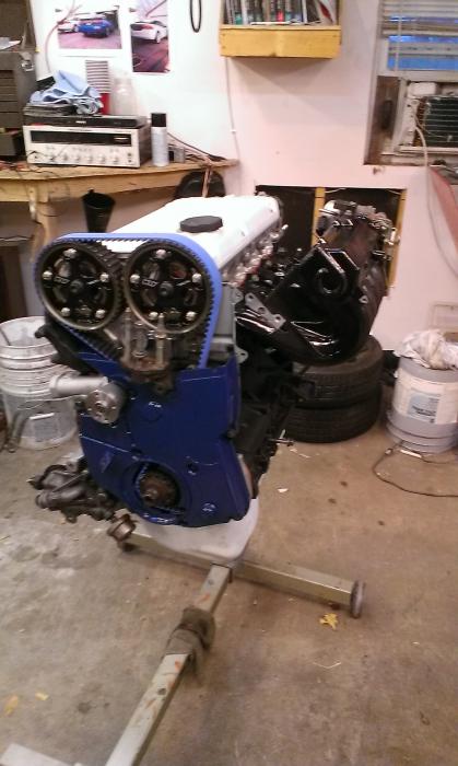

but anyways im still waiting my cam cap dowel pins to show up so I can install everything else, but here are so updated pics.
I did fix the keeper myself, and got the paint runs off all the mating surfaces.

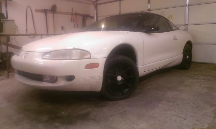

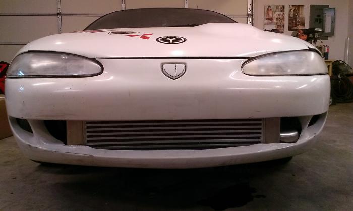

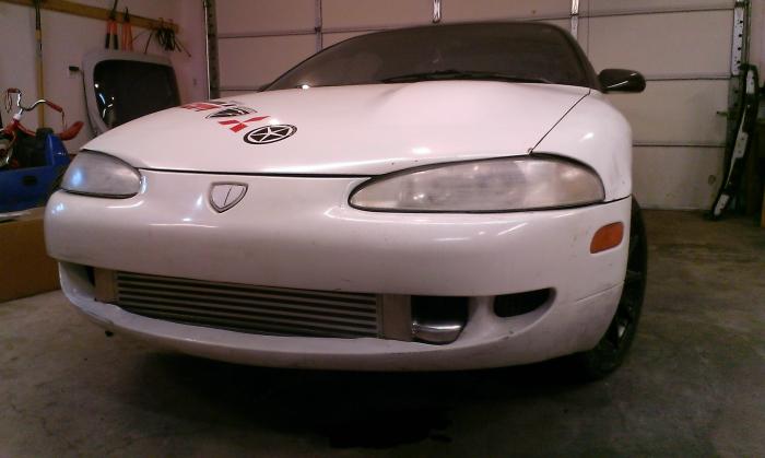

Havent updated this for a while now. But i havent made awhole lot of progress but i have done some things. Heres the latest pics of my talon and build.

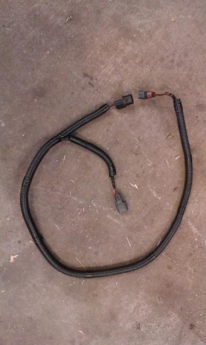

This is the cas harness i built for my 1g cas to 96 talon harness
Don't forget to get a good aftermarket trans cooler to keep that trans lasting for a long time bro... and relocate that thing to the passenger side where the SMIC used to be. It will help with I/C clearance, get rid of the nasty looking metal lines that are like 5' long and make your trans cooler lines like 2' each way instead of like 5' each way
Slowly but surely its about to get there. Looks good man, just thought I'd chime in too. (Matt's Dad) Like your love of advertising!!!
