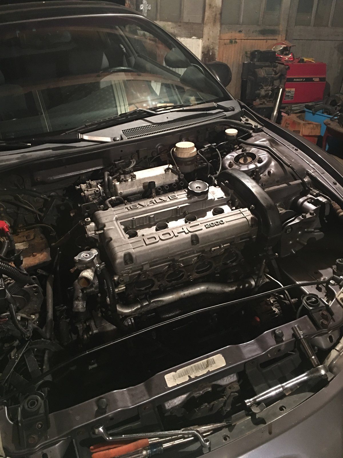

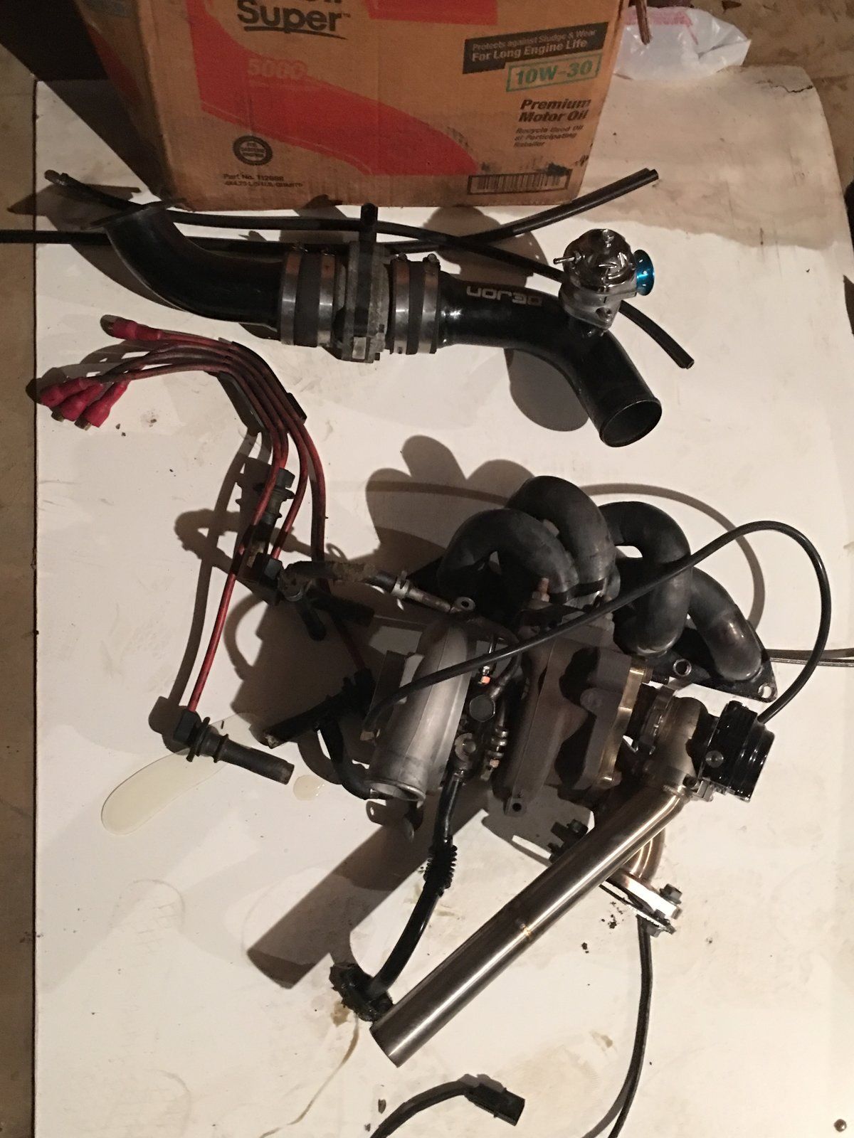

Okay I got a good bit of work done tonight. I removed the turbo and all associated equipment. Things are going great so far. I'm pretty eager to see what shape the bottom end is in. At this rate I'll have the motor pulled in a week or so. Here's some progress pictures!

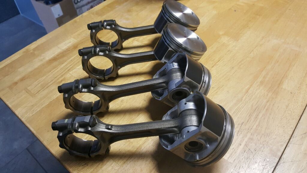

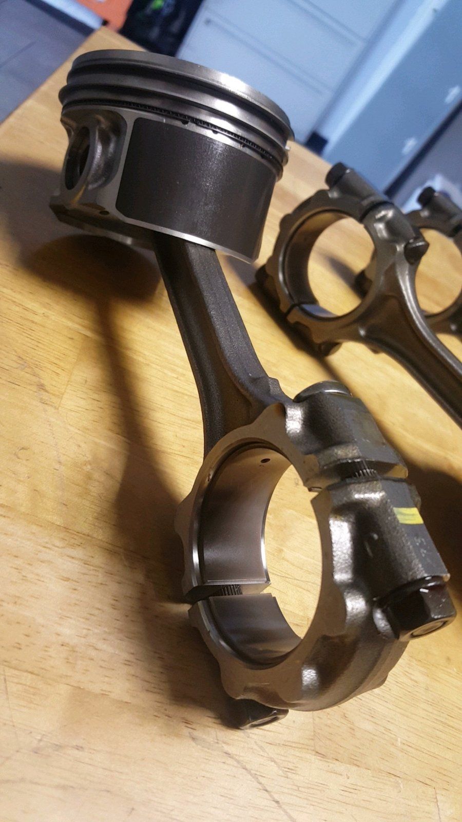

So after going back and forth between buying a running motor and building the one I have, I just decided to rebuild it. I got a good price on these and have ordered some Evo 8 rods and Pistons from Cory at STM. They were pulled from an OEM shortblock and are pretty much brand new.
Now I'll be needing a crankshaft, bearings, head gasket, head studs, and a timing kit. More to come, feels great to get some stuff for the DSM!
Evo Pistons and rods are officially in my possession! They're in amazing shape (which they should be, they're new after allLOL), and I'm currently working on the ol DSM. I have to disconnect the driveline and the passenger axle now and she will pull right up. Stay tuned!
The engine is officially out of the car! I spent a few hours after work today to pull her out and start stripping the accessories off of it in preparation for disassembly.
I've noticed some bolts and things either missing or completely un-tightened throughout the entirety of the engine and trans itself. I'll touch more on those tomorrow when I post pictures up. The ol DSM is one step closer to being back on its feet and spooling, I'm satisfied:)
