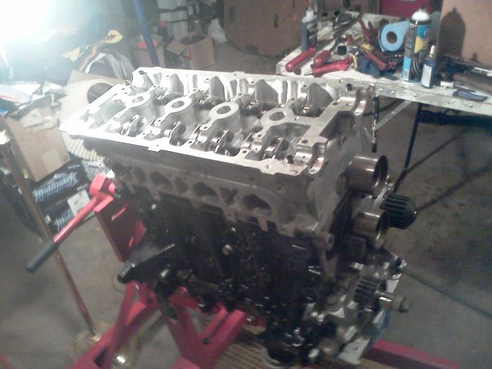

Building a 1998 Eagle Talon 420a engine for a street build and a weekend racer. Started the build in 2011. Already built the block most of the way. Purchased a long block assembly from a junk yard to tear down and to build up while my car is still together to use instead of having no way to get around. I have built the block with callies compstar 2.2 stroker crank, eagle h-beam rods, 1/4" thick side wall super alloy wrist pins with anti gaul coating, cp pistons (88 mm) with coated piston tops, bored .020 over, cleviete p series mains and h series rod bearings (tri metal), arp main studs and head studs, factory oil pump, factory water pump. painted the block black.

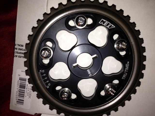

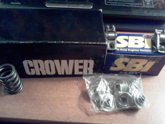

Cylinder head is built with crower stage 2 turbo grind camshafts, AEM 5 spoke cam gears, upgraded pt cruiser rocker arms, crower titanium spring retainers and spring kit, PEP stainless steel valves 1mm oversized swirled polished heads chrom plated steams and steallite tips, BLE solid lifter conversion kit, and bronze valve guides.
head and block both hot tanked, checked deck flatness, line bores.
.030" thick MLS head gasket.

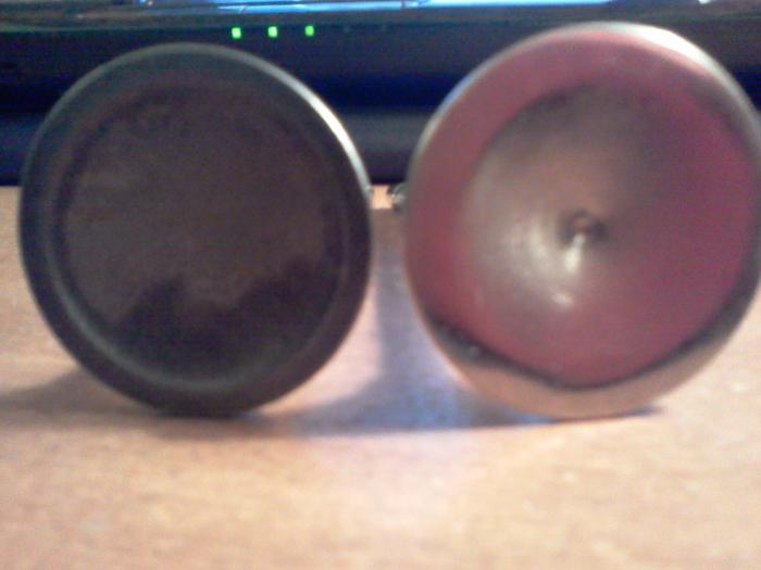

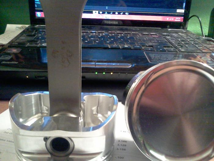

Coated piston tops with teflon coating. currently waiting on a crankshaft scrapper and windage tray set up. ordered a timing belt tensioner conversion kit to go from hydraulic to mechanical. Have an ati super damnper under driven balancer.
pistons are 8.5:1 compression. final compression is 8.35 to 1
Head has been ported and polished to stage 3 specifications. intake ports flow 310 cfm and exhaust flows 285 cfm. combustion chambers cc out to 50cc's
Build videos on youtube channel: thecartuner007

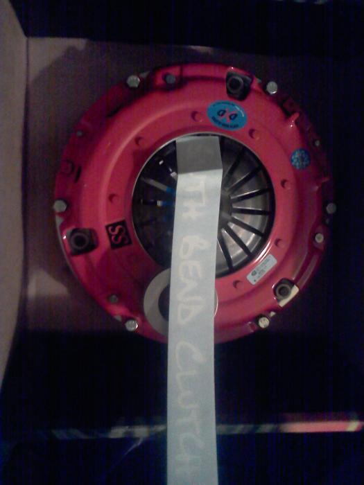

another picture of a part i had bought. cryo treated and sfi approved flywheel and clutch. holds 520 ft lbs of torque.

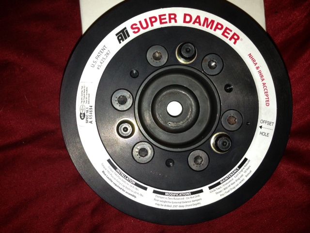

my ati super dampner and aem timing gear. i will point out that the timing marks for advance and retard are actually incorrectly placed. so the retard side is actually advancing and adcanving is actually retarding.

:hmm::ohdamn: dude if that's how you torque the cam gears down. I highly suggest you take your motor to someone who really knows what they are doing and ask them to go over your motor!! FYI there are what look like bolts molded into the cams so you can place a big wrench on them to hold while you torque or there is a hole you can use to have a little rod hold them. How are you tightening the flywheel and crank pulley bolts? If your not carful your motor isn't going to last 10miles!

:hmm::ohdamn: dude if that's how you torque the cam gears down. I highly suggest you take your motor to someone who really knows what they are doing and ask them to go over your motor!! FYI there are what look like bolts molded into the cams so you can place a big wrench on them to hold while you torque. How are you tightening the flywheel and crank pulley bolts? If your not carful your motor isn't going to last 10miles!
thanks for your concern but remember its my motor and i am an ASE certified mechanic. and there was no place on these cams for that, if you have the crower cams that i have you would kno, so i had to substitute something that would work ok. and the flywheel isn't on yet and those are going to be done differently. the harmonic balancer was installed with a pully intaller.
