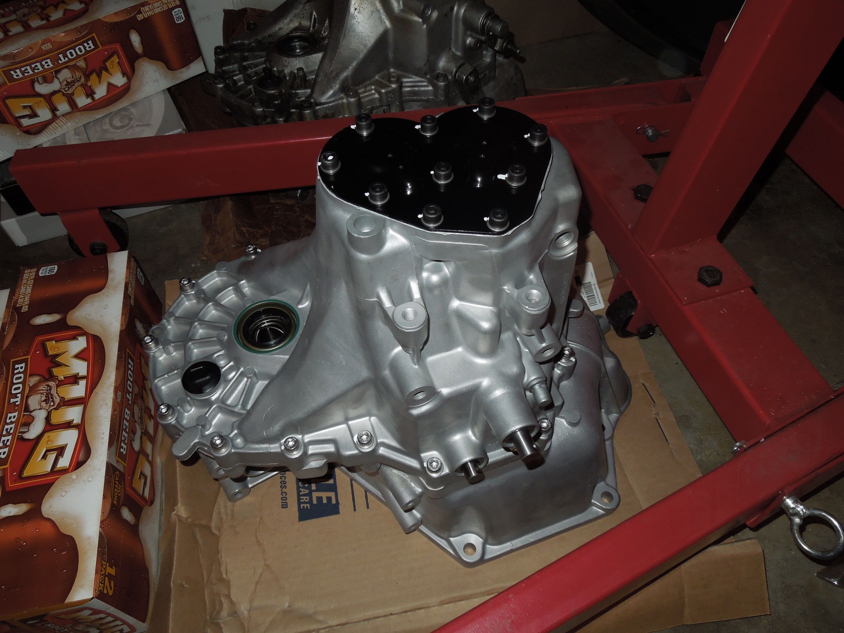

thanks but i already got a smoking deal for my trans build at $2k. inlcudes all the treatments i want to use for the parts and new gears and syncro's as well as bearings.

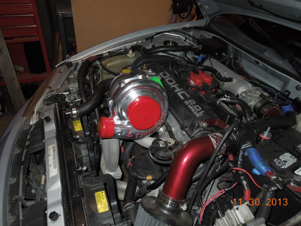

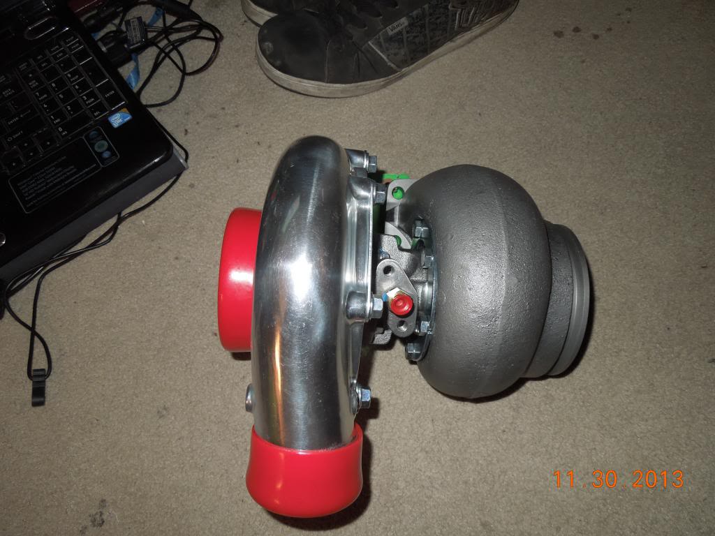

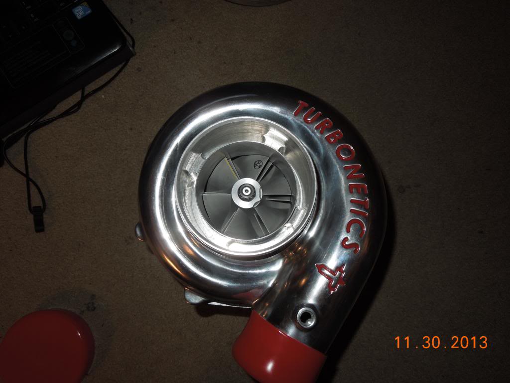

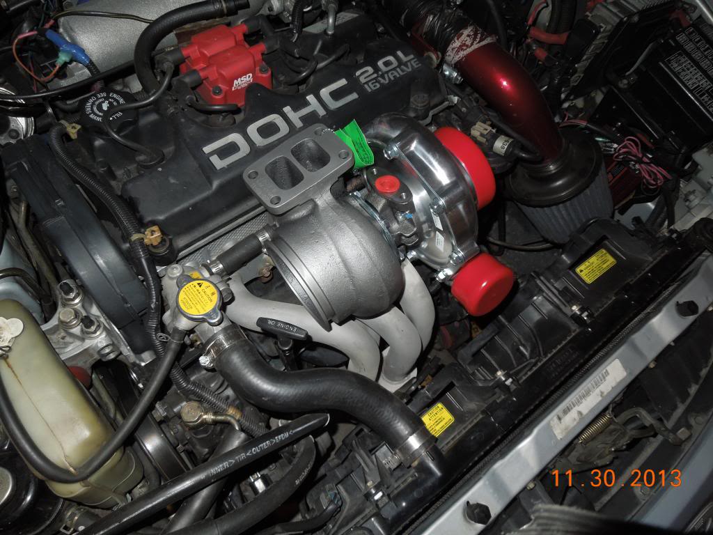

this just in, got the turbo delivered 30 minutes ago. here are some pictures of it:
So you have some dss axles it sounds like. Just saying its a lot of air to move so it will take a really really good tune to utilize the setup. You have a lot of stuff your adding and changing, it's going to be a bit of a challenge to get a good base tune going let alone a wot tune! I would really think about your tuning software and the best one to use!
i am well aware of that and i know people who tune cars like this, and i have thought of that already. let me put it this way i have though of everything i need to do and to buy for this build. thanks for a suggestions but i already know of the tuning part of it isn't going to be a walk in the park.
Shiny!! holy crap and twin scroll! What manifold are you going to use for it? Going to take something custom for sure and you will need to clock that thing better if its fitting under your hood! As it sits its kinda ass backwards for a 420a motor but would work fine on a 4g63!
i know what manifold i am going to use, its a matter of will it fit right. and i know i have to clock the turbo, i knew i would have to way before i bought it. and i din't buy a good turbo for nothing either. i did a lot of research and condsidered all the best turbos and chose this one, the turbonetics hurricane series. and the turbo is sitting correctly as it will when it does go into the car after its been clocked correctly. if you haven't seen other turbo 420a's, this is practically the same way the turbo sits anyways ( just saying)

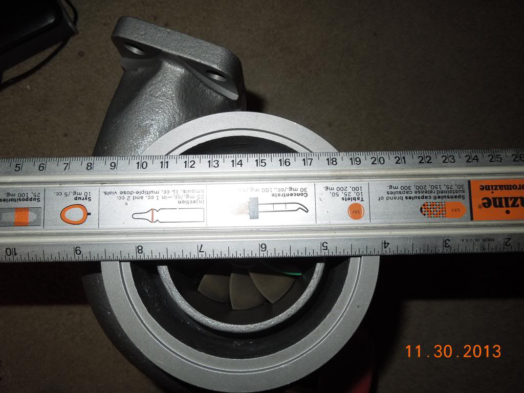

some info on the turbo: the turbo is a t3 turbine housing with a 4 inch v band outlet. the compressor housing is a 4 inch inlet and a 2.5 inch outlet. turbo shaft rides on ceramic ball bearings for faster spool.
More information from turbonetics website:
Hurricane 7268-3 Christina 600-700(hp range) HP-72(compressor wheel) 4.0" / 2.5" Ported Shroud (compressor housing) F1-68 (turbine wheel) T3 0.84 A/R (turbine housing) 4" V-Band 11521-BB (part number/product number)
