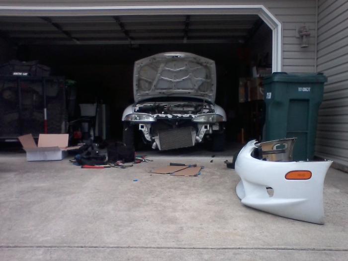

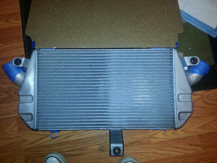

My next mod was a front mount I got off a evo 8. I figure if the inter cooler works good for the oem evo 16g it could work great for my little T-25. I ordered a piping kit off of ebay and a HKS SSQv 4 bov waited for them to all show up then got to work. The piping was a pain in the but to cut and get right, but I finally got it the way I wanted. http://www.dsmtuners.com/forums/attachment.php?attachmentid=162822&d=1386169441
