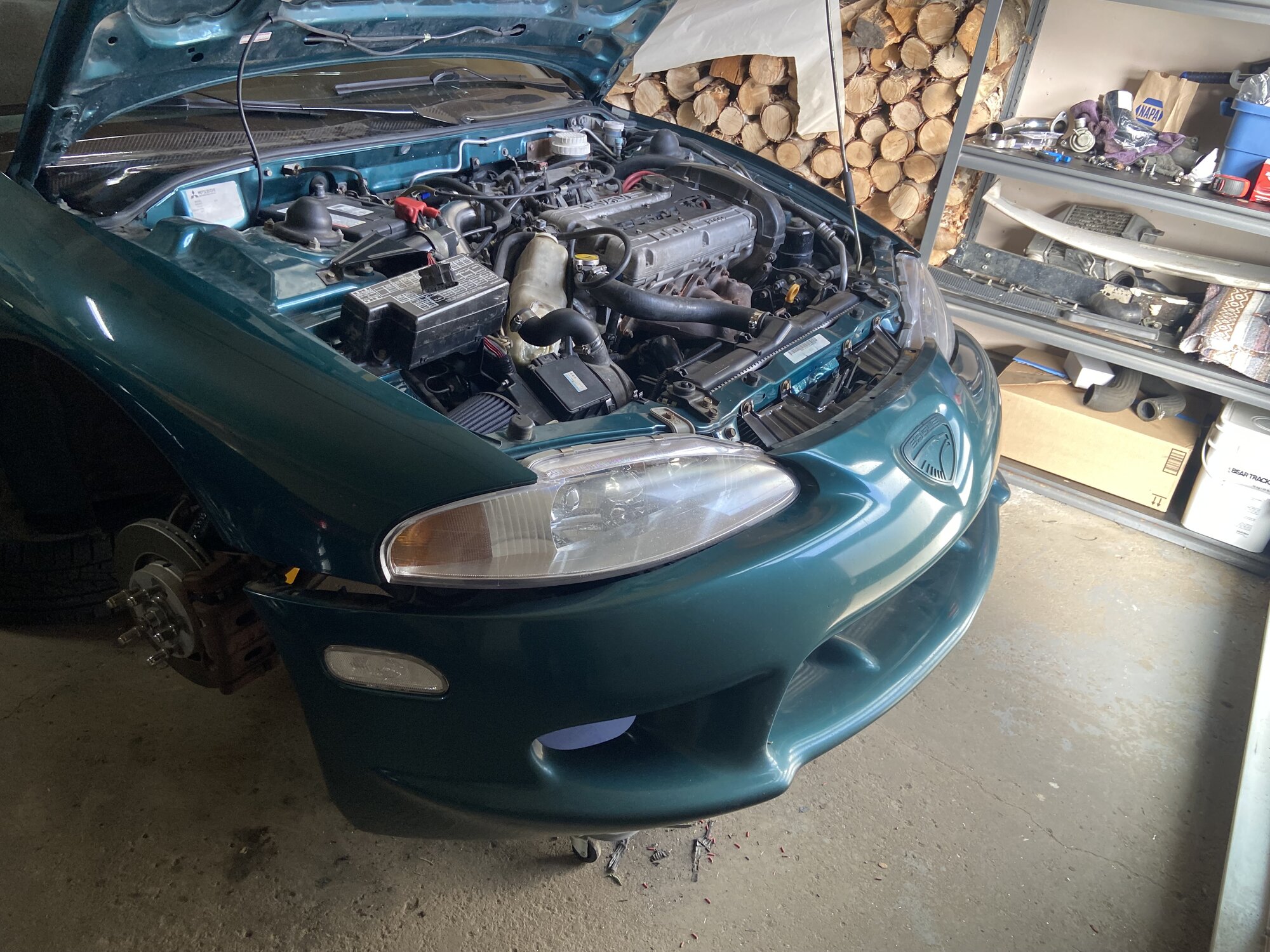

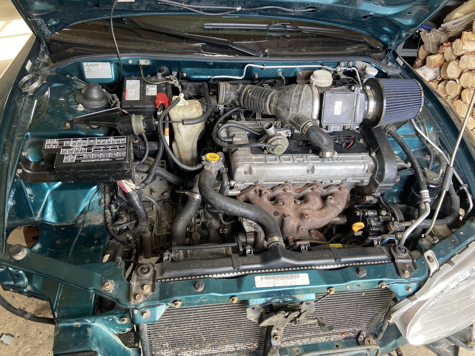

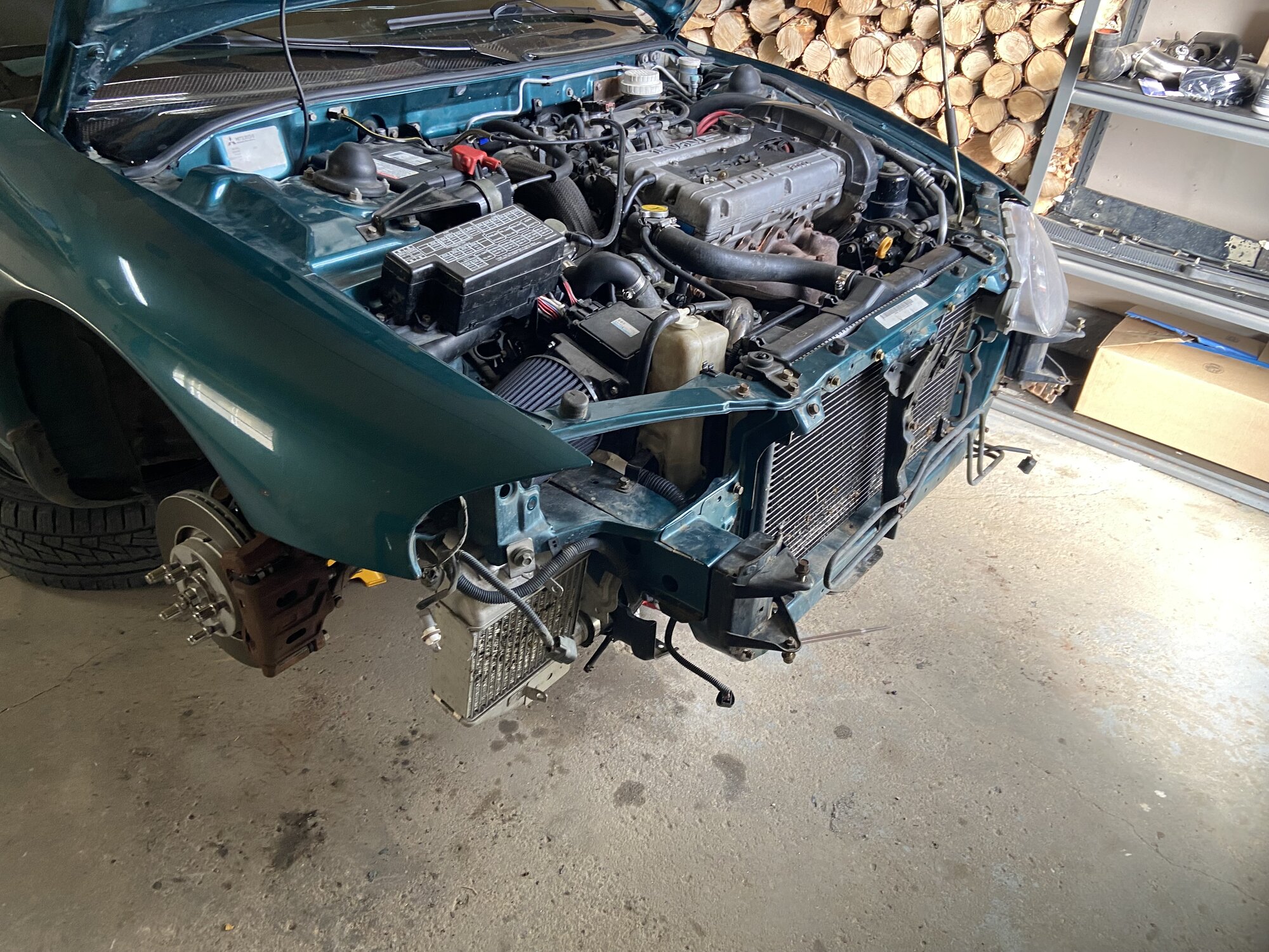

September 2025 Update – FMIC Install & a Wiring Surprise​
By September 2025, after driving the car as-is for the rest of the summer, tackling some maintenance, and experiencing a few of those earlier-mentioned headaches — including a broken front driver-side axle, leaking transfer case output shaft seal, leaking oil filter housing coolant supply line, installing a missing A/C compressor tensioner pulley and belt, adjusting the throttle cable, replacing fluids, and doing an oil change — it was finally time to start adding some supporting mods.

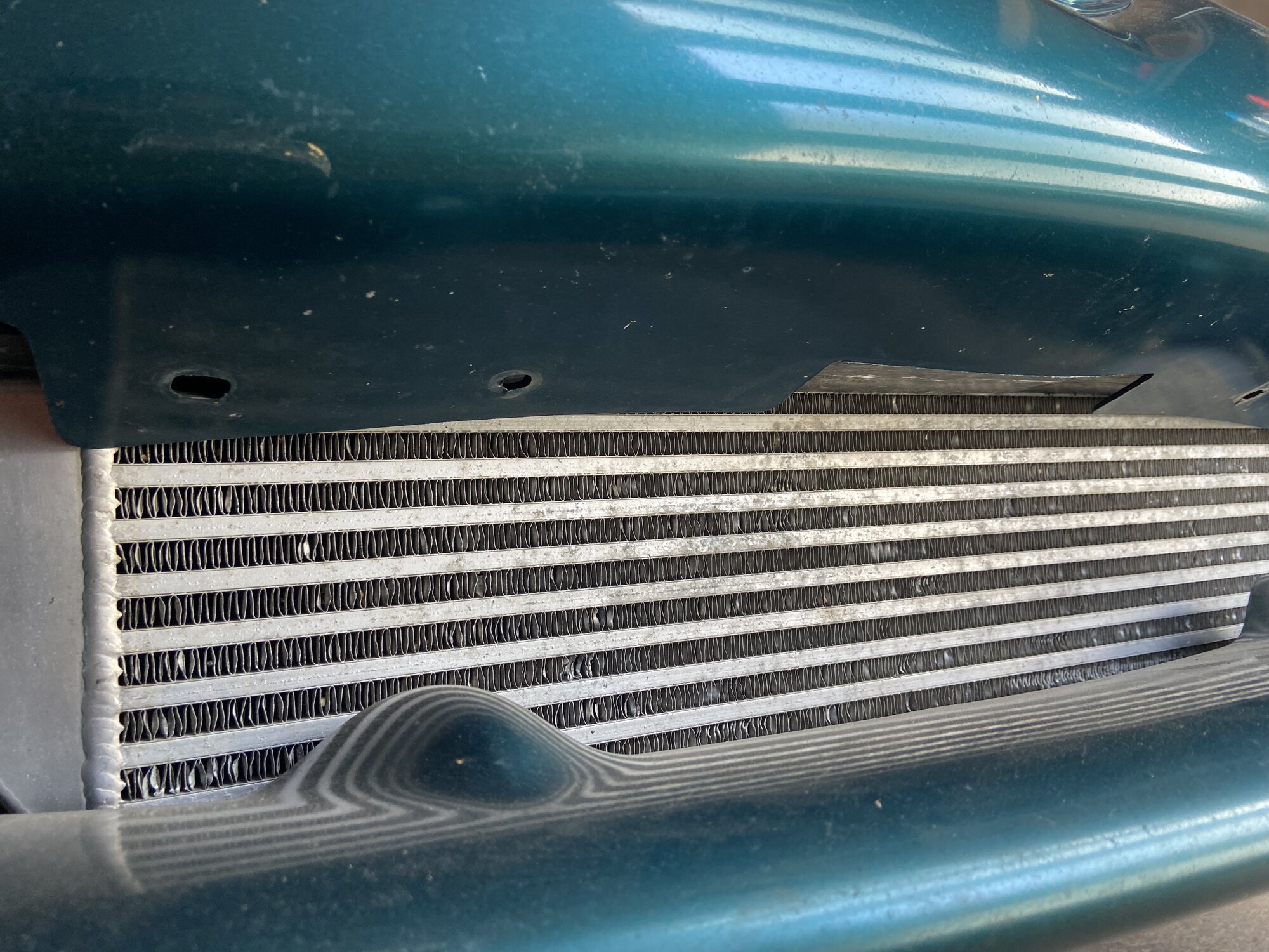

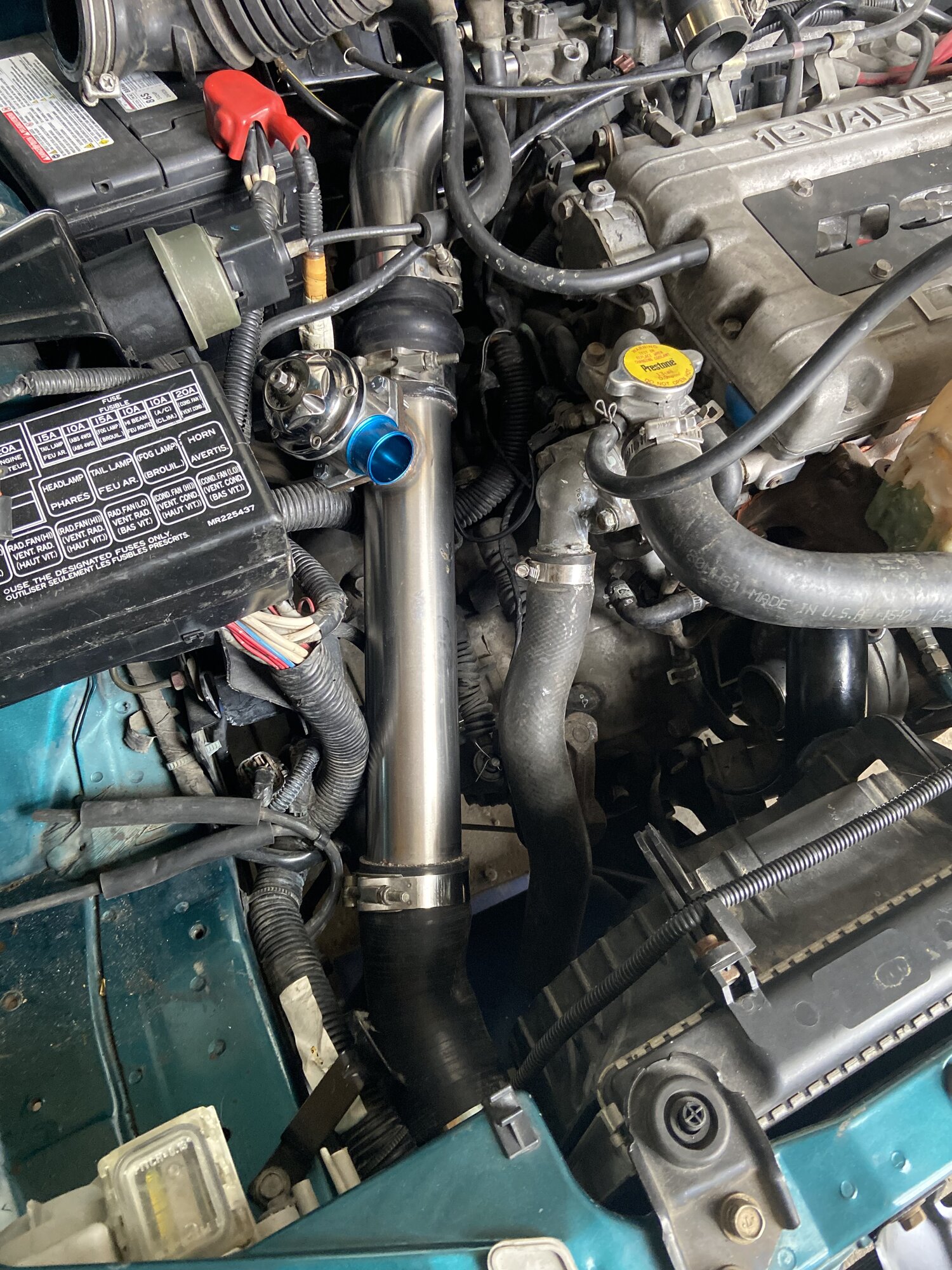

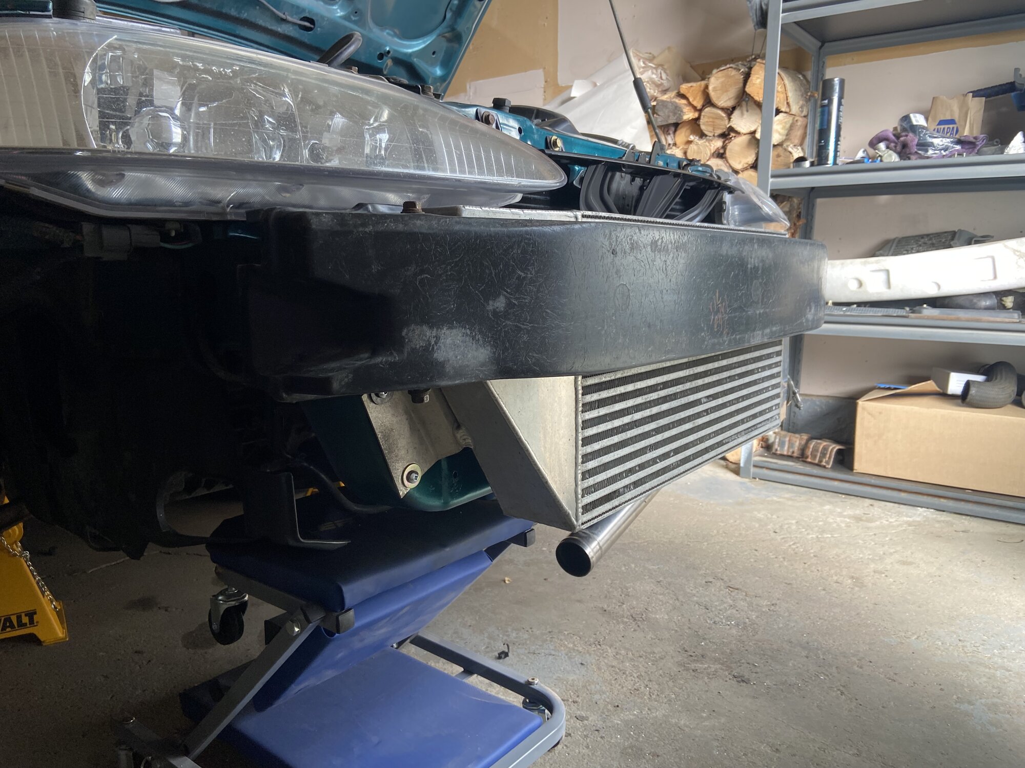

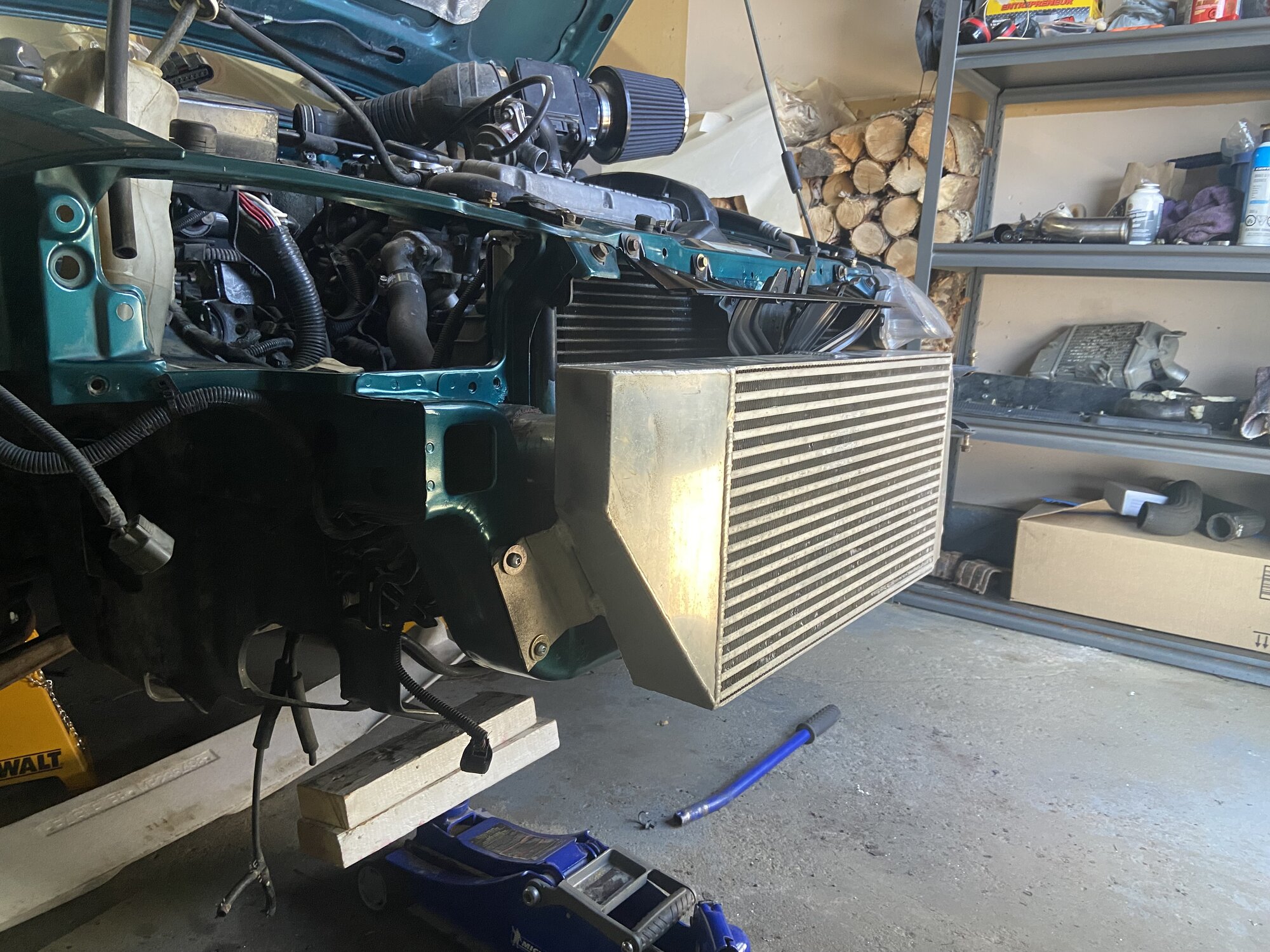

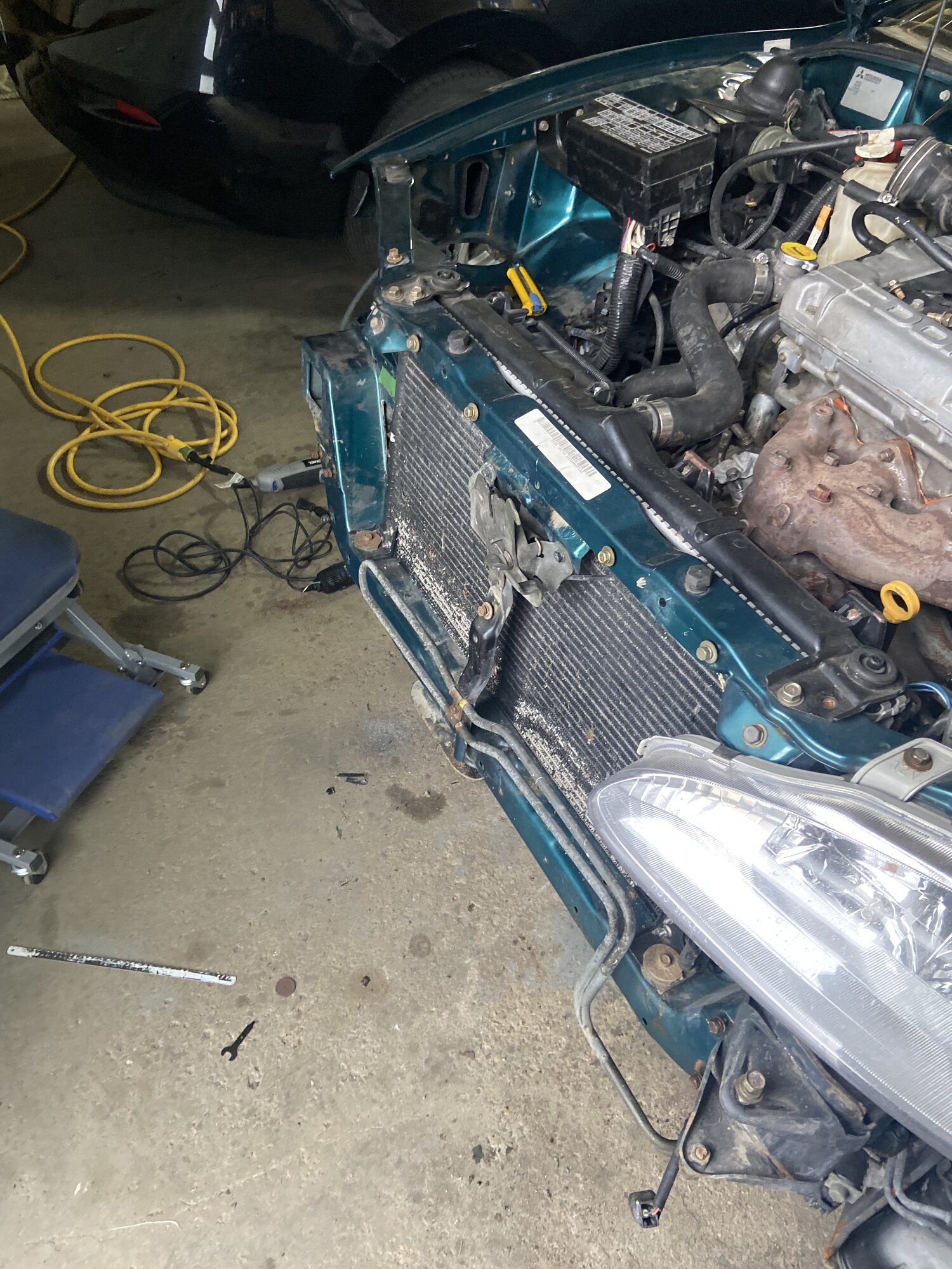

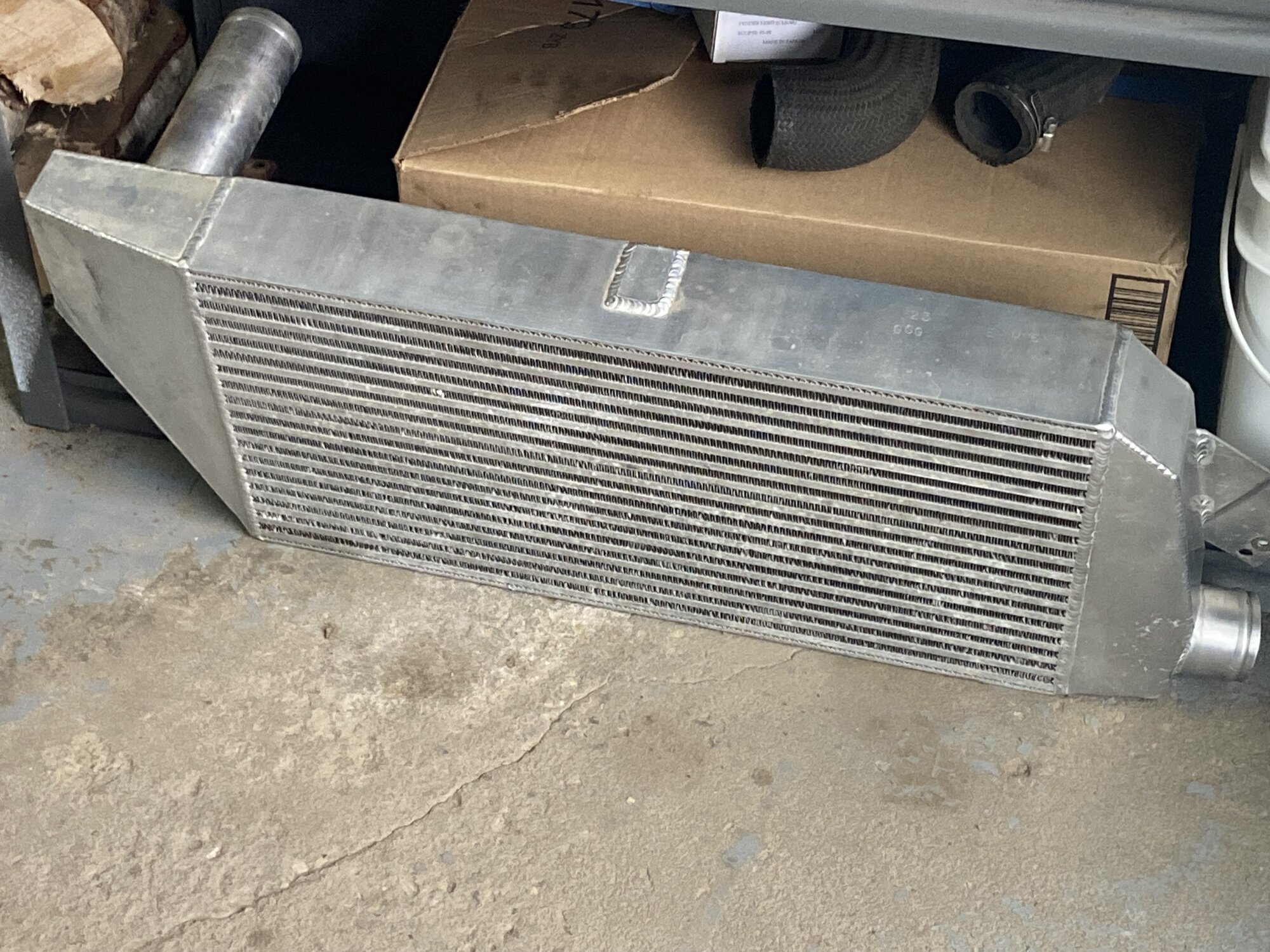

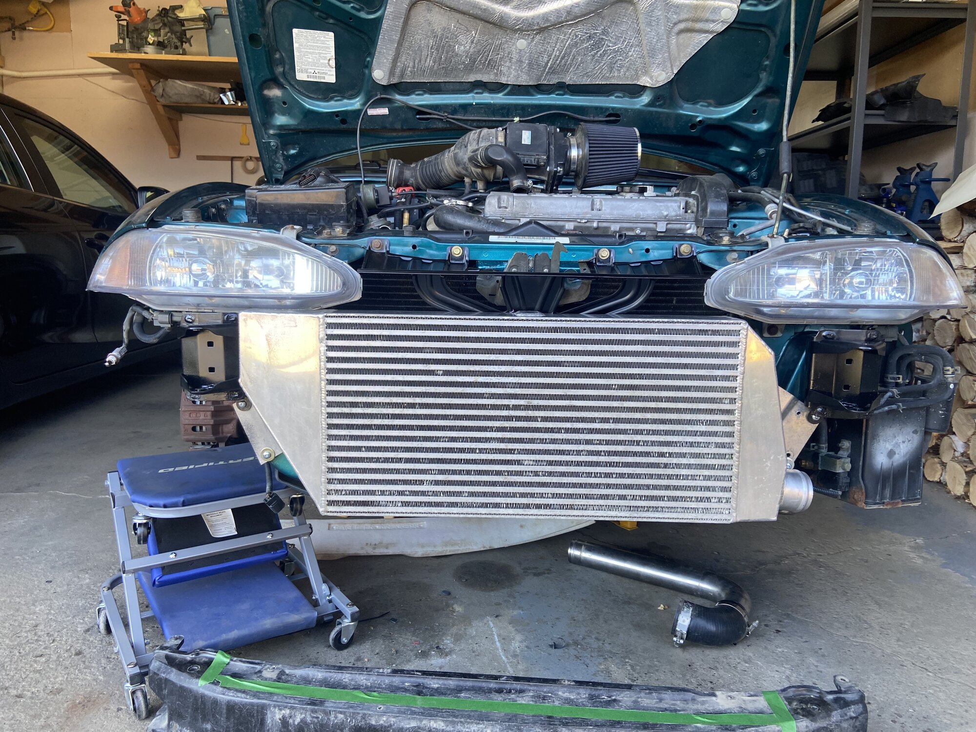

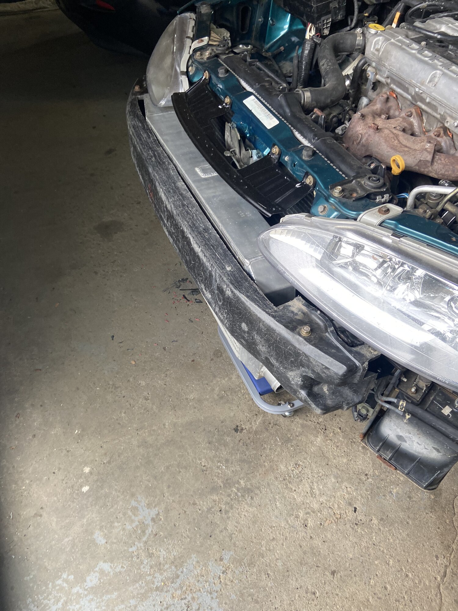

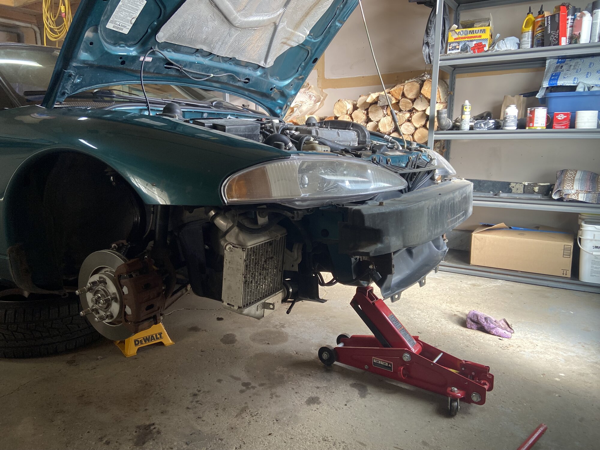

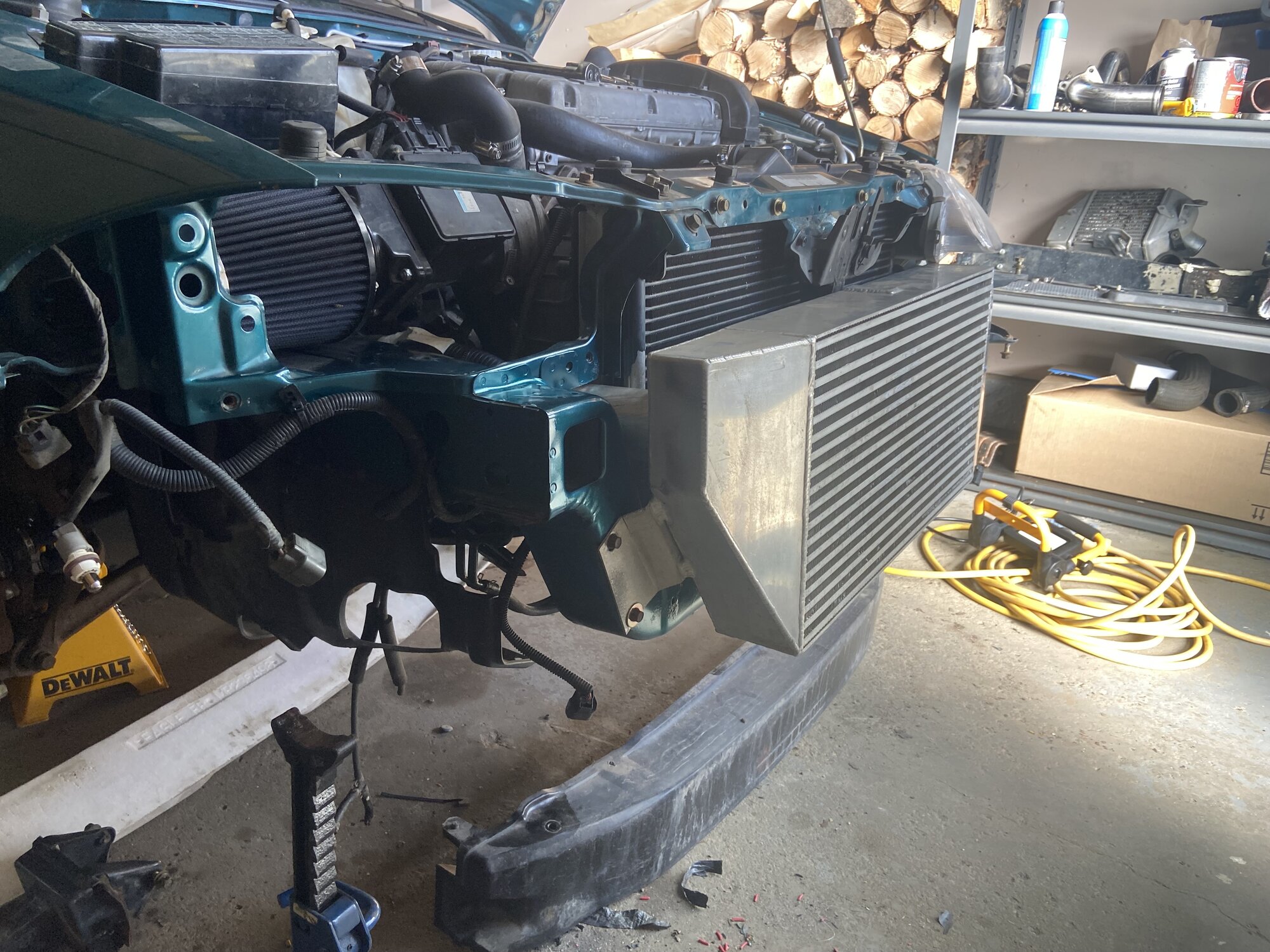

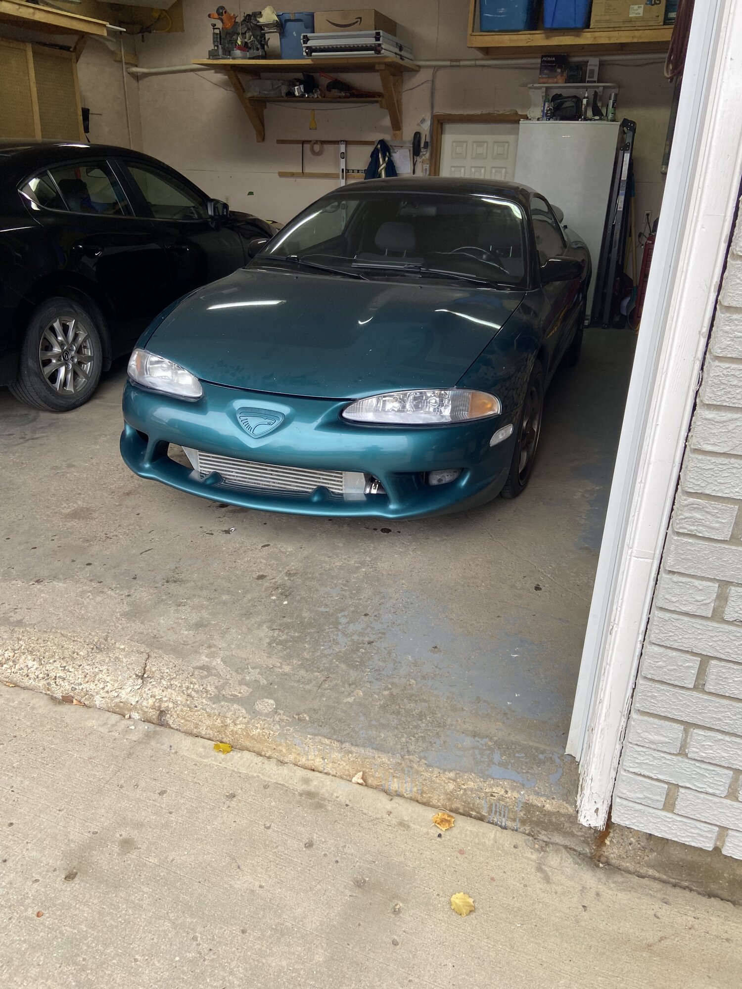

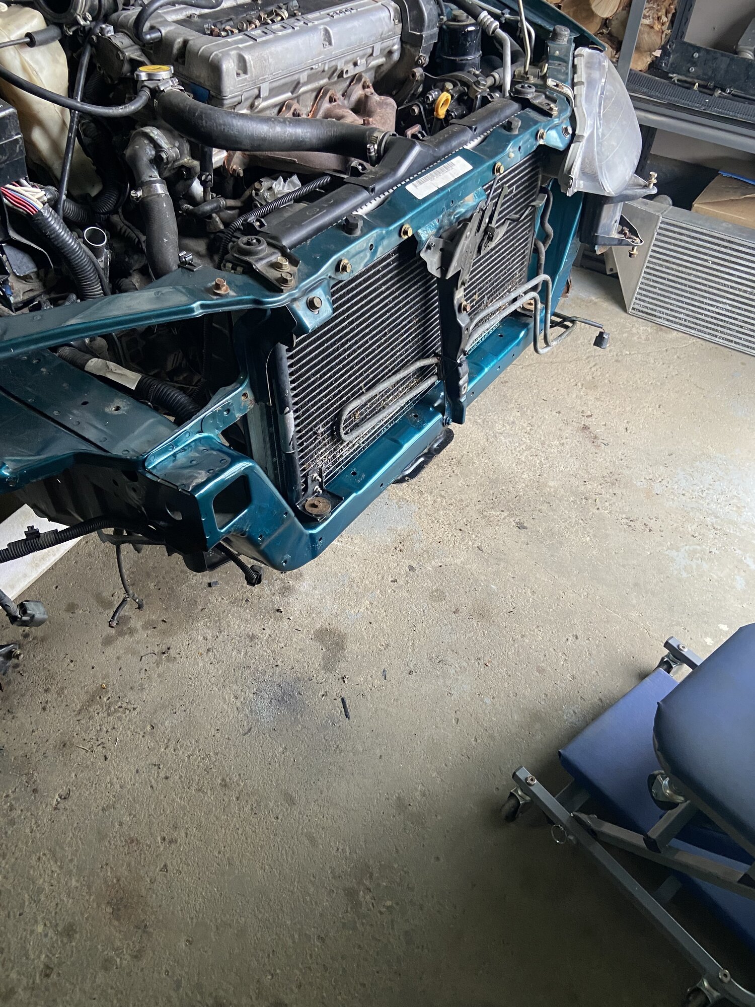

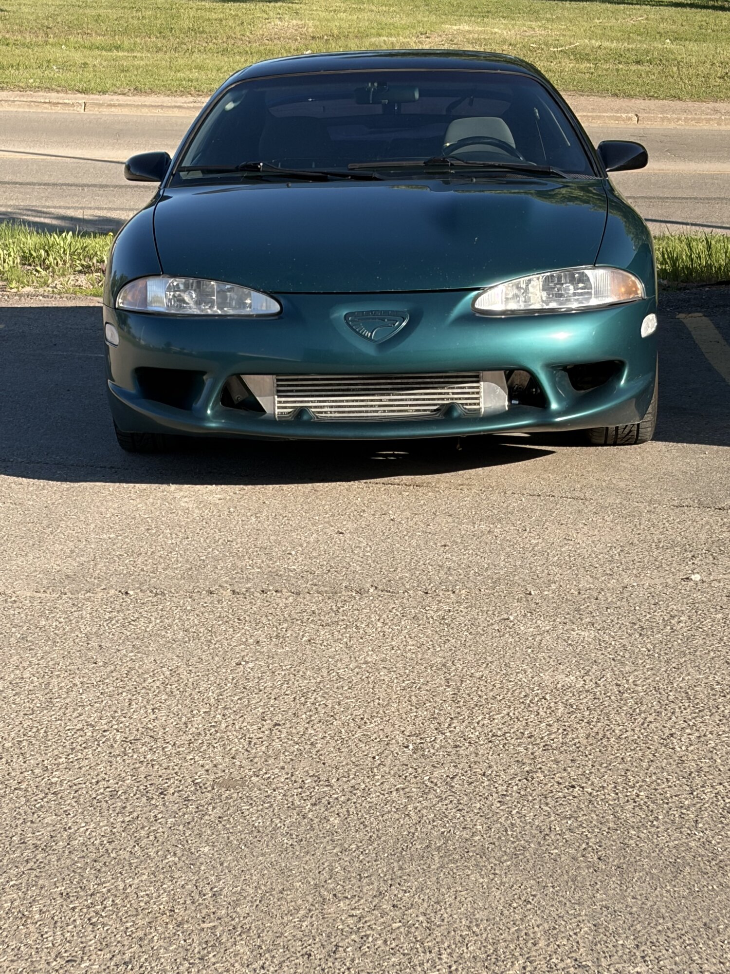

First on the list: a short-route front-mount intercooler (FMIC).
I picked up a short-route kit from another local DSMer here in Alberta, along with a GReddy BOV to pair with it. The car originally had a 1G BOV, but it had a nasty boost leak, so replacing it was a no-brainer.

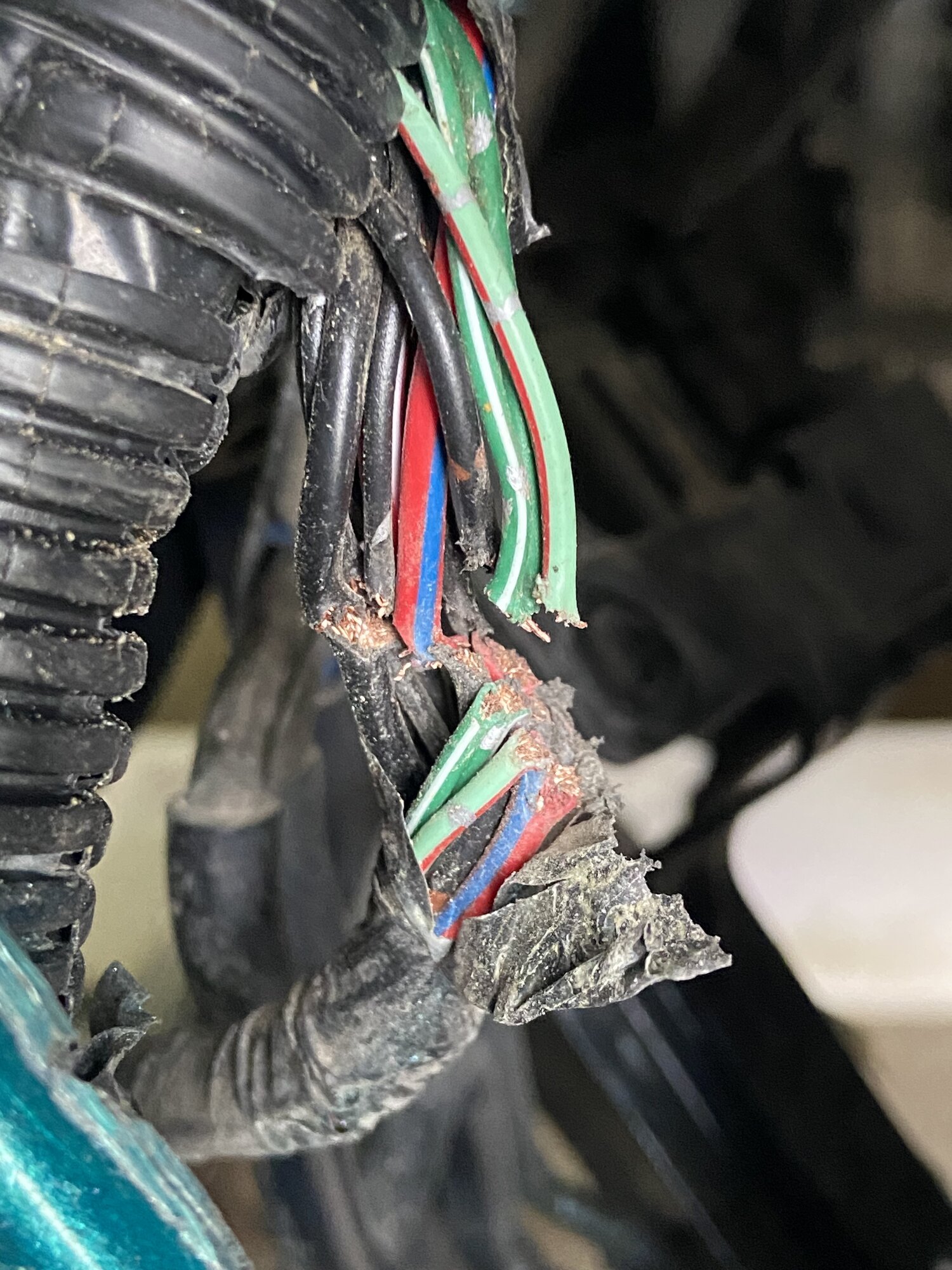

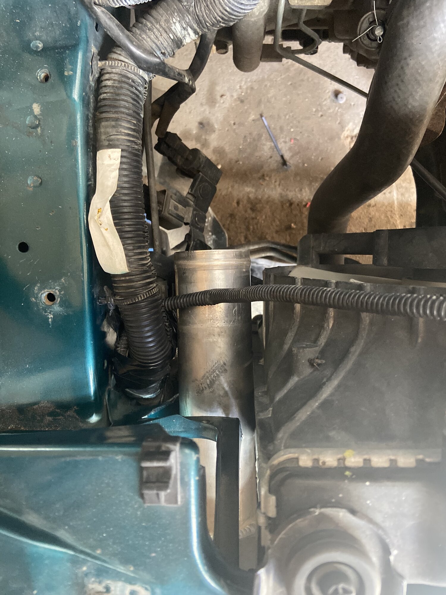

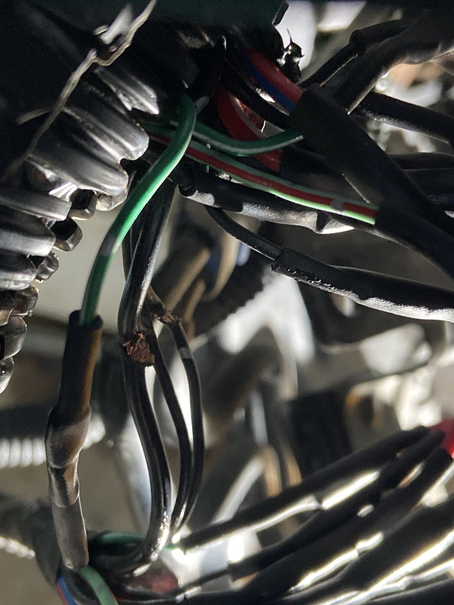

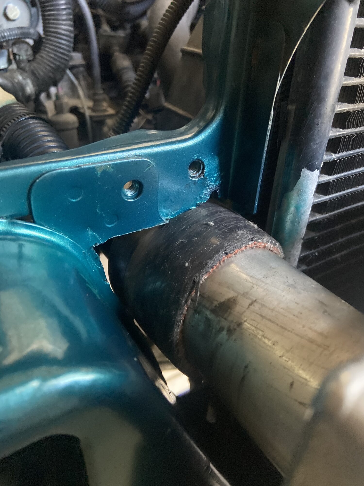

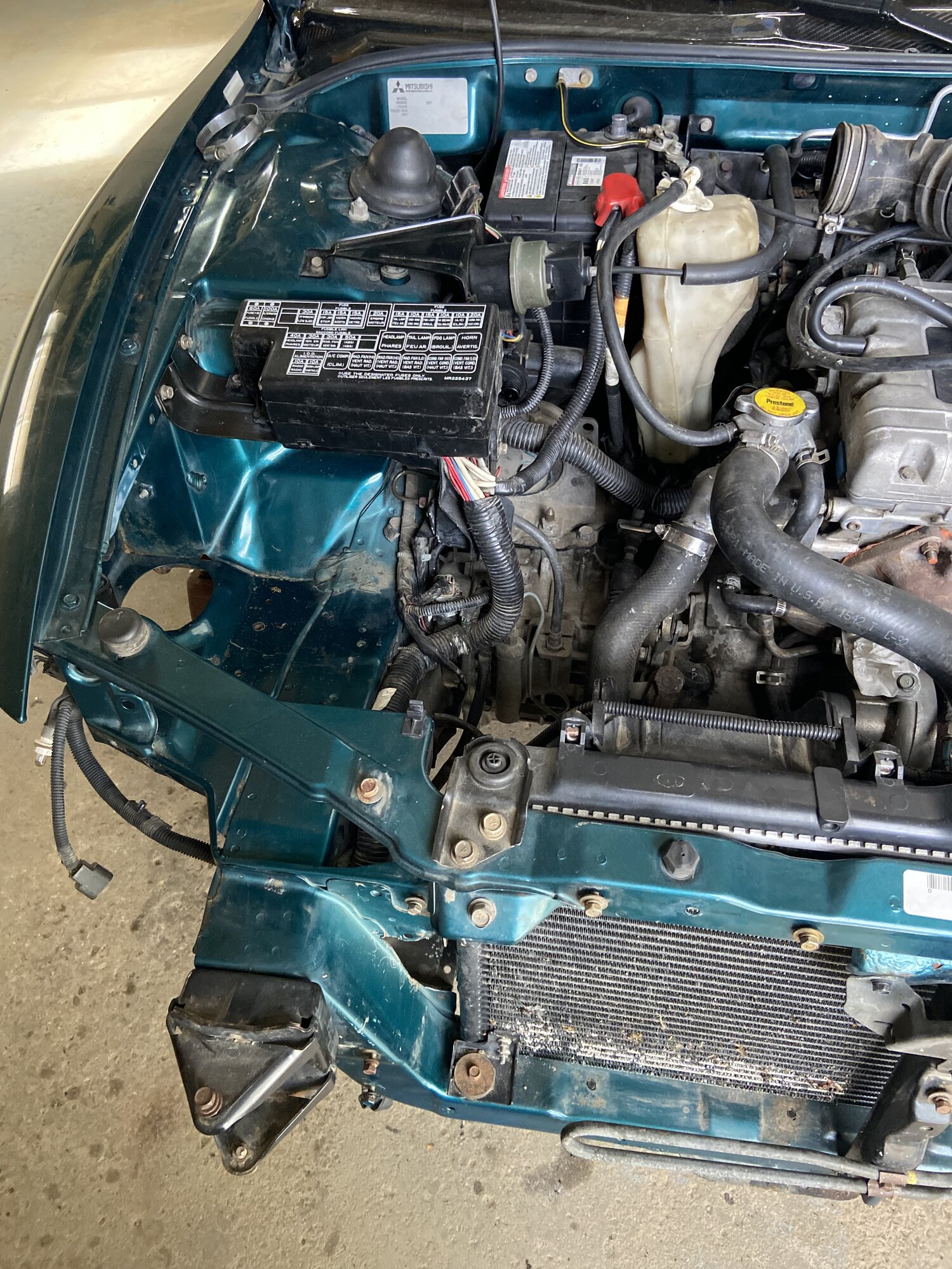

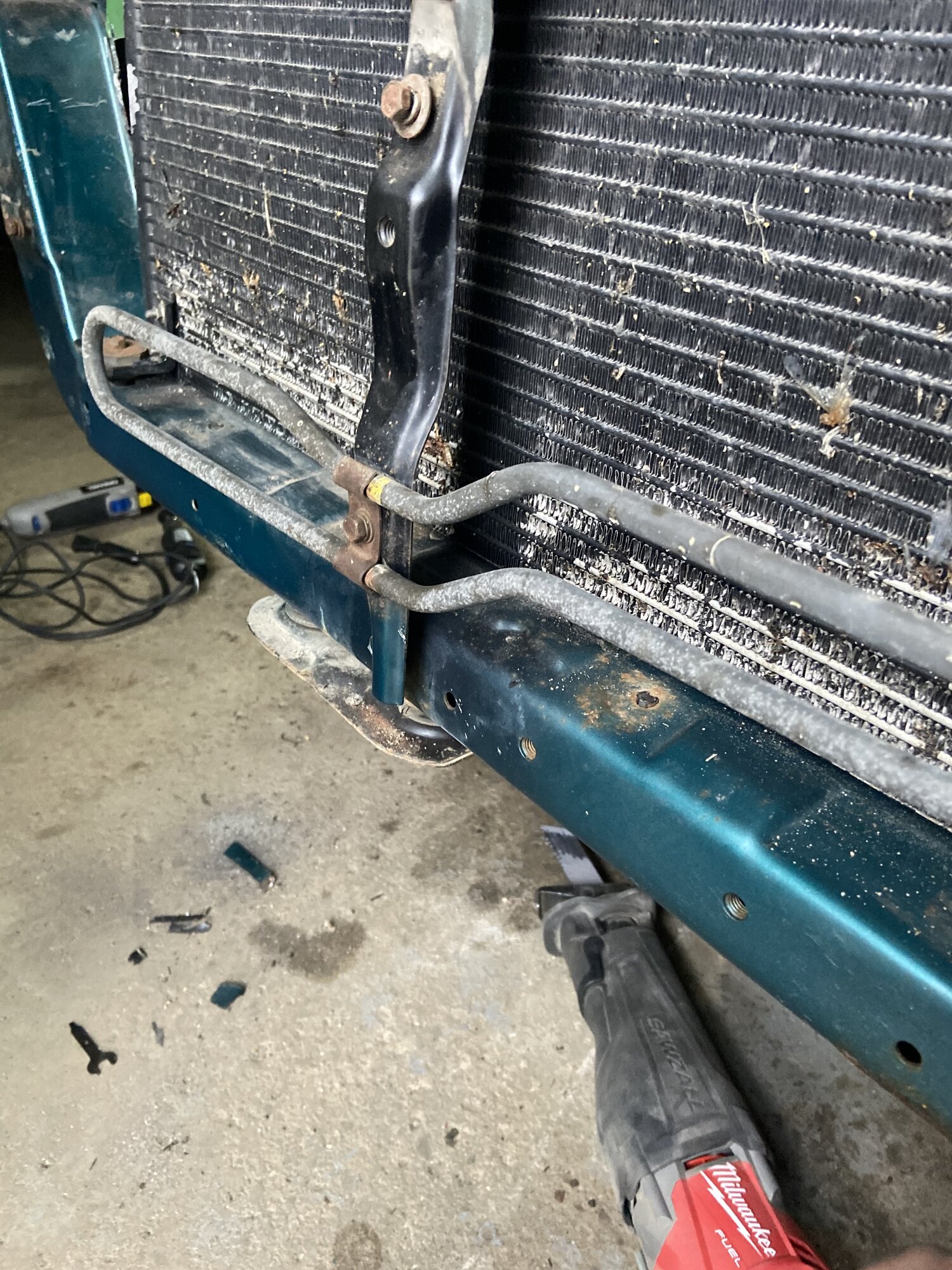

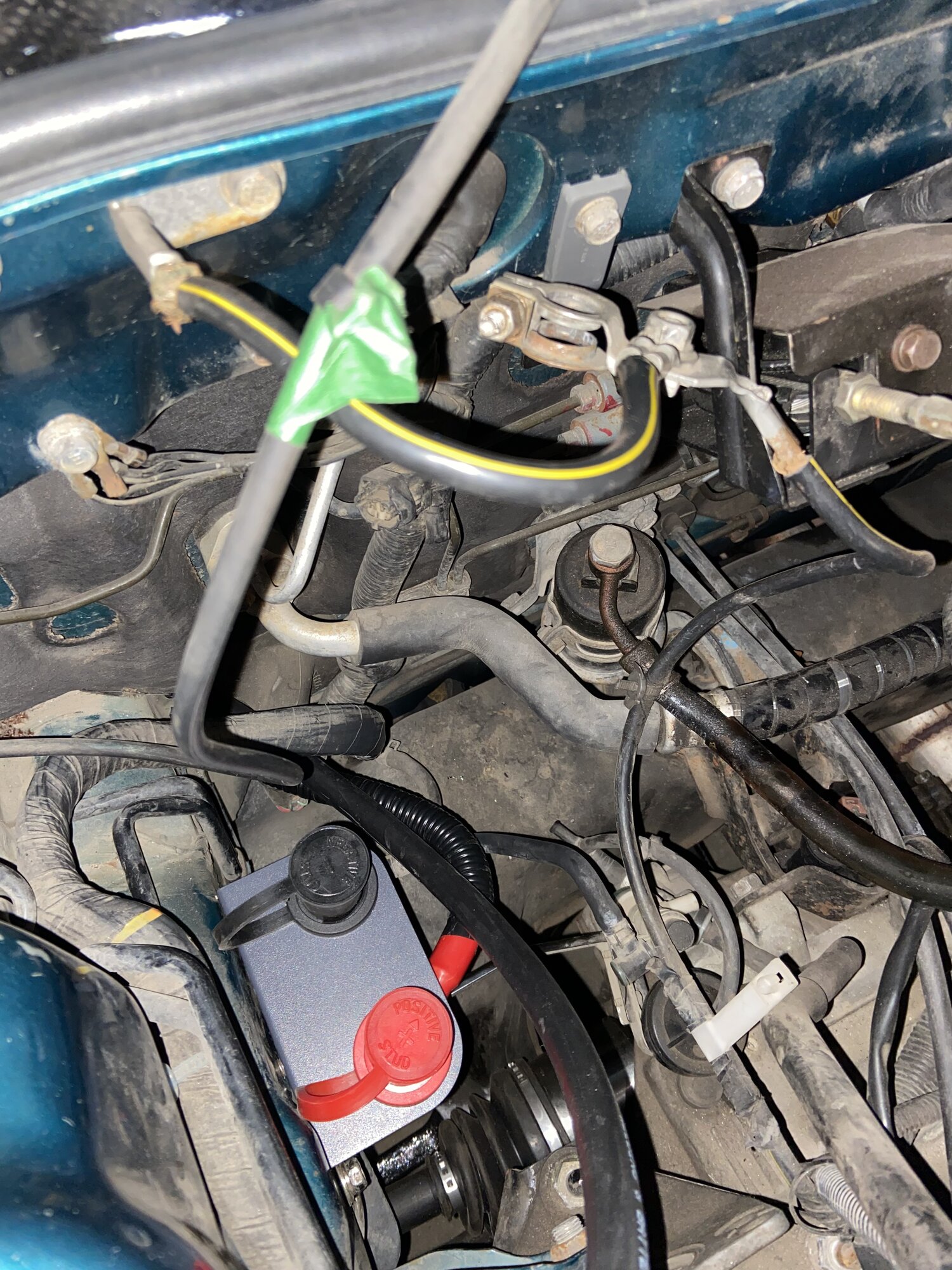

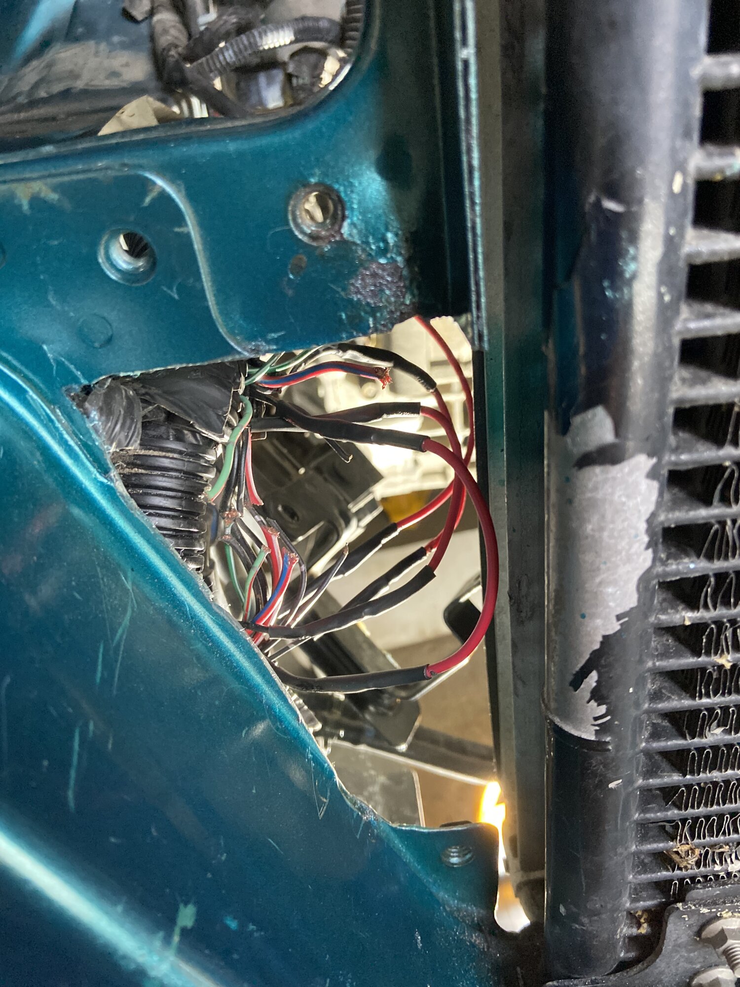

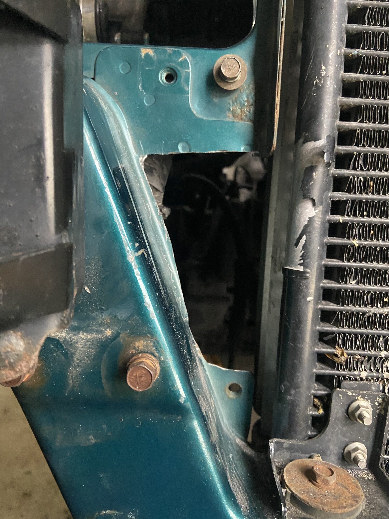

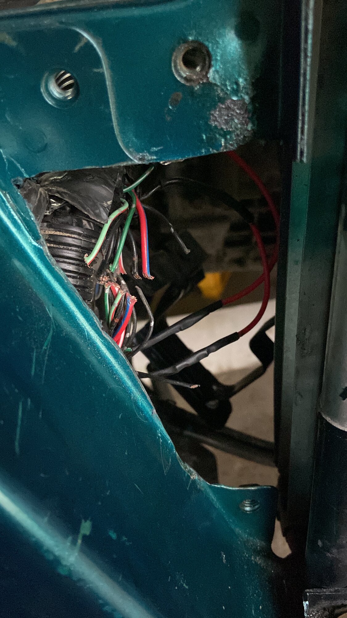

The Unplanned Wiring Adventure​
In my eagerness to get the new setup installed, I rushed the cutting process while notching out the section next to the radiator support bracket — and, regrettably, completely cut through the passenger-side front harness near the headlight. That unexpected mistake produced a few choice words as I spent the next while carefully rewiring and splicing the harness to restore full function. Lesson learned: measure twice, cut once!
FMIC Installation & Finishing Touches​

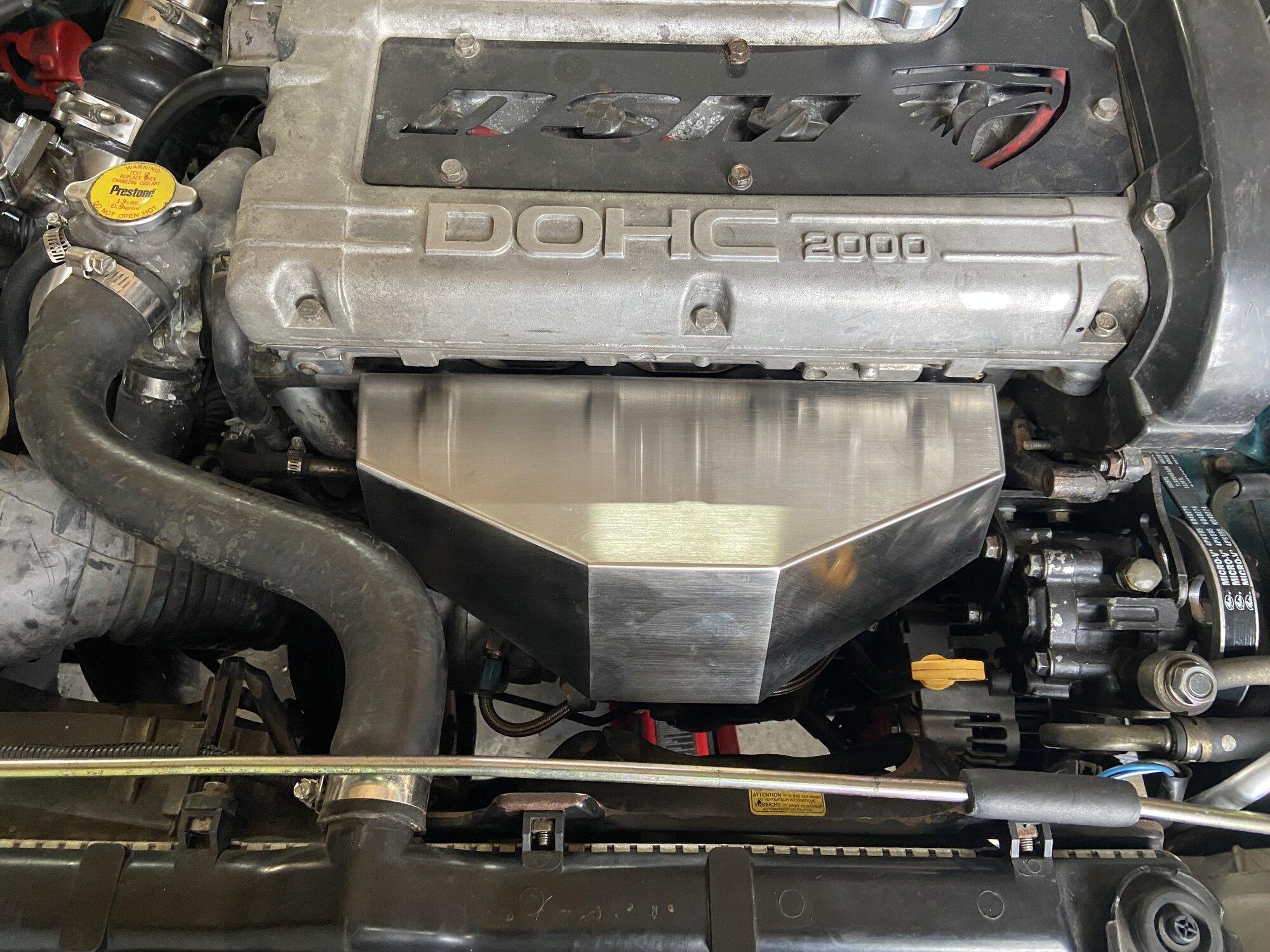

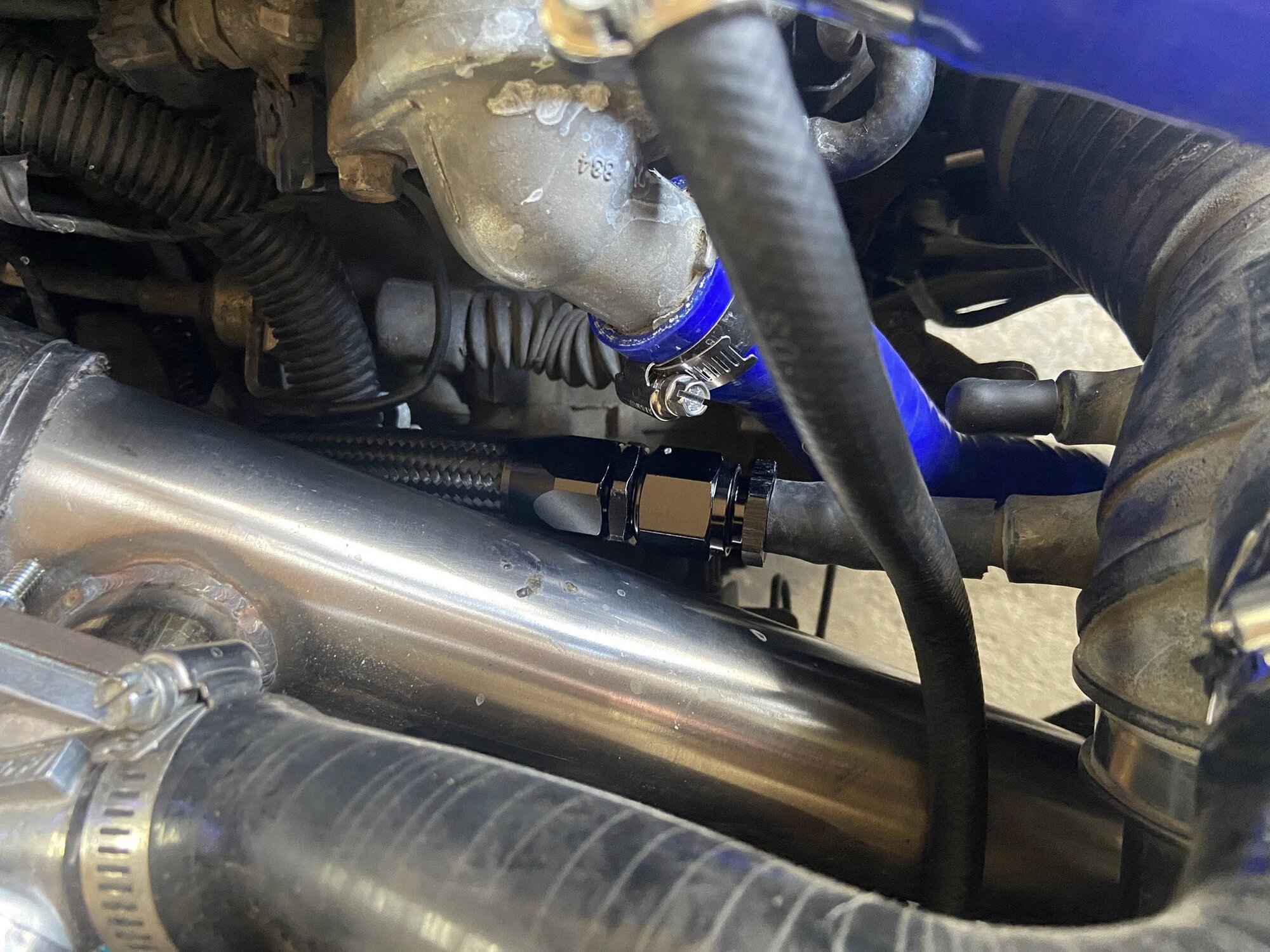

Once I got past that mess, the FMIC install went smoothly. I used an old 2.5-inch coupler as a bushing around the cold-side charge pipe where it passes through the radiator support. That small detail helps prevent any metal-on-metal contact that could eventually wear a hole through the piping. With everything lined up and tightened down, the installation was complete.

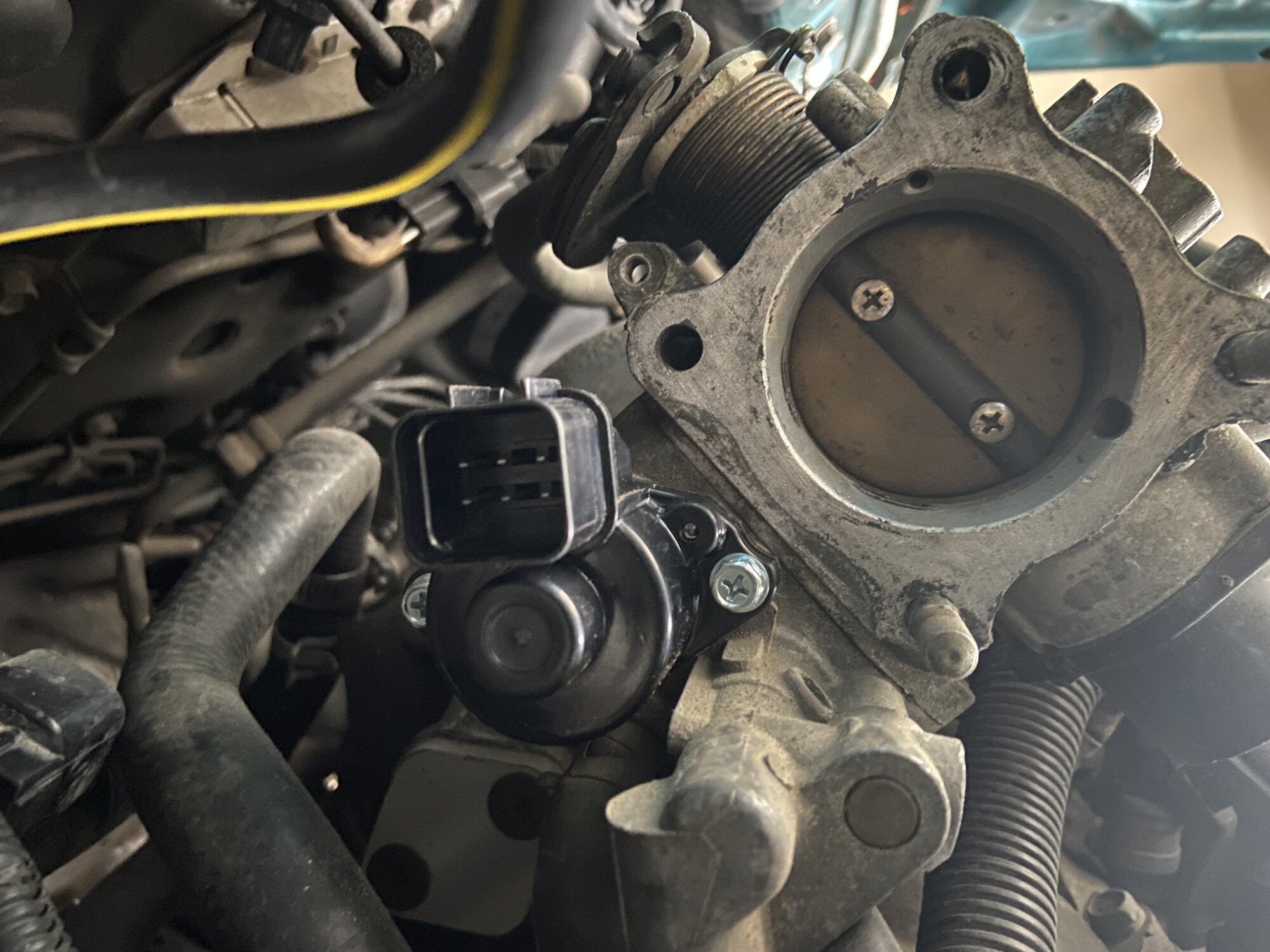

While I was in there, I also replaced the Idle Air Control (IAC) valve, which had been giving me some issues previously.

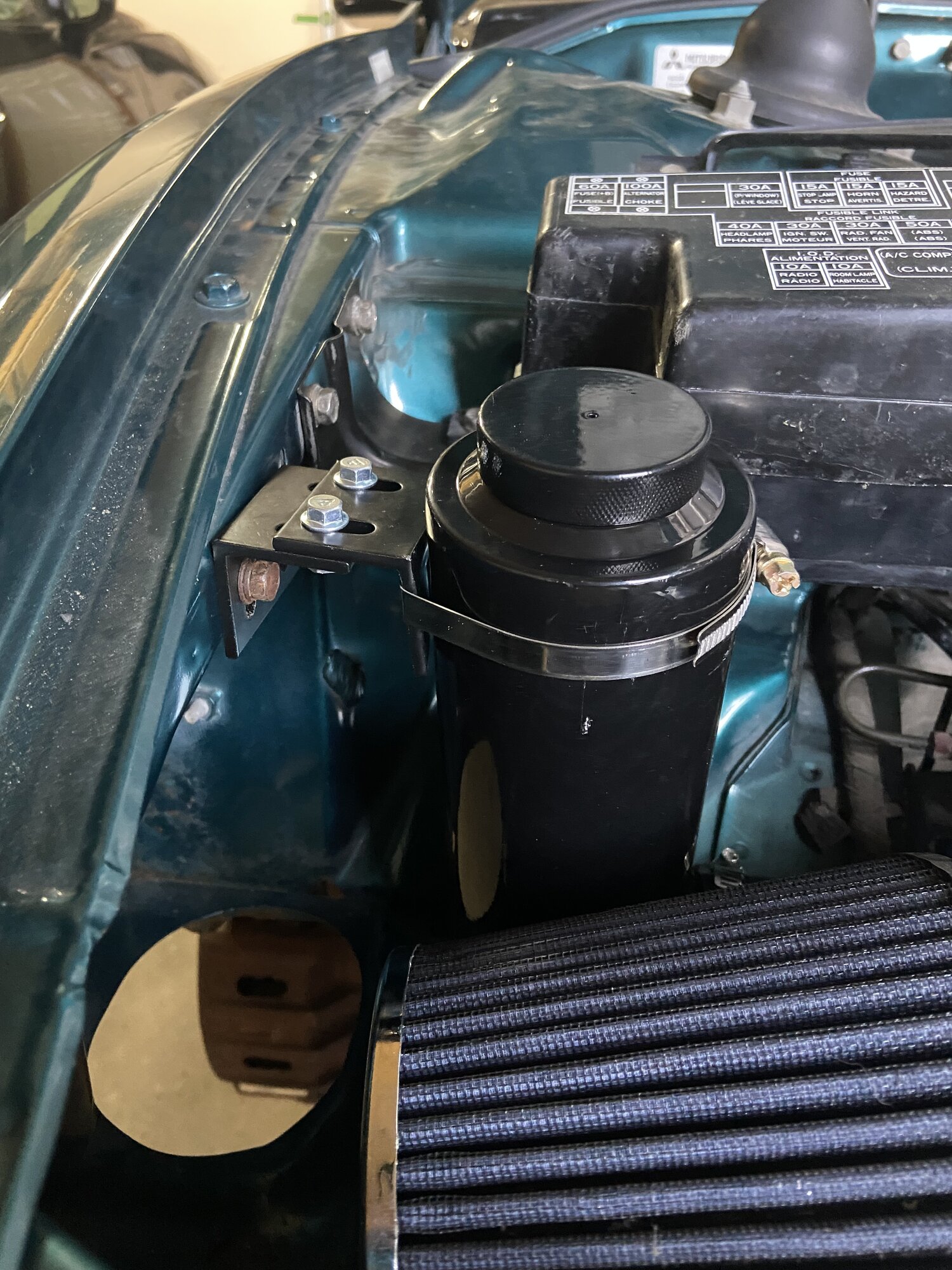

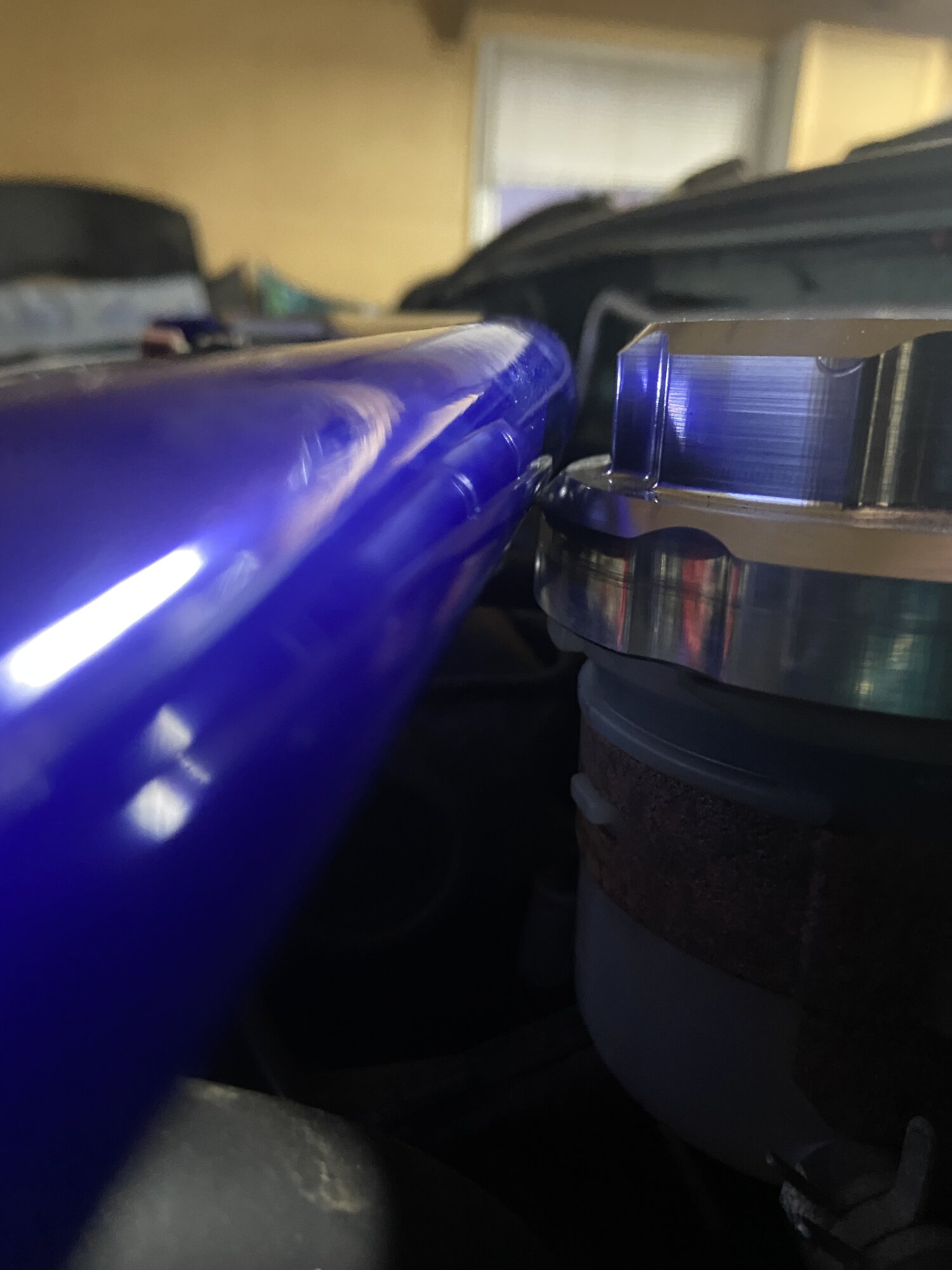

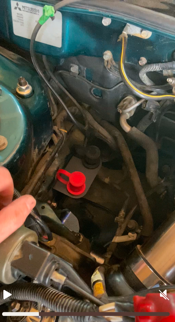

Coolant Reservoir Relocation​

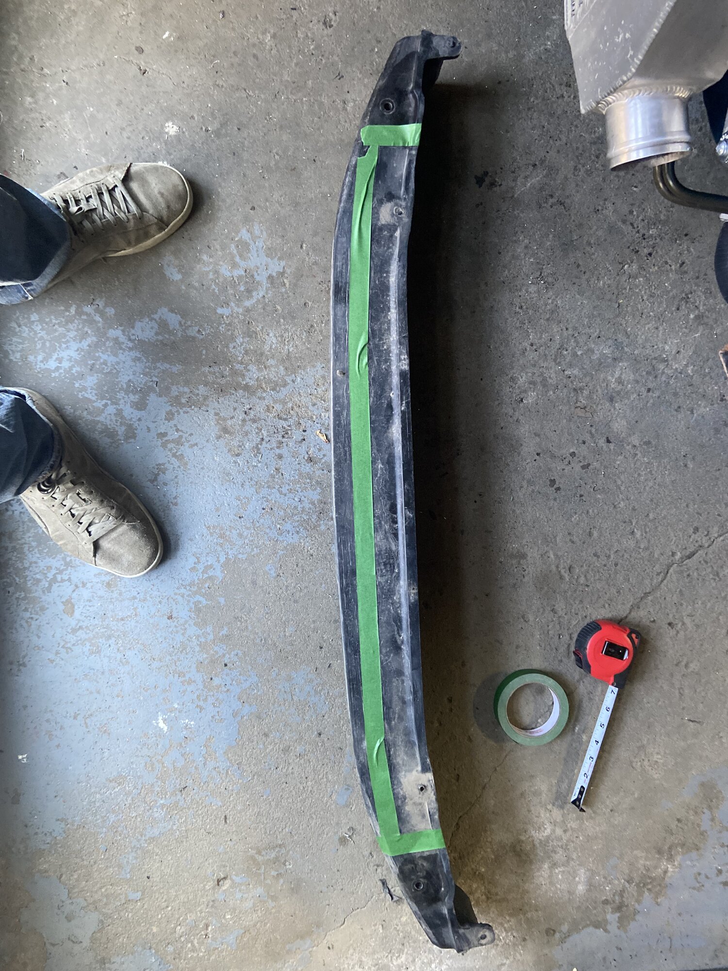

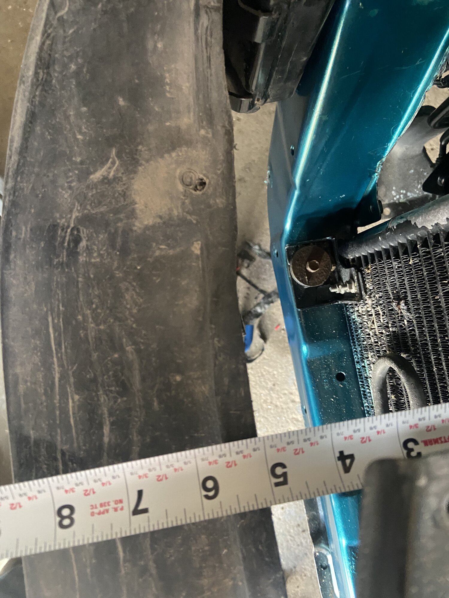

After installing the FMIC, I discovered that the OEM coolant reservoir no longer fit in its original spot. To solve that, I ordered a universal Evil Energy coolant reservoir and temporarily mounted it next to the intake. It’s not a permanent solution yet, but it’ll work until I fabricate a cleaner setup.
Pictures attached below show the full process — from the wiring disaster and splicing repairs to the FMIC fitment and final measurements.

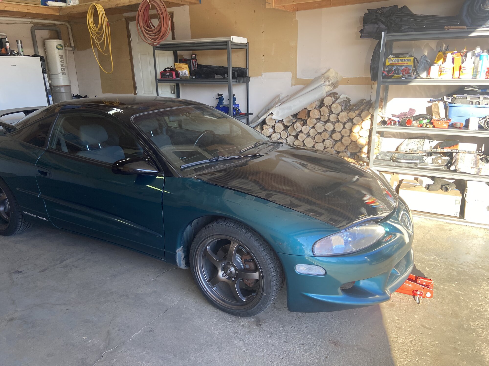

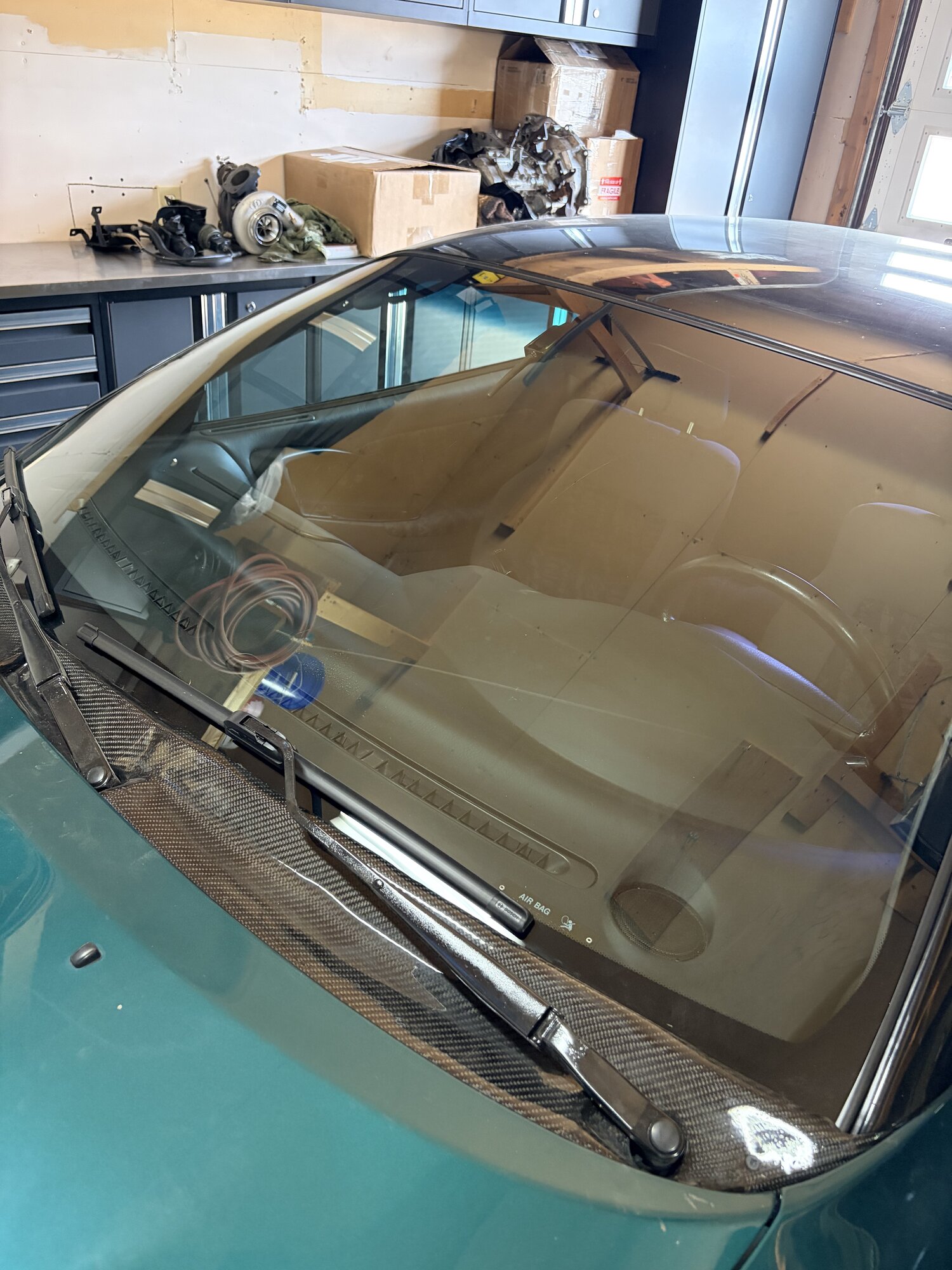

November 2025 Update – Carbon Fiber Hood & Hatch Tease​

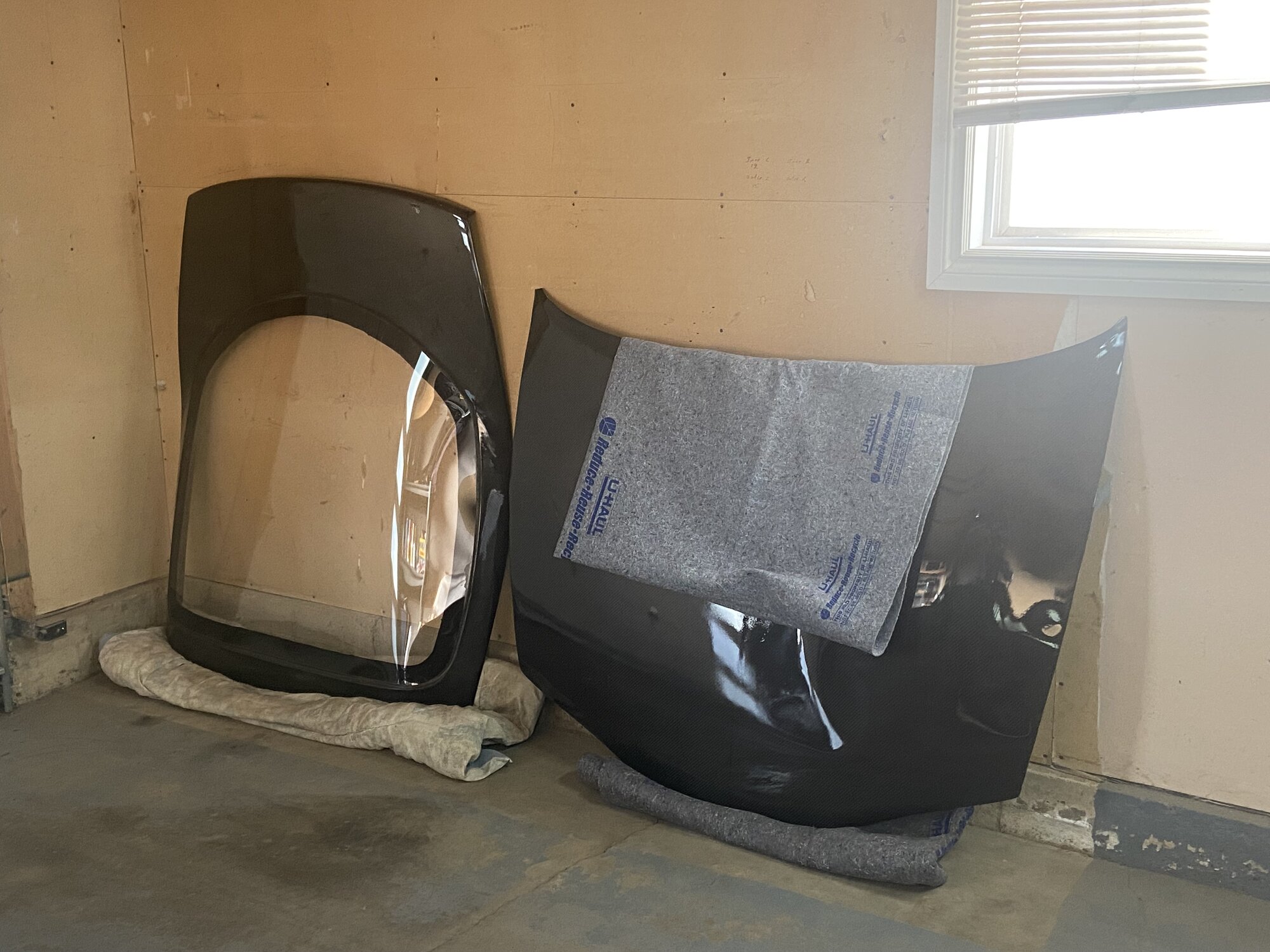

By November 2025, my carbon fiber hood and hatch had arrived—and were sitting patiently, still waiting for installation (and yes, they still are, haha).

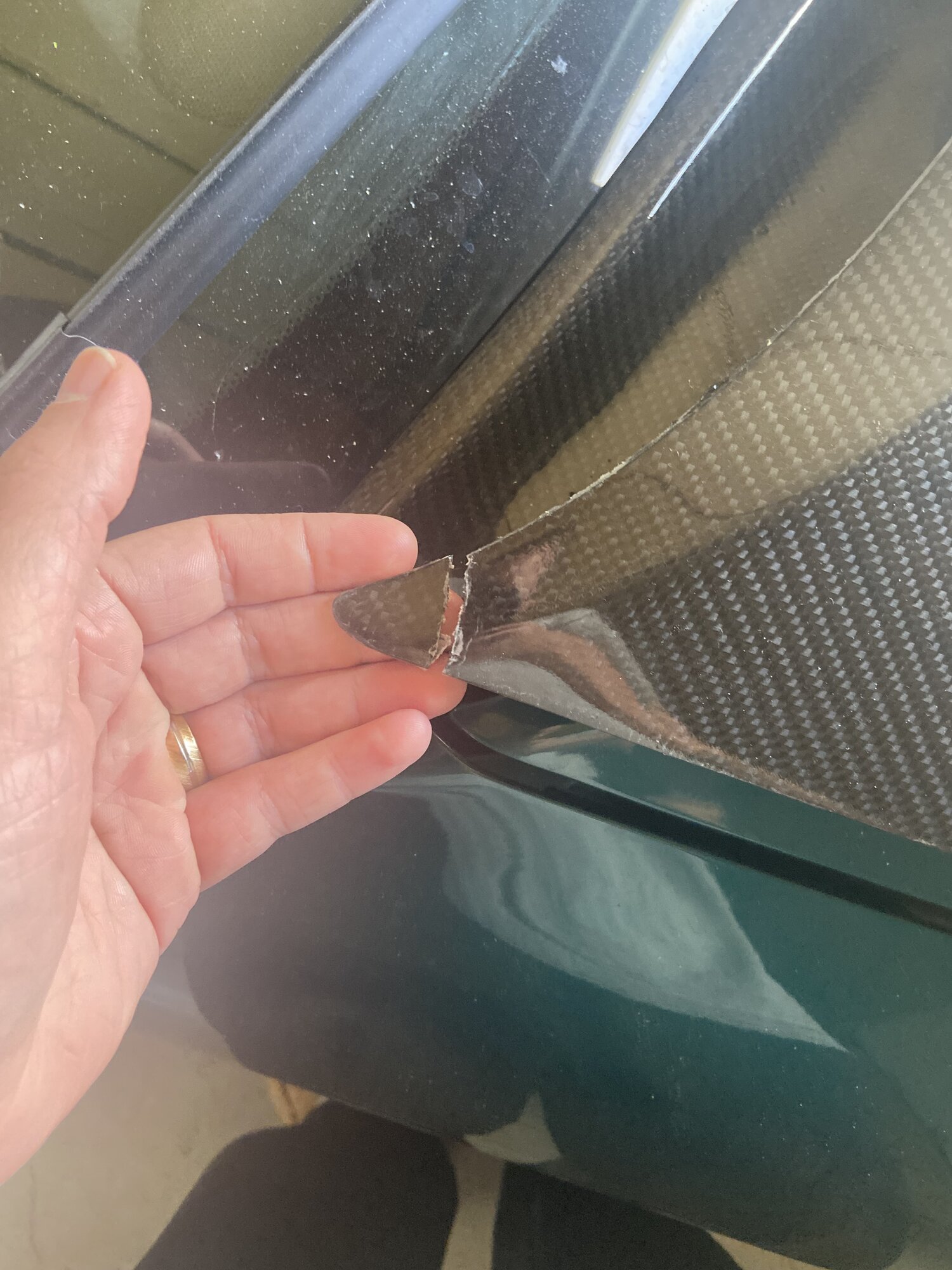

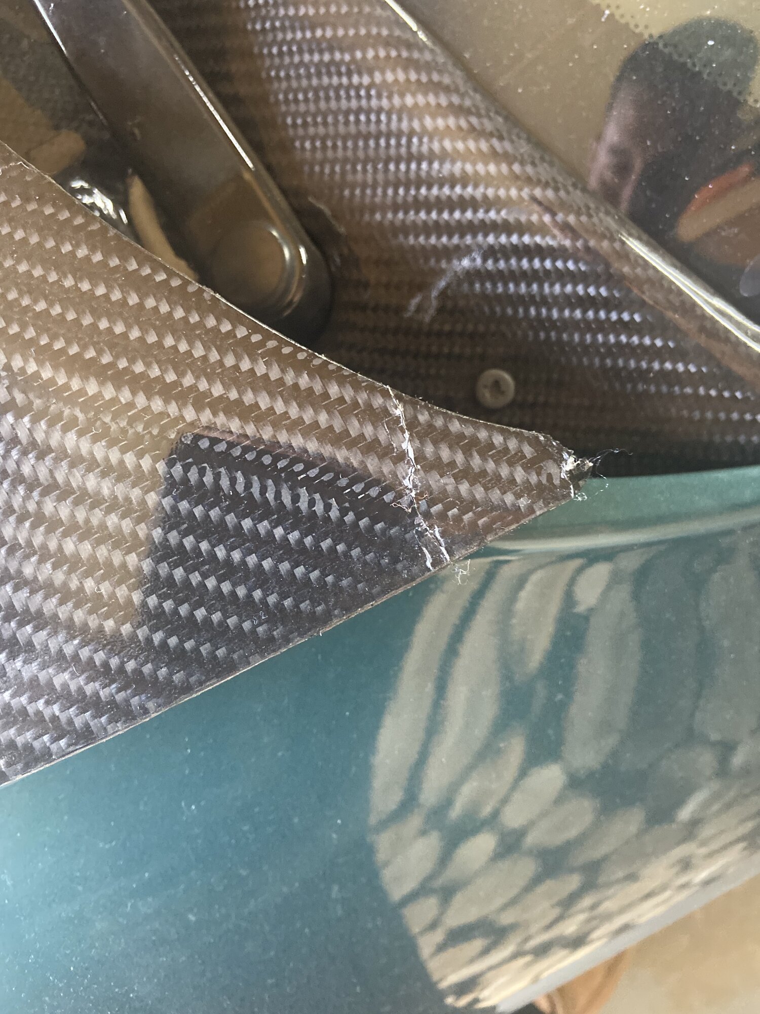

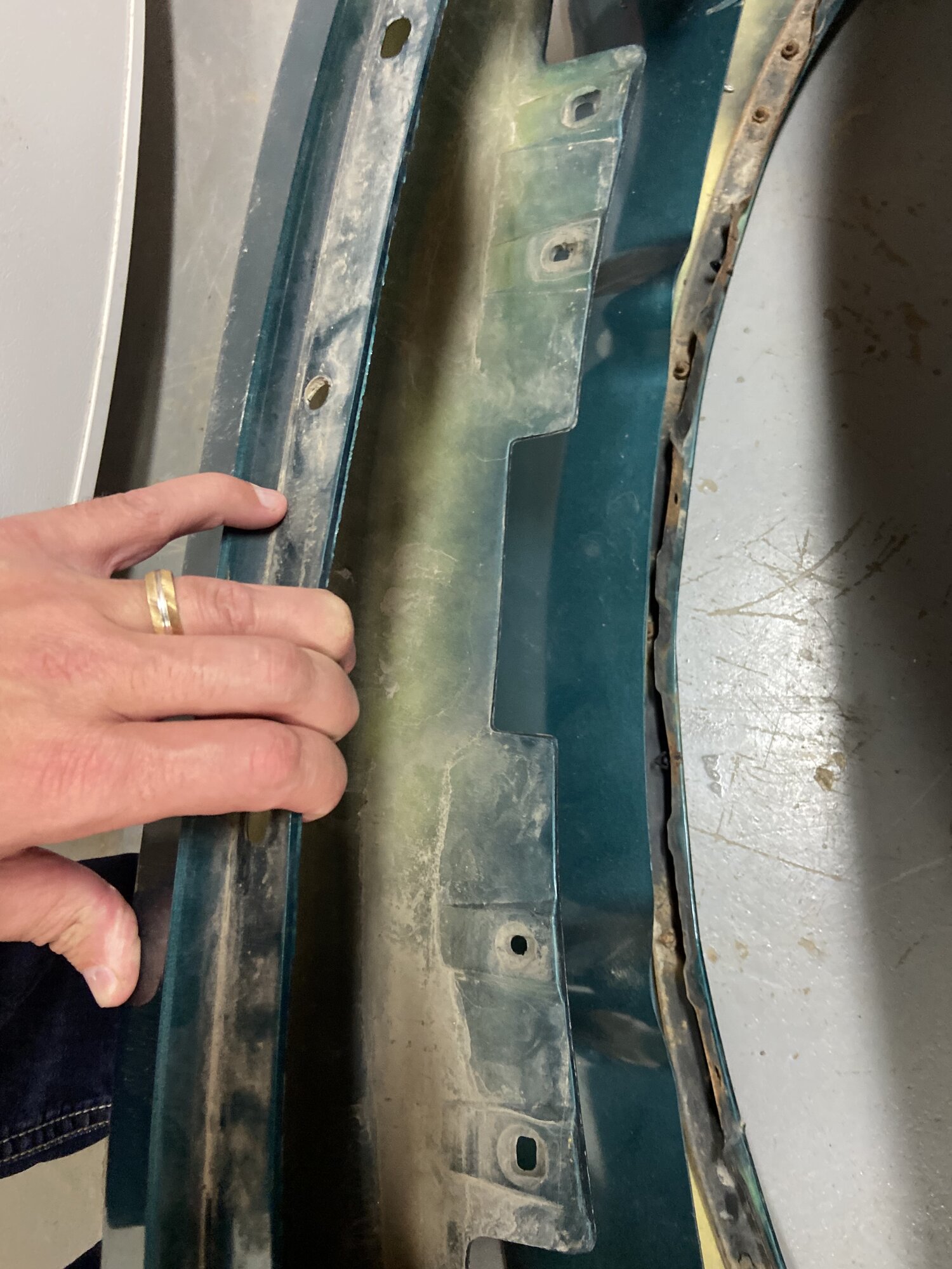

Unfortunately, when the hood arrived, I discovered some damage from shipping. Both front corners had cracked: one corner had completely broken off, while the other was still attached but split through. Not exactly the kind of “carbon” I was hoping to see!
Thankfully, the manufacturer stepped up and offered to repair the hood free of charge, even helping to arrange return transport to take care of the damage.
That didn’t stop me from mocking it up on the car just to see how it’ll look once installed for real—and let’s just say, it’s going to transform the whole appearance of the Talon. Really can’t wait to get it fitted properly once it comes back repaired.

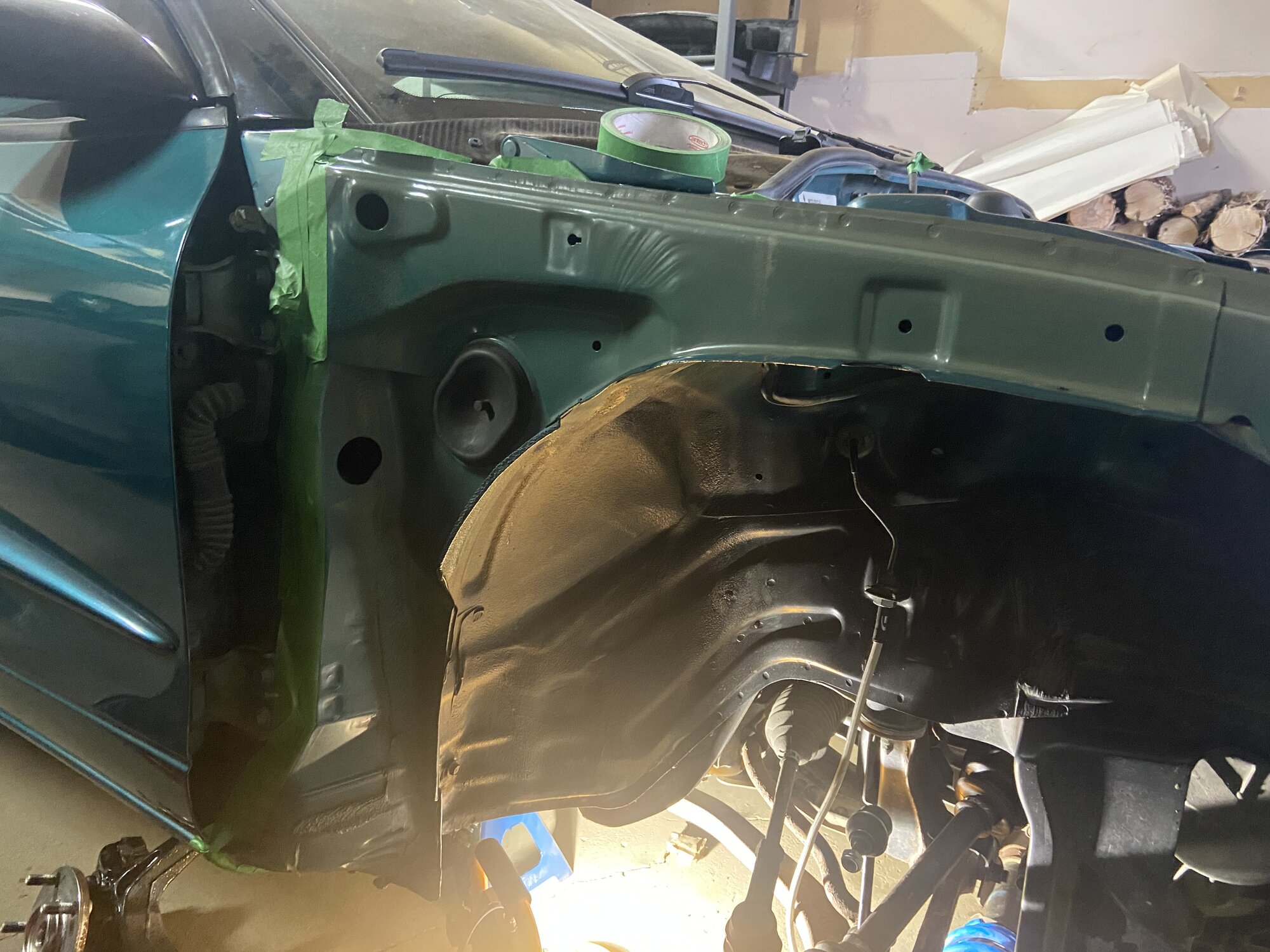

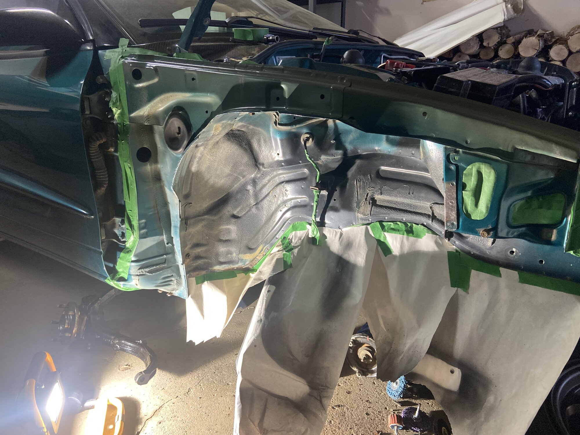

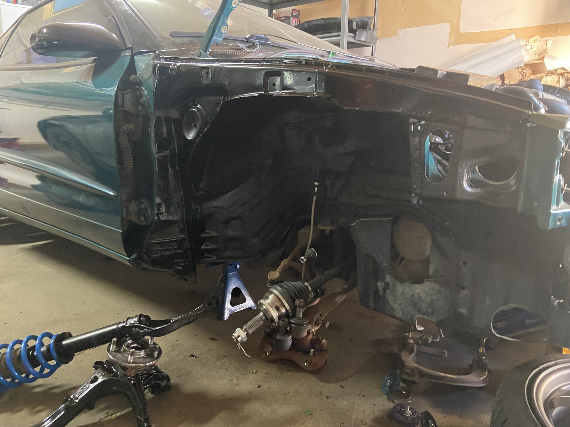

December 2025 Update – Winter Wrenching & Preventative Body Work​
By December 2025, winter had fully set in here in Fort McMurray, AB, making it the perfect time to tackle some preventative body work — specifically undercoating the front wheel wells and suspension components.

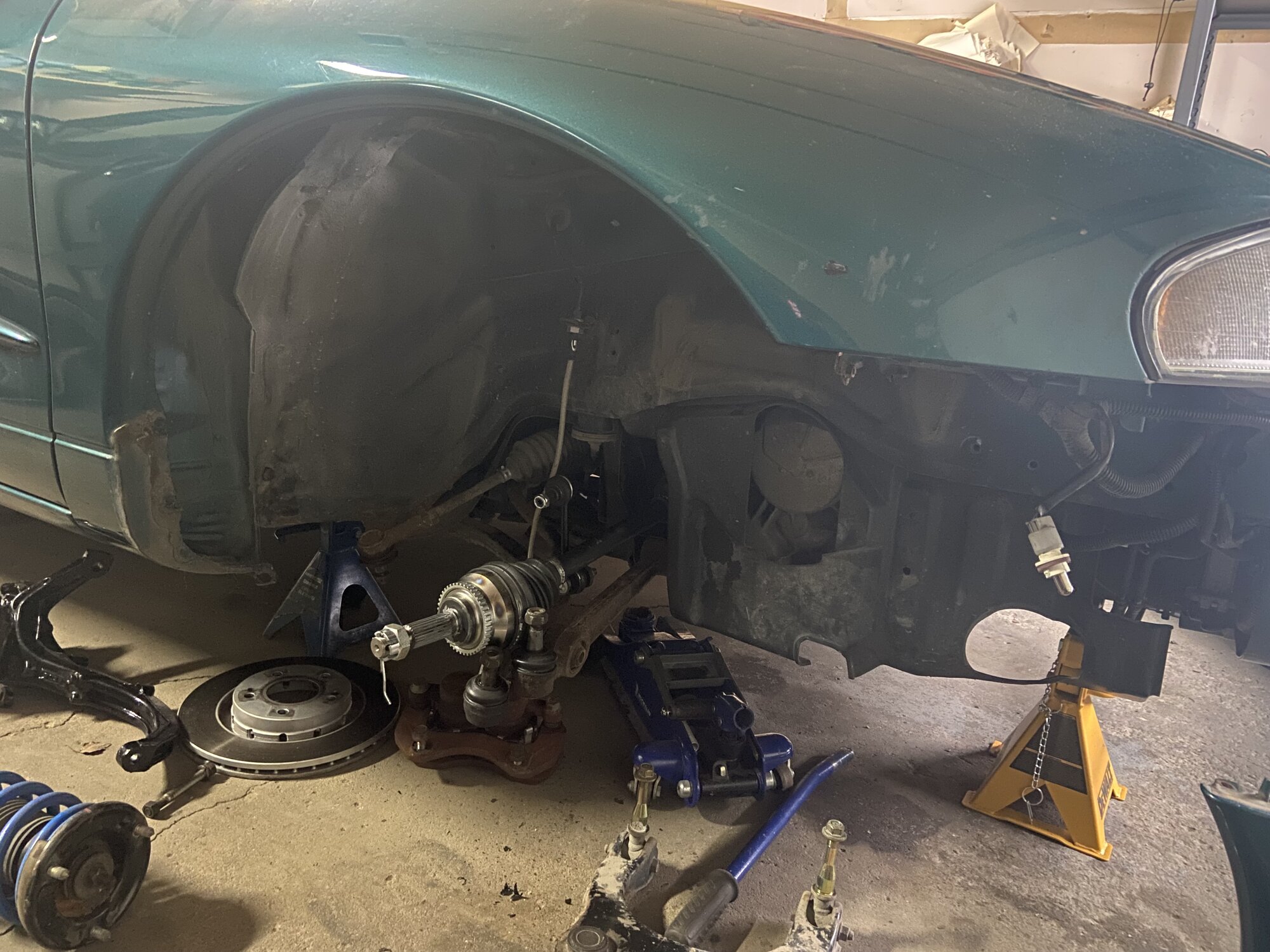

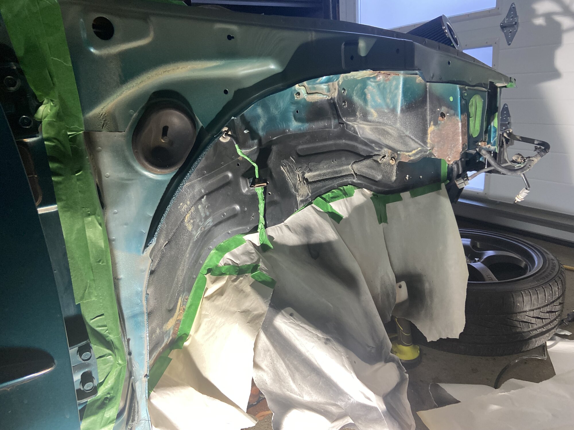

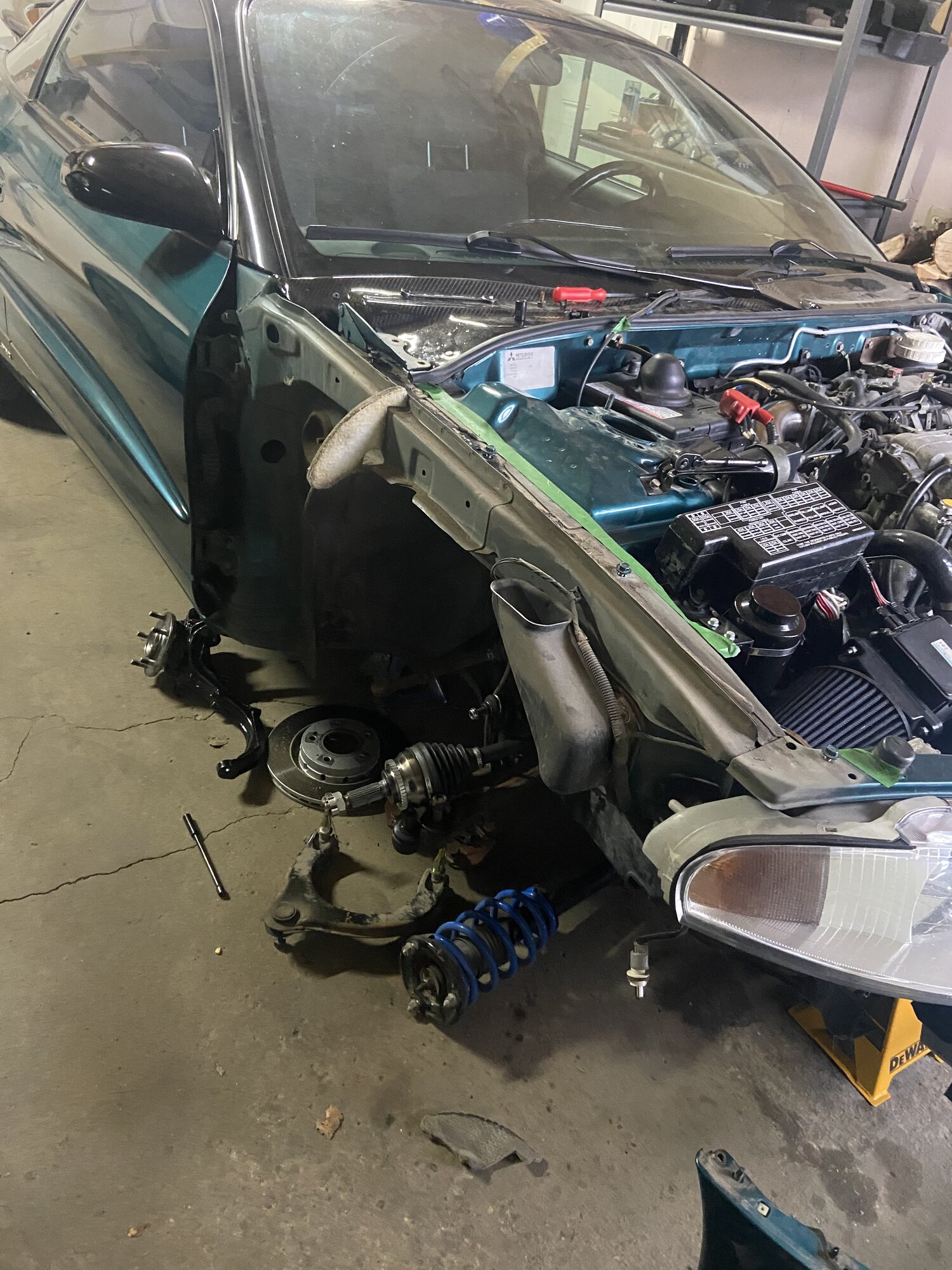

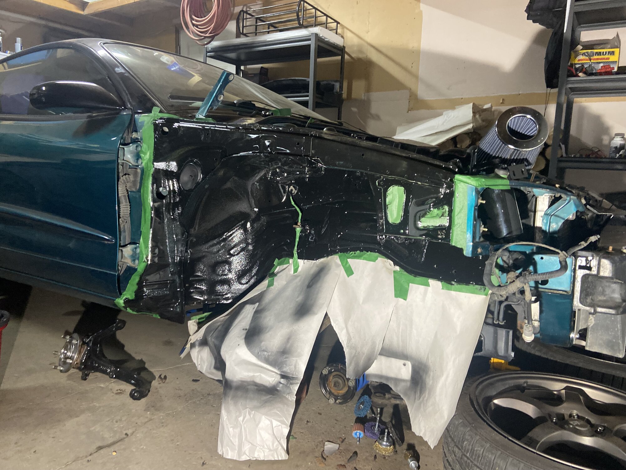

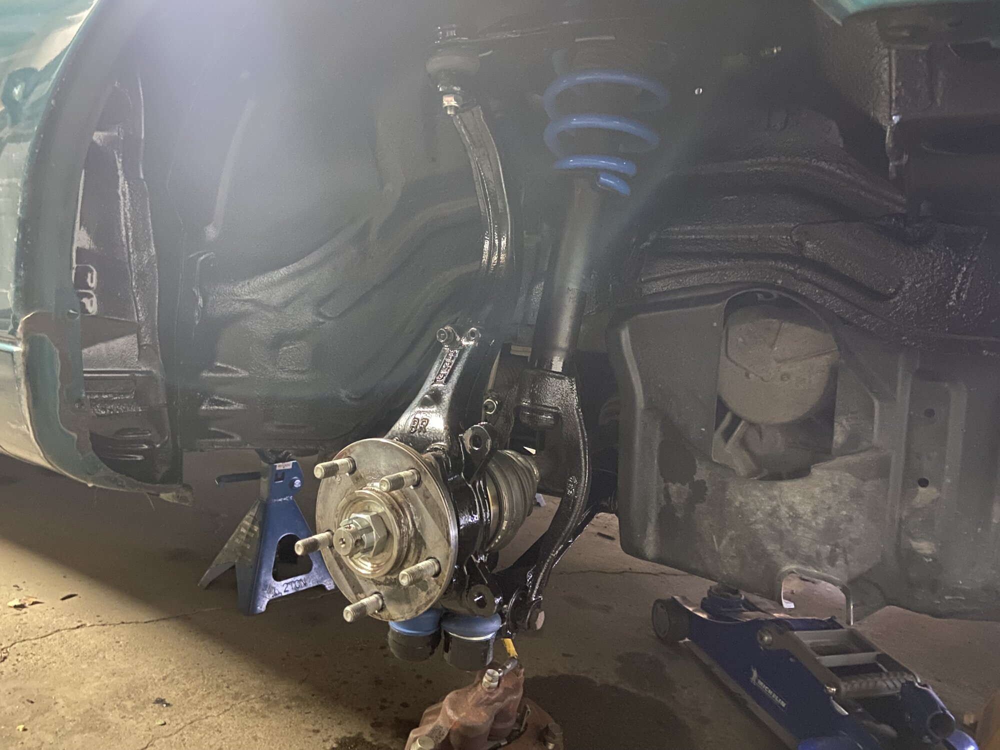

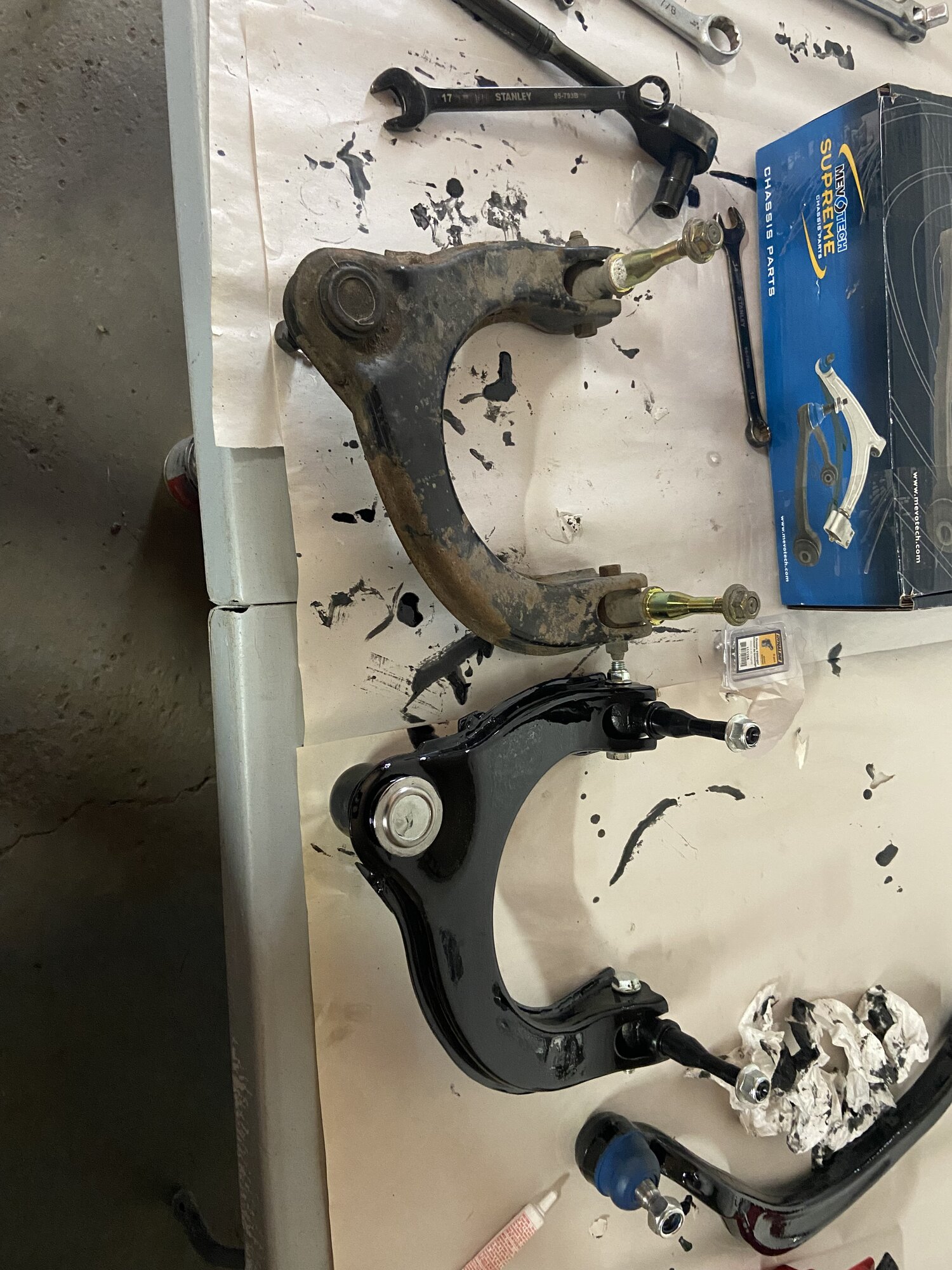

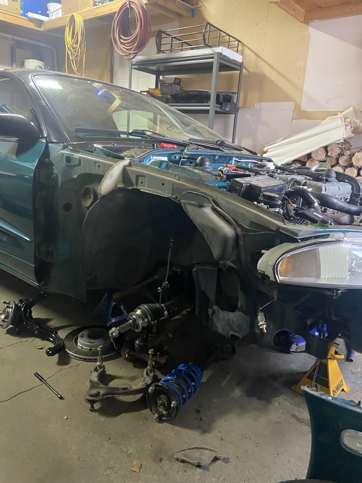

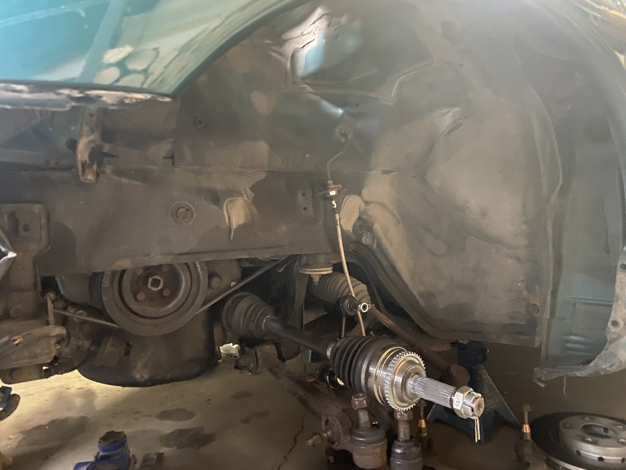

To get started, I completely stripped the front suspension and removed both front fenders. Judging by the condition of the factory body silicon, I’m fairly certain I’m the first person to ever remove them — the original OEM sealant still firmly bonded the fenders to the chassis and had to be carefully pried loose after unbolting.
Refreshing the Front Suspension​
While inspecting the control arms and bushings, the age of the car showed clearly — after all, she’s 28 years old now, so I sourced a full set of fresh replacement components with greaseable ball joints:
  • Upper control arms
  • Lower straight arms
  • Lower toe arms
  • Tie rod ends

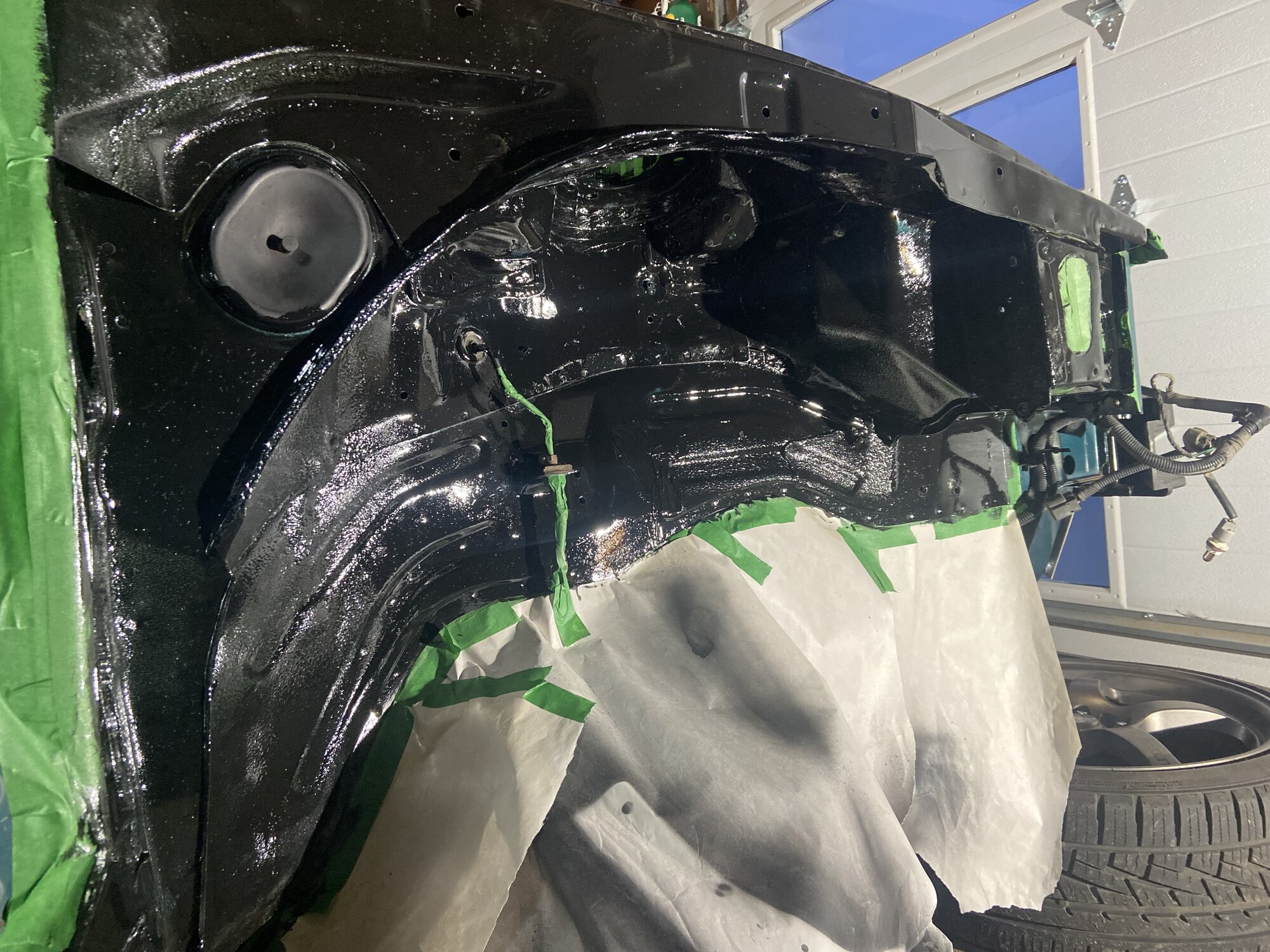

Before installation, I coated all of the new parts for extra corrosion resistance and long-term protection.
Undercoating Process​
For the wheel wells, I wanted to make sure everything was properly cleaned and sealed:
  1. Cleaned and wire‑wheeled all surfaces
  2. Sanded thoroughly
  3. Cleaned and degreased again
  4. Applied two coats of POR15
  5. Added one coat of rubberized undercoating
  6. Finished with a top coat of enamel chassis paint
Of course, all surface rust was removed ahead of time — the goal was to ensure I never have to worry about strut tower rust during my ownership.
After everything cured, I reassembled the front end and also undercoated the inside of each front fender before reinstalling them.
Now it’s just a waiting game until summer when I can take the car in for an alignment and get a proper feel for the refreshed suspension setup.
Eventually, I'll add a set of FEALS Coilovers to complete the suspension setup.

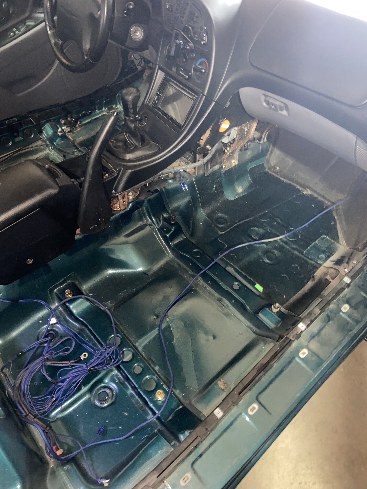

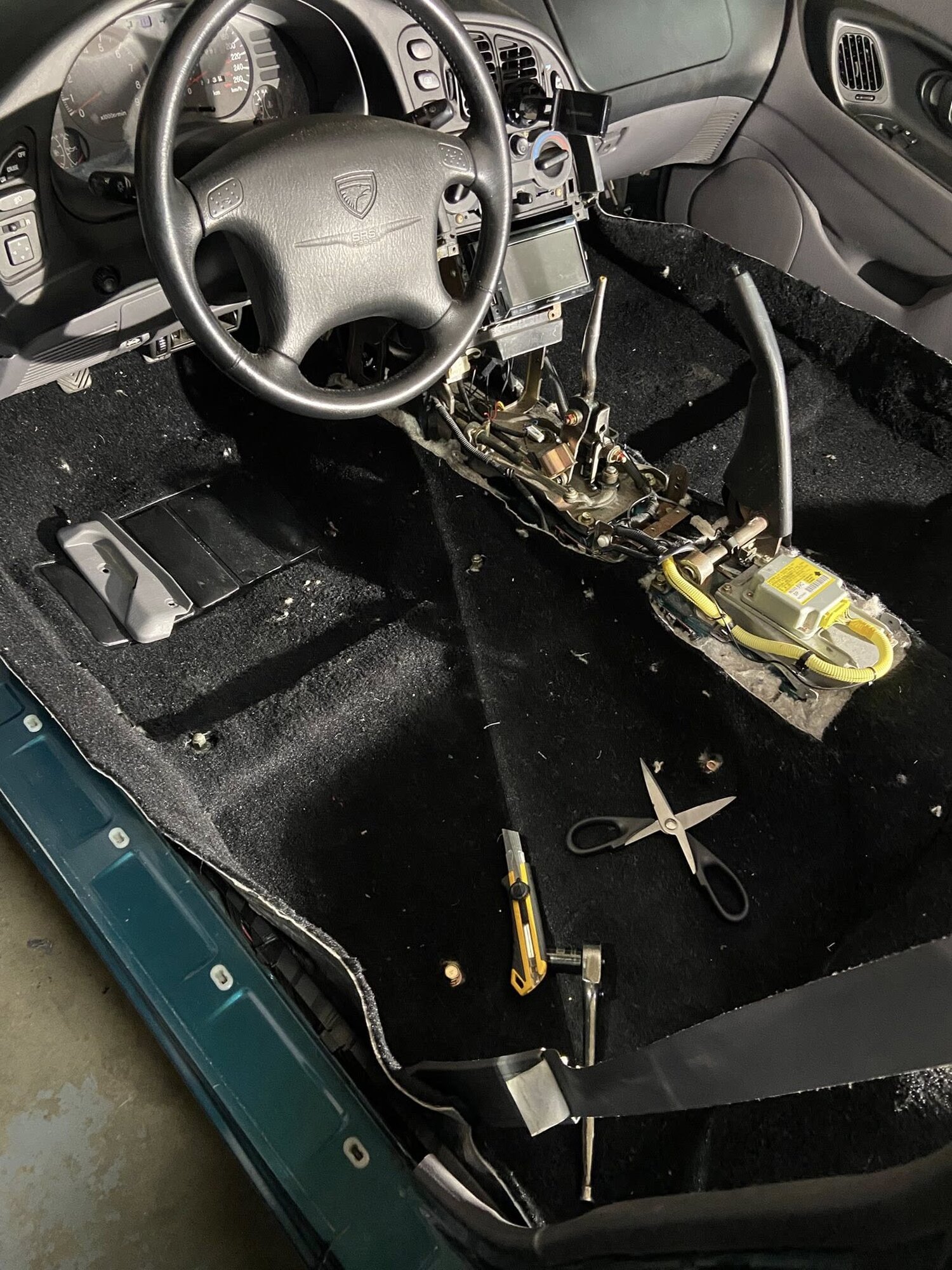

With the front suspension refresh complete, I shifted focus to two comfort and functional upgrades: finishing the foundation of the interior sound deadening and relocating the battery to the trunk to tidy up the engine bay for future catch can installations.

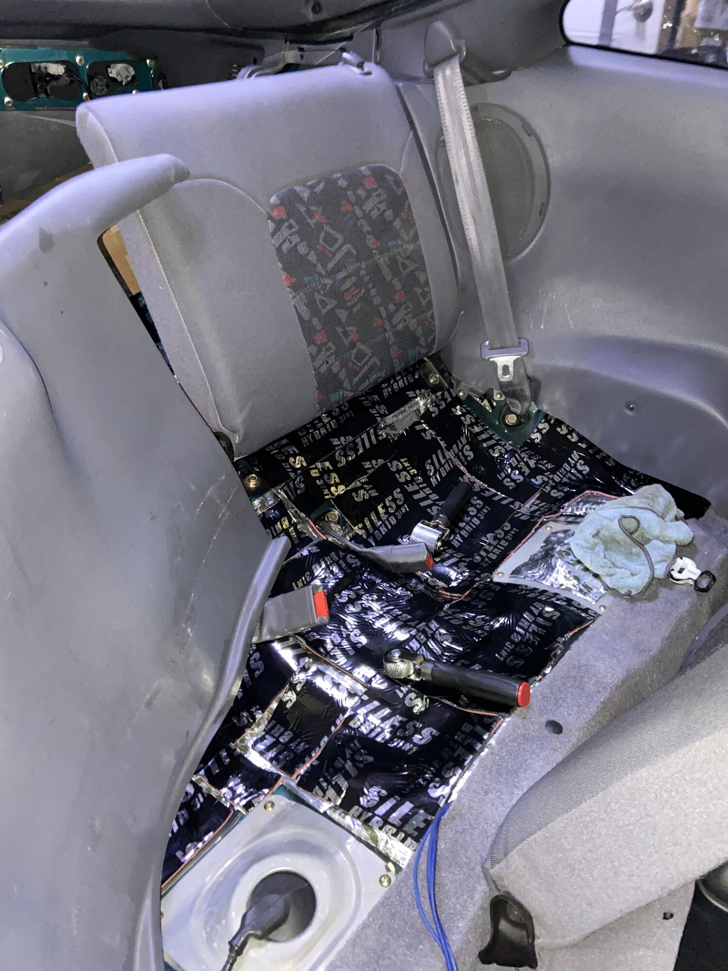

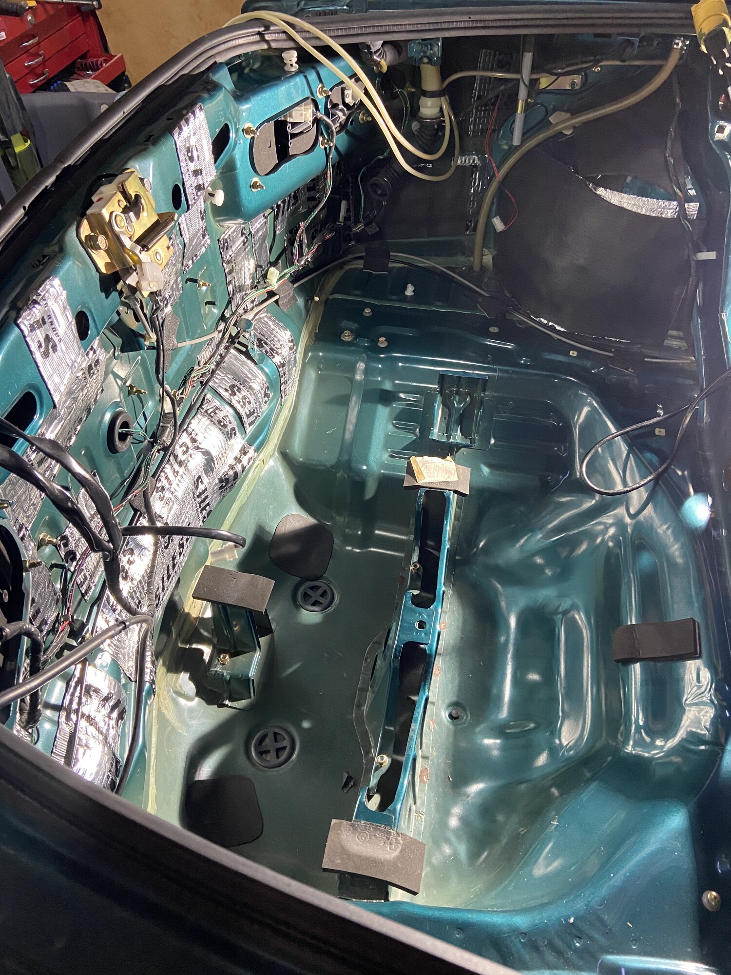

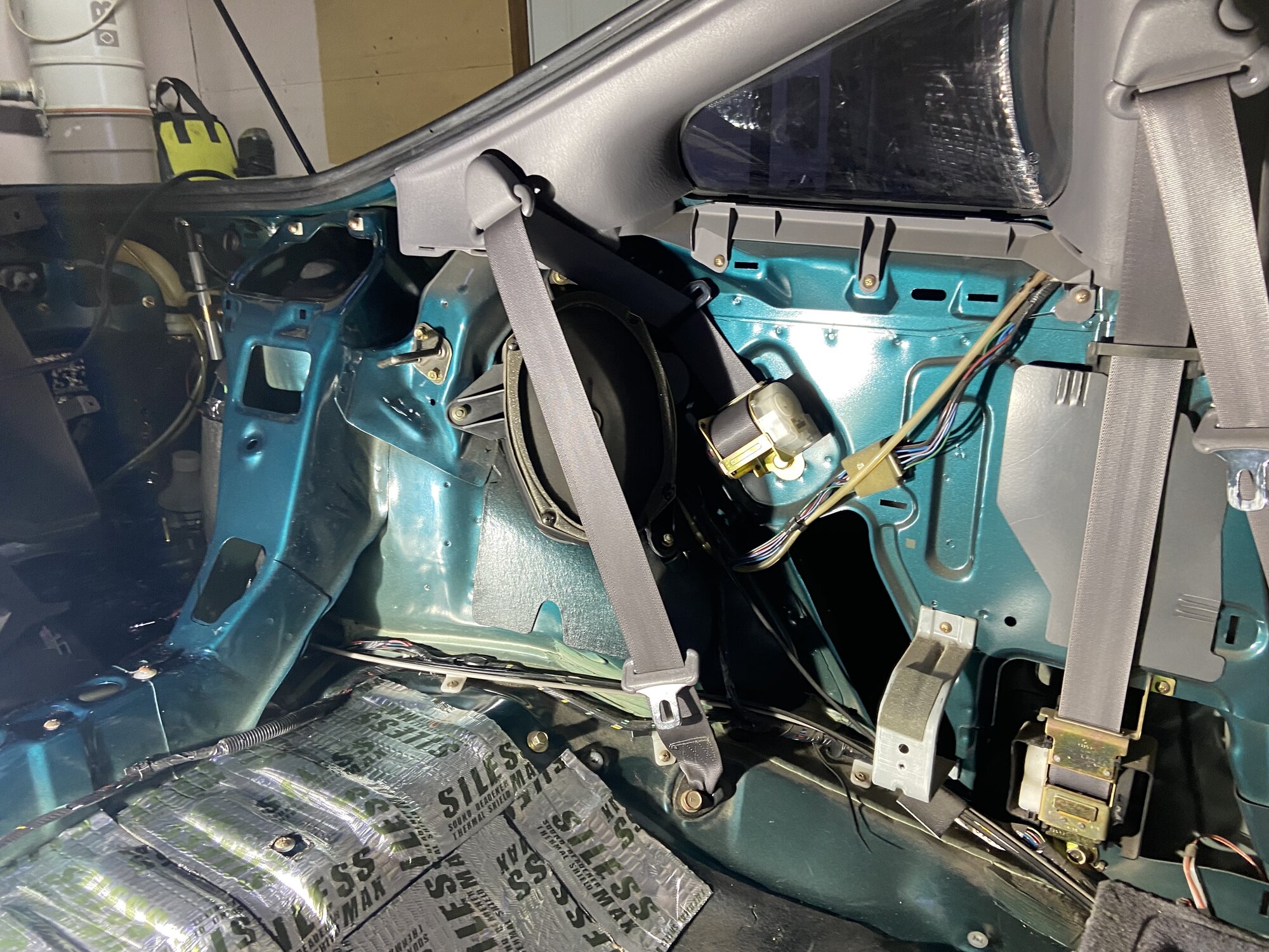

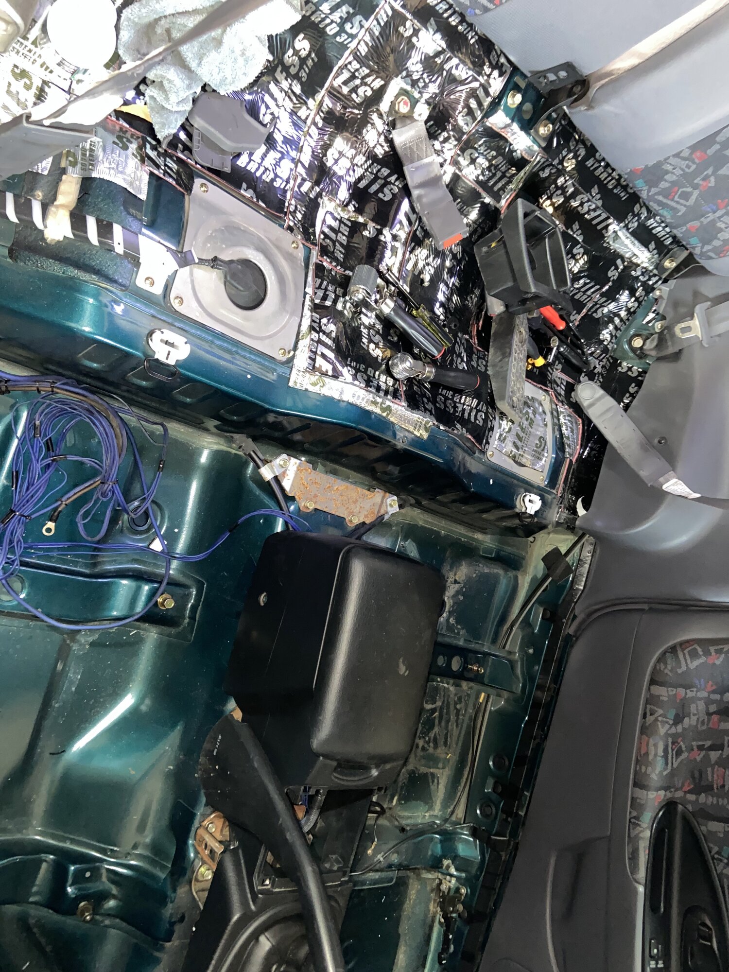

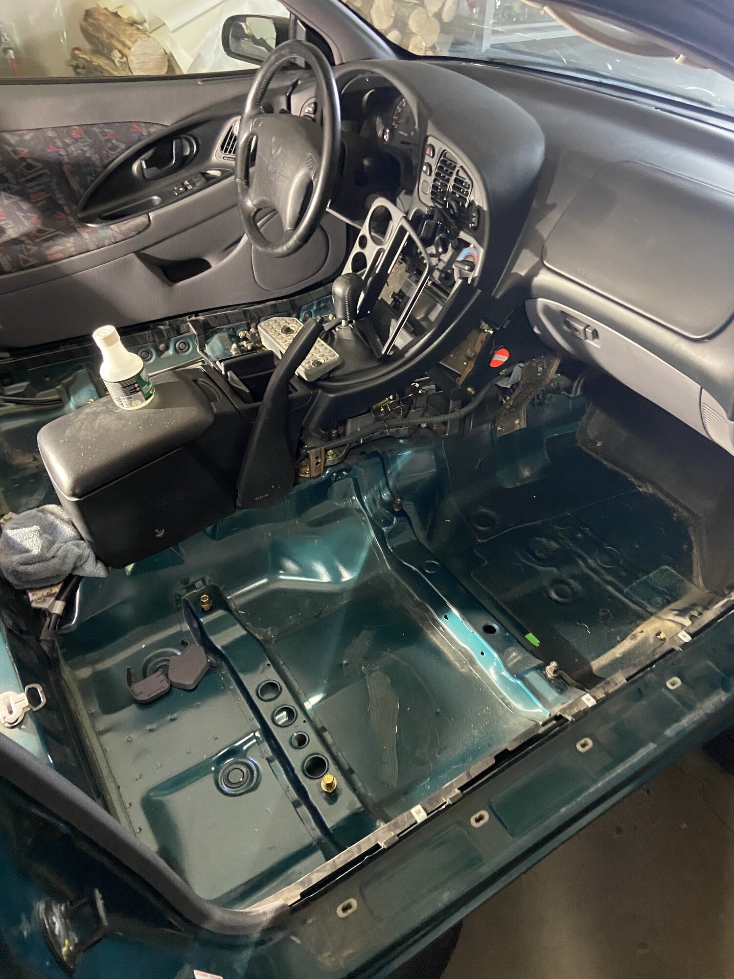

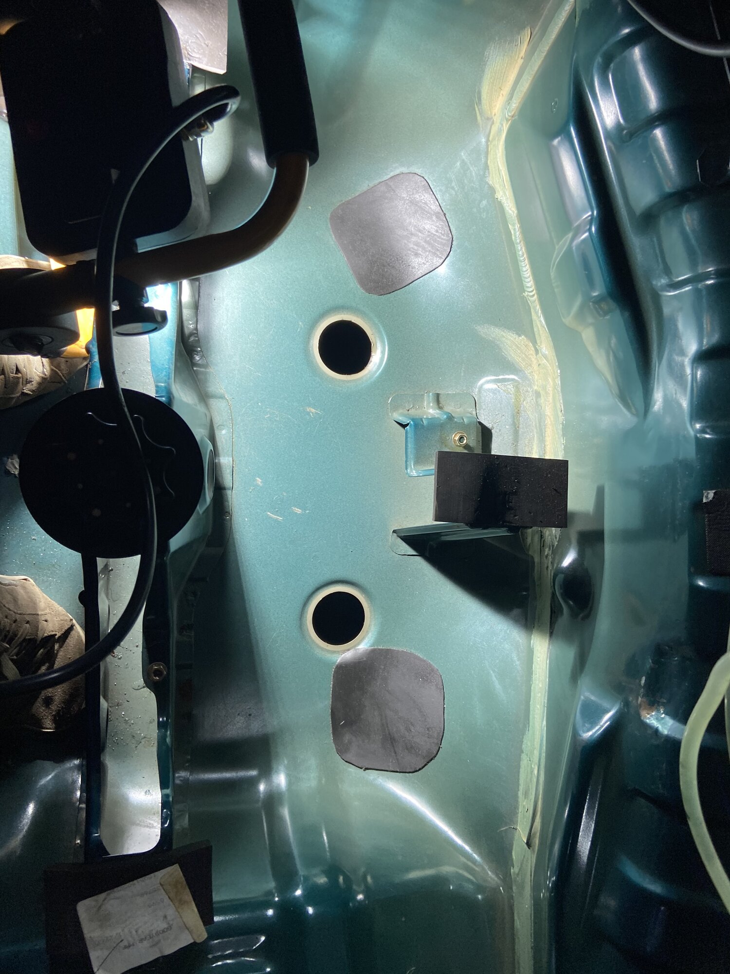

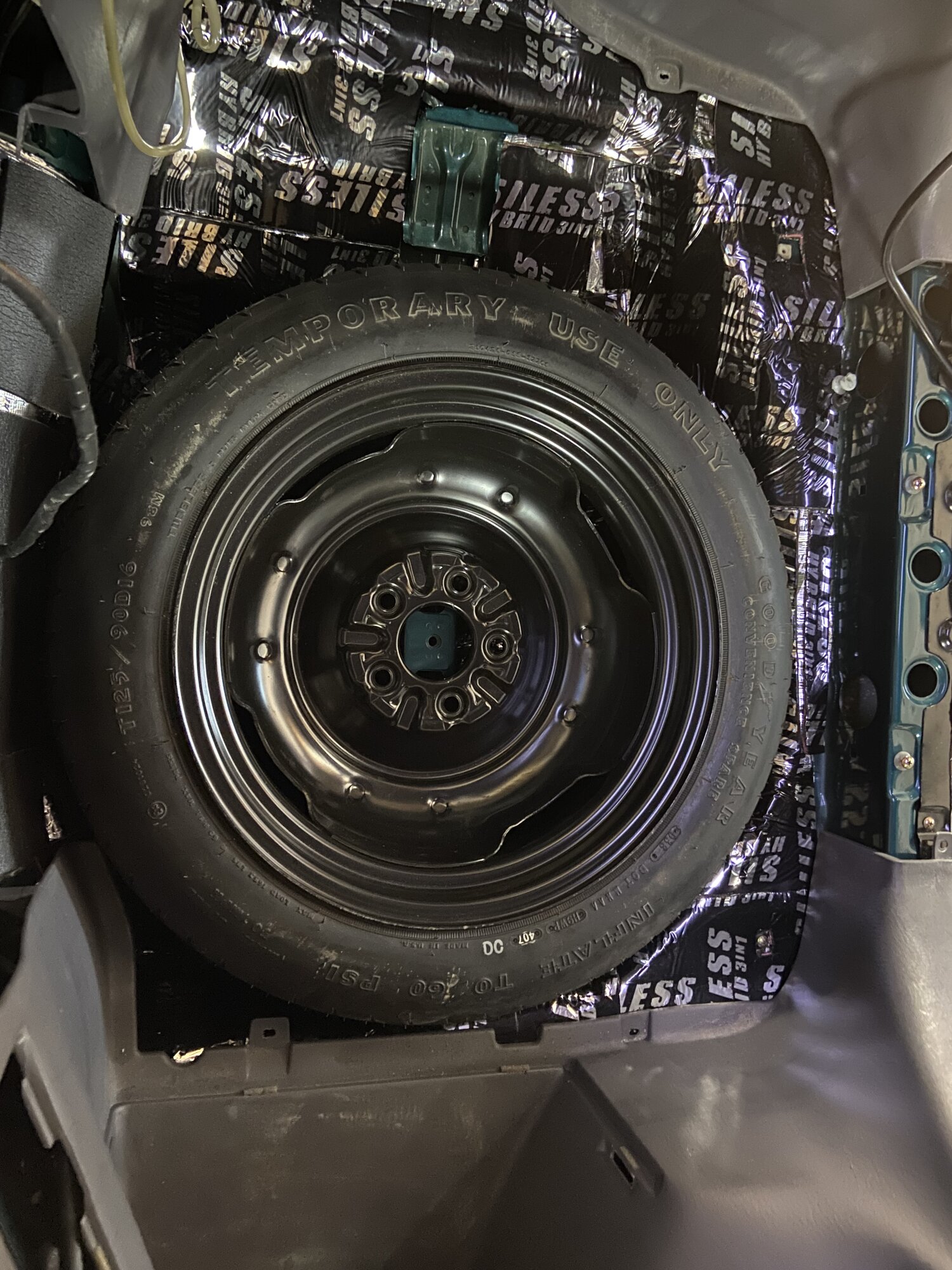

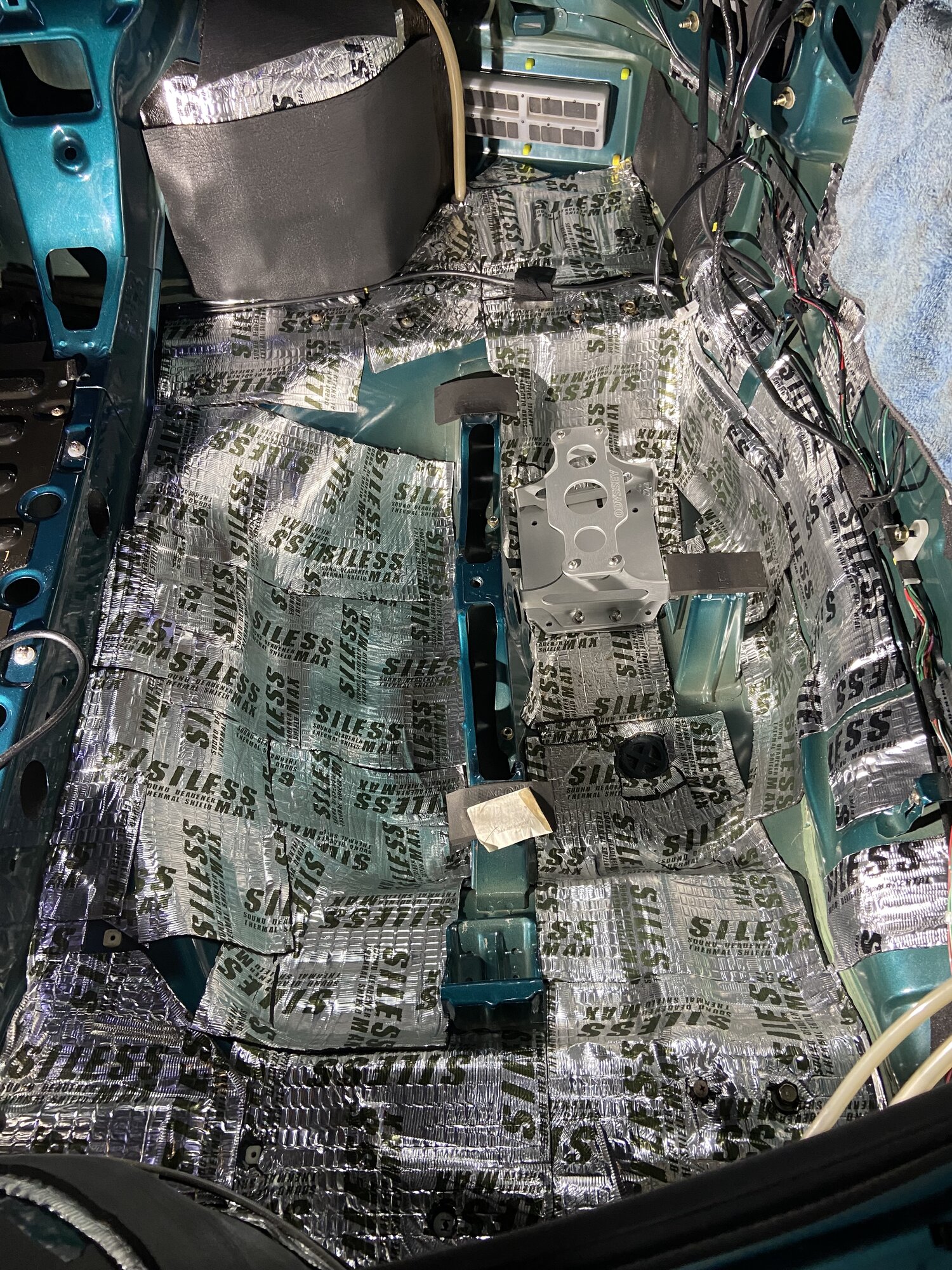

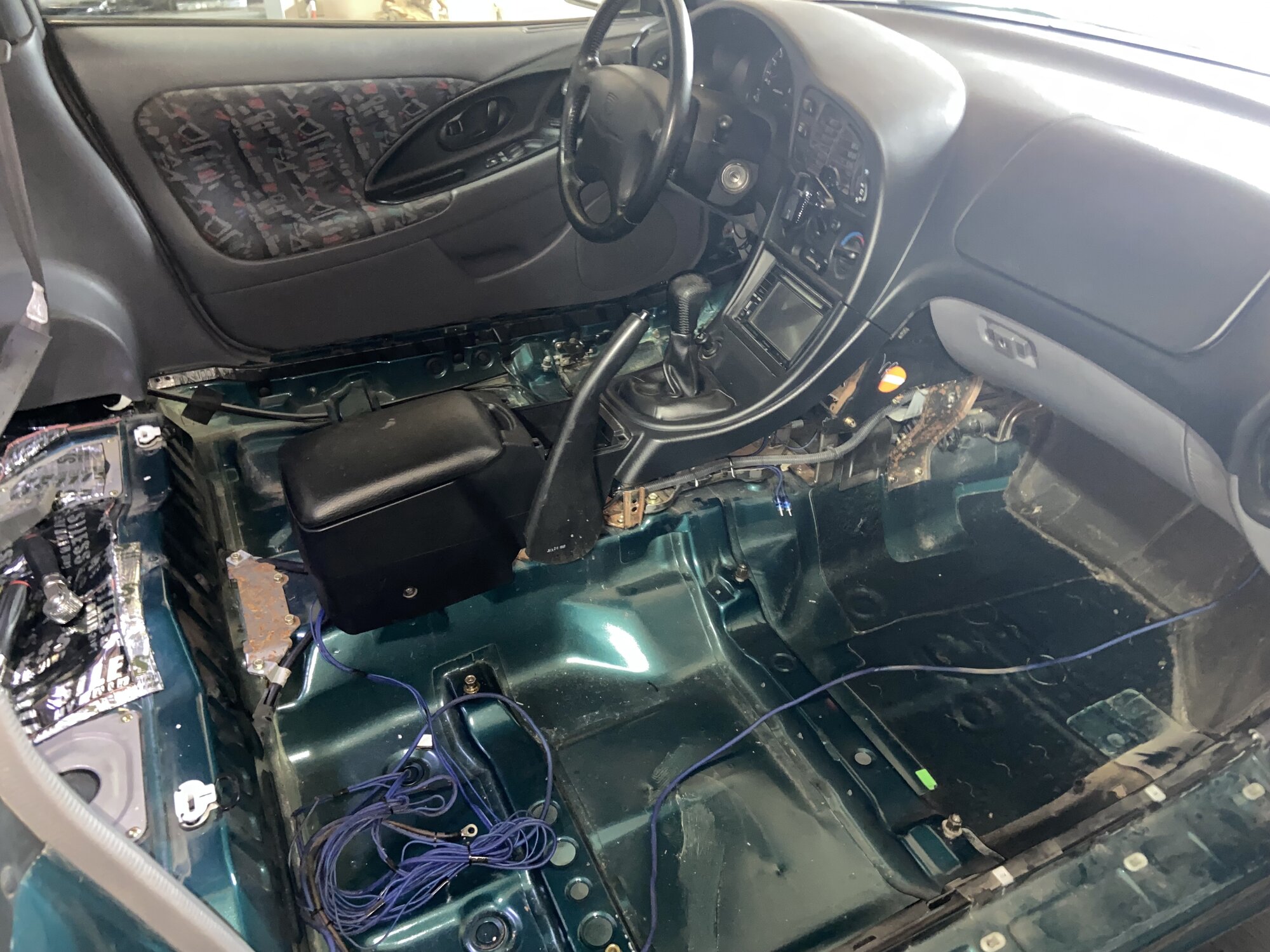

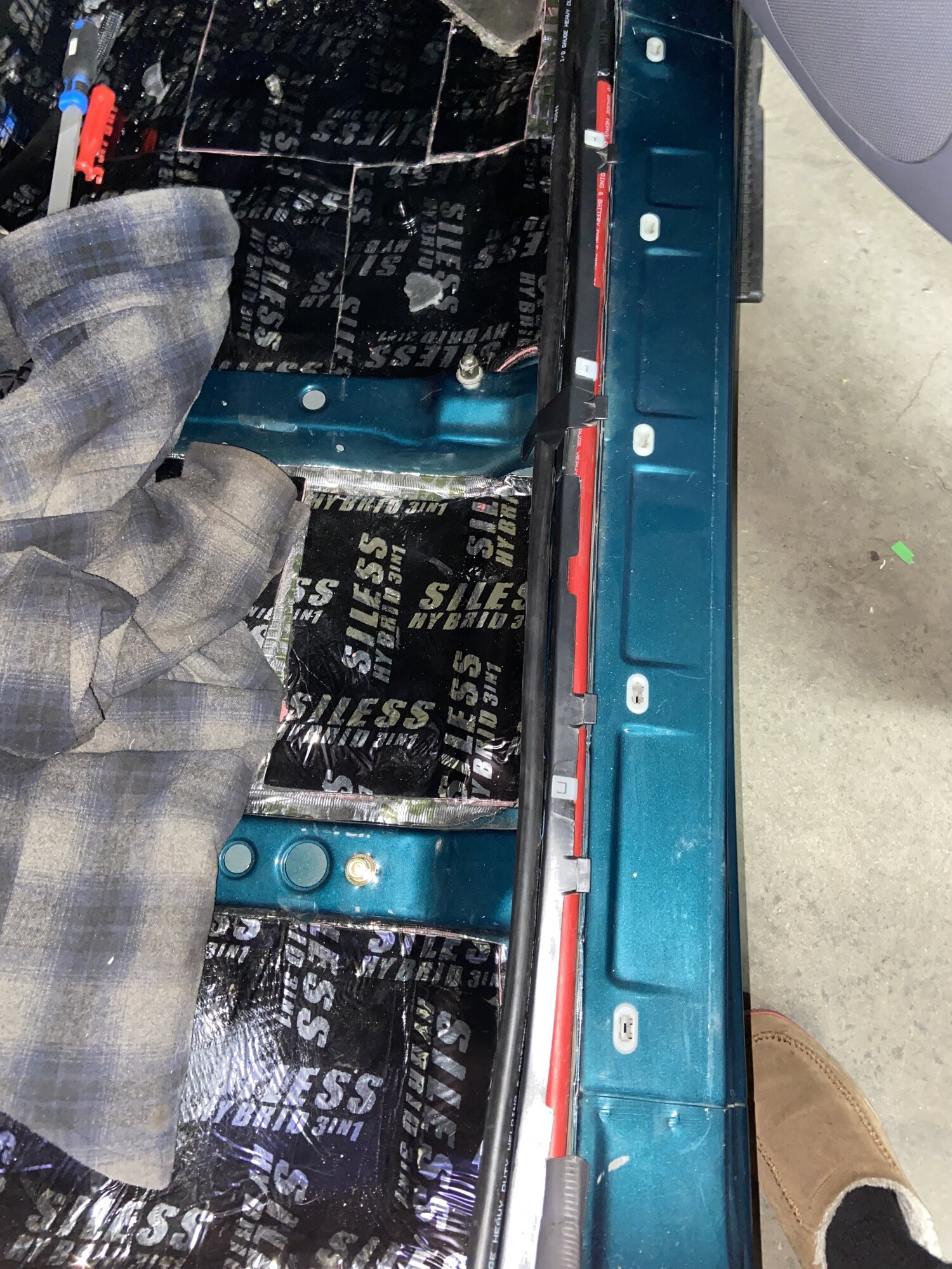

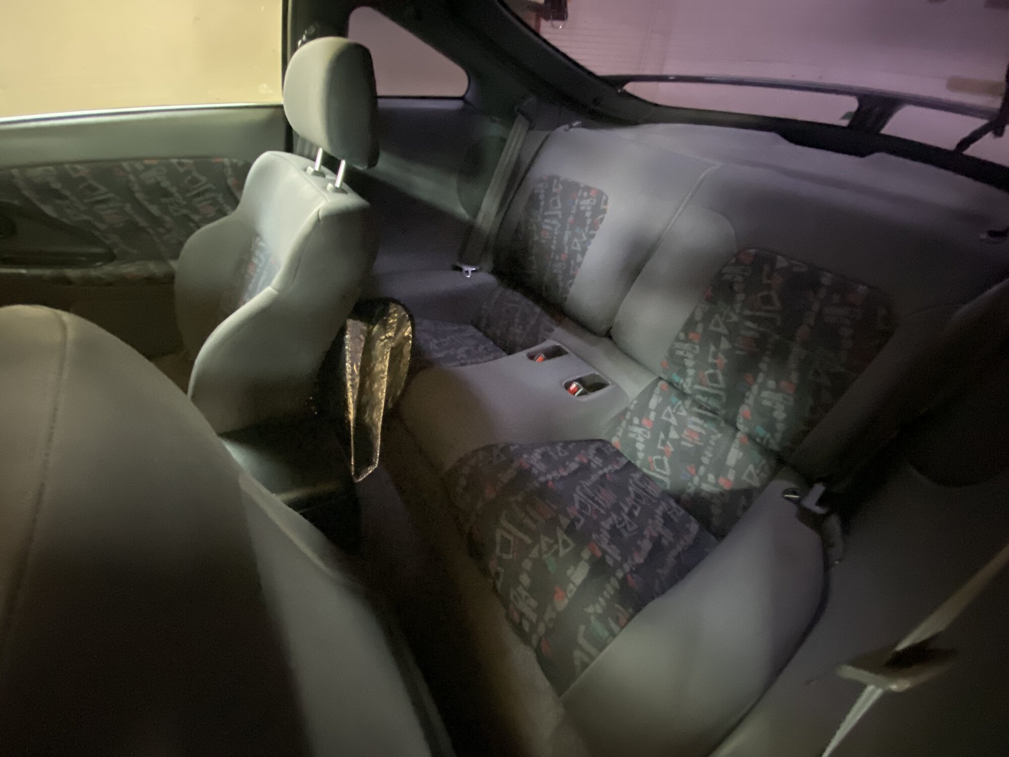

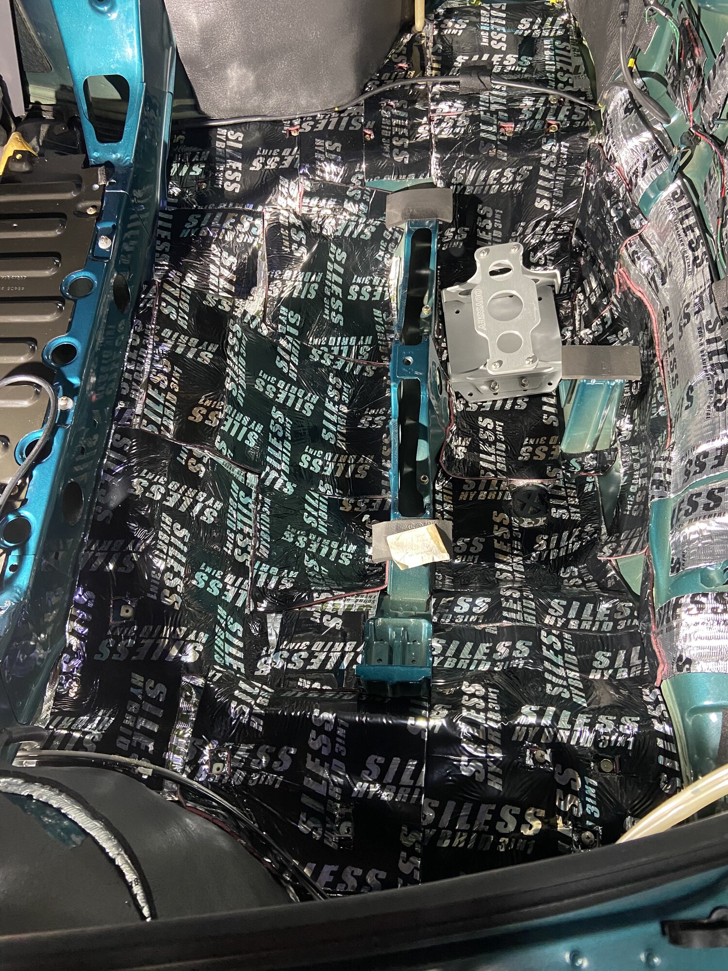

Sound Deadening and Cabin Insulation
When stripping the interior, I was super pleased with the condition of the body — absolutely no rust anywhere, and only a fine layer of dust from years of use. A simple wipe‑down and light degreasing were all that was needed before starting.
I used a combination of Siless materials for damping and acoustic control:
  • Siless Max 120 mil constrained-layer damping (CLD) topped with Siless Hybrid 3‑in‑1 (CLD/CCF/MLV) throughout the cabin floor, rear seat area, and trunk.
  • Siless 80 mil layered with 157 mil closed‑cell foam (CCF) along the rear quarter interior sides and trunk side walls for vibration and airborne noise isolation.
Every sheet was applied with full roller pressure and sealed in overlapping seams for maximum coverage. The result is an incredibly solid feel everywhere — panels sound muted when tapped, the rear quarters are acoustically dead, and the overall cabin isolation is dramatically improved. I’ll be finishing the doors and interior roof panels later this year to complete the sound-dampening package.

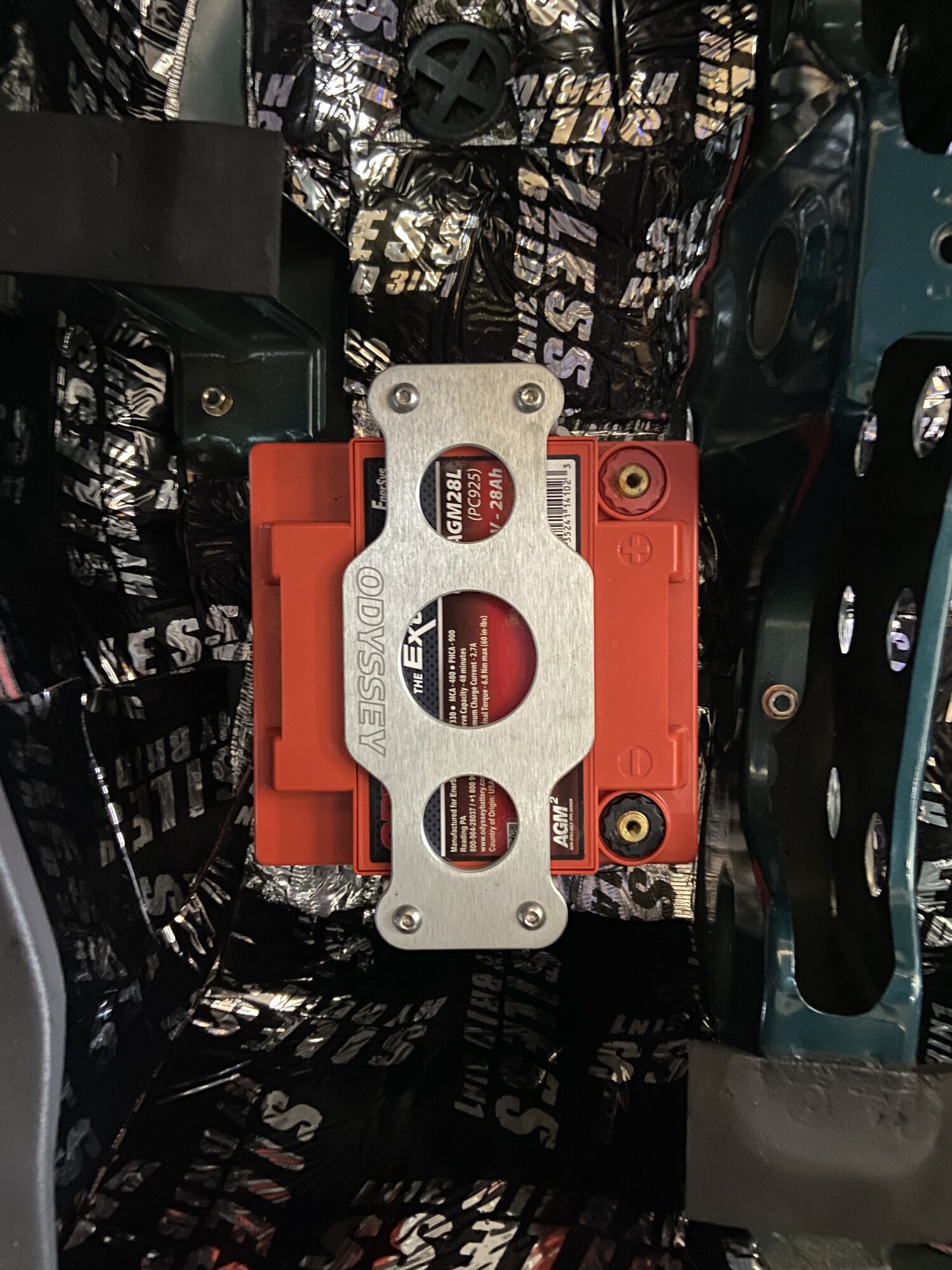

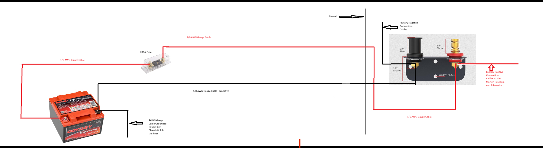

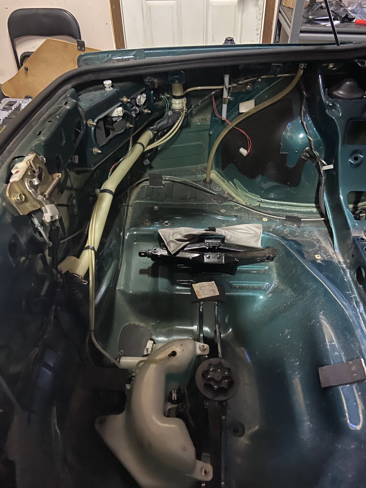

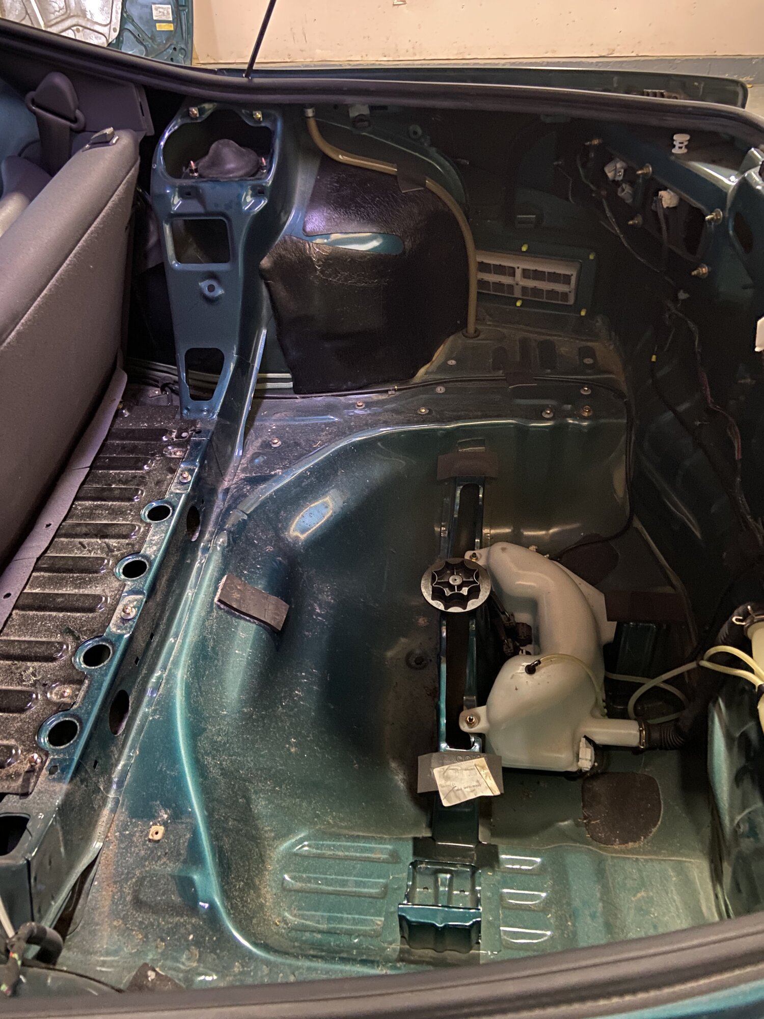

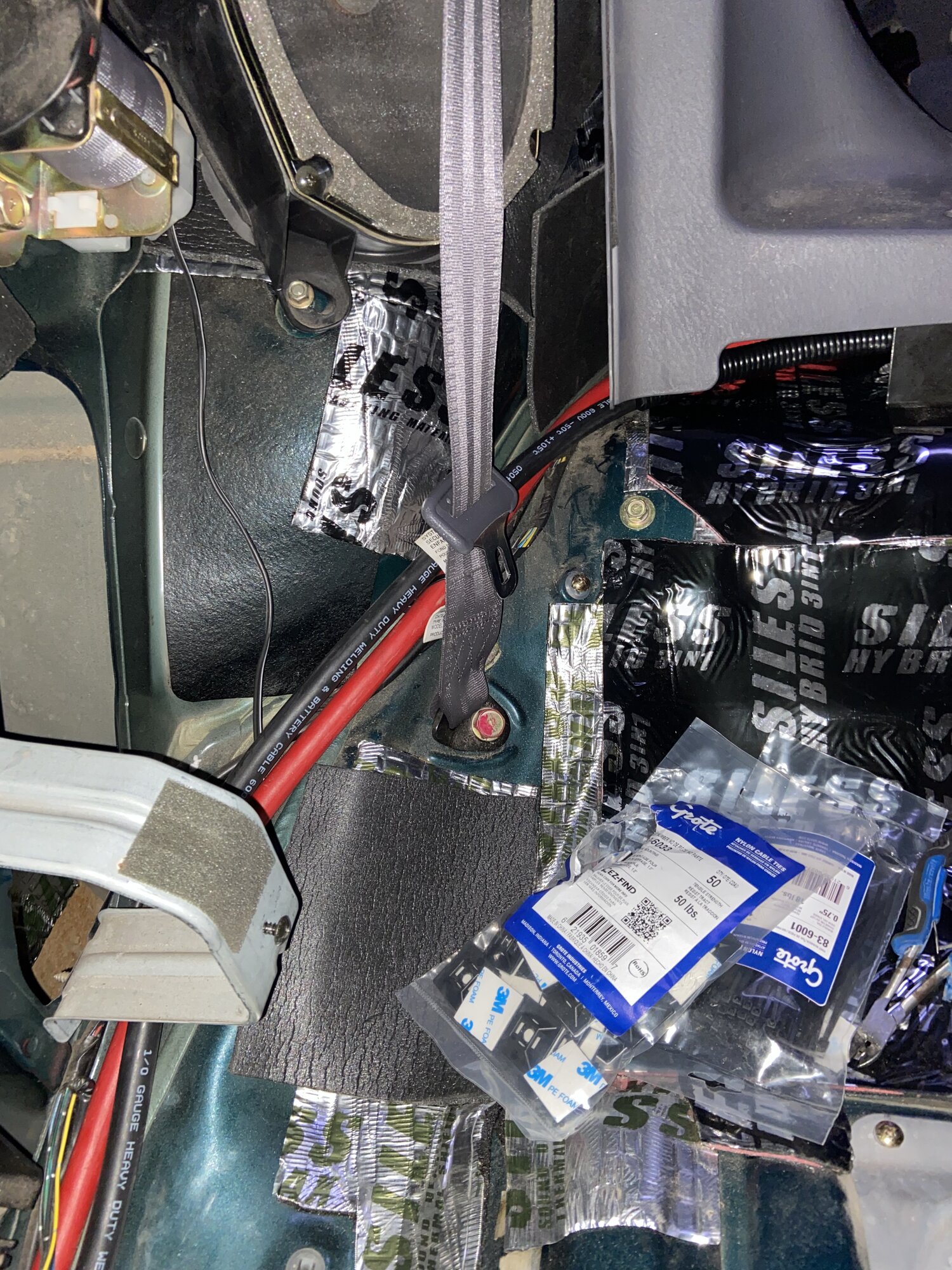

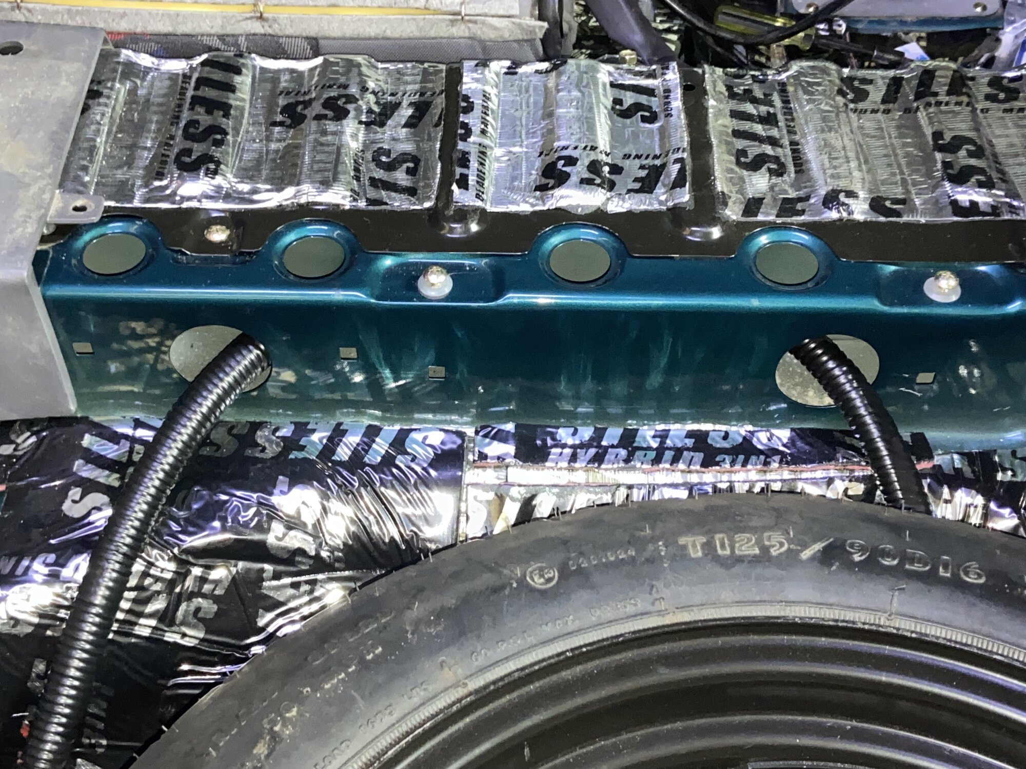

Battery Relocation to the Trunk

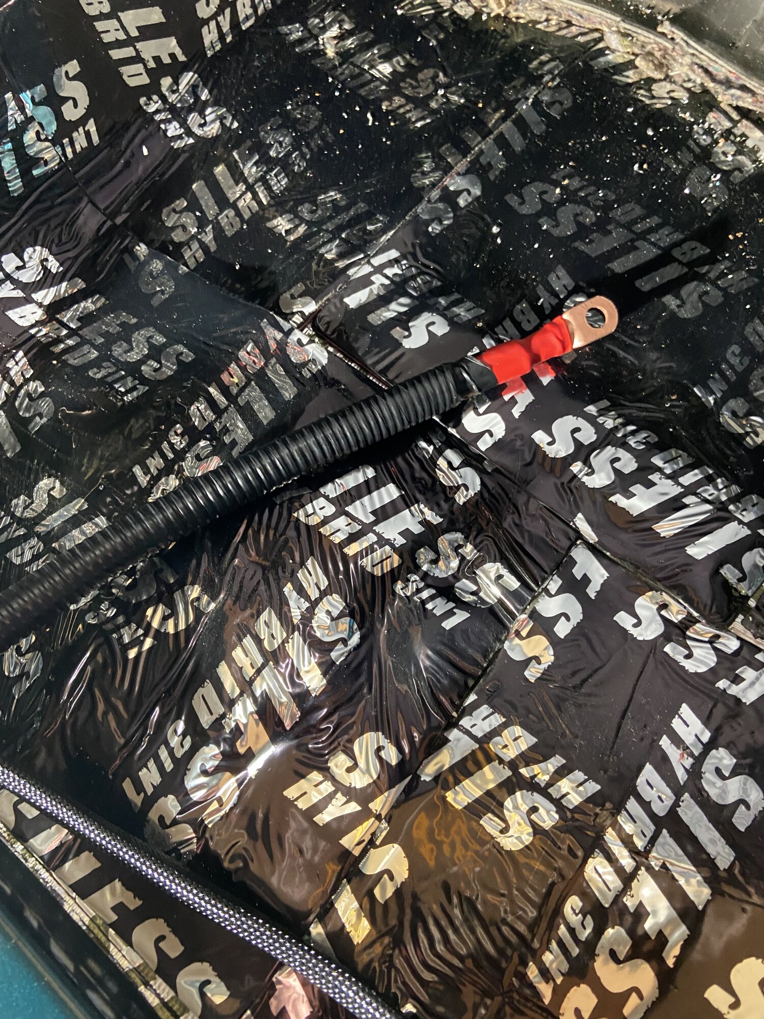

Once the interior was prepped, I moved on to relocating the battery to free up space in the engine bay.
For this setup, I used an Odyssey AGM28 sealed battery, which doesn’t require a separate battery box. It’s held firmly in place with an Odyssey aluminum hold‑down bracket, bolted directly to the trunk floor beneath the spare‑tire well.
To make room, I deleted the factory washer‑fluid reservoir and installed a rear washer‑fluid reservoir from an Eclipse GS, repurposing it for the front sprayers. The front washer‑fluid hose and control harness now connect to this new reservoir’s pump. The rear washer‑fluid pump hose and harness were tapped and tucked out of sight.
Because the new reservoir doesn’t include a low‑level sensor, I jumpered the original low‑level switch harness to maintain a closed electrical loop which will prevent the dash warning light from triggering while driving.
For the electrical side I used:
  • 1/0 AWG OFC cable for both positive and negative runs.
  • The positive cable connects to a 200 A inline fuse within 8 in of the battery, then travels along the passenger‑side cabin route, through the firewall to a remote battery terminal mounted on the lower chassis rail beneath the original battery location.
    • The factory positive and negative engine‑bay harnesses connect to this terminal’s posts.
  • A full‑length 1/0 AWG negative cable also runs from the trunk battery to the same remote terminal, plus a secondary 4‑AWG ground directly from the battery to a bolt in the trunk.
This layout keeps voltage potential balanced across the chassis, ensuring stable power delivery to the ECU, starter, and alternator, and provides an easy access boost/charge location in the engine bay tucket out of the way.
All cables are protected in wire loom, secured with electrical tape at every grommet, and neatly tucked — completely invisible once the interior is reinstalled.
Interior Refinishing and Electronics

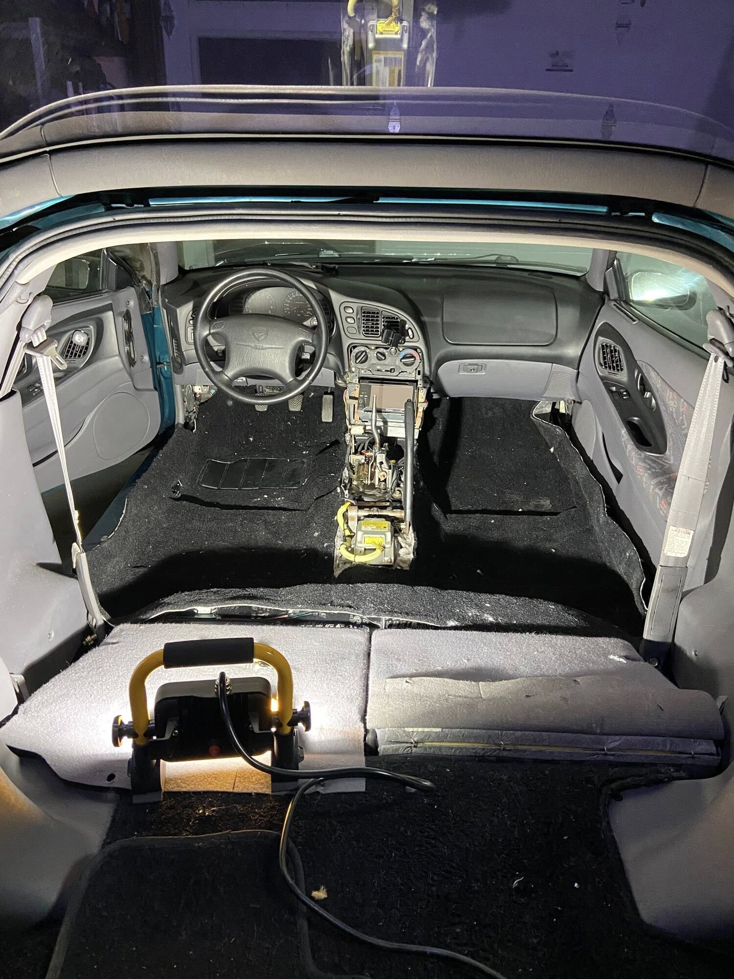

With the wiring done, I ordered a new mass‑backed ACC replacement carpet for added insulation and luxury. Before reinstalling it, I’ll be installing the Boyo VTK601HD reverse‑camera wired to my Kenwood DMX908S head unit, finalizing the next stage of modernization for the cabin.
Up Next

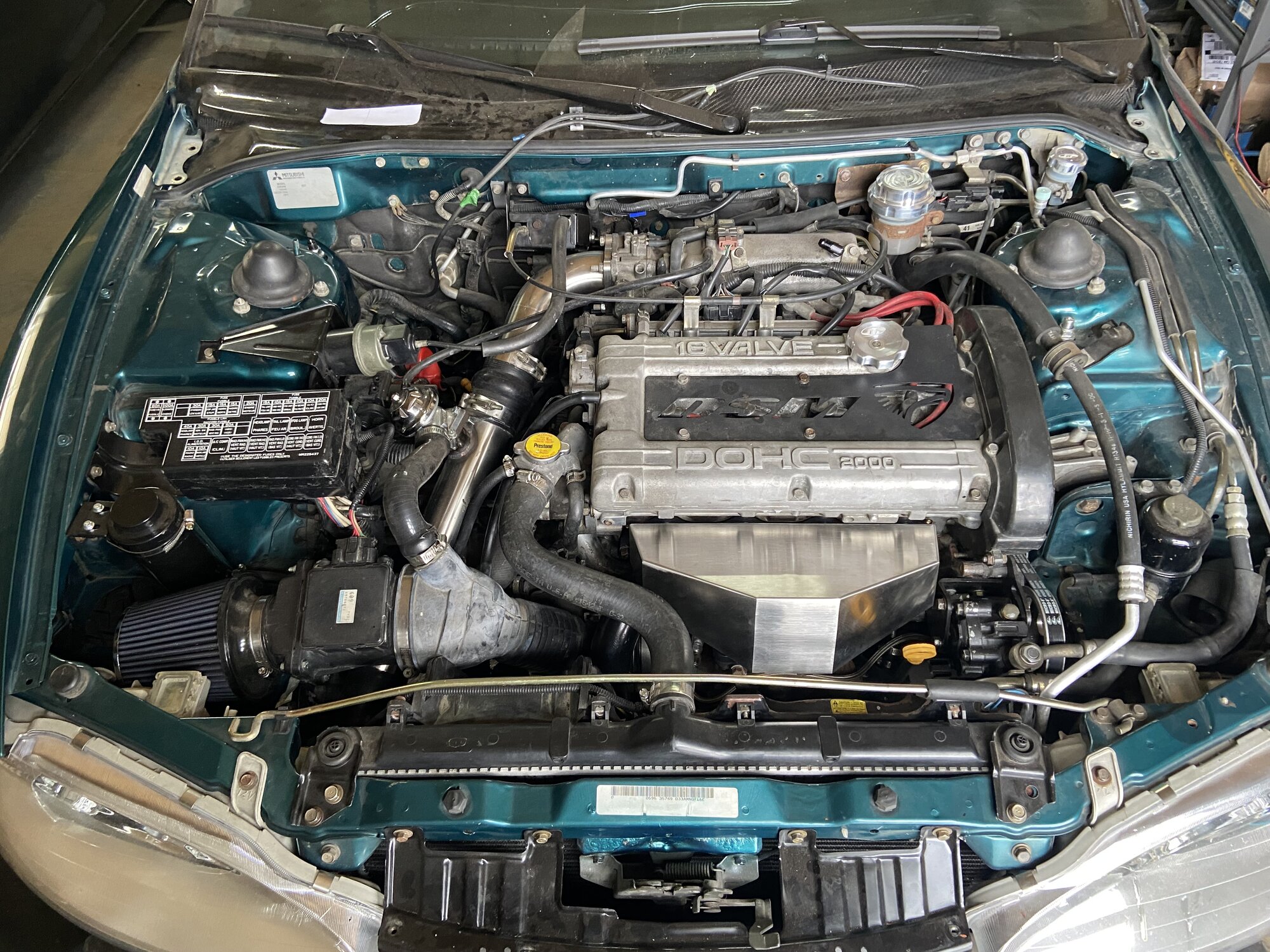

Once the new carpet and head unit are in, I’ll finish the remaining sound‑deadening work on the doors and roof panels later in the year. From there, it’ll be time to move outside again and begin reassembly for the spring/summer season.

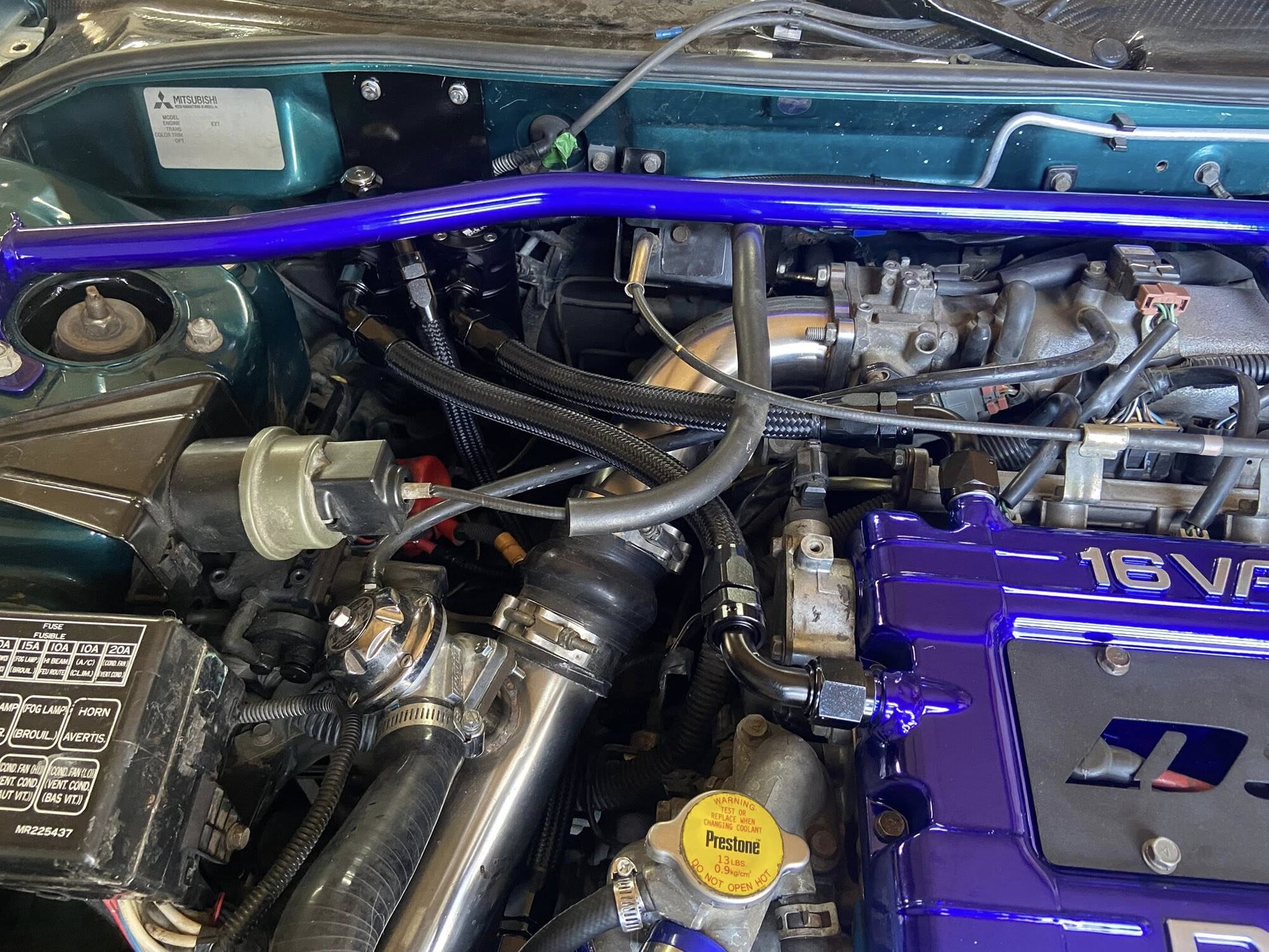

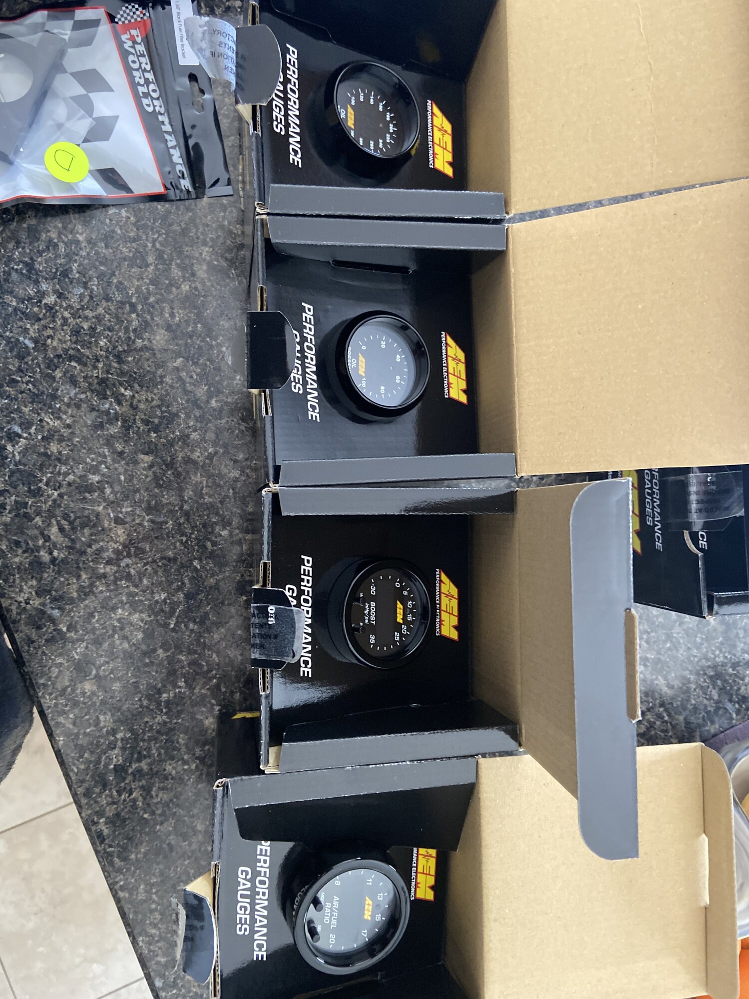

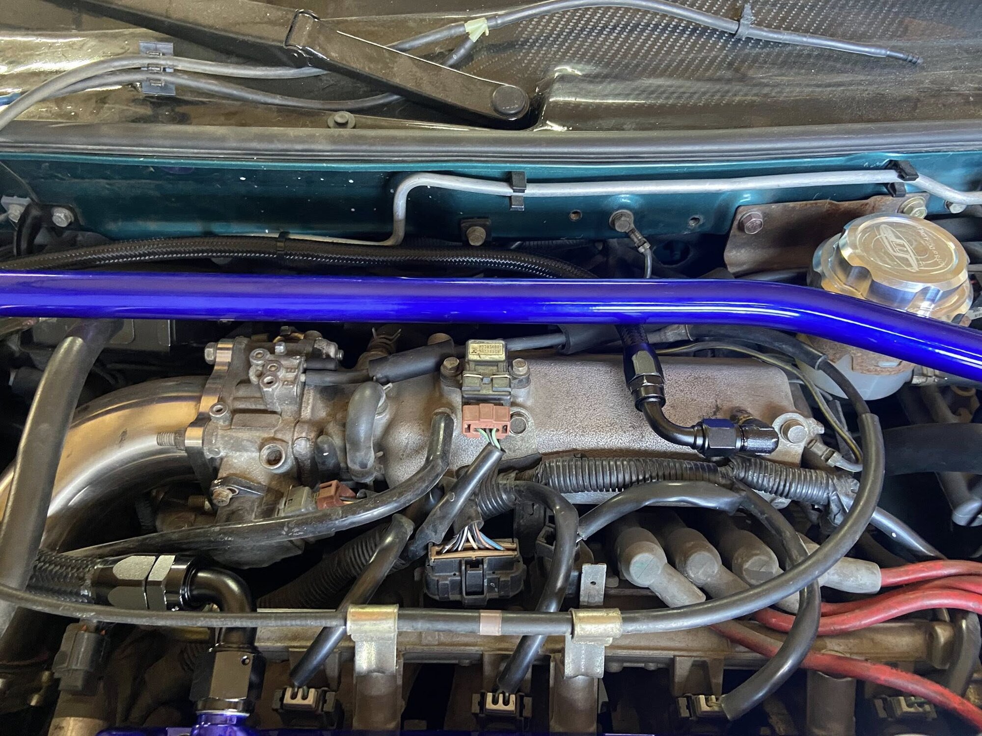

Additional system upgrades planned for 2026 include crankcase ventilation, monitoring instrumentation, fuel and cooling systems, and drivetrain updates.

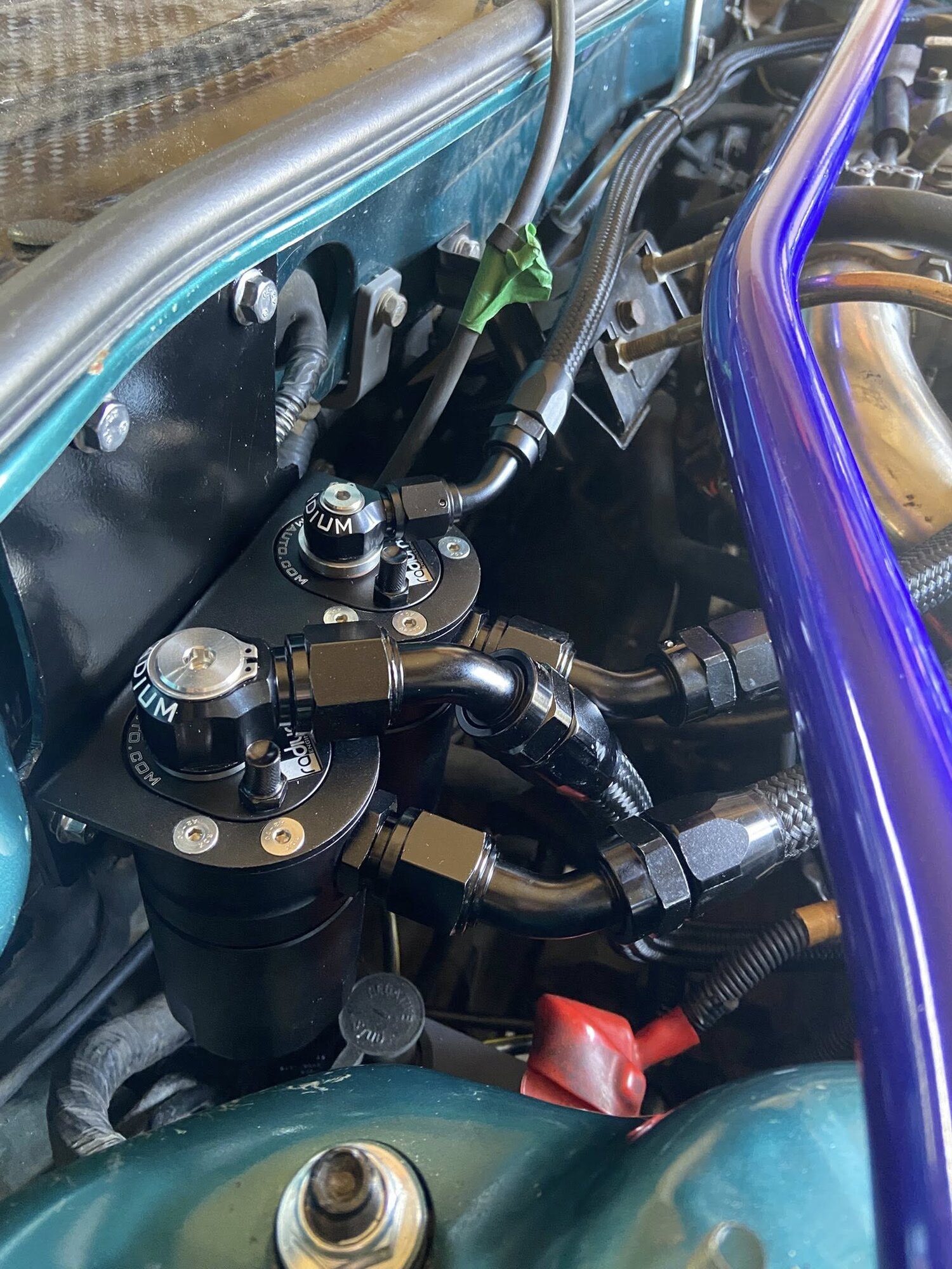

  • Crankcase Ventilation:

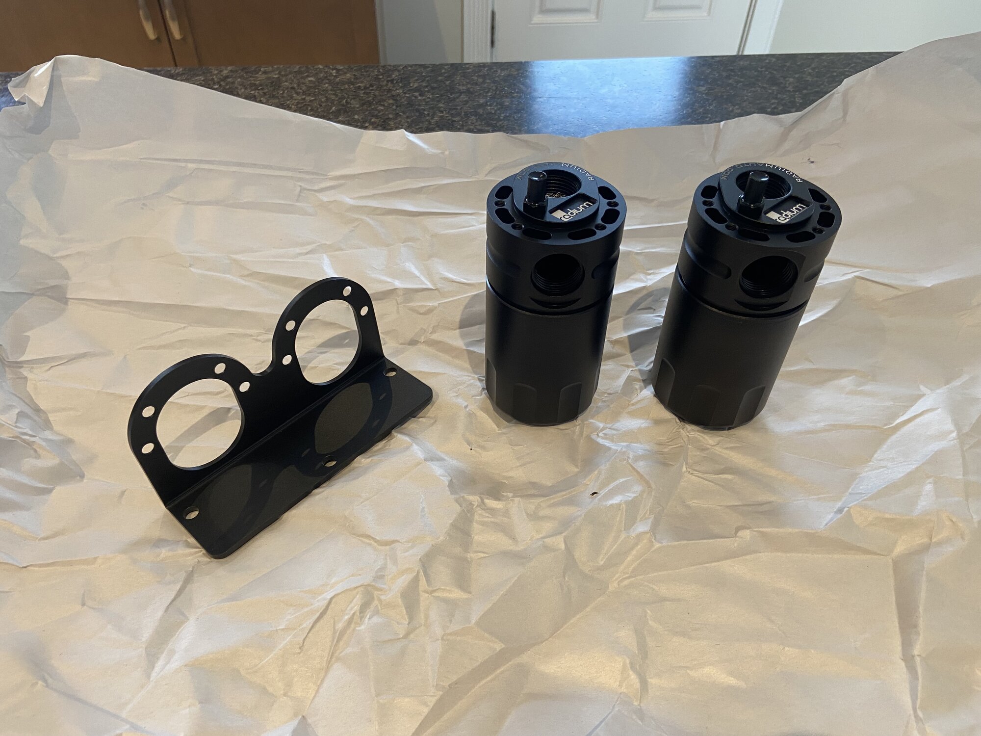

    • A new powder coated valve cover will have dual 10AN fittings welded on to support a pair of sealed catch cans — one for boost‑pressure relief, the other for vacuum operation.

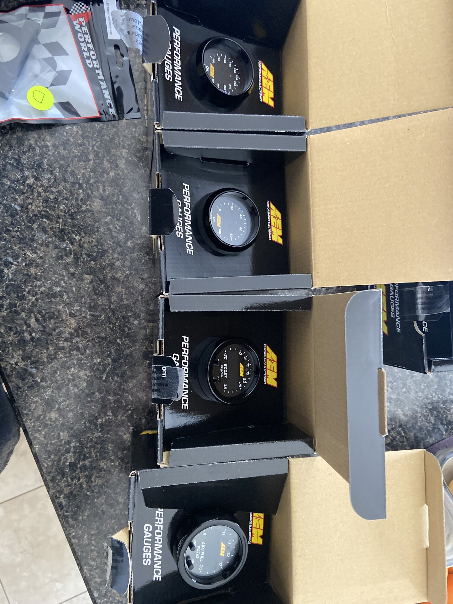

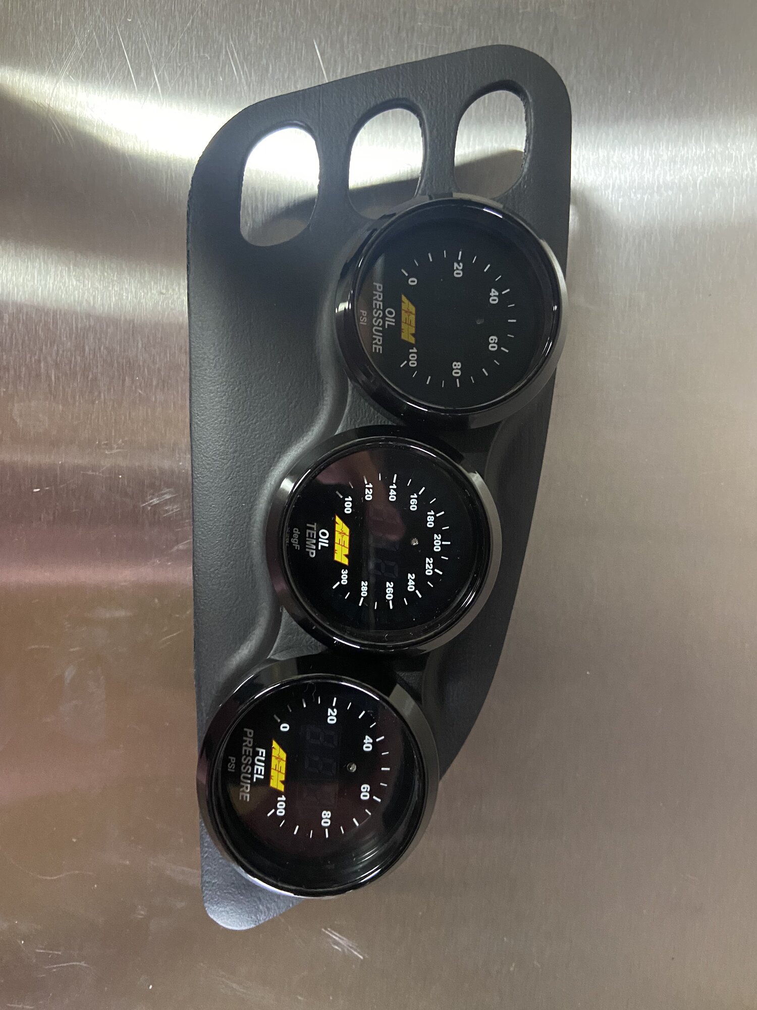

  • Monitoring Gauges:
    • I’ll be adding AEM X‑Series gauges for Boost, Wideband O₂, Fuel Pressure, Oil Pressure, and Oil Temperature to keep tabs on the powertrain.
  • Fuel System:
    • The upgrade will feature a Walbro 450 lph pump, 8AN supply line to a Performance World 10‑micron filter, Radium Engineering fuel rail with direct‑mount damper, gauge, and FPR supporting a 6AN return. Two fuel‑pressure sensors will be installed — one driving a remote in‑cabin gauge, the other wired to the ECU for datalogging.

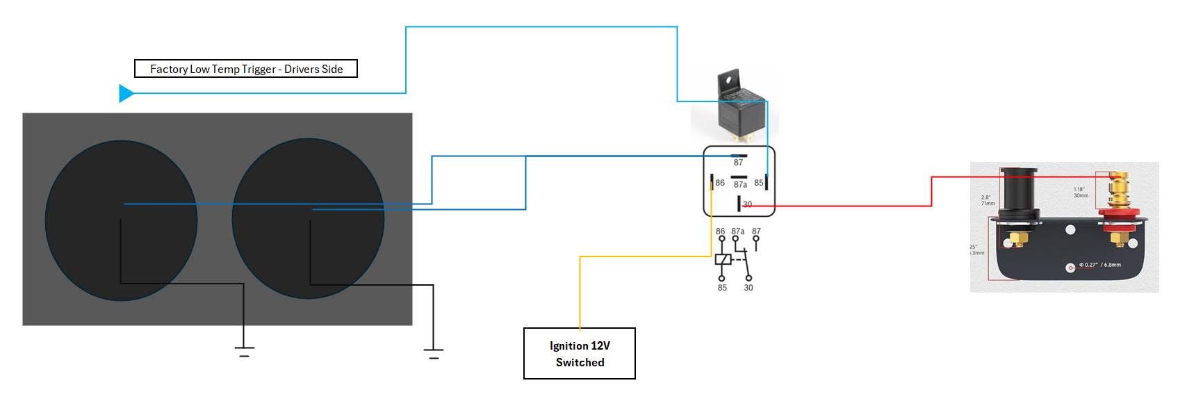

  • Cooling System:

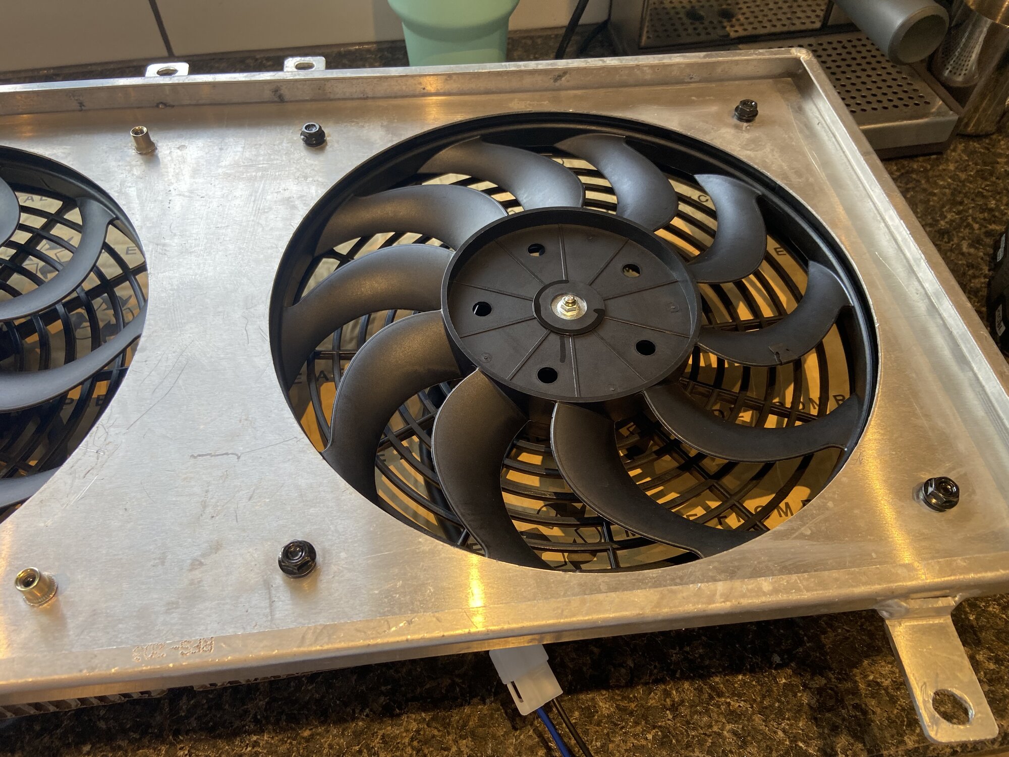

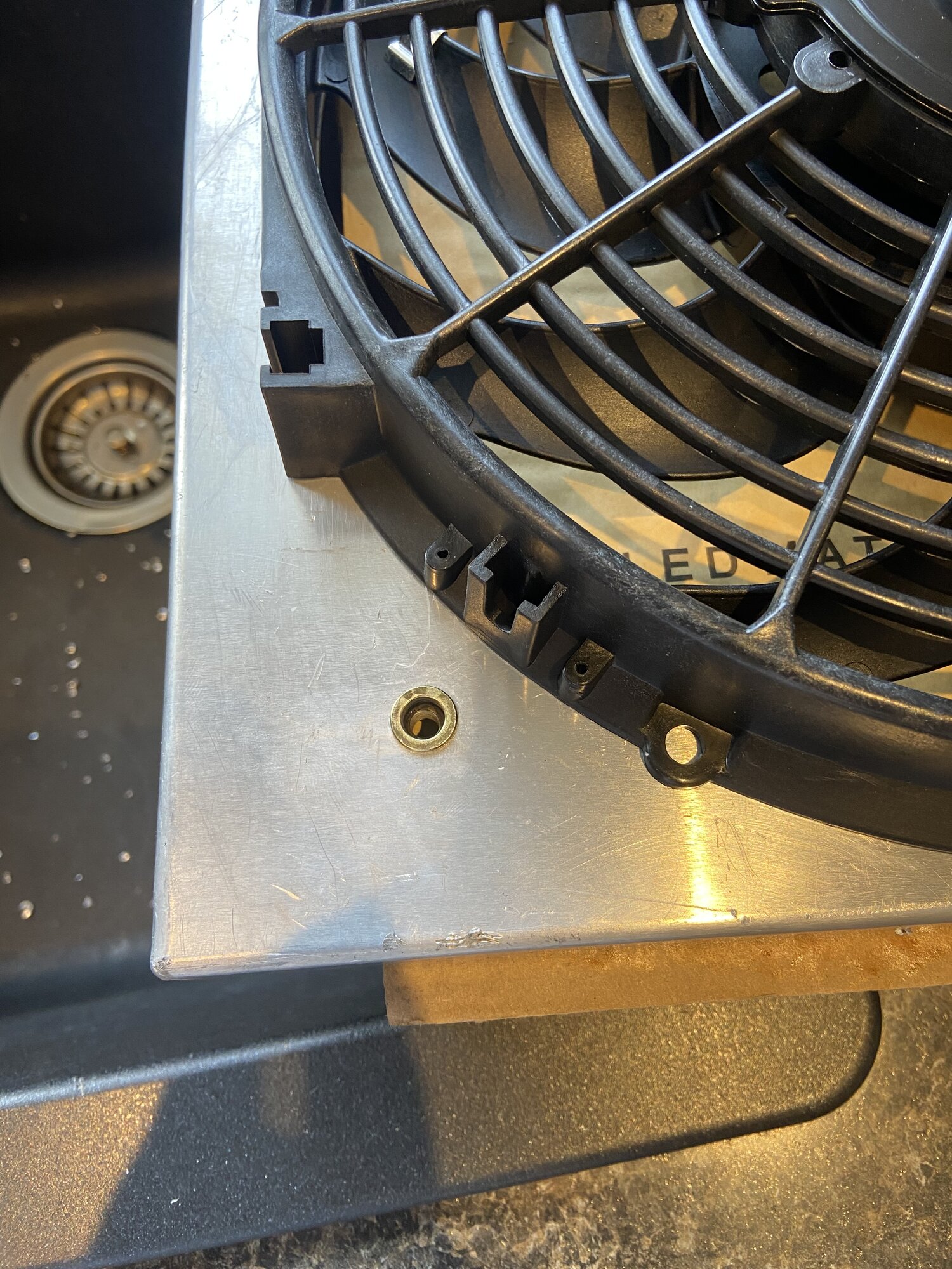

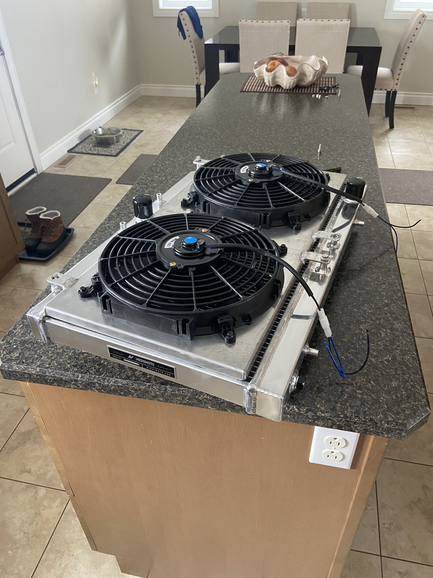

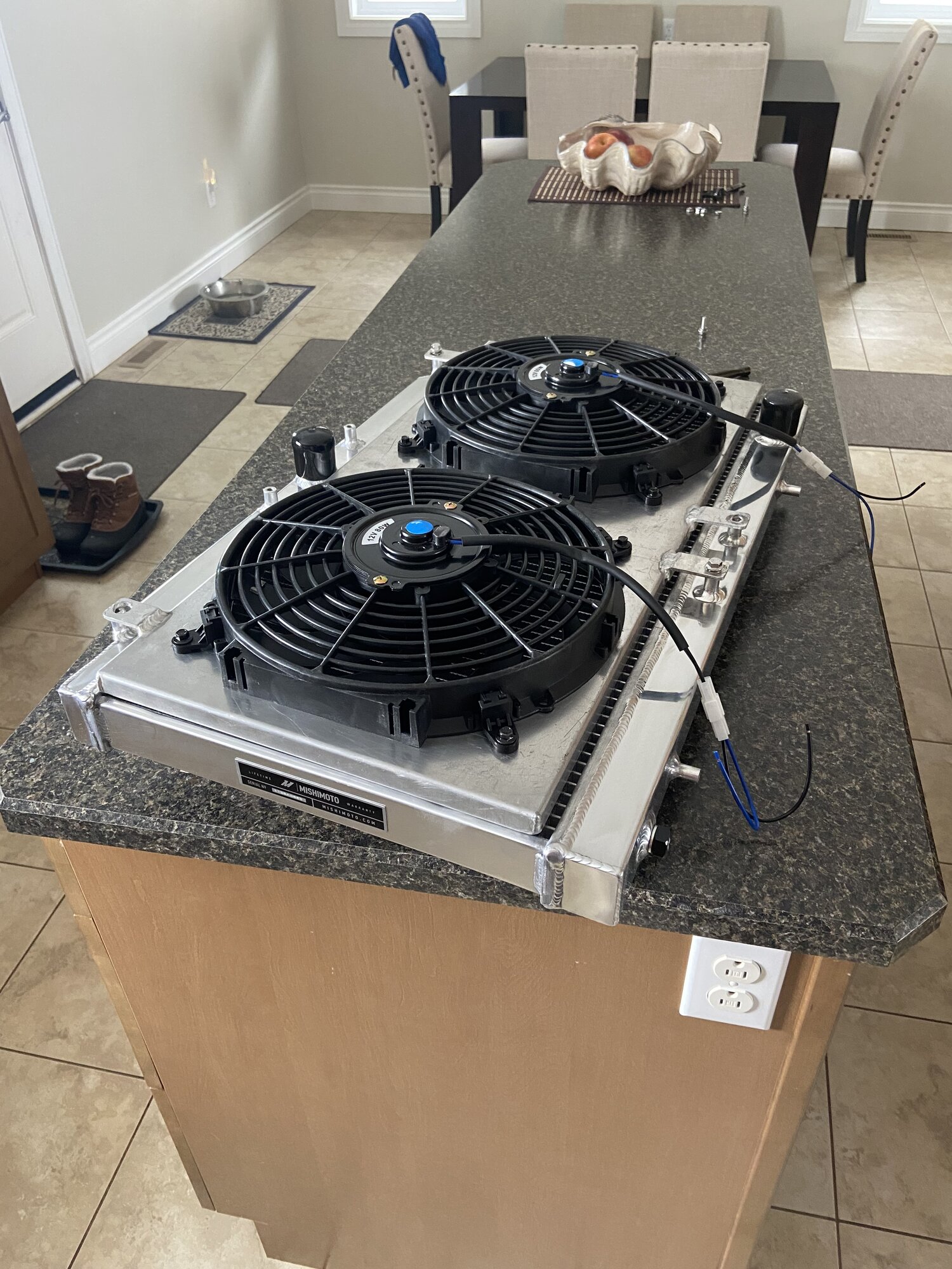

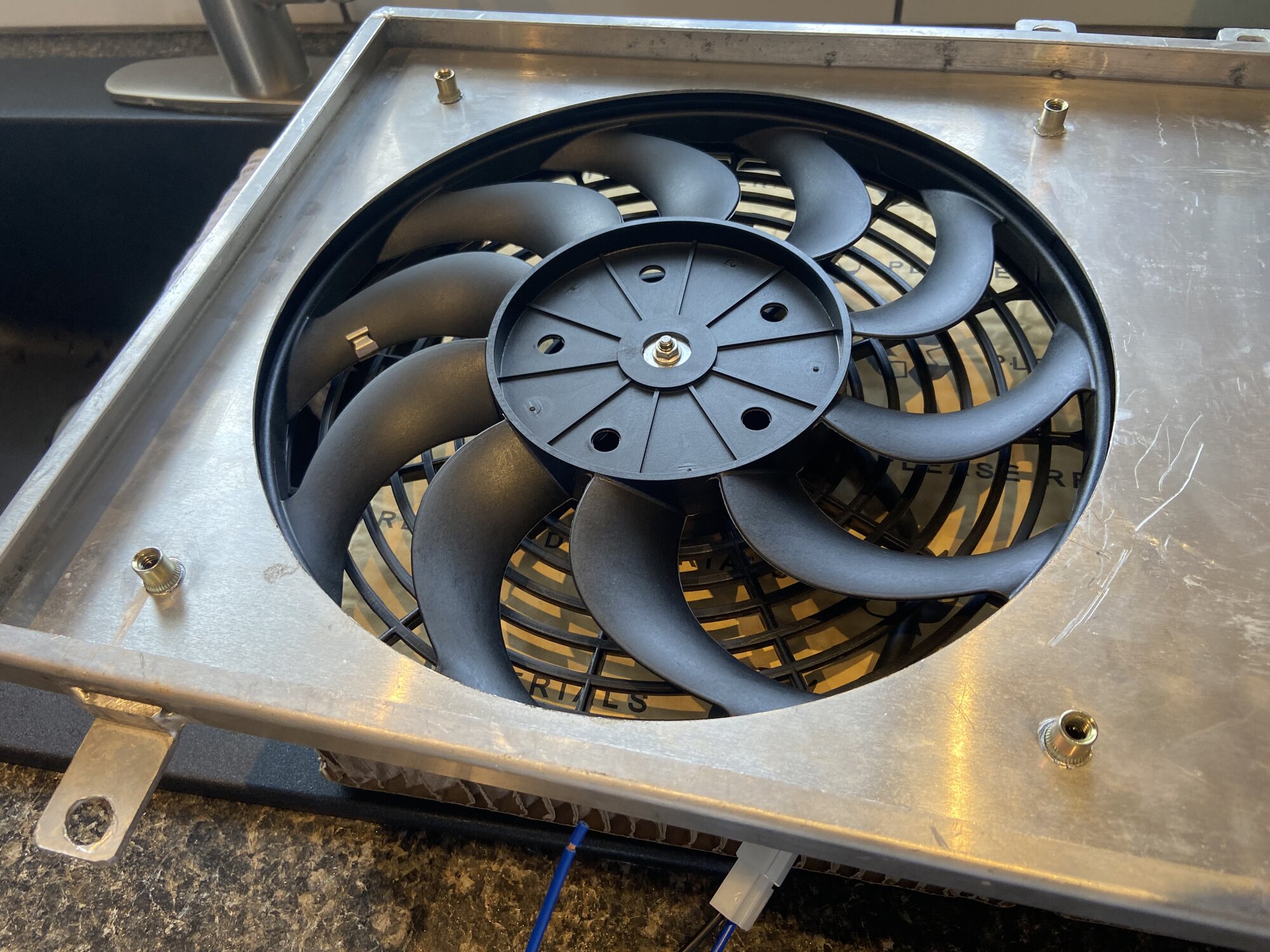

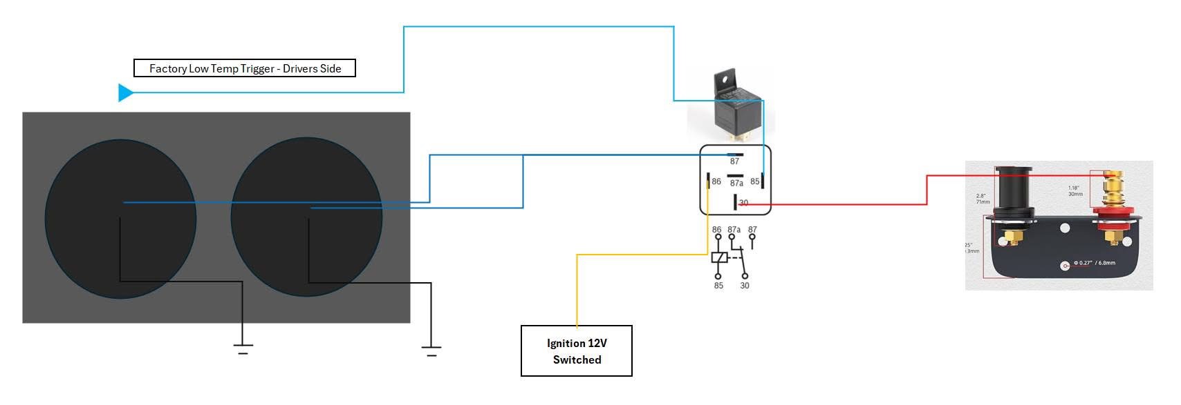

    • A Mishimoto radiator paired with dual 12‑inch Spal puller fans, each powered through dedicated relays which will stabilize cooling while reducing fuse‑load risk.
  • Drivetrain:
    • A Stage 1.5 TRE AWD Manual Transmission is on order. Once it arrives, I’ll pair it with a South Bend SS‑X Series 2700 lb pressure plate, a TZ/B‑Series Kevlar‑Ceramic clutch disc, and a Streetlite flywheel — aiming for smooth, responsive engagement with long‑term durability.
Lots on the horizon for the next few months, and if all goes to plan, the Talon should be more refined, reliable, and mechanically sorted for the upcoming summer driving season.

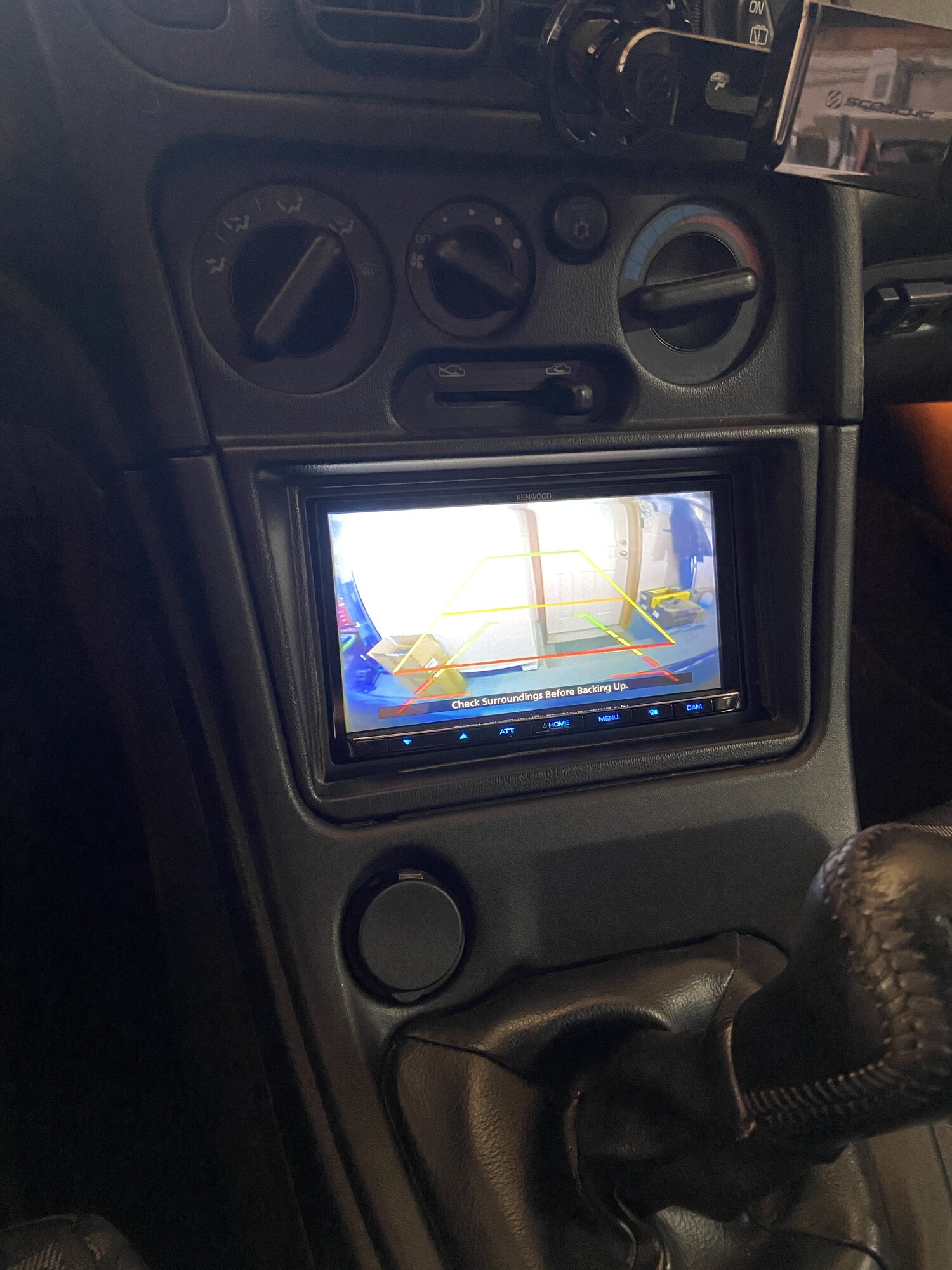

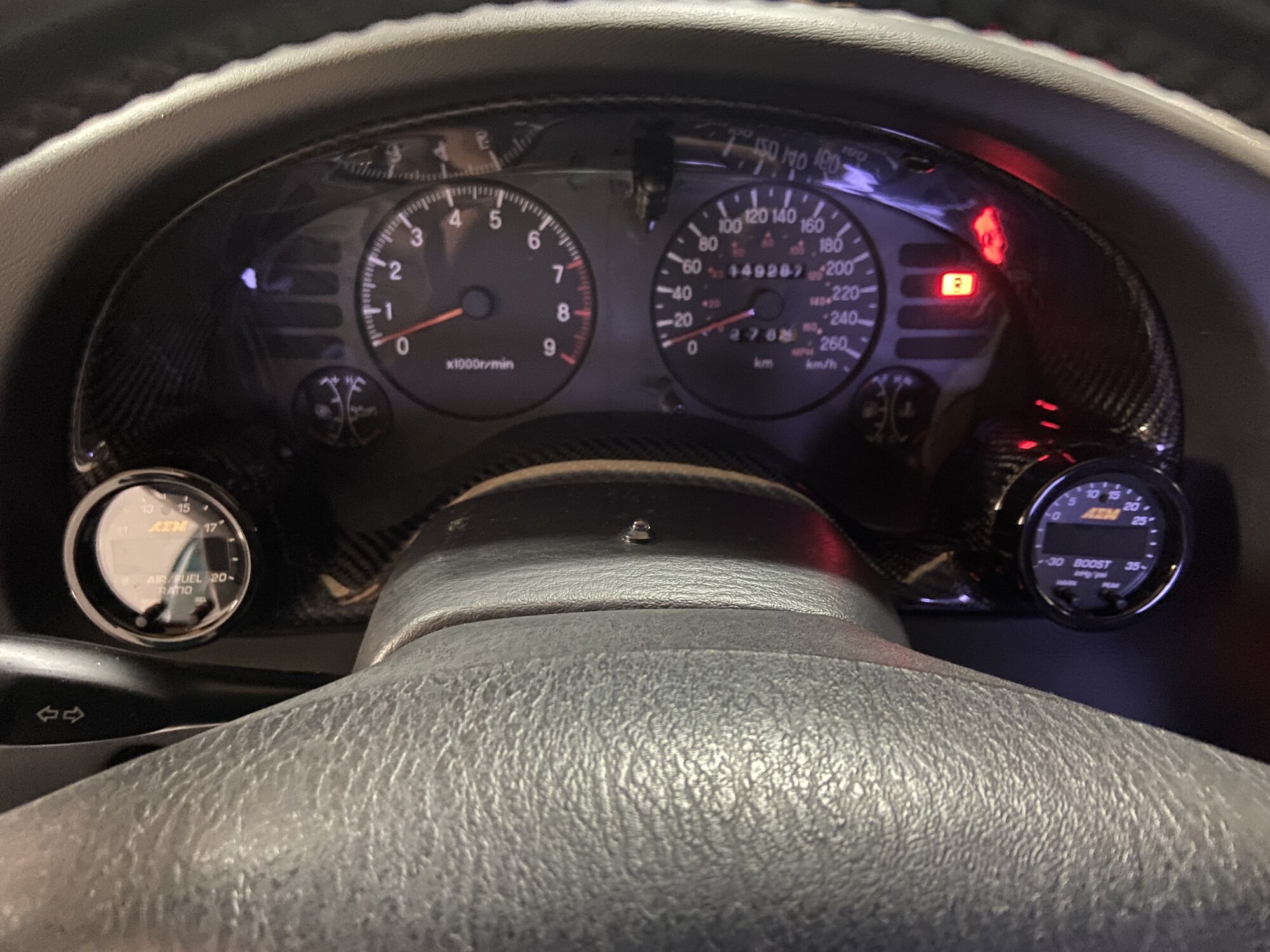

Late February 2026 Update – Interior, Stereo, and Reverse Camera

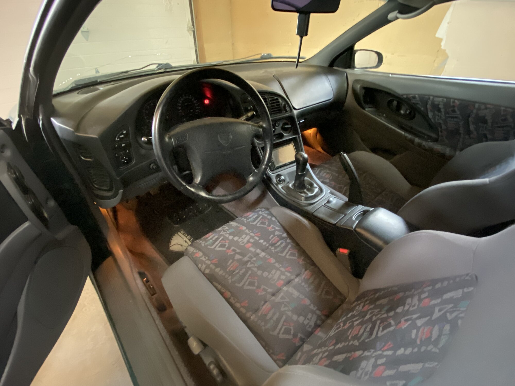

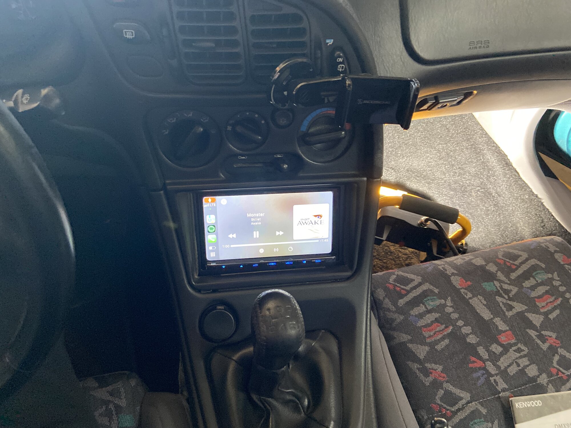

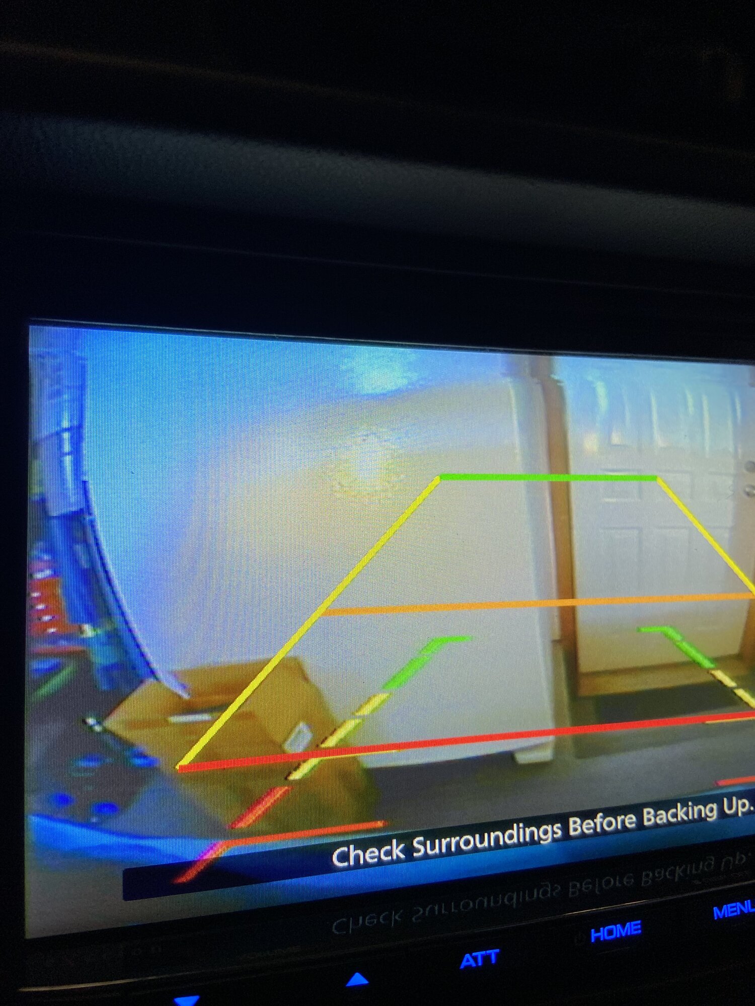

With the battery relocation wiring complete, it was time to finish off the interior by installing a new black ACC cut-pile carpet with added mass backing, as well as a modern stereo and reverse camera. For these upgrades, I went with a Kenwood DMX908S head unit paired with a Boyo VTK601HD reverse camera.
The previous owner had installed a Pioneer AVH-P3200BT, which was functional but starting to feel dated. I wanted something that offered Bluetooth, wireless and wired Apple CarPlay/Android Auto, hands-free calling, multiple camera inputs, and a 5V preamp for improved audio quality with a 13-band EQ tuner — basically a full modern infotainment setup.

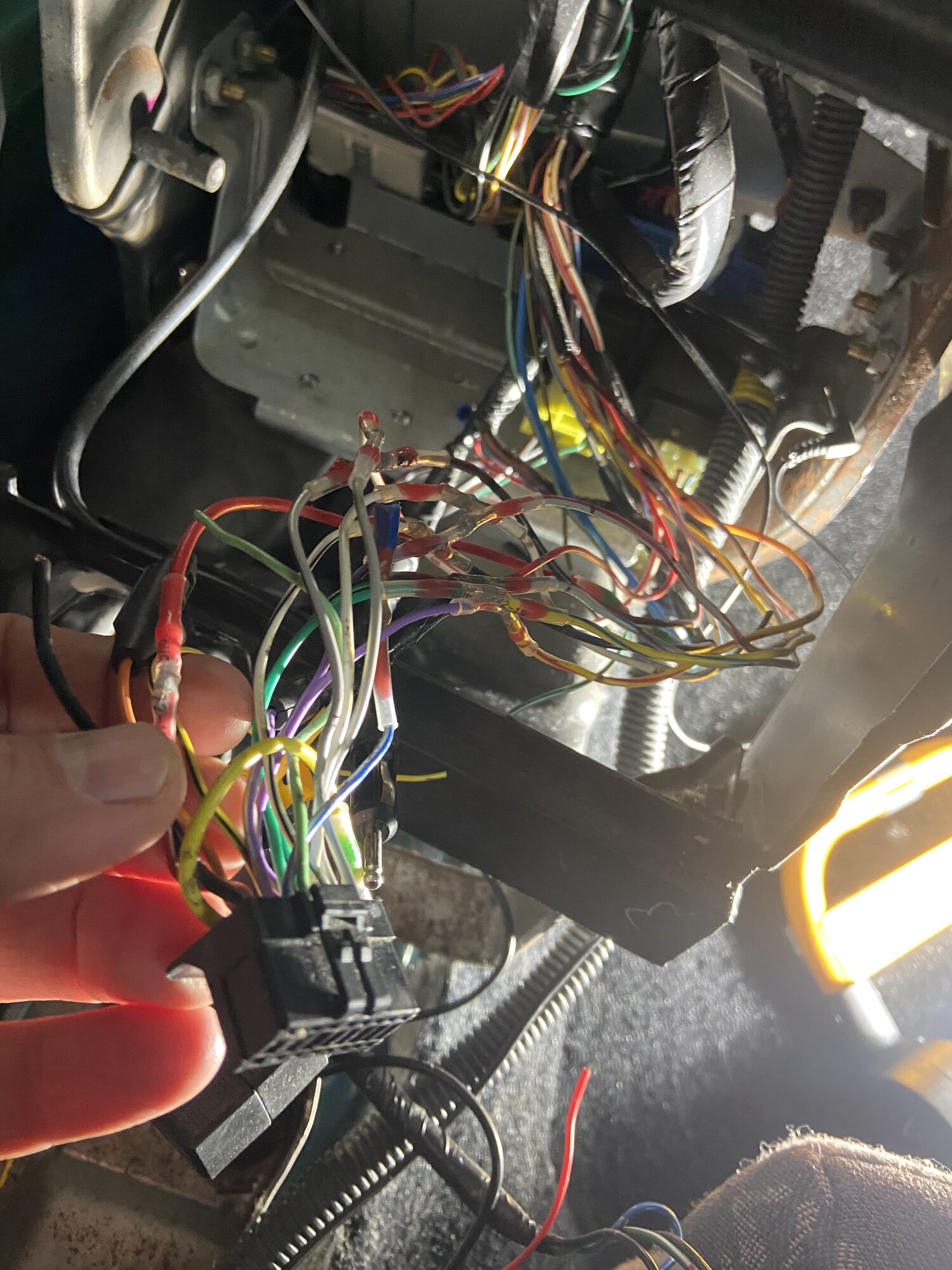

Installation wasn’t plug-and-play, as the stock stereo harness had been cut and spliced multiple times over the years. Even though I was confident about which wires were which, I still double-checked every connection with my voltmeter before hooking up the Kenwood head unit. The result? I’m not sure if it’s the head unit, the sound deadening, or a combination of both, but the audio quality is night-and-day compared to before — even with the stock speakers.

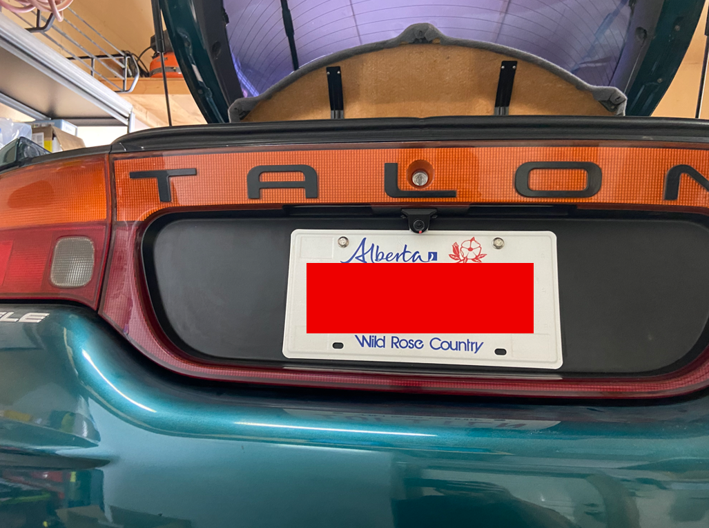

The reverse camera was straightforward. I wired it so it activates automatically when the car is in reverse by tapping the reverse light trigger wire in the trunk. Since I pre-ran the wiring through the cabin and under the car during the earlier interior tear-down for the battery relocation and sound deadening, connecting the Boyo camera to the head unit was easy. I mounted the camera just below the trunk latch using one of the supplied brackets, and it sits cleanly and discreetly.

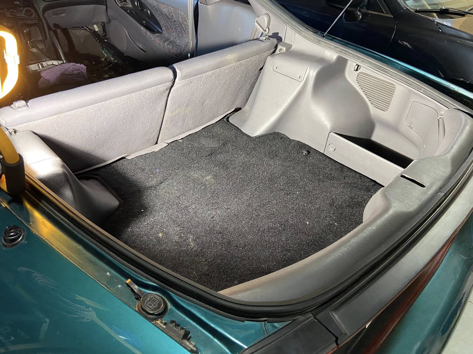

New Cabin Carpet 2.jpgNew Cabin Carpet.jpgIMG_5401.jpgIMG_5403.jpgIMG_5402.jpgNew Trunk Carpet After Battery Relocation.jpgReverse Cam Location.pngIMG_5407.jpgIMG_5408.jpg

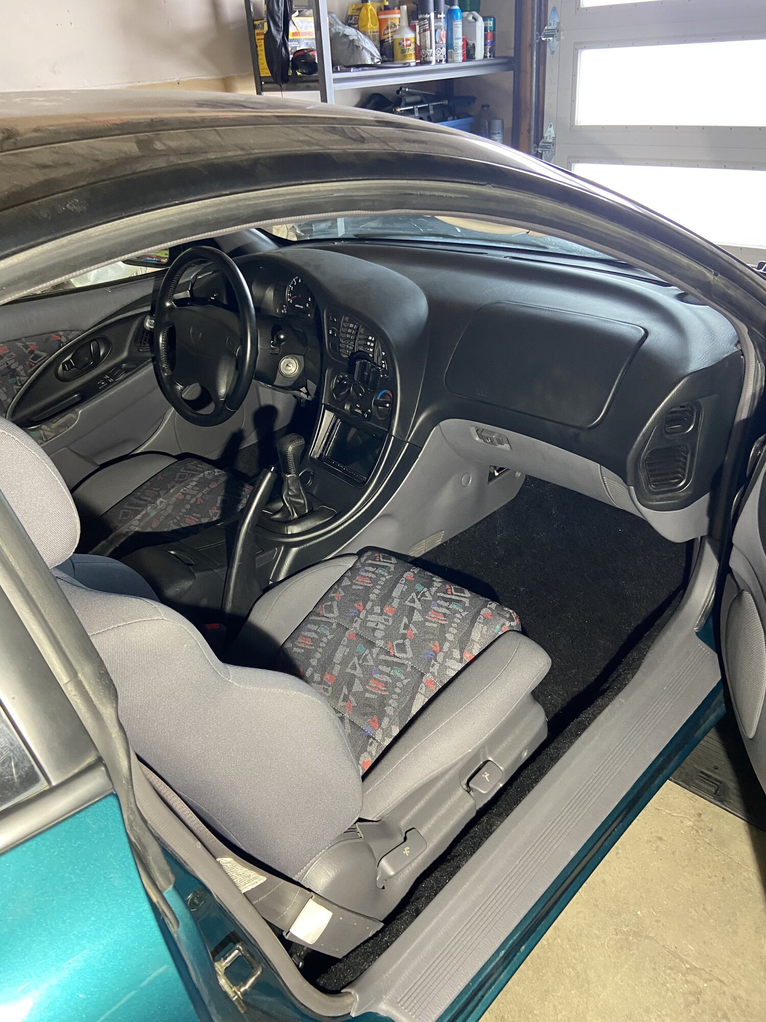

Looks good. How do you like the fit and finish of the carpet?
The finish is great. Fitment took a lot of work. The carpets come oversized with extra material like the image below. To install, you have to trim the center console material. I let the carpet rest outside of the box for 24hrs and then used my factory carpet as a template to cut the rough shape needed for it to fit inside the car, then finished the remaining trimming for it to have a proper fit. I also transferred the plastic clips that held the edges of my factory carpet to the sides under the door sills, using 1/8" rivets. This ensured the carpet didn't pull loose under the door sills.
If you choose to replace your carpet with an ACC one, I would go with the cut pile carpet, not the Essex one, otherwise it may be too thick. The cut pile with mass backing is plenty thick and much heavier than the factory carpet which will also help with the noise dampening I wanted.

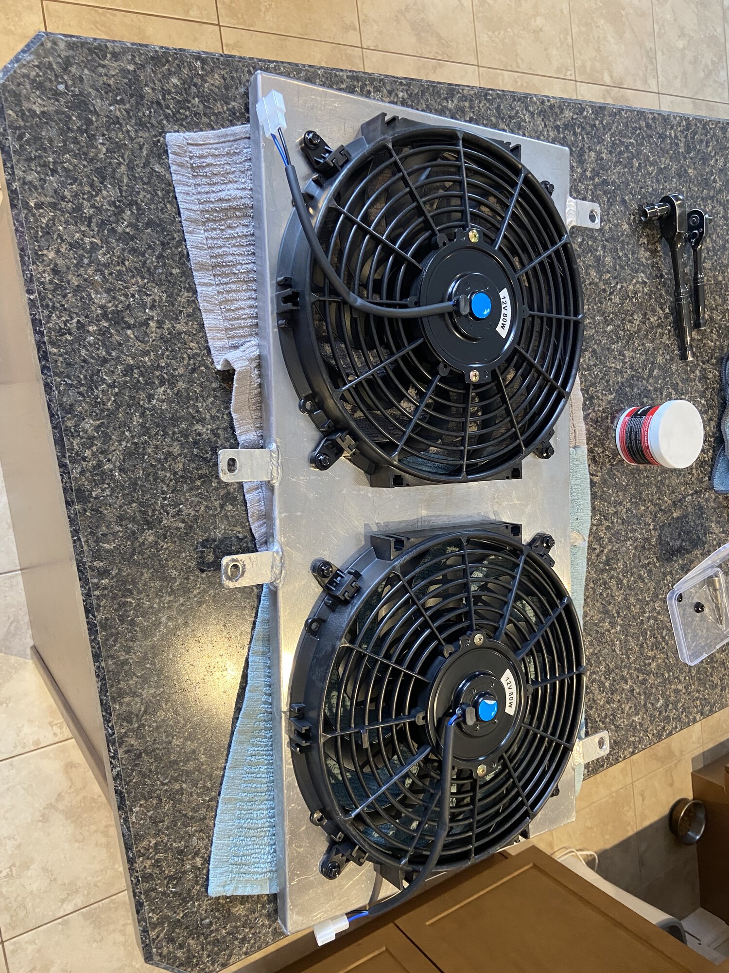

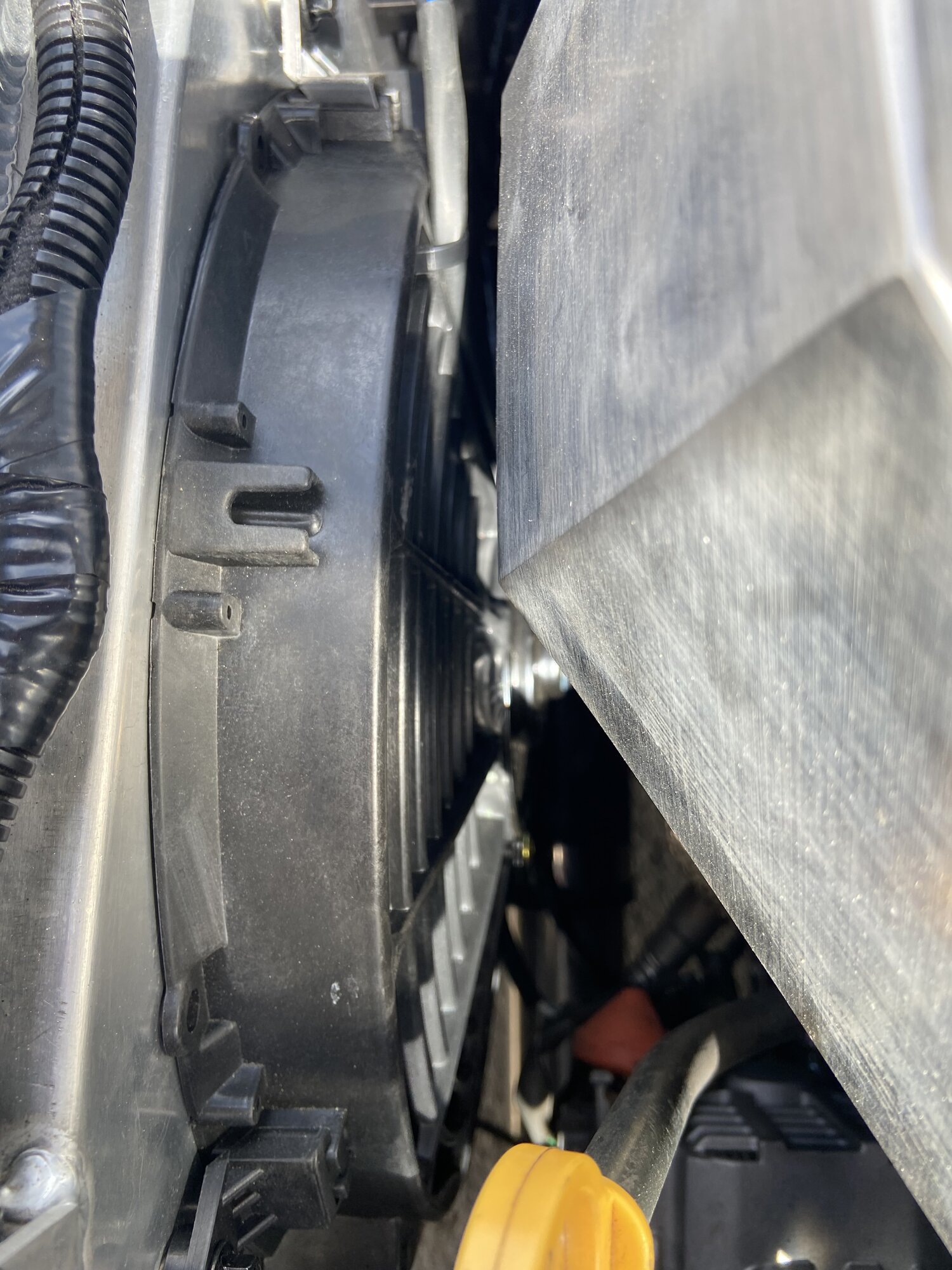

Cooling System:
• Mishimoto dual-core radiator
• Performance World 7712B slim puller fans (x2, 1450 CFM each)
• 30A relay harness for radiator fans

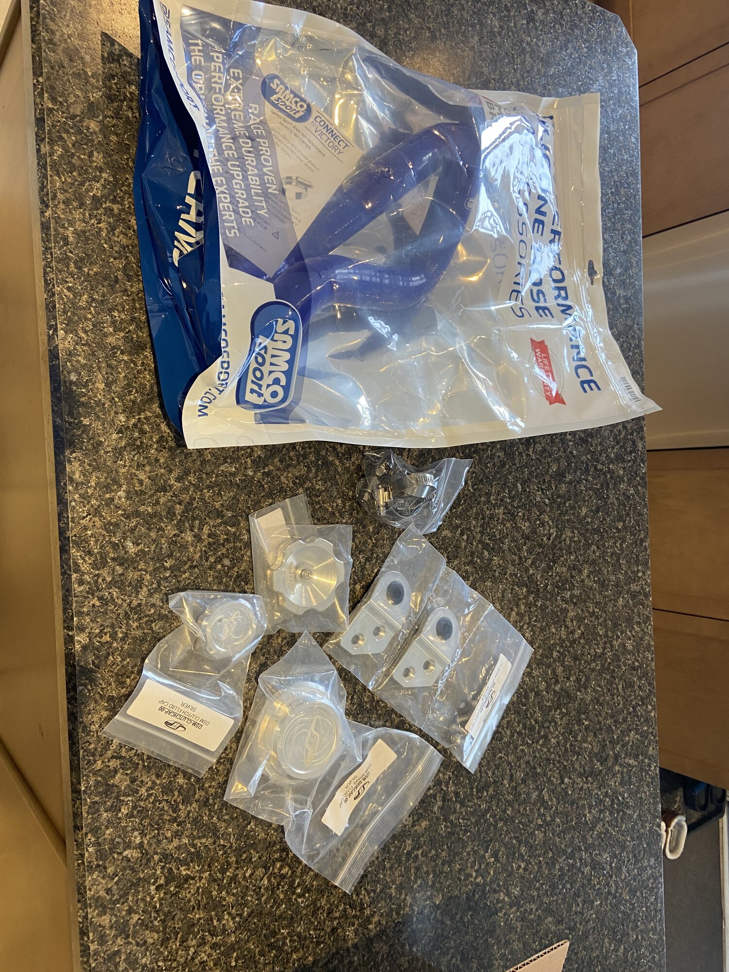

• Blue Samco silicone radiator hoses (upper & lower)
• New radiator hose clamps

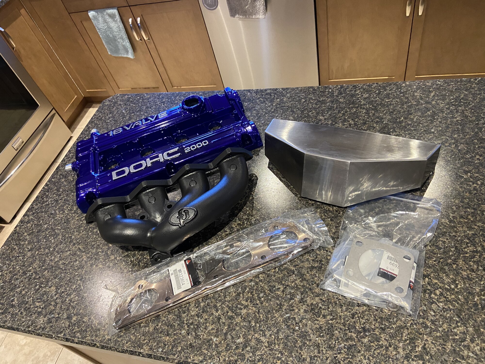

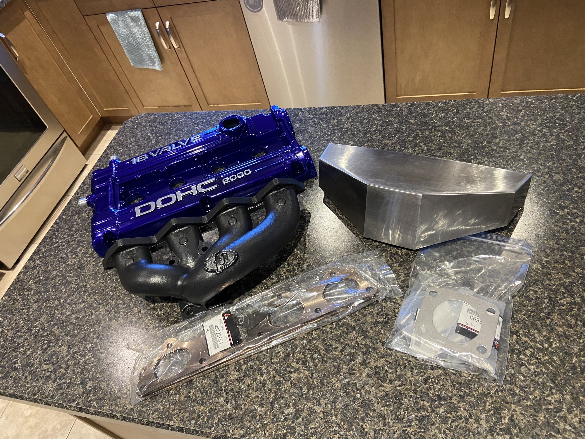

Exhaust:
• FP Race manifold (ceramic coated & ported)
• OEM Mitsubishi exhaust manifold gasket
• OEM Mitsubishi turbo housing gasket
• Evo 8 exhaust manifold hardware kit
• ExtremePSI heat shield for FP manifold

• AEM X-Series UEGO wideband
• AEM X-Series boost gauge
• AEM X-Series oil pressure gauge
• AEM X-Series oil temperature gauge
• AEM X-Series remote fuel pressure gauge

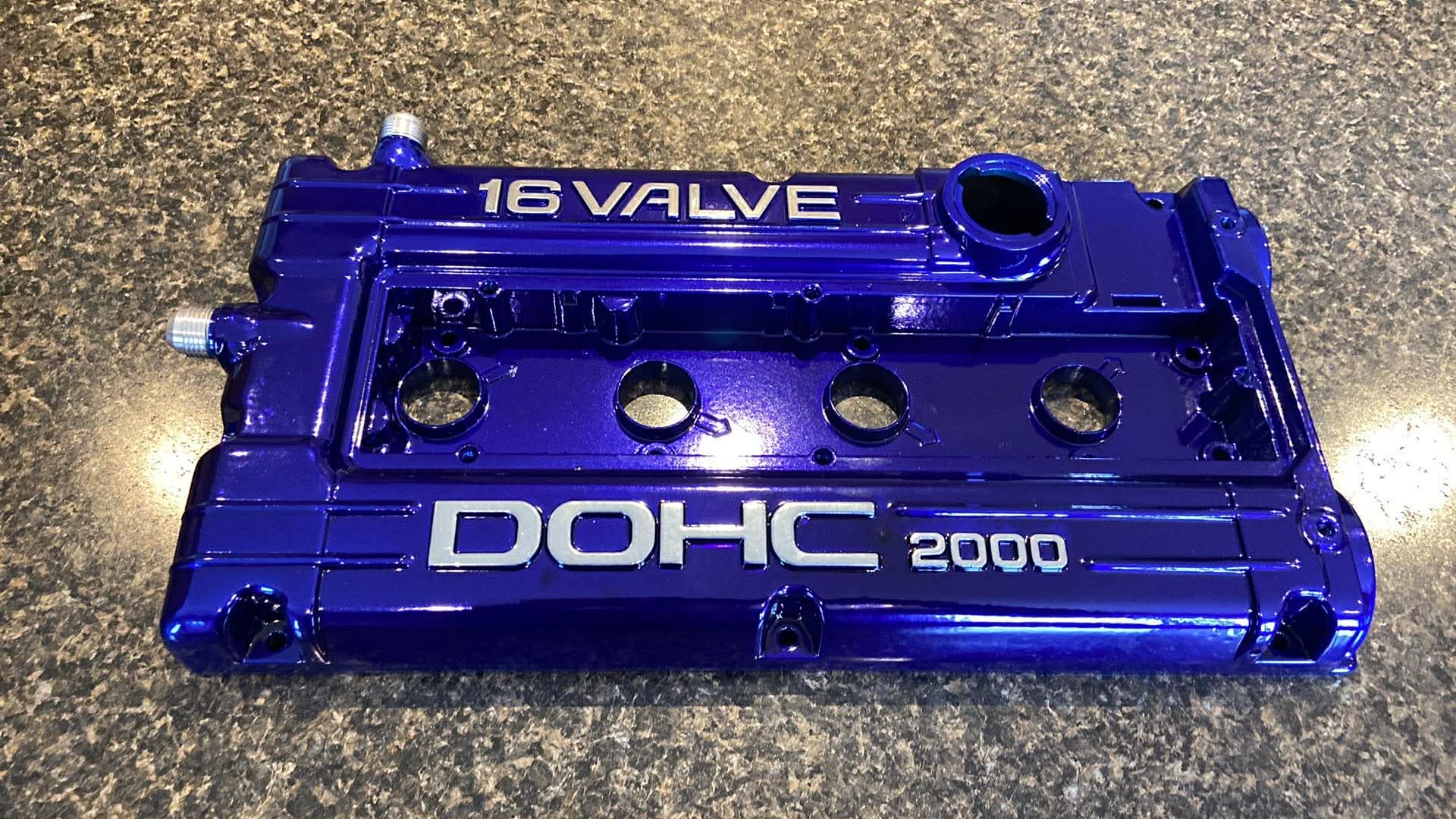

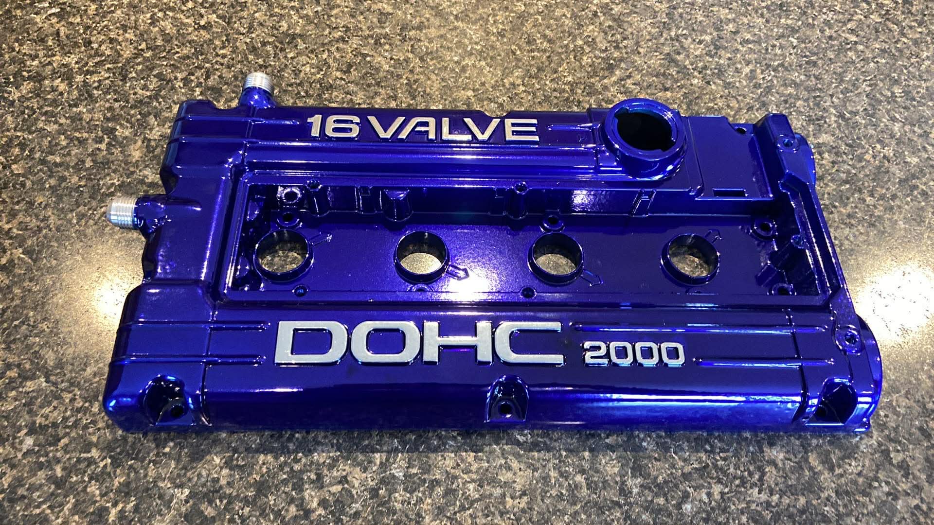

• Custom valve cover from Rix Racing, powder coated in Prismatic Powders Intense Blue (PPB-4474) with dual 10AN bungs for catch cans

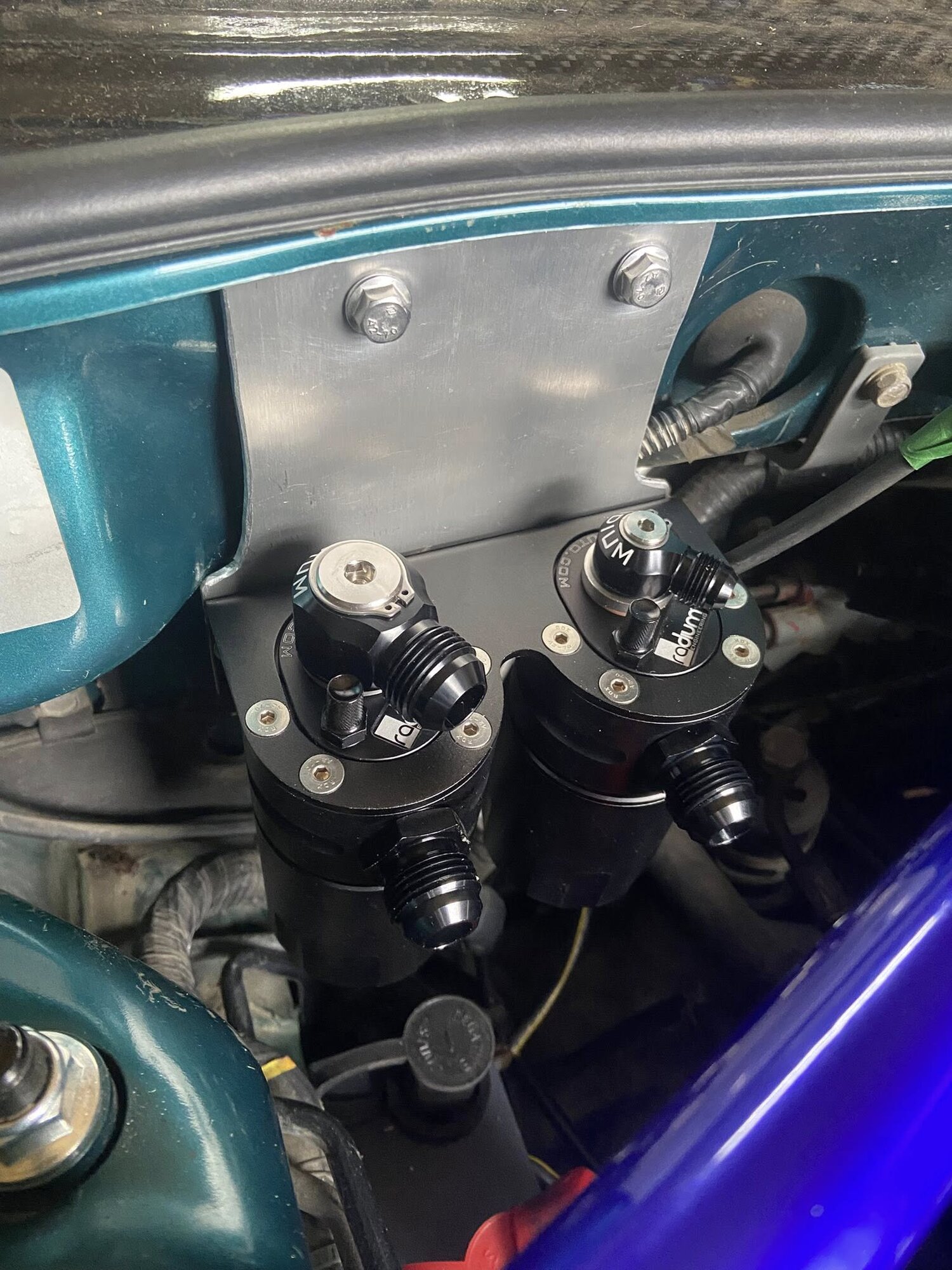

• Dual Radium Engineering catch cans with 10AN lines/fittings

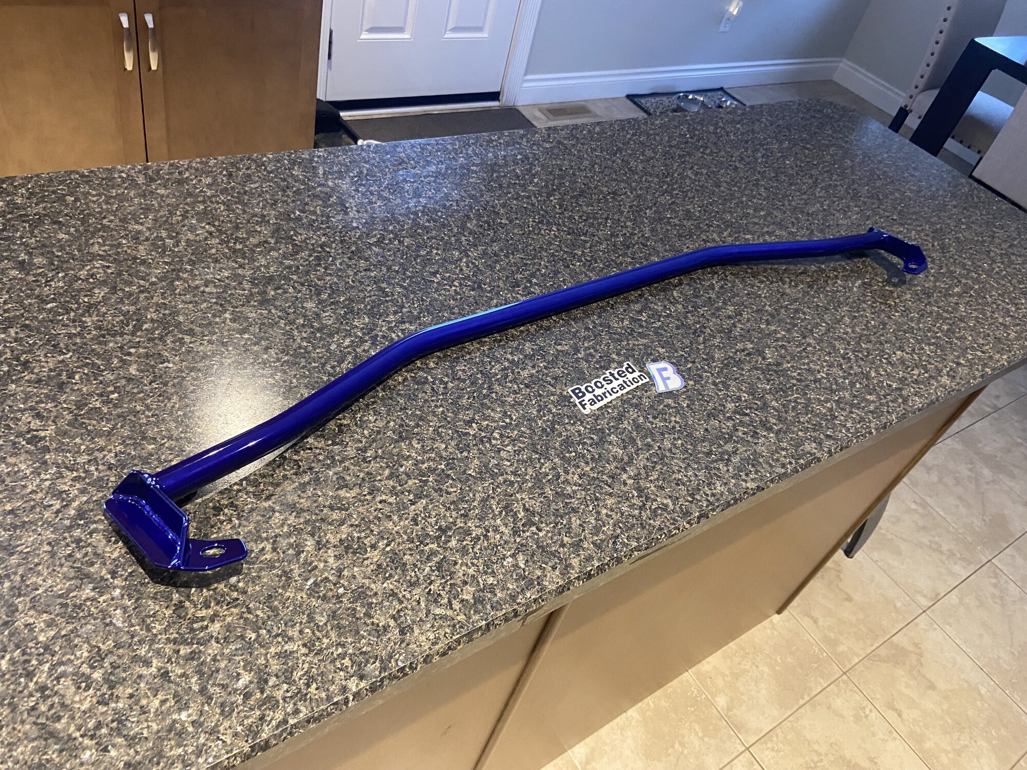

• Boosted Fabrications 2G front strut bar (OEM intake fitment), powder coated to match the valve cover

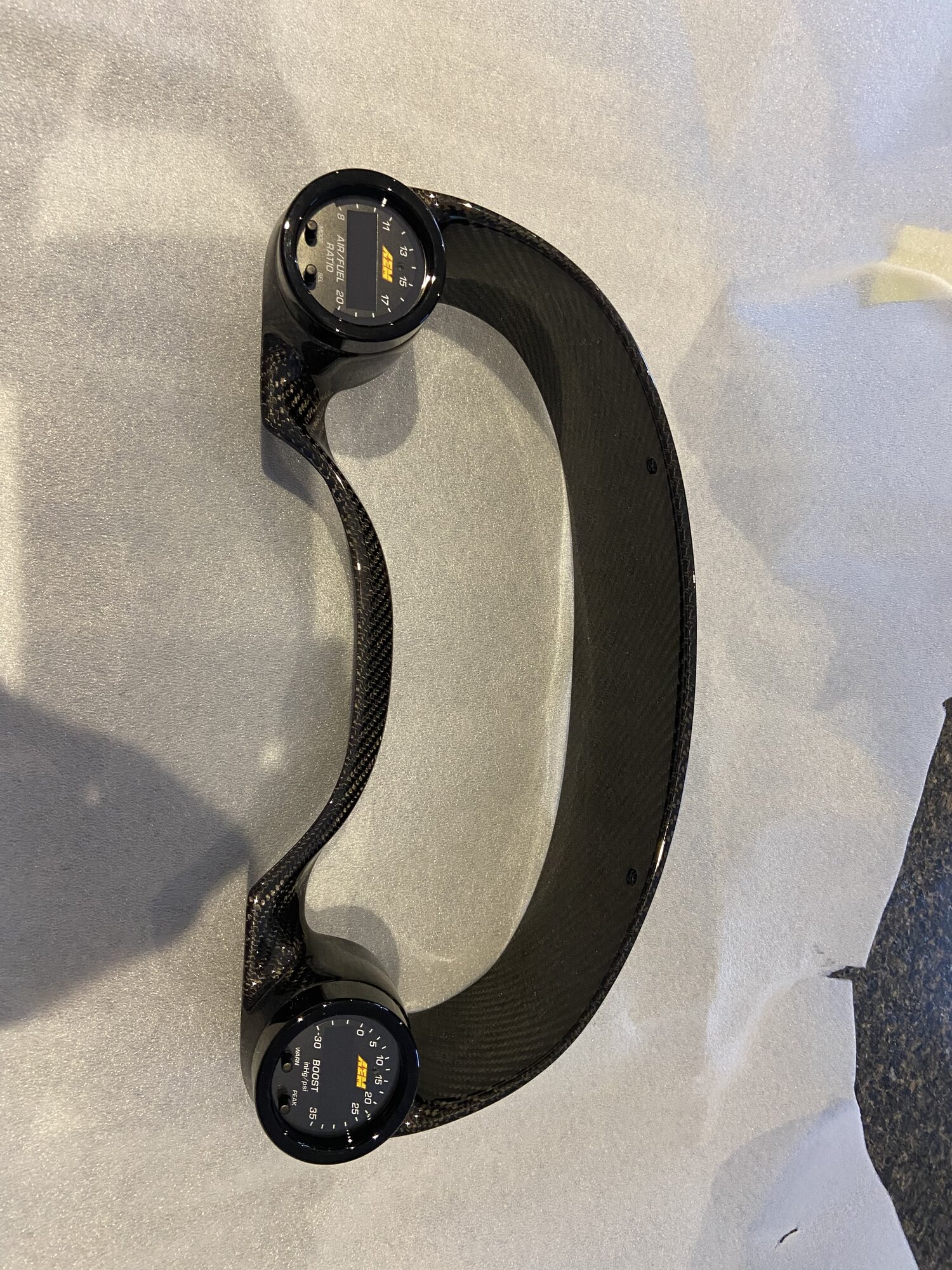

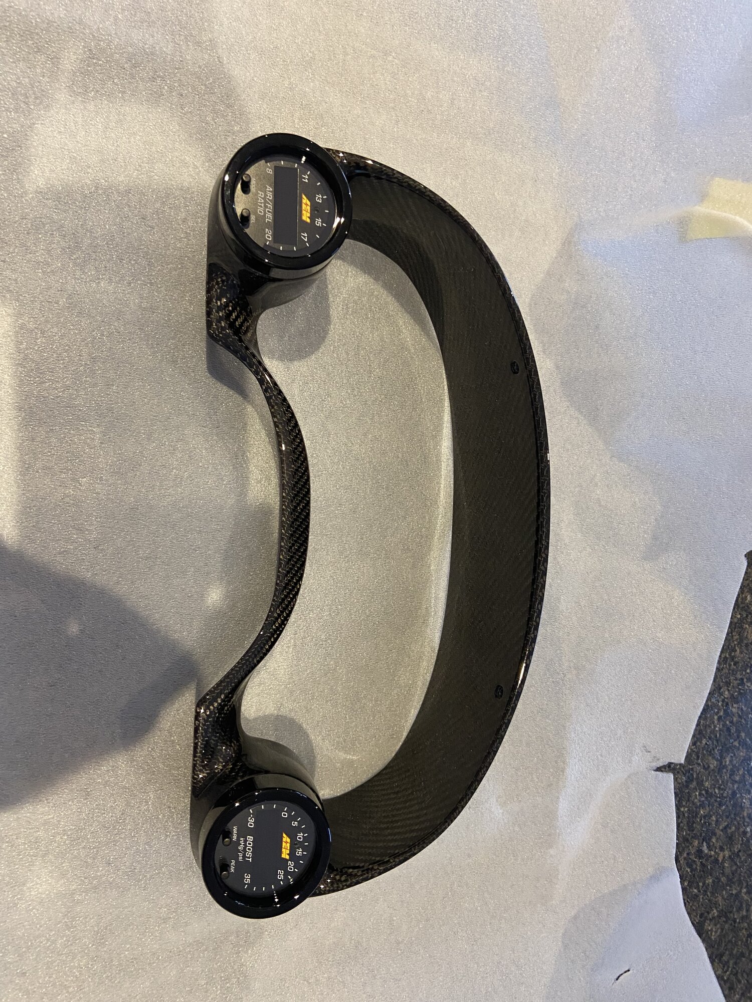

• Triple gauge AC vent pod from OS Gauge Pods (custom)
• Carbon fiber 2G DSM gas tank / trunk release trim piece
• Carbon fiber Gauge Cluster Speed Ring with Dual Gauge Pods

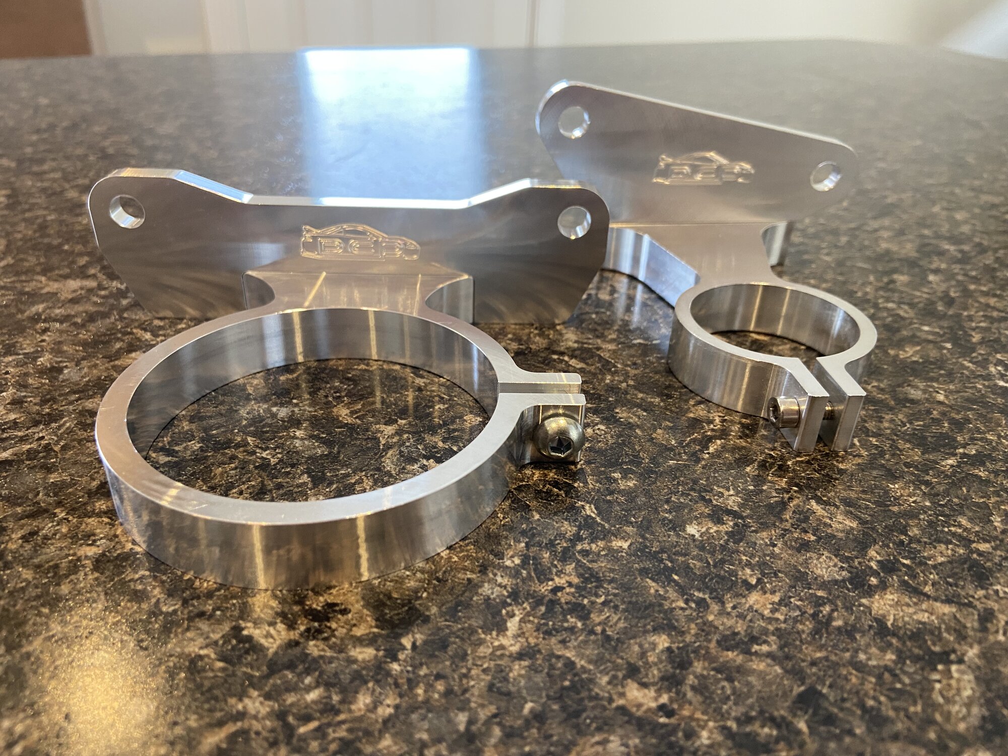

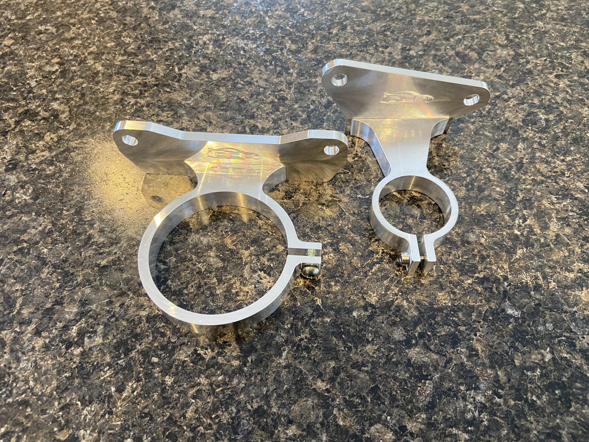

• JMF radiator brackets – bare aluminum
• JMF clutch fluid reservoir cap – bare aluminum
• JMF brake fluid reservoir cap – bare aluminum
• JMF engine oil cap - bare aluminum
• DCP clutch reservoir bracket – bare aluminum
• DCP brake reservoir bracket – bare aluminum

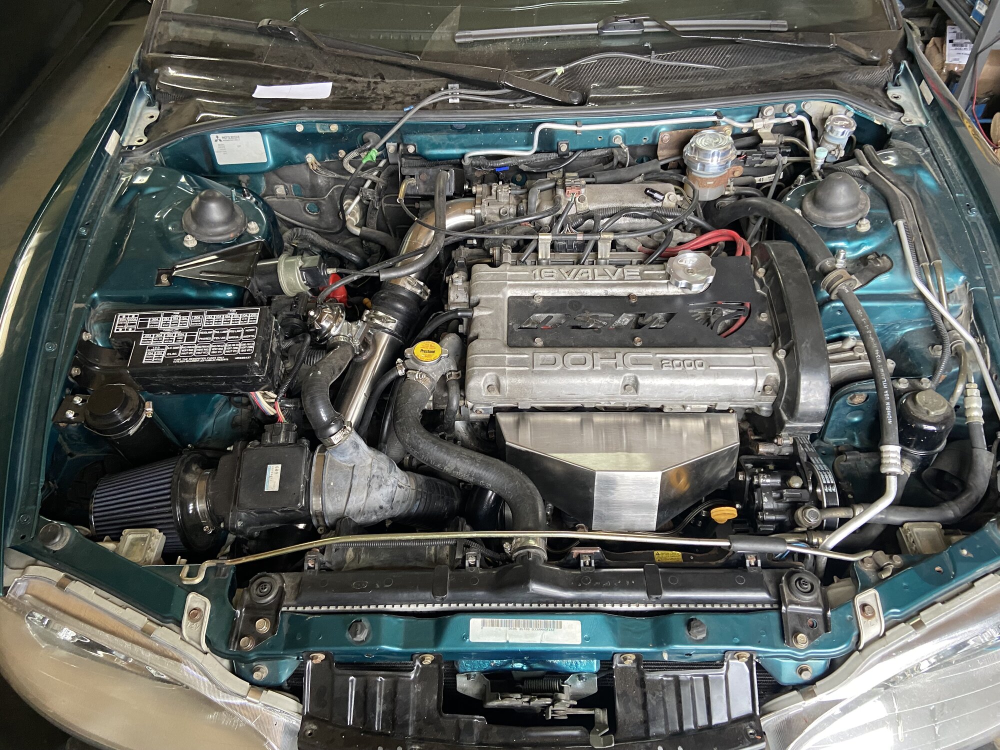

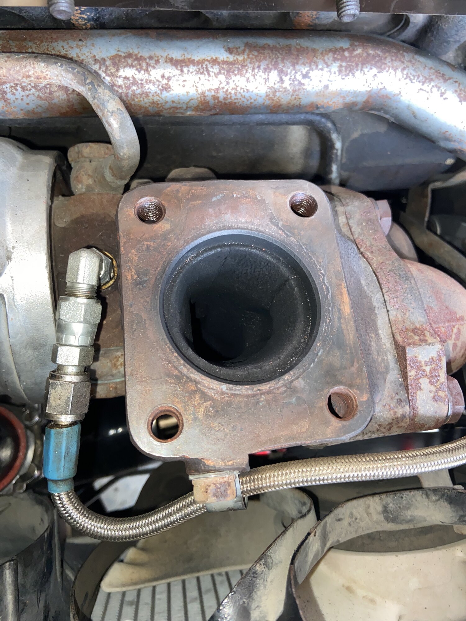

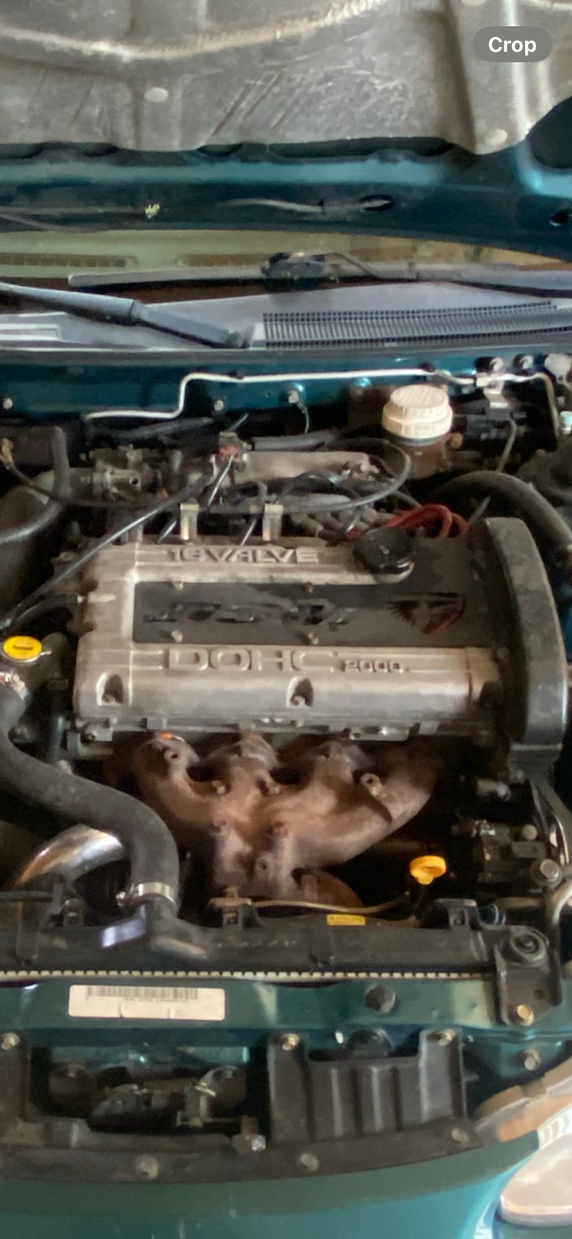

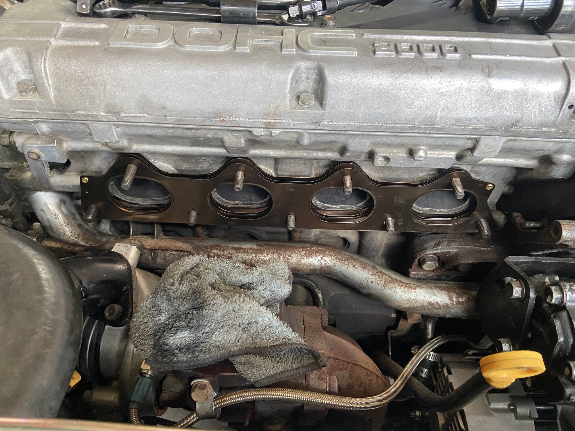

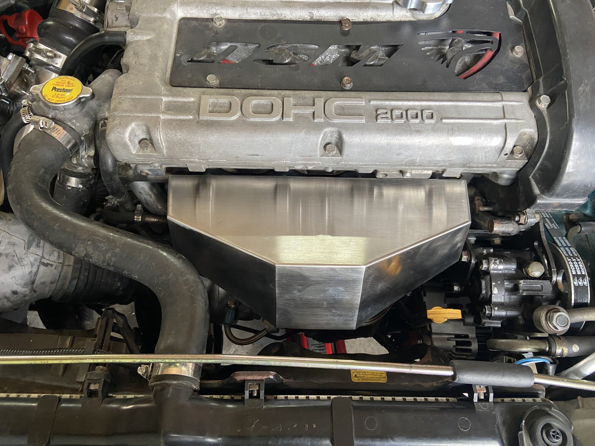

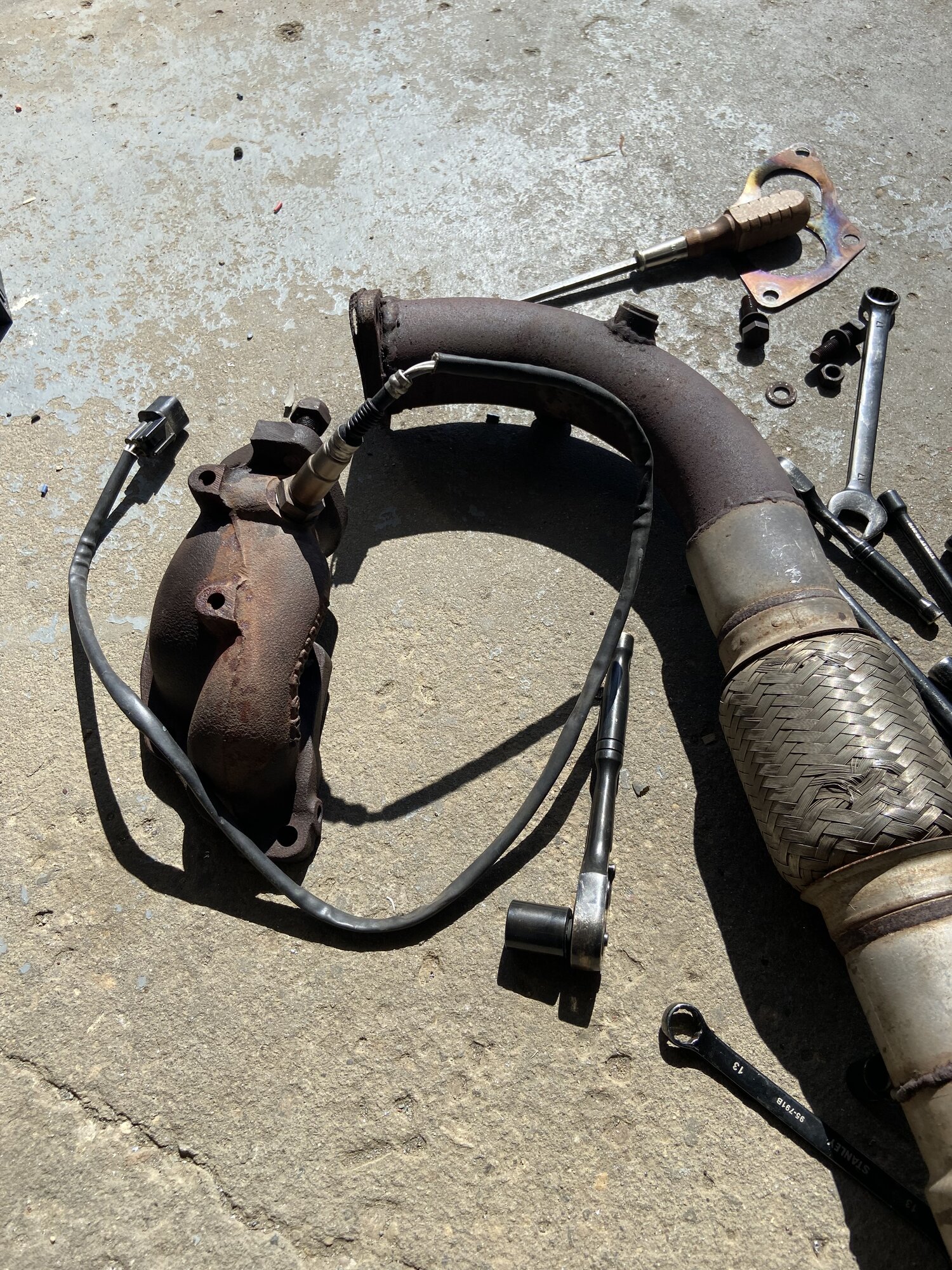

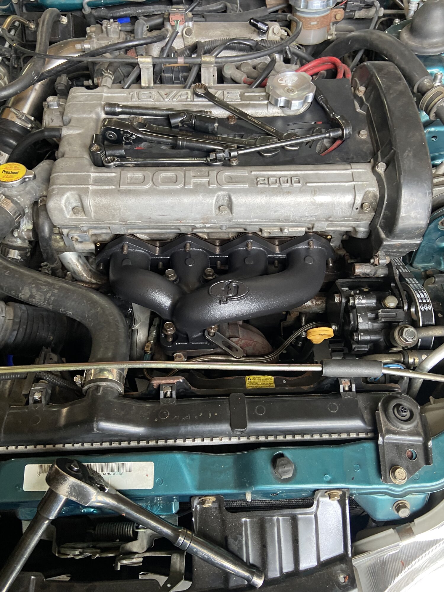

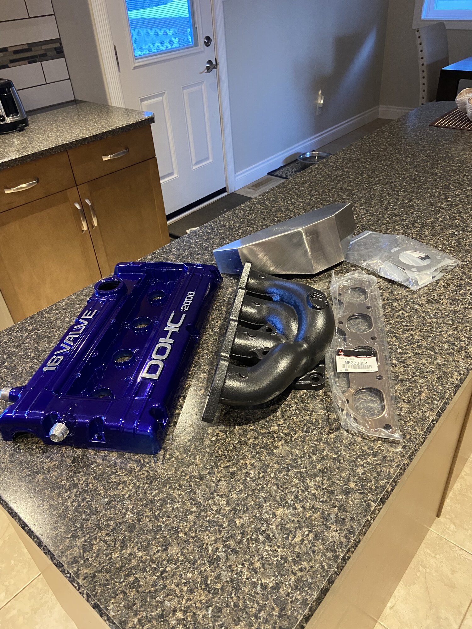

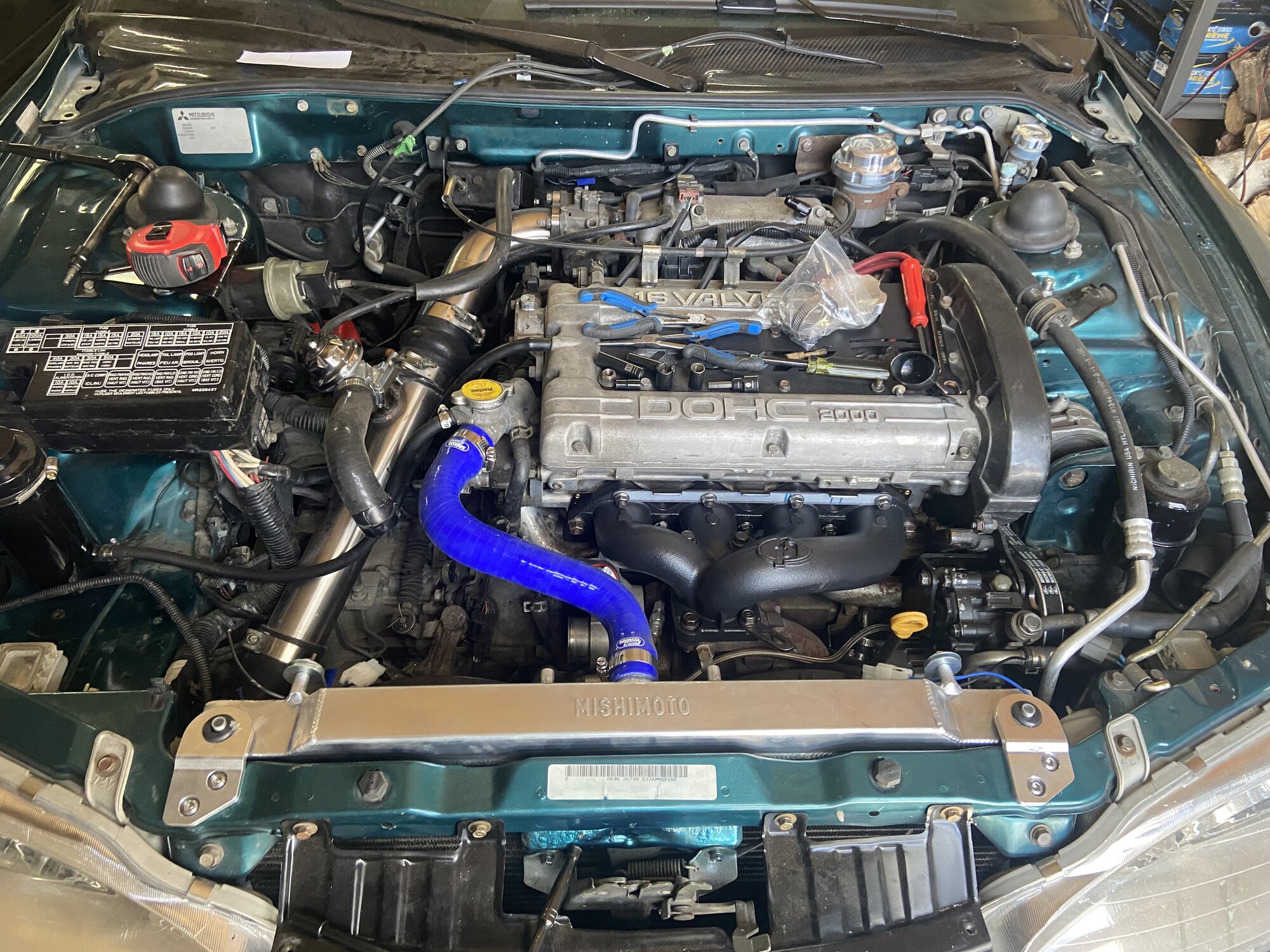

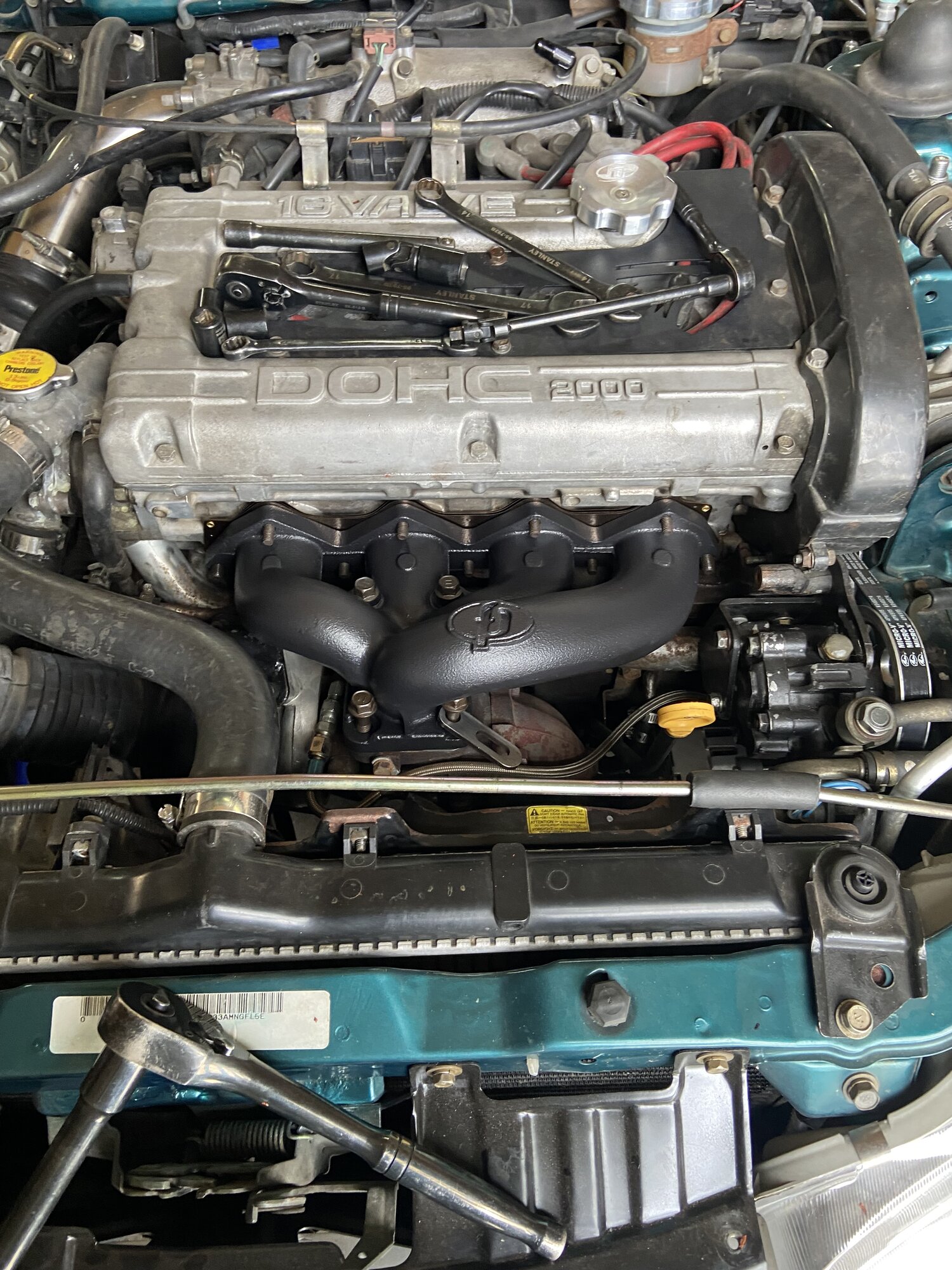

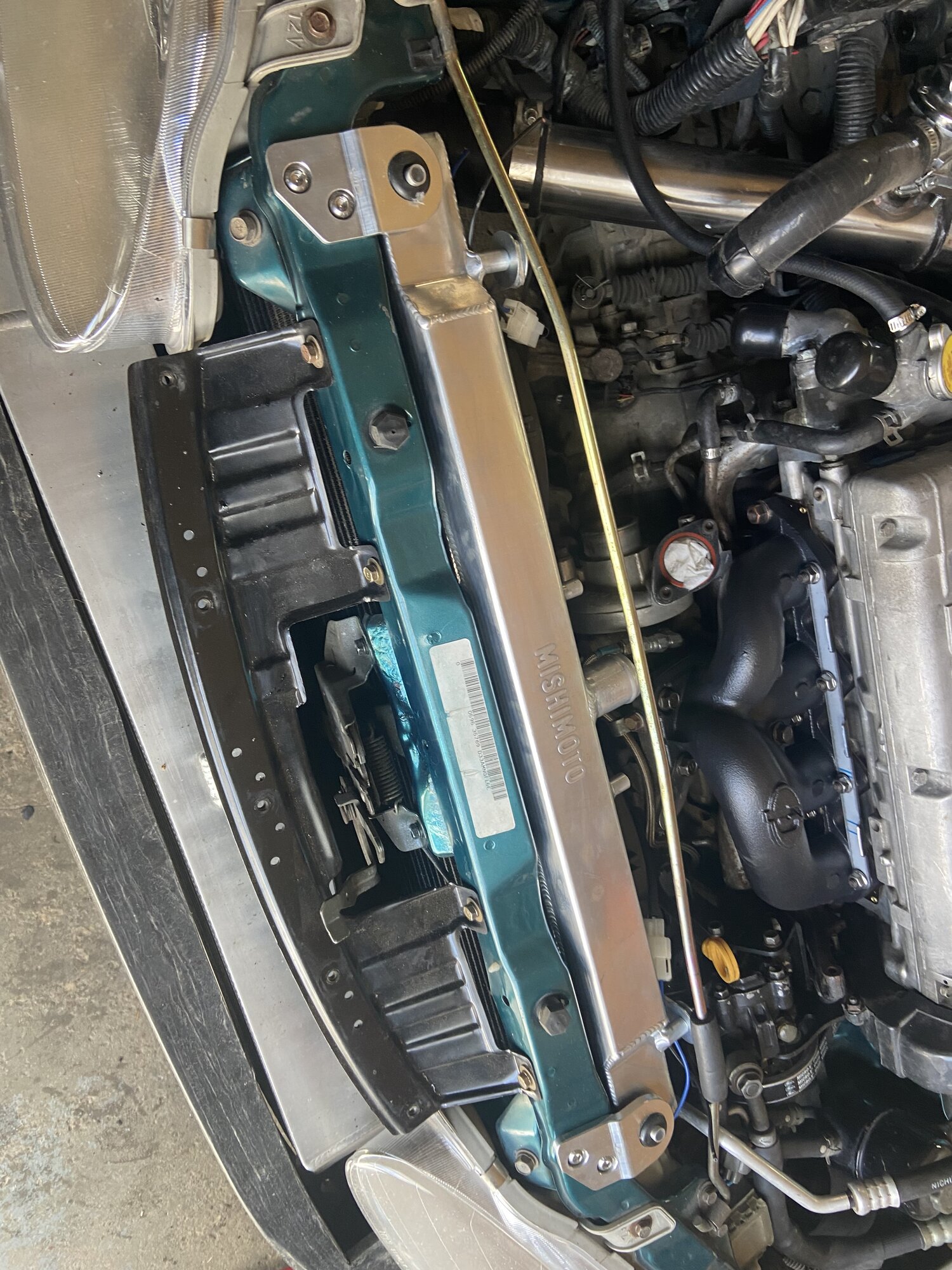

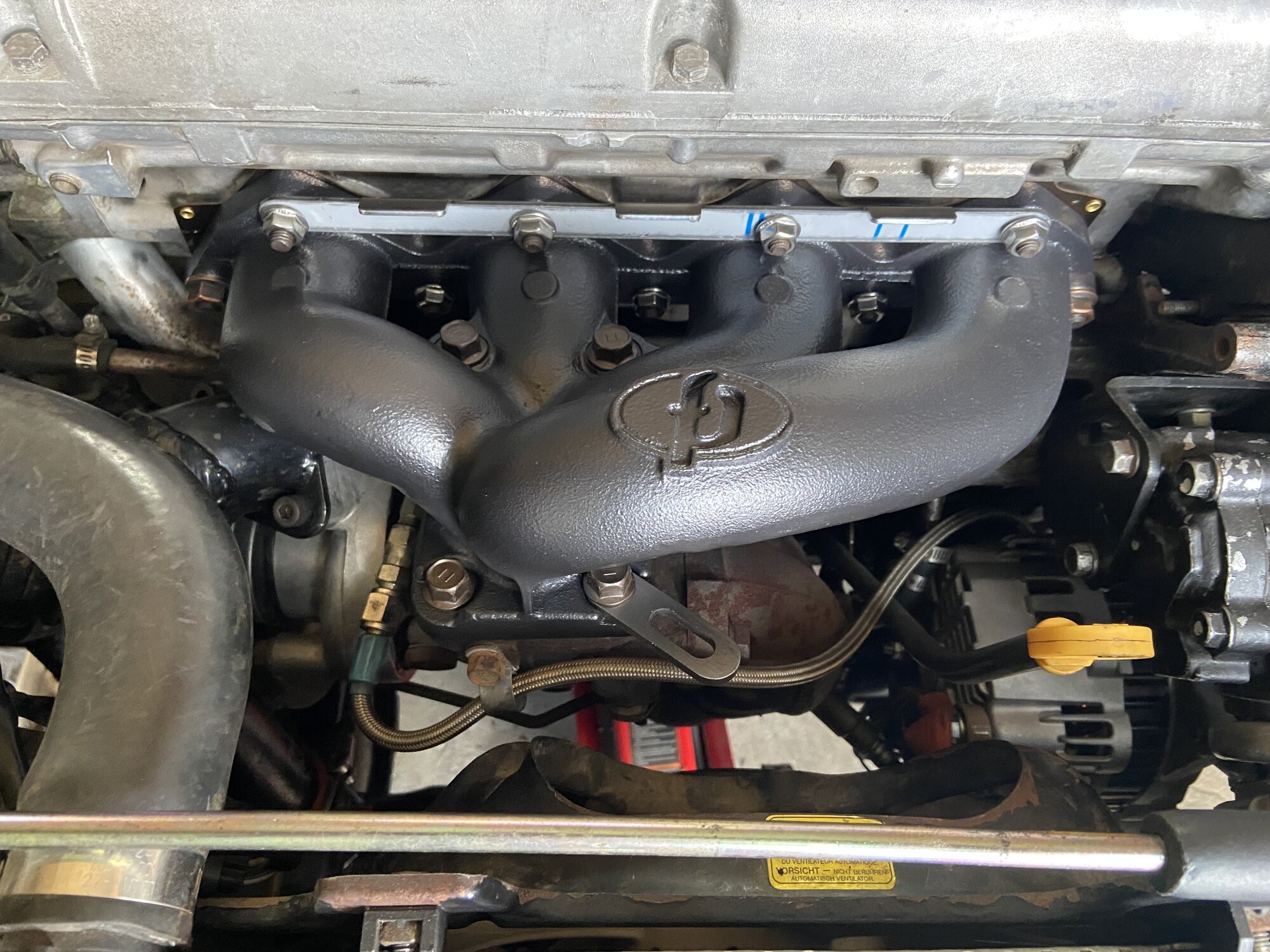

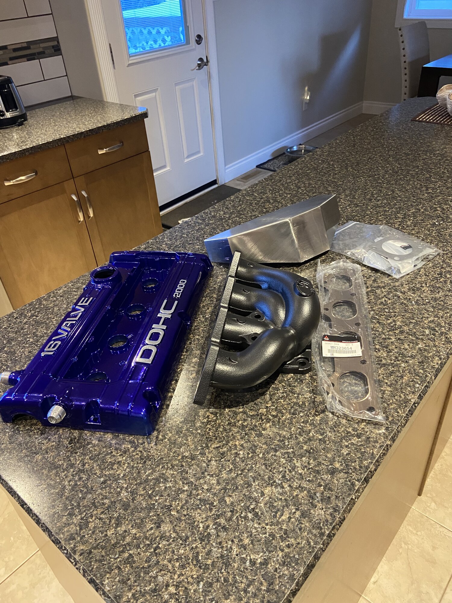

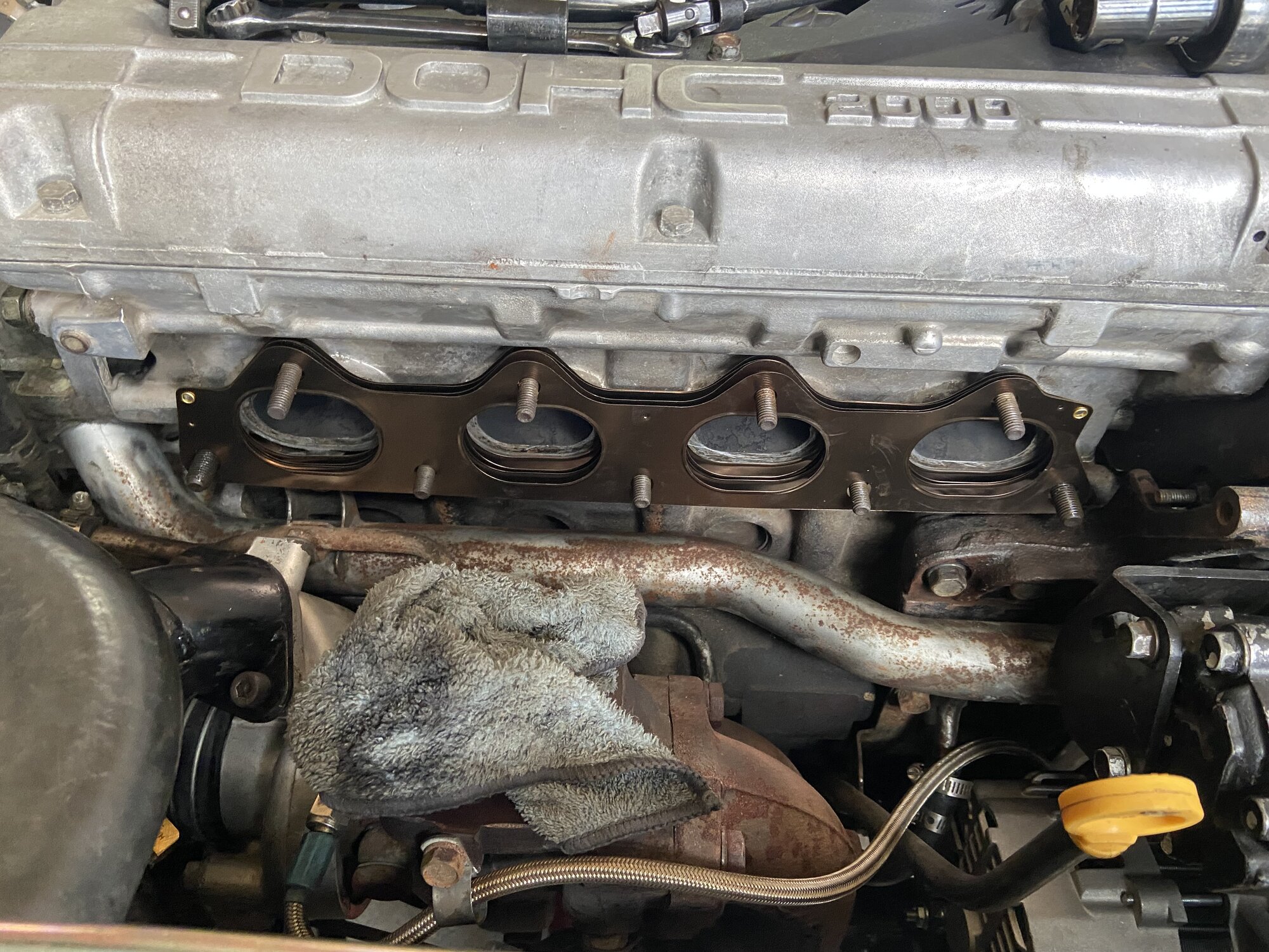

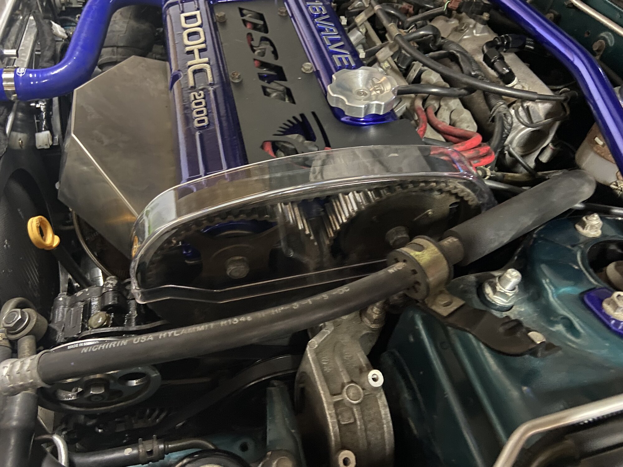

Exhaust Work – FP Race Manifold Install

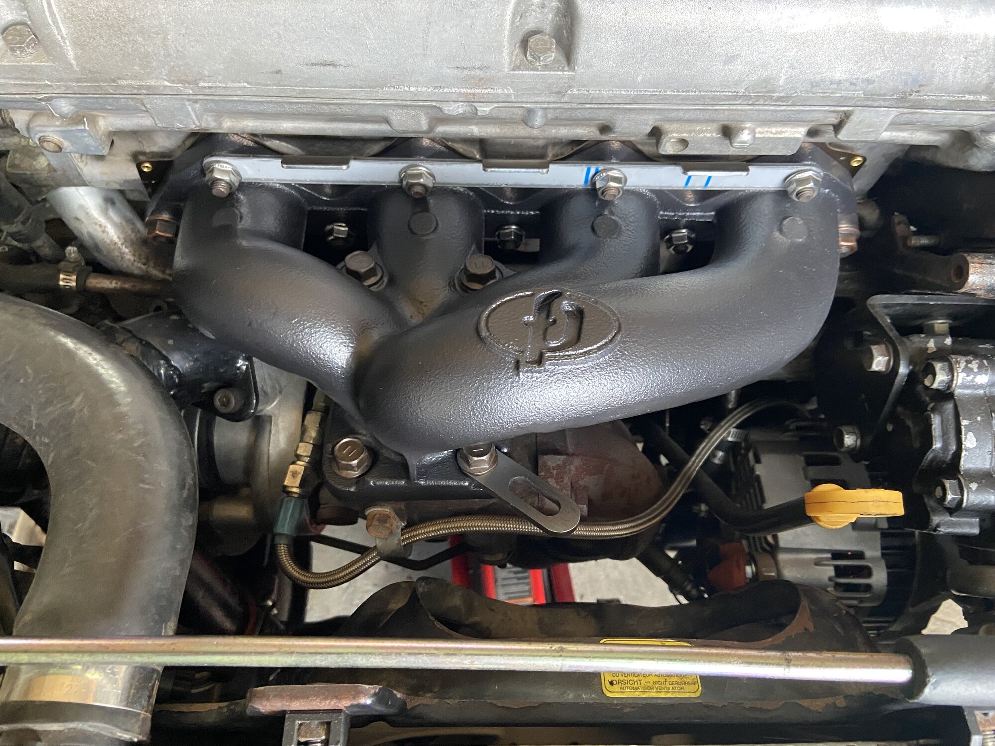

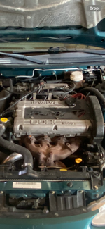

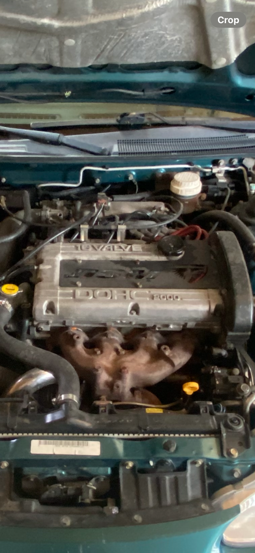

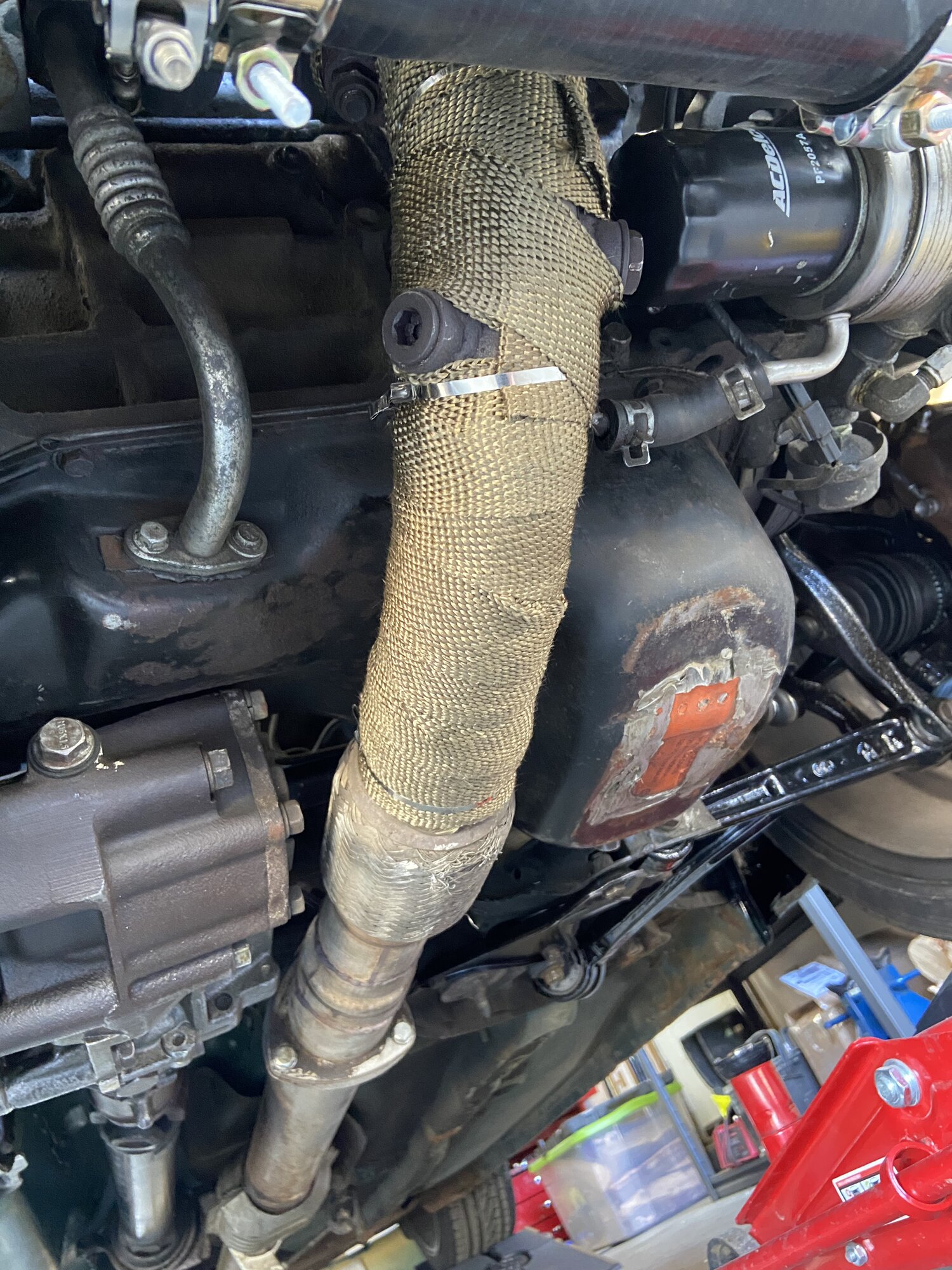

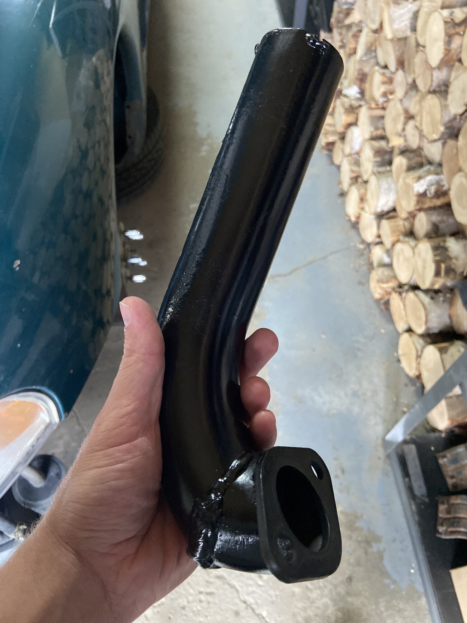

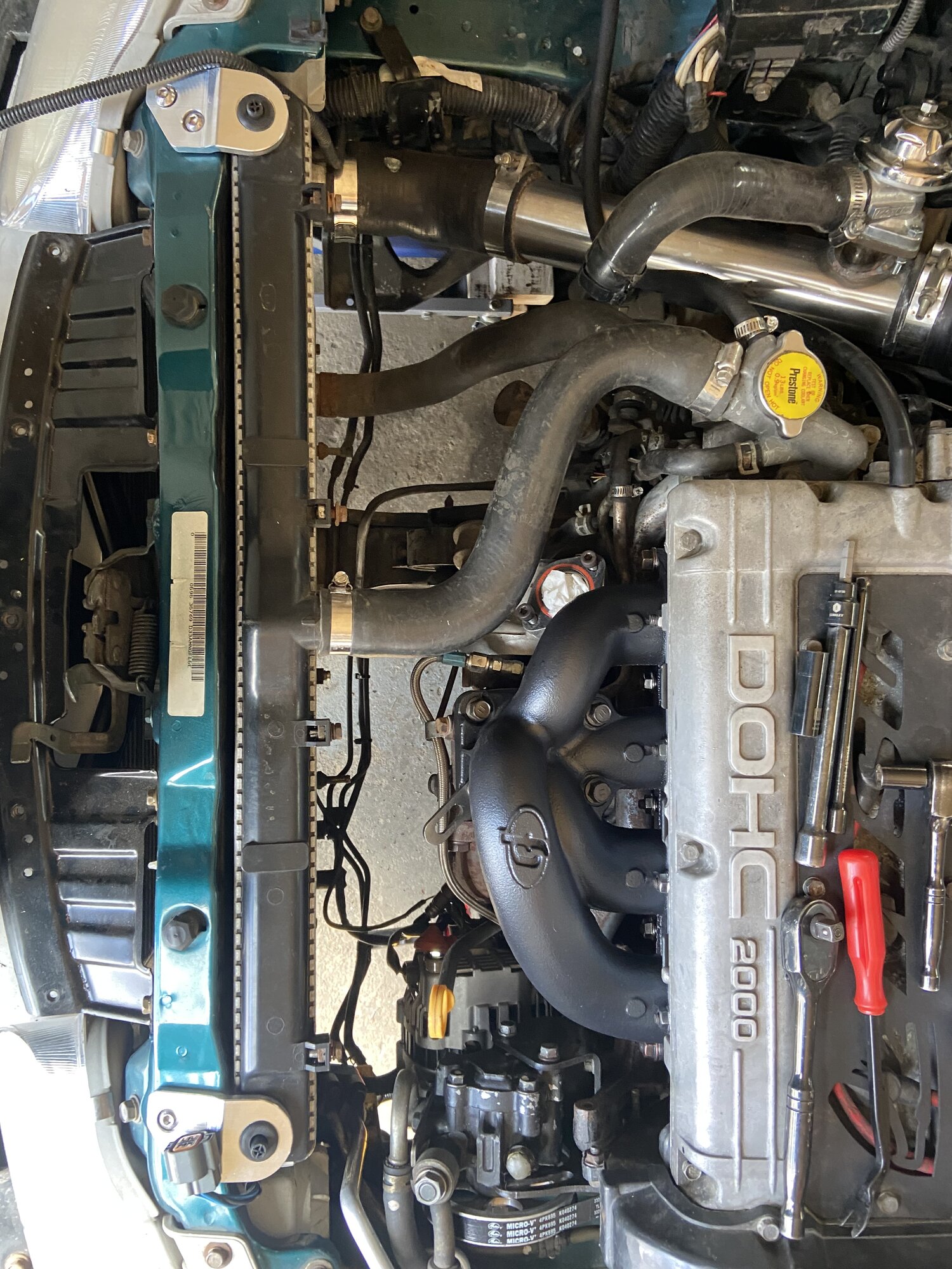

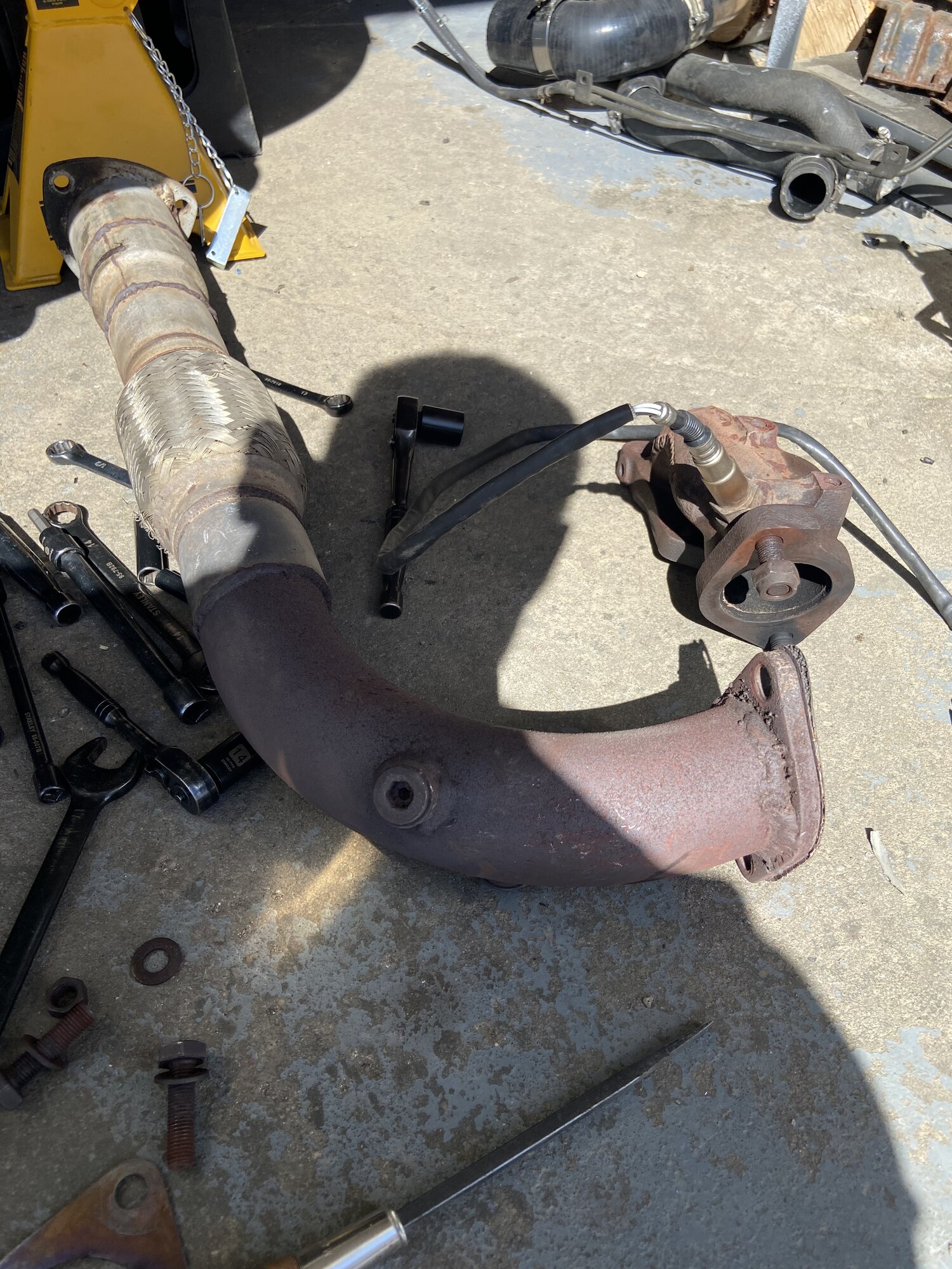

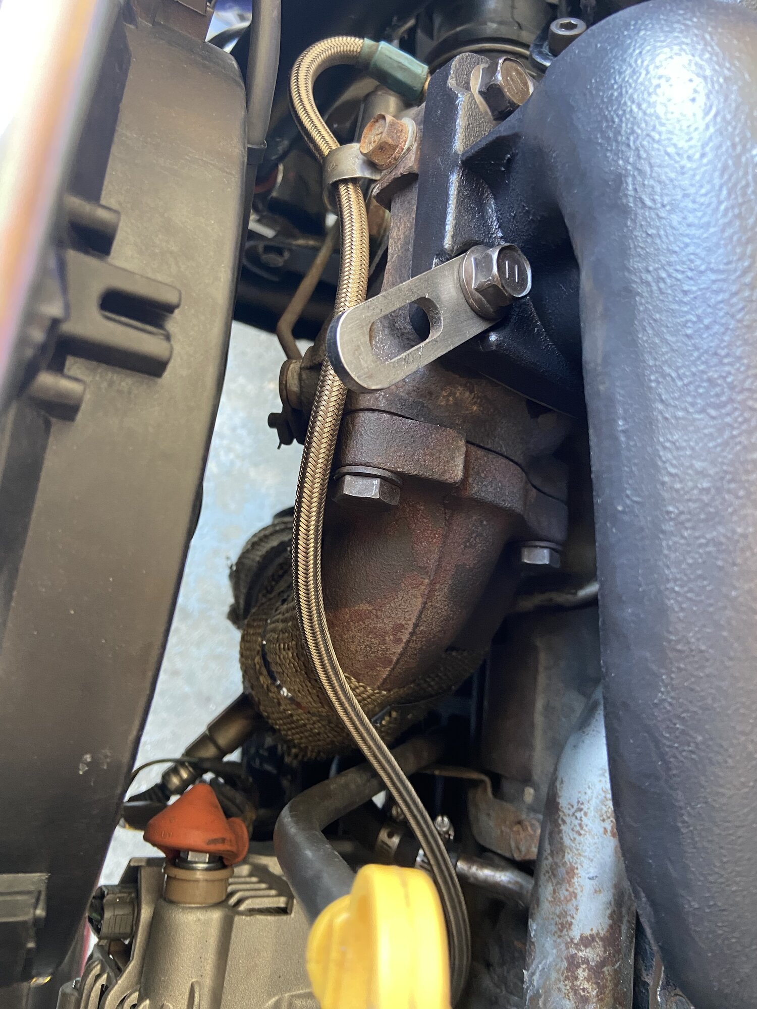

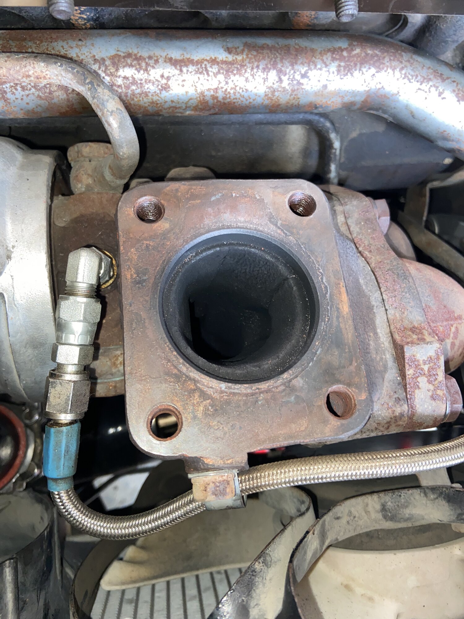

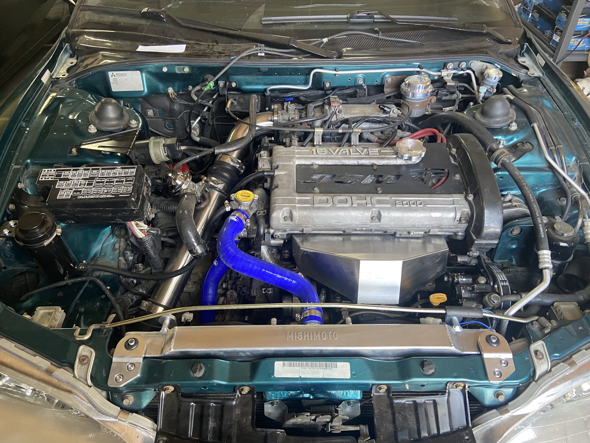

Once parts started arriving, I was able to get some time in the garage to install the FP Race manifold along with the ExtremePSI heat shield and I was definitely happy to get rid of the factory 2G manifold — especially the excessive RTV that had been used on the gasket previously. Everything cleaned up well, and the new manifold fitment was straightforward.

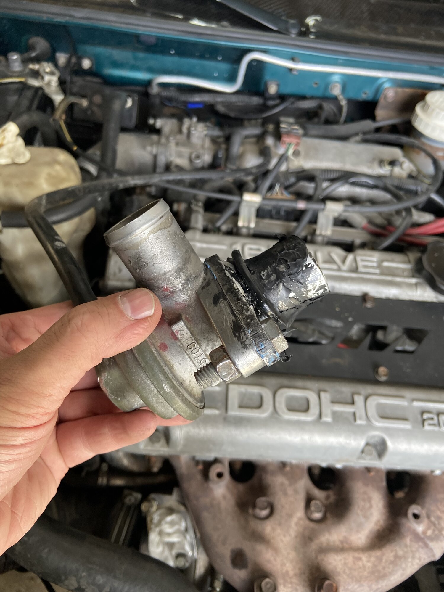

However, while everything was apart, I came across an issue that explains a lot. After pulling things apart, I found that my TD05H 14B turbine housing is cracked and the crack appears to run through the wastegate flapper area allowing exhaust gases to bypass the turbine wheel. This is a common failure point on these turbos, but it effectively reduces the energy driving the turbo, which explains the laggy spool characteristics I’ve been noticing. Not ideal, but also not the end of the world since a turbo upgrade is already part of the long-term plan.
For the manifold install, I opted to use Evo 8 exhaust manifold hardware instead of the factory 2G hardware. The Evo hardware uses nuts with small serrations/teeth that improve grip and help resist loosening over time after heat cycles. It’s a small upgrade, but one that should improve long-term reliability.

March 2026 Update – Parts Arrival, Interior Refinement & Exhaust Progress
This past month has been a slower one, mostly spent waiting on parts to arrive—but that didn’t stop me from making a bit of progress where I could.
Interior Refinement – LED Conversion
While the car was sitting, I took some time to refine the interior lighting by converting everything over to 6000K LED bulbs. It’s a small change, but it really modernizes the cabin and improves overall visibility at night.
Here’s the full breakdown:
• Glovebox & footwells – 6000K 194 LED bulbs
• Vanity mirrors – 6000K 29mm LED bulbs
• Dome lights – 6000K 31mm festoon LED bulbs
• Hatch/cargo light – 6000K 28mm festoon LED bulb
The difference is immediately noticeable—much cleaner light output compared to the factory incandescent bulbs, and it complements the rest of the interior upgrades nicely.
Parts Orders – Lining Up the Next Phase
Back in late February, I placed a couple of large orders to support the next stage of the build. The goal here is to continue building out the supporting systems so the car is ready for more power and improved reliability.
Fuel System:
• Walbro 450lph E85-compatible fuel pump
• 30A fuel pump rewire relay harness
• Radium Engineering fuel rail
• Radium Engineering direct-mount fuel pulse damper
• Radium Engineering direct-mount mechanical fuel pressure gauge
• Radium Engineering direct-mount fuel pressure regulator
• Performance World 8AN ORB 10-micron inline fuel filter
• Fuel filter bracket
• 8AN male to M14x1.5 bubble flare fitting
• 10 ft of 8AN PTFE line (supply) with fittings
• 10 ft of 6AN PTFE line (return) with fittings
• All remaining AN fittings for a complete setup
Cooling System:
Exhaust:
Gauges:
Drivetrain:
• TRE Stage 1.5 AWD 5-speed transmission (used)
Other:
Dress-Up:
____________________________________________________________________________________________________________________________________________________________________________________________________________________________________________________________________________________________________________________________________________________________________
Up Next
Next on the list is installing the Mishimoto radiator along with the dual slim fans that I'll be wiring through a dedicated 30A relay harness to keep electrical load off the factory circuits and avoid blowing fuses.
With all the major supporting mods now on hand, things should start moving a lot quicker heading into the next update.
Stay tuned for more.

April 2026 Update – Catch Can System, Cooling Upgrades & Spring Prep
With the battery relocation complete and the factory battery finally out of the engine bay, I was able to move into the next phase of the build and free up some much-needed working room under the hood.

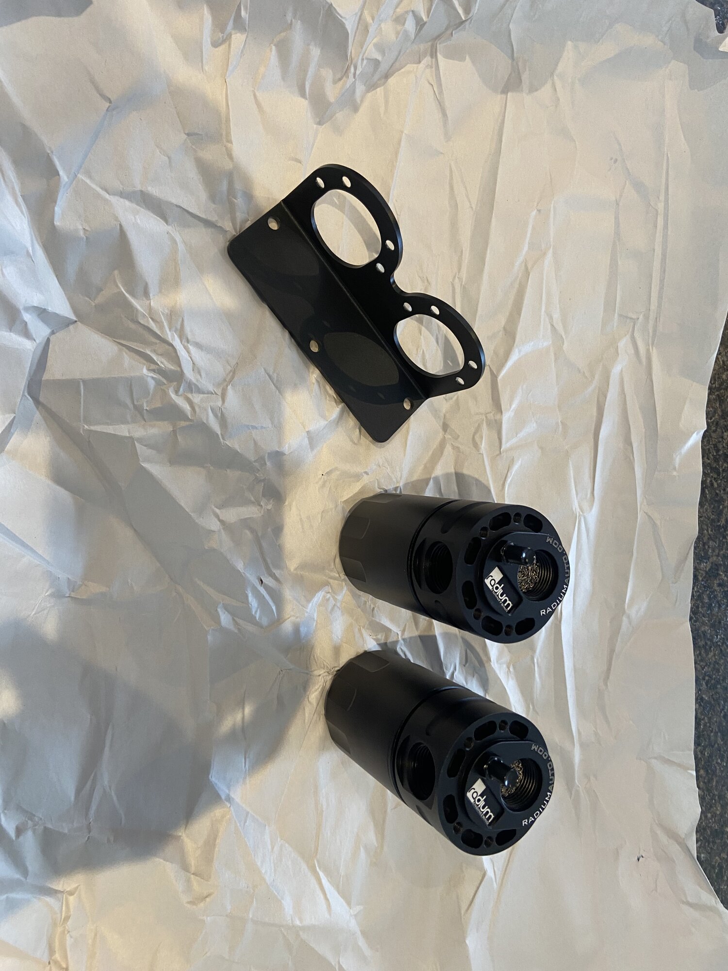

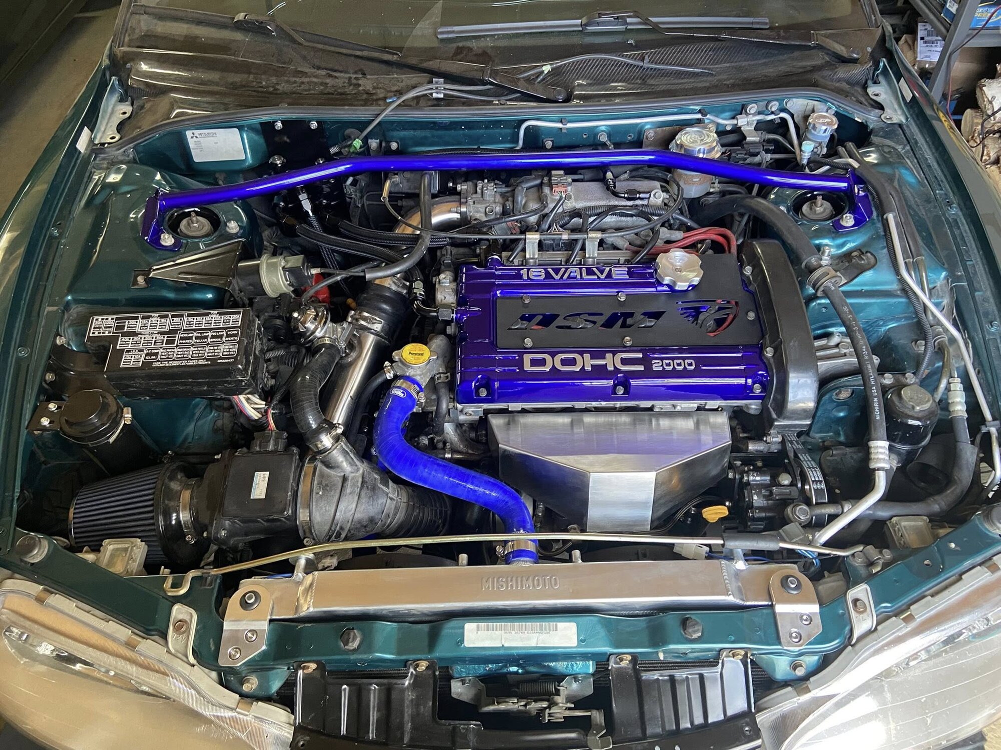

Dual Catch Can / Custom Valve Cover Installation
First on the list was installing my valve cover from Rix Racing that has dual welded 10AN bungs for the PCV system and was powder coated in Prismatic Powders Intense Blue with a new Felpro valve cover gasket kit.
With the valve cover in place, I got to work installing the catch can setup using two Radium Engineering universal catch cans, each side receiving its own dedicated 10AN feed line directly from the valve cover:
  • Boost / vent side: routed to a catch can with a 10AN banjo outlet, then connected to the turbo intake pipe
  • Vacuum side: routed to a second catch can using a 6AN banjo fitting with integrated PCV valve, then connected to the intake manifold
I chose to reduce the vacuum-side return line to 6AN, since it doesn’t require the same flow capacity as the pressurized side, which remains 10AN. This was my first time building AN lines from scratch, so there was definitely a learning curve but they turned out great, and I’m really happy with how clean the finished system looks.
Front Strut Bar Installed
Next up was the installation of a Boosted Fabrication front strut bar, also powder coated in the same Intense Blue as the valve cover for a matching look.
Fitment was excellent overall but it barely cleared the brake master reservoir cap, so I’m hoping it still fits once I install the new CNC aluminum reservoir brackets from DCP otherwise I'll have to modify the DCP brackets a little. And aside from aesthetics, this should add some welcome front-end rigidity and improve handling.

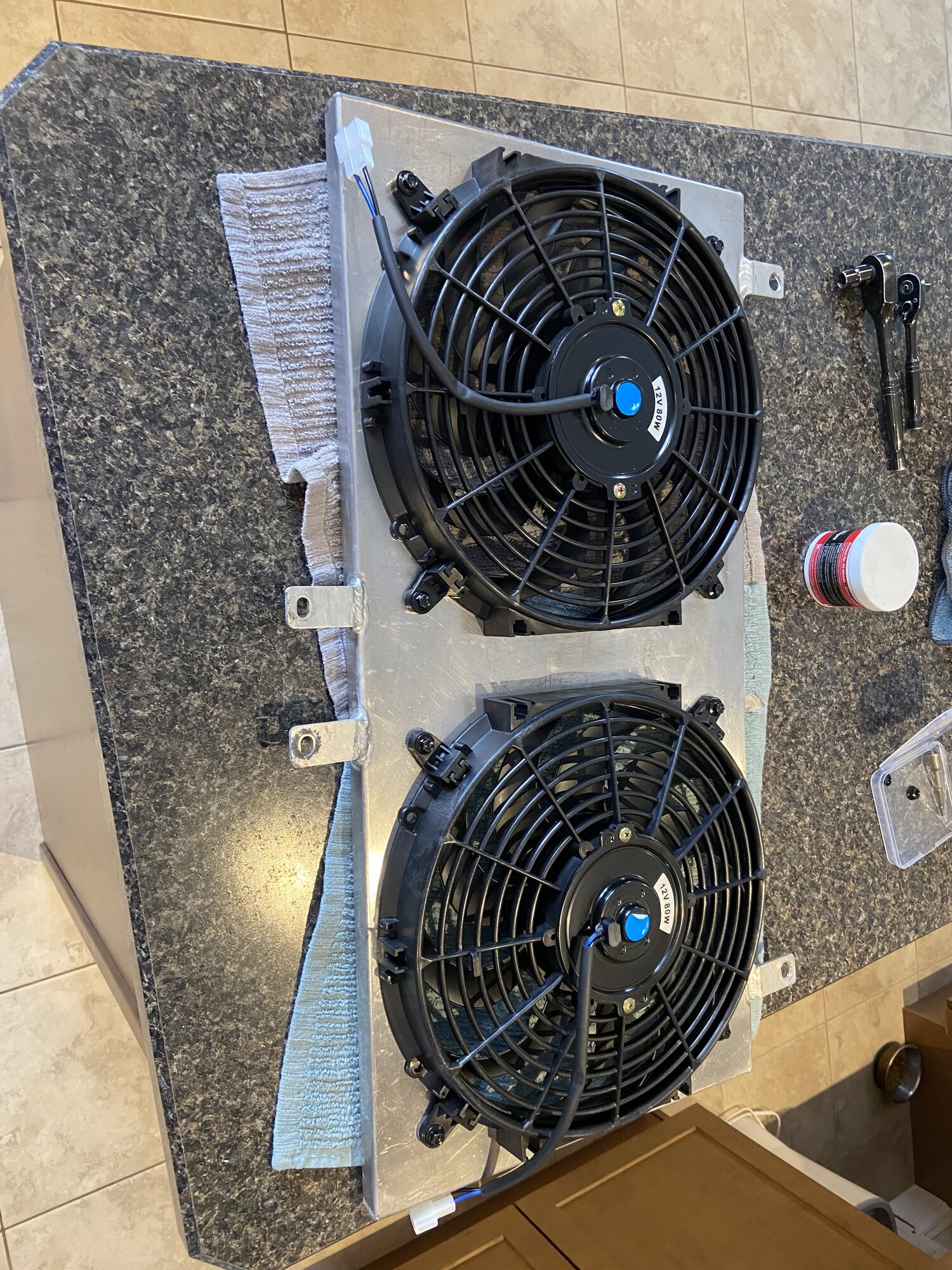

Cooling System Overhaul
From there, I moved on to the cooling system.
Installed components:
  • Mishimoto aluminum radiator shroud with nutserts installed for easy install and removal of the fans later
  • Blue Samco Radiator Hoses (upper/lower)
  • Dual Performance World 7712B slim puller fans
  • Standalone 50A relay harness
Rather than rely on the factory fan wiring, I chose to run the fans through their own dedicated relay circuit to ensure full battery voltage, cleaner power delivery, and a properly fused high-current path.
My stand alone relay wiring layout was as follows:
  • Pin 30: 12V battery power from fuse box
  • Pin 87:positive leads to both fans
    • Fan negative leads were tied together and chassis grounded.
  • Pin 85: chassis ground
  • Pin 86: trigger from the positive side of the factory condenser/radiator fan relay circuit
Knowing I could have simply re-pinned the factory 4-wire fan connector, I wanted a dedicated solution that would reduced load on the factory circuits and provide more stable power to the fans even though I know many others have done just fine without an additional relay.
Exhaust Heat Wrap
Lastly, I removed the O2 housing and downpipe so I could wrap sections of the exhaust in titanium heat wrap to reduce engine bay temperatures, improve thermal efficiency, and help keep radiant heat away from the new slim fans and surrounding components.
Up Next
Still left on the pre-season to-do list:
  • Install AEM gauges
  • Reinstall front bumper
  • Final check-over before first drive of the year
Here in Fort McMurray, we’re still dealing with 2–3 feet of snow, and once that melts the roads usually turn into a muddy mess before they finally dry out. So while driving season hasn’t officially started yet, it’s getting closer and I’m definitely looking forward to getting the Talon back out on the road.

May/June 2026 Update – Dialing Things In, Chasing Heat & Solving the High Idle
With spring finally arriving in Fort McMurray, I was able to get the Talon mostly reassembled and back on the road. After months of winter projects, it felt great to finally drive the car again and start sorting out some of the smaller issues that only show themselves once everything is up to operating temperature.
Exterior Reassembly
The first order of business was getting the front end back together after all of the cooling system and engine bay work from the previous update.
I reinstalled:
  • Front bumper
  • Front fender liners
  • Hood
With everything back together, the engine bay is finally starting to look complete again.
Interior Monitoring Upgrades
With the car back together, I installed a pair of AEM X-Series gauges for boost and wideband monitoring.
To keep the interior looking as factory as possible while still adding useful instrumentation, I mounted them in a carbon fiber gauge cluster speedometer ring with integrated dual gauge pods from Tuning Art Official. The fitment turned out excellent, placing both gauges directly within my line of sight without having to add bulky A-pillar pods or clutter the dashboard.
The AEM X-Series gauges are incredibly responsive, and having accurate boost and AFR data readily visible will be invaluable once the larger turbo and fuel system go on later this year.

Alignment... and an Unexpected Heat Problem
With everything assembled, I booked the car in for a wheel alignment after replacing the front suspension components over the winter.
The alignment went smoothly, but the drive home quickly revealed another issue.
My driver-side Performance World slim radiator fan had partially melted from radiant heat coming off the turbine housing.
Although I had already wrapped portions of the exhaust and installed the FP Race manifold heat shield, it became obvious that the exposed turbine housing was still radiating far more heat than I had anticipated.
To address the issue permanently, I removed the FP Race manifold again to gain enough room to install a turbo blanket, and with everything apart, decided to improve the overall thermal management around the turbocharger with the following:
  • Turbo heat blanket installed on the turbine housing
  • 2000°F reflective thermal barrier applied to the coolant hard lines behind the turbo
  • 2000°F reflective thermal barrier applied to the underside of the ExtremePSI manifold heat shield
I then replaced the melted fan with another to verify my solution worked, which it did, and then swapped out the cheaper PW fan for a Spal 30101522 puller fan and have another to go in on the passenger side as well. So, far these changes are keeping my temps under control, and will only get better once I add a vented hood.
Throttle Body Adjustments & Boost Leak Testing
Since the car was finally together, I wanted to revisit the throttle body and make sure everything was adjusted correctly before chasing any tuning issues and I’m glad I did since I found that the factory throttle stop adjustment screw (SAS) was missing causing the throttle plate to stick inside the bore. A fellow DSMer in Alberta happened to have an extra that they mailed me via Canada Post, but to my surprise the envelope came with a hole in it and no SAS. Thanks Canada Post…
After some trial and error, I was able to find a machine screw at one of my local stores that fit, so I finished the install using a voltmeter to verify the TPS voltage was within spec (0.57V) then warmed the engine to approximately 190°F and confirmed idle speed was sitting between 950-1000 RPM after making a small adjustment to the BISS screw. I’m going to adjust the TPS slightly to target 0.63V later, but for now I moved onto a boost leak test and found two remaining leaks:
  • BOV flange
  • BISS screw O-ring
Both were easy fixes, but it turned out my BOV set screw also stripped the threads out of the upper diagram body which prevented it from holding boost. But a quick rebuild with a helicoil fixed that issue.
I replaced the BISS screw with a genuine OEM screw complete with a new O-ring and cap, then removed and resealed the BOV flange using black RTV.
A second boost leak test confirmed both leaks had been eliminated.
Solving the High Idle Mystery
Unfortunately, one drivability issue still remained.
Once the engine reached operating temperature, every time I came to a stop at a traffic light or stop sign, the idle would slowly begin climbing until it reached roughly 2,500-3,000 RPM.
After pulling over and inspecting the engine bay, I noticed the throttle cable was becoming extremely tight and was physically pulling the throttle plate open. After some troubleshooting, I traced the problem back to the factory cruise control actuator. The cruise control solenoid was failing internally and applying tension to the throttle cable, effectively opening the throttle body on its own.
Rather than replace the aging cruise control components, I decided to simplify the system. I removed the cruise control throttle cables entirely and converted the car to a single non-cruise throttle cable using an ATP Y1154 cable.
The difference was immediate.
Following another test drive, the idle remained perfectly stable every time the car came to a stop, confirming the faulty cruise control actuator had been the culprit all along. Sometimes the simplest solution really is the best one, though I’ll miss cruise control on the highway. Future plans involve a stand along ECU with drive by wire, so I’ll get cruise control back eventually.
New Windshield
To finish things off, I finally replaced the windshield.
The original glass had accumulated enough chips and wear over the years that it was beginning to affect visibility, so I had an OEM replacement windshield installed by a local shop here in Fort McMurray. They were one of few shops who took the time to source a replacement windshield, even if it had to come up from the US, and I intend to order a spare piece that I’ll store for the inevitable future that I need to change it again.
