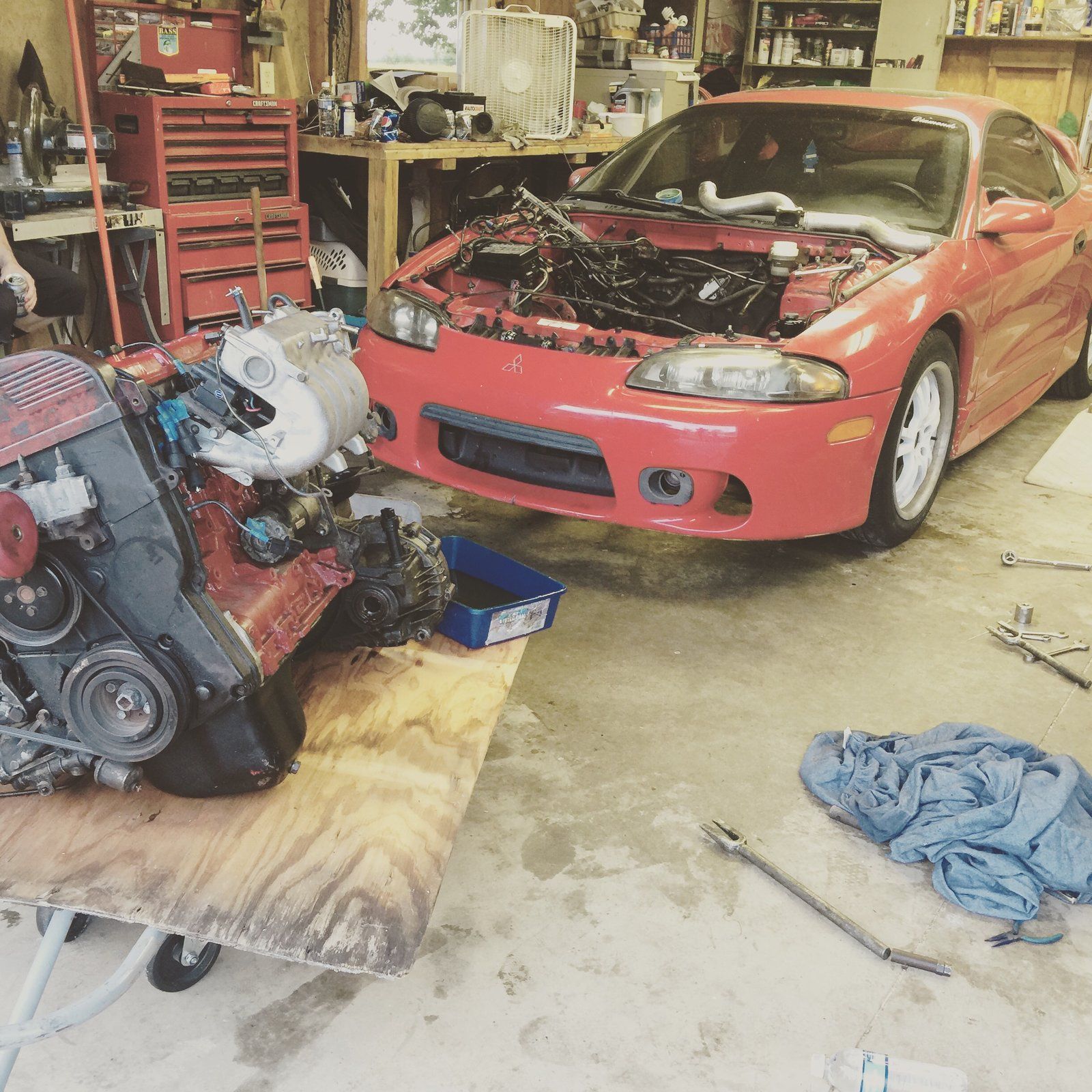

Motors out and ready to ship off to the shop with the tranny as well. Gonna get inside the engine bay and clean up a little bit and retape the wiring harness as well!

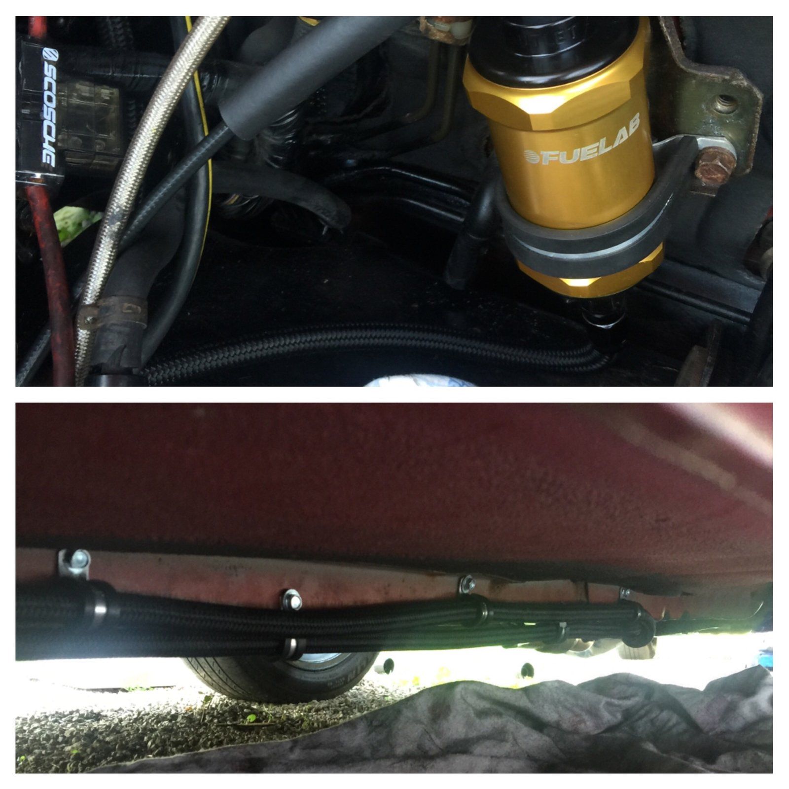

6an lines isn't needed for 400hp. What are you planning on running pump, race, e85? I would also do a fp rewire. How are you planning on connecting ss line to tank?
I used avid 75 motor mounts and they fit great. Car is definitely a lot more vibrant LOL. If you get the fp manifold make sure you get it ceramic coated. It'll rust and look like shit if not. As for a catch can @Calan makes awesome cans. That's who I went through.
400 will be a fine setup for this car bc after I get done with it I'm going to start on my 1g tsi awd. I have also given some thought to the hx35 and decided against it for various reasons. But those gsc cams what kinda info can you give me on them? I've already got a 2 bolt WG :idontknow: and Im gonna be running pump gas for the time being.
You say you want 400 hp now but once you get there you'll want more. I would go the hx35 or 40 route. Injectors, if you think you might want more power down the road then go big. As for cams I went with gsc s2. They seem to kick ass in all the comparisons I've seen. You getting a quaife lsd? Pr 02 is awesome. Make sure you go v band and not 2 bolt. My 2 bolt has gave me hell.

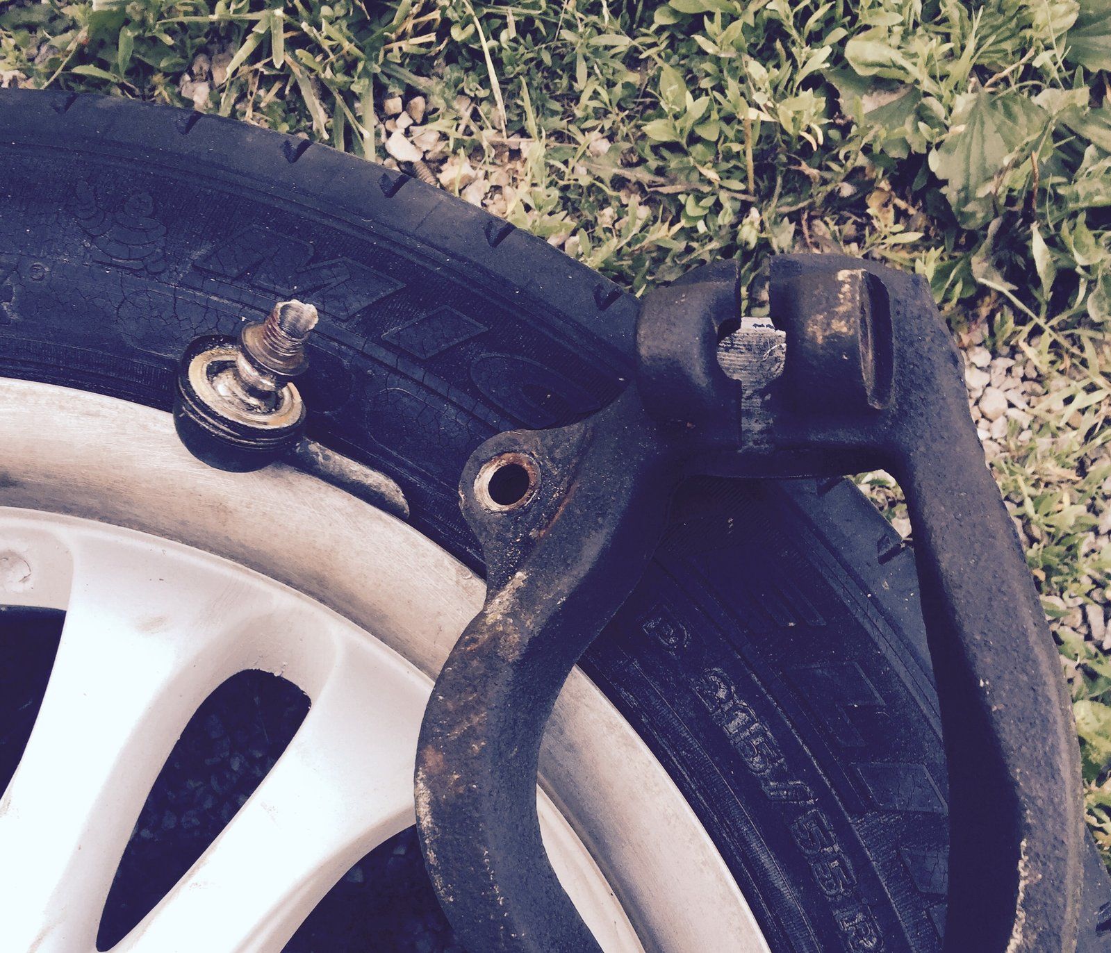

Well after about 4 1/2 hours of cussing and struggling I finally managed to cut and drill this sway bar link outta my shock fork. Now I'm ready to order some suspension!

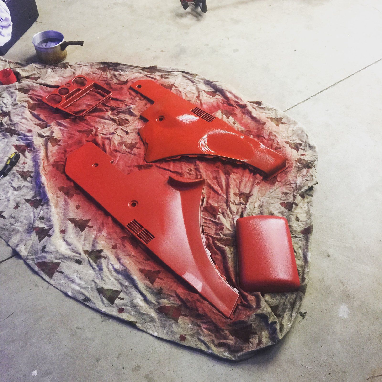

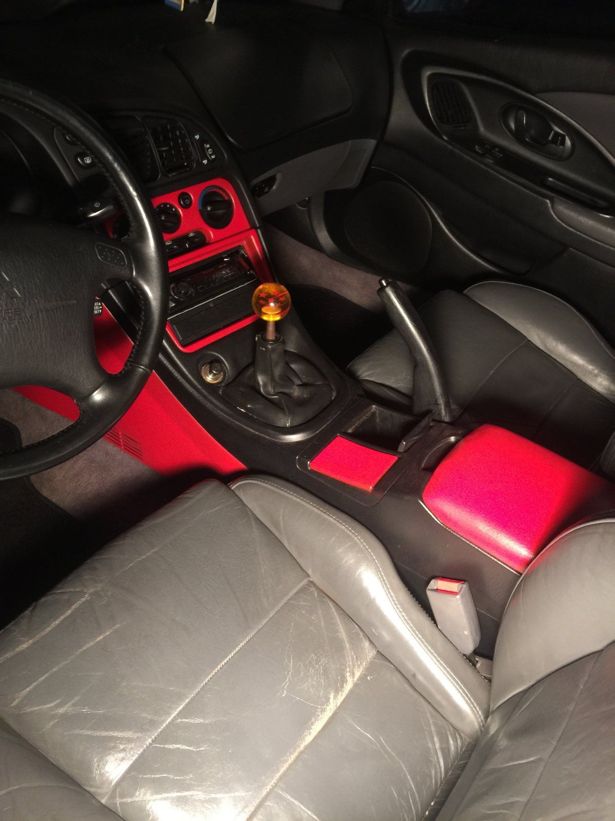

Picked up some spray from autozone and finished up my interior. It might be a little bit too much but I think it turned out decent and its a good change for me
Noooooooooo... Red painted interior. Looks like someone went through the hassle of swapping in the black/grey interior, why wreck such a great combo?
Yah I just wanted to look at somthing diff tho man. It's just like *****. You get hit a different one every once in awhile
