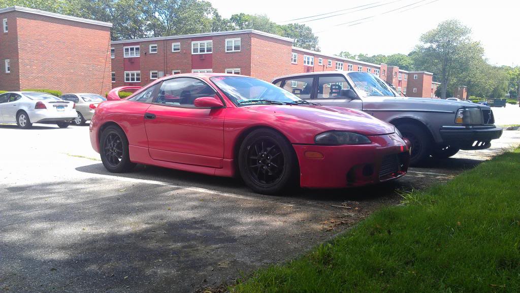

Alrighty so this was the car after a month of owning it. I painted the rims black, Exhaust, FMIC, and Lowering springs. Unfortunately I don't have any pictures of the car Before this.

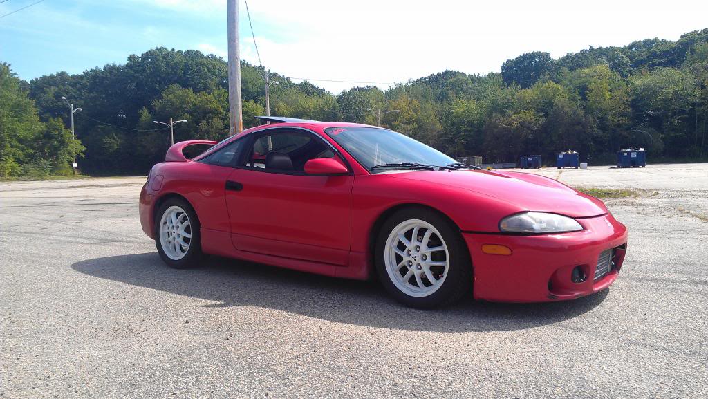

So then I was in a predicament, and I still am, about Rim color. I plan on eventually getting Rota Grids in either Bronze or White. So in the mean time i decided to paint my rims white, to see how i liked it.
I DO like the white a lot, but I'm leaning more towards bronze. Rims will be next on the list after my tune when my DSMlink comes in.

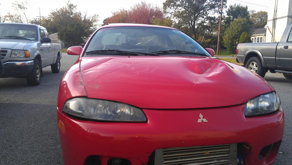

So here i was about 2 months ago, minding my own business at the skatepark not even in my car, and i hear WAM!! CRUNCH!!! SCREAAAAAAAACH!!!! I noticed a truck ON TOP of my car. Apparently when he was backing up, he didn't see my car in his mirror. Apparently a lowered car is hard to see in the mirror of a lifted dodge ram. So here's the aftermath.
My Cam hump had become anti-hump. So being smart like I was, before I tried to start it i popped the hood. Luckily I had my 9lb Snap-on deadblow in my trunk, and i pounded it up as best i could so that it wouldn't rub on my T-belt. After getting his insurance information we parted ways on good terms. Damage ended up being $1900. I milked it too for the damage estimator. "Well you see the side skirt over laps the fender so that will have to be blended. And the Door then will have to be blended. Also the hood and driver side fender will have to be blended, as well as the driver door and side skirt." Hehe, after all it was true! So i decided, I can buy a hood and fender at a junkyard for $40 a piece, paint em myself, and throw em on. So here we go $1900 Engine Rebuild Fund!!

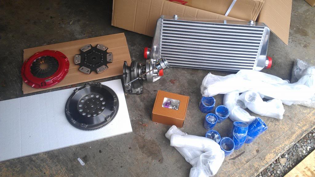

Next was the goodies
20G Godspeed Turbo, CX Racing intercooler, XTD Stage 3 Clutch and 11lb chromoly Flywheel, and my go fast bits Manual boost controller. I Know I went cheap on the turbo, intercooler, and clutch. But I've had great experience with all three companies in the past, and they haven't given me reason to doubt them yet, especially for the price. I had a Godspeed turbo in my 87 rx7, along with a CX racing V mount intercooler and XTD stage 3 Clutch, 383WHP for over 9 months, and sold the car in perfect running condition.

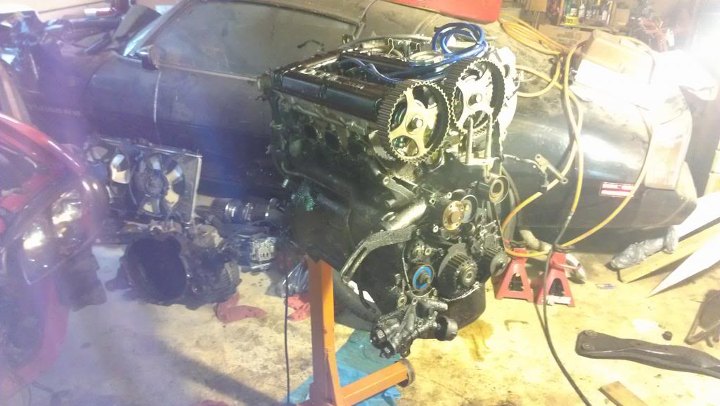

So it was time to start pulling the engine.
This is a shot of the engine at the very beginning, before I pulled it i figured it would be a good idea to get one last shot of the original engine bay.
Started to tear her apart. Mind you, i am 95% sure that this car had original axles, original clutch, and original engine. And not 1 single bolt broke or stripped out in the process of dis-assembly or re-assembly which was amazing.
Got it out start to finish in 2 hours. Little faster without dropping a transfer case, but not by much =p

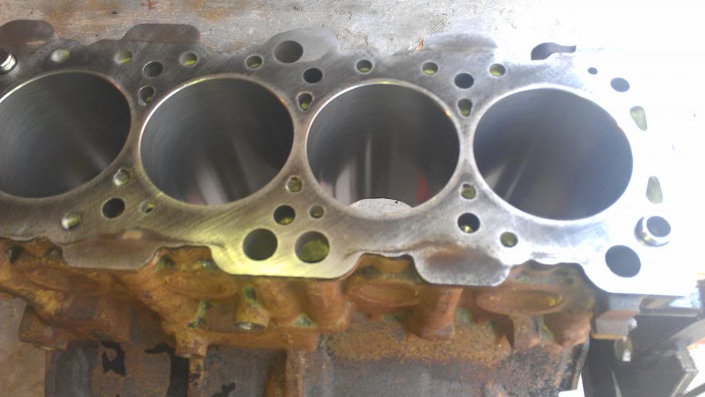

The was the machine shop that did my work, VERY reputable. EFI Logics is the Top Tuning and performance shop in CT and they send all their head work there from over and hour away.

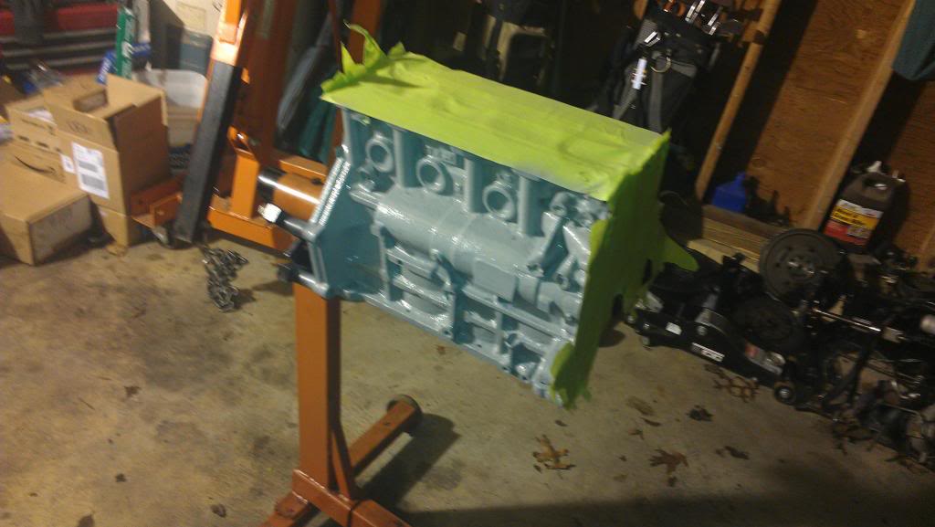

This was the day i got the block back, very fast return time.
Decided to paint it while i could because it looked hideous.

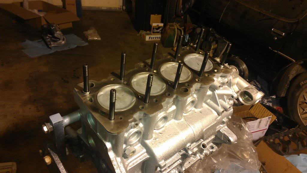

Started gapping the rings And put the pistons in.
Ended up going .018 on the compression ring, .022 on the scraper, and the oil rings were .024 so I left em alone.

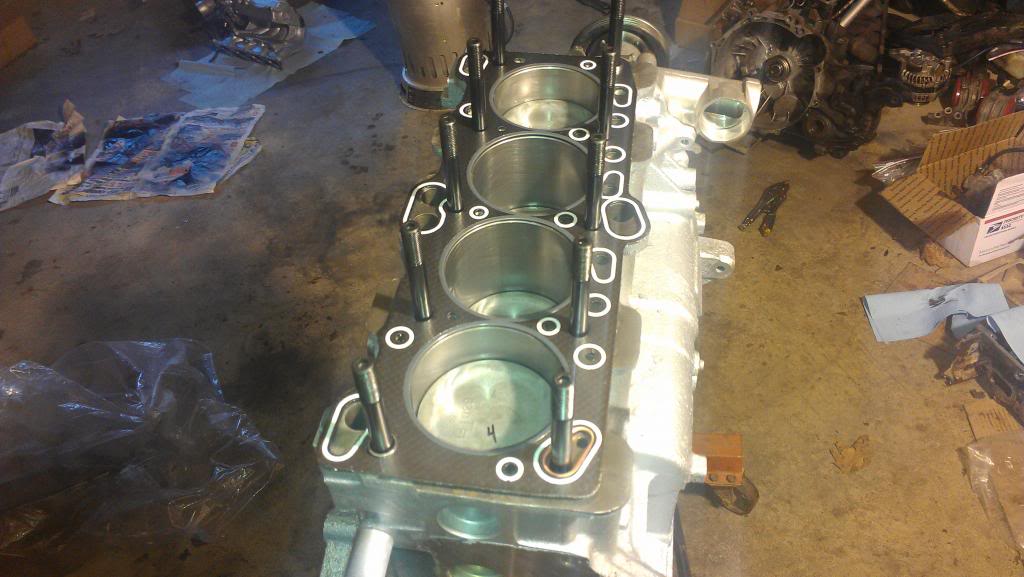

Put in the headstuds

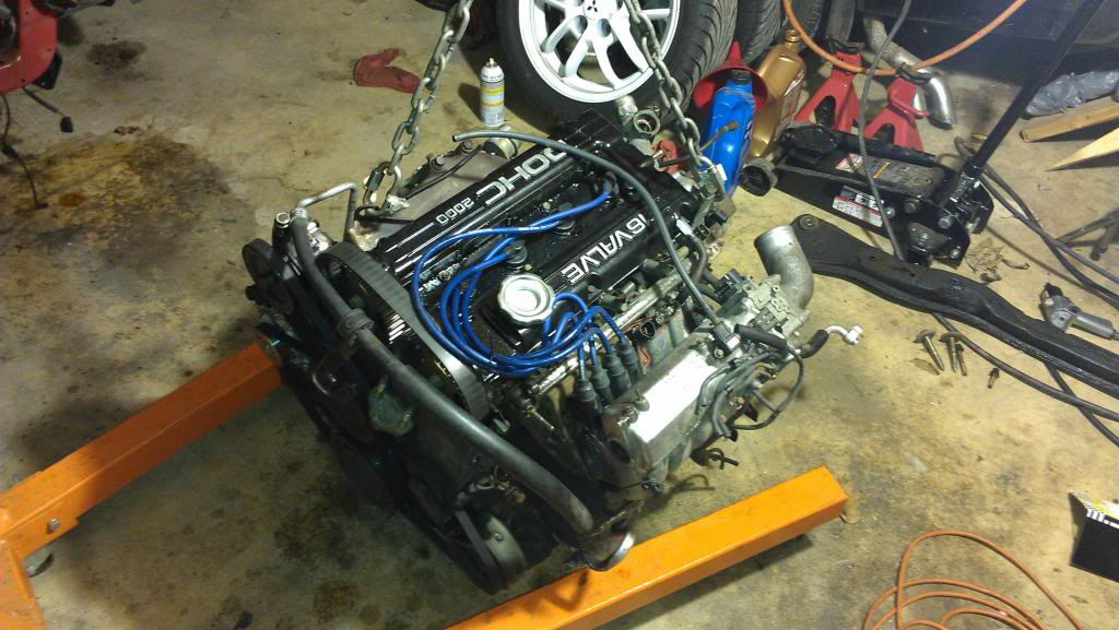

Next was the head gasket and head and timing belt.
Pictures of everything on and ready to drop into the car

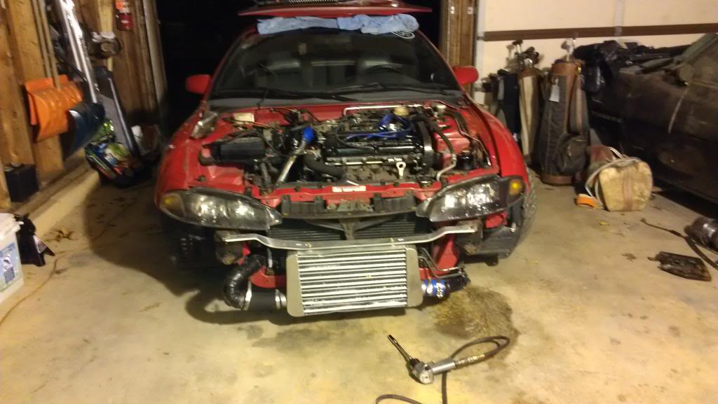

So after about 4 hours I got the engine in, bolted up, and ready to start up, with the new intercooler bolted up as well.
I made A nasty Rookie mistake and forgot to put Teflon tape on the oil galley plug behind the flywheel, and sadly it leaked all over my clutch. It was slipping within the first 100 miles to where it was impossible to drive. I ended up getting a free stage 4 replacement clutch from XTD and he let me keep the old one! I didn't have to pay a dime out of pocket.
All in all the build wasn't too hard and was extremely fun aside from my clutch setback. I guess it was for the best, the stage 3 felt like oem as far as clamping strength. The stage 4 he replaced it with is MUCH stiffer and grabs a hell of a lot better. It took me a total of 4 days start to finish for the whole build minus redoing the clutch. But i was burnt out, very tired, and my brain was fried. In the future I will have to force myself to spread out the work and not try to jam out a ton of progress in one day.

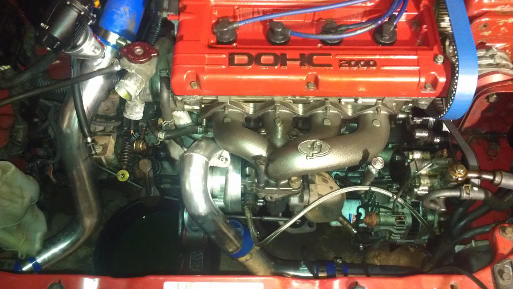

Manifold came in today. So excited it looks great, good quality metal gaskets, smooth all around. Very high quality manifold.
Drilled out all the old holes and heli-coiled them. Bolts kept giving me issues so i said the hell with it. Came out nice, also ended up putting the stud back in instead of having 4 bolts.
And finally got her mounted up, looks great, no leaks. Turbo seems to spool better and I can hear it now without the manifold ticking on me :thumb:.
