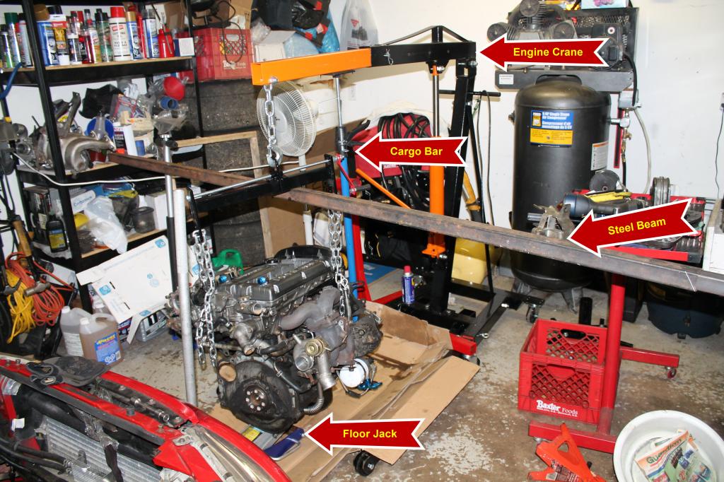

Finally got the engine out. Told you I was slow. Had a buddy come over to lend a hand.
Pulled the transmission off, then the clutch & flywheel, only to discover that I did not have the right size bolts to attach the engine stand. Will run out today to pick some up. But in the meantime, my buddy was concerned that the crane might leak down and drop my engine on the floor. So we devised a support system with whatever we could find on-hand. LOL
Pictures aren't so great due to all the clutter in the background, but you get the gist of it. :)
